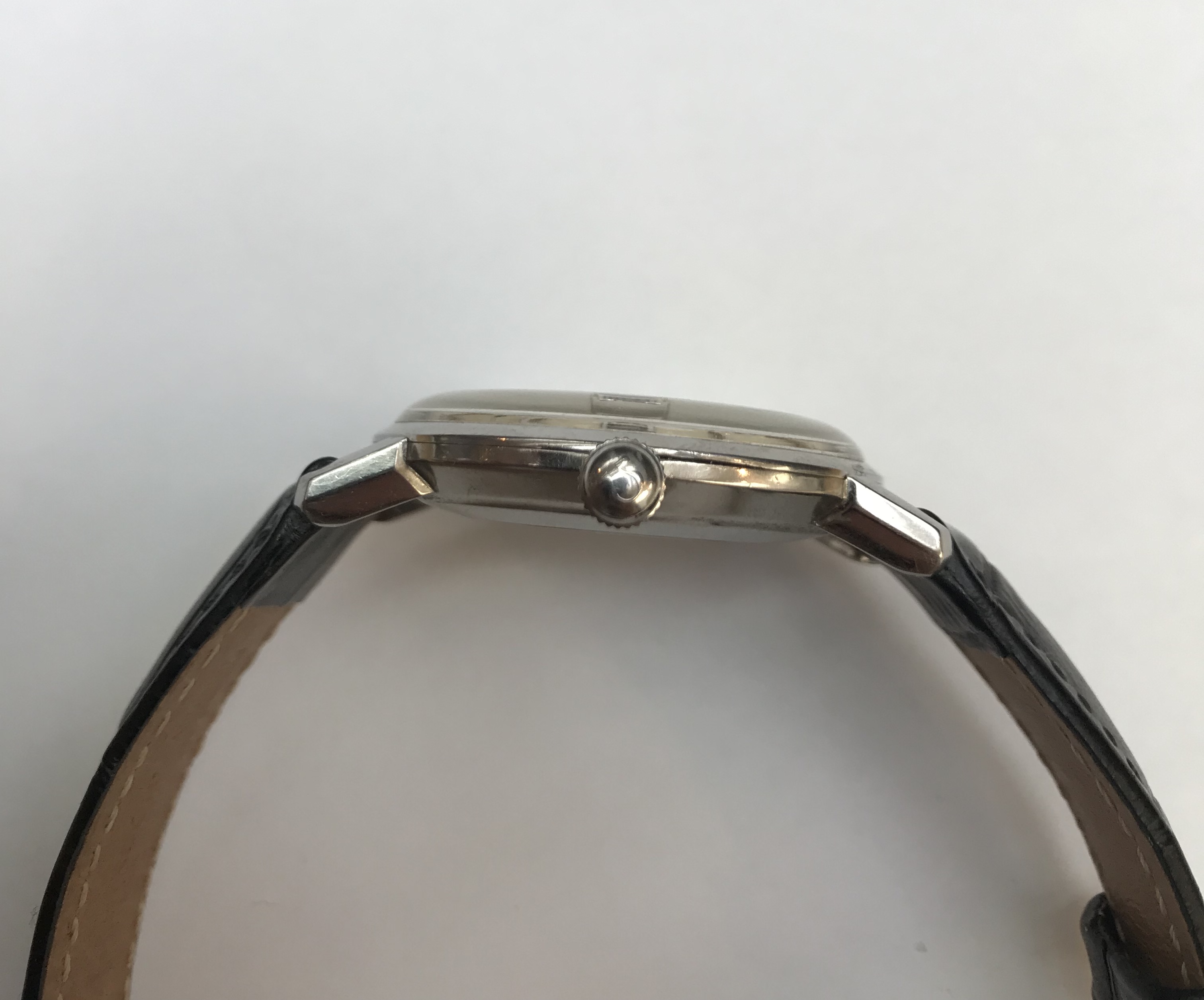

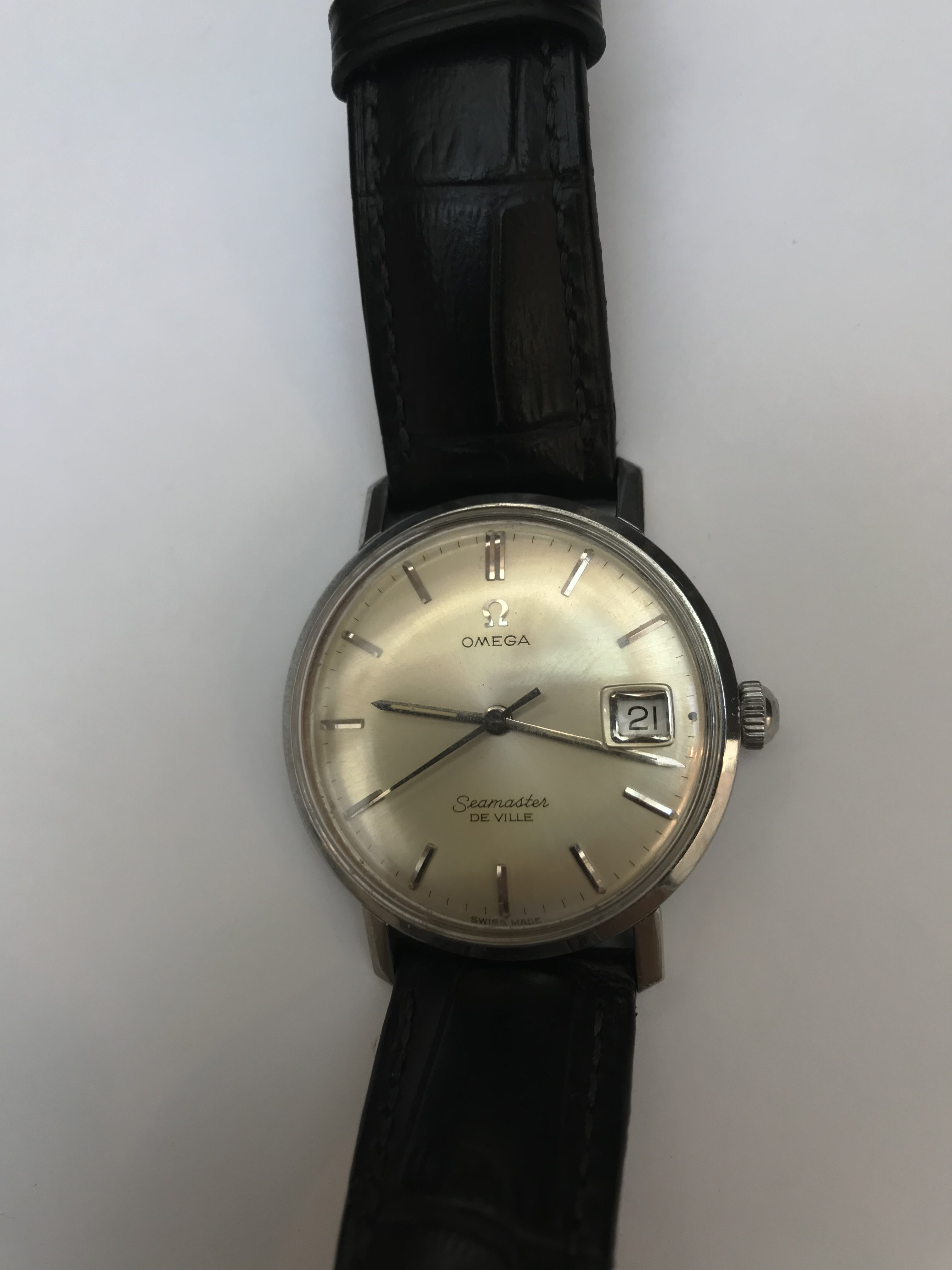

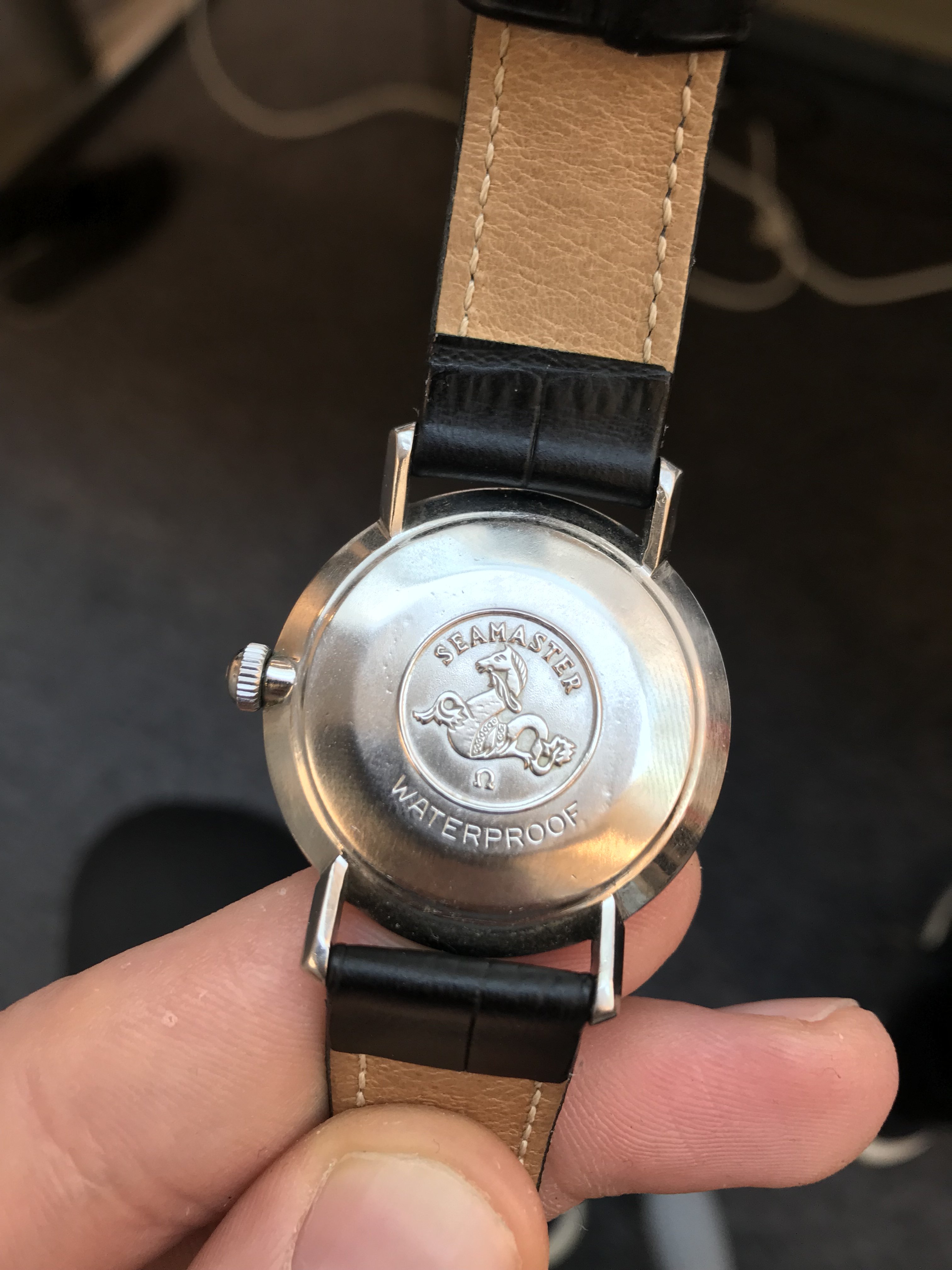

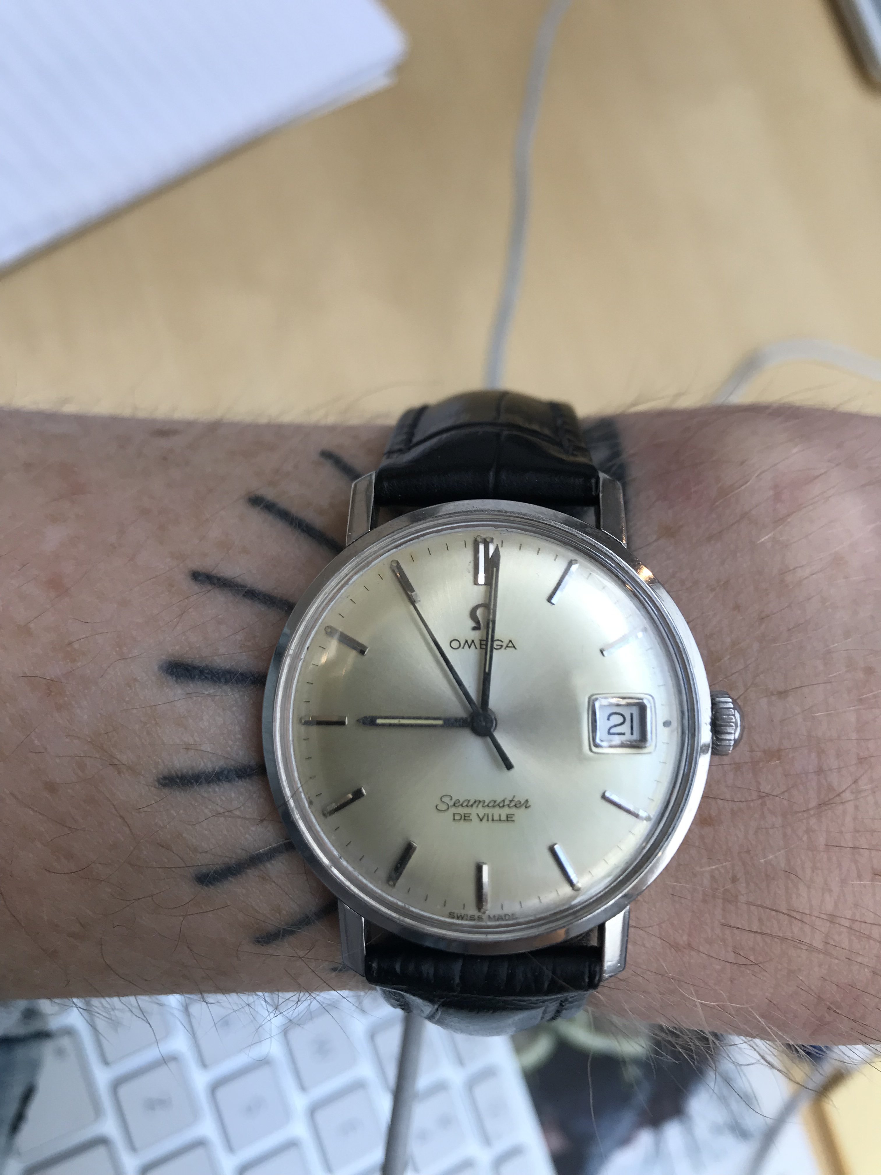

I’m new to the forum and vintage watches, need your help to identify my first Omega Seamaster. It was a gift from my parents on my 30th birthday. All i know is that its a manual wind and that the lug width is 18mm. The watch has been serviced 1 year ago.

IMO an early 60 ies (No "T" on the dial) manual wind, could be cal. 61X
Crown is wrong, otherwise it looks very good.
7 Row BOR with 70 end links should look good on this watch, see this one for comparison (taken from an older sales ad)
