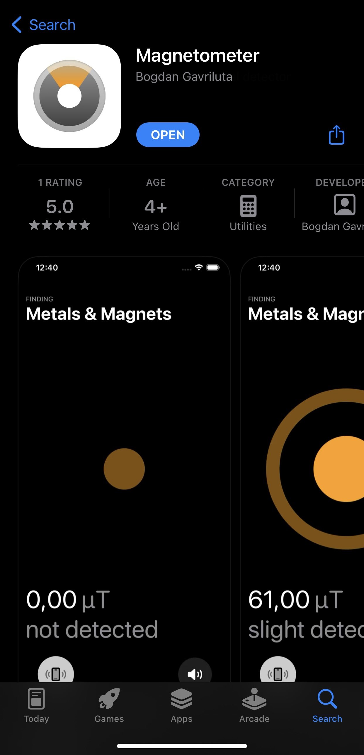

Can you self check if it has been magnetized?
Yes, there's an app for that.
