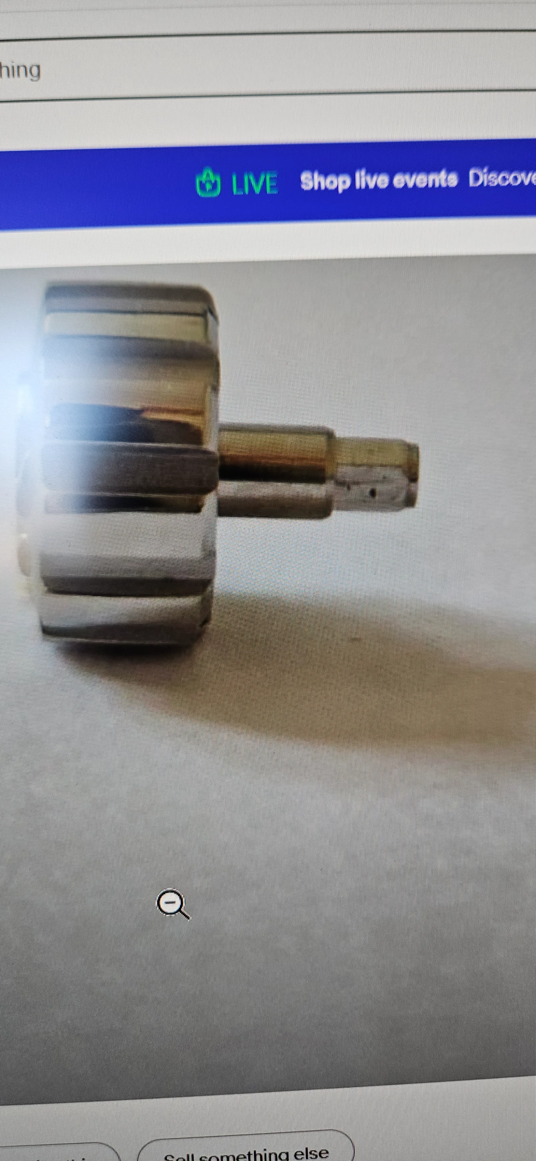

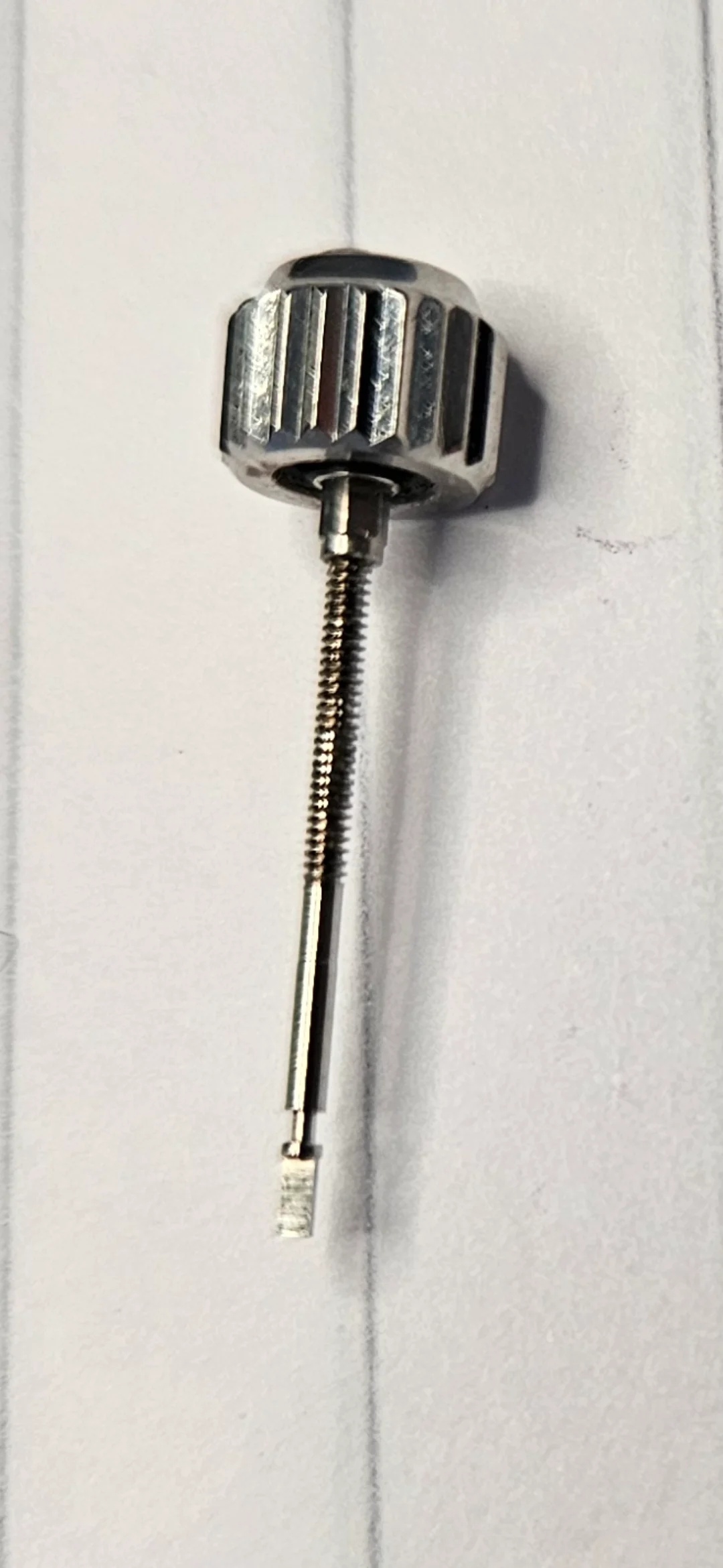

Cheers the problem im having is the crown doesn't pop when unscrewed. It works fine. Im now wondering if the crown is engaging the spring when screwing in heres a pic of mine and one on ebay. It looks like mine is partially stuck. Any thoughts? Thanks

Crap. My bad. Thought it was a vintage Seamaster 300. Nothing to see here. Move along.
This is a concern

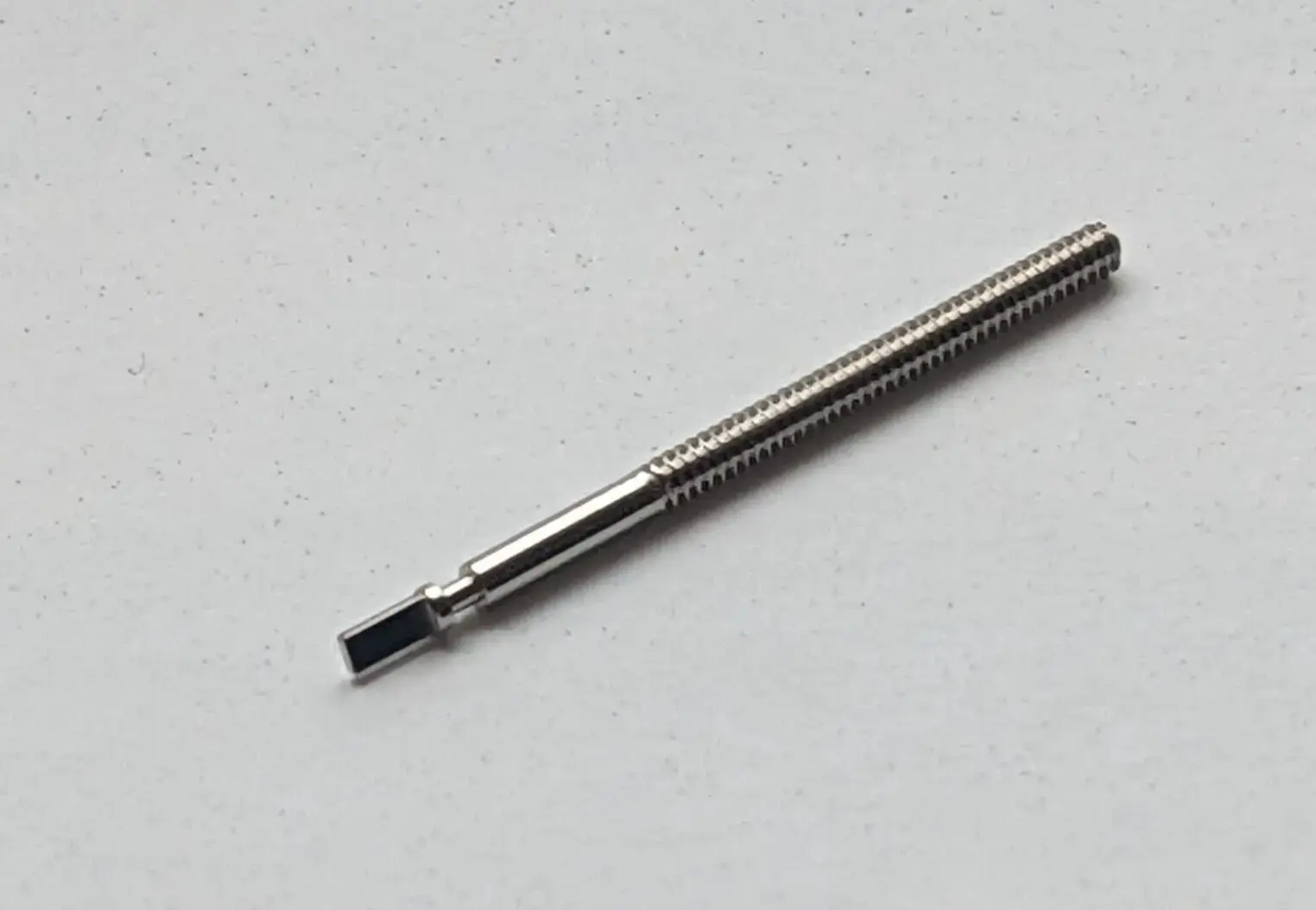

Stem is missing the tip. Should look like this.
2,358
2,540
I don't have experience with this watch, but typically the 'pop-out' is a feature of the crown itself. The spring is inside of it, not inside the movement. Can you compress/see it pop out as-is? I wouldn't expect the stem length to matter for that (unless it is slightly too long? What does it look like when you've tried to screw it down all the way?).
@redpcar has already edited his post, but your stem base has no problems. Stem for th at movement seems should look like this. NEW to me to see one without the little protrusion!

Hi your right its the crown. Now its does move when i put pressure on it but may be not enough
