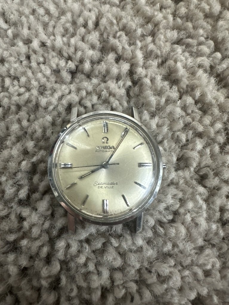

I received this Omega from a grandparent a couple of years ago. It's a stainless steel Omega Seamaster Deville, automatic. Sadly, when a family member was evaluating the watch shortly after receiving it, the crown popped off and despite hours of searching was never found. The movement seems to be working well as it immediately starts ticking again shortly after moving around with it.

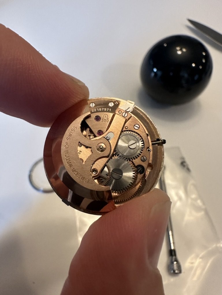

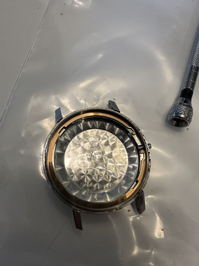

What I can see:
Caliber 550
Serial Number: 22187971
17 jewel
Case number 165 020 (I think, it's a little hard to make out whether there's a number between the two sets of three)

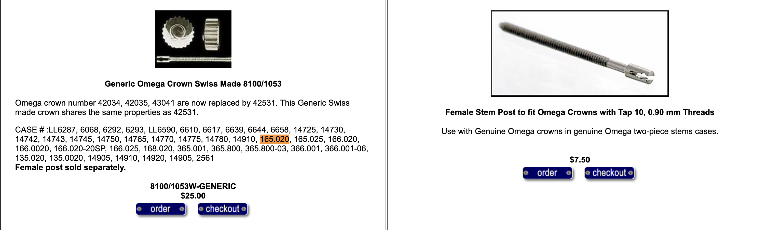

Trying to figure some things out as I go along this afternoon. Let me know if I'm on the right track here. I saw a couple of people mention Ofrei so I checked out their website. Would this be the right thing to order? I would need to order both the crown AND the female stem next to it right?

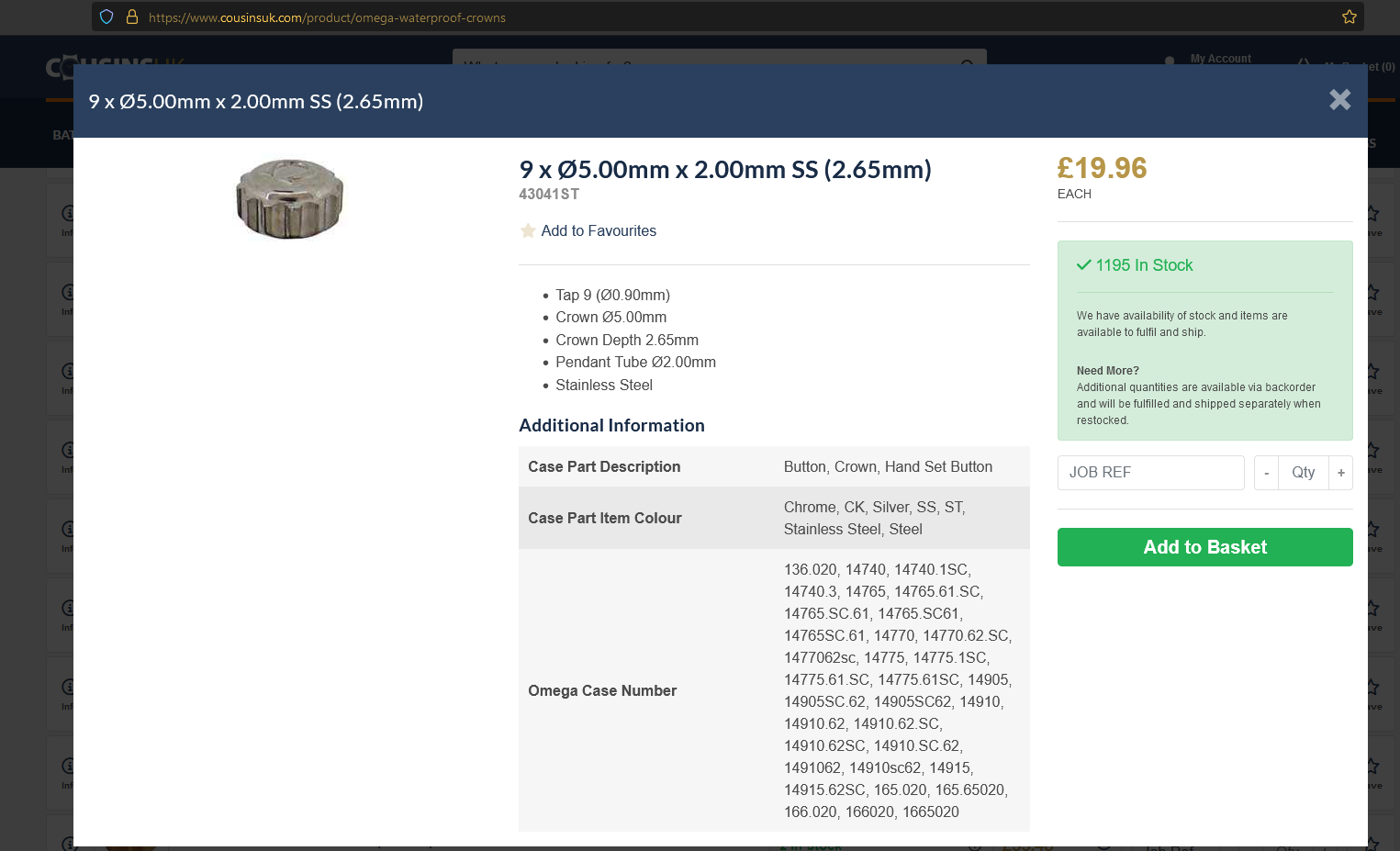

I would also advise to find a local watchmaker to take care of any issues. The crown reference looks to be 43041ST if I'm not mistaken.
Here is one on https://www.cousinsuk.com/category/filter/omega-case-parts, but you might find some on other sites aswell. I recently bought one off ebay once ensured it was the correct reference. Here https://omegaforums.net/threads/crown-glass-gasket-list.81619/ are some catalogues with matching case/case-part references

The correct service crown for the DeVille mirrors the wide edging shown on the 43041. This is the correct ref.
The fine toothing on the OP crown is incorrect.

Those prices are not out of line, and could be higher if very many movement parts need replacing.
In any case, the current replacement crown that Omega identifies for this case is 069ST42531 - the one shown on the Otto Frie web site.
Yes, you will need the female part of the split stem, and depending on the condition of the male portion, you may need that also.
