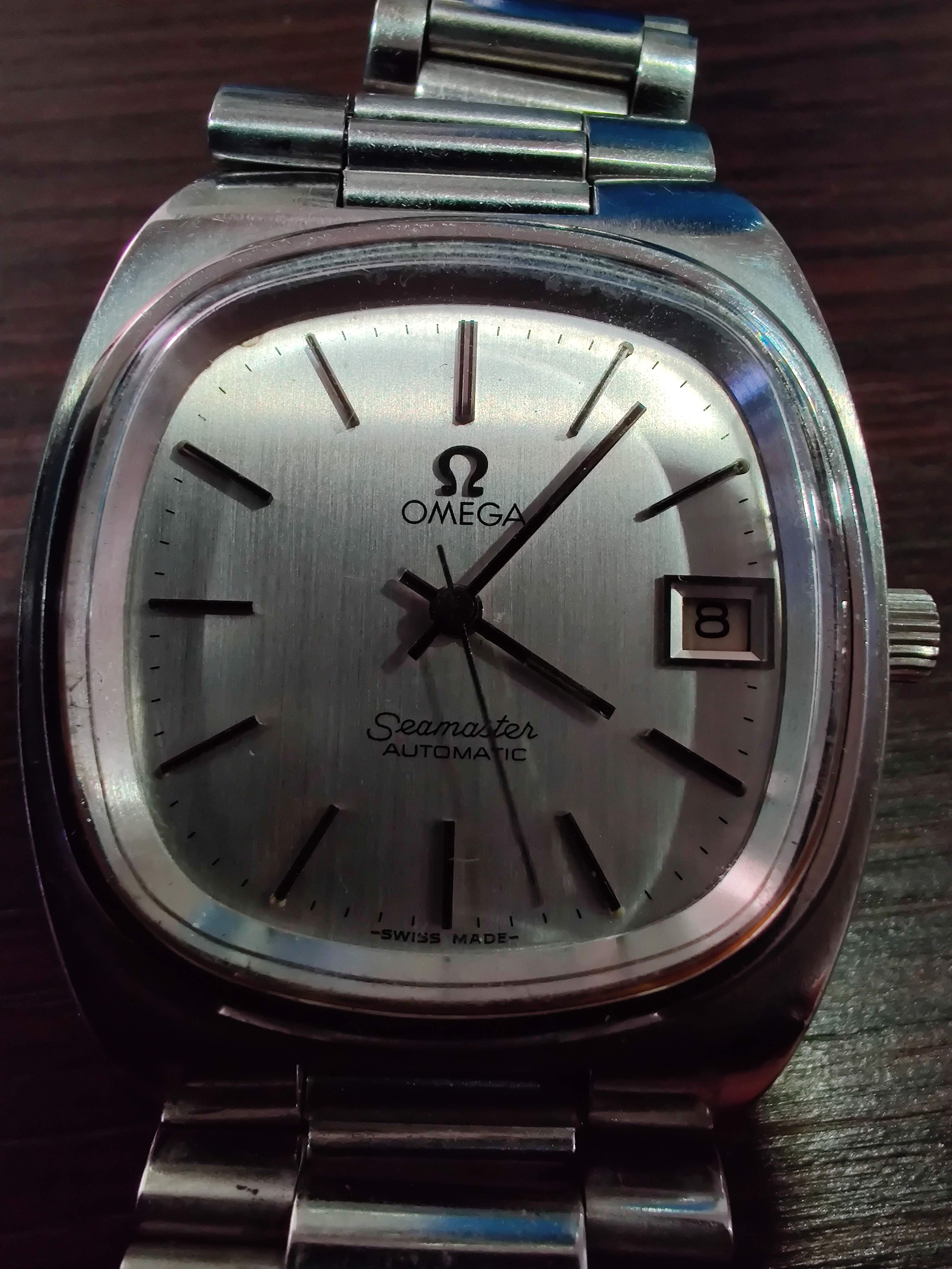

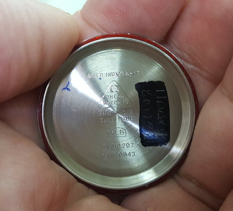

I was hoping someone can give me the part number of the crystal used on a 166.0207 case:
my crystal is a bit broken:
5szEhSRr-885GCNwitnCtOgIqLt2L9uZM7Yk57R9vI2DGuM4lrRlbSH3qfJTghKGtRE1z_LCPt61HR7uG7fZtjuVGLZwhl-36mjURLB-oZb7rPlPcLsdnYN22LQqn_BGCUH6WEZhe_QNzsZ5TjxUMzE8e1IT56LFCbEOQlv7Np48jrS2U4v4V7N9O3I2y2ZC2sFqt8Y4fSmnUk6hgAIL9SoAX0owPuMRl8aMLnTFFkTKHI7ZxVK7pSN6t6S6s11H3Gcpwb8fnmJbja3fqCn_-NQxcMA-1vs_Hcovx7gC0DgL4VBK1V7uIhGmm6kLDWW-OaeFOOvrPMOiKt1NGI3vps65mNN1ekGue7rpaUGmEqX6JDup0AvAcH-ukdeNy01EeX0m4JSCMbrk8p6rxlk034h1lpw6cl67Mei_LLti_W7YMTgLEGfcpaCmqTyG2ECacww-Ve6U7-fpA-VWAm1y7EruTT2cvvxfh-qiDzxF53Pg2sV4TC5B70bjsmuElUZh2C7fmPavEKz6gneLvw6-4bXvqJLOwX1txeIV93GQJKQ9hPJPBE5cVwoxE28sHUEmb71J0iePDXI5gf872MCwCiFhcUiUMgzG1s0aKKcDljW7a8YepxjqoBudZN1XFSb2LuE3XJlec1bh7spw2Lynlc8oXCDtTsp4bmAqBvOULqGStiUSX9x7wrL6uVG6qQ=w1292-h969-no
and would love to replace it, but i just dont know what is the part to look for and buy here.
Can someone be so kind and help me out?
Thanks so much
18,791
39,041
http://www.stsupply.com/pz5289-omega-crystal-white.html
"White" means that the tension ring in the crystal is silver coloured.
You could also use a "gold" tension ring crystal as it looks like your watch has gold indexes.

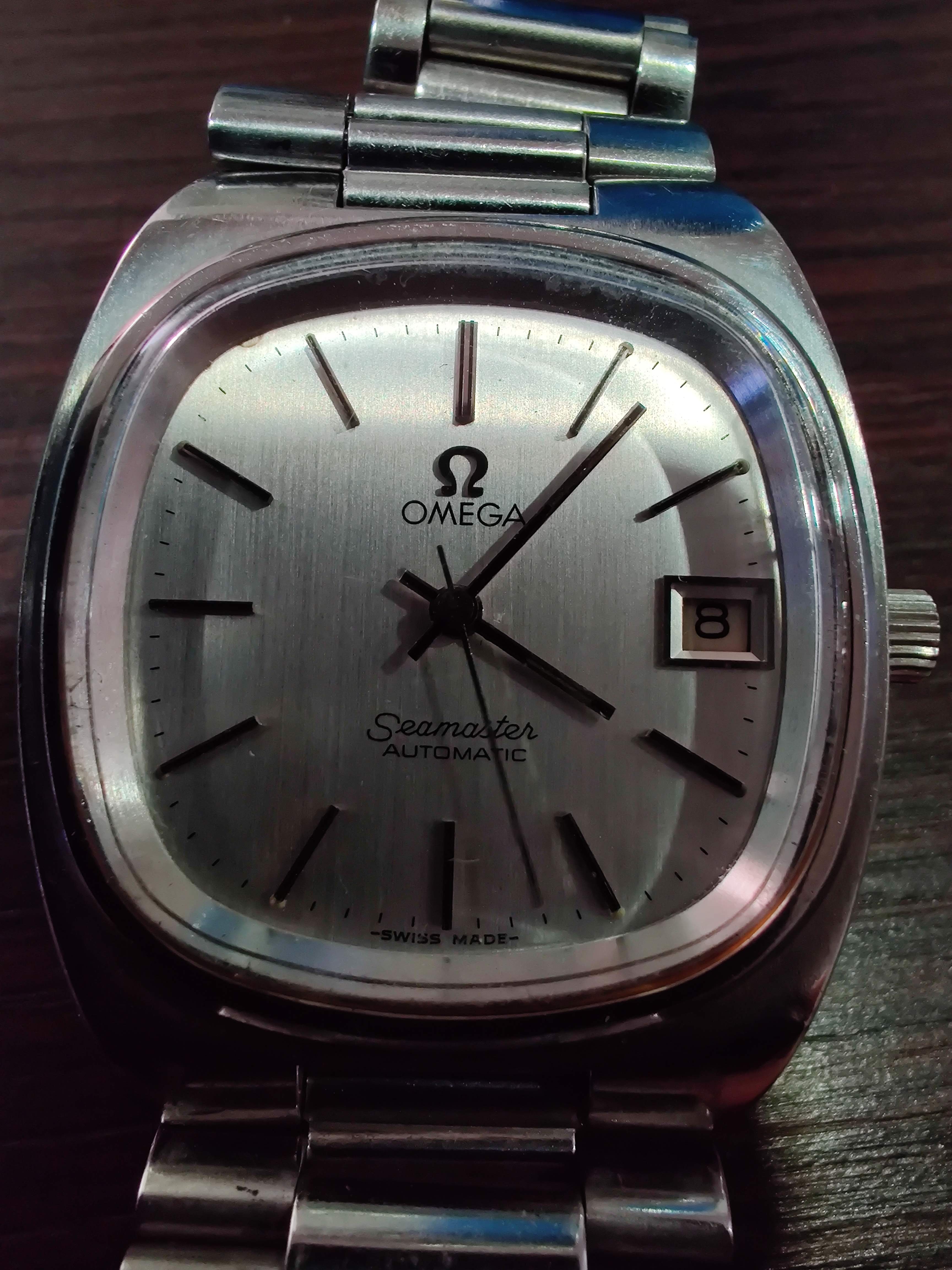

i think the light makes it look like it had gold, but not rally:
X-GYEE5xdy6cAQ-YjQtFhLHIKcCryVf4du9QzcybT9rFGZSEWRzPk_cah0o61rOdF42OfMqbm_xVjEDi8vccSbPNCTuqlJeHXv12PoJ98uuvR_YEF1uxHQ5ECf_iAEZiX7D70msM6lVuE5LiWA1SeMwCJKY0GkdnJcQs2jutzrRfkDiv_Bw_MFsEUE624p7FfyGY9aPlHEABwTpOMNRJqVzR6hpvaxO-t75T9KLQmhY7XUvCyUHRps3-wnRPBSby_f_bumF3hv7wguTJuz_CUQdKdFDidr3-F0DgsUaLsGRVbS9yG-QjvsFvTs0rdeZQN8PdIT8JF4rVH2YFe0mWlRspYIBRbXaXipJ_s0AAfBANLZ6aX8NIbnvJ7Wn-9whSpQrRW7gpROPt5knsyI2jPtLNXhck9ojR3w9FmvNqlALw2NdgSdvNIVTNlM4BMxiAdB0k8zNlaVhjlU89y5YOXjCY6CC42qmPBK08PFwXX9-k2pwVXDh5w4C8q0spZ3VLPhYqP0ARaxoP9KtoAL799-xHmOlq2HKkw6m7CGpAJDIpuFx_WUqcx2eap_IAeFXg7On9HBuBrAL10KIHcXiQL-APueZeTSZFmXHRguyPNeUZ0fLdzuuZd7tz9-C3U-TEK7TSIR1QF1B0xkuiW1-WW7b08-biNdVJYIs3AQxW6Imvt9AOc7RFqeO89u9KMg=w727-h969-no
Again thanks sooo much you are a life saver!
