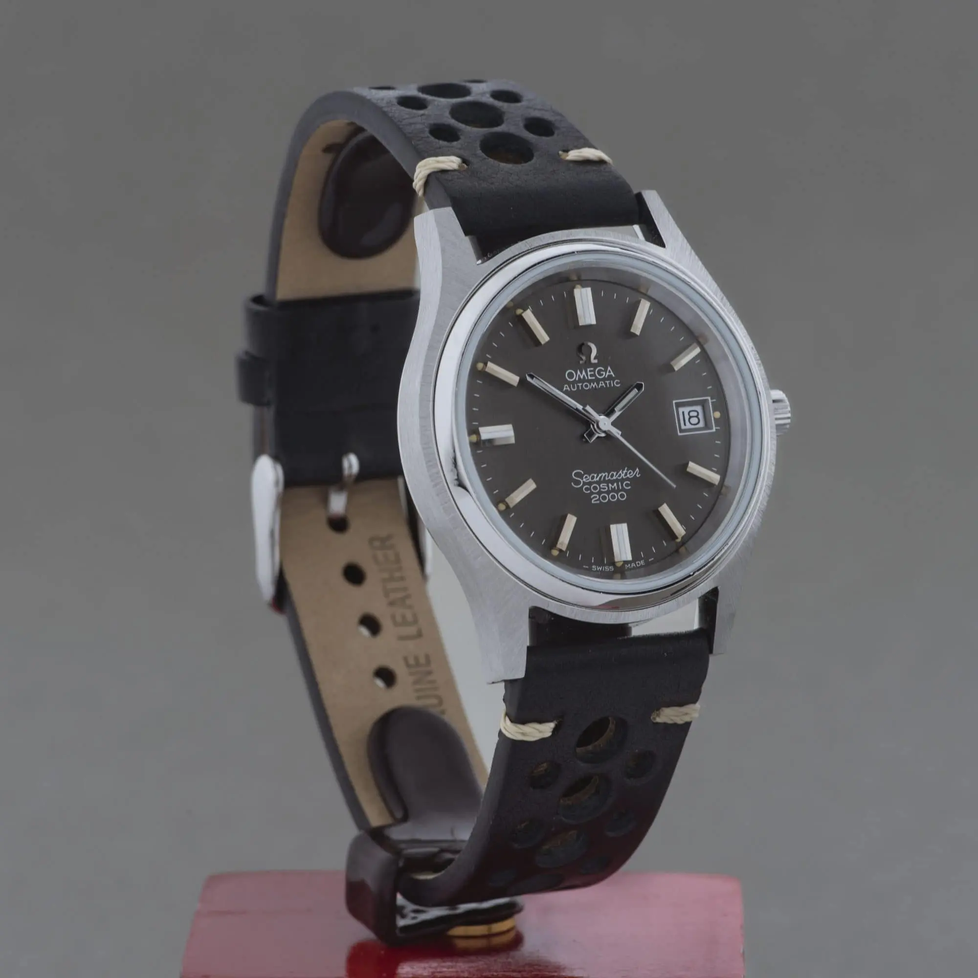

Hello everyone,
Hoping to get some help to find a source in europe for this crystal or the part number?
My watchmaker likes to add hefty profit on parts.. and want to look into it myself, example of the model included as per photo.

Note that this is not an expensive one by Omega standards, mainly because it's a mineral crystal. There's nothing special about this crystal - it's a flat crystal 2 mm thick and 31 mm in diameter. If your or your watchmaker can find a mineral glass or sapphire of the same dimensions, it should work fine.
