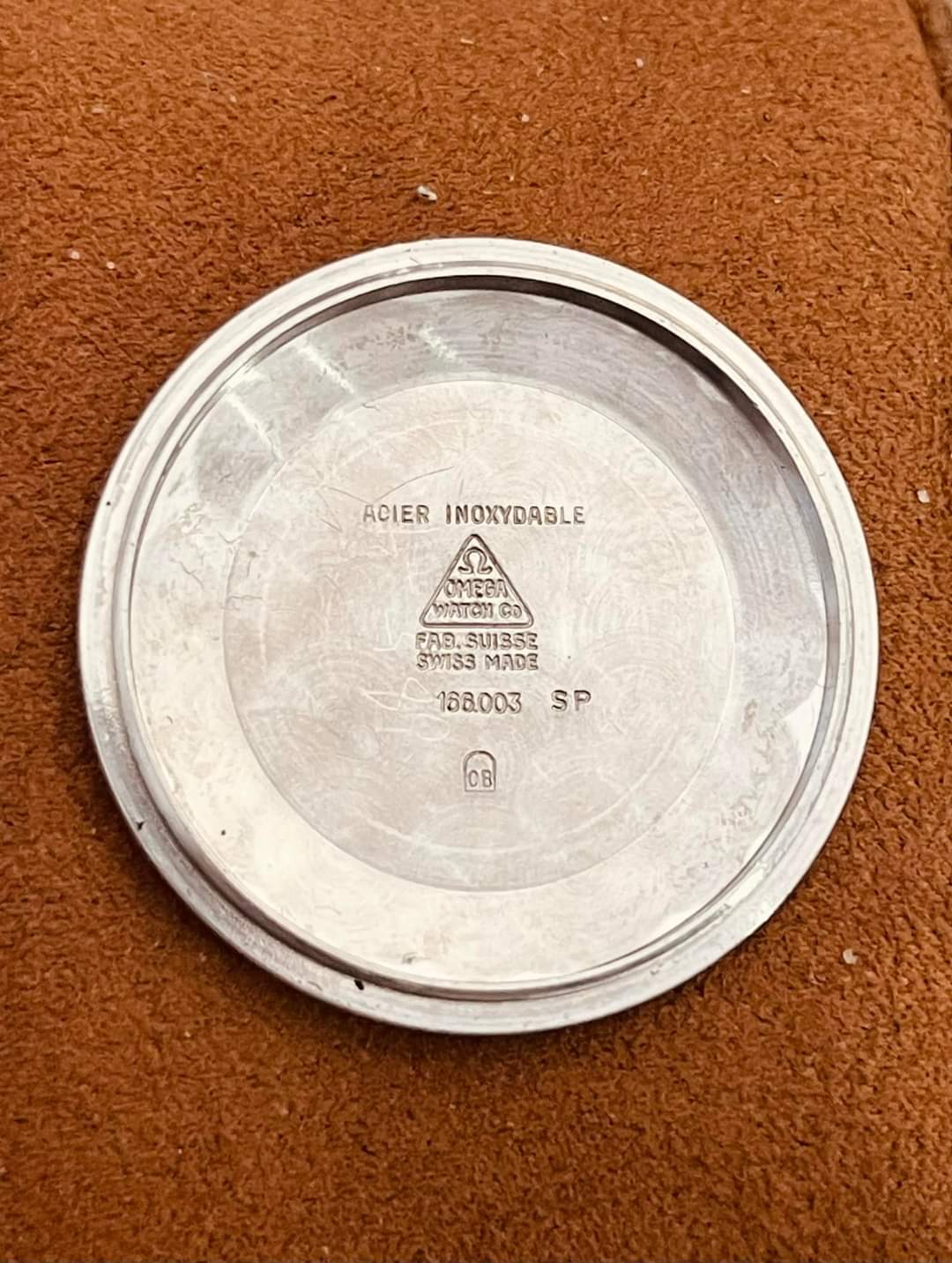

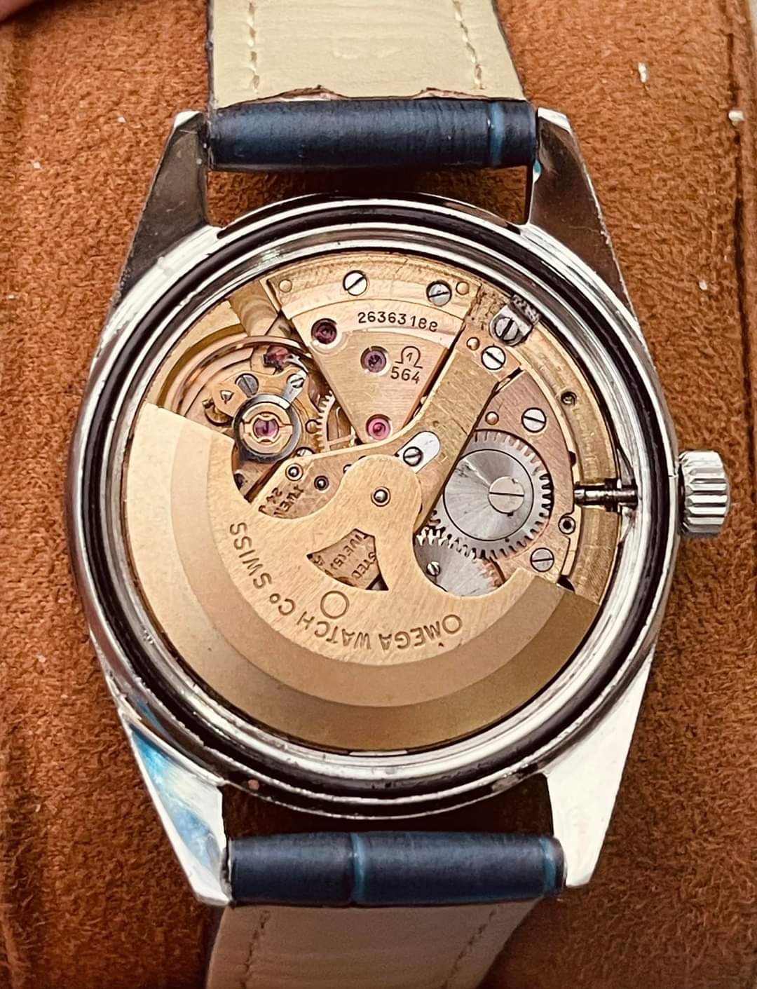

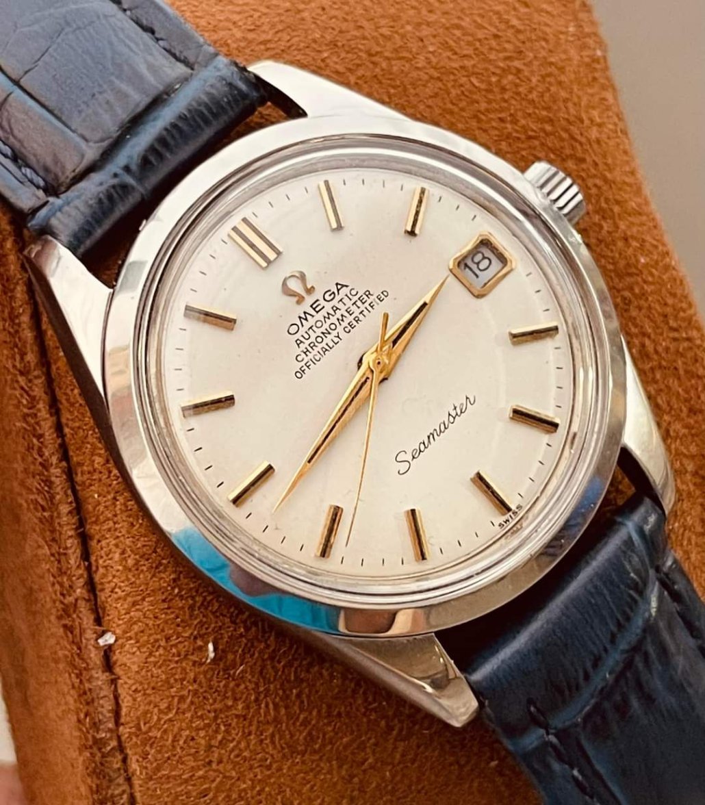

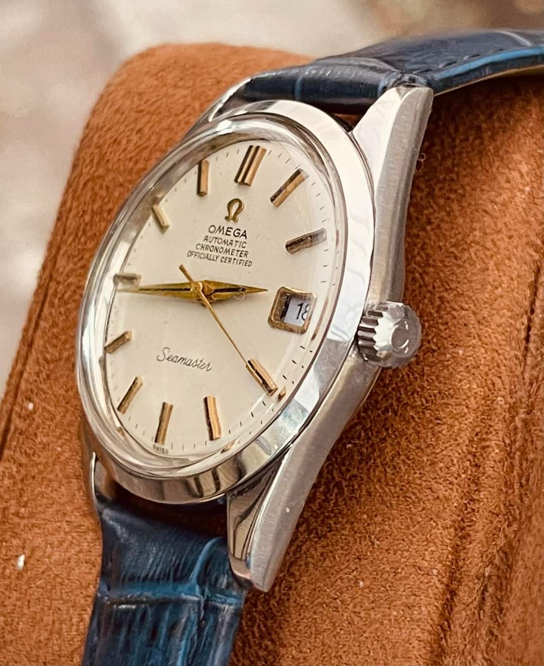

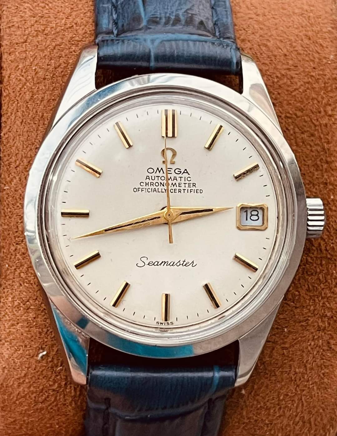

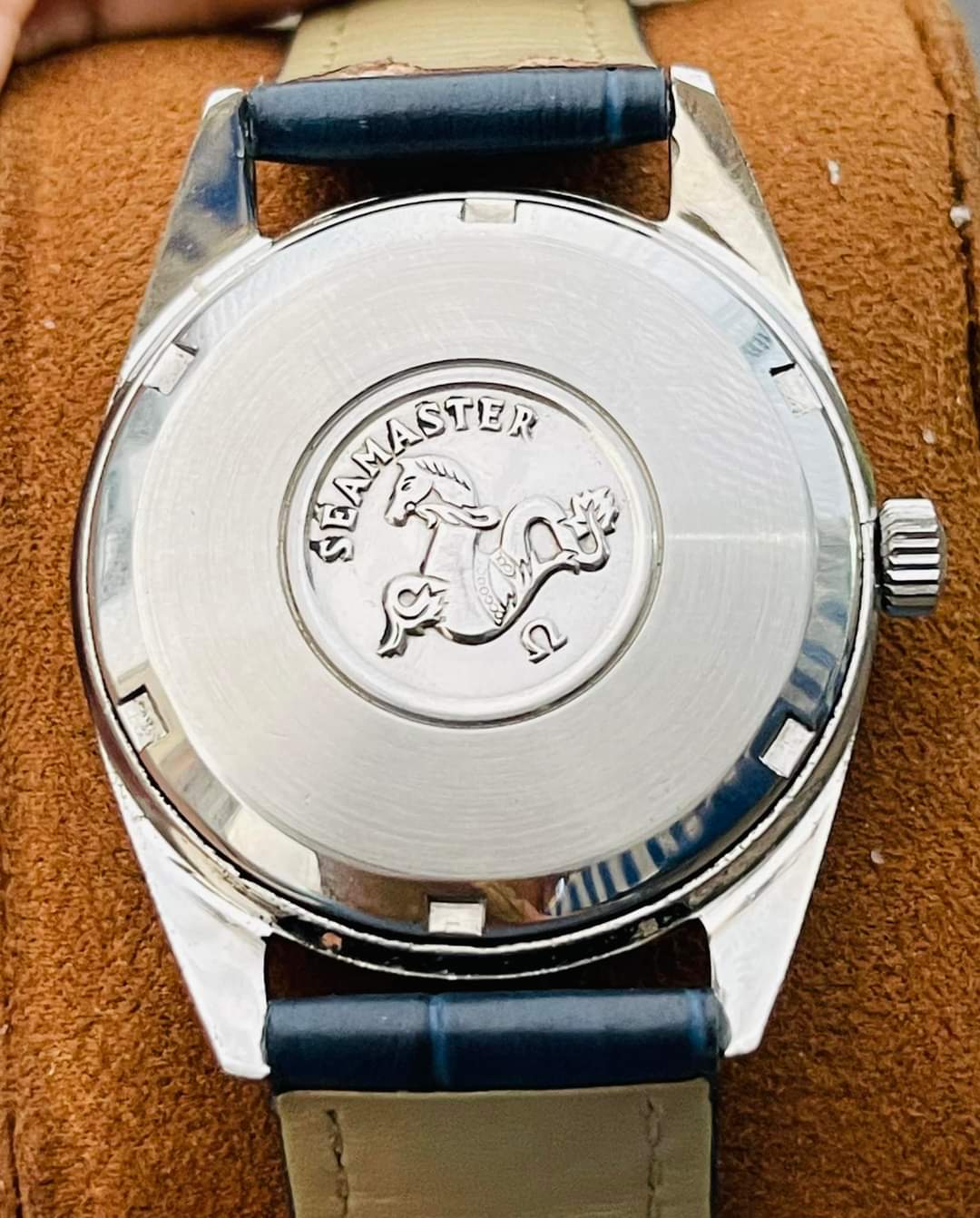

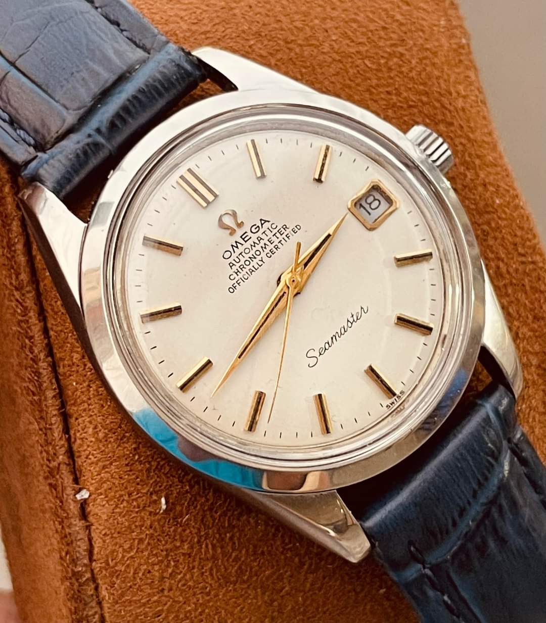

Im dealing with seller with this Seamaster, using 564 cal. with Chrono Certified. Do you agree with the price of 400$? I'm a newbie on this vintage watch enthusiast hobby and would love to hear your opinion.
Please tell me if this omega is original
Thank you so much and have a nice weekend guys.

I have some questions on this one. According to the Omega Vintage Database, Ref. 166.(0)003 should have a non chronometer rated cal. 562 or 565 movement.
https://www.omegawatches.com/en-us/watch-omega-seamaster-omega-cd-166-0003
However, this example has a chronometer rated movement and appropriate dial. Generally, when Omega produced a chronometer version of an automatic Seamaster model, they assigned a different case reference number, usually starting with “168”. We do not see that here.
My guess is either the caseback was replaced at some point, or the movement and dial were transplanted from another watch. I also think the rotor was replaced with one from a later movement. The parts of many Omega movements from this time period are interchangeable. We sometimes call this a “Frankenwatch”. It will never be a true collectible watch.
All that being said, it’s likely worth every penny of the $400 being asked. That’s a low price for an entry level Omega, and this one has one of the best movements they ever made. I just would not spend huge money on a complete service and would not treat this as an everyday watch.
It’s certainly a nice looking example.

Funny. It looks a bit like a 168.024 with a gold hardware dial, which I've never seen on a SS case, with a wrong caseback but a correct caliber and serial in range for a 168.024

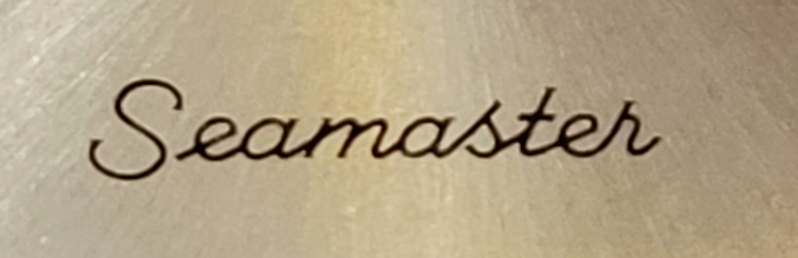

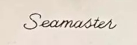

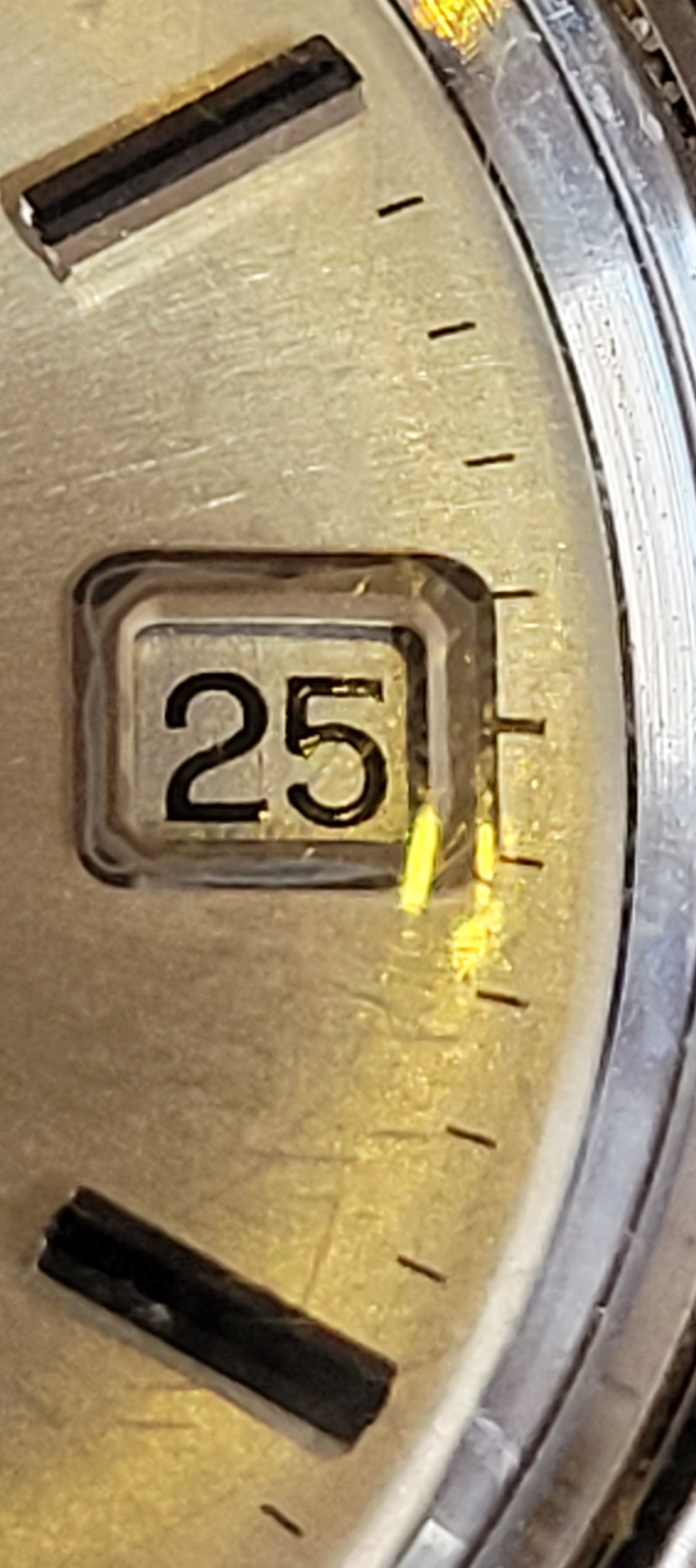

+1 for repainted:
"Swiss" instead of "Swiss Made"
Omega "O" looks very bad
As said above never seen such a SS Seamaster Chrono with gold furniture
It seems like the stem is broken
I would not buy this watch!
My exact thoughts.

What I was saying is that the watch is worth the asking price. However, if you add the cost of service for the watch (likely another $200 to $300), you will be well past the watch’s value as a Frankenwatch. In addition, because of the issues mentioned by the members above, that value is not likely to increase very much.
So you can either spend the money on the service in excess of value and have an everyday wearer, or stay within the realm of the real value and use it very sparingly to avoid damage.
This is a decision that watch collectors should be weighing with every purchase, unless you don’t mind overspending.
