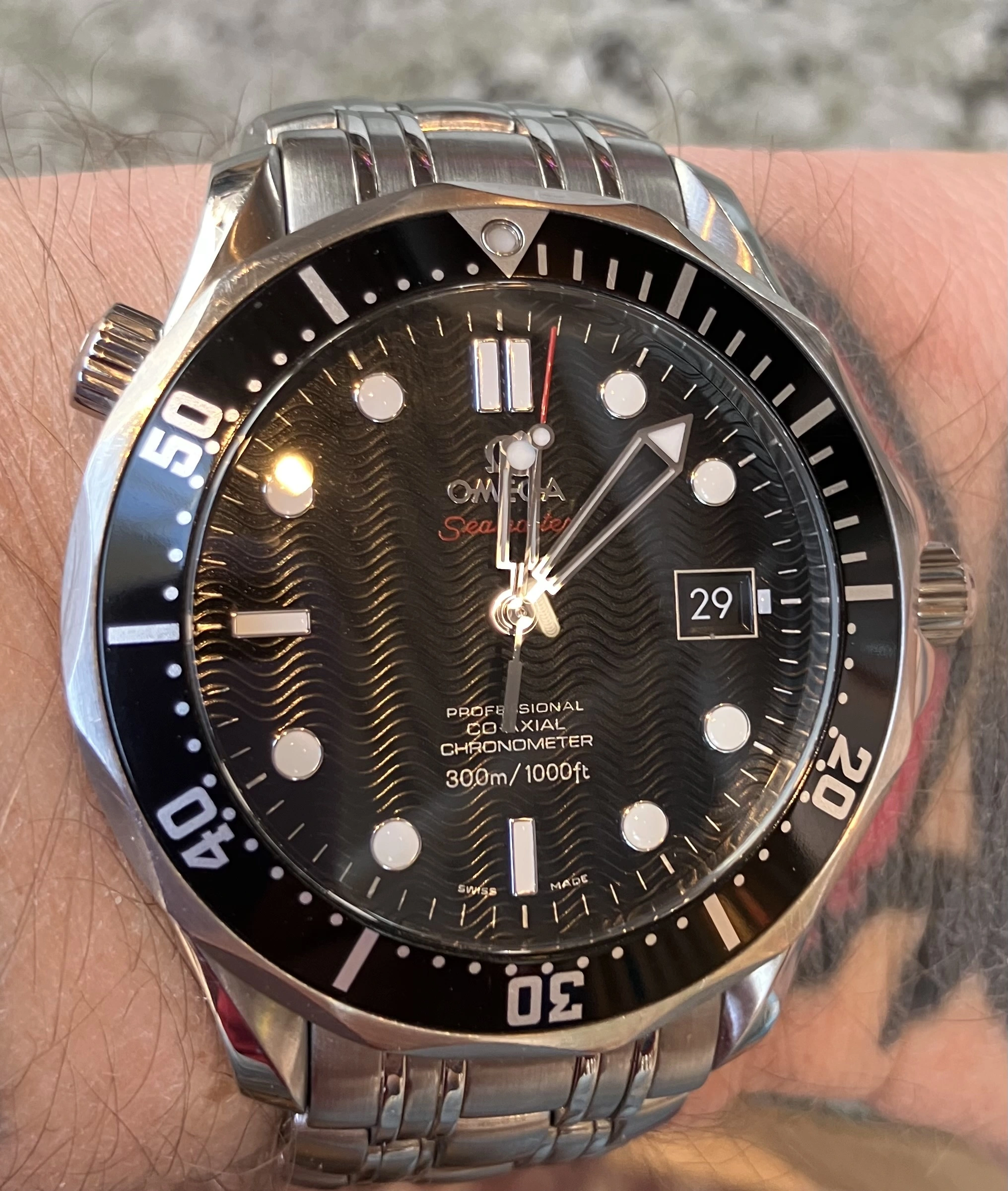

Hi, I'm new to the forum and just bought my first Omega. It's a black dial Seamaster ref: 212.30.41.20.01.002
The watch is from 2012 and I have the full set. It was tested 2023 and it gained +3sec / day and I have a receipt from that also.
I bought the watch a week ago and it gains now +12sec / day. The previous owner is not sure when the watch was serviced last time since he bought it used that year 2023. The watch should have 48 hours power reserve, but it's more like 43 hours. Other than that it works fine.
Would you get this watch serviced because it now gains +12sec/d instead of previous +3/d? Or any other insights if I should get it serviced now? I can live with this +12/d but I thought that maybe getting it serviced would make it last longer, if it's now dry or something like that.
Any thoughts would be appreciated. Sorry for this rookie question.

I would get that serviced, it's most likely never had a service in 14 years.

Have you tried putting it in different positions, when you are not wearing it?
May help - but I'd get it serviced regardless.

That can be easily regulated without a service, but that bezel insert alignment relative to the scallop ridges is horrendous. Good lord!

I'm not sure if I quite understand what it means to regulate a watch. But if it's anyway three years or more from the last service, should it be better to do a full service? Of course, I wouldn't like to pay something like 800€ from a service if it's not needed. My intention is to keep this watch a long time, so I'm willing to pay that money if it gives my watch a lot more healthy years.

How something like this can happen to the bezel? I suppose it wasn't like that as new.

It likely was not serviced in 2023, just regulated to get it to +3 sec/day on the timegrapher for a quick sale. I suspect that 90% of watches sold used are never serviced. They just get traded to a dealer, the dealers gives it a quick inspection and regulation, then off to the next buyer.
Get it serviced if you I tend to keep it. As far as the insert, someone has been messing with it. That can be fixed during a service.

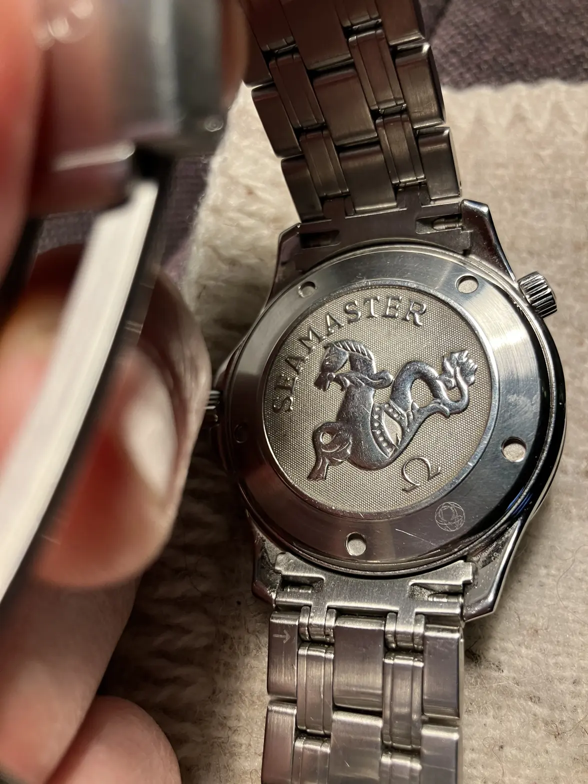

Does the watch look otherwise authentic? I got scared that it might be fake because of the bezel.
I attach a picture from the back as well.

It looks good.

Man, send it to Omega for a full service. It’ll come back looking good as new, keeping accurate time, and it’ll have a fresh 2 year omega warranty. Worth the time for a piece that has sentimental value.
But maybe wear it for a while to bond with it first? As you say, just keep it dry.

It looks good to me. Don't worry about the bezel too much, Omega will sort it out - and you could even do it yourself if you're that way inclined. You picked a great watch.
