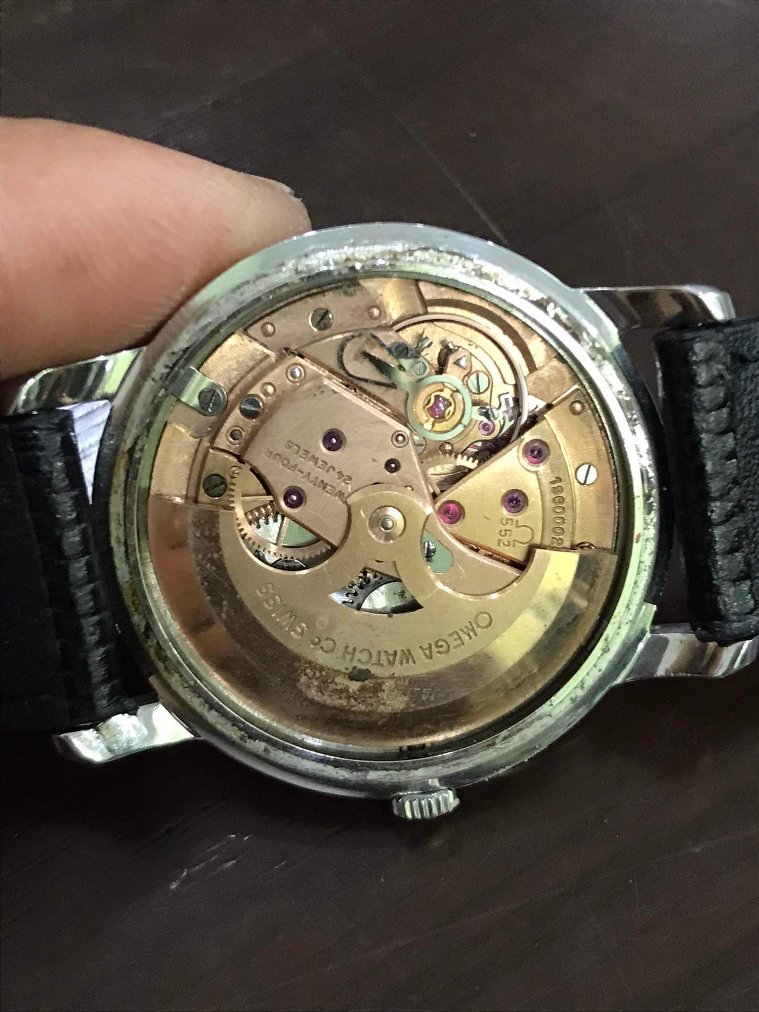

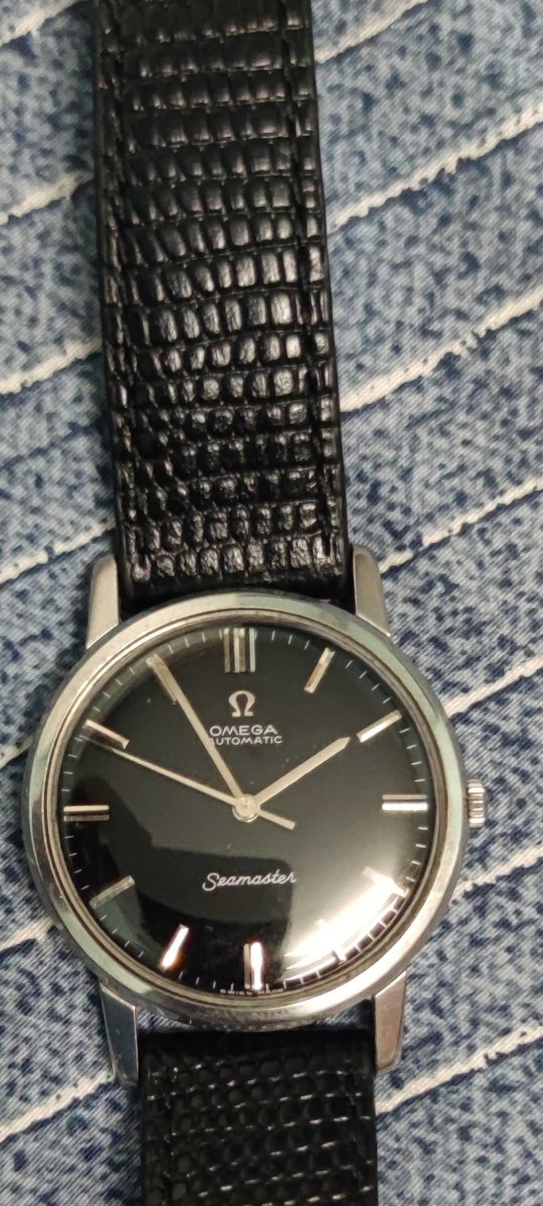

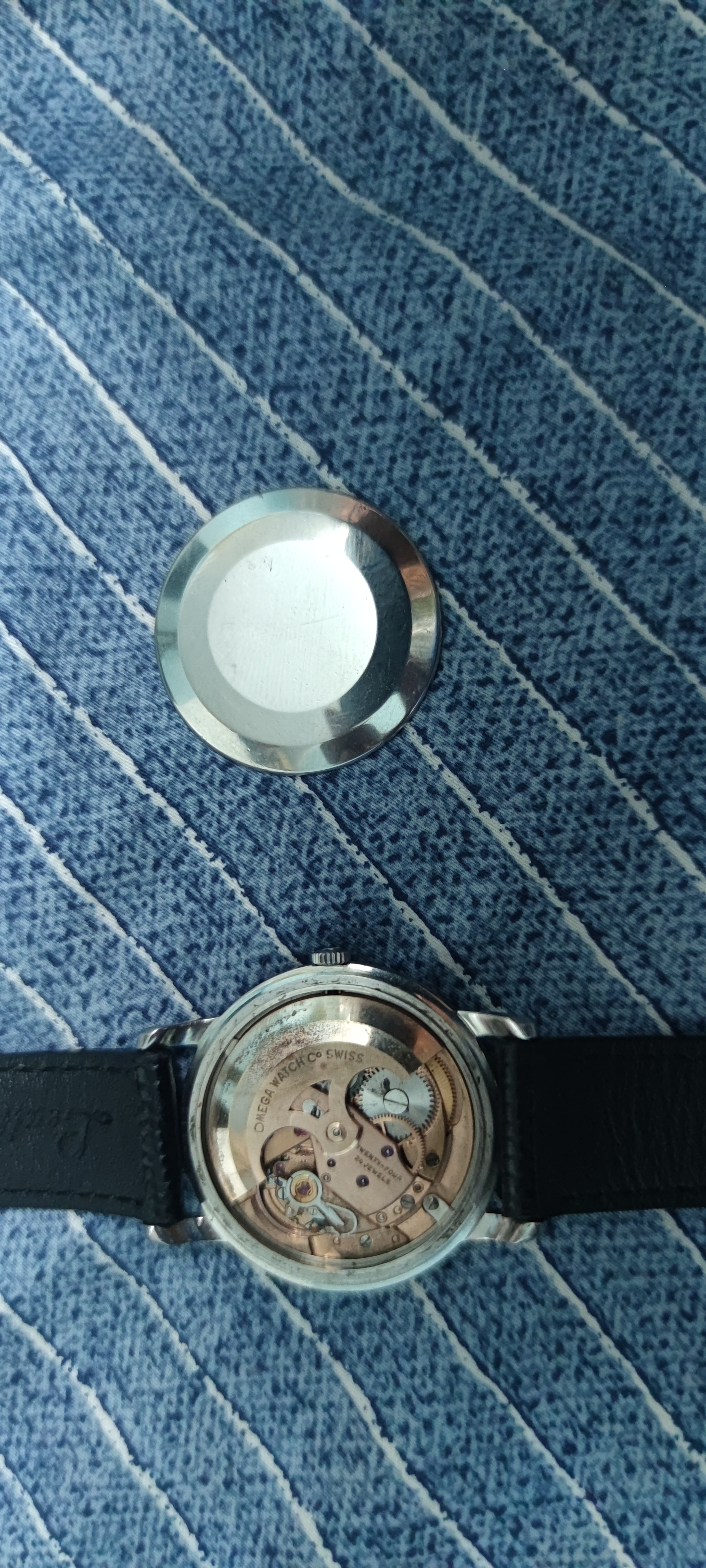

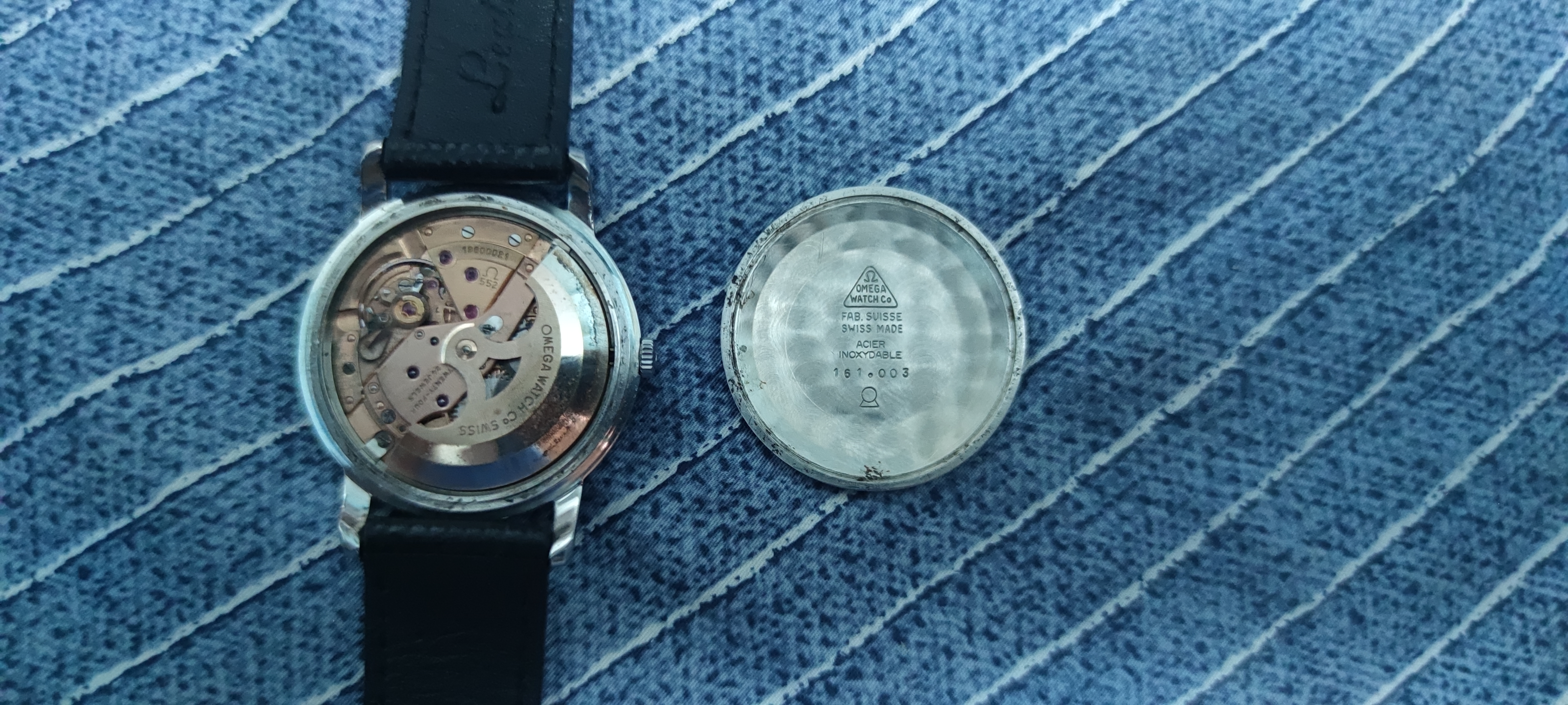

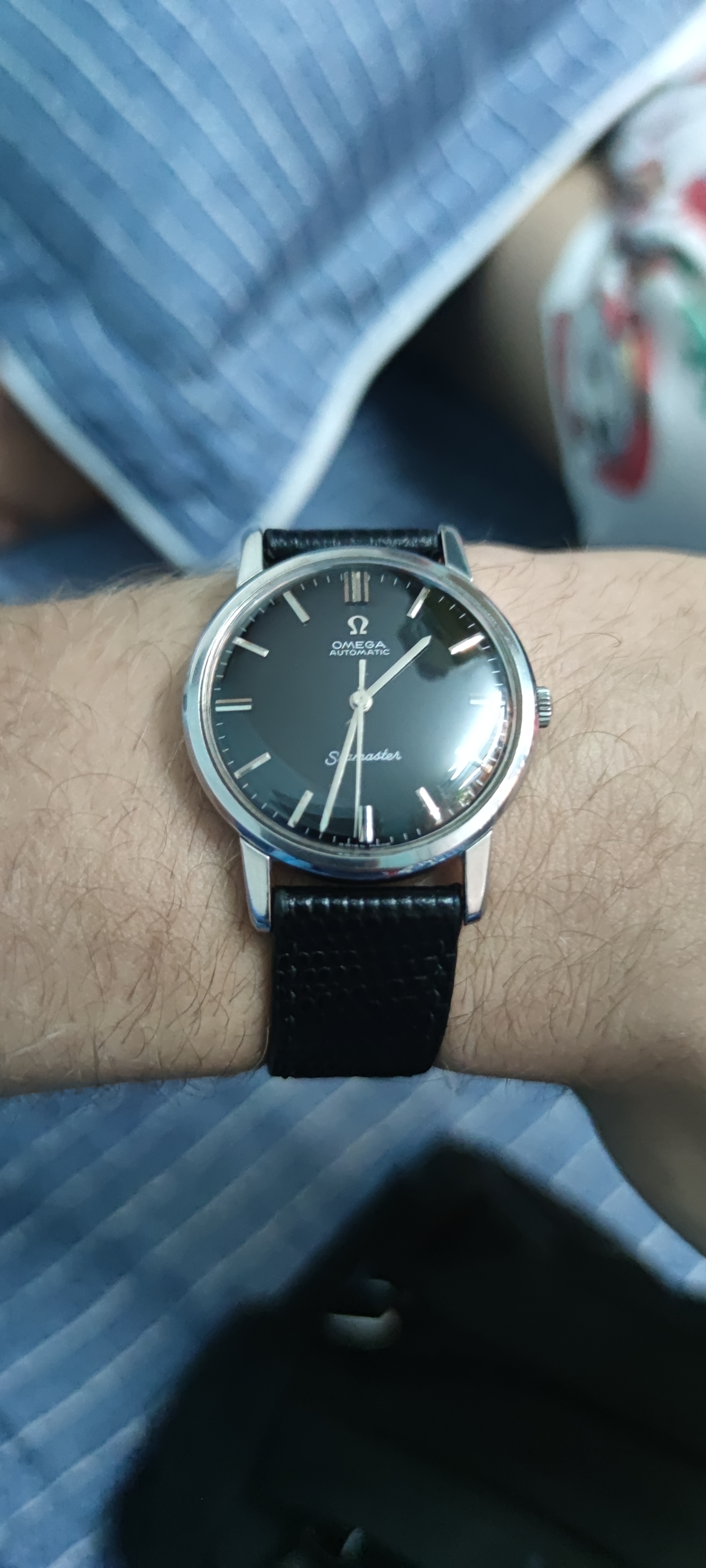

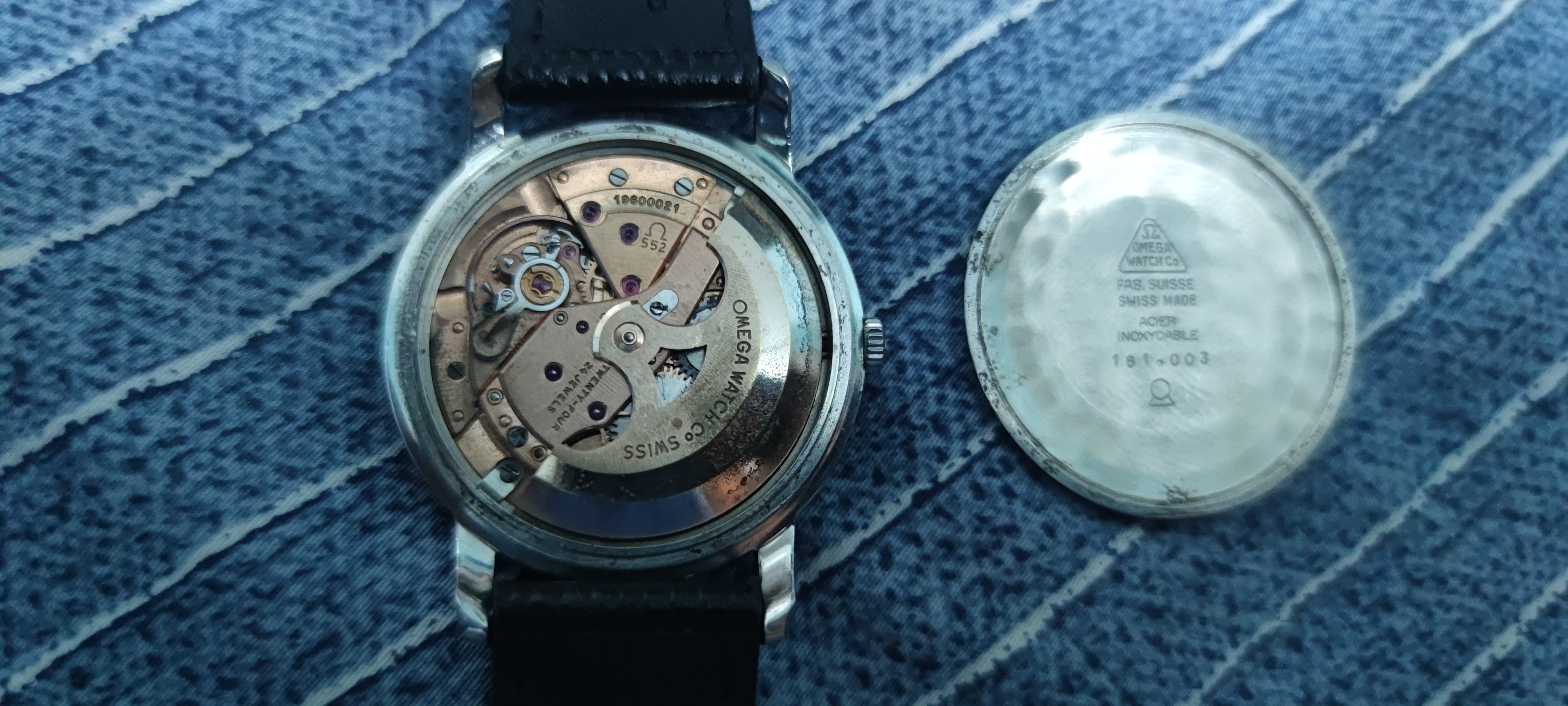

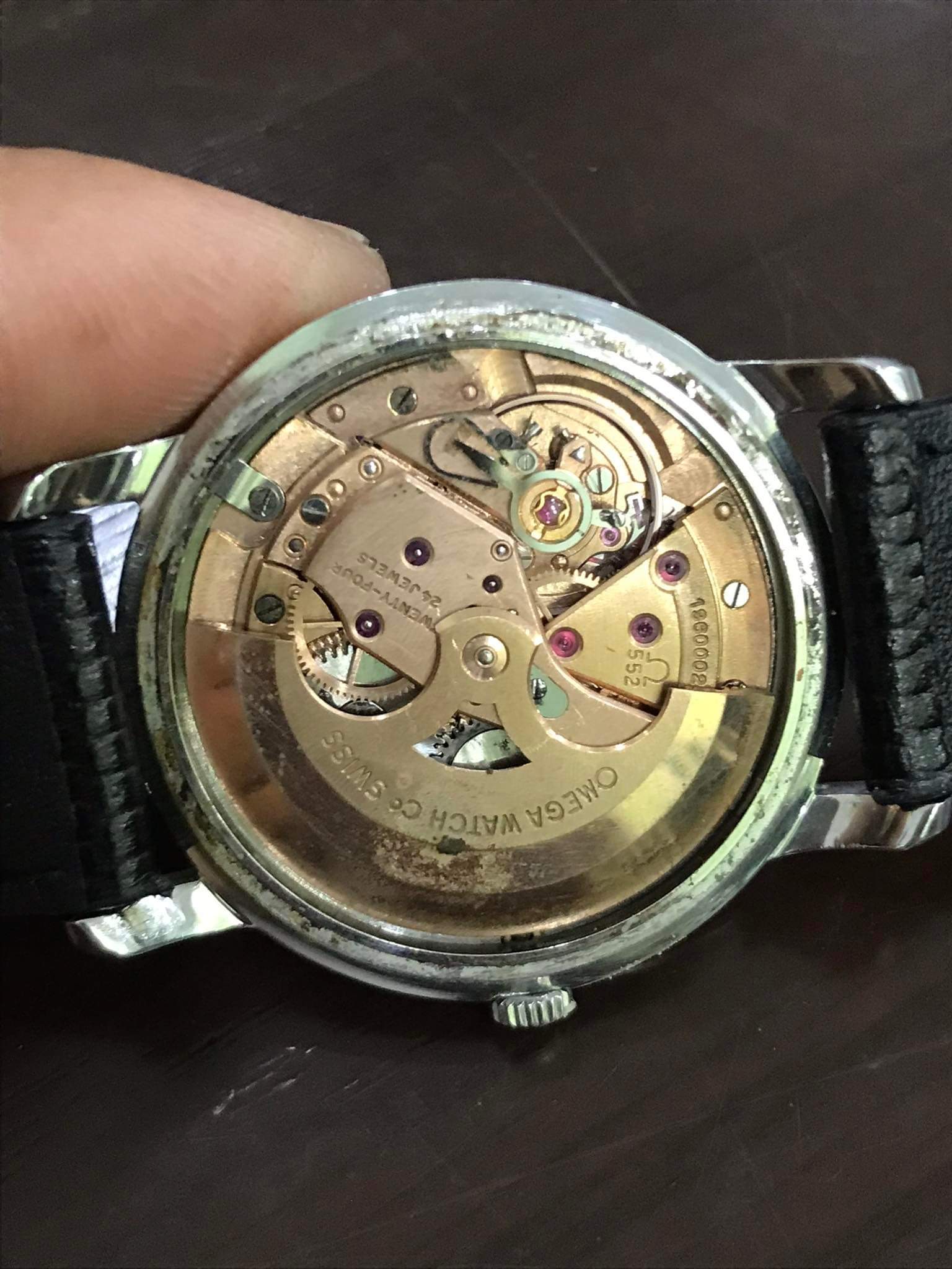

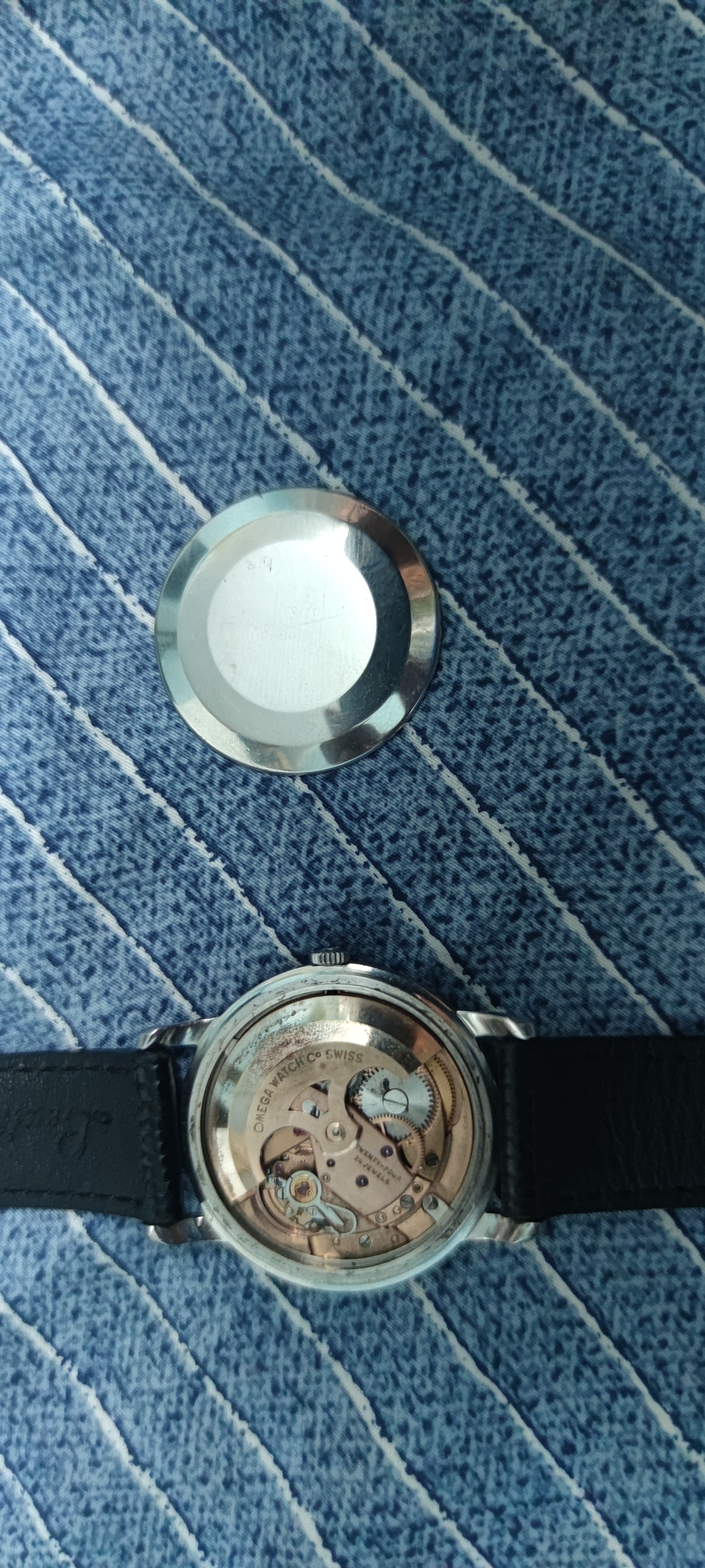

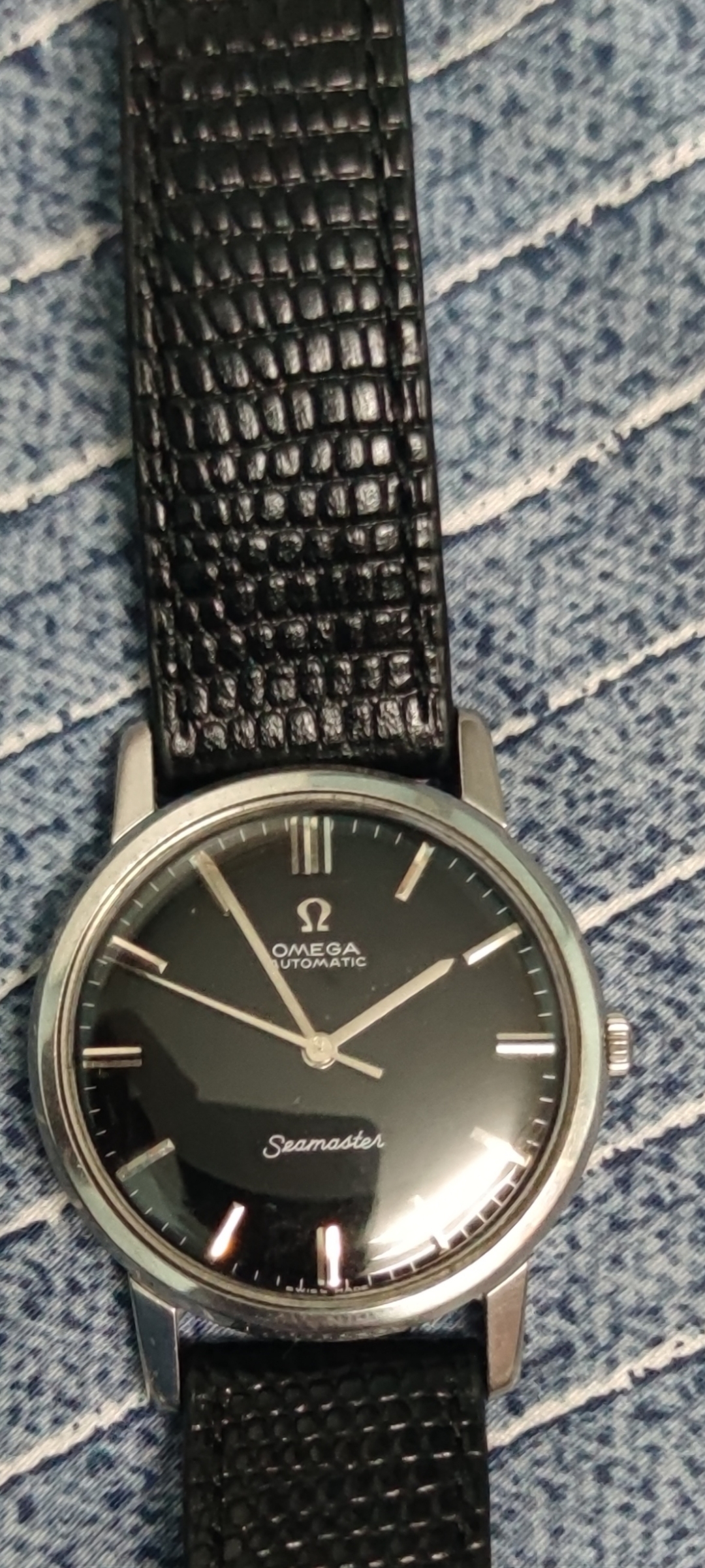

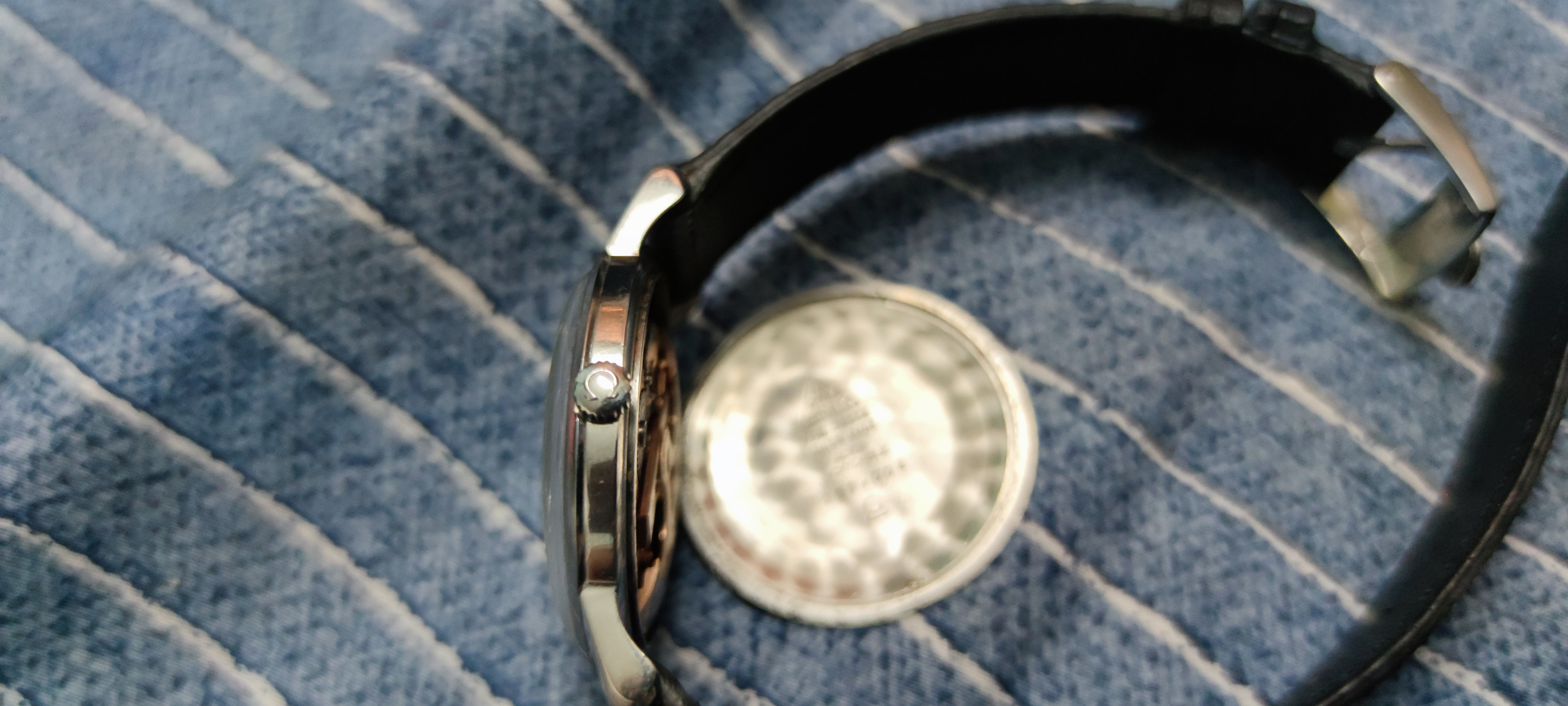

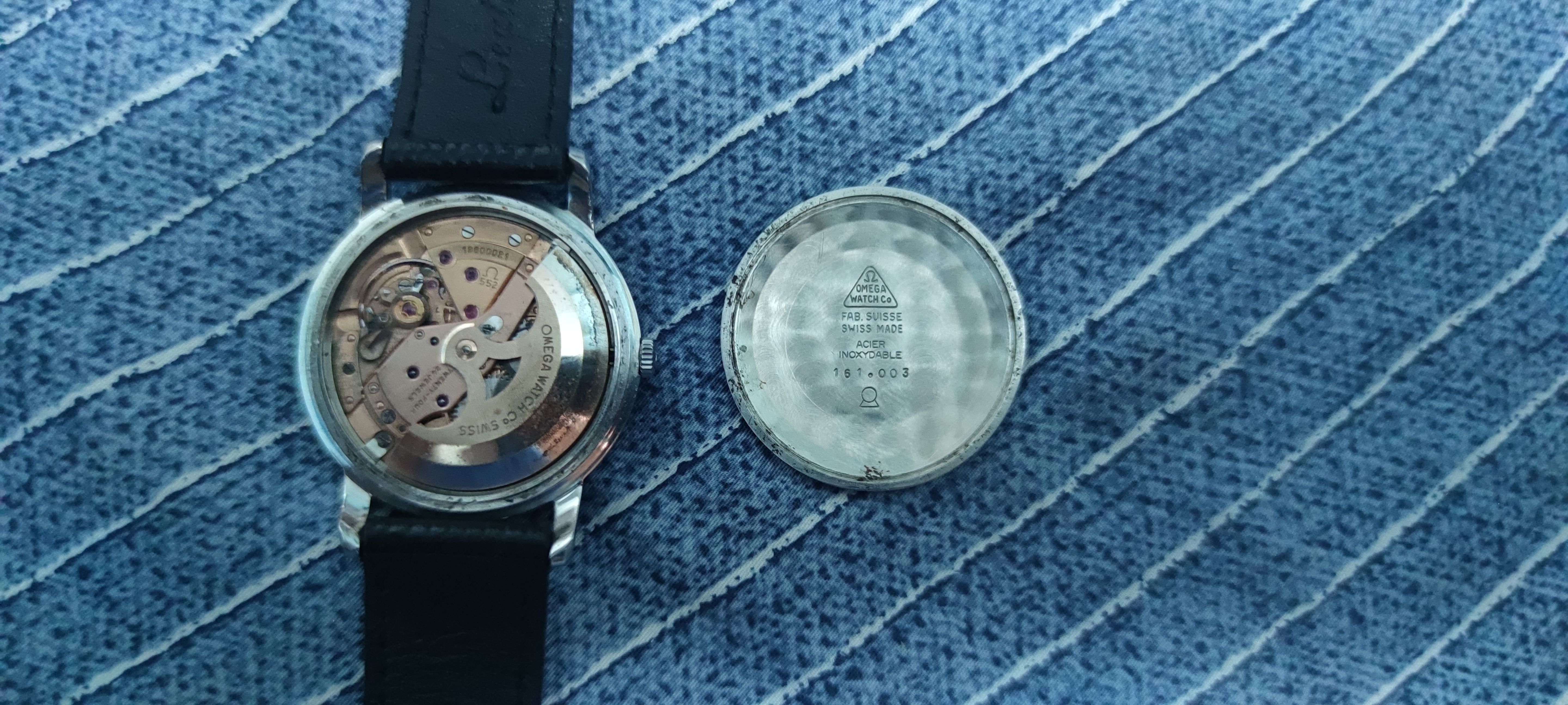

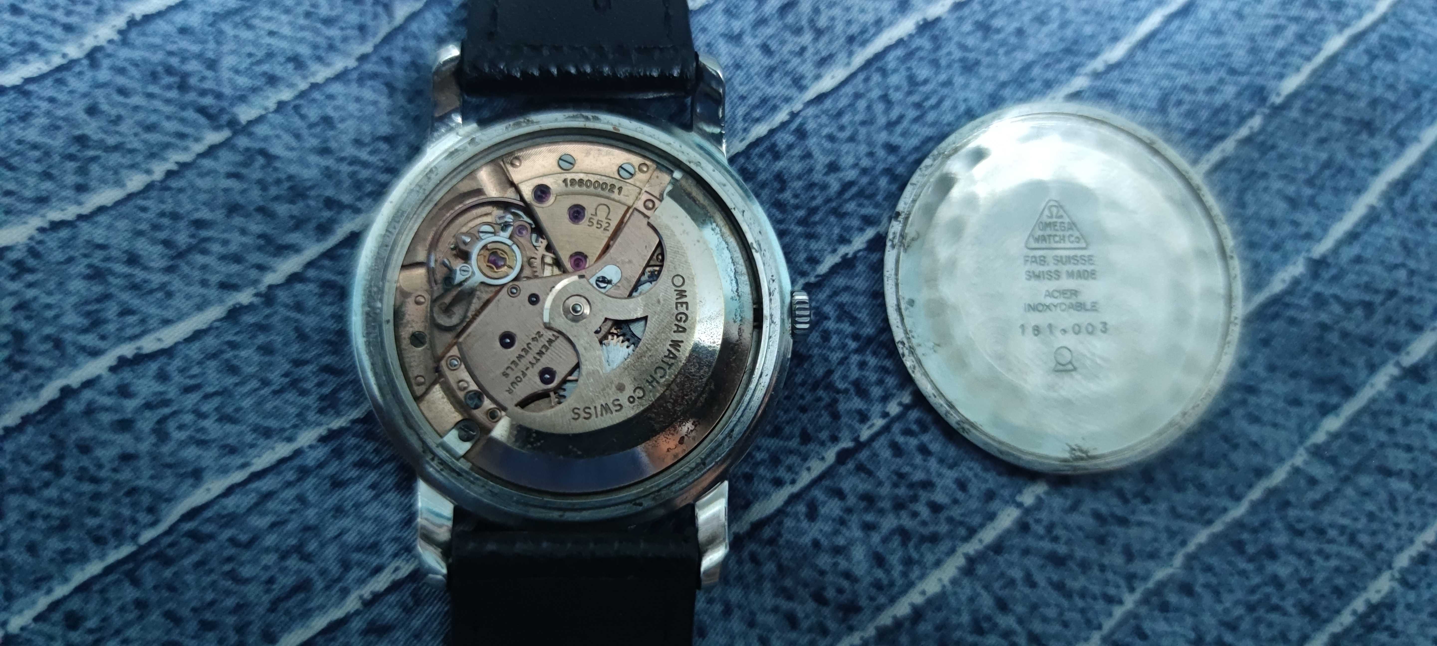

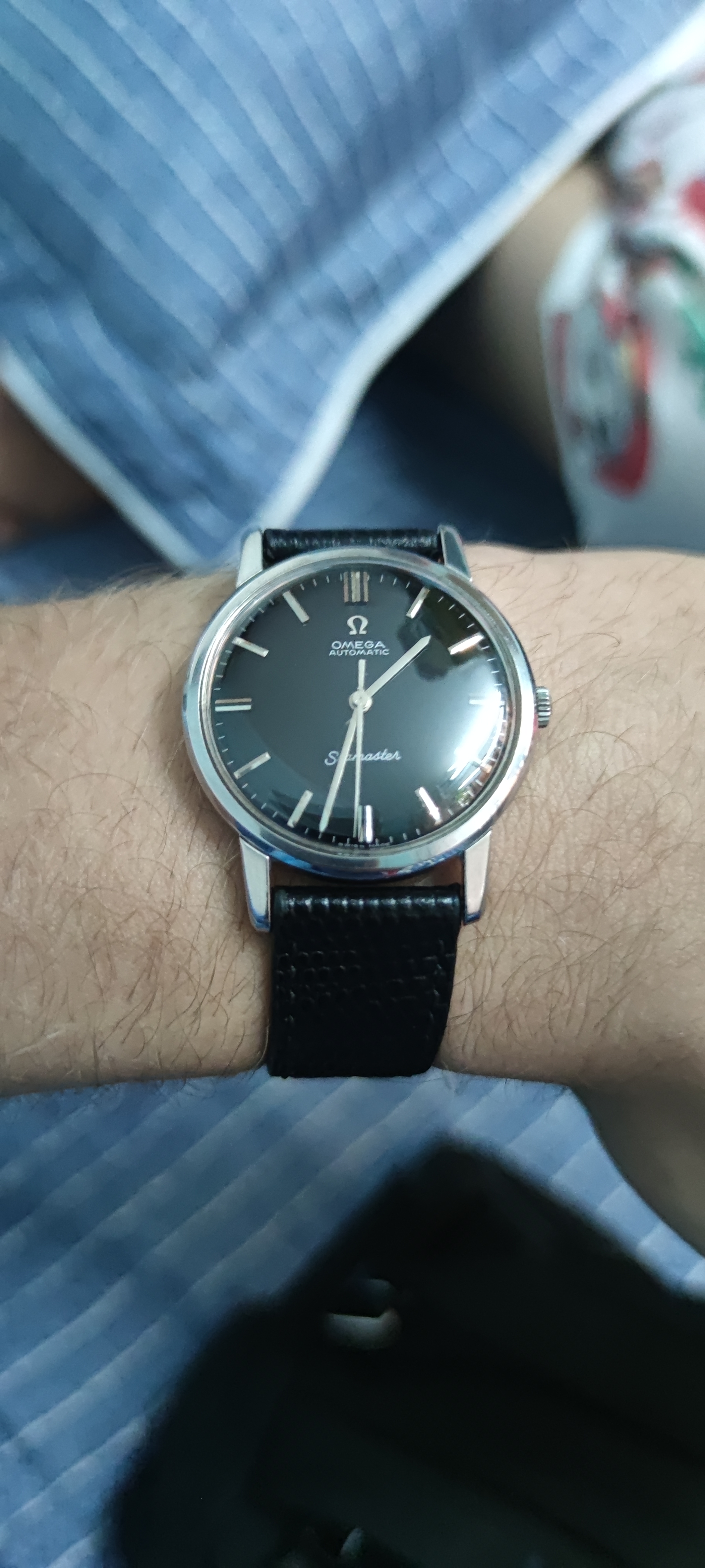

Hello. I am new at this forum and beginner watch collector. I need your help with identification of this watch. What do you think about this dial? I worry that is was refurbished. How much this watch can be worth in this condition? Thanks for all replies.
24,836
55,255
Yes, the dial has been repainted, and the movement also looks a bit rough. Not a watch for someone who is interested in starting a vintage watch collection IMO.
3,595
13,551

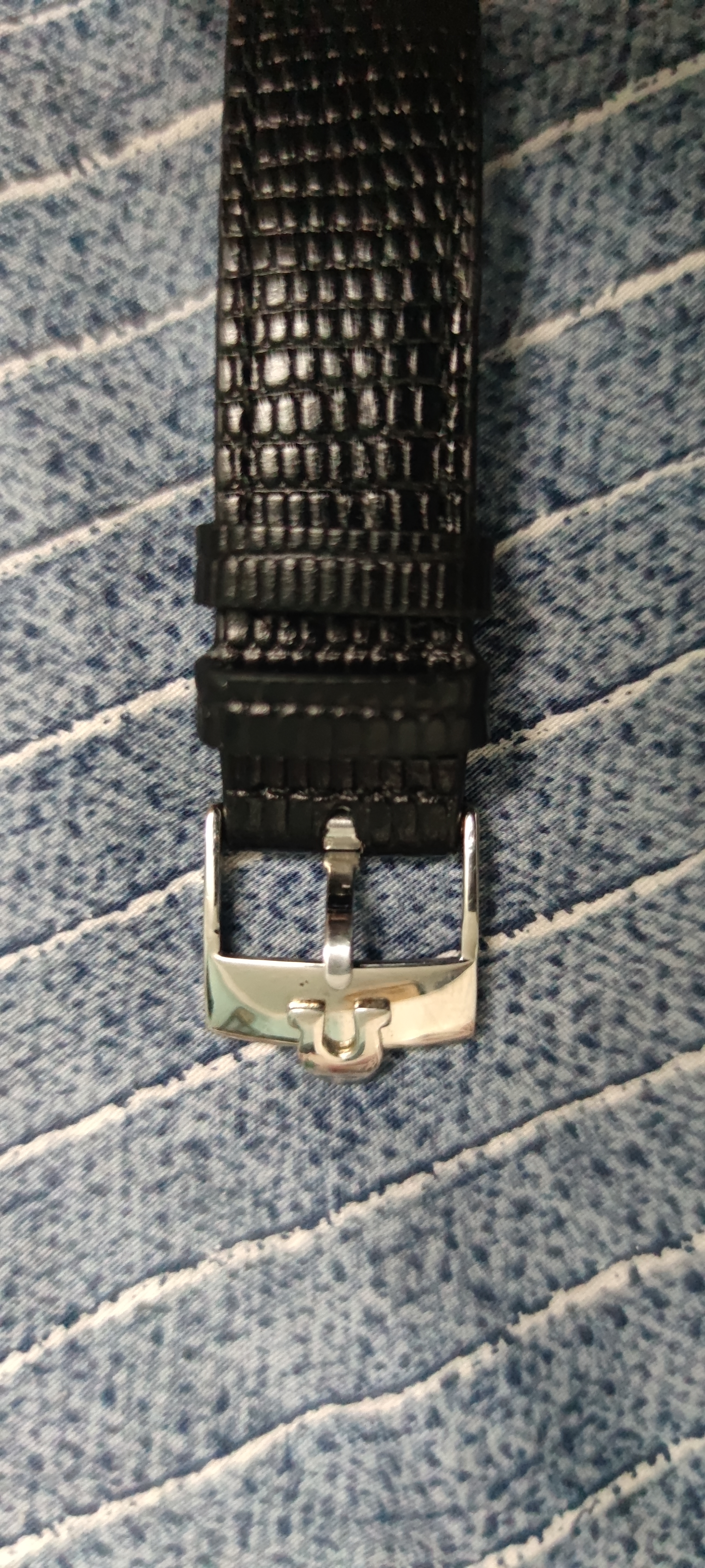

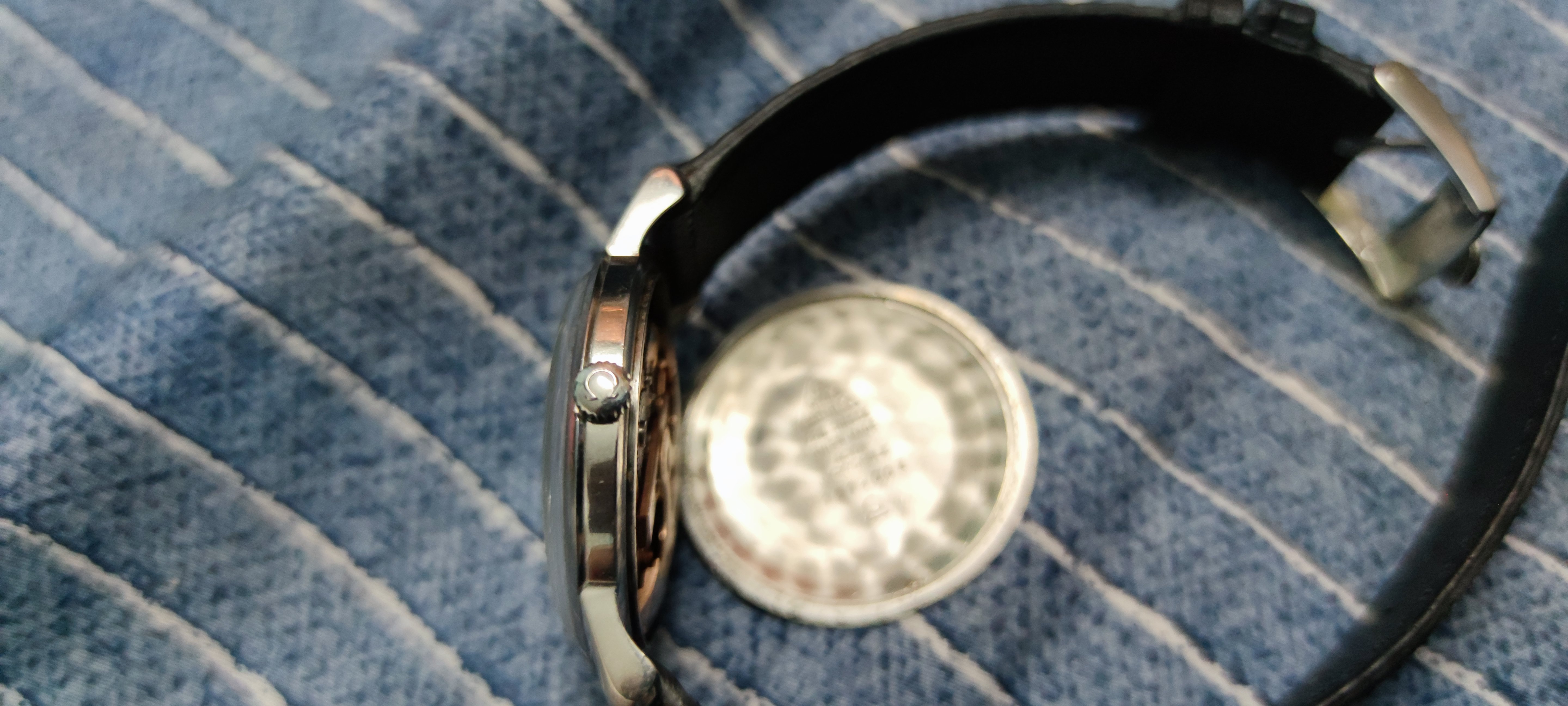

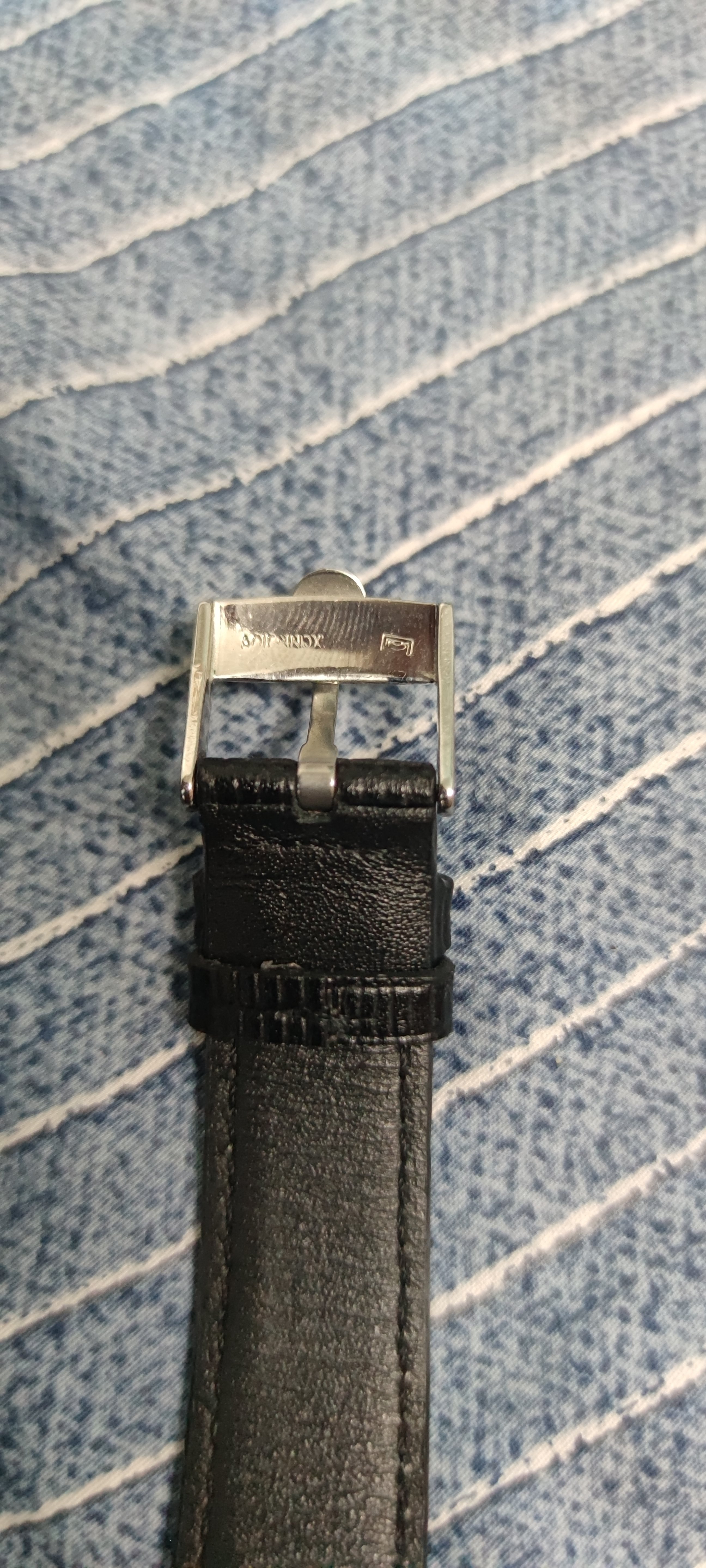

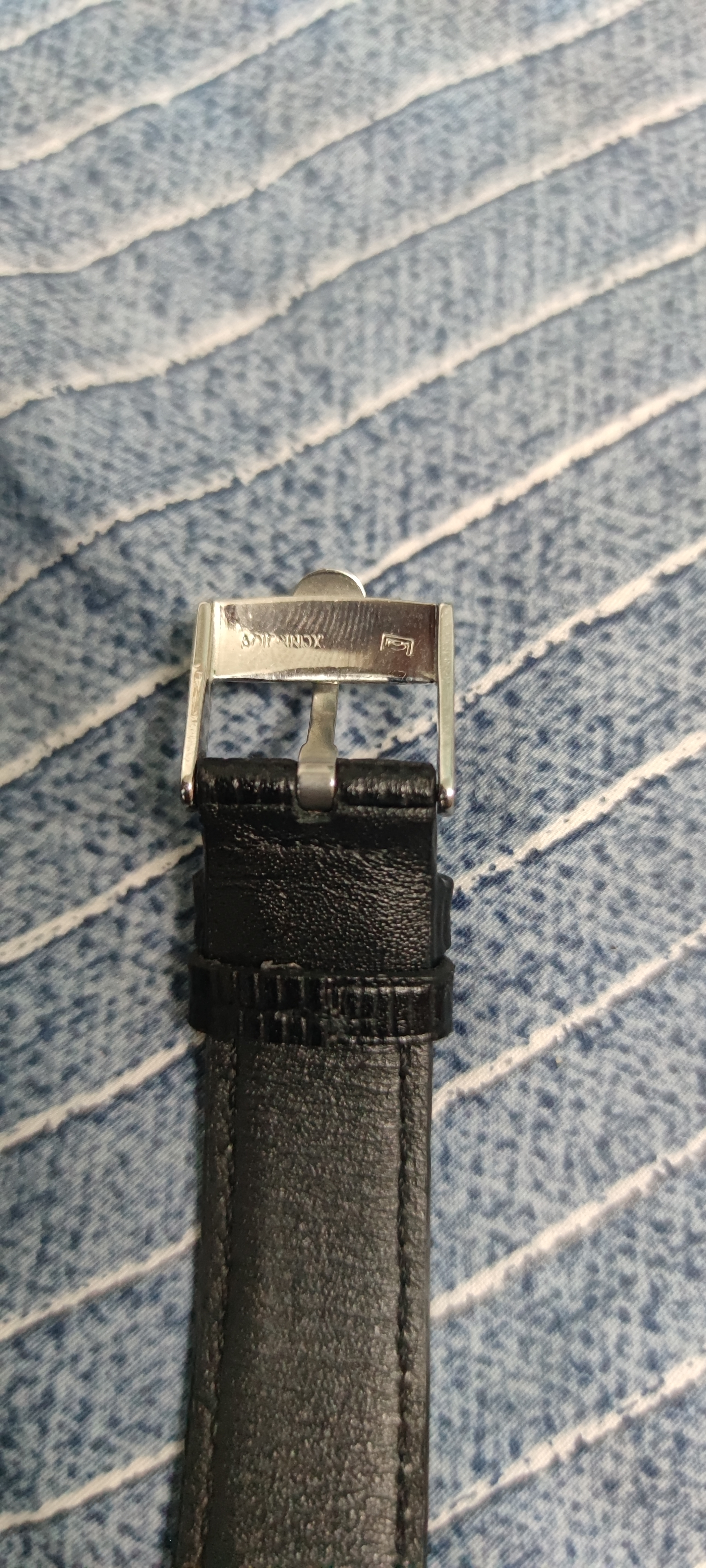

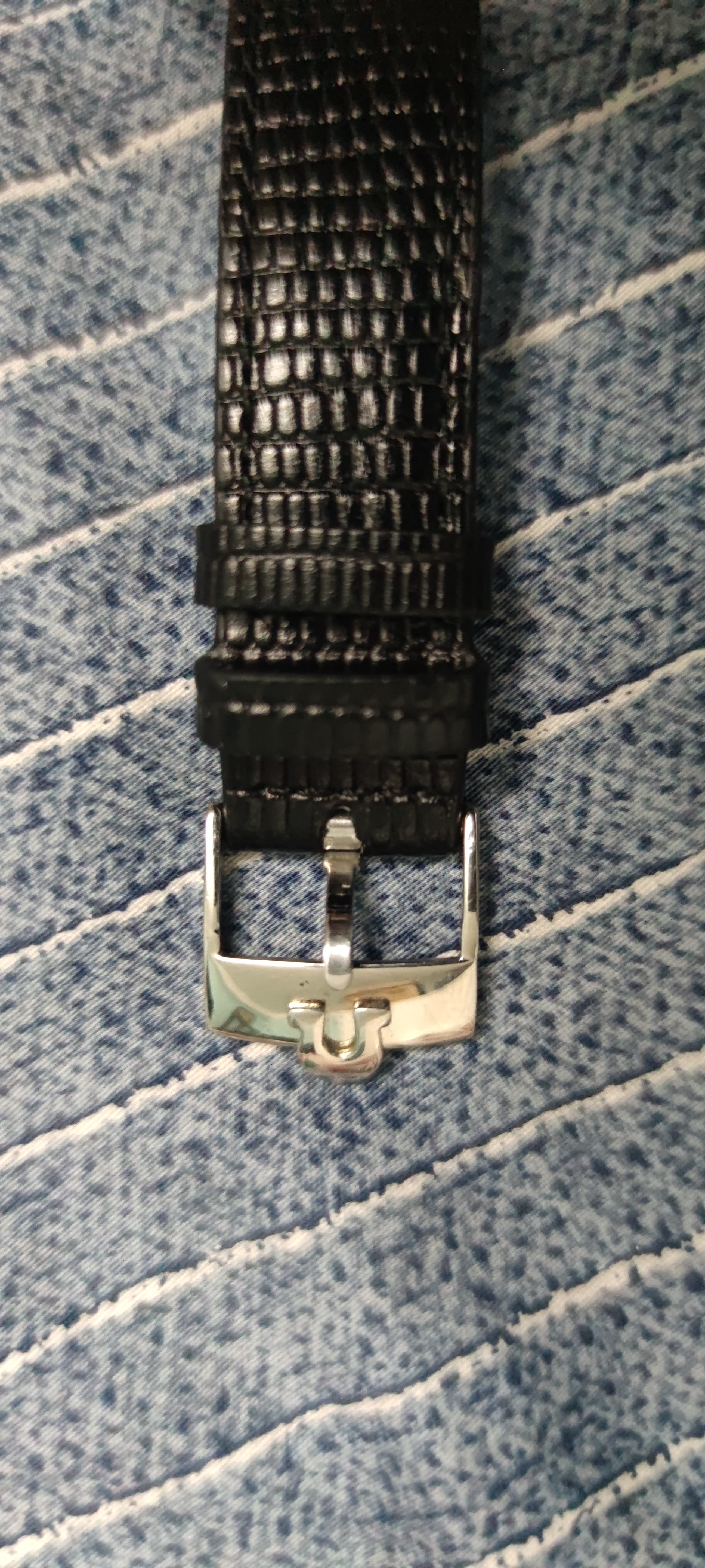

Also, the case has been heavily polished, the edges of the lugs are completely gone. The clasp is a cheap fake, not an actual Omega product.
In the current state, the value to collectors would be in the parts. With the case condition and the dial being repainted, that's maybe 200€ or so left, I'm afraid. Mind you, that doesn't mean it wouldn't fetch more in an eBay auction.
Stay around, read through the forum and look at other examples. You'll soon start to see the flaws with this example. We call that "noob tax", the early, uninformed purchases, and you're definitely not alone.

As MtV said it's surely "noob tax". For my comfort I can only add that I paid for it around 200$. I was also aware about mechanism condition. Maybe I am naive but I was hoping to give it little touch by myself since I planned to amateurish service my collection by myself. That is also the reasons that my budget for watches is not so big same as my watch servicing skills. I don't have enough confidence yet to try dismantle and service expensive watches. I was hoping that this "cheap" omega will be good material for improving my skills and later can stay with me in my collection. Thanks for you feedback.

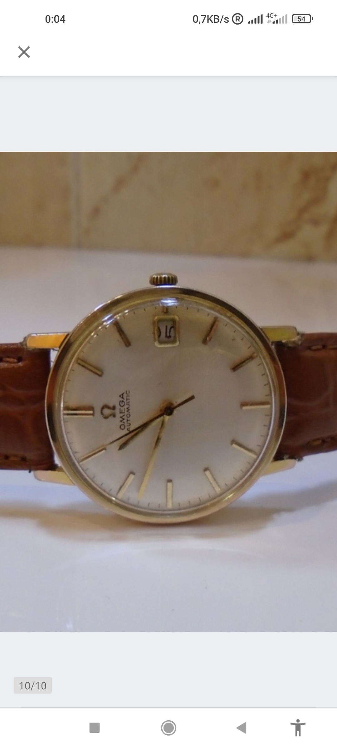

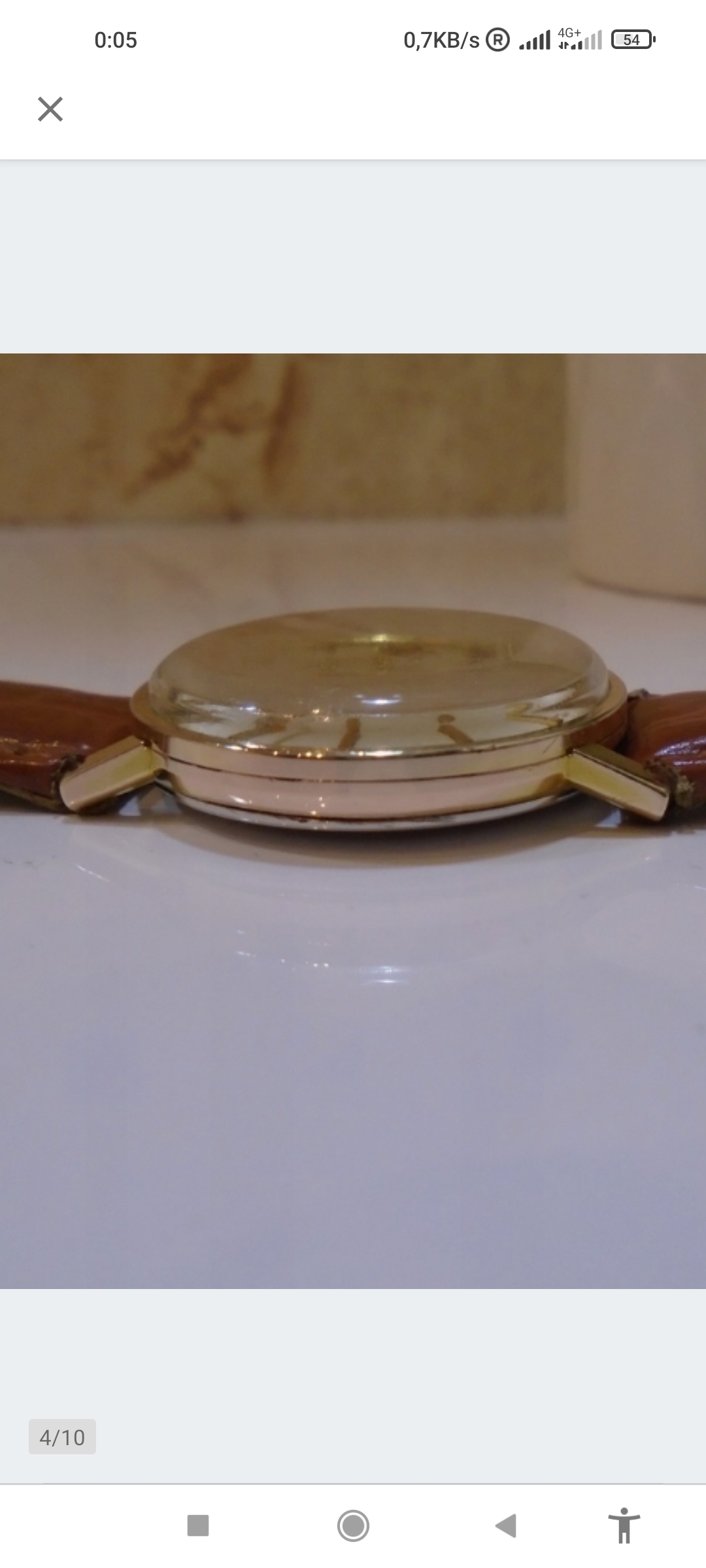

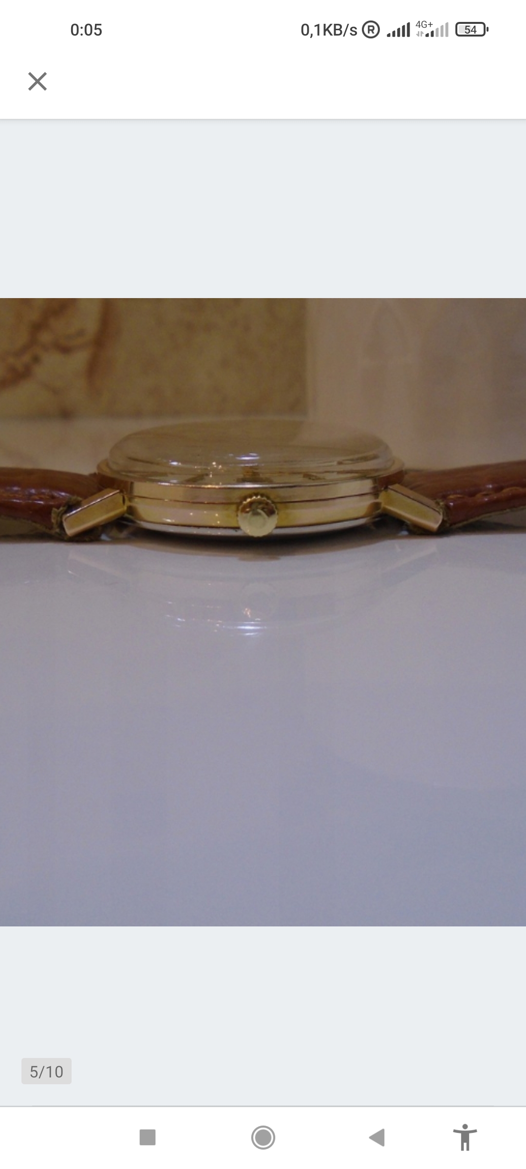

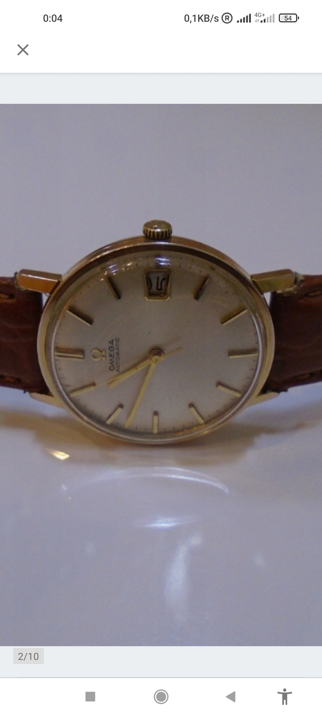

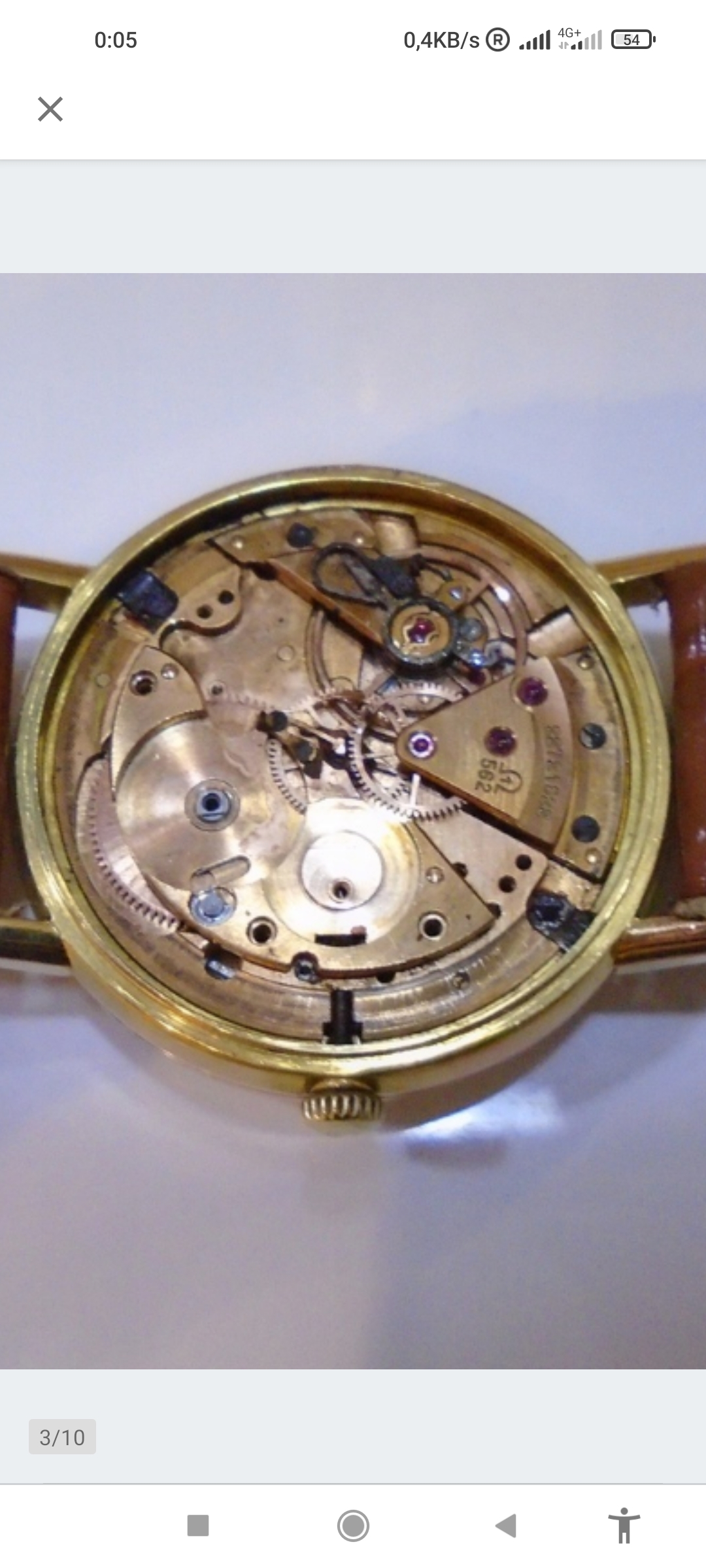

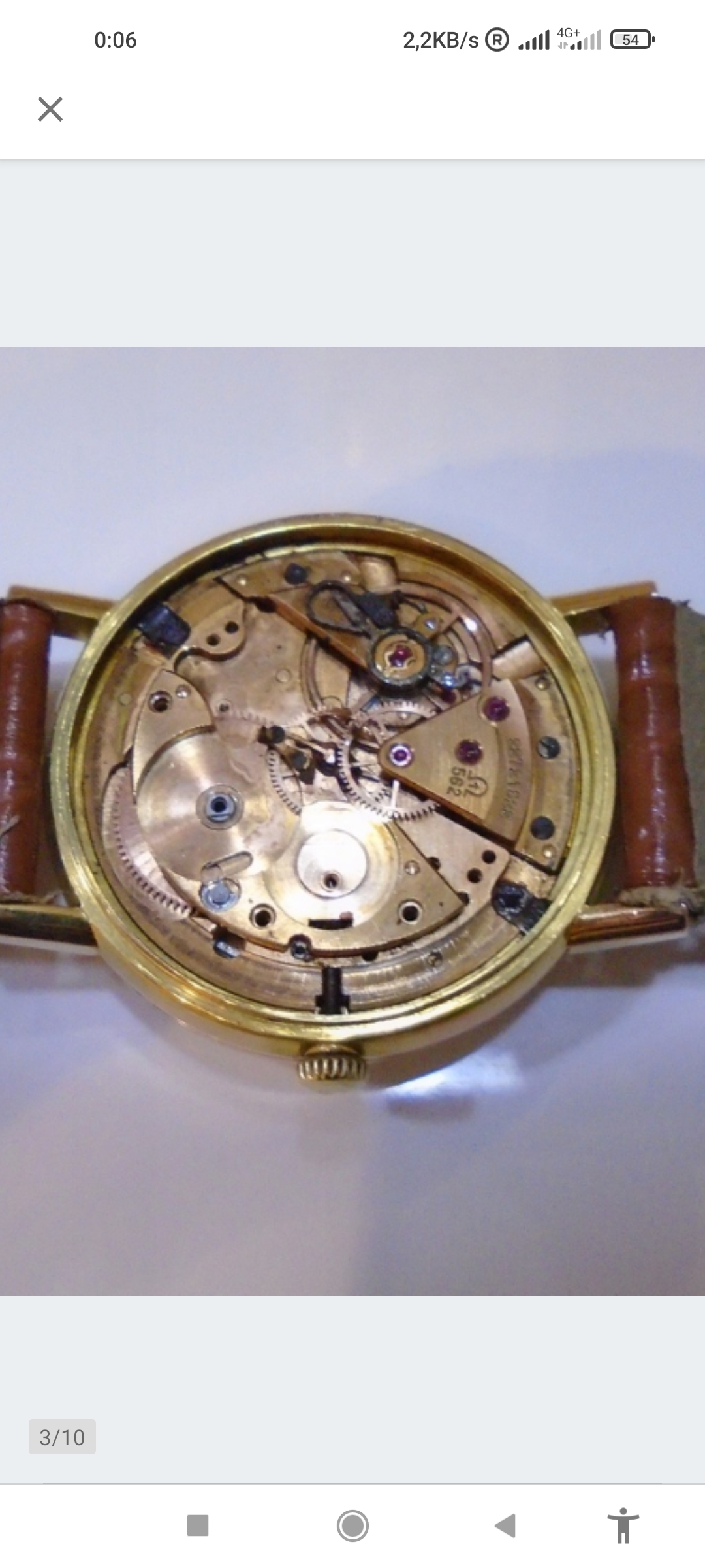

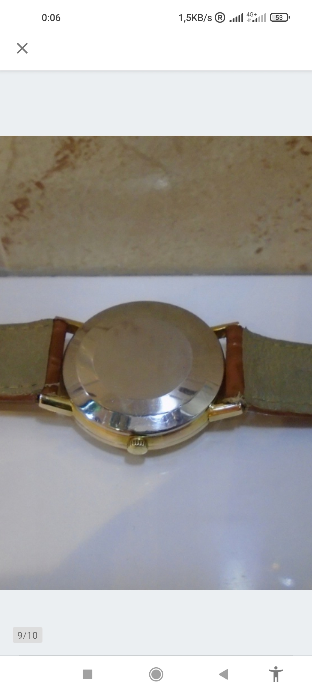

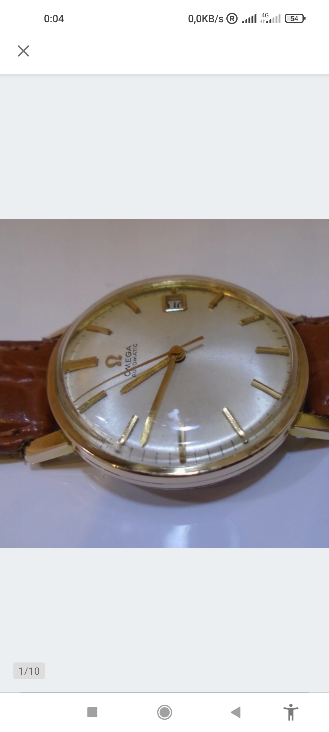

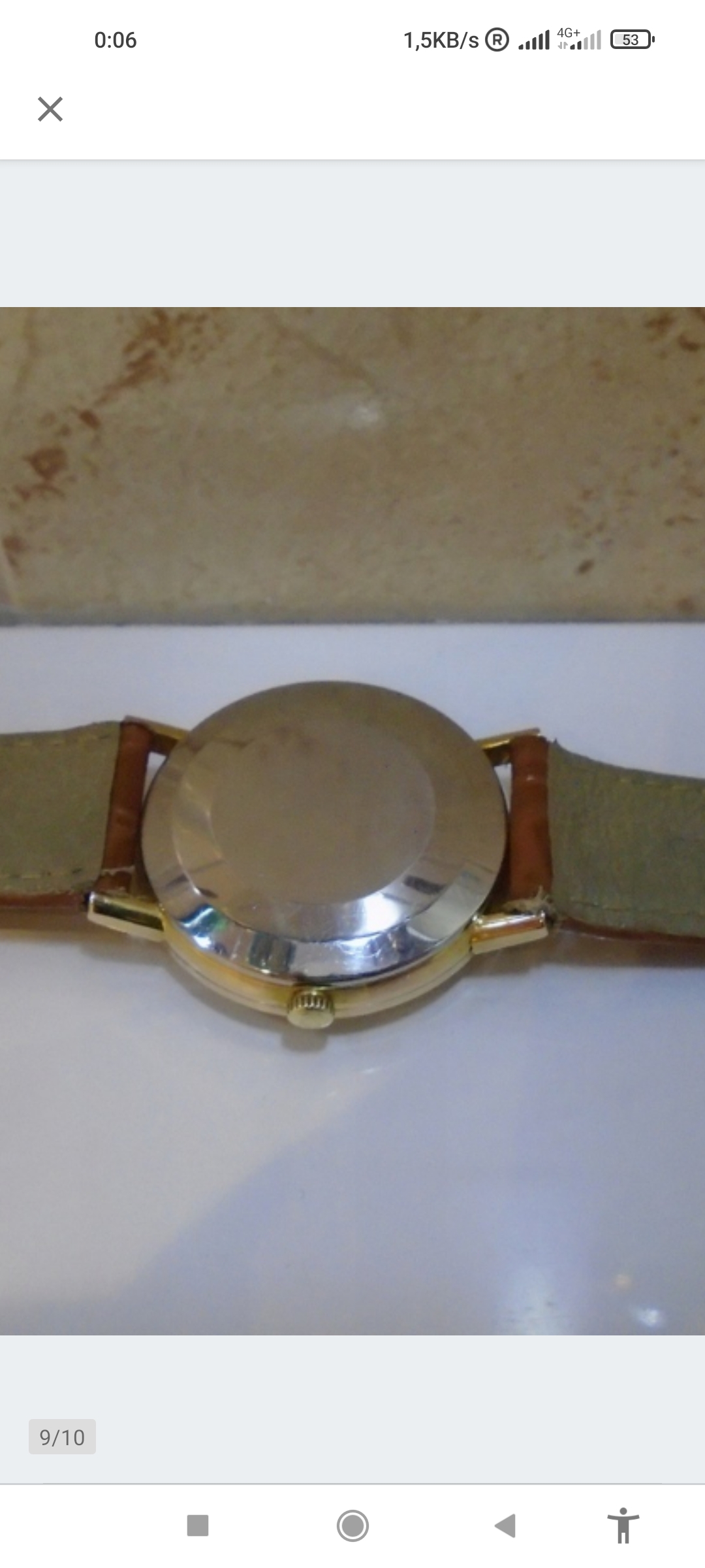

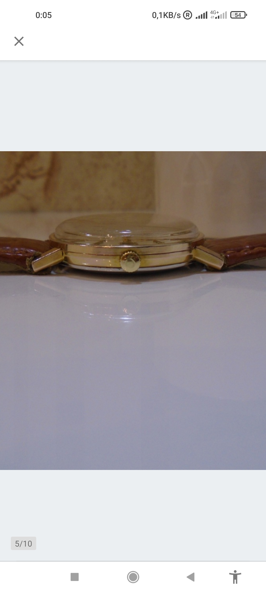

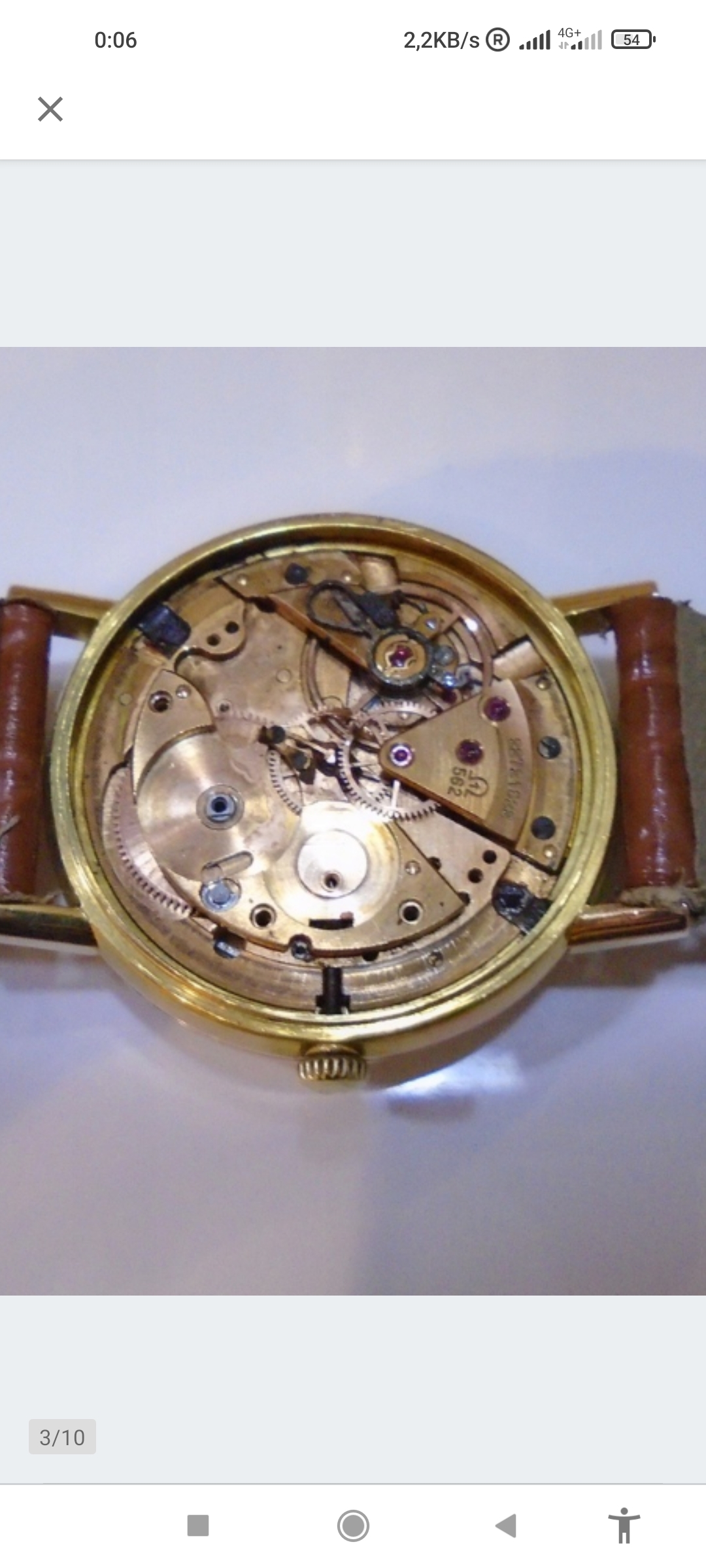

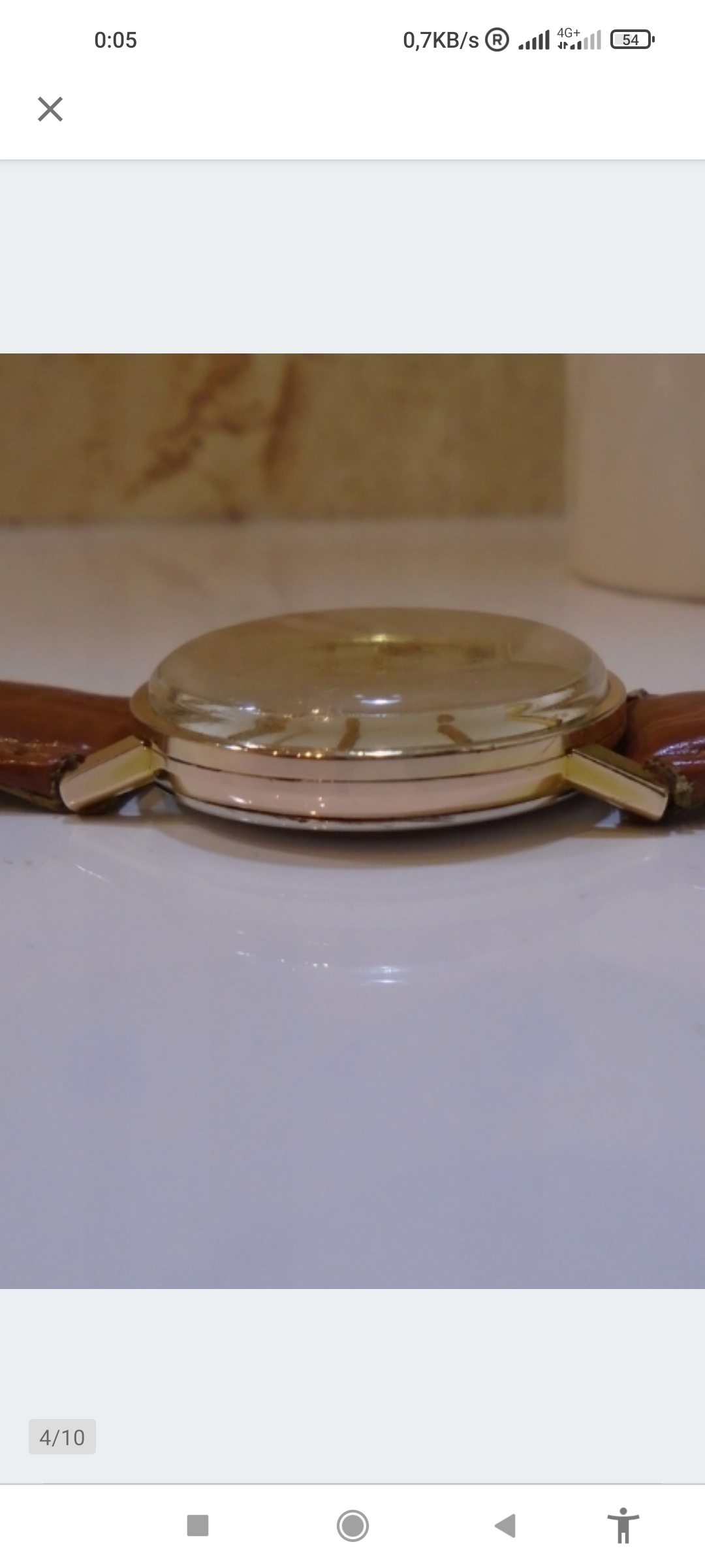

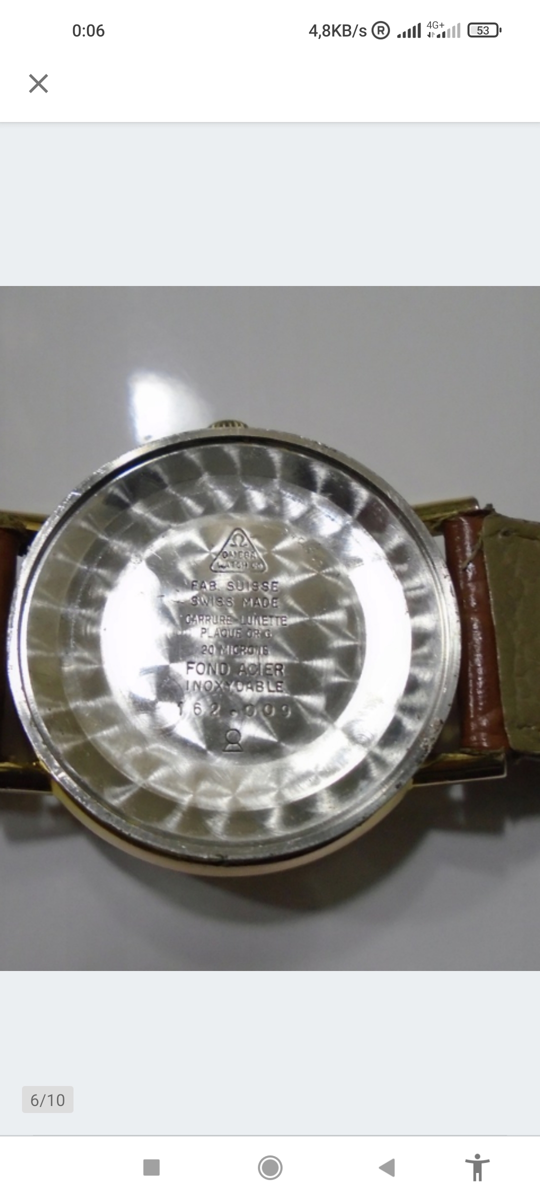

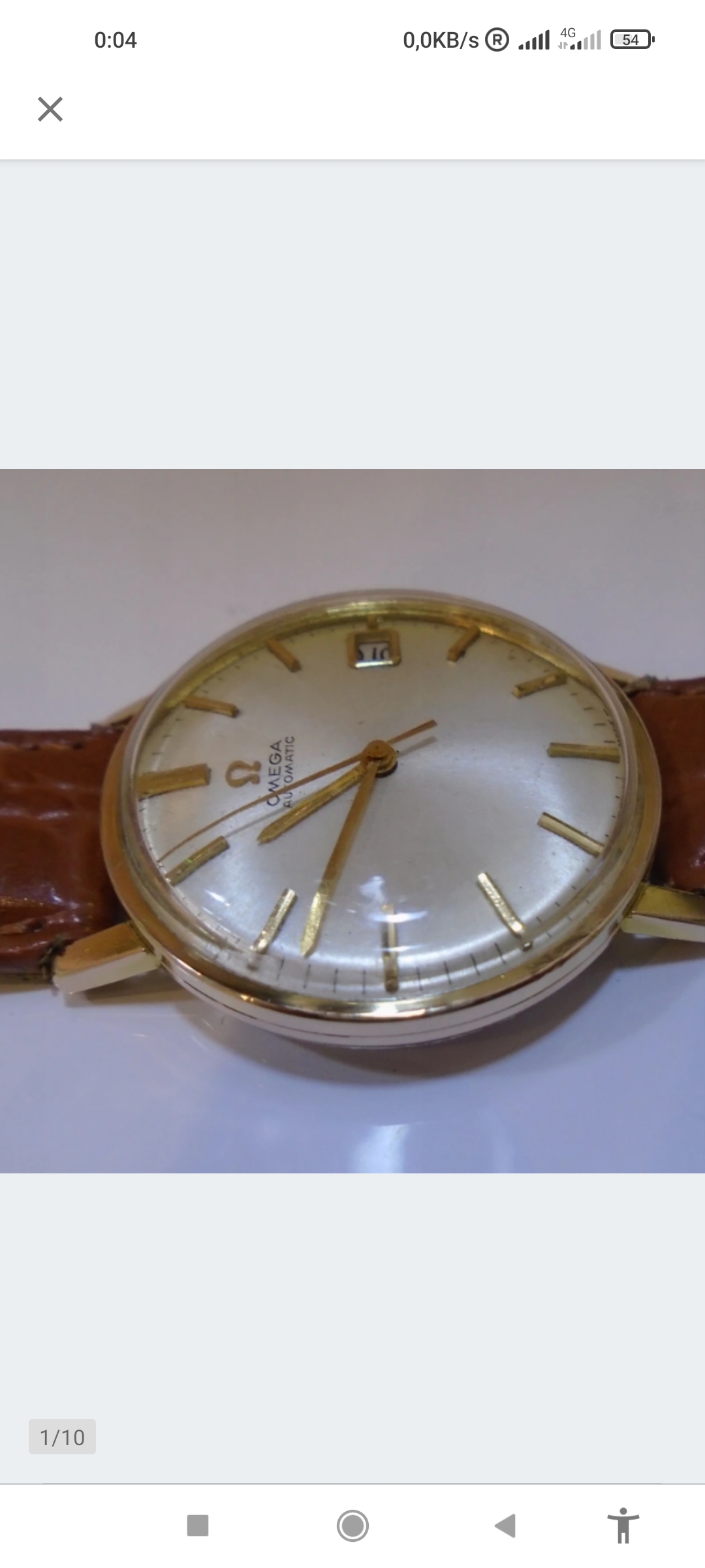

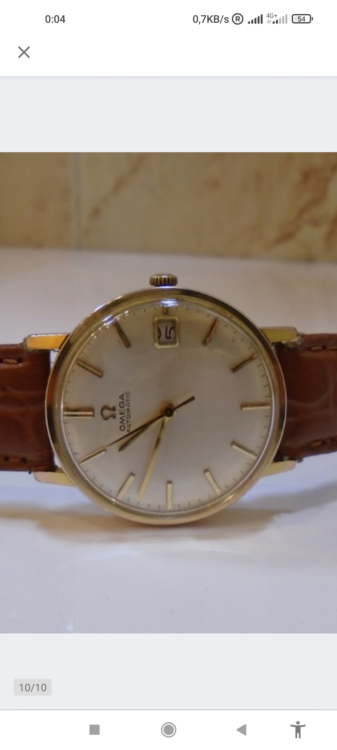

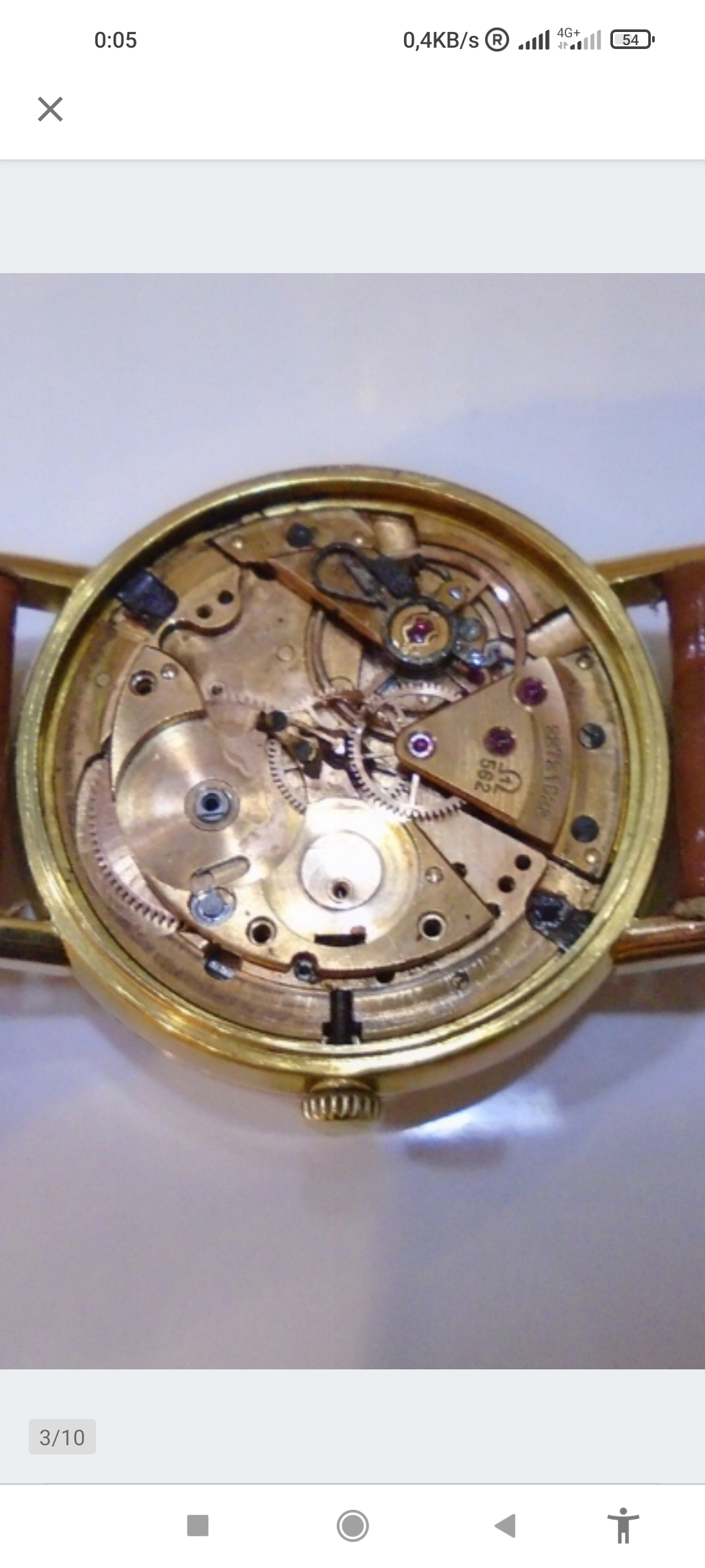

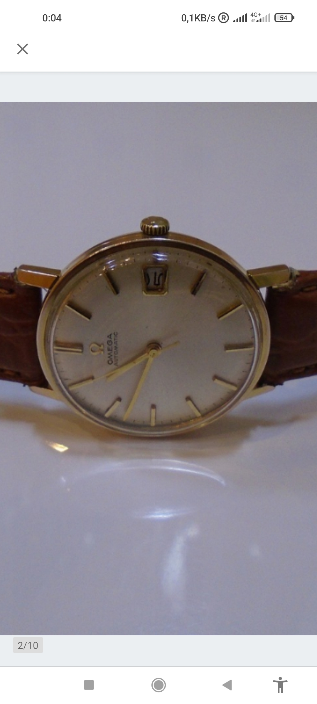

I found another watch in similar budget. Is worth of buying for 200$? Maybe this case and dial are in better condition so I can use it as base for recondition using this black one( since cal 552 and 562 have many common parts). The point is not to obtain a perfect watch but just make something and have some fun during my new hobby. Waiting for you opinion
24,836
55,255
Step back and take a couple of months to read the forum and do research. You are posting pictures of junk and junk. The movement in the second watch is incomplete.
