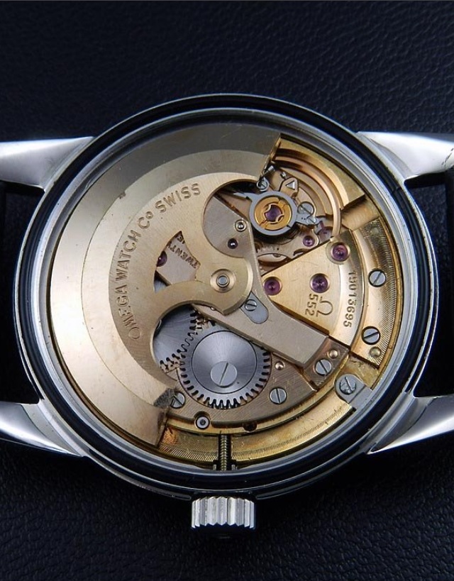

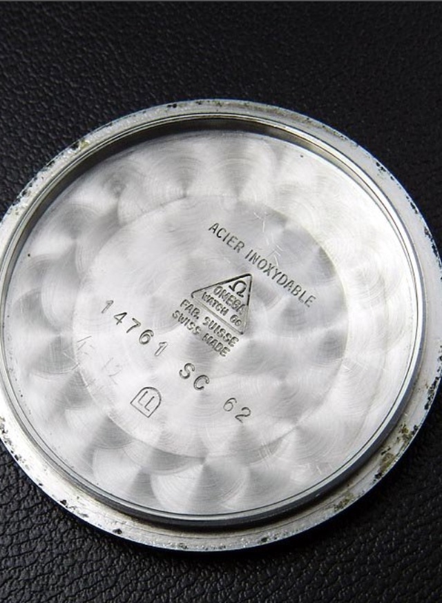

    Welcome! It looks like authentic parts, just maybe not ones that all came together from Bienne. We call that a franken. One of the tip offs is the different color of the parts in the movement, which usually means some have been replaced. That dial might have come from an earlier watch with a 50x series caliber from the late 50's, or at least that's what the fonts lead me to believe. The serial number dates the watch to 1962, which corresponds with the 62 on the caseback. It sure is a really good looking franken! If it runs well and you like it I wouldn't worry too much. Only if you plan on reselling it does the value to a collector come into play.

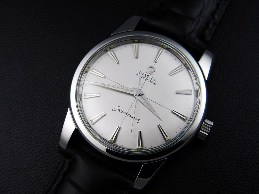

    I think the dial was refinished. By looking at the m (in Seamaster), I believe the the guy did not do a good job. AUTOMATIC has pointed top A's and that's not a good sign, either. The second hand is too short, the crown is not for a Seamaster.

    and Omega did make dials with crosshair in those days.

    Ok so pointed "A" bad, and flat top "A" good. If i'm reading this correctly. Since you mentioned crosshair dial is there a purpose for that or is it just a design?
  6. hoipolloi Vintage Omega Connoisseur Apr 12, 2012
    3,516
    5,795
    Because you wrote "...Since I don't see any watches from the database that has a cross dial. "
    AUTOMATIC with pointed top or flat top A's help you determine the authenticity of a dial.
    Certainly, some experienced redialers know it and make it look perfectly the same, some don't and some make it too flat.....
