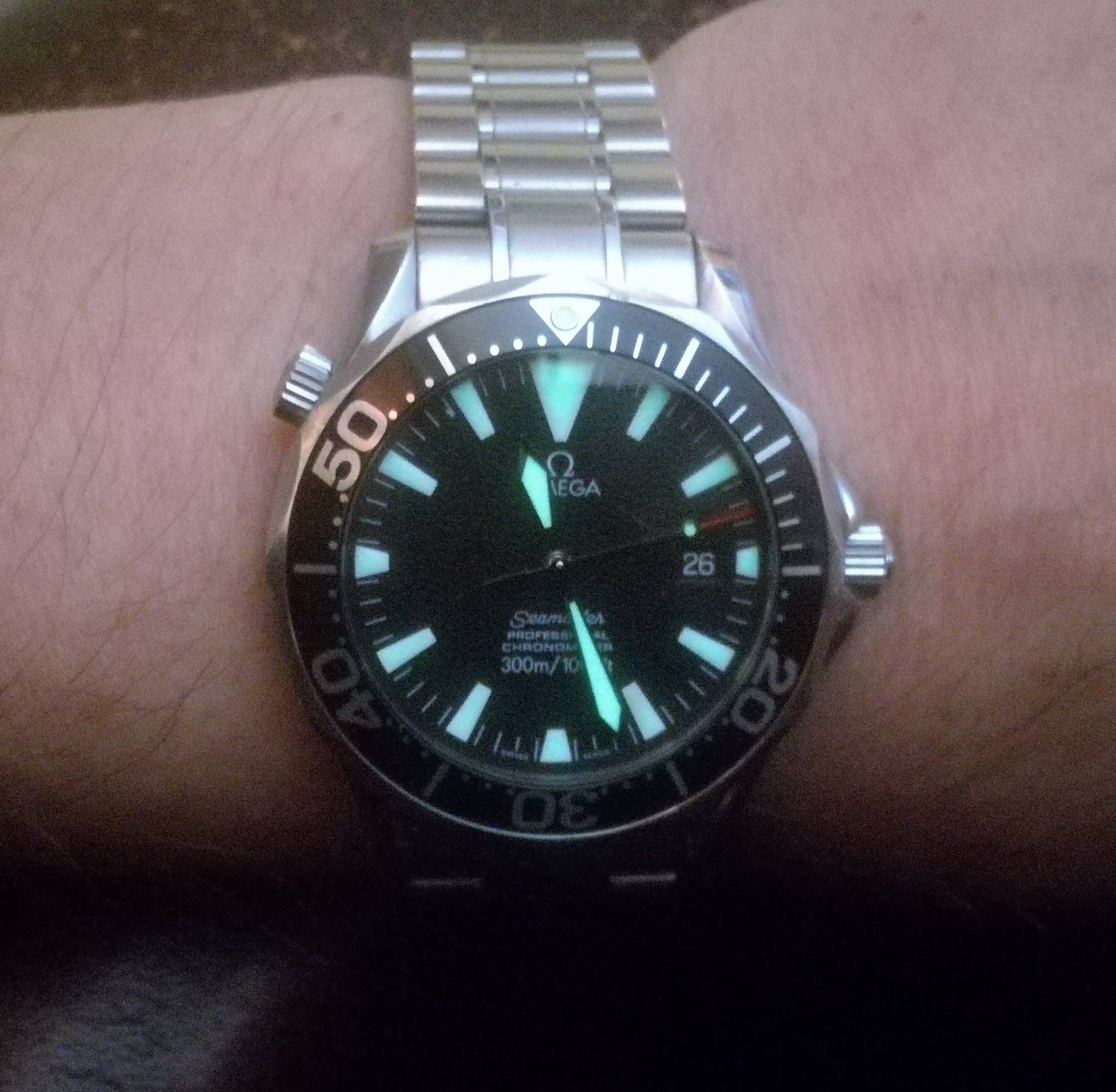

Hi all, I have a Seamaster 2531.80
The bracelet has seen better days with links stretching and divers extension coming loose.
Is there any way to recondition this or is it just a matter of replacing the whole thing
Thank you in advance
