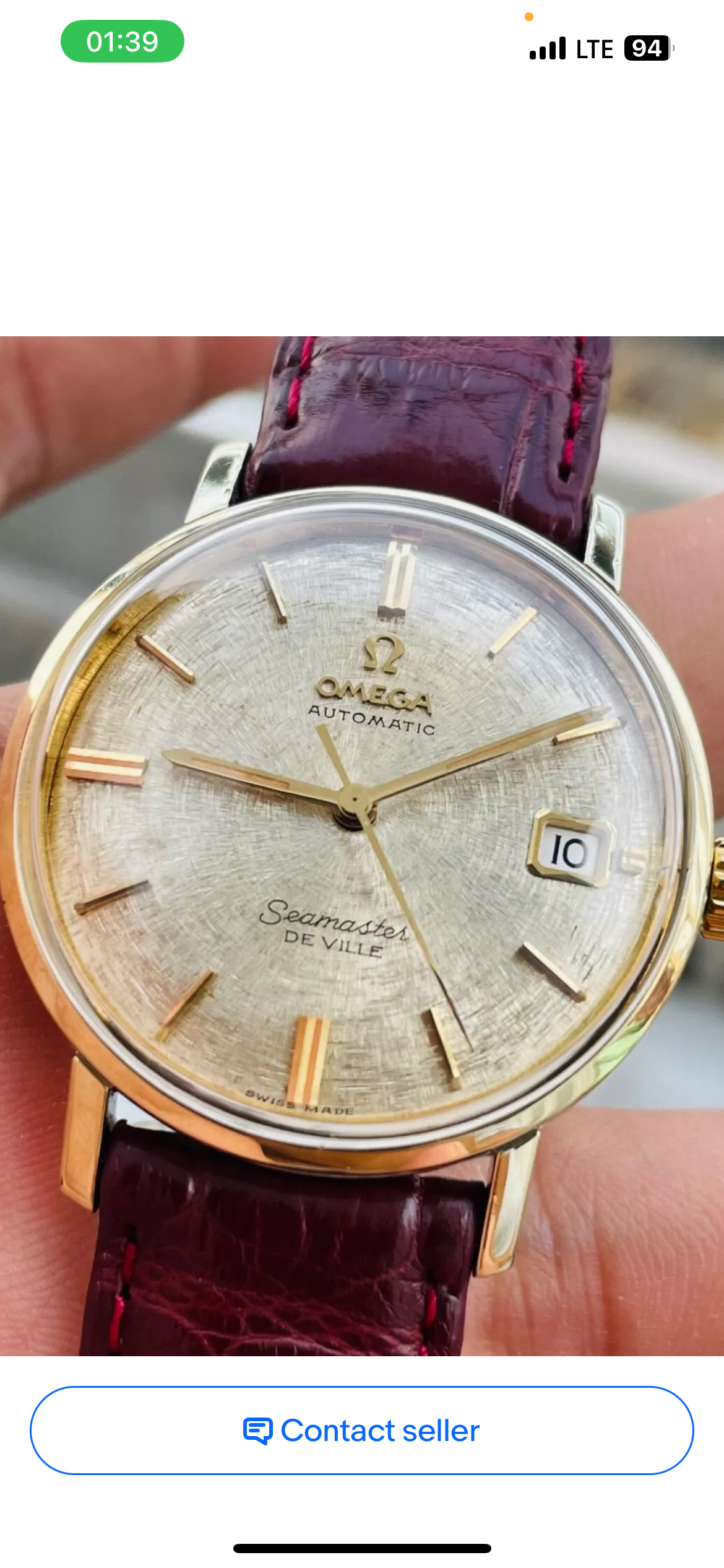

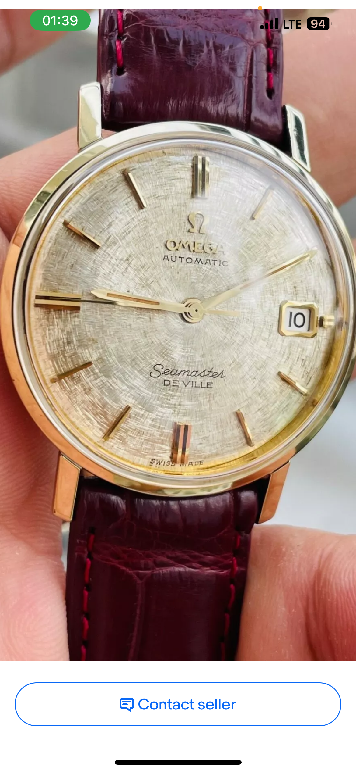

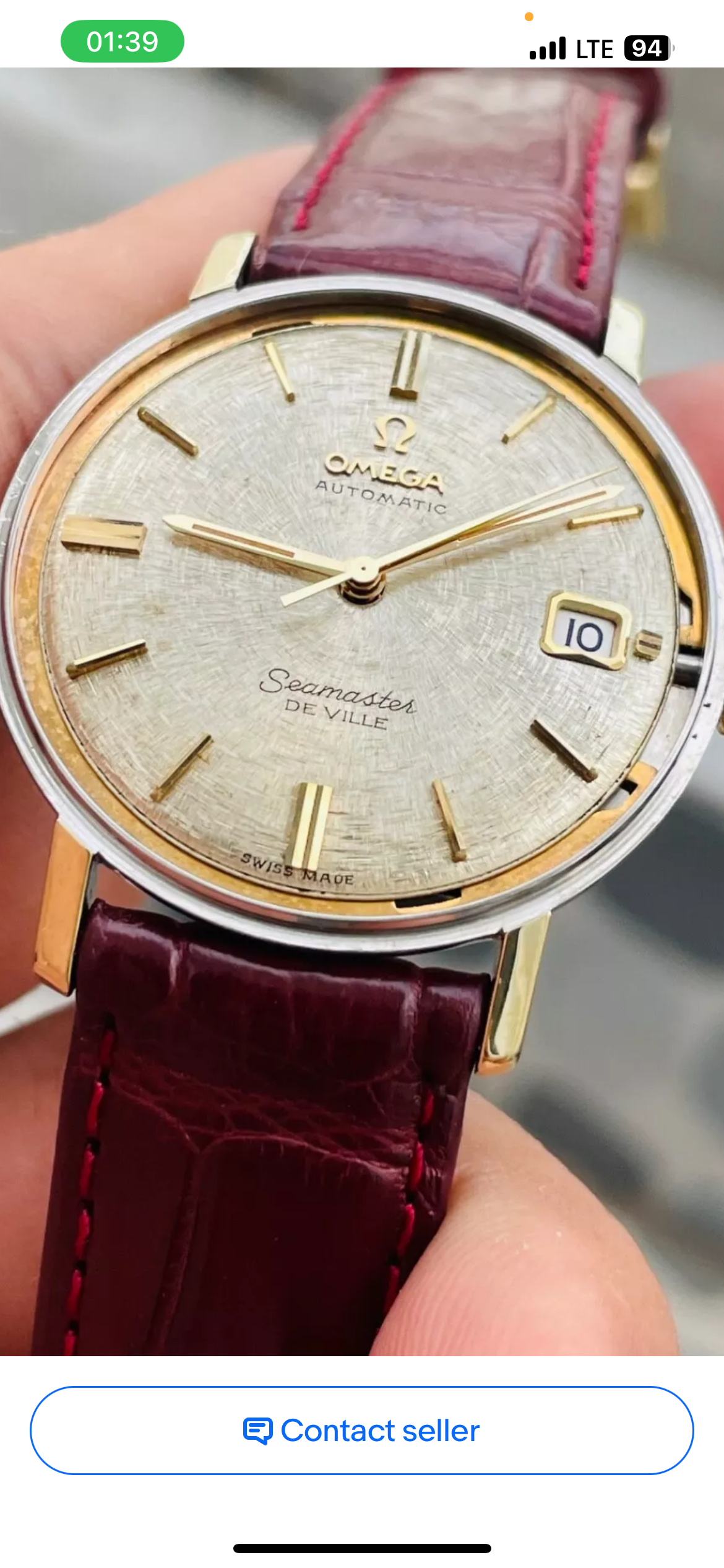

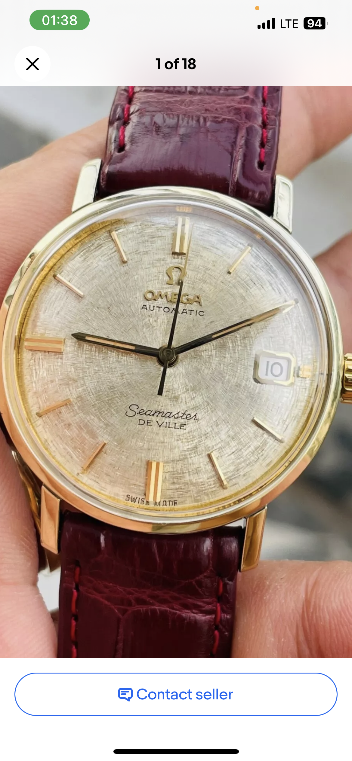

Regarding this watch, have you asked the seller what exactly has been done to this dial and if it has been done by himself?
884
1,749

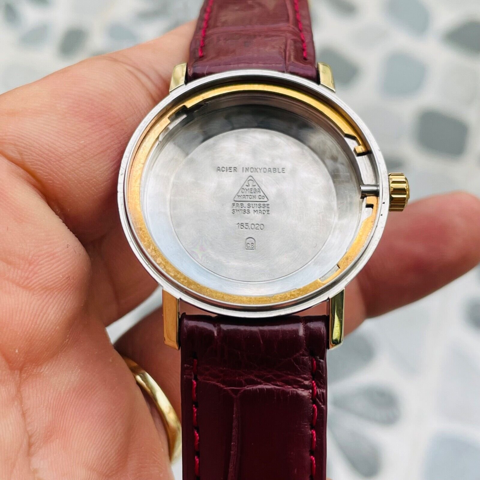

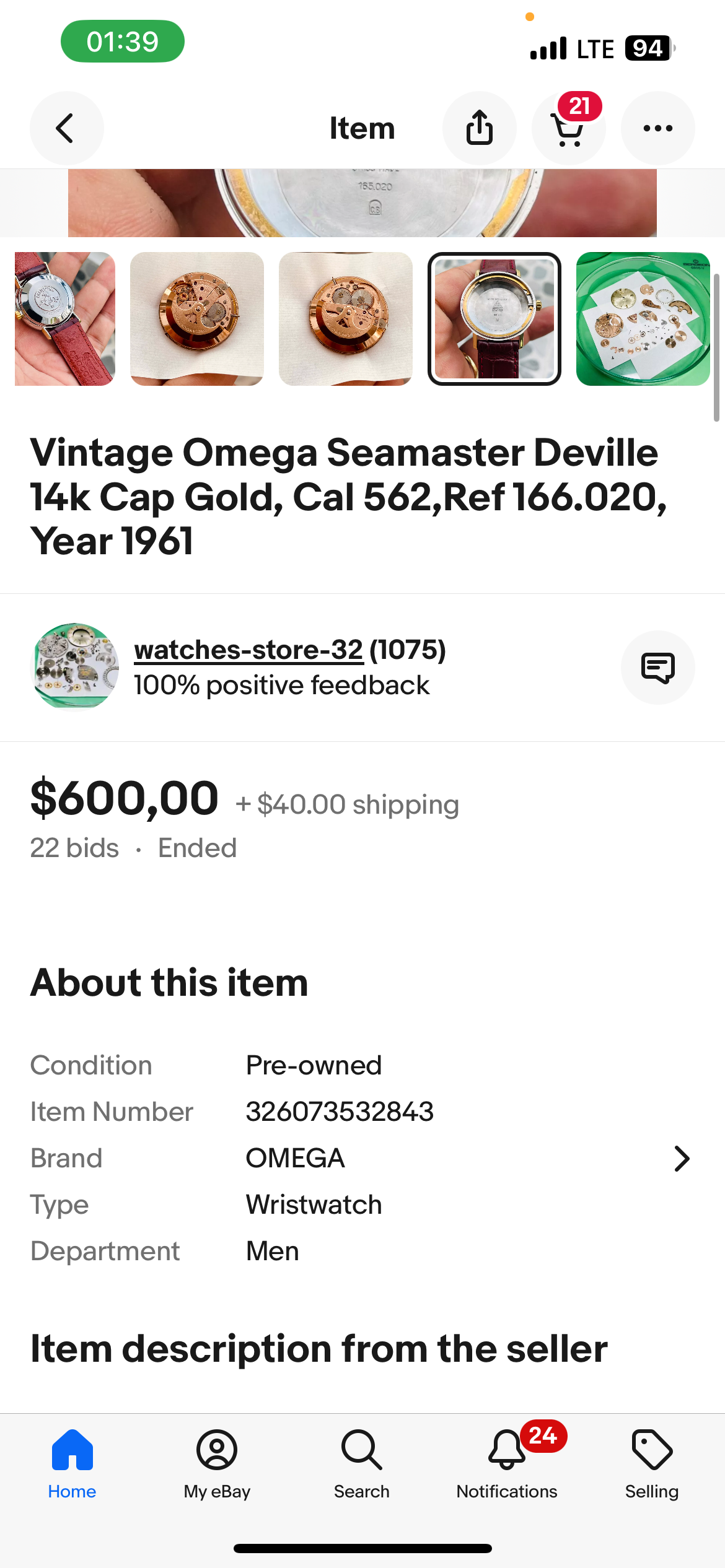

https://www.ebay.ca/itm/326073532843
Well this watch is also a franken since even though the correct reference is mentioned in the title (166.020) corresponding to the date version, the case is from 165.020.
It's a mistake in the description, which was later fixed.
152
911
The watch case should be a 166.020 and not a 165.020 since the latter is the no-date reference but the movement 562 (and the dial) is the date version.
2,640
3,093
I’ve talked to the seller, he confirms he redialed it
And also repeating what I stated earlier, the seller is quite awesome, and an expert craftsmen

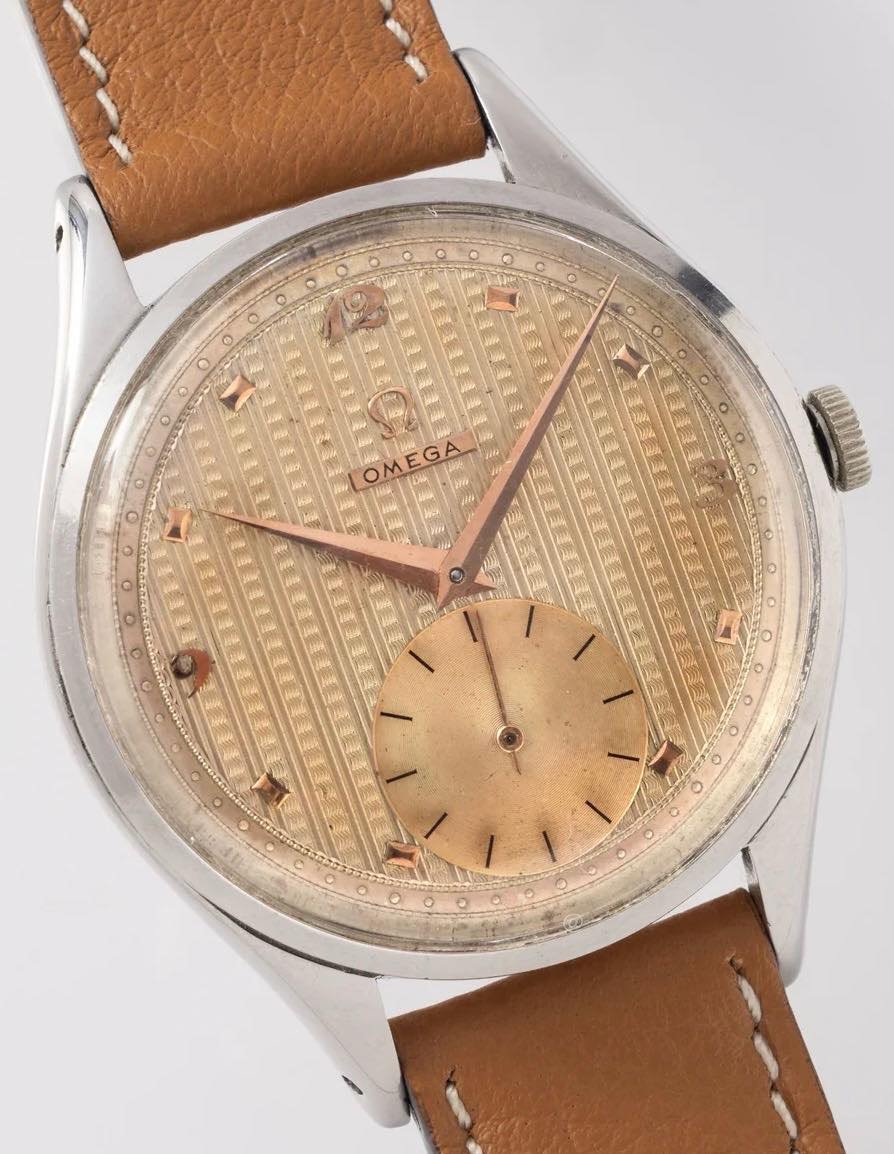

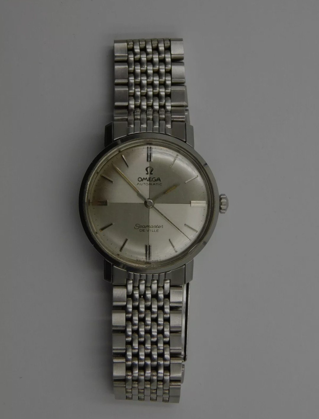

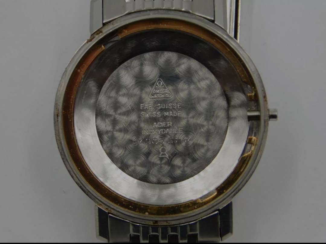

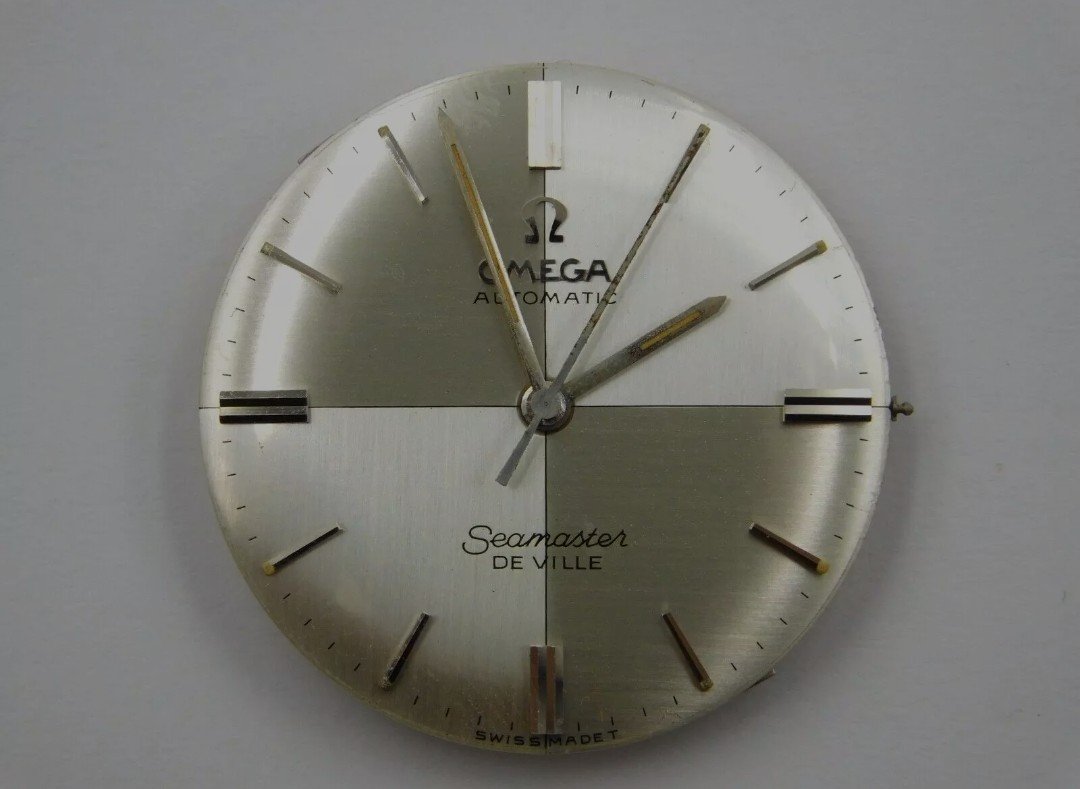

Hi guys, found this example of a quadrant dial SMDV.
Now, comparing the dial to the examples under this thread, I can observe a few differences in the font. Reviewed side-by-side, I don't think it matches with any of the SMDV fonts earlier, either. And the alignment of Swiss Made T doesn't look good. Obviously, the 'scratched' text on the inside of the caseback and lack of further info raise doubts. However, the placing of the cross hair and alignment of other texts with it seem quite the bull's-eye. The overall texture of the dial also looks good.
Do you think this example meets the criteria for the quadrant dial? My verdict is on the suspicious side. Either way, I hope that this would contribute to the info pool here.
3,785
20,205
It looks pretty authentic to me. The condition of the tritium dots tells me that dial is not refinished. The gasket and screw heads tell me that watch has never seen a service. I probably wouldn't really sweat anyway it because A) it looks really good aesthetically and B) it's a pretty inexpensive watch. Stylish. I'd buy it and service it and wear it.

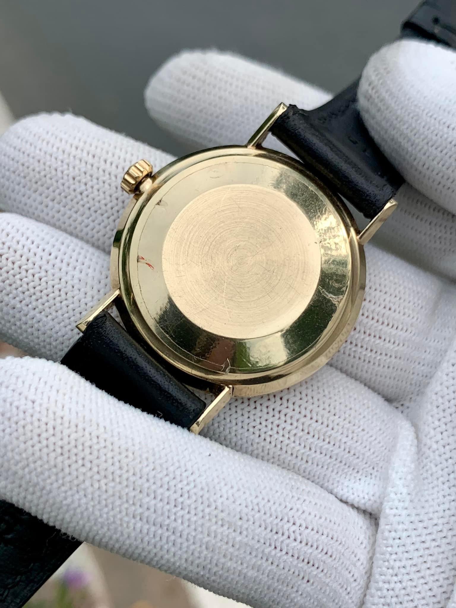

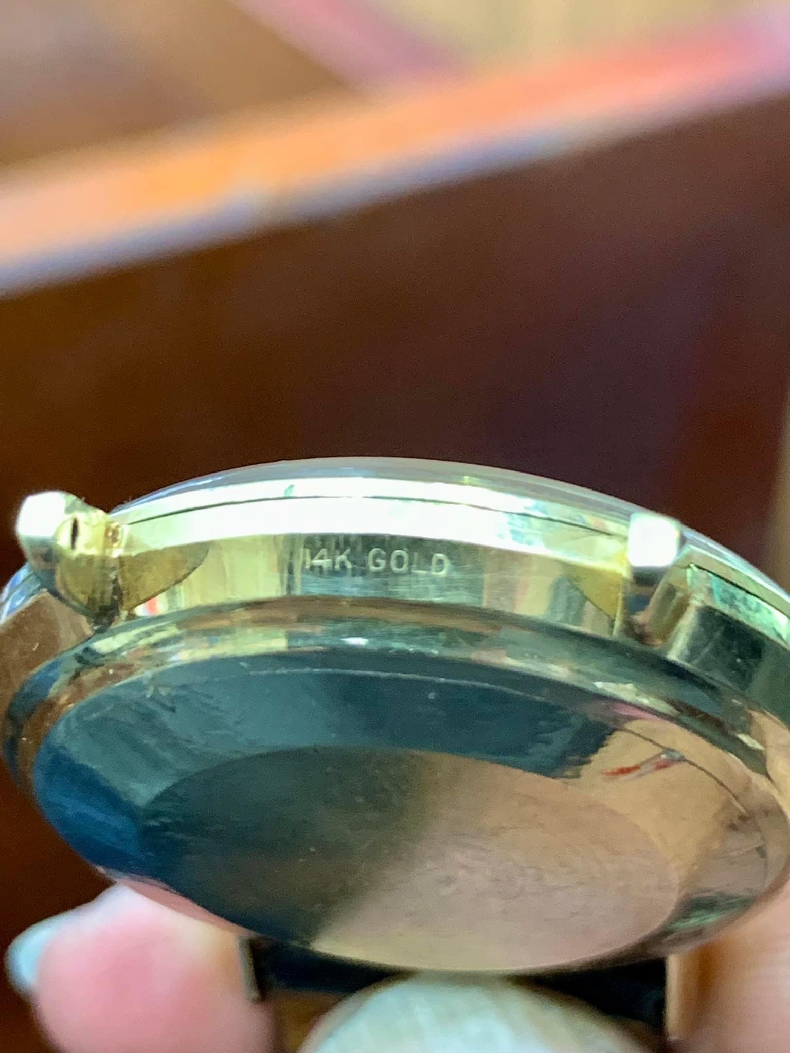

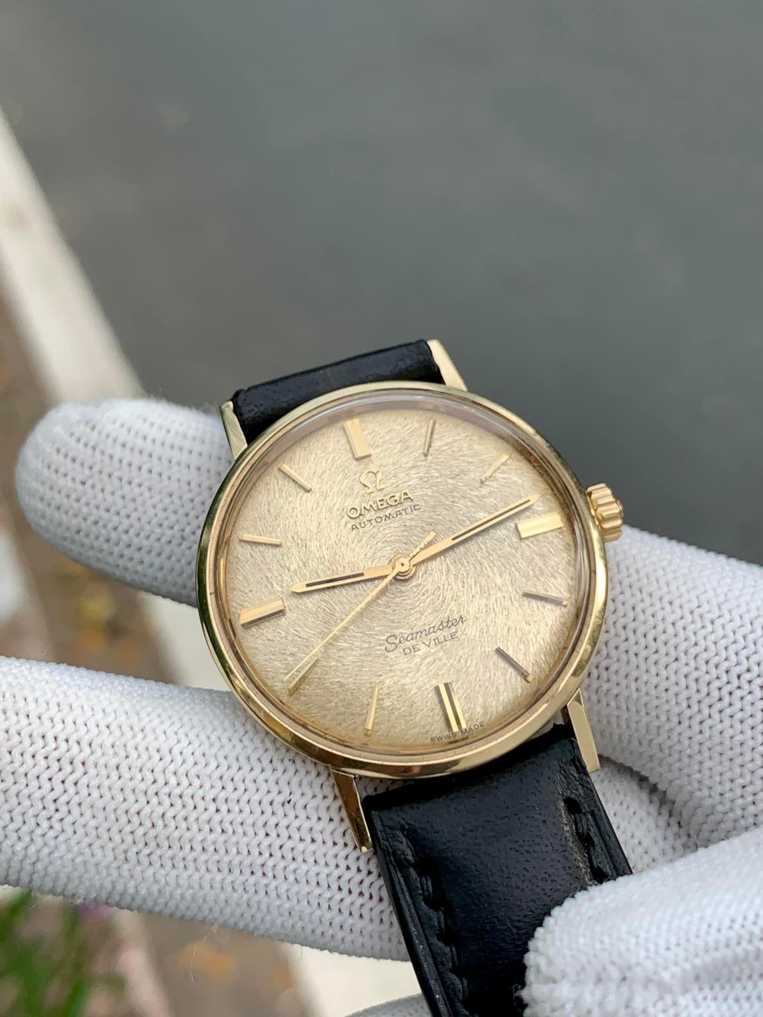

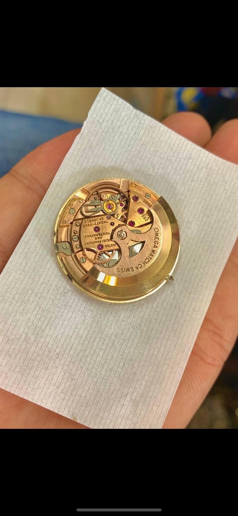

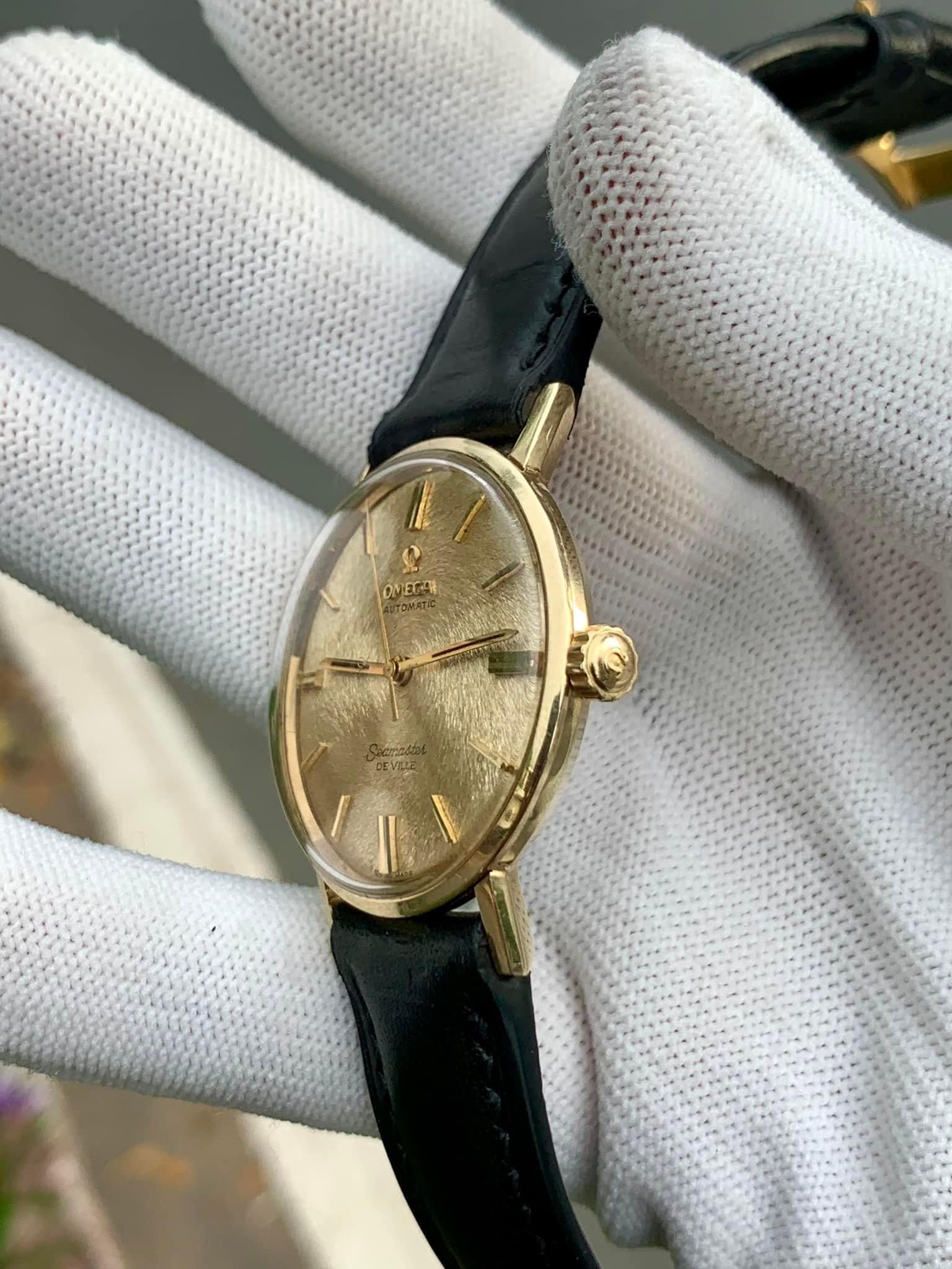

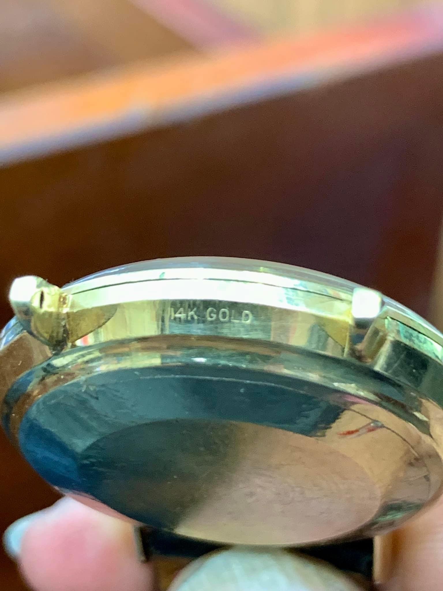

Found ad on local forum for this Seamaster (14k solid gold case, 22M serial range, no seahorse case back). What do you think about its authenticity. Thanks in advance for sharing your thoughts.
PS: I am not eager to buy it. Asked here just for the sake of my education.
884
1,749

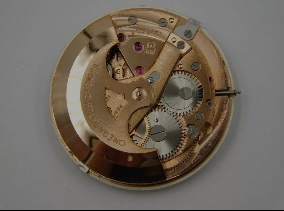

Hello! This is a frankenwatch, the movement should bear the "OXG" mark on the balance bridge.
The case has been polished to make it look like brand new and this is probably a repainted dial.
411
626
Thank you @PlainVanilla for very quick reply to my request. The ink - quite faint - on dial is suspect but dial texture (swirling) seems authentic, isn’t it?
