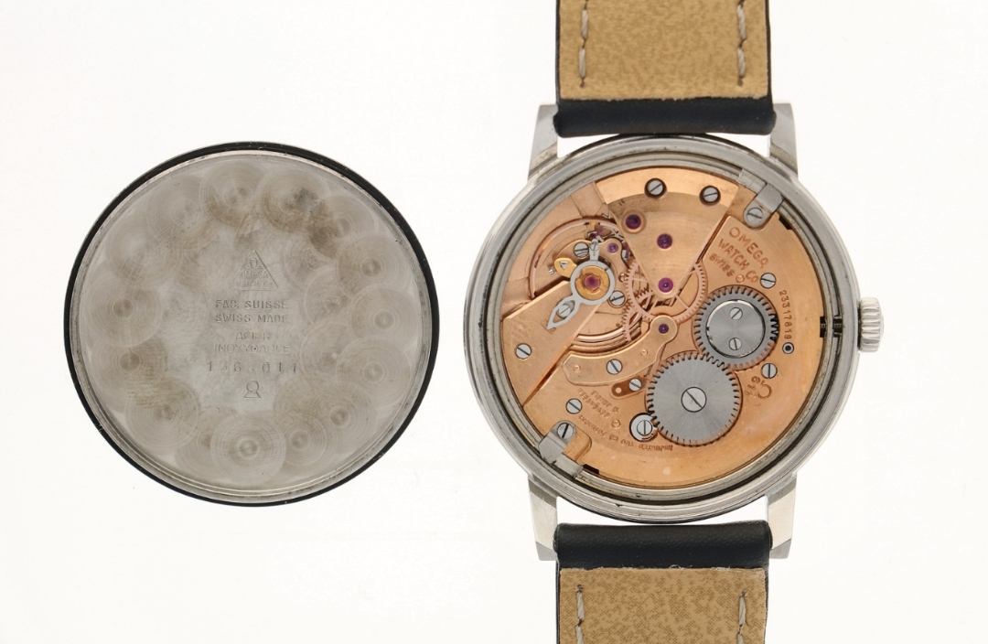

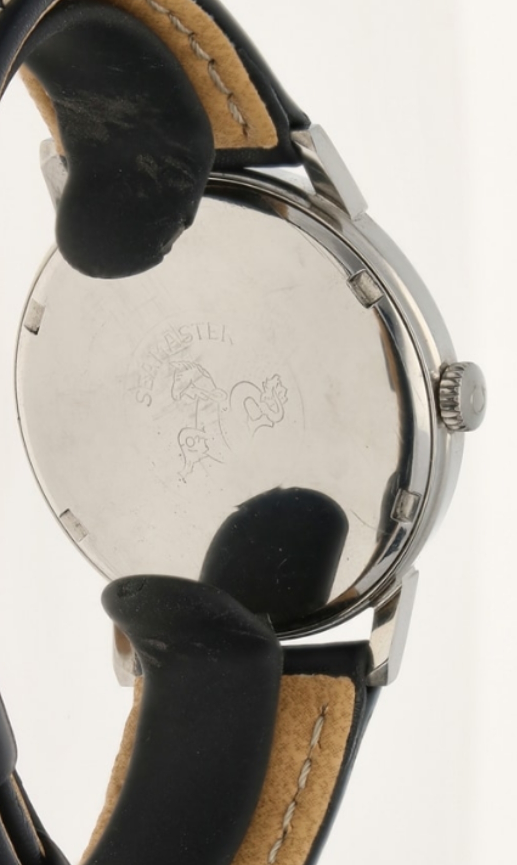

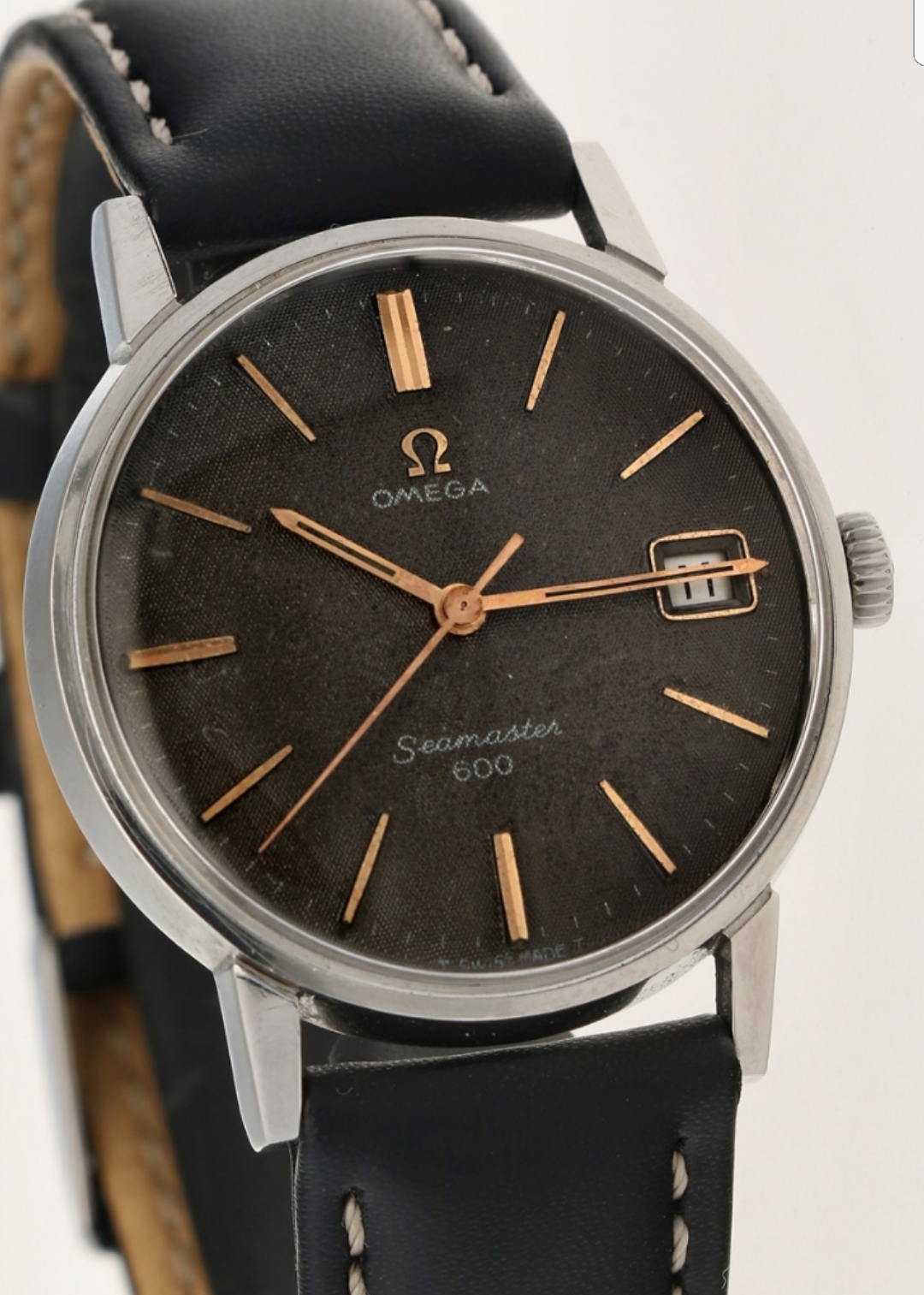

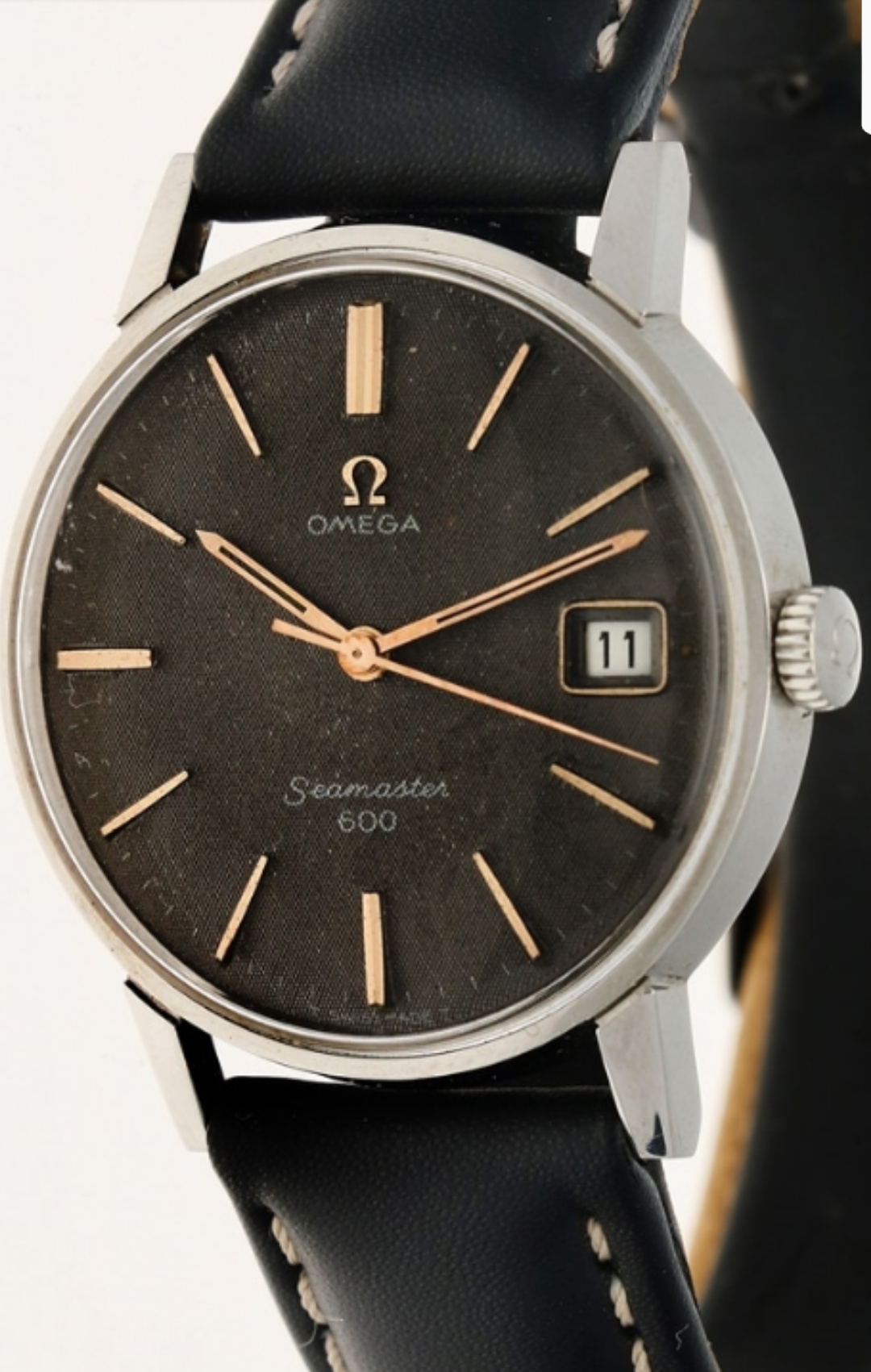

Hi,
I haven't bought this watch yet but I showed my interest in it. I have a few questions about this watch. Are there any known problems with the linen dial? Like does it fade? Furthermore, do you see anything strange? Parts missing? My last question is about the original box, what does that look like?
Thanks in advance!

That dial looks like a pretty half-hearted effort to me.

Do you mean you think it's fake? Or not worth to buy it because it will eventually go bad?

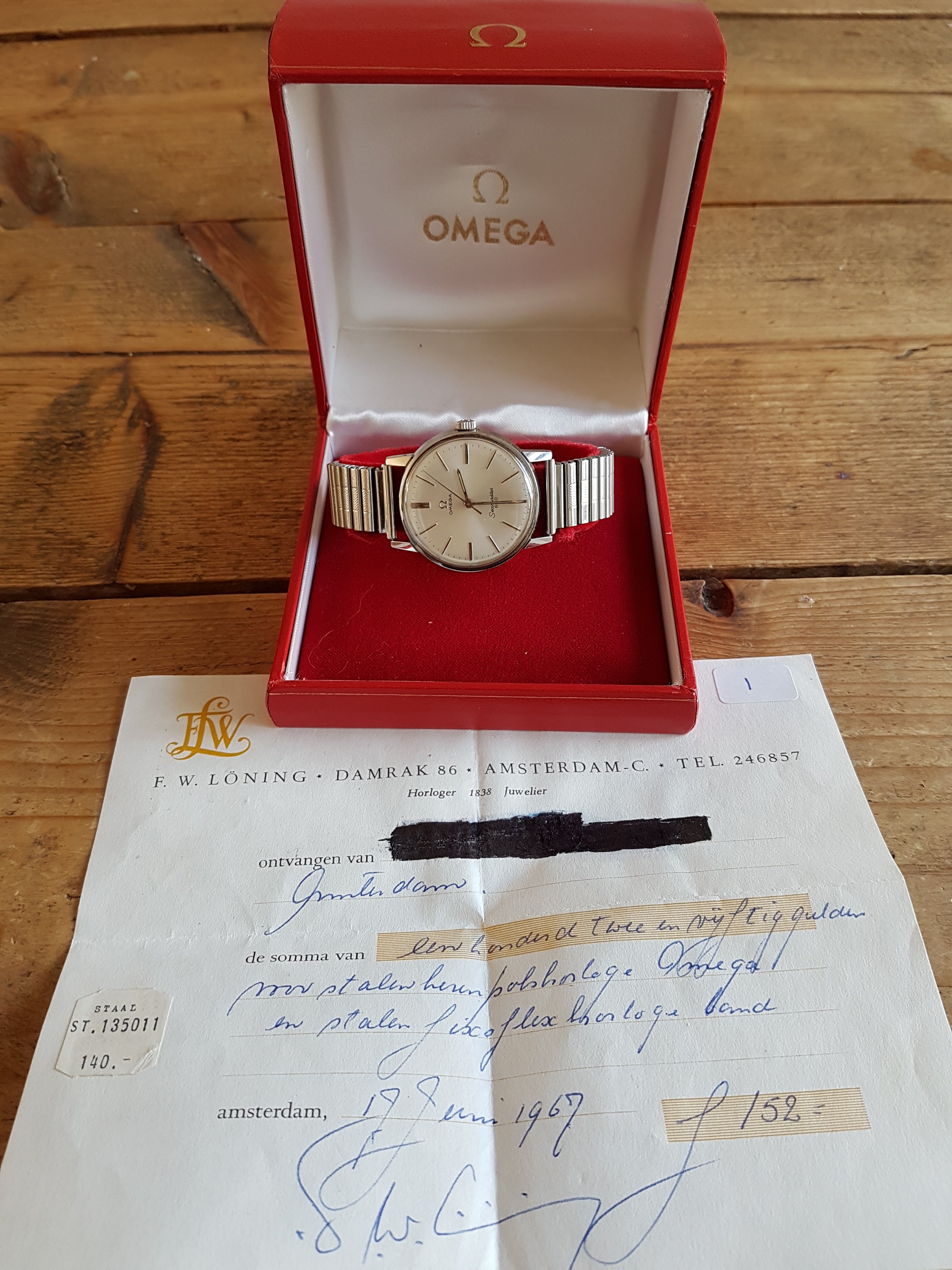

I have never seen a dial like this on a 600. I would start with another watch. Here's the box of a 600

OMEGA font all over the place.
T Swiss Made T doesn’t match the lack of lume from indices and hands.
Why do redialers depart from known dial formats?
