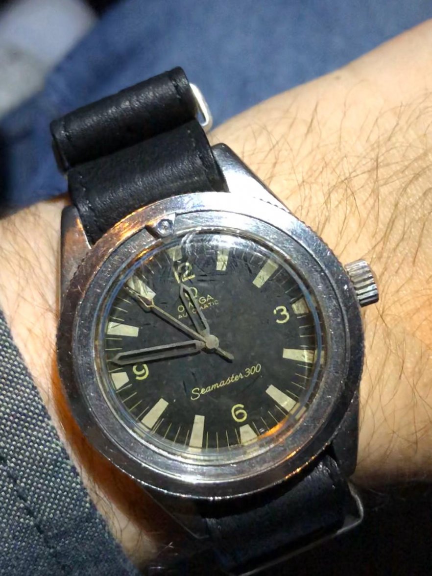

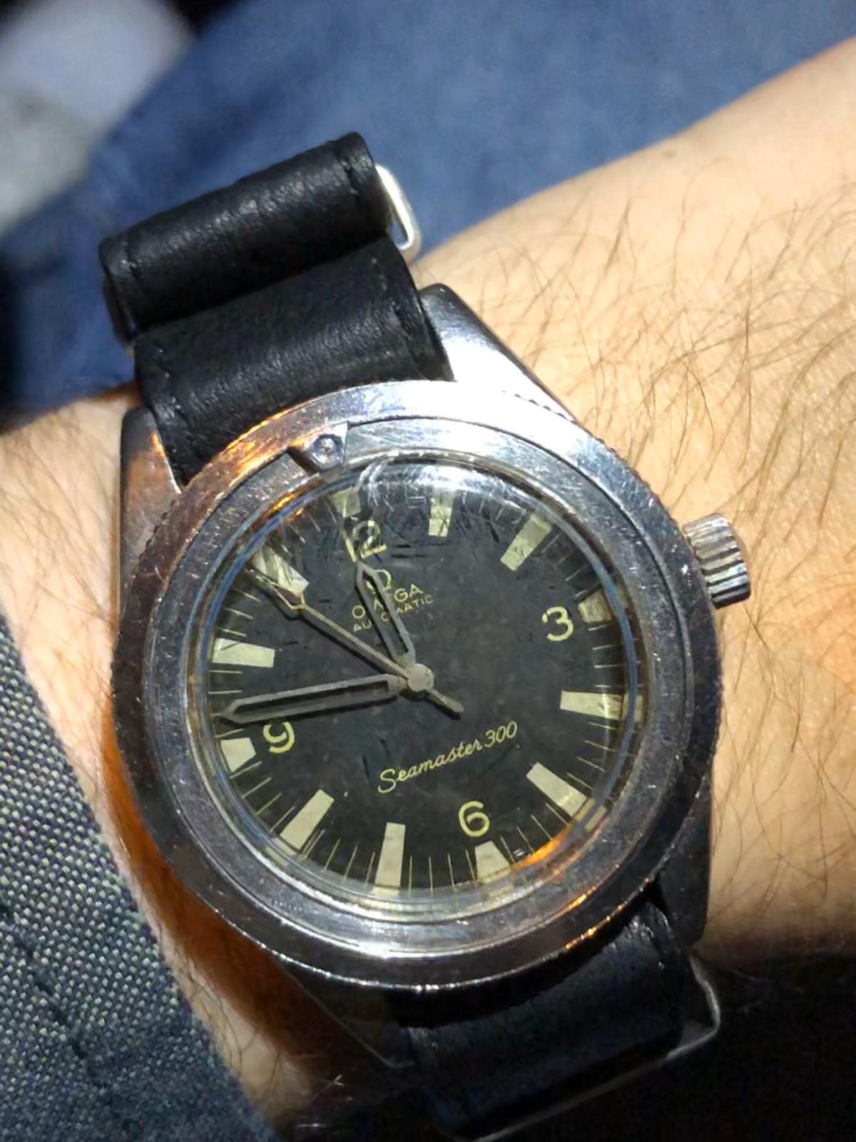

As I started taking the watch apart right away to restore it, I unfortunately didn't spend time on taking a proper before-picture. Here is all I got:
First step was taking the watch apart. It is worth pointing out that since I am not a watchmaker I do not touch movements. However, I like playing around with the rest of the parts of my watches and do some restoration. After a good cleaning of all parts, I started with repainting the running second hand white with a touch of patina to make it not look as bright white as a new hand would look.
After that, I started mixing up some old tritium paint to relume the dial and hands. I know that a relume is not to everyones taste, but since I use old material I see myself doing restoration work rather than destroying the originality of the watch. Also, there was no lume left anyways.
Next up was the bezel. As with most of these watches, the plastic of the bezel ring broke off and fell apart. I speed quite a some time thinking how I could restore it. I am still playing around with it and learning a lot but I think the first result is quite okay.

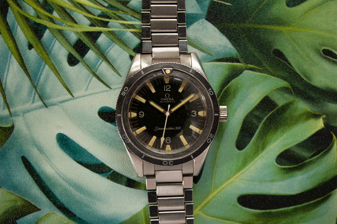

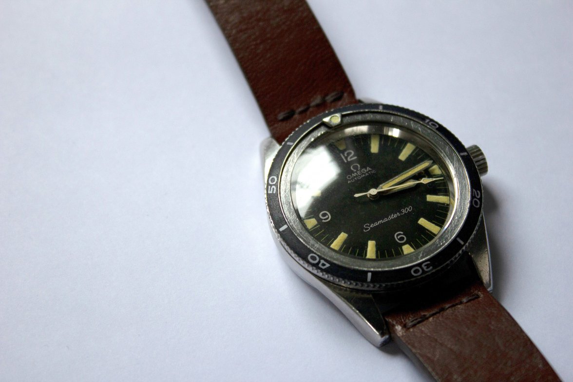

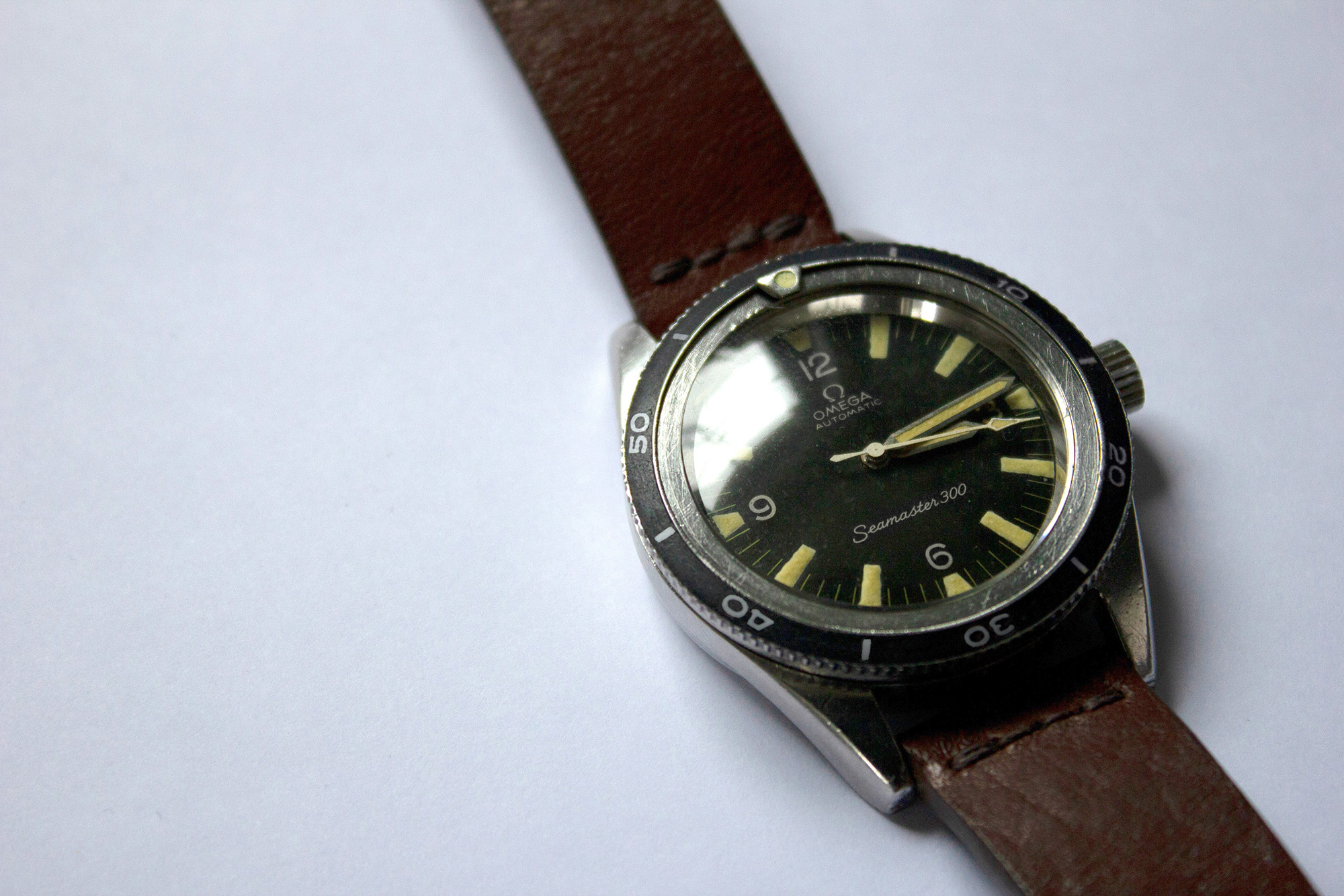

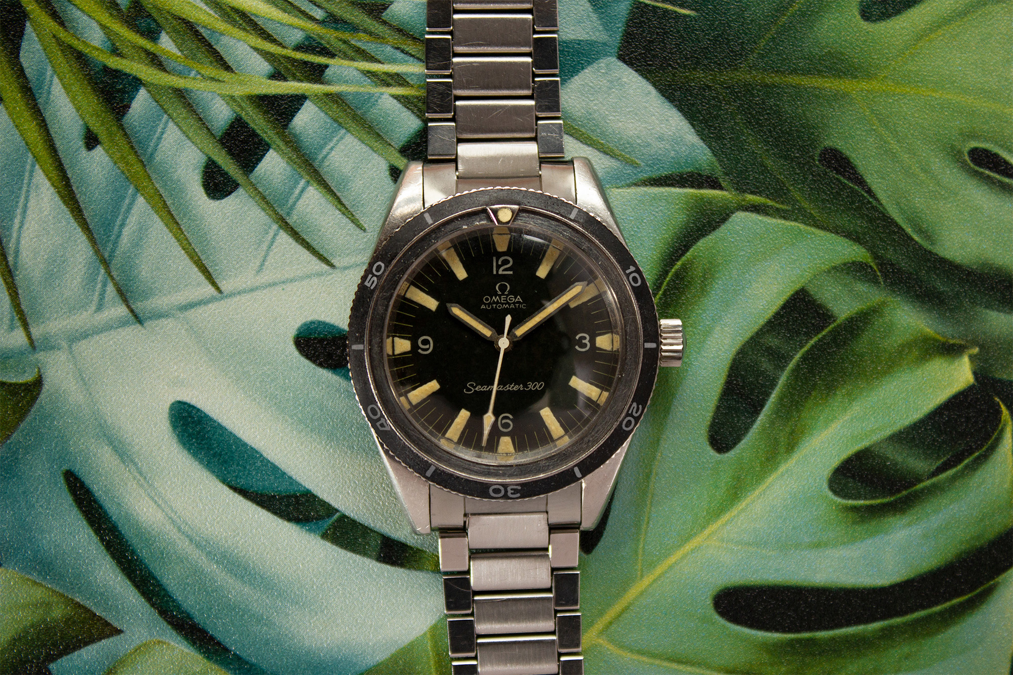

now finally some after-shots. let me know what you think!

Congrats!
The bezel looks not bad, but have you considered Aldo's bezel restoration?

Thank you!
Not really since I heard mostly negative feedback regarding his communication and lead time.
Also as I was able to do it pretty good myself it was not really an option to send it to someone else. i think I am pretty close so far. I will do some more tests with it. Unfortunately I ran out of bezels to experiment with.

Very good with the resources, you had ! The relume is a bit too even for that age of the watch. If you used waterbased tritium, try the following the next time the movement is out: buy the finest artist brush, you can find. Natural hair. Brew a strong black Tea. Let it dry on a saucer. Use a little water to colour it with the brownish, dried Tea. Dab very carefully the lume in slightly different shades, control these shades with more or less water added. same for the hands. They age differently due to a different material. Make them one or two shades darker than the dial lume. Will make a difference. Patience needed. Kind regards. Achim

That鈥檚 a very nice result, good job. How did you restore the bezel?
