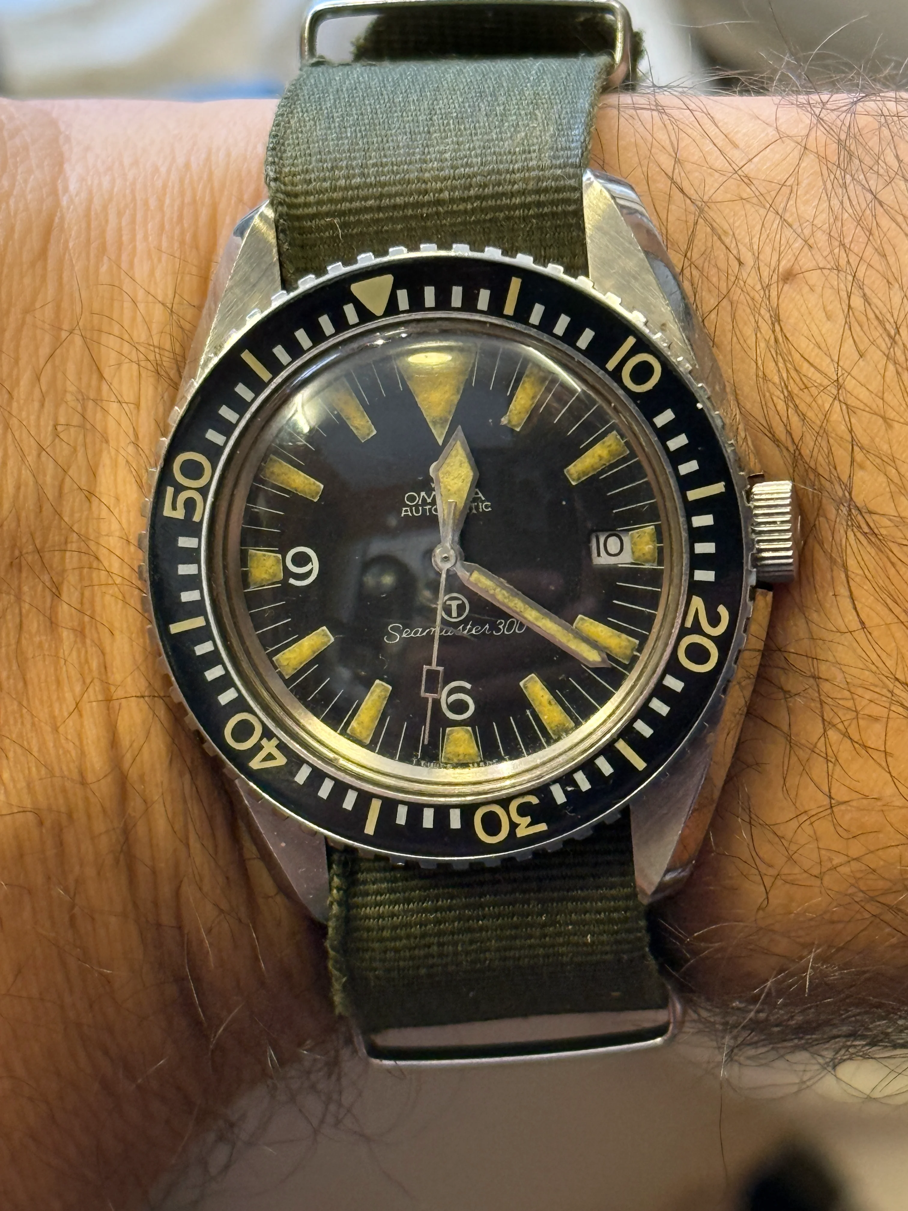

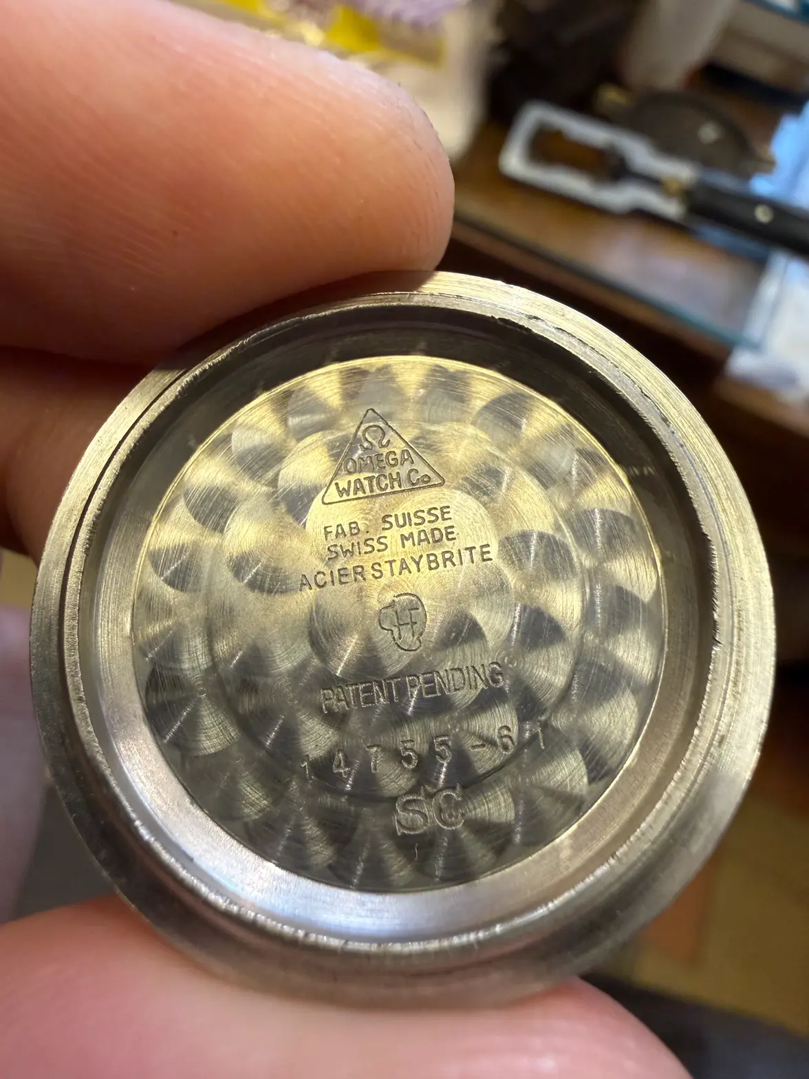

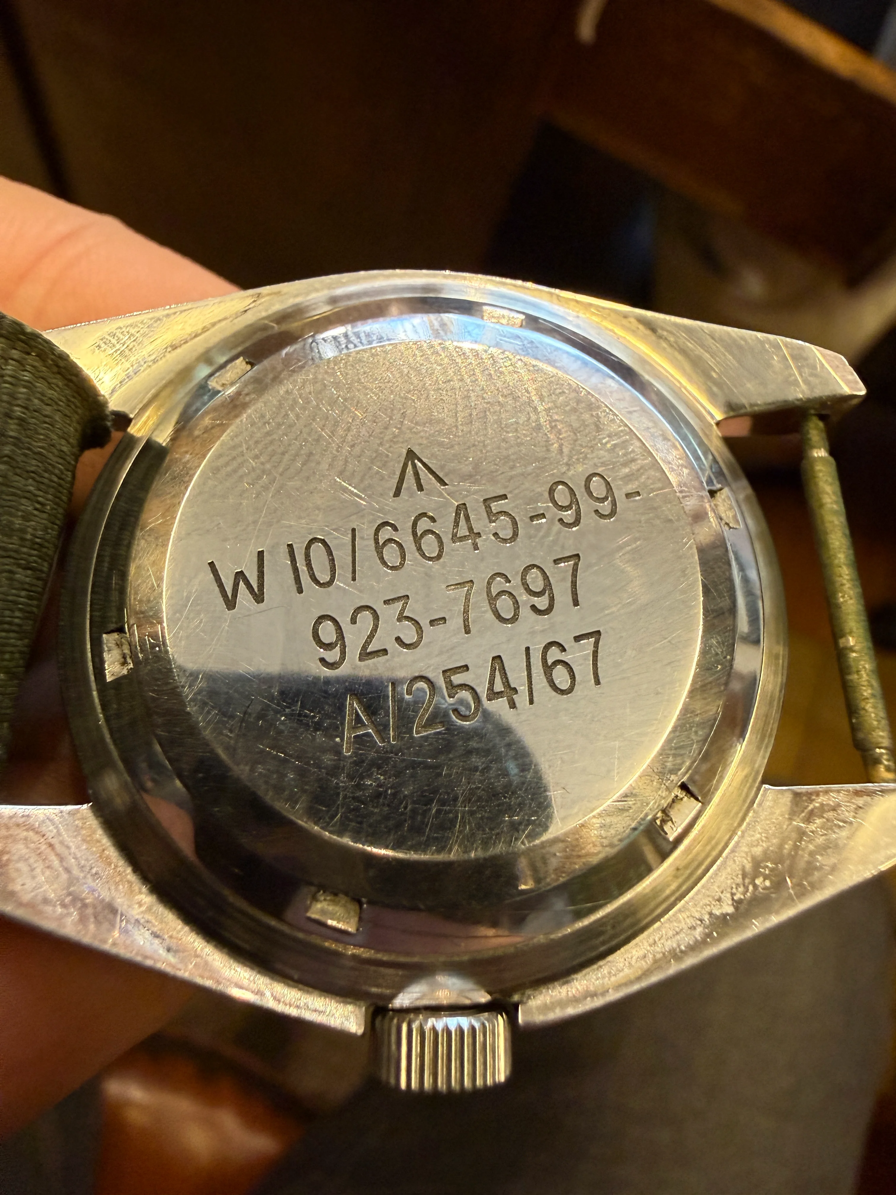

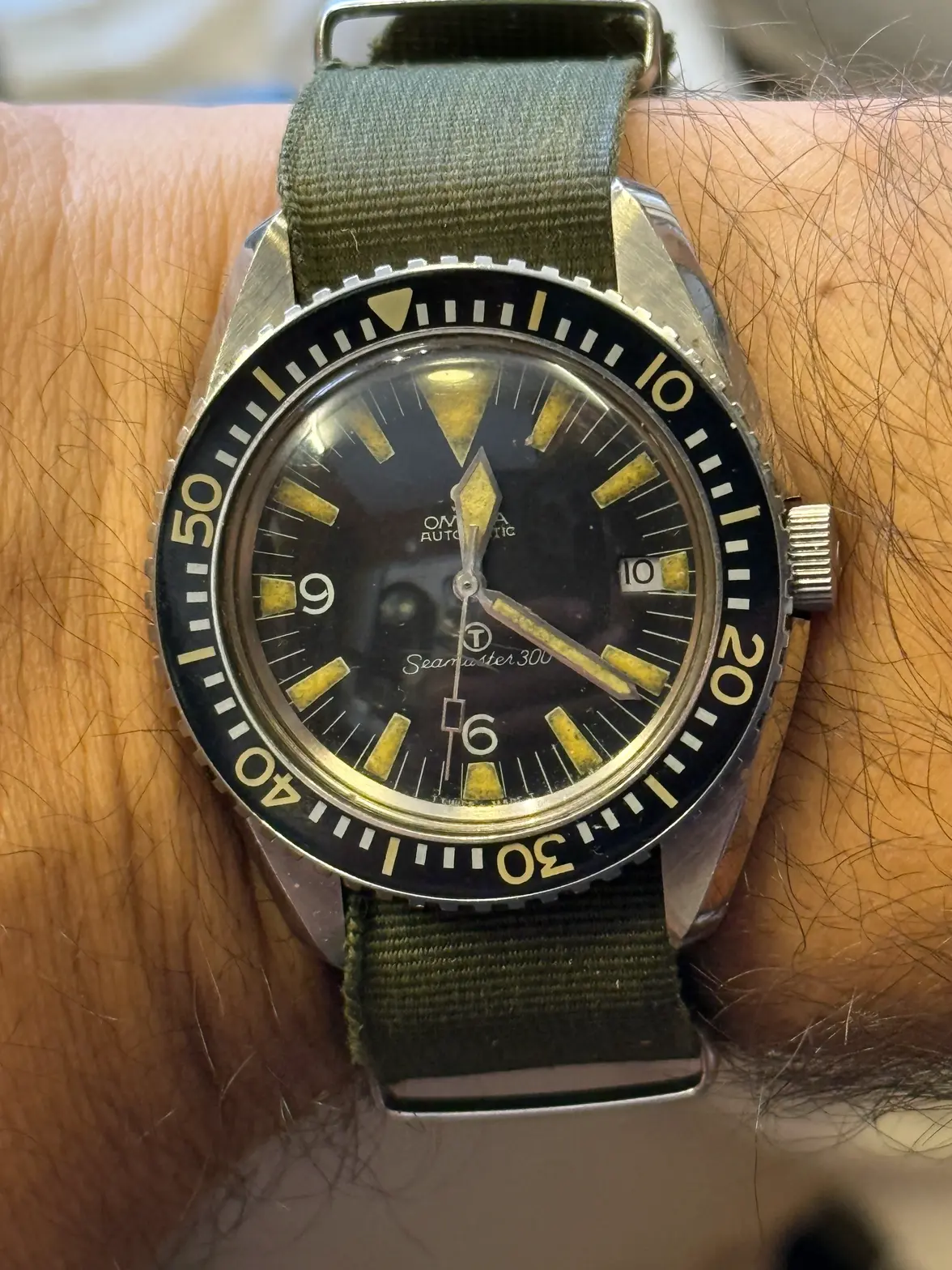

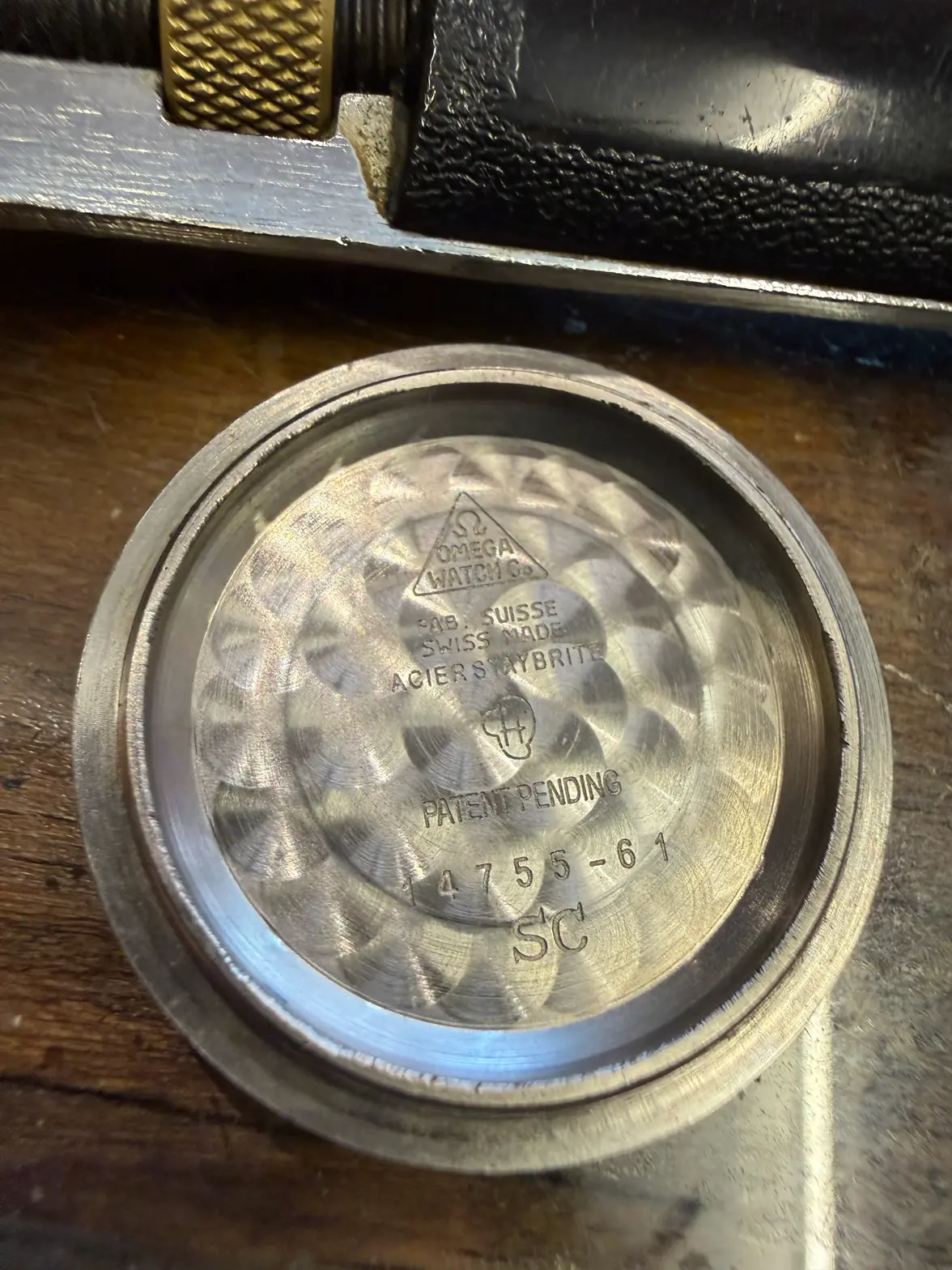

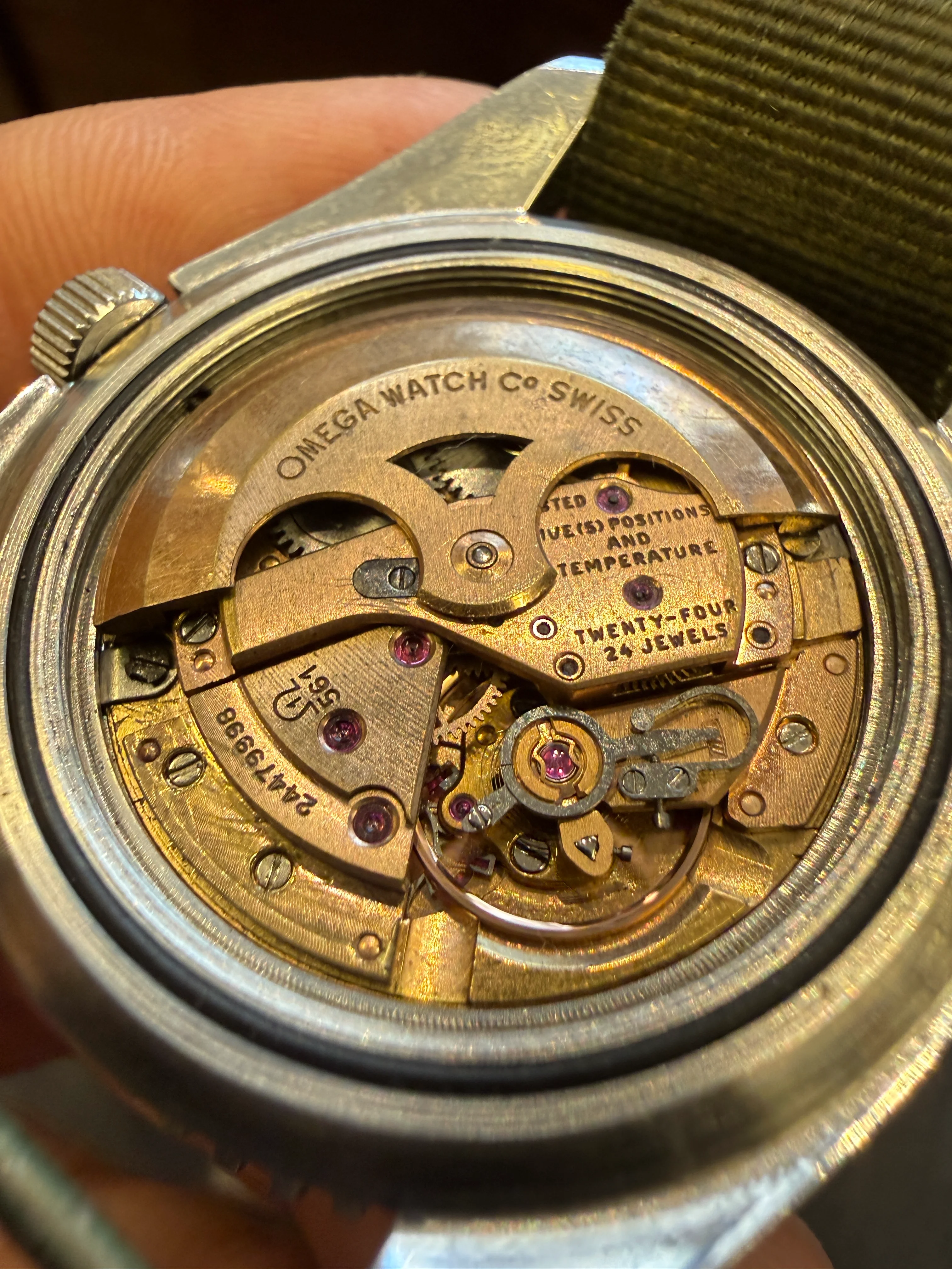

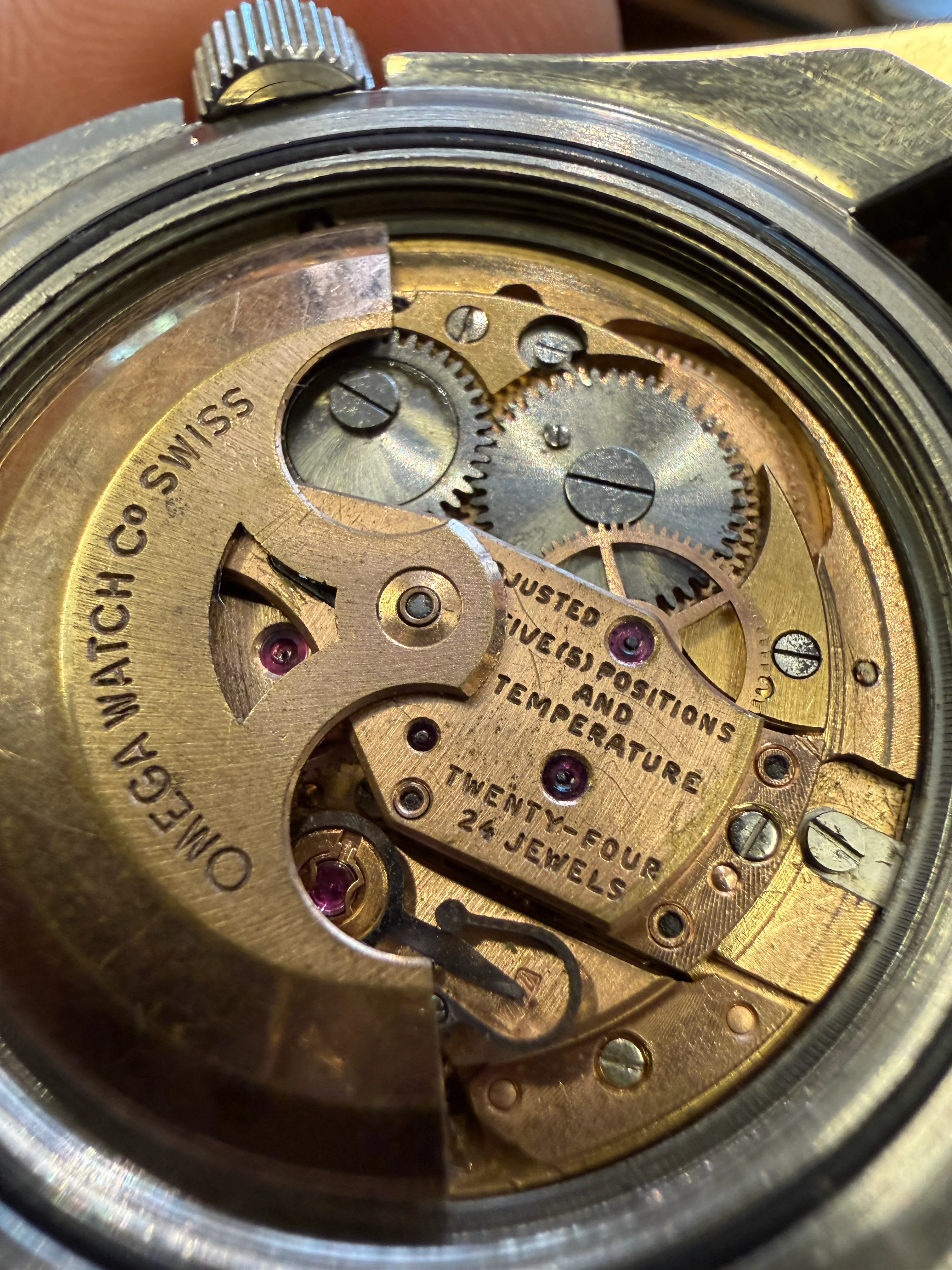

Hi, I'm new to the forum. I live in Türkiye. I just bought a watch and I'm trying to find out exactly what kind of watch it is. Is it fake?

Pretty sure it's because this is a total fantasy watch made up of mismatched parts and faked engravings. But I'm no expert.

Honestly, my reason for coming here is to get accurate information. I believe you. What exactly is this watch? Is the dial fake? Is the movement fake? What exactly is it? Can you explain it to me in detail?

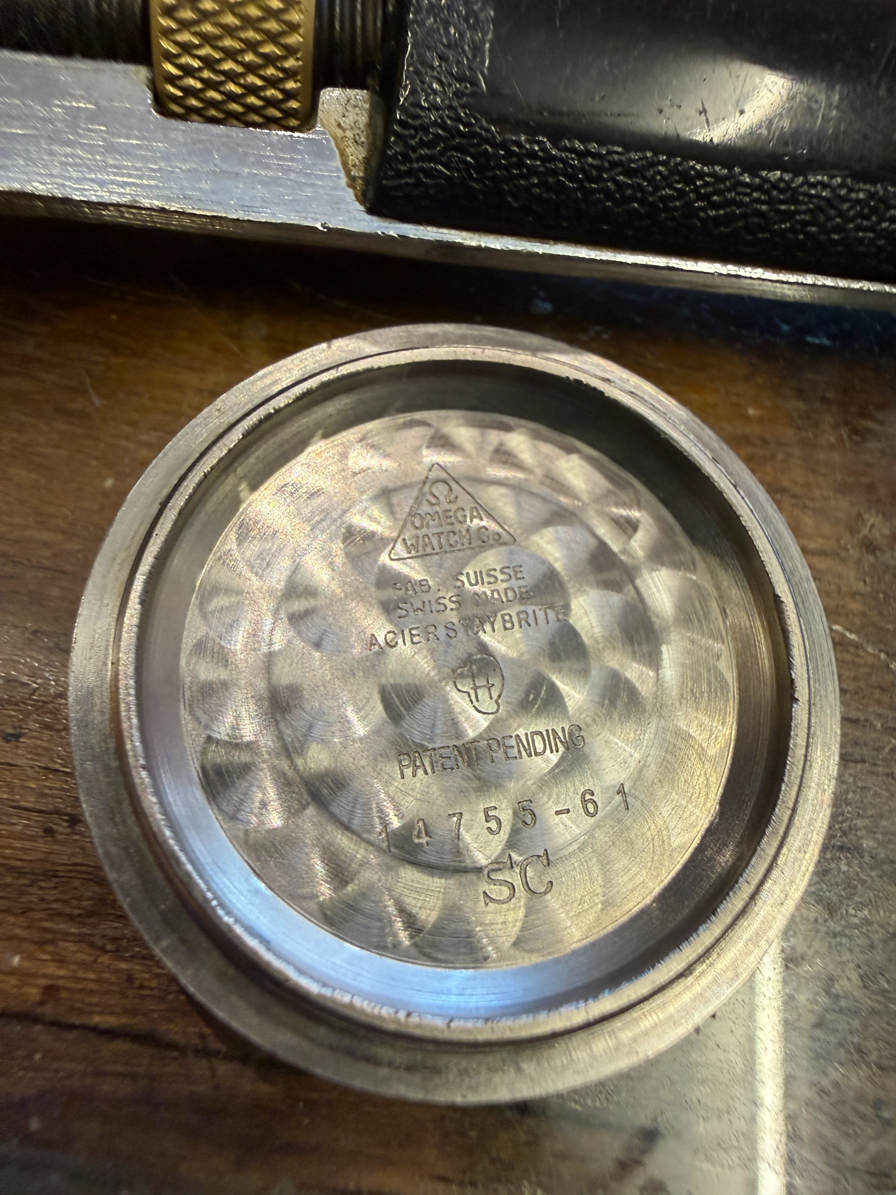

Wow, that NSN and pheon look like they were engraved yesterday, not 59 years ago.
Amazing.

The basics.

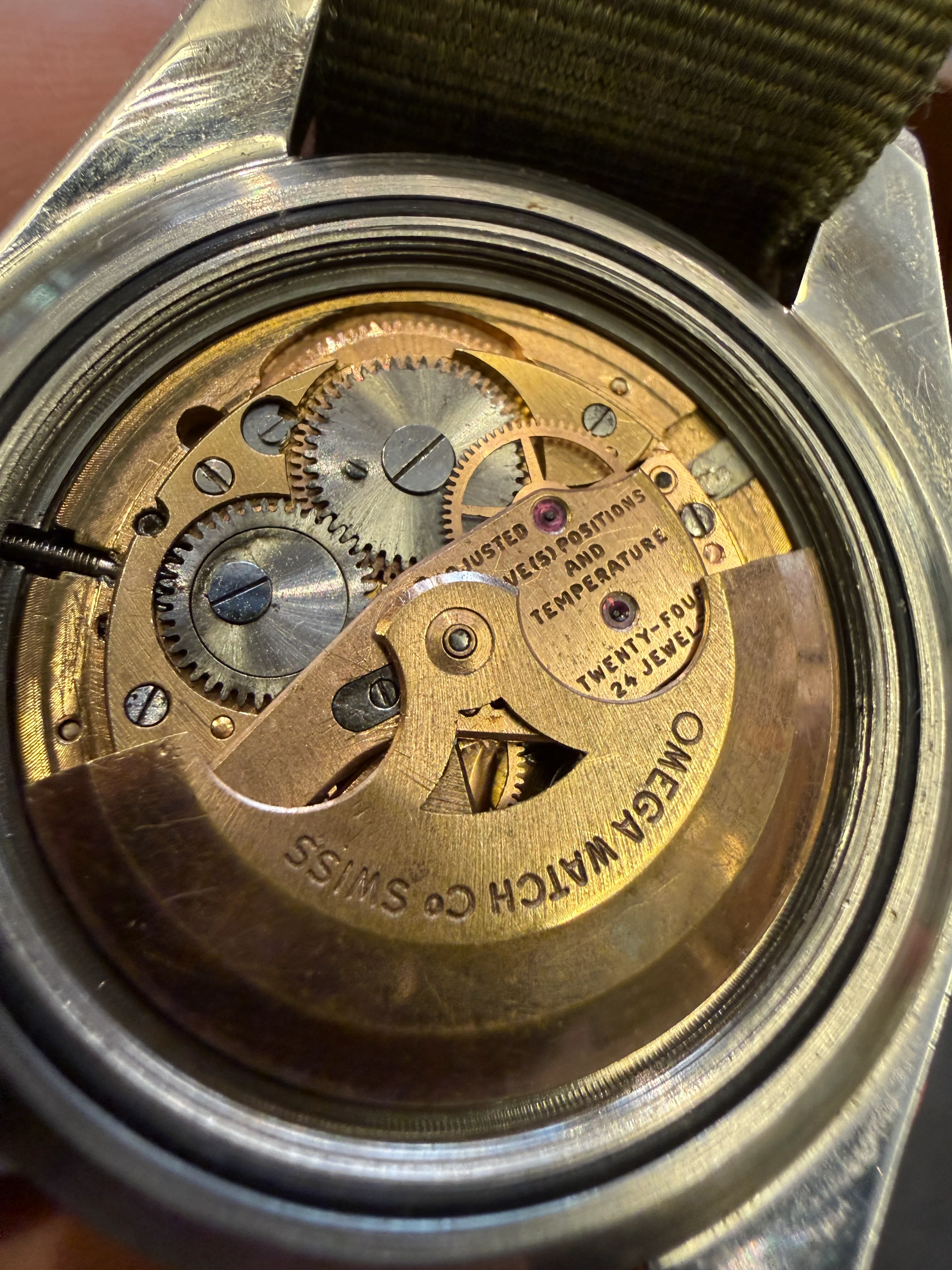

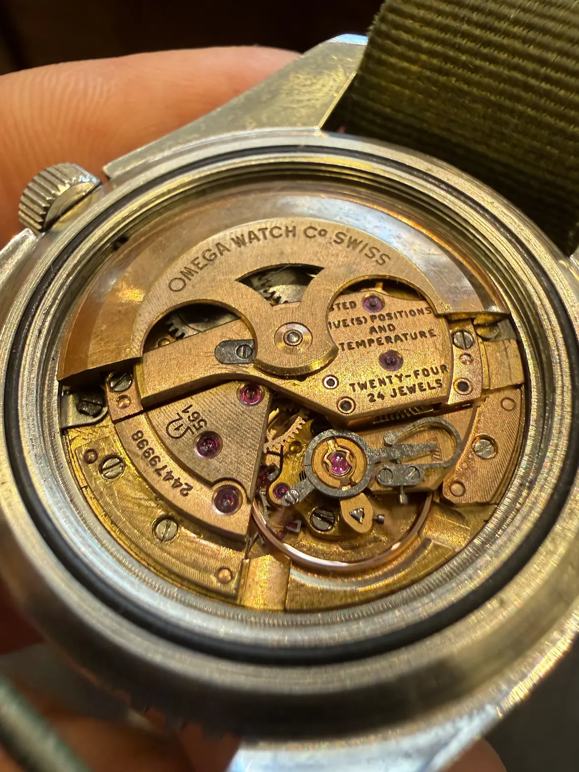

Compare the condition of the movement to the rest of the watch.
Condition should be the opposite, the movement being protected in a waterproof case would be pristine, the exterior of the watch should show wear and tear, this case is still too crisp for a working watch of it's age.

Inscriptions are a joke

I would suggest looking at least one or two Originals before buying your next vintage watch, or just buying a new watch from an authorized dealer.

Stubbies are never a good sign.
It's not "Stubbies", it's "STUBBEEEEEEEEZ!"

Everything about this watch seems fake, from what I can tell...

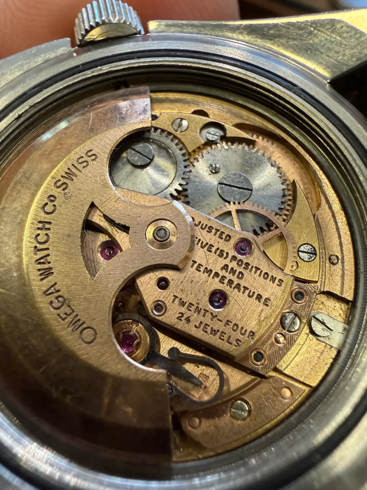

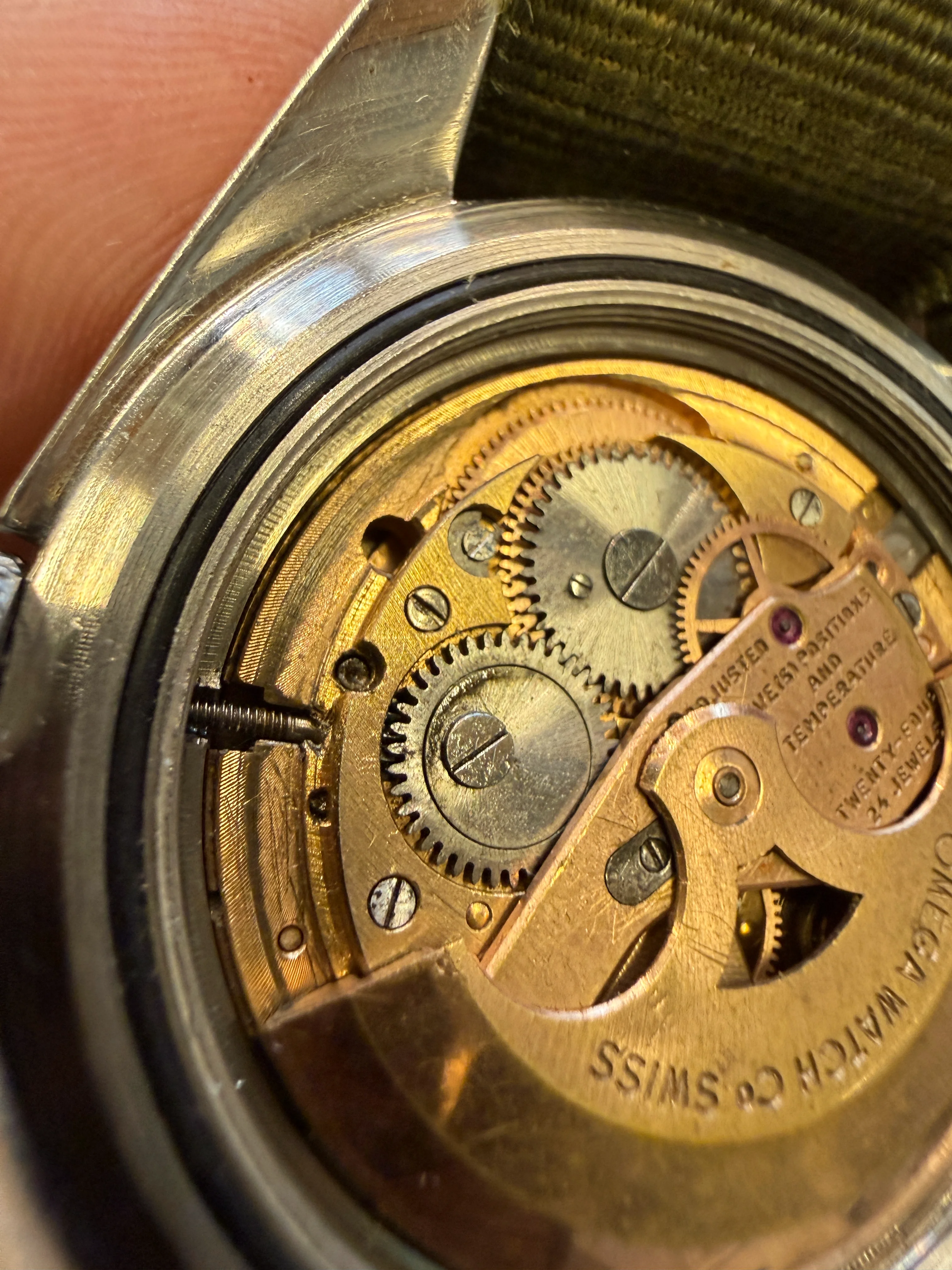

not the movement, it IS made by Omega, just from pieces and bits and put together

Stubbies!!!!
I know it’s been said already but if you post a watch here with these then prepare for a spanking.

To be clear, the movement is genuine but it’s been put in a completely fake case, dial, bezel hands etc.
