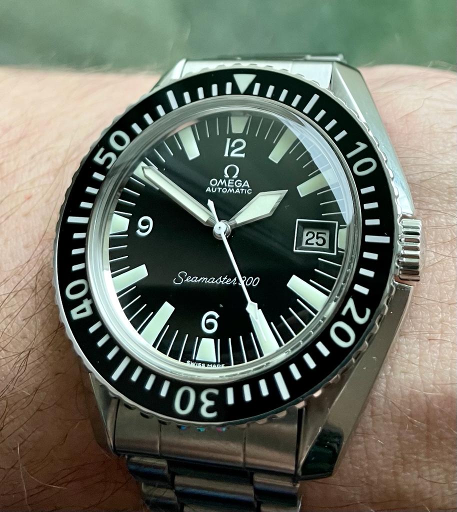

Hi, a bit delayed response, I know 馃榾 My friend has made the tubes for me. The project was finished in meantime and here is the clone of very early 166.024

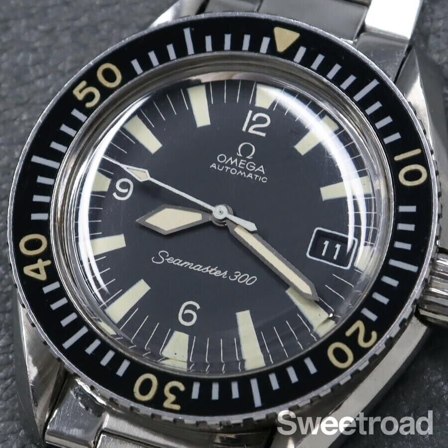

27.1 mil SN -- Naiad:
http://www.josephbonnie.com/en/prod...00-vintage-ref-165-024-caliber-552-year-1968/
27.4 mil SN -- Naiad:
https://forums.watchuseek.com/f29/f...tritium-dial-plexi-1171-bracelet-4659643.html
27.9 mil SN -- Naiad:
https://www.lunaroyster.com/archive...-300-sword-hands-165024-on-flat-link-bracelet

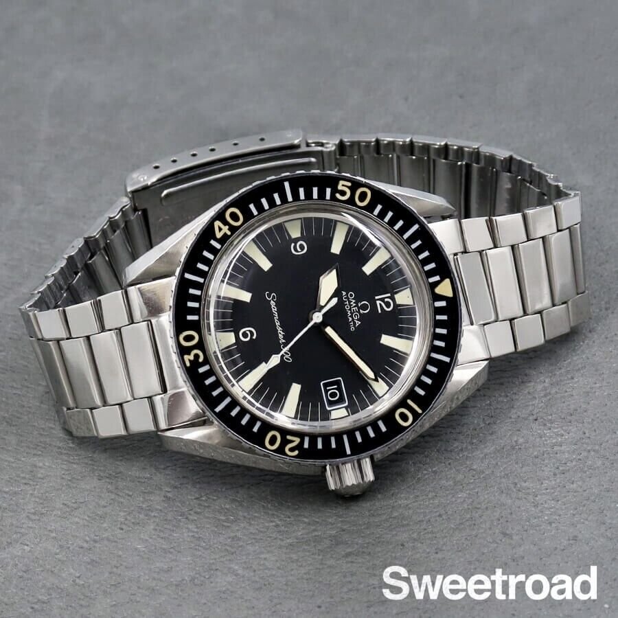

So as we can see here the Naiad crown is still quite prevalent well into the 27 mil range, which is likely well into 1968 production. We also see some screw-ins appearing obviously and I've also included an early outlier that was almost certainly retrofitted.
This is not say that I draw any hard and firm conclusions other than the apparent fact that the Naiad was not actually phased out by late 1967. It seems highly unlikely that so many of these would be "reversed" for the push-in Naiad either, especially as that requires an entirely different tube and is not just s straight crown swap. In other words if you have a later 165.024 with a Naiad and not a screw-in crown I would have to conclude that it's perfectly acceptable.
As for myself, I still kind of feel like the screw-in crown was some sort of ex-factory option and not really standardized. Otherwise why so many surviving Naiads so late in the 165.024 game? Could be replacing the crown was also a recommended procedure for factory service later on when these watches were turned in for overhaul. Hard to know for sure and YMMV on that. But IMO, both crowns can be found later in production and it should not prejudice the overall opinion of any given 165.024's authenticity. Clearly a screw-in crown appearing too early is another story, of course. But again, if we are looking at an overall customer or Omega-recommended upgrade scenario even that might take on a different hue.

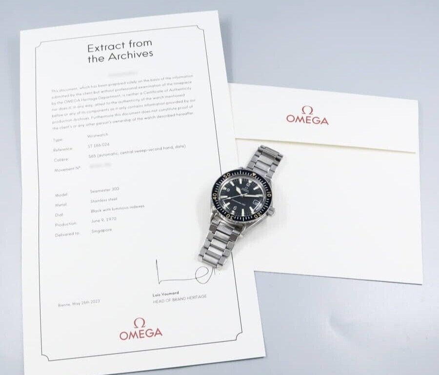

I came across this 166.024 on eBay (no affiliation) that has a June 9, 1970 production date. This appears to be one of the latest production civilian 300s. It has a screw down crown. Not sure if the SD crown is original or was replaced later.
What year did the Seamaster 300 disappear from Omega catalogs?

I have to update my statement, I have found 165.024 with SN 279212xx SEP1970, so it seems like both civilian/military versions were last produced in autumn 1970.
From what I know, the SM300 last appearance in catalog was in 1970.
I almost sure, that the watch above were produced as SD crown watch, nice condition, but very expansive.

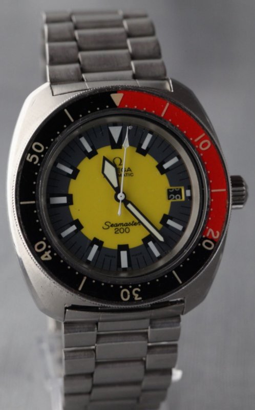

Was the it replaced by the 1969 Seamaster 200 166.068? If so, a huge design downgrade!
Note that the 1969 Seamaster 200 apparently came equipped with a screw down crown. From 1969 - 1971 it had a 565 movement. But in 1971 the movement changed to a 1002 movement.
