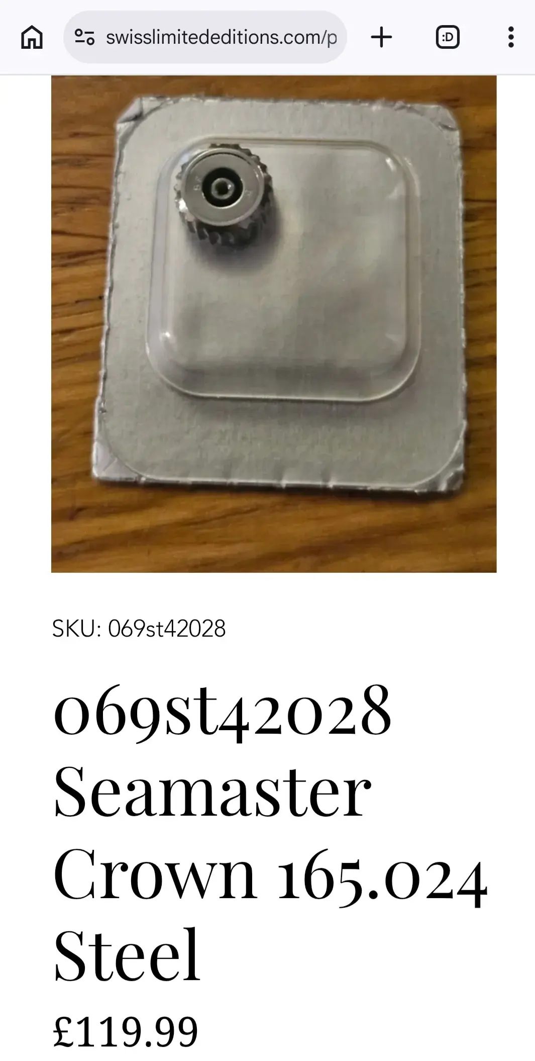

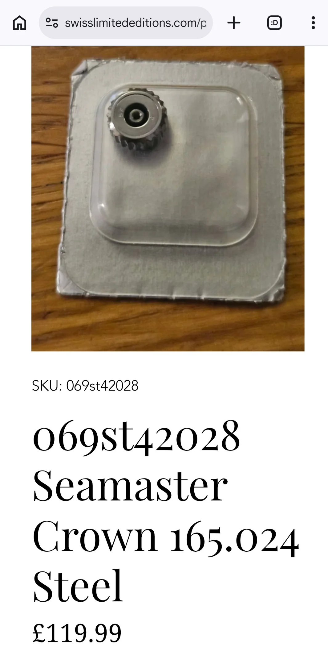

Crown is 069ST42028

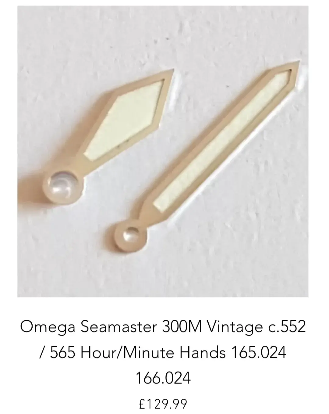

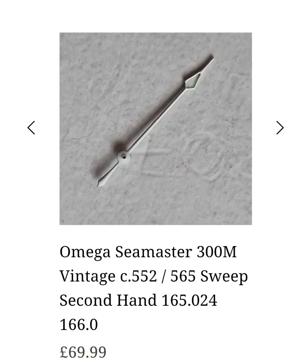

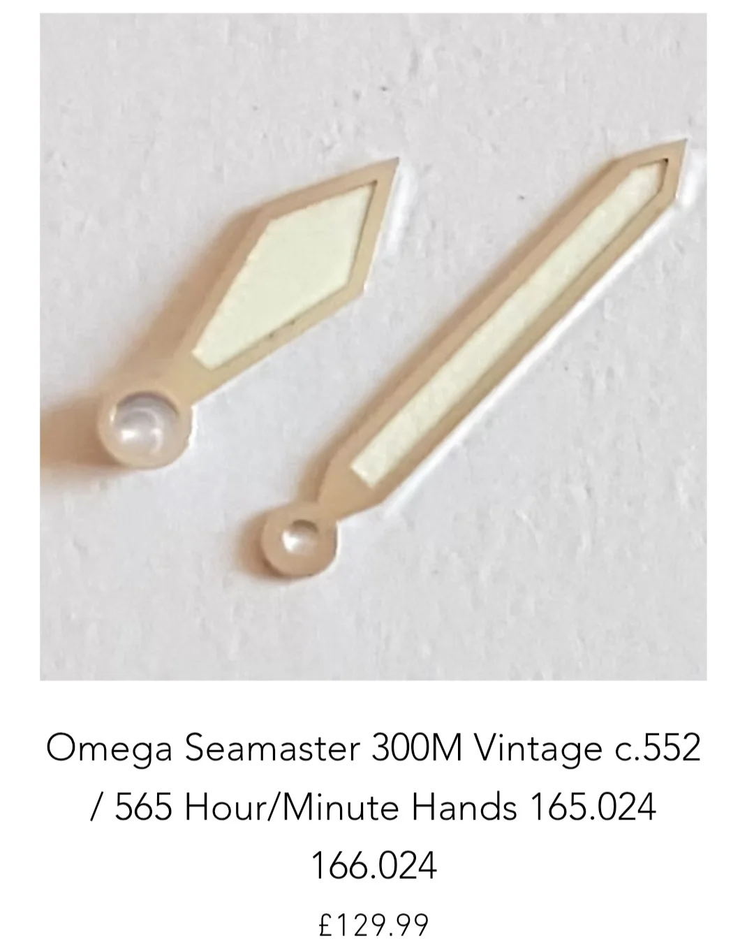

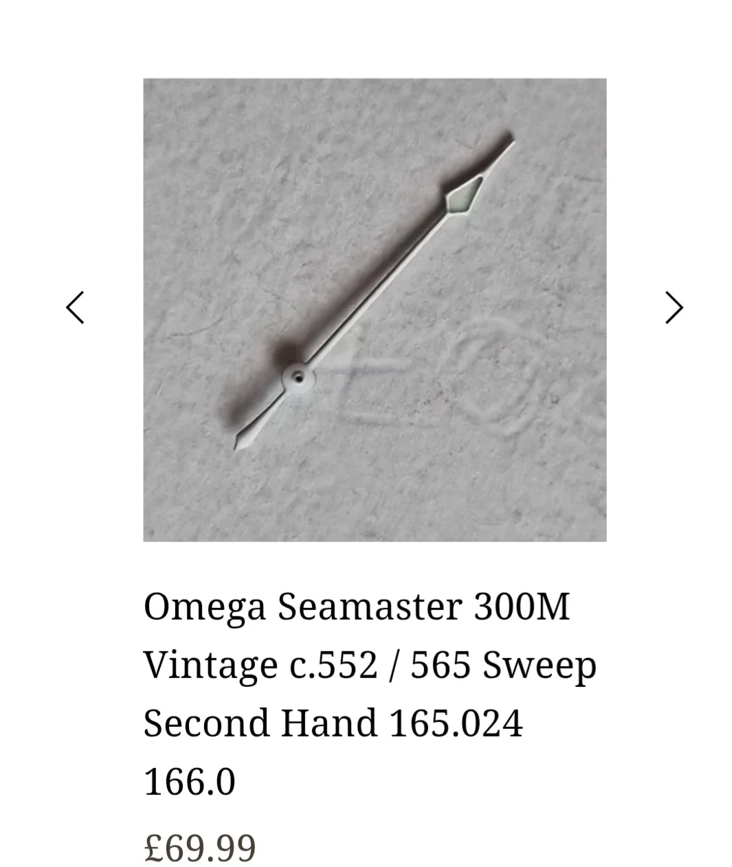

Thank you very much for the Information. Do you also have Information about the hands?
Im in europa
30,357
78,320
H/M hands - 065PZ1176
Seconds hand - 066PP8118

Is there also a way to only change the 2 O rings of the original crown? Where do i find the messurements?
Greetings
What's up Buddy
Unfortunately, the O-rings in the Najad crown is not intended to be replaced, they are pressed in to place during the manufacturing.
So if you want your piece ready for some action, you have to replace the crown for a new one...
You will find the crown and a full sword hand set here... and some other stuff that you might need in the future...

120 ukp for a crown that costs 23 ukp...yikes!

I used g30873 o rings from cousins for the crown. Of course 2 of them. It seems to be flush but i didn’t do a waterproof Test.

Take it to a watch makers and have them conduct a pressure test and then you’ll know for sure
