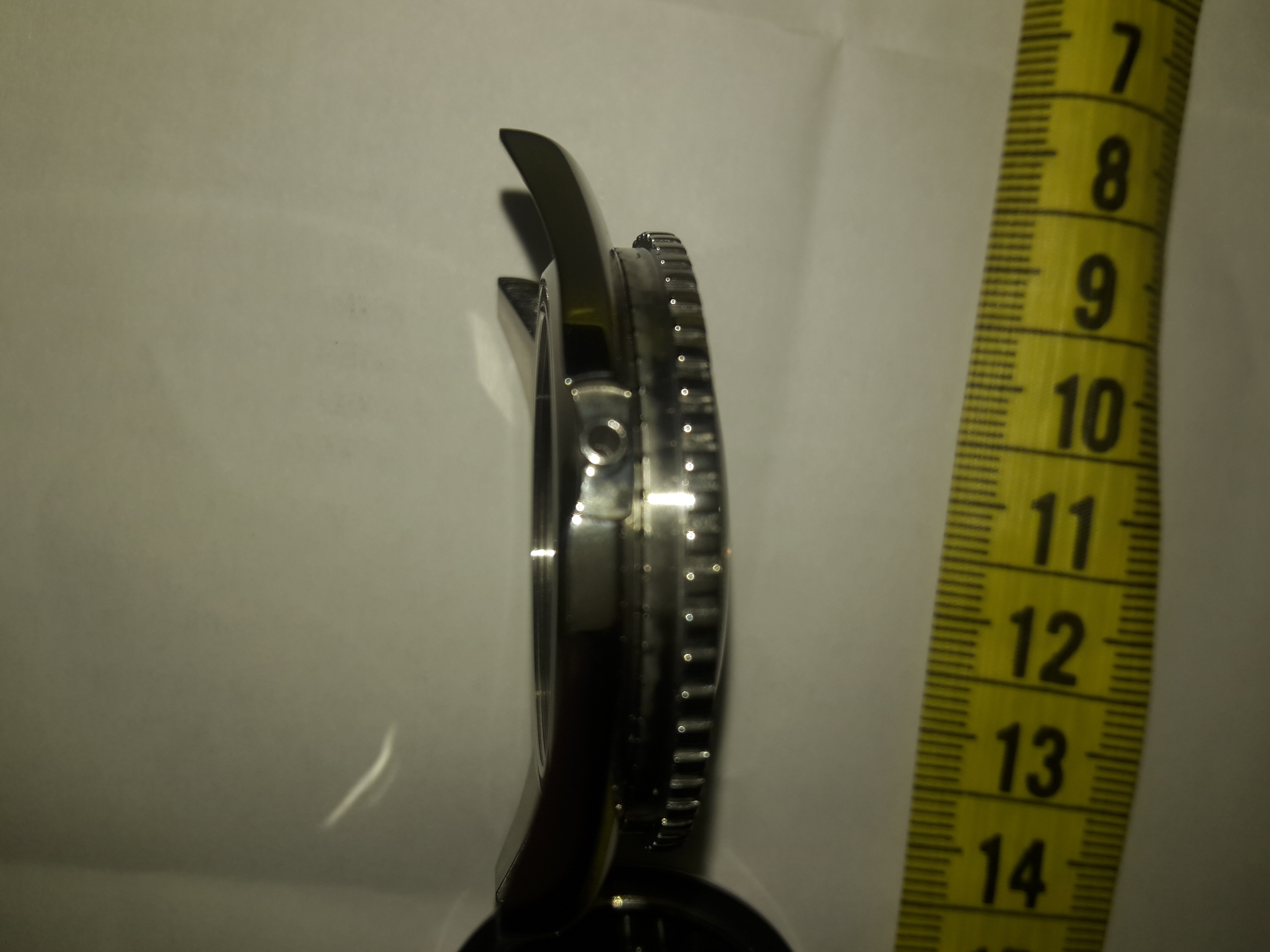

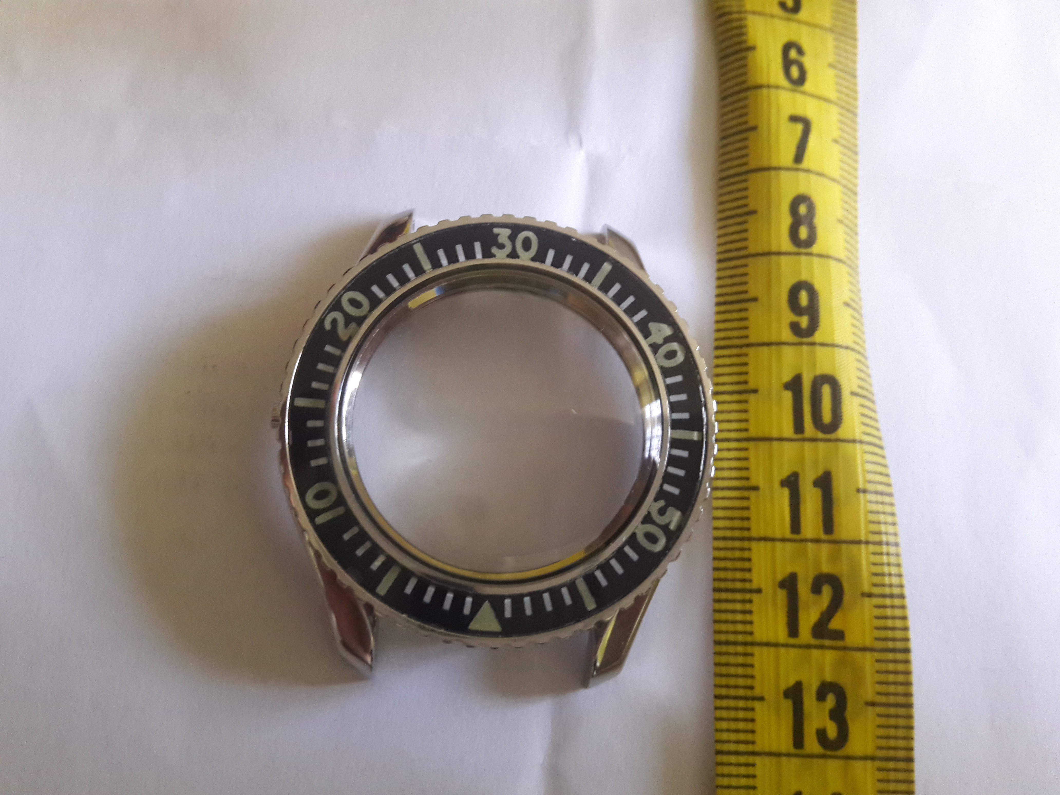

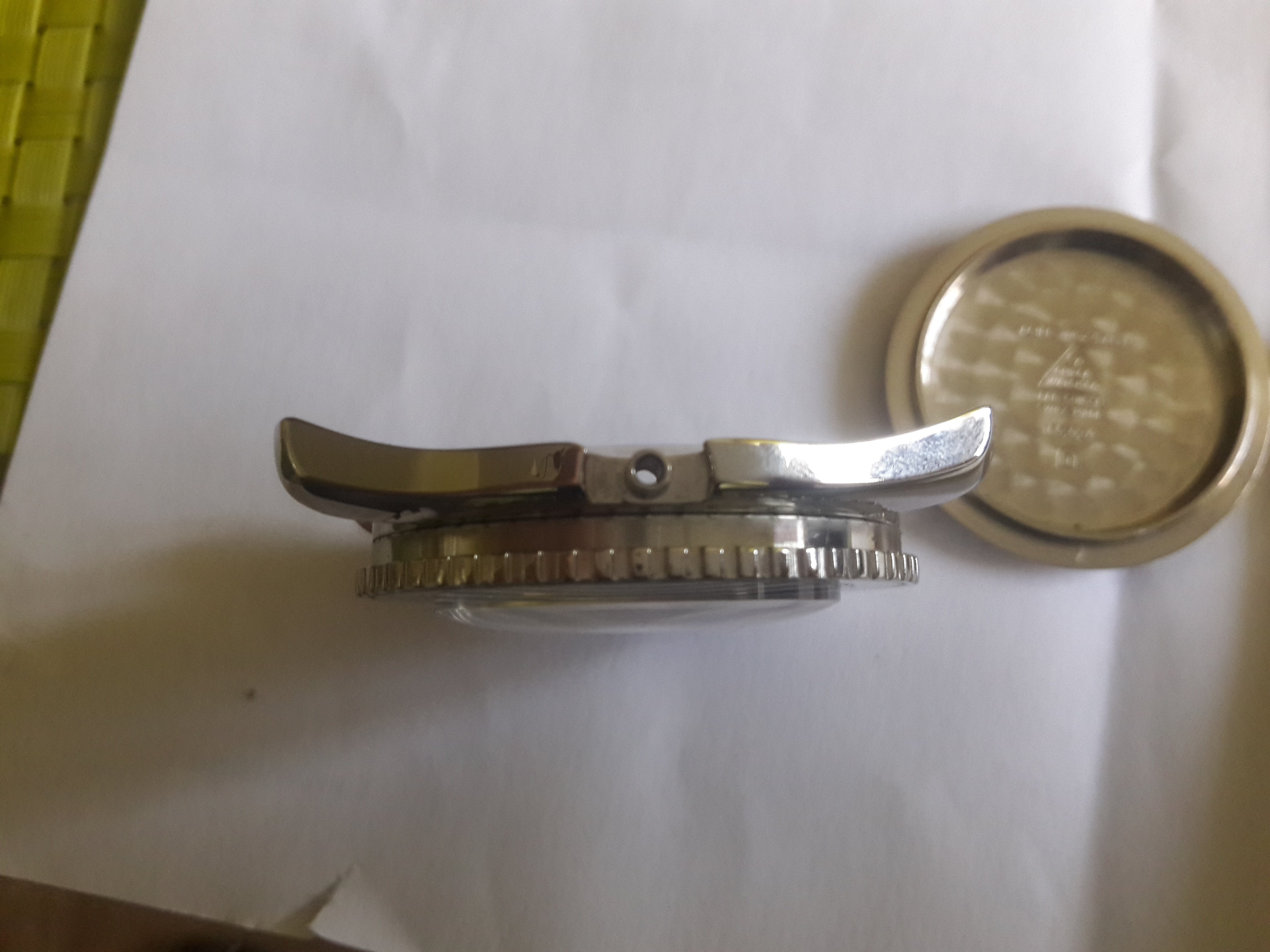

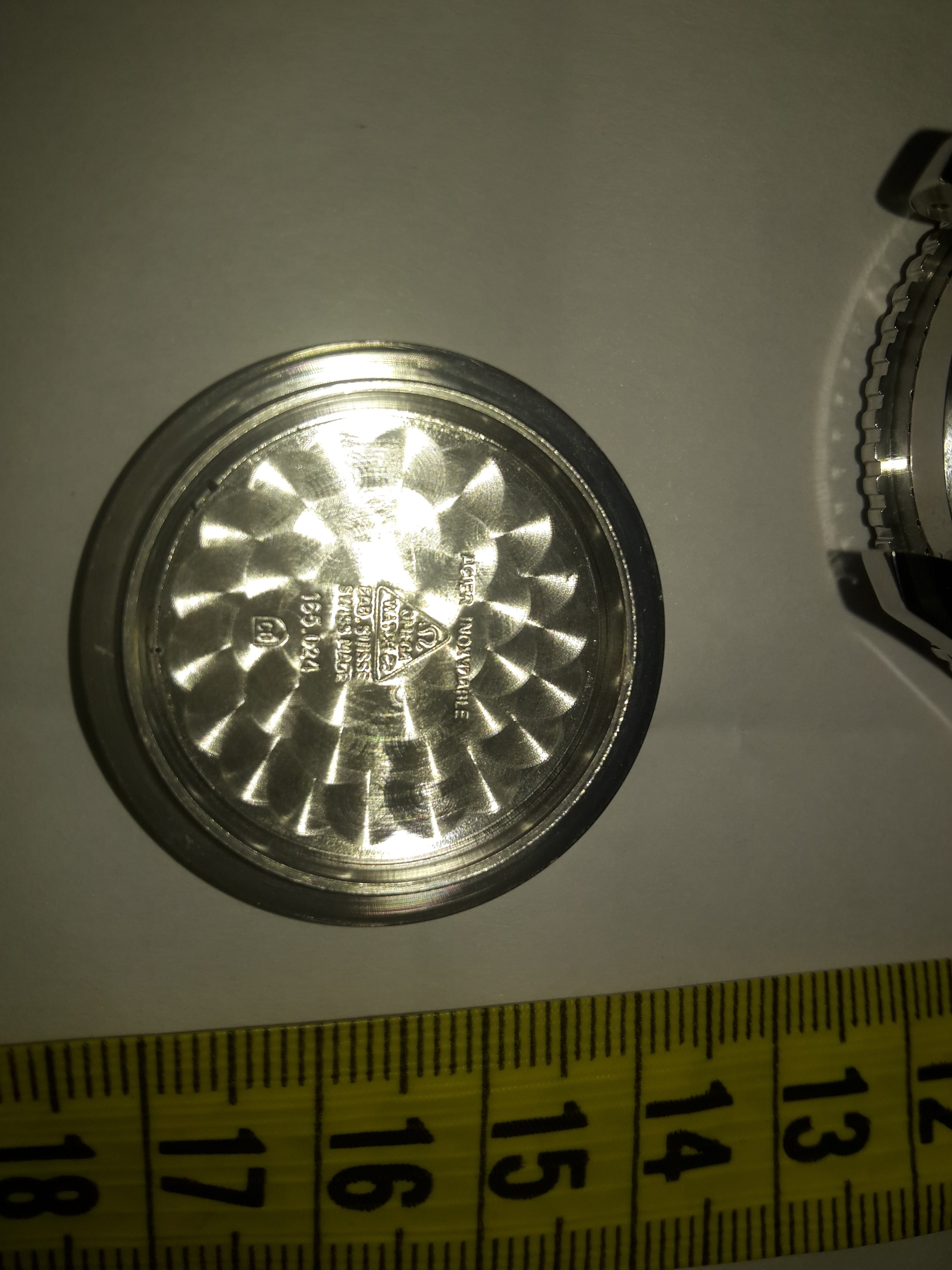

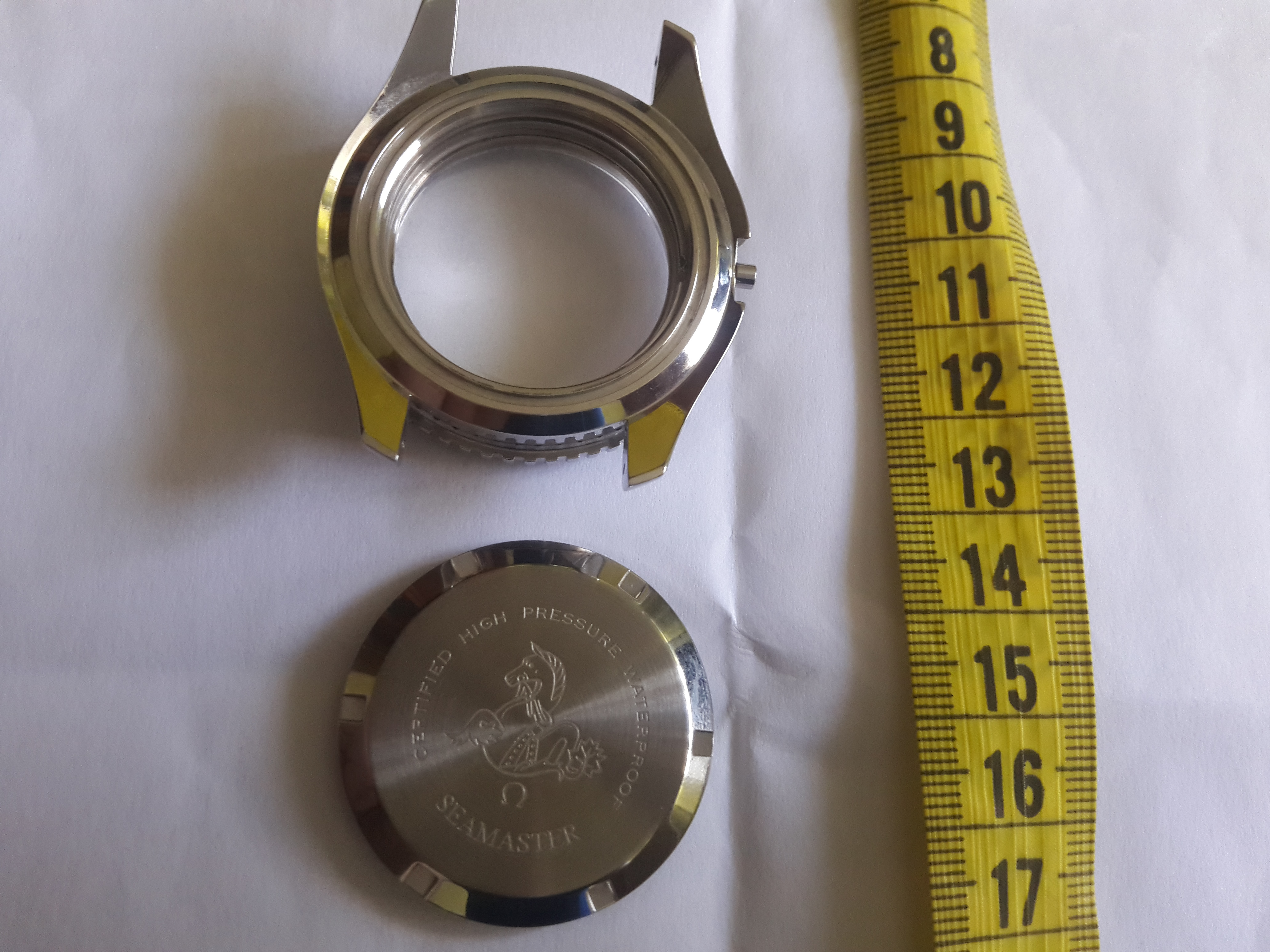

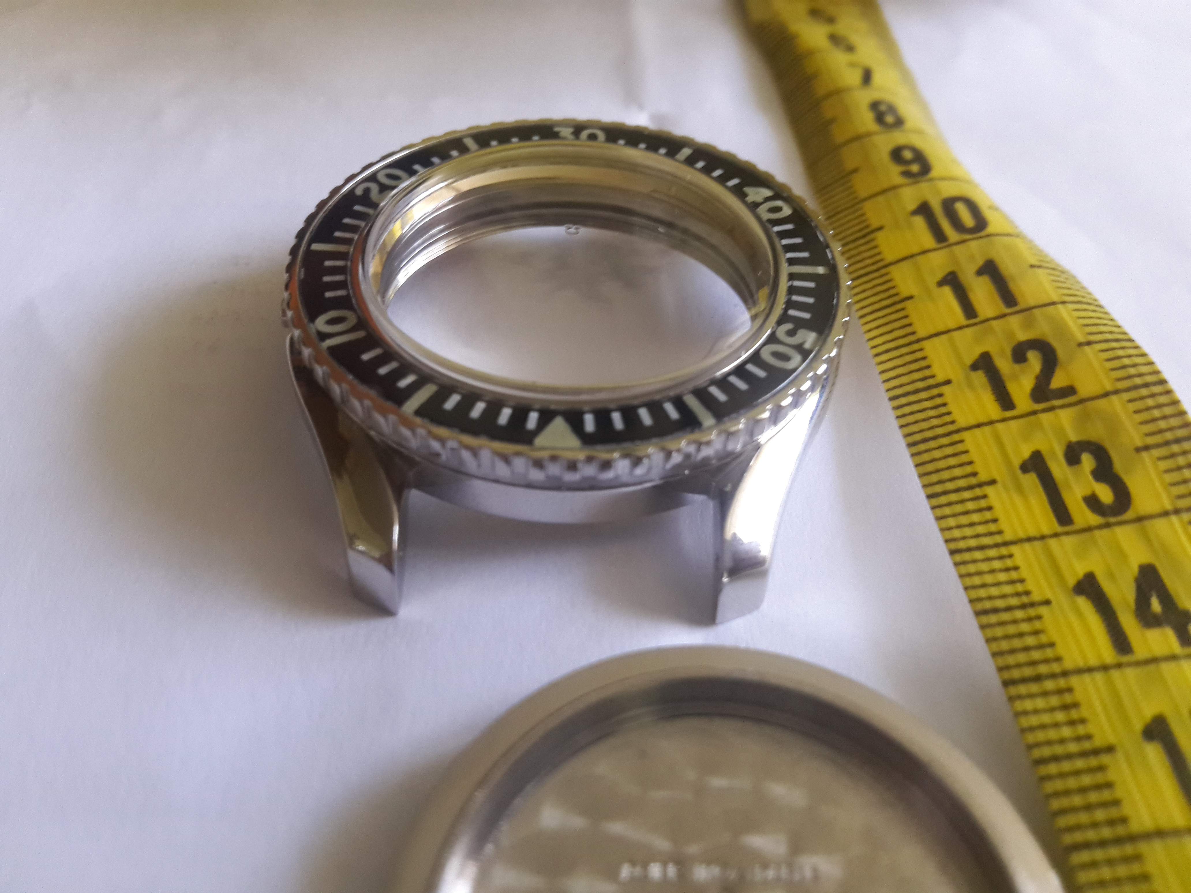

Here i found Omega Seamaster 165.024 case and wondering is it real.
Have suspicion about bezel. It not glows in the dark and looks strange.

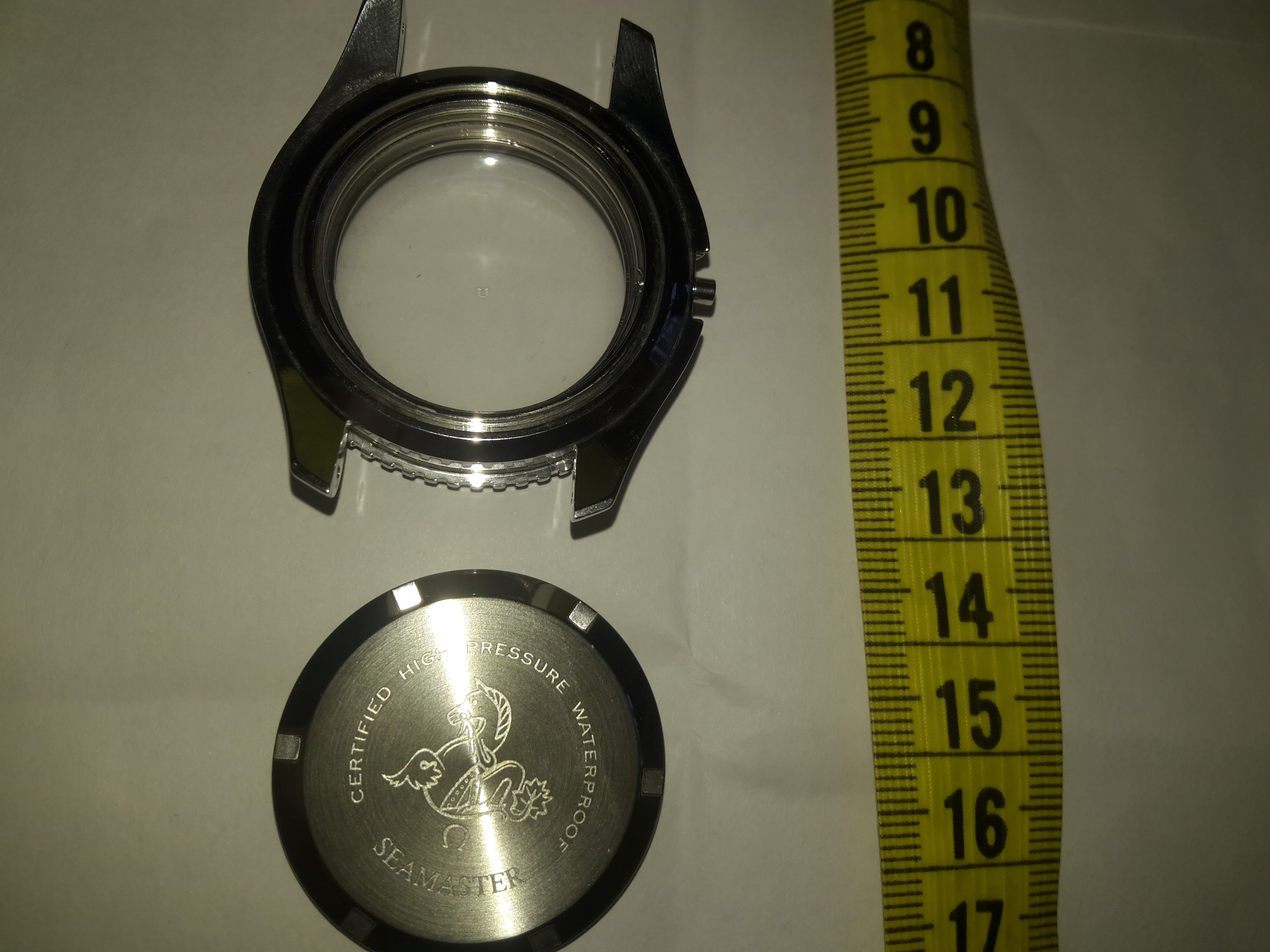

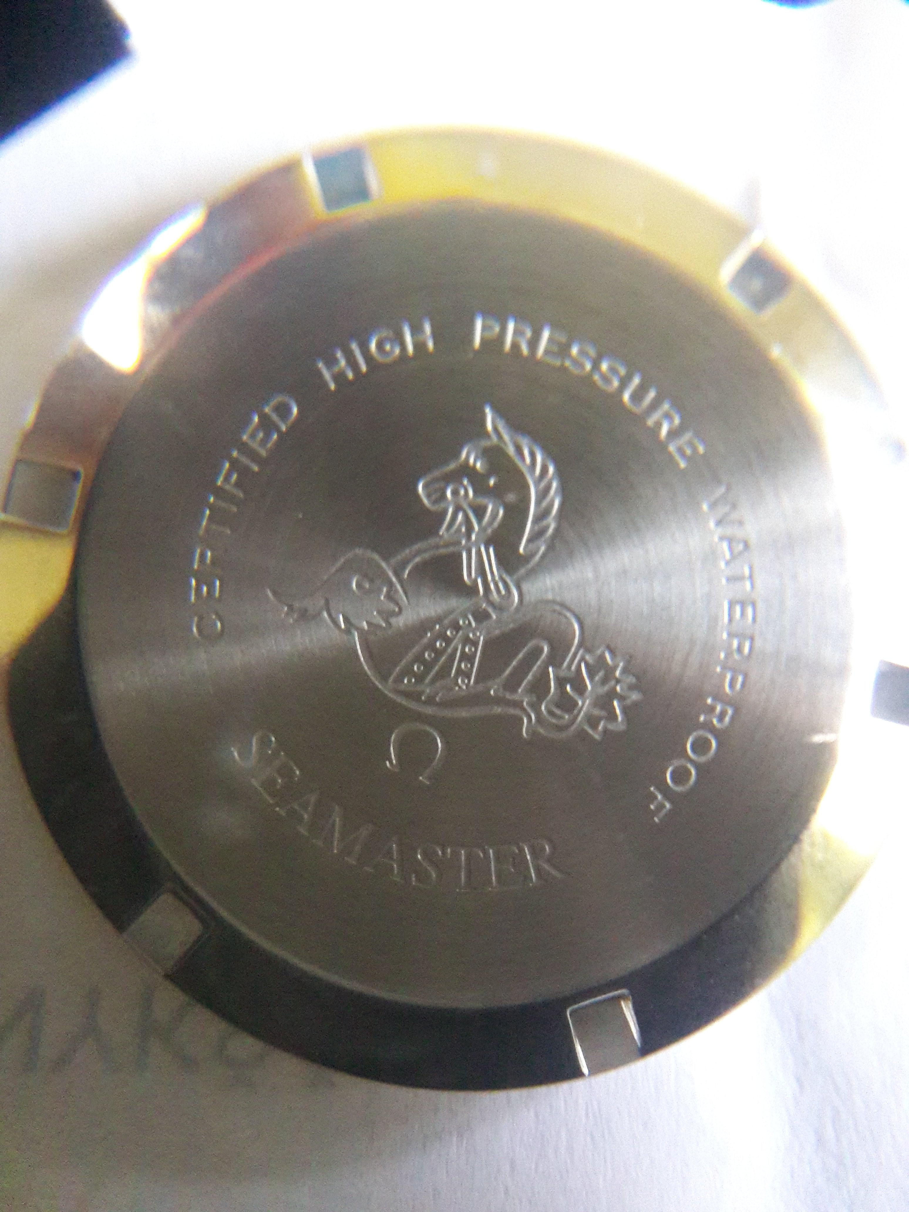

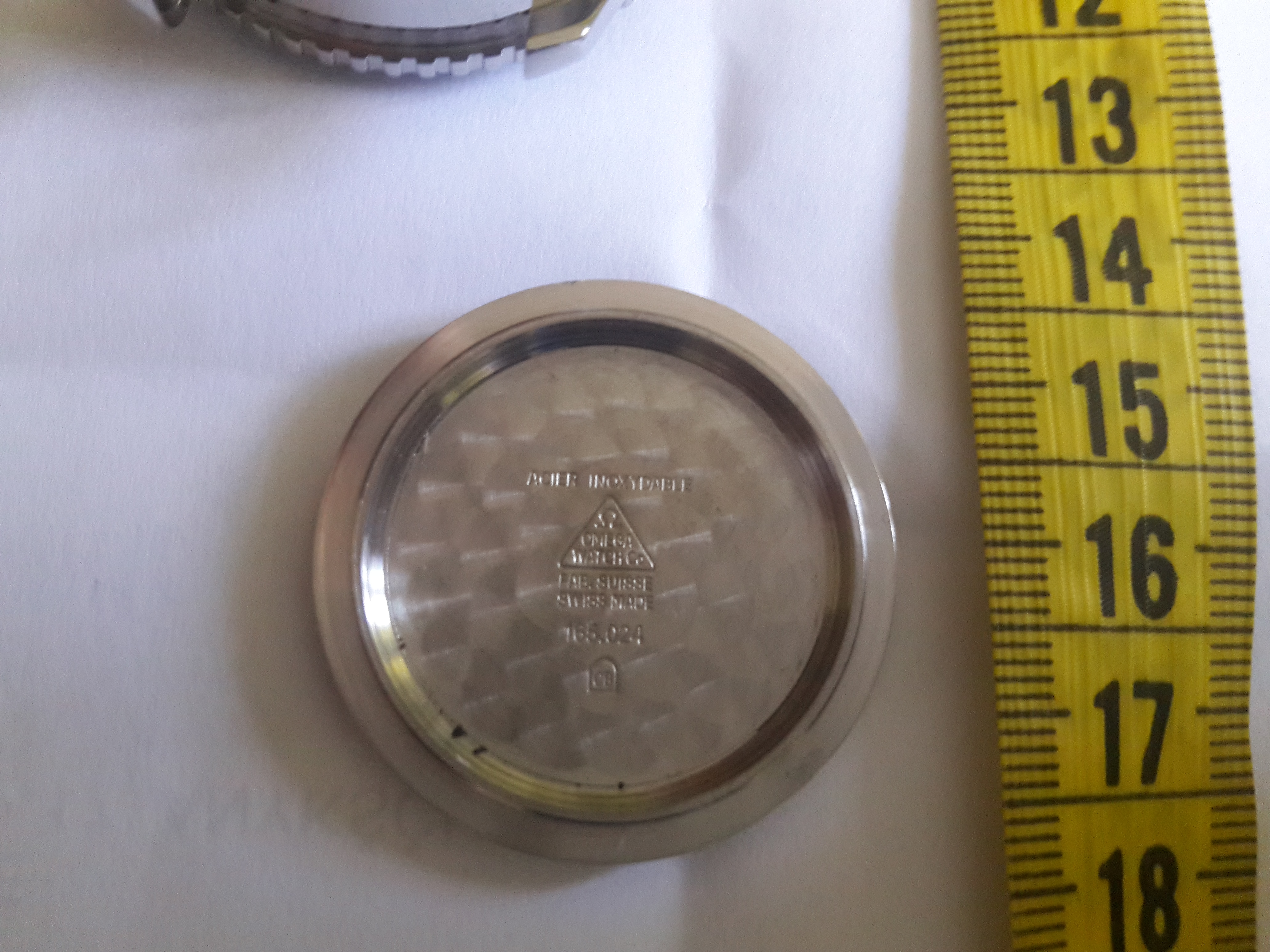

Added also case back cover photos.
Please advice me if it real or if all parts fake.
Any advice on how to remove bezel ??

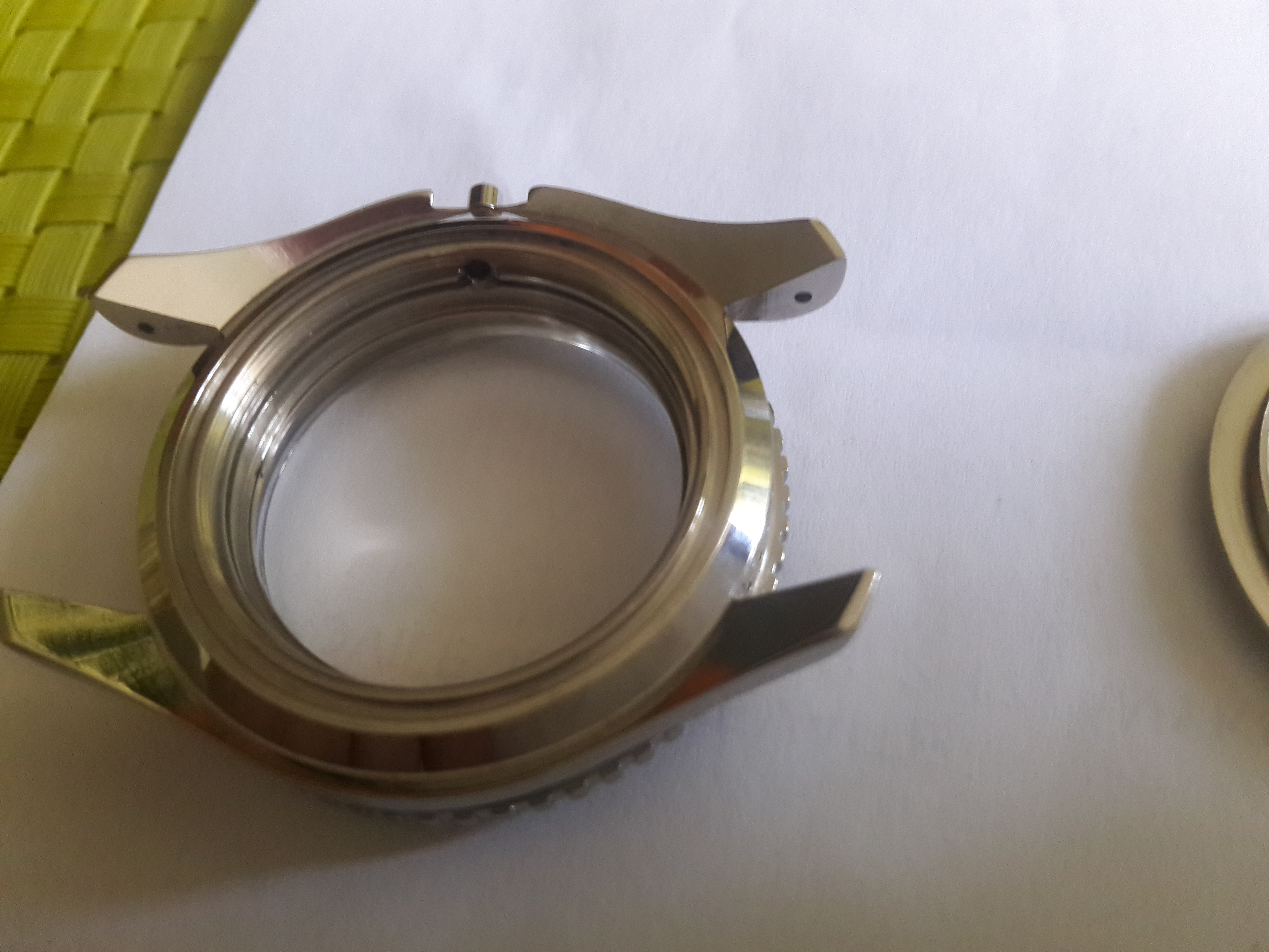

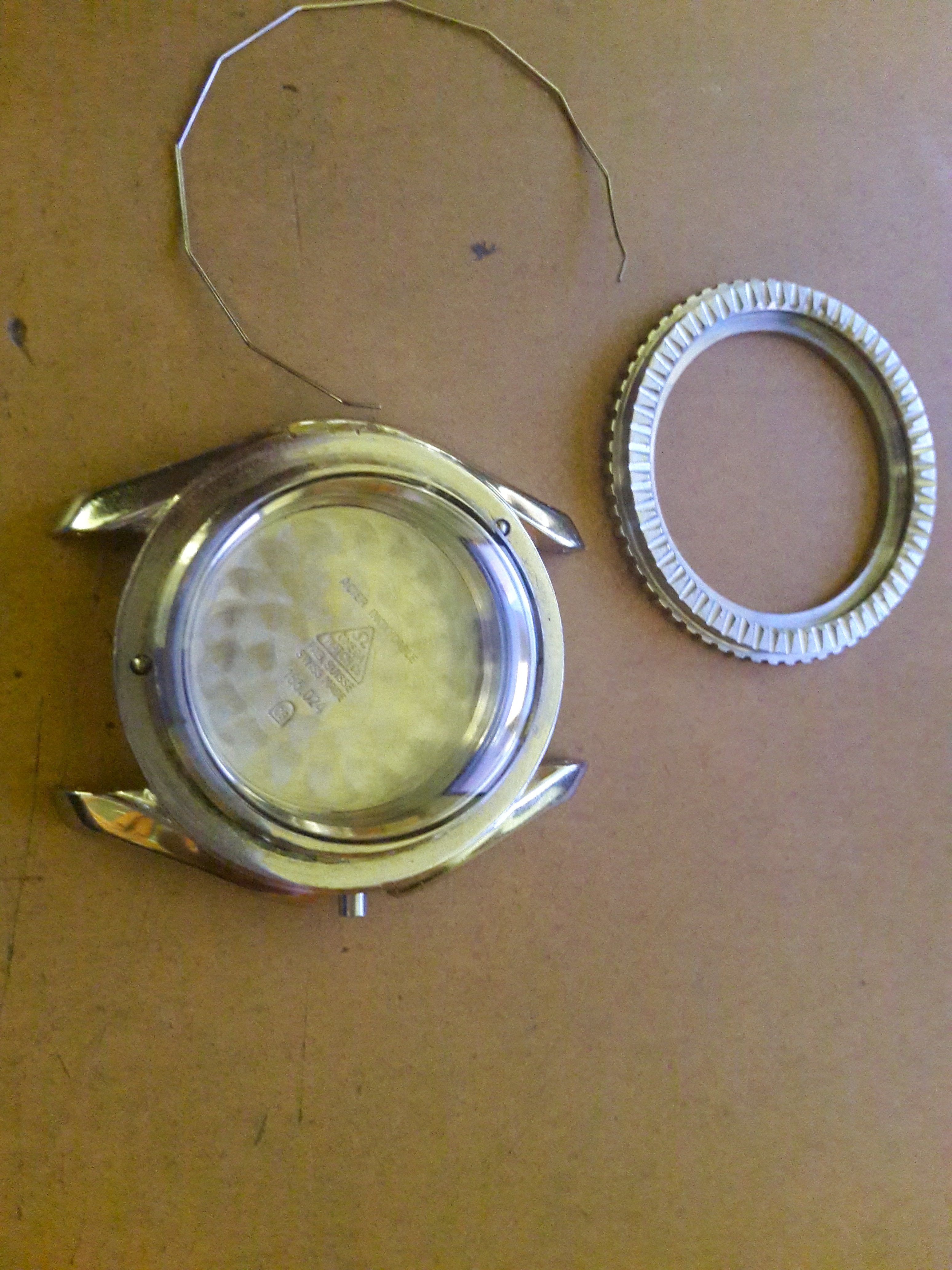

To the best of my knowledge, there are two designs for the bezel click using the spring loaded balls. The original design uses ruby 3 spheres, and the new cases (1660324) uses 3 ceramic spring loaded spheres.
Your case uses what appear to be 2 steel balls...so without doing any detailed review of anything else, that alone tells me there's likely a problem.

Yes, Watchco-s would be 165.0324, your case is 165.024 which seems like a "true vintage" case.

The design may have changed materials over time, so I can't say for certain. But I know they all used 3, not just 2 as the case you show has.

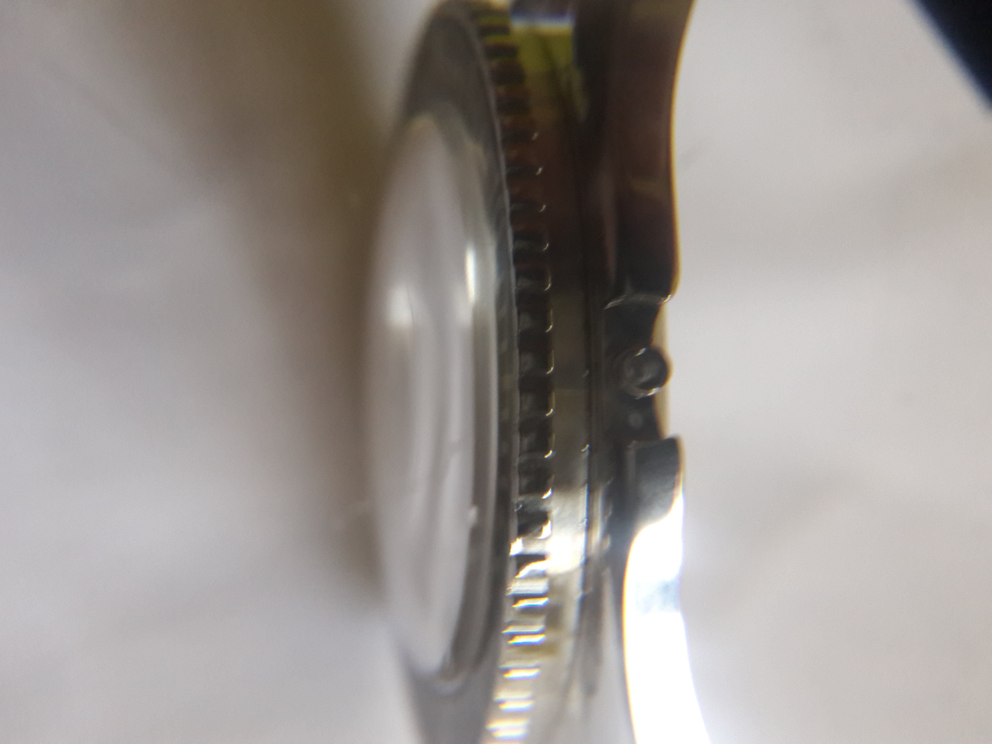

Case looks solid to me. Now i am worried about that balls. Anyone know if the 2 balls still legit ??

It’s fake. Look at the caseback. Pointy A in “WATERPROOF” is a classic sign for a fake. Only 2 balls for the bezel instead of 3.

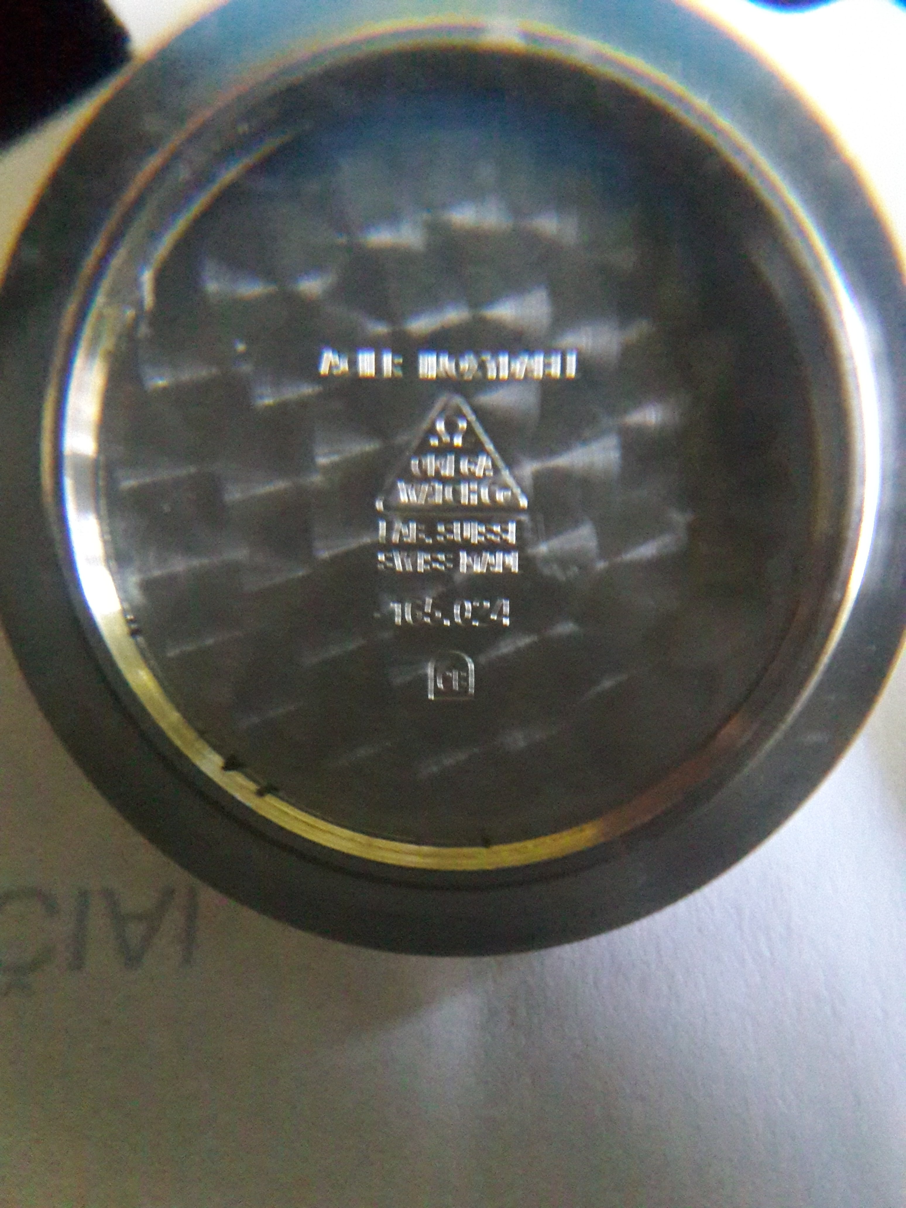

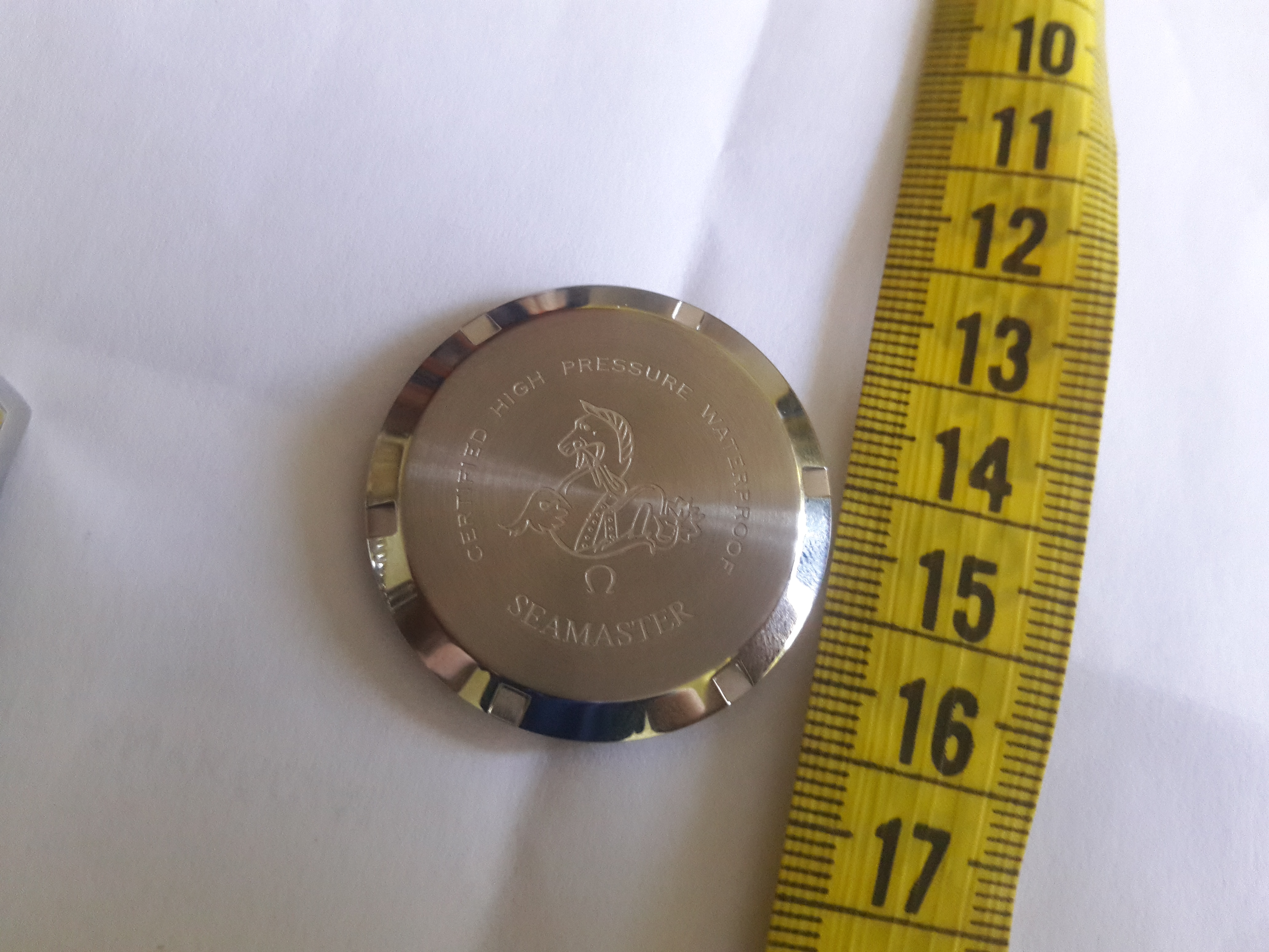

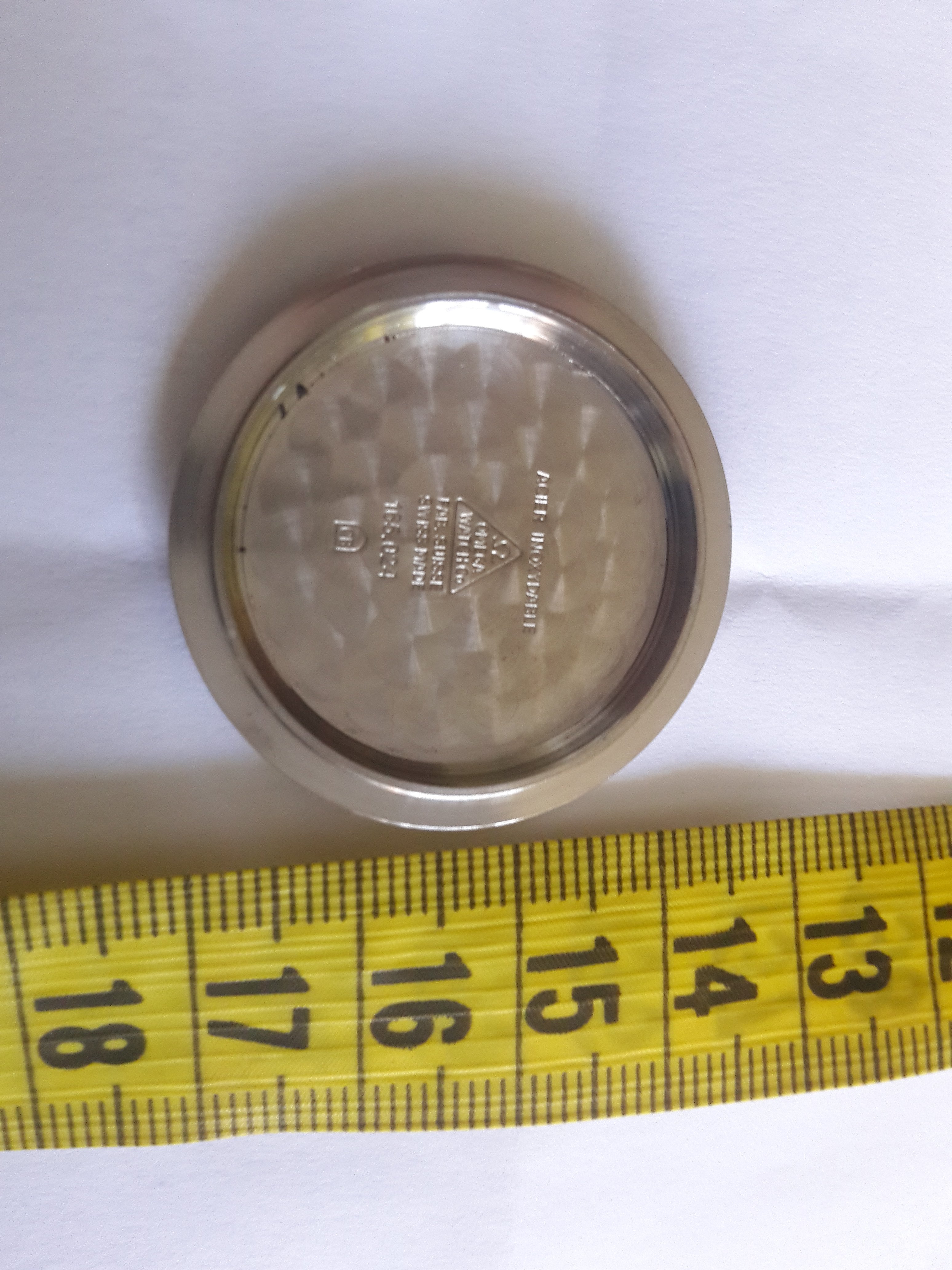

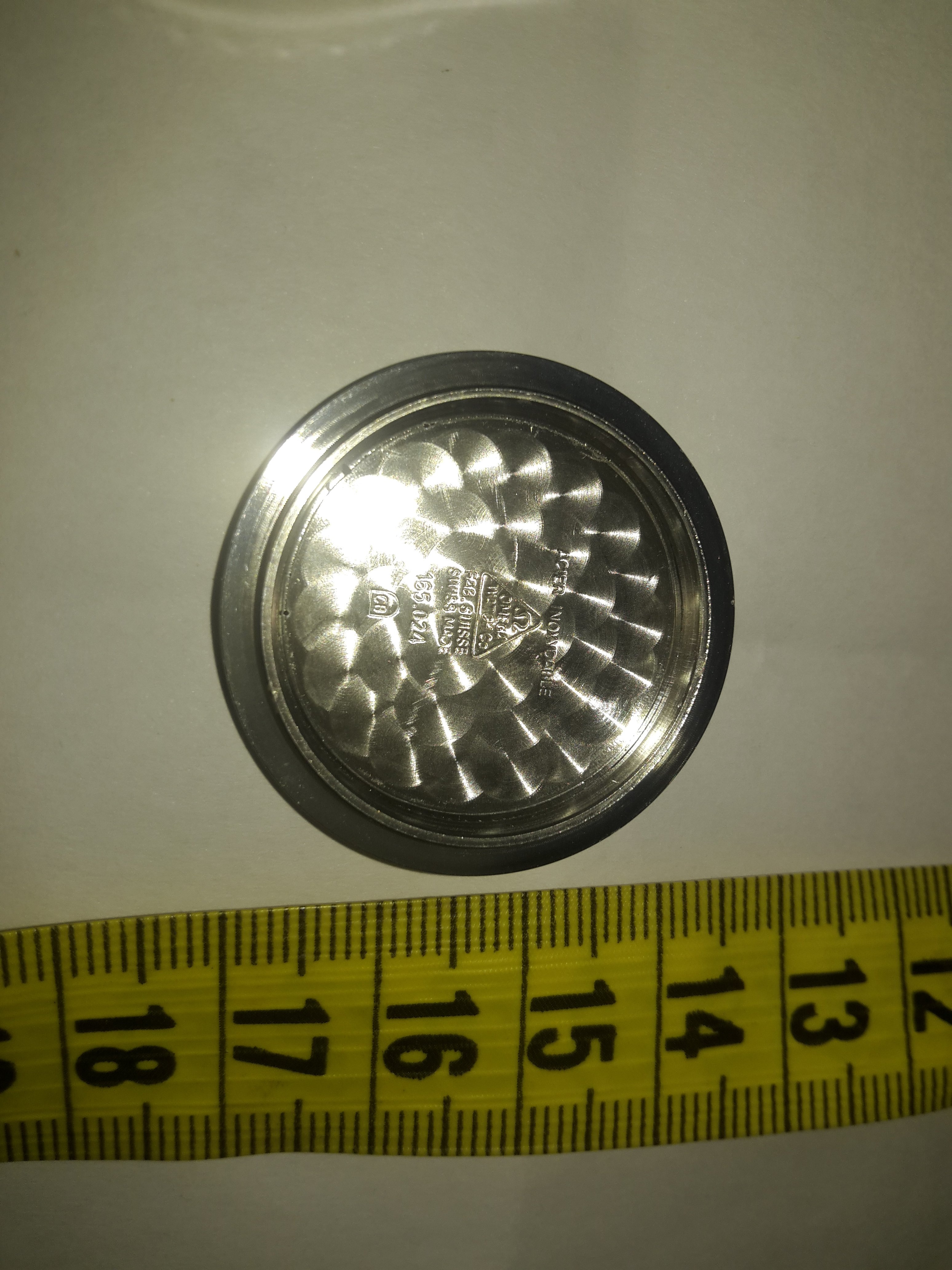

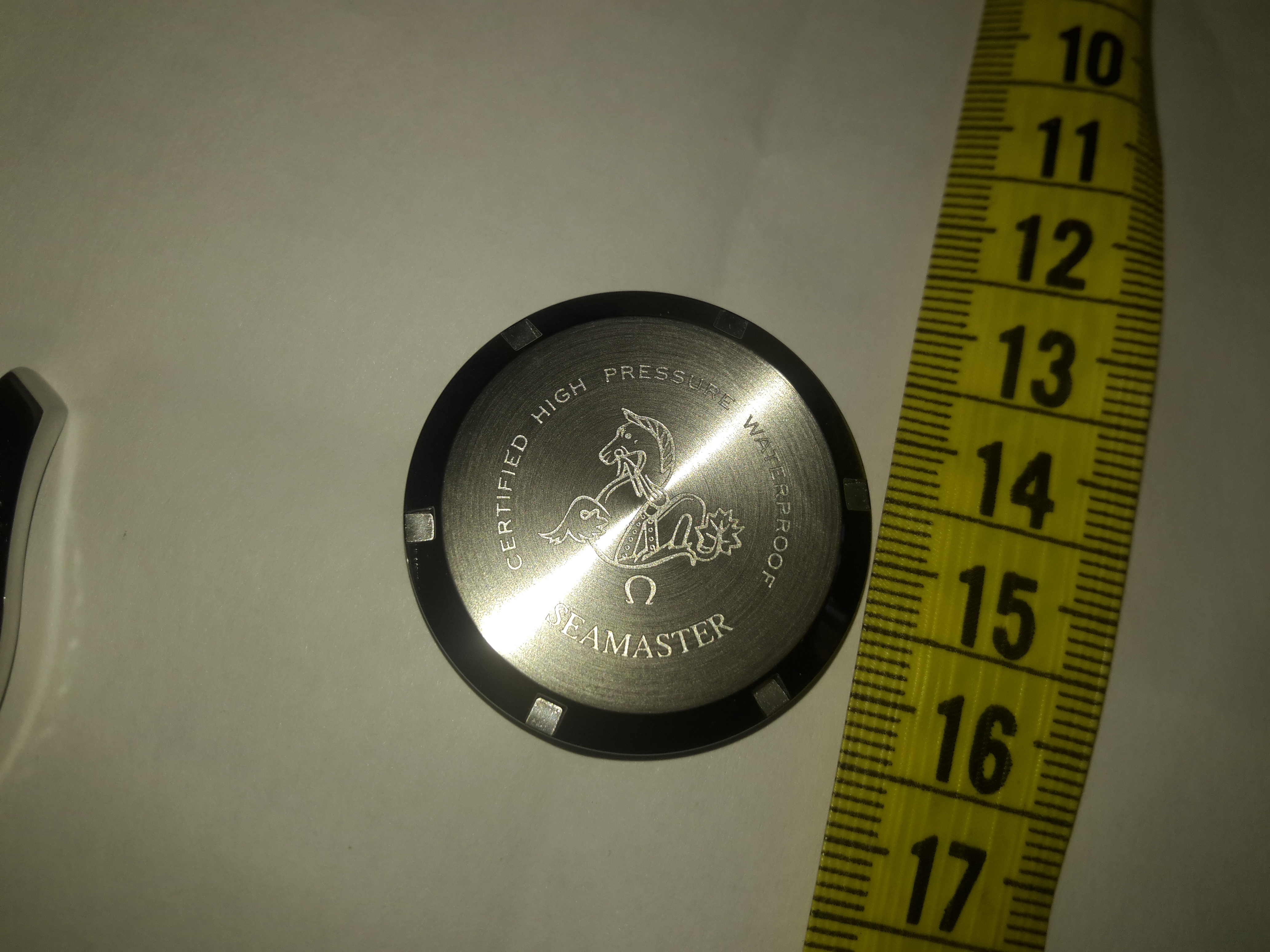

Well you might be right about balls. Added more clear caseback picture. My old wrecked case had 3 balls so i agree. Will keep looking on case then. Few years passed and been unable to find proper case yet. Thats damn rare for shure.

Case back looks etched not stamped as it would be on an original of this reference.

This is a horrible example of fake CB case. everything is wrong, bezel, case. caseback... there were never steel ball bearings on SM300 cases, only 3 pieces of ruby on vintage and ceramic on service cases. Bezel has wrong grooves machined for the bearings, wrong bezel spring, bezel insert is terrible bad joke with no lumi, wrong font, caseback has bad stamping on the inside, big slots for opening tool...
The myth of sharp A as determinant of fake cases is busted, there are original Omega service casebacks with sharp A.
And as you can see here, there are also fake cases with "correct" A also....

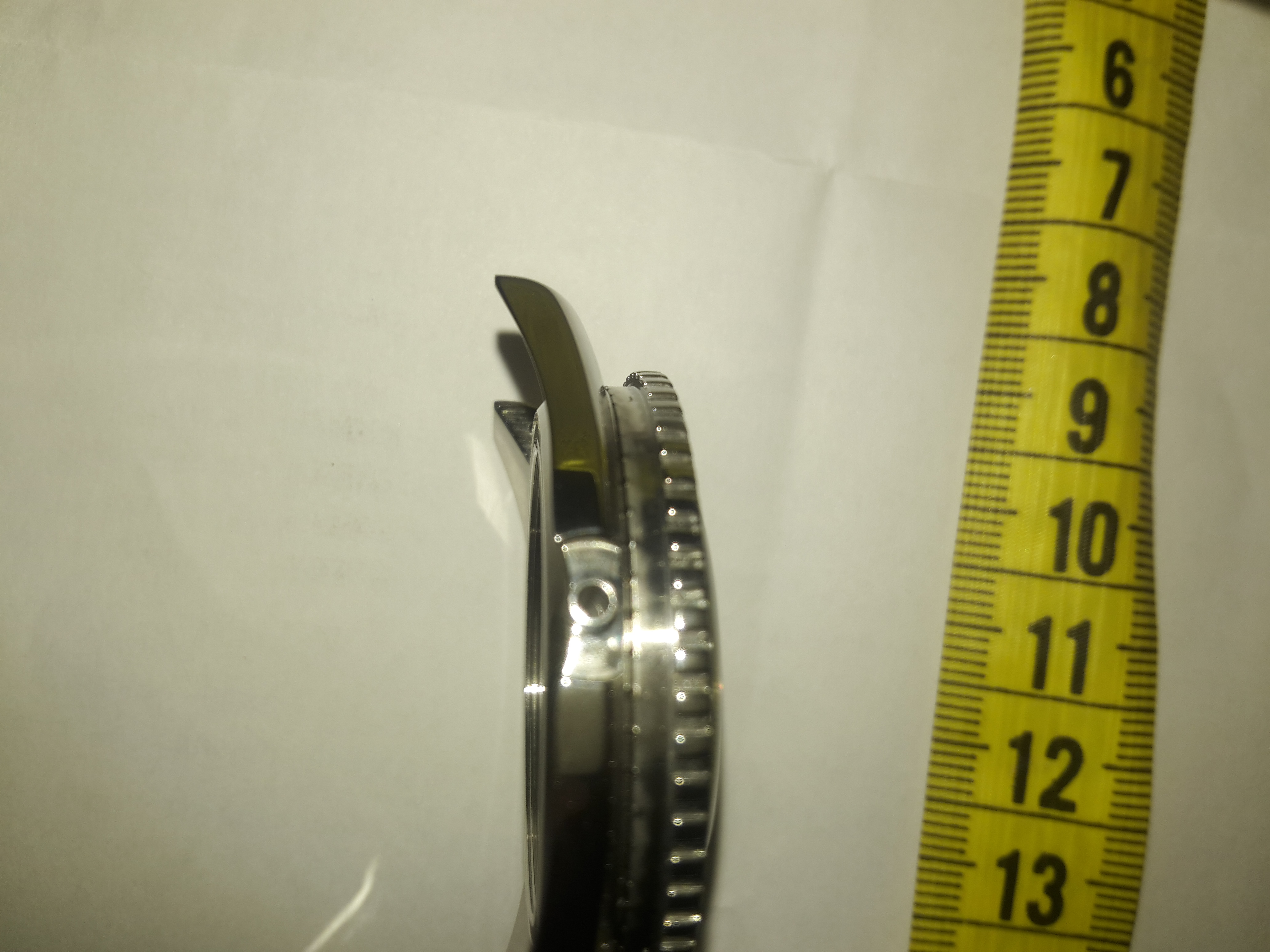

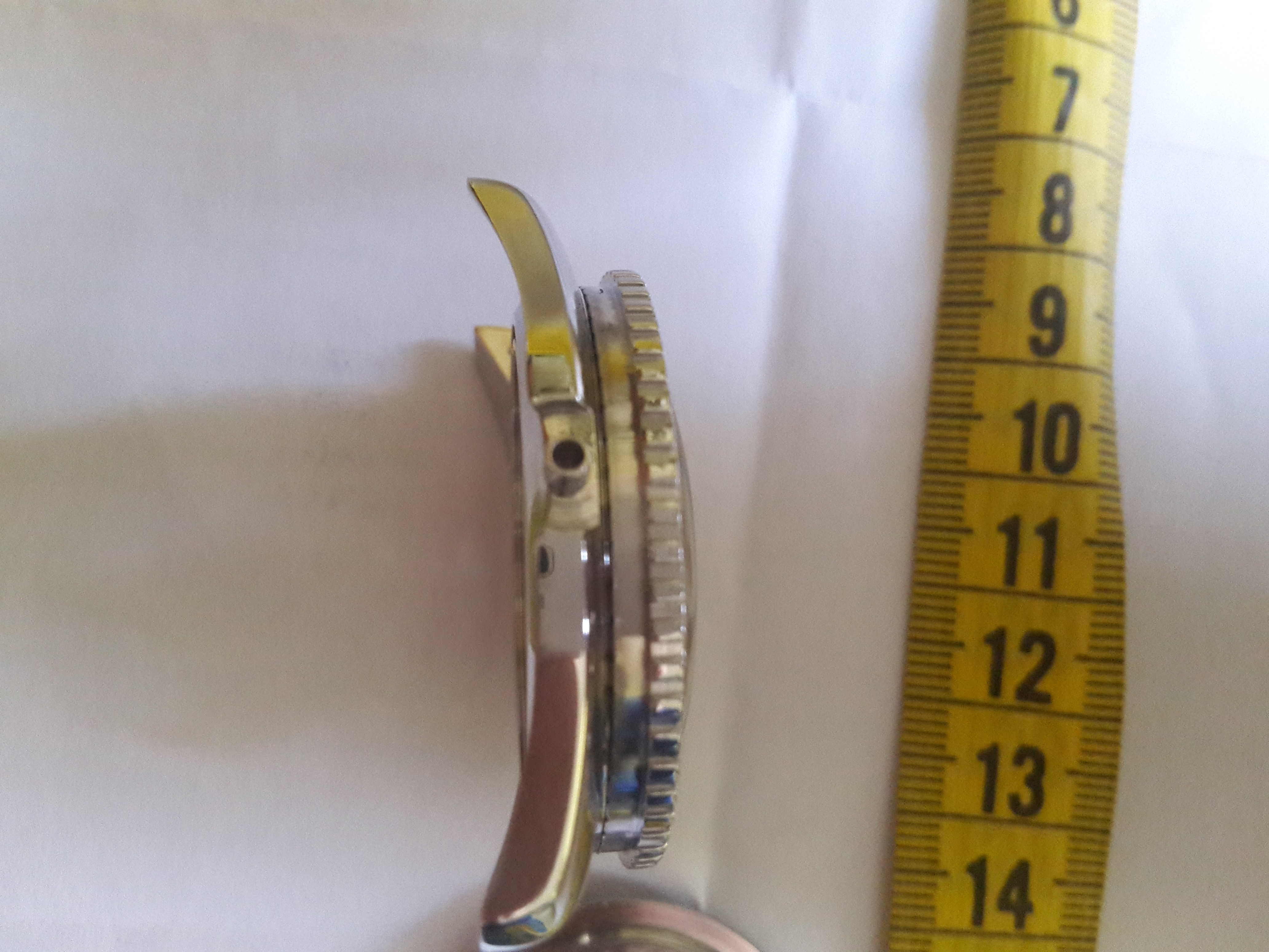

Far too late to the party but all genuine cases have 3 holes for the ruby bearings to run on for the bezel. Massive tell tale is also the side profile of the case on the 9 oclock side. The fakes have a lower edge line and lugs are no where near as open as the genuine. These cases come out Vietnam. Bezel teeth are also too big and have no chamfer on them

Here is a picture of a fake big triangle up for sale on eBay just now versus the genuine watch. Look at how more open the lugs are on the genuine watch and notice the side profile on the non crown side. The genuines side brushing metal is higher up as less metal on the fake Vietnam case. The Vietnam cases non crown side profile sits lower. Look at the 2 on the insert of the gen and fake and how much wider open the lugs are on the genuine watch. Teeth are also crazy sharp on fake. Dial on fake will likely just have been aged with tamiya weathering kit, matt clear coat and coffee. A lot of the sellers of the fakes often hide the side profile
