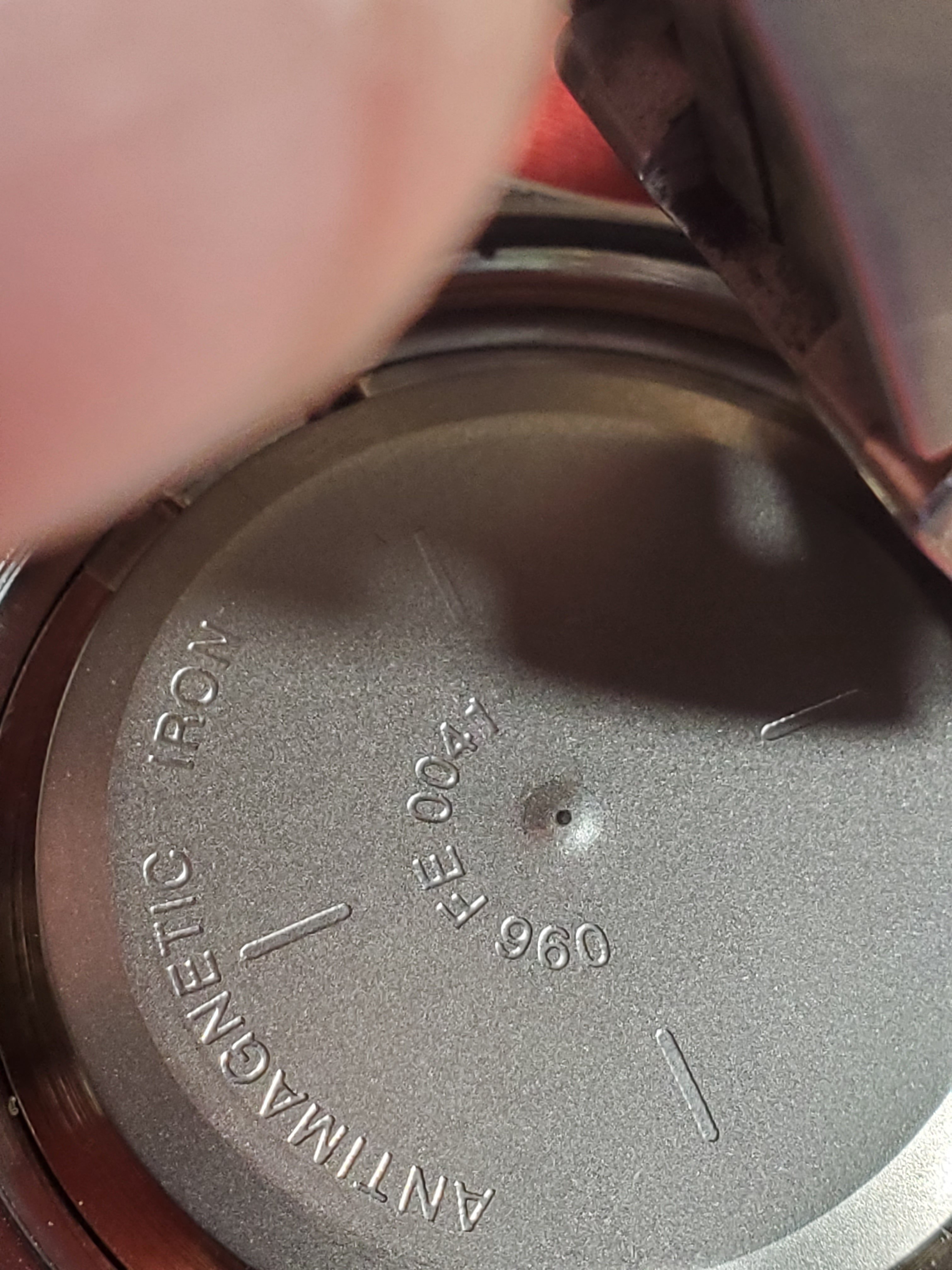

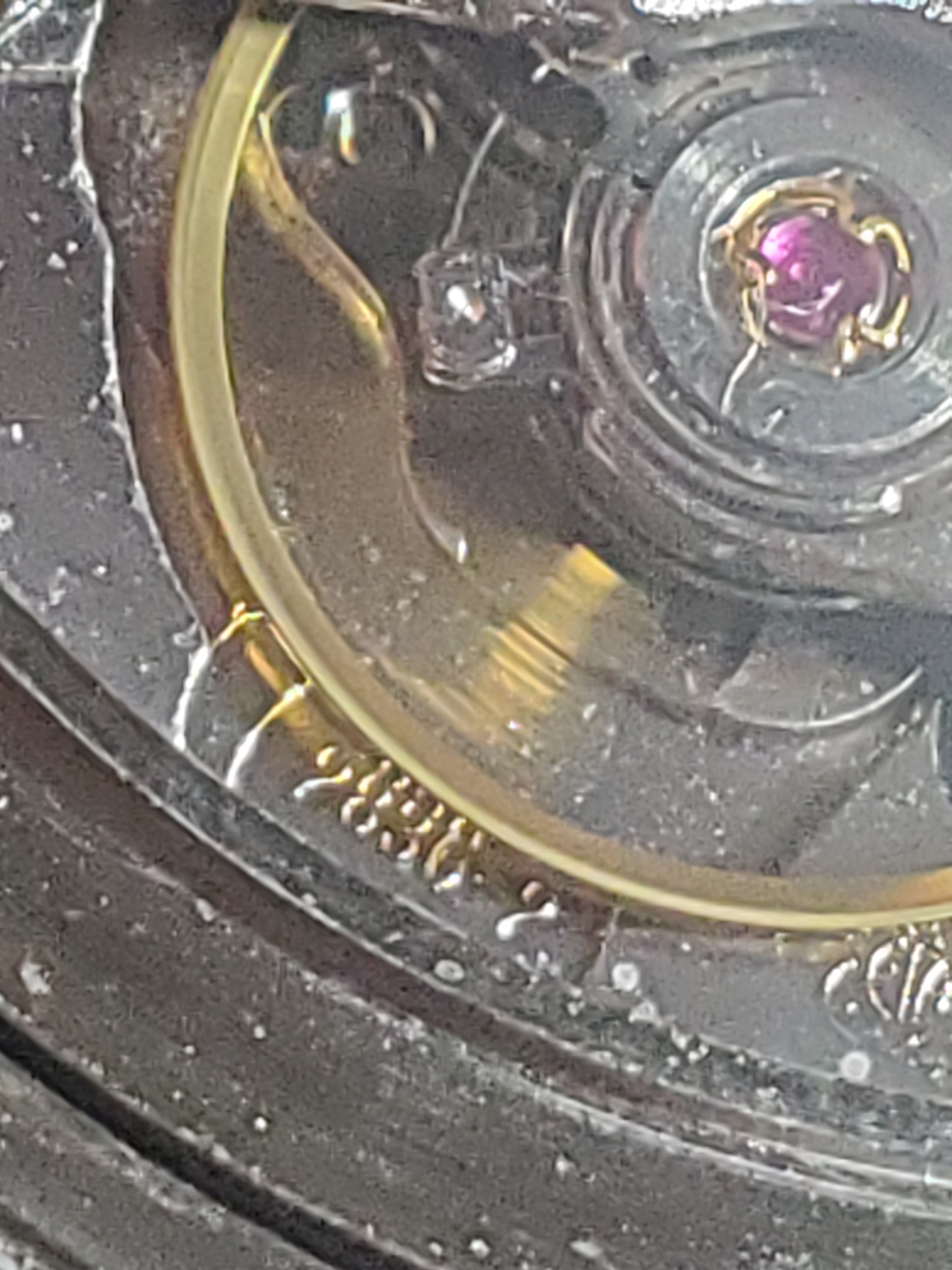

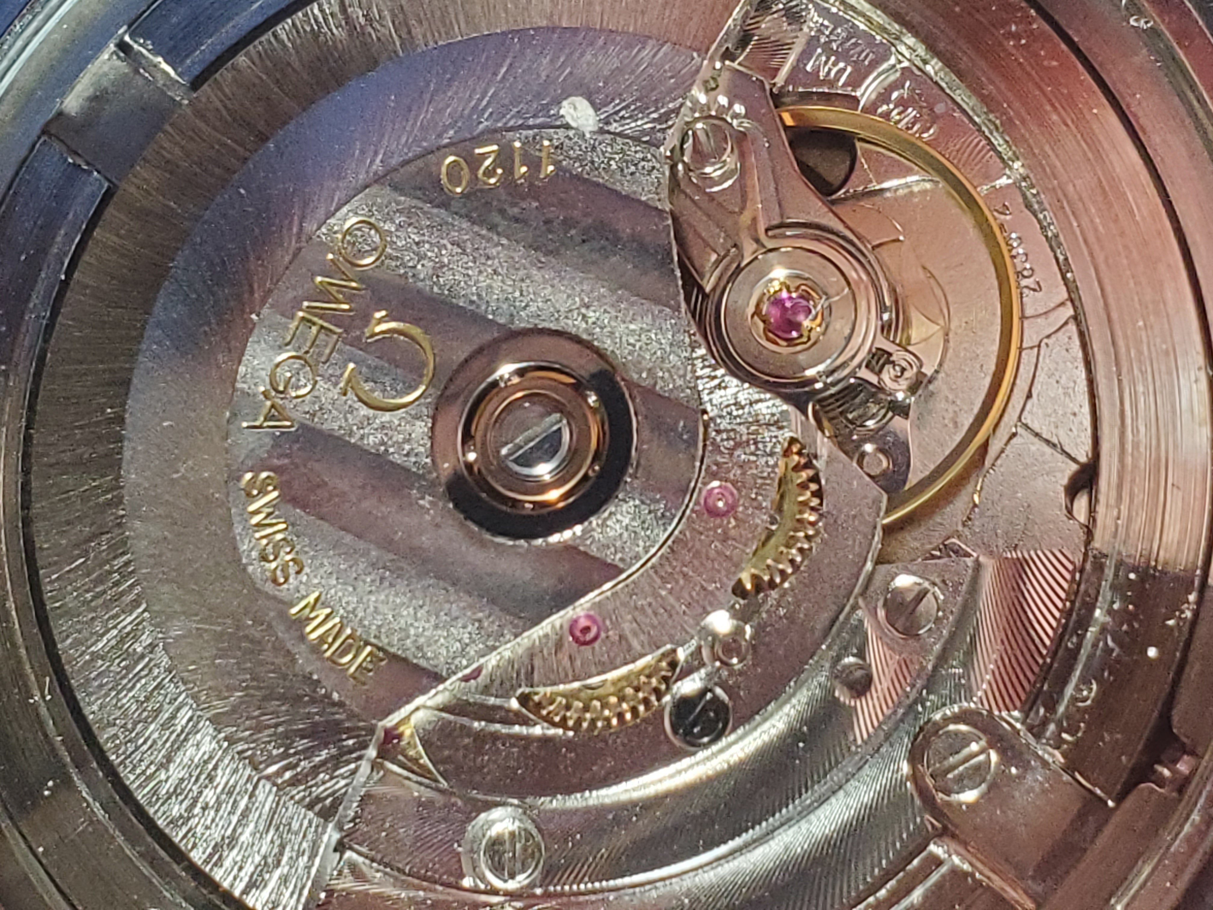

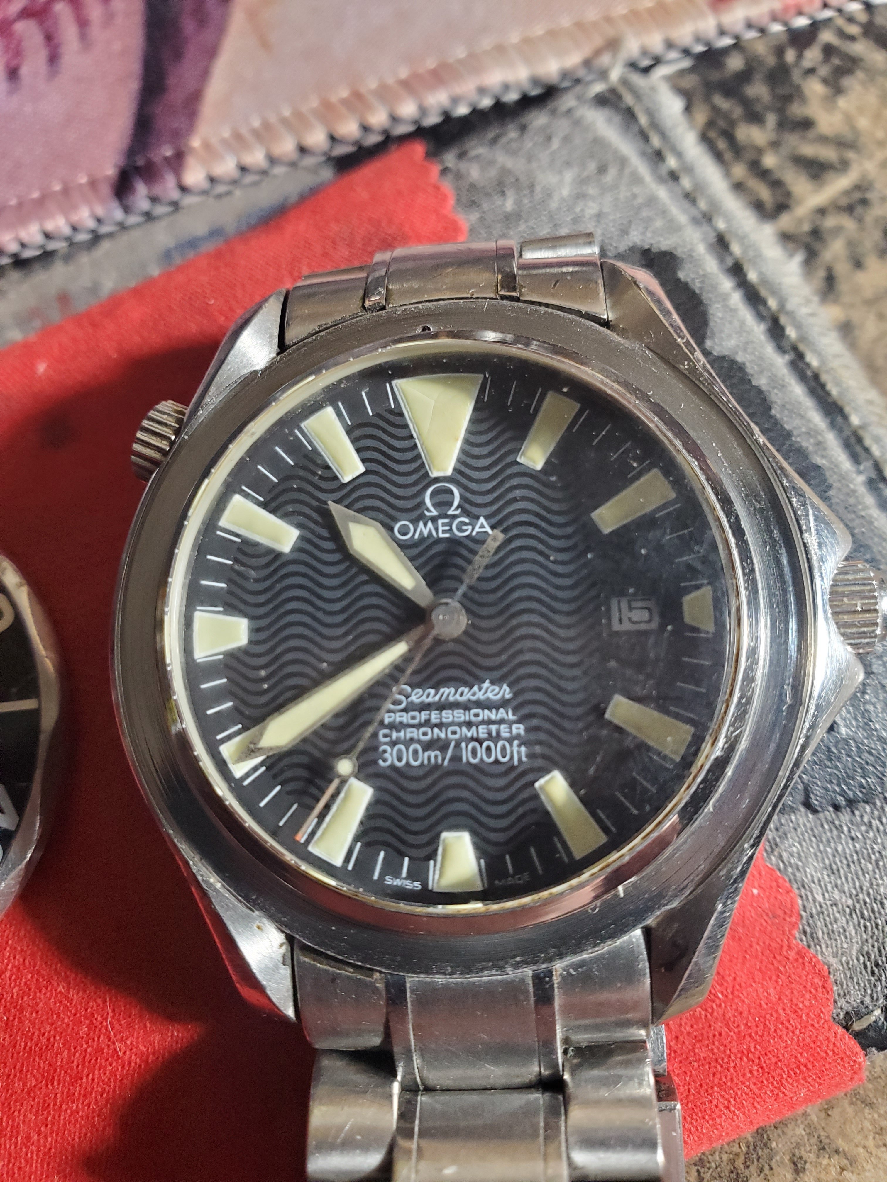

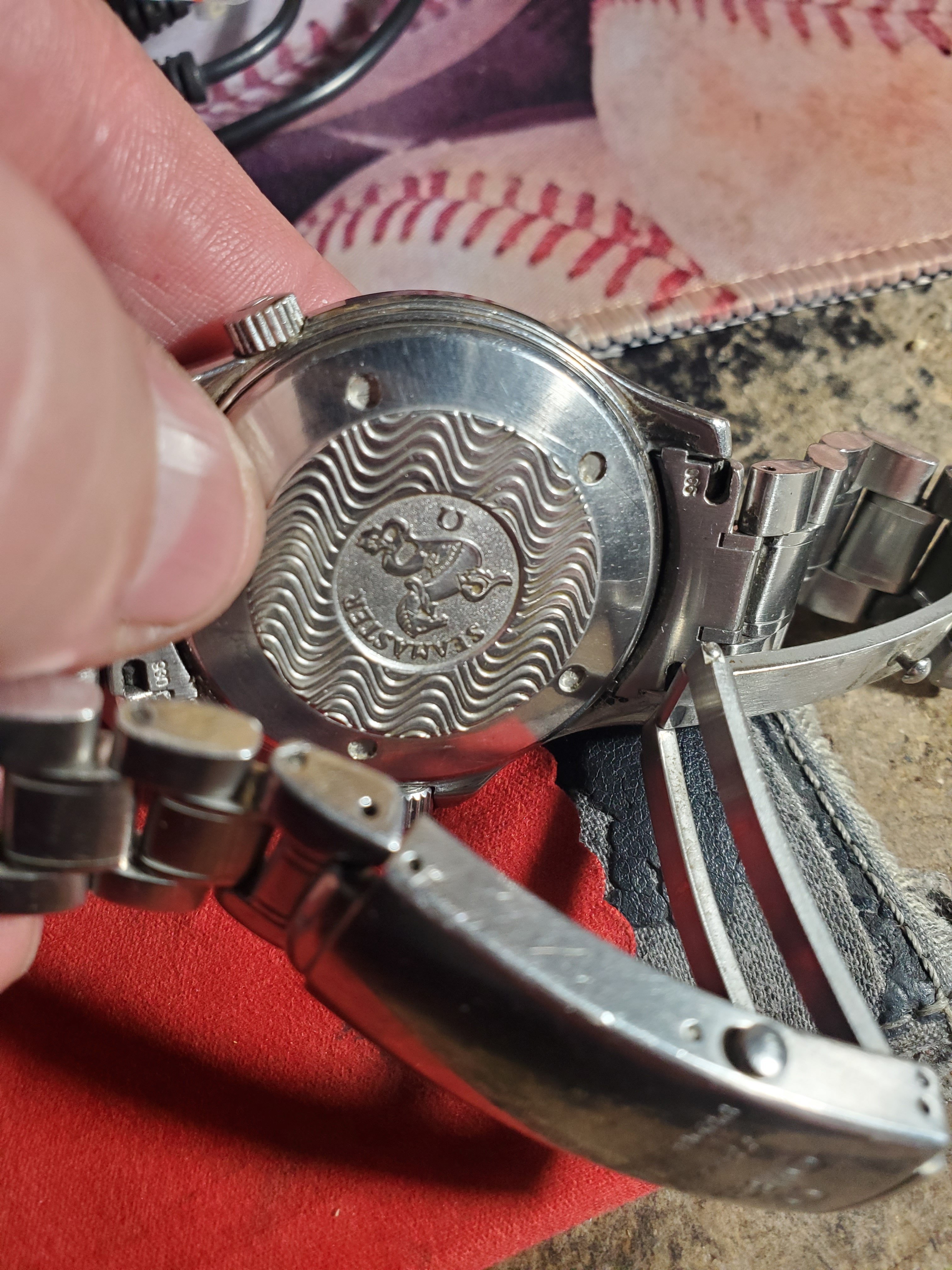

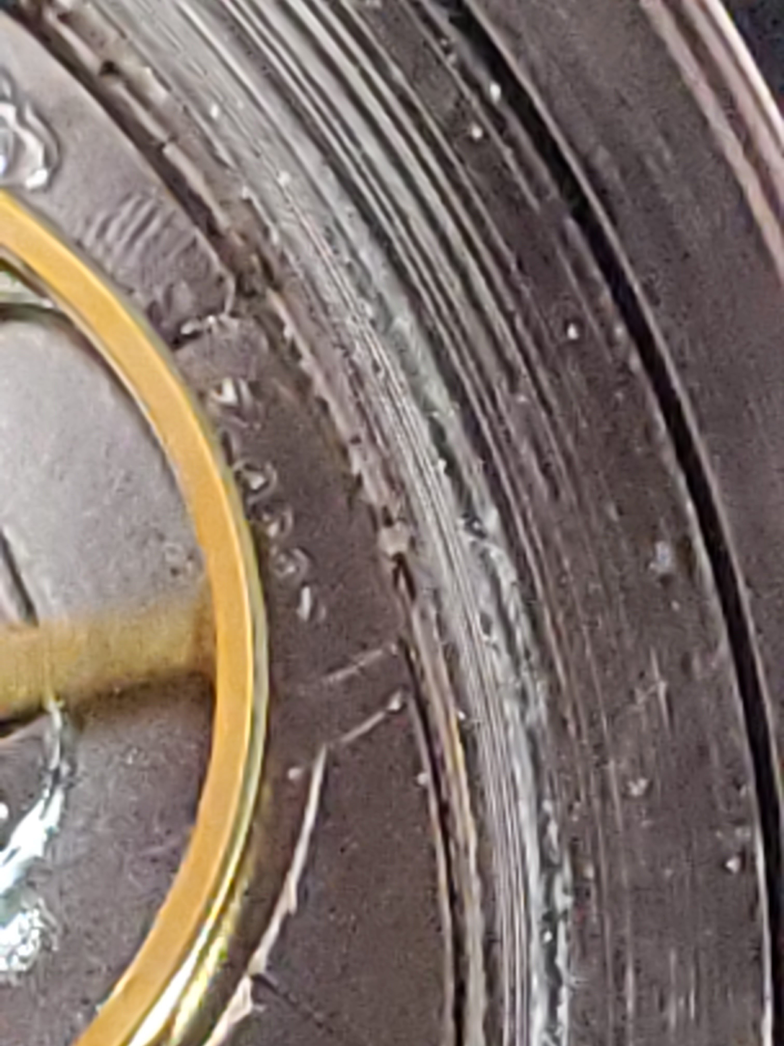

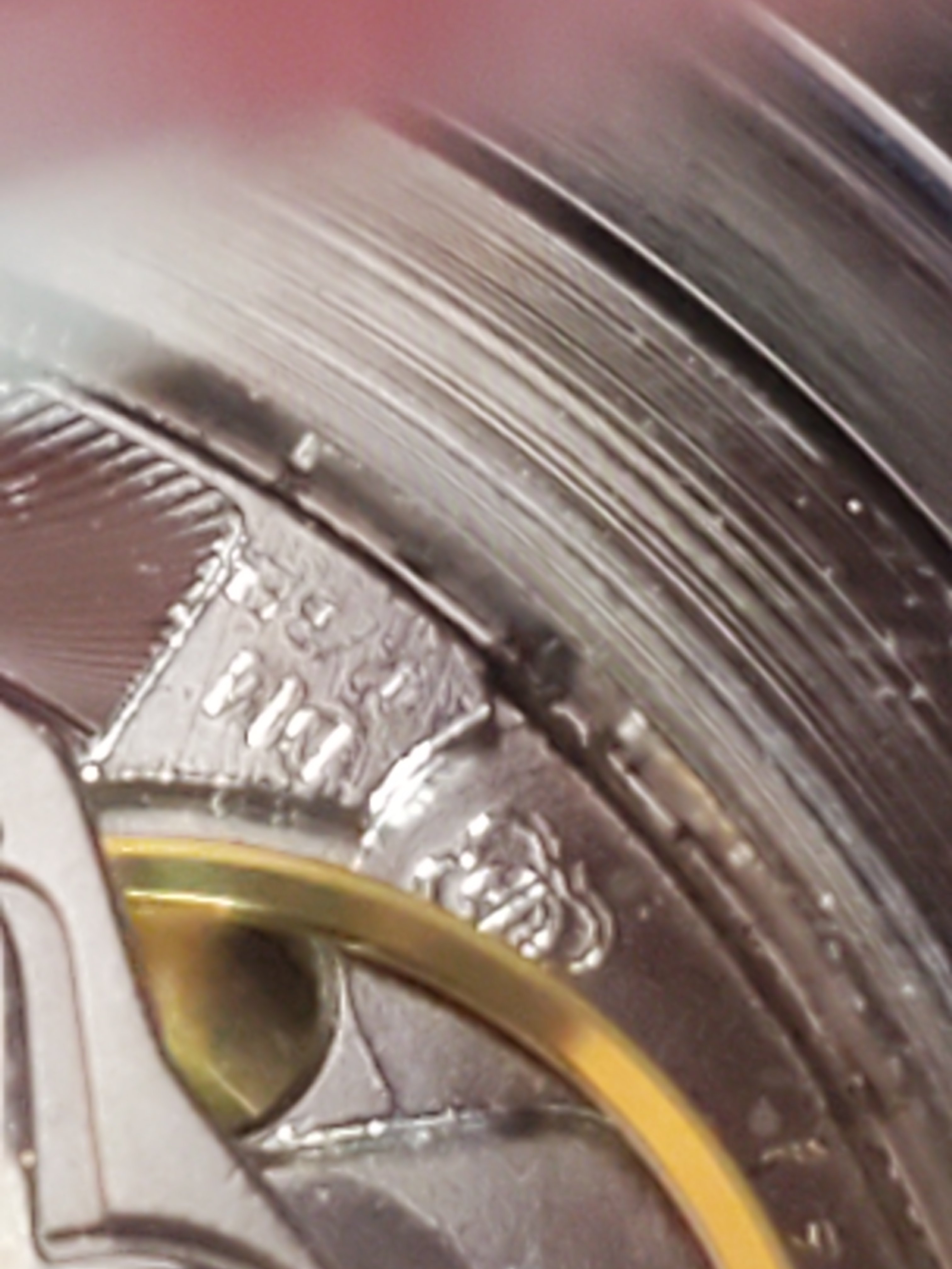

Picked this up at an estate sale it was mixed in a bunch of other watches, can you tell me if its authentic or maybe some replacement parts? Movement marked 2836 2 Rotor has Omega 1120 swiss made on it as shown.

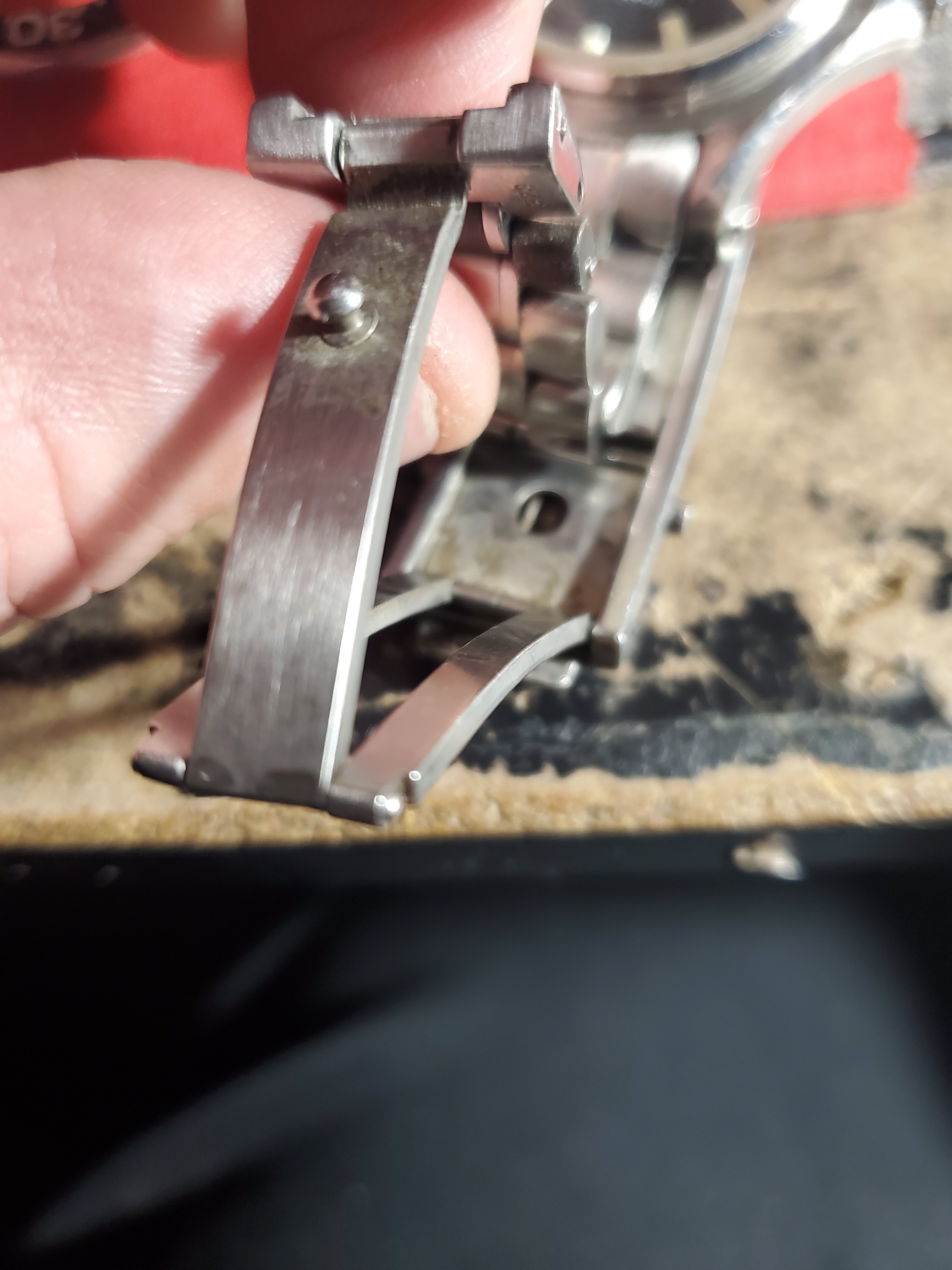

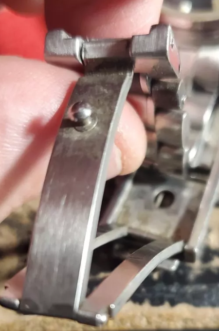

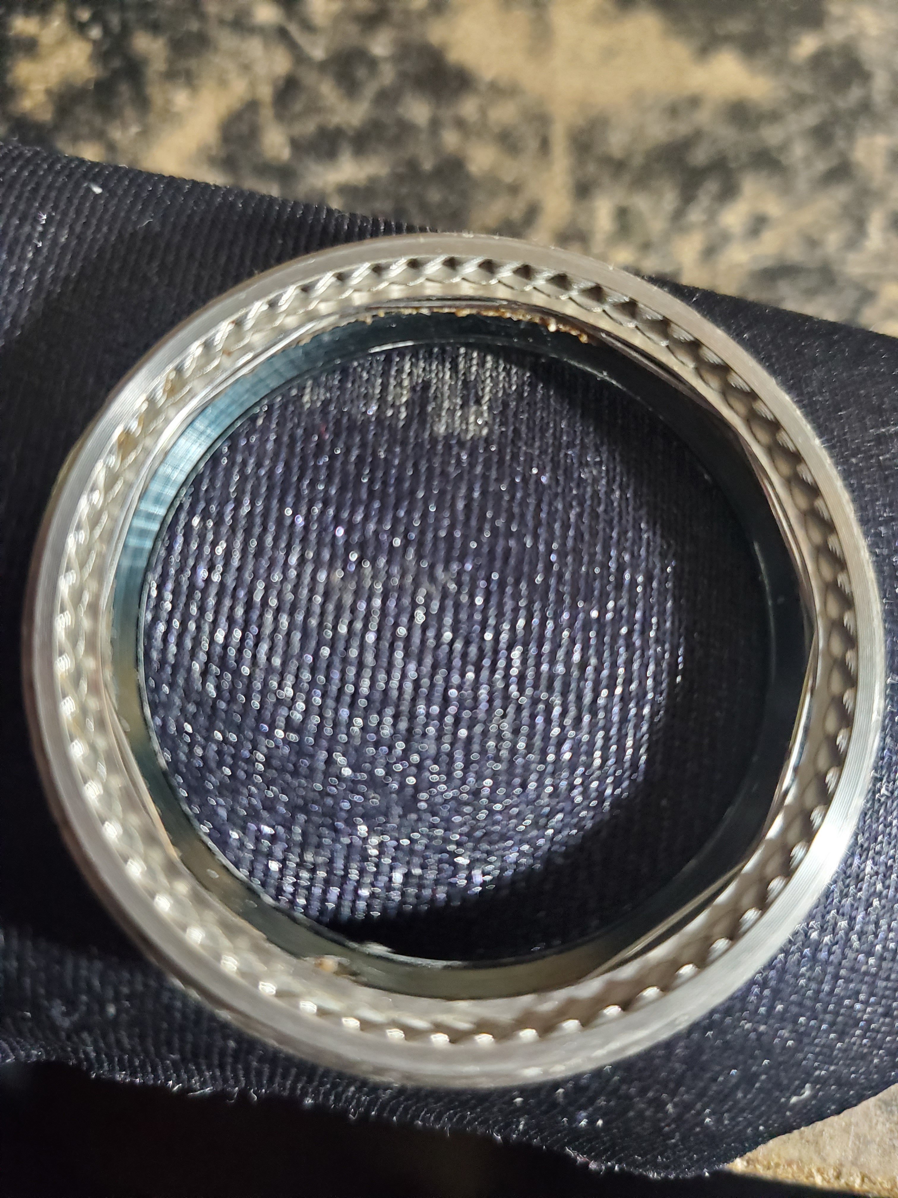

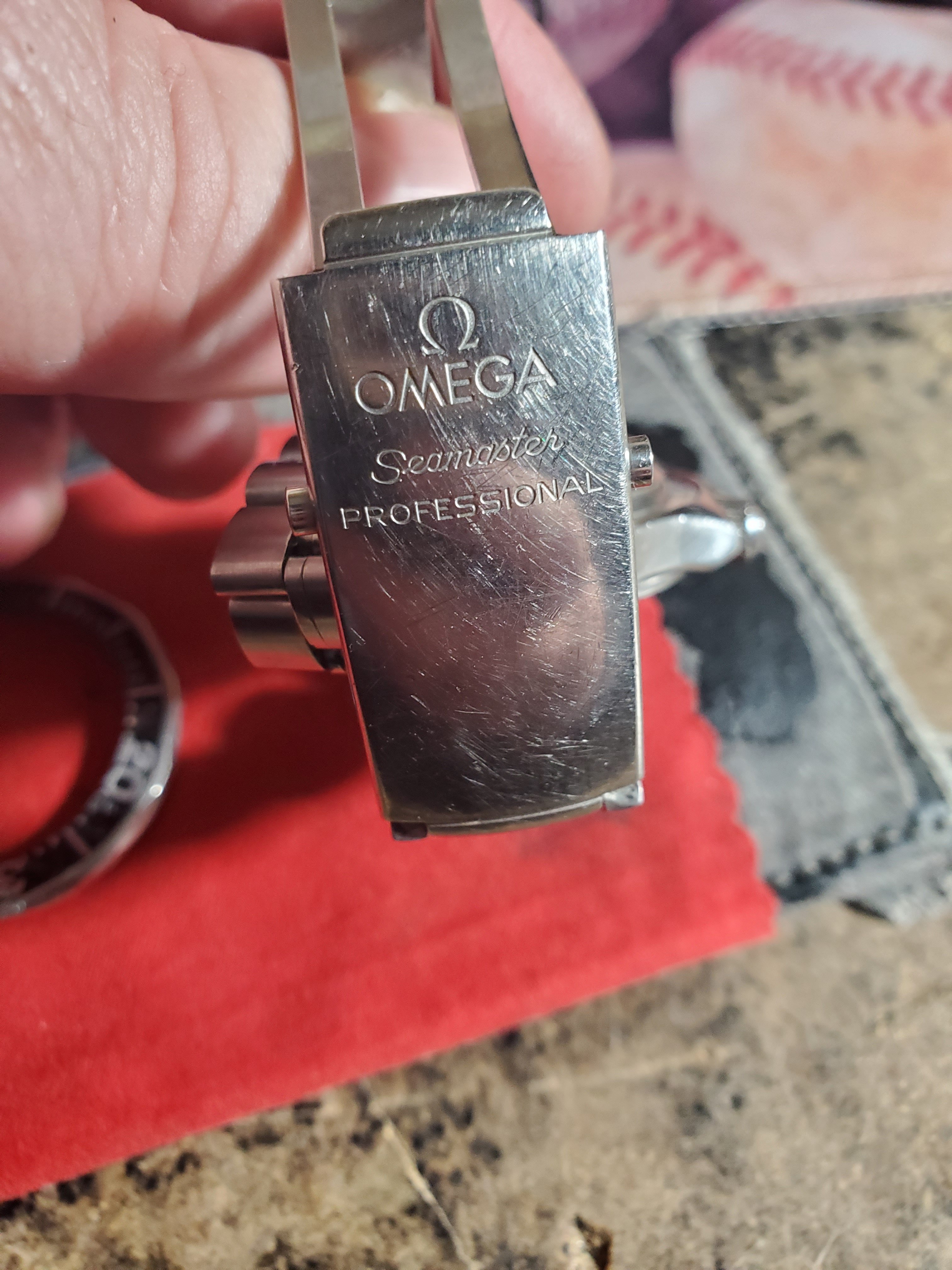

Needs a bezel click spring, is the bezel factory, never seen that saw blade type back . 930 on end lugs. bracelet looks good, lots of wear of coarse. Lots of questions looking for some expert help/info, value, year,ect? THX guys !

Not sure I like that. Bits of it look right but the lume pip is wrong and the base movement for the 1120 is the 2892. Note the 2836 is a day-date movement based on the 2824. The text on the rotor is different to any I have seen and the lume application is weird, it seems to be damaged at 12. I suspect it is a Franken at best, close fake at worst. Perhaps it is a water damaged 2254 that received some incorrect generic ETA and aftermarket parts. The year is anywhere from 1997-2006, you can't be more specific without a serial number. Value? Not a lot, something for the bracelet maybe (if real and not too stretched).
Even if it were straight, and it most certainly isn't, you have no right to offer that for sale here by the way as selling privileges are for established members. I doubt anyone will want it as it is...

It's all fake. In fact, why is this post even up?
