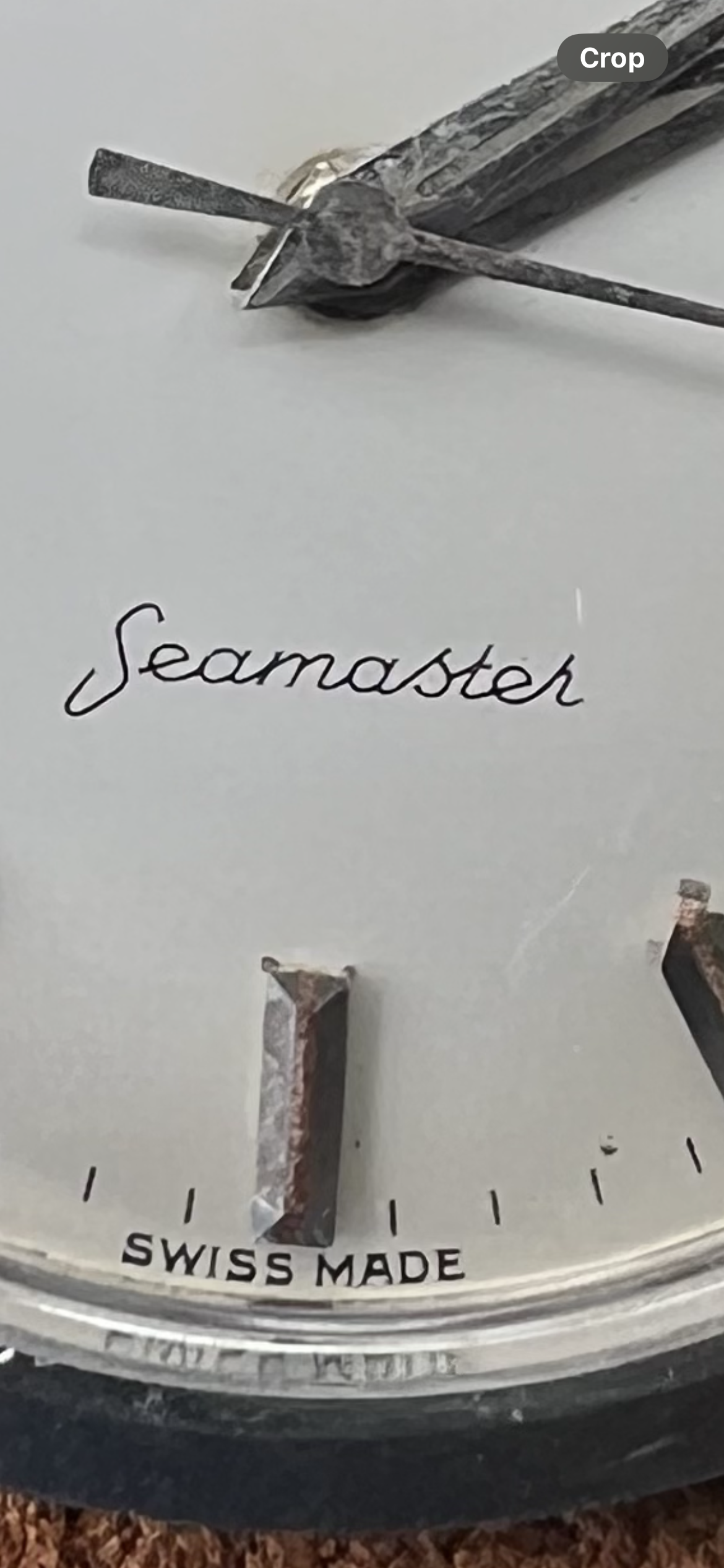

Hi All - I’ve been lurking on this forum for a few months and I’m just incredibly impressed by how much knowledge there is here. It’s been super helpful as I look for my first watches.
I’ve been looking for 1950s seamasters with beefy lugs and came across this 2846. It has breguet numerals, which I like, but haven’t seen them on a 2846. What do folks think? Could this be a redial?
Thanks!

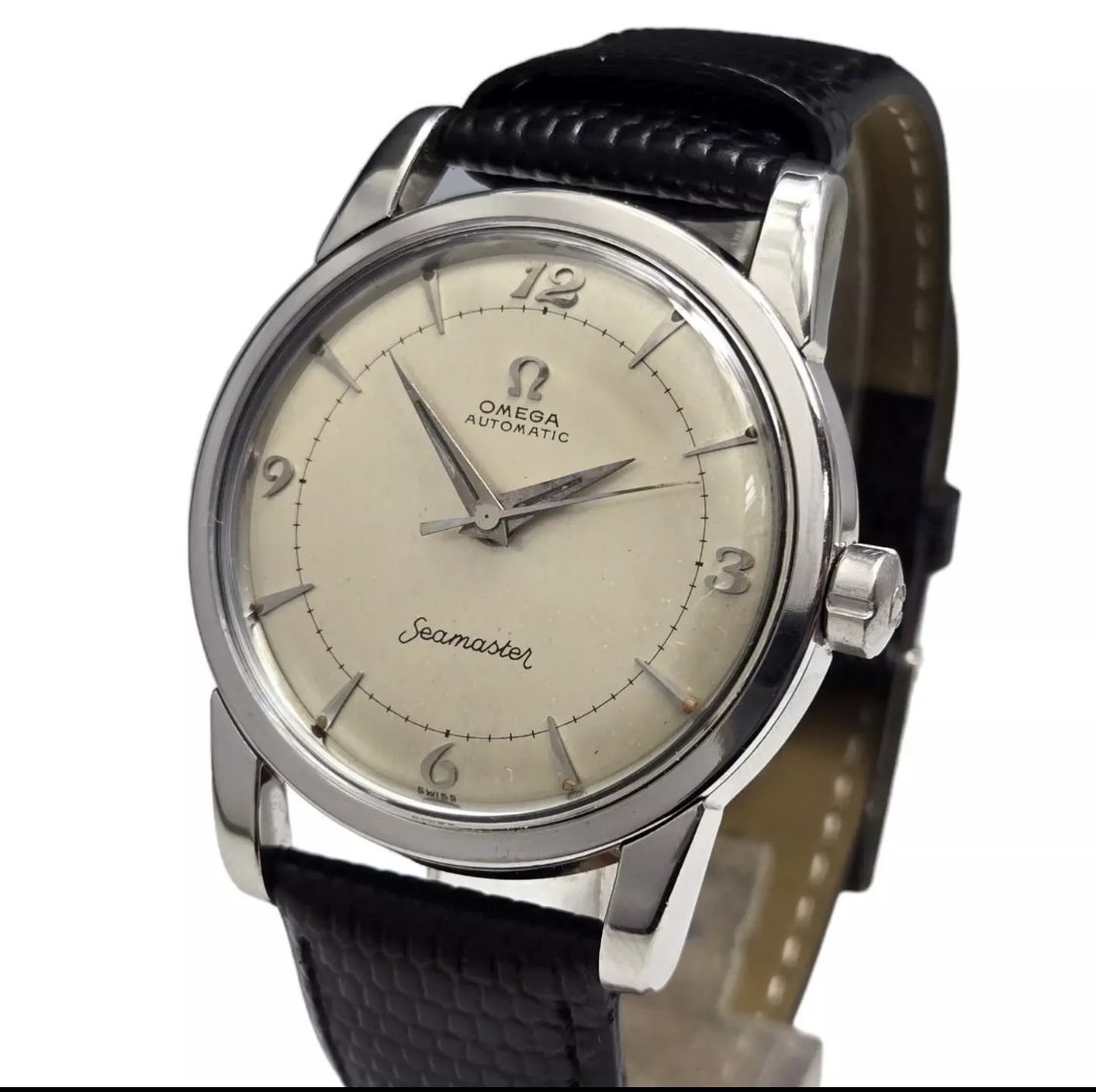

Looks fine to me, an American market watch, case is quite polished.

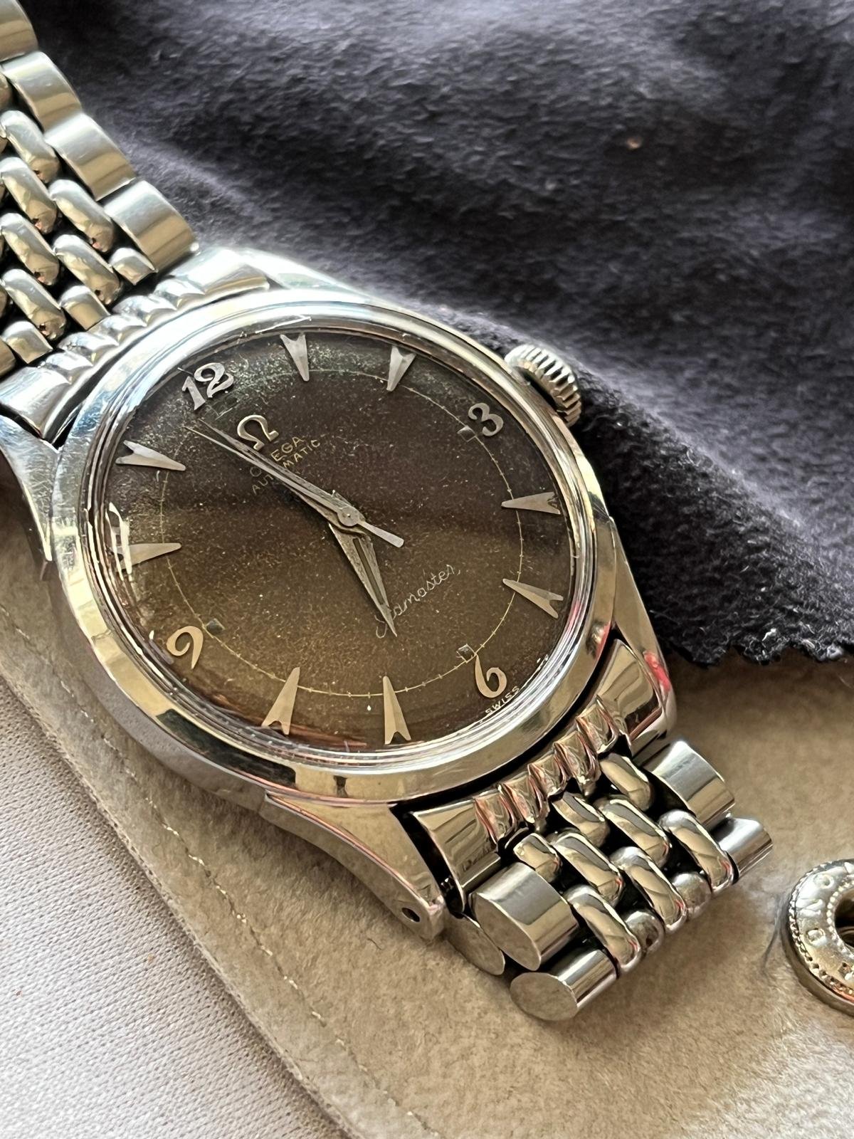

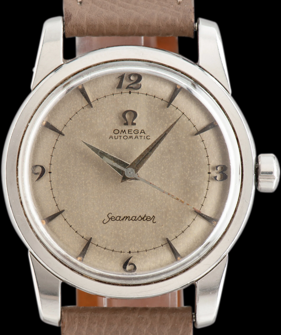

Here is another example.

I thought redial as e’s have very horizontal cross stroke compared with this and other examples with much different steeper slant on e’s

It looks ok to me at first glance, and certainly the applied Breguet numerals are original.
