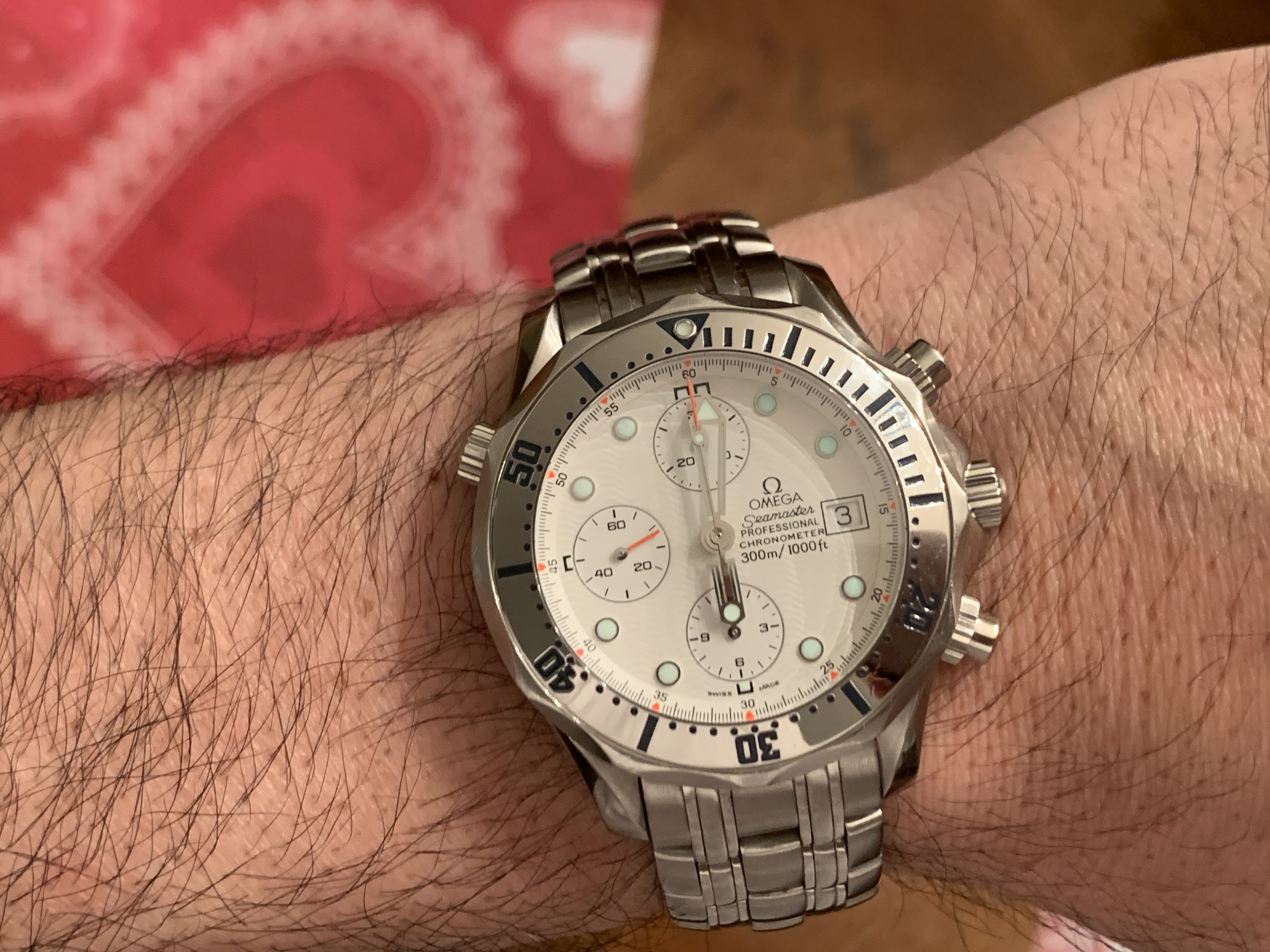

Ok took my watch 2001 Omega Seamaster Chronograph with 7750 eta movement if not mistaken to a repair shop because it was stopping after the power reserve finished. The gentlemen said it needed a new mainspring and the watch had what he said some minor steam or water penetration showing and that he would service it. $550 he quoted me . I know Omega charges $750 for a Chronograph service so I took it plus he had good reviews. He said 2-3 weeks. After 3 weeks I called he told me he had done everything but the Chronograph didn’t work after he had done everything including pressure testing the watch and he had to order more parts and would be another few weeks no extra charge. The Chronograph worked when I gave him the watch so I don’t understand this. Well we’re at 5 weeks now and I’ve still heard nothing back yet. This is the first automatic watch I’ve had to repair and would appreciate any feedback , opinions and stories. Thanks
20
11
Ok update. After about 7 weeks he says the watch is ready and I go pick it up. Says the watch is running fine and shows me the parts he had to change. The main spring and another little wheels. I get home and start testing the Chronograph and the wheel that counts the minutes stops at 4 but the other wheel that counts the hours seems to be fine. Now I have to bring it back. I’m not so sure this watch repair man has great experience with Chronograph watches.

Thanks for your feedback all of you. I really feel like cutting and running but I already paid, the watch keeps time without stopping and he said I have a 1 year warranty on his work. But I dread having to leave it to him again. Arggg I’m so annoyed. I’m going to go back tomorrow to talk to him and see what he says. So far this is how much I’m into the watch. I paid $1400 for the SMP300 Chronograph 2598.20 watch, $50 for an extra link and $550 for the watchmakers work. It’s just a nice clean example of this watch and really like it alot. There no yellowing on the dial like many examples. Thanks

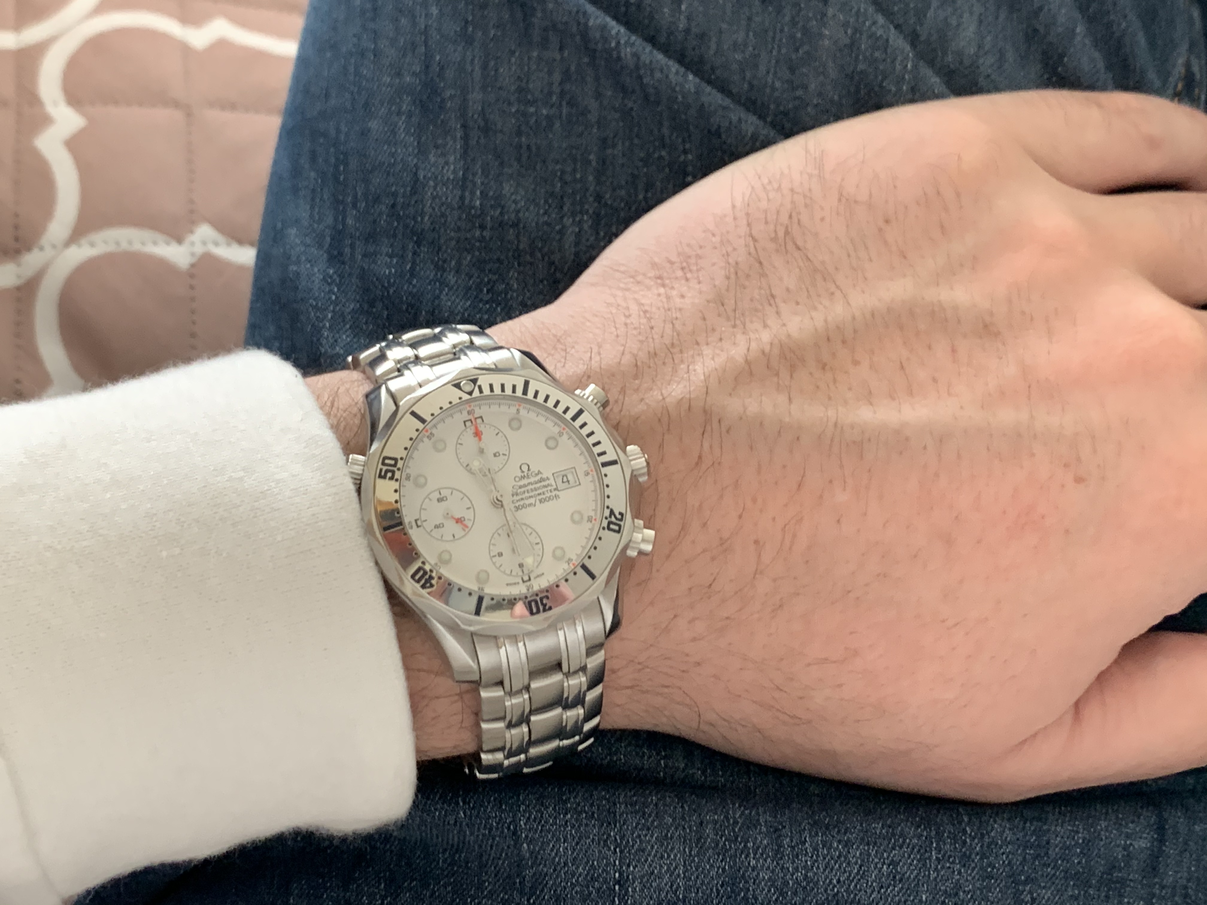

I woke up this morning the and the Chronograph is now working fine! Very strange. I’ll keep an eye on it but all seems well now . Maybe it was the oils that needed to spread?‍♂️

Another great shot of the beauty. I live white dial Seamaster 300 watches.

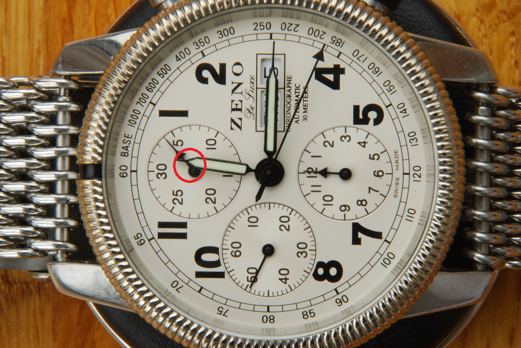

Yes 12:15 or so.
Hi David
This is the only 7750 I have here and the hands are a little different to yours but, the hour hand and minute recorder hand are aligned at this time (the red circle) and I suspect that you have a slight hand interference issue. You can imagine that if the minute recorder hand is a little high, or the main hour hand is a little low, they would contact at this time. In that case, you might never see this combination at any other time and it will not necessarily stop the watch completely. You can try and reproduce the issue if you want.
Definitely take it back and point out the issue to the watchmaker and they should be able to resolve this without major work.
