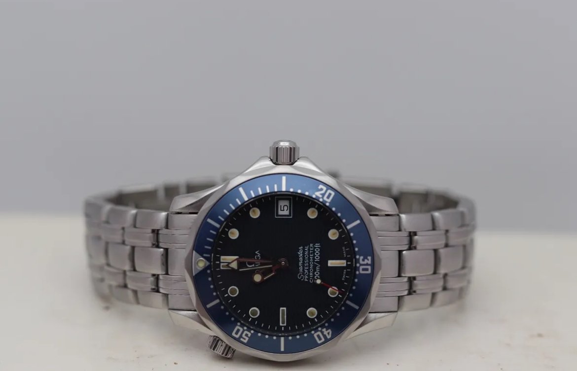

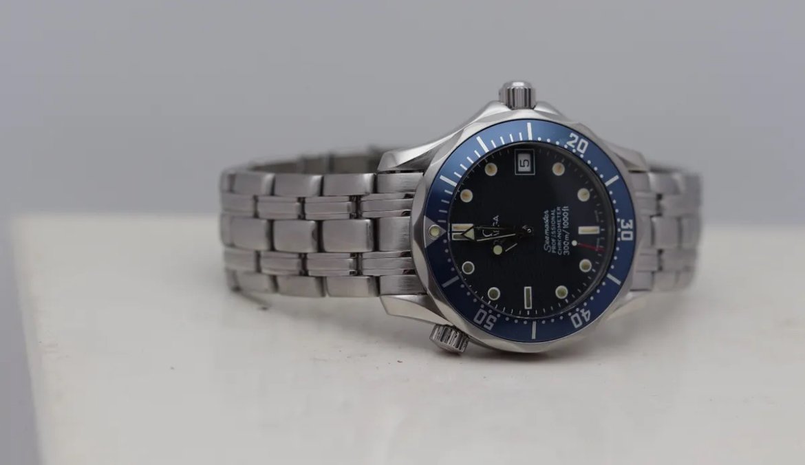

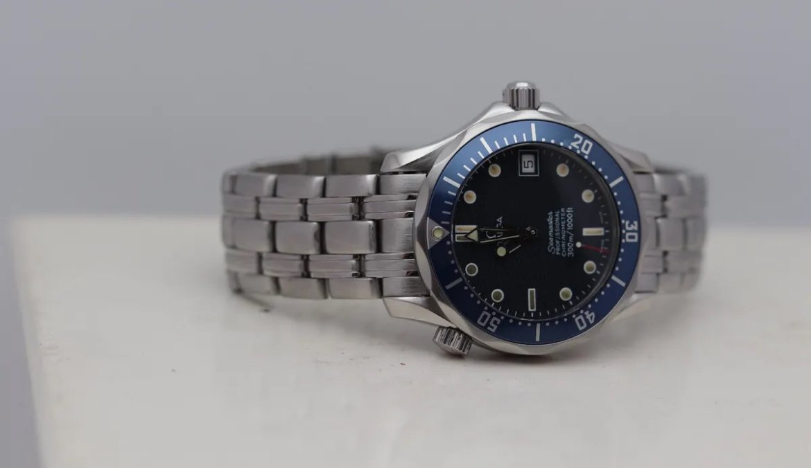

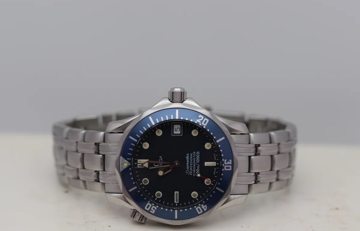

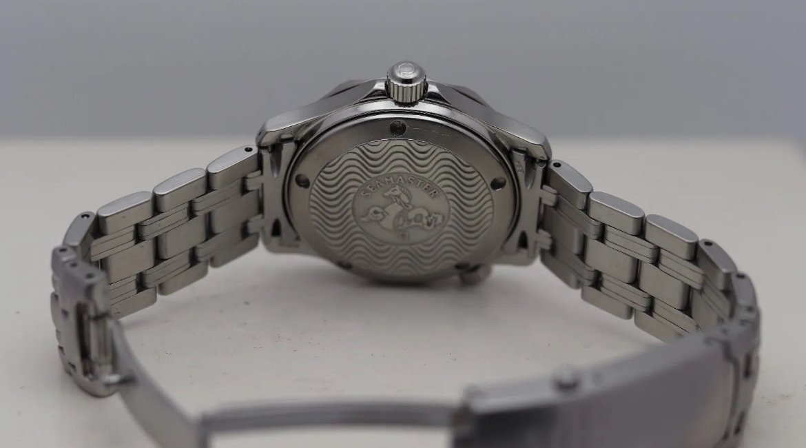

Hi all,
I’m looking at this Omega Seamaster Pro SMP 300M 2551.80 Mid Size 36mm VTG OG Blue Wave Bond Auto.
All looks legit to me, but anyone see anything off about it?
Seller is asking $1,750… based on my limited knowledge, that seems fair, but I’m curious about everyone’s thoughts.
Also - since these aren’t vintage, can they be considered waterproof?
Thank you for any insight.

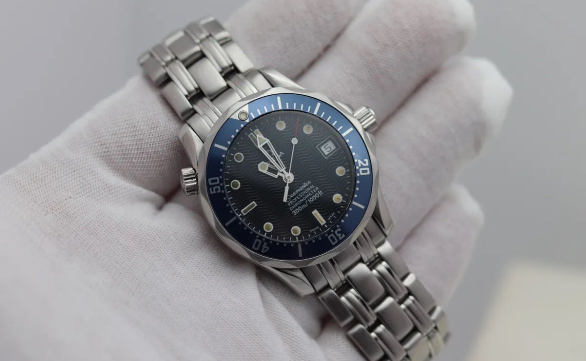

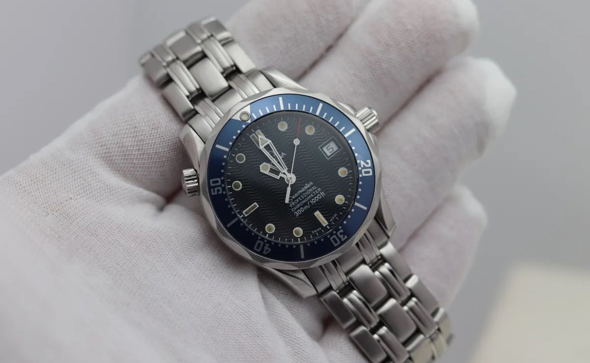

Not sure I like the look of the lume there. It may indicate water damage at some point as it looks like it is going fungal on the LHS plots. An SMP can be made fully waterproof yes, but it needs a pressure test to check if this is the case.

Looks fine to me—and the price seems reasonable.

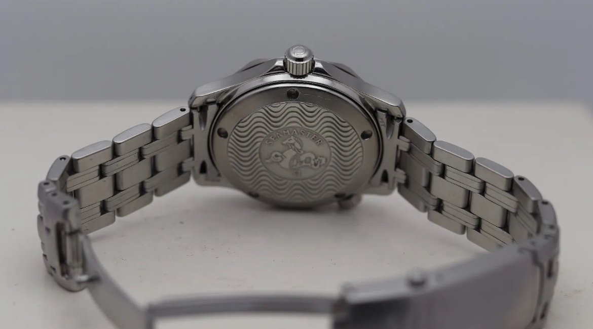

Since the paperwork specifically says that pressure testing was not performed, then no—you should not consider the watch waterproof. You’ll want to have a watchmaker test it and replace gaskets if needed.

I agree re: the lume plots, though nowadays that passes for a “tropical dial” or whatever. It wouldn’t necessarily put me off the watch at that price. Just get it pressure tested to prevent any further damage.
You are probably aware already, but if not: by today’s gargantuan watch standards, 36mm is going to feel small. I had one of these (with the black dial and sword hands) for a while and it did take some getting used to. 36mm includes the width of the bezel: the dial itself is dainty. Very wearable—I like 36mm—but if you have larger wrists it could disappoint.

I am also concerned about the lume plots. Half look moldy, the other half fine. Could be the lighting, but I would ask for another picture to prove they are the same color all around. If the seller refused, I’d walk away, because there are better examples out there.

Thank you very much!

Thank you. Yea I actually prefer smaller watches. I have a really small wrist so the 34mm vintage omegas I have fit well. I have one 39mm watch and it’s the absolute biggest I can go.
Thank you for your insight! I’ve just asked for additional photos and will share if I get a response.

Just got a response:
“The tritium dial markers have discolored with age and are not equal in this process.”
Could this be an age thing or is it certainly a water damage thing? Thanks everyone.
I asked for additional photos again so we’ll see.

I totally hear what others are saying about the lume. FWIW, I’d say that’s a condition issue that’s baked into the price. By comparison, a place like SwissWatchExpo often has these midsize SMPs in better condition listed for $2300 or so. I’m a little confused as to why a seller would include a service but not a pressure test. But the lume thing would concern me more (or, rather, repel me) if the seller were asking over 2k. Unless people think this is an issue that will progress?

I'd keep looking personally. That dial is pretty grotty and that isn't how they normally age so I do think there has been some extra factor such as water ingress, and that may mean there are horrors lurking in the movement too.

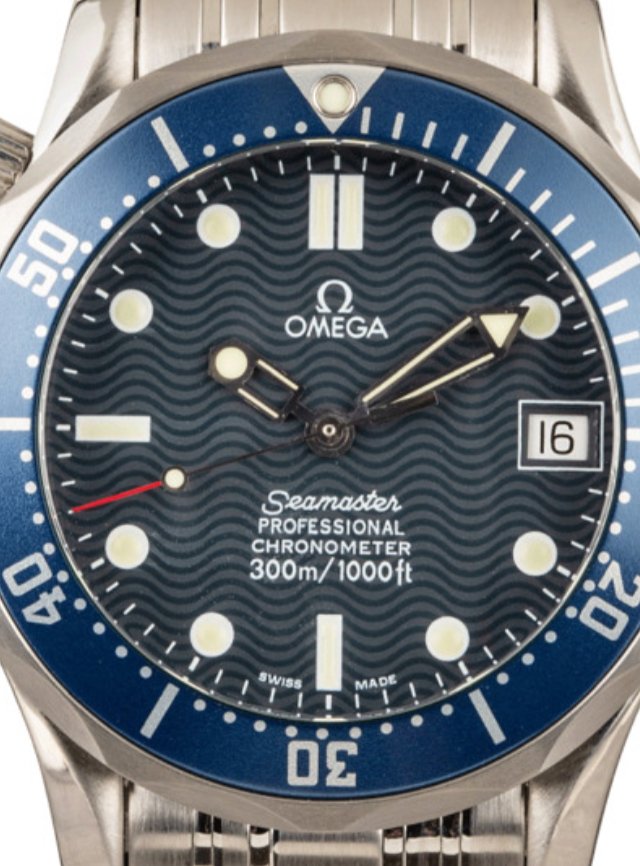

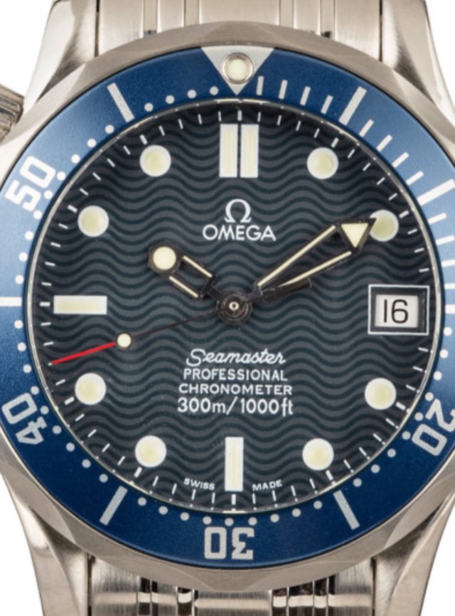

Any thoughts on this one for just under $1,600? Seller says it is running at -37sec/day... Is that concerning?
https://www.chrono24.com/omega/255180--300----785093--id32077292.htm
1,944
2,964
Bezel’s got a few dings and -37 seconds means it’s due for a complete service, so you’d need to factor in $$$ for that (and having it out of your hands while it’s being serviced). But the dial is definitely better.
122
188

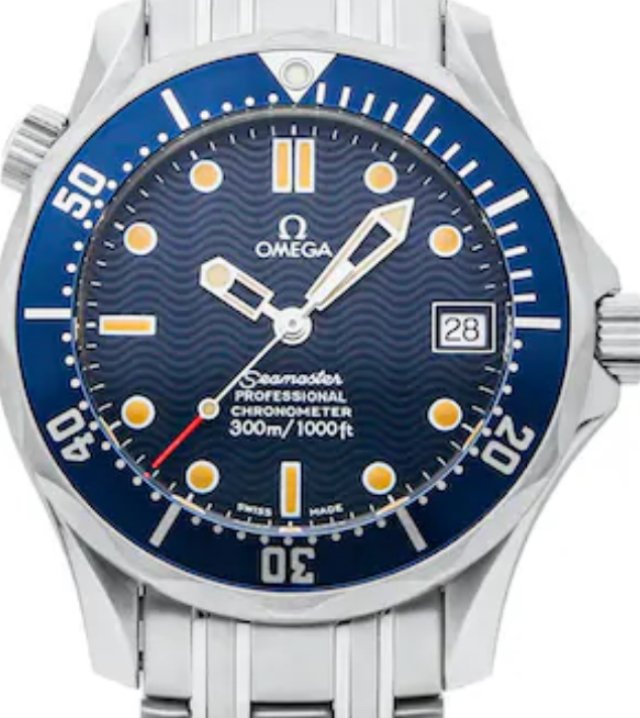

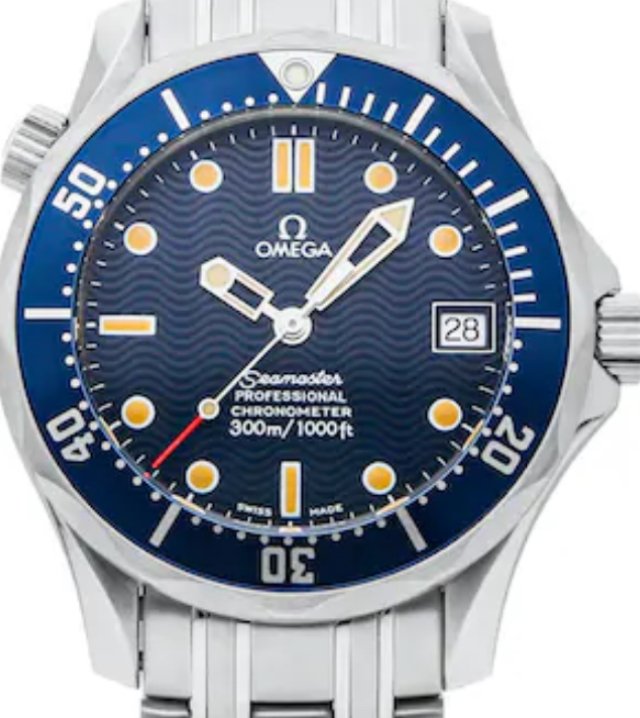

Yea... Most dial lumes I see have this yellow tint to them. Is that just normal age? Is the fact that this one is white a rare thing?
1,944
2,964
Just aged differently—same luminous material but different life-experience. Some collectors like the yellowed look; others prefer it to look like-new (whiter).
122
188
I've only been looking at these guys for a short time... Do you think in terms of value for money, I could do better than that one? I'm not seeing many others in as nice condition (ignoring need for service) at that price point...

I don’t think it is the same lume. The first watch looks to be tritium, though it’s not gone the pumpkin colour normally seen. The second is definitely SuperLuminova. The change over occurred around 1997. SL lume doesn’t noticeably age or change colour even after decades. It keeps on working. Tritium will be very dim by now, after 2 half lives.
The second watch is better, and you have $150 to put towards a service vs the first.

Also possible (what Padders said). I’m pretty sure both of these are tritium that aged differently. (Could be wrong but then the listings are wrong, not just me.) Both already sold watches.
Tritium aging can really vary.
