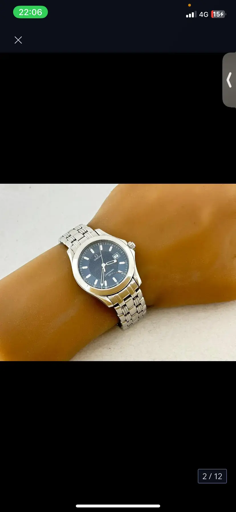

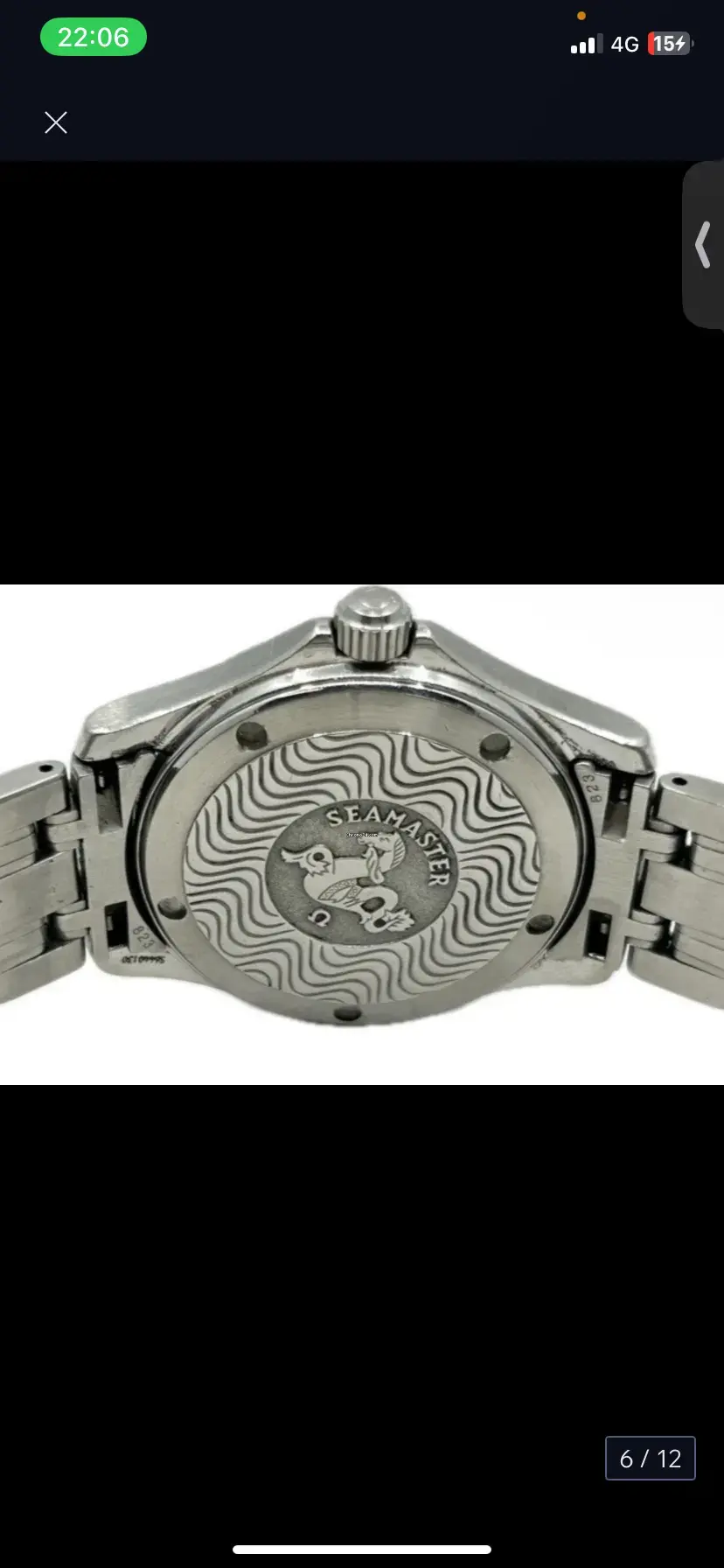

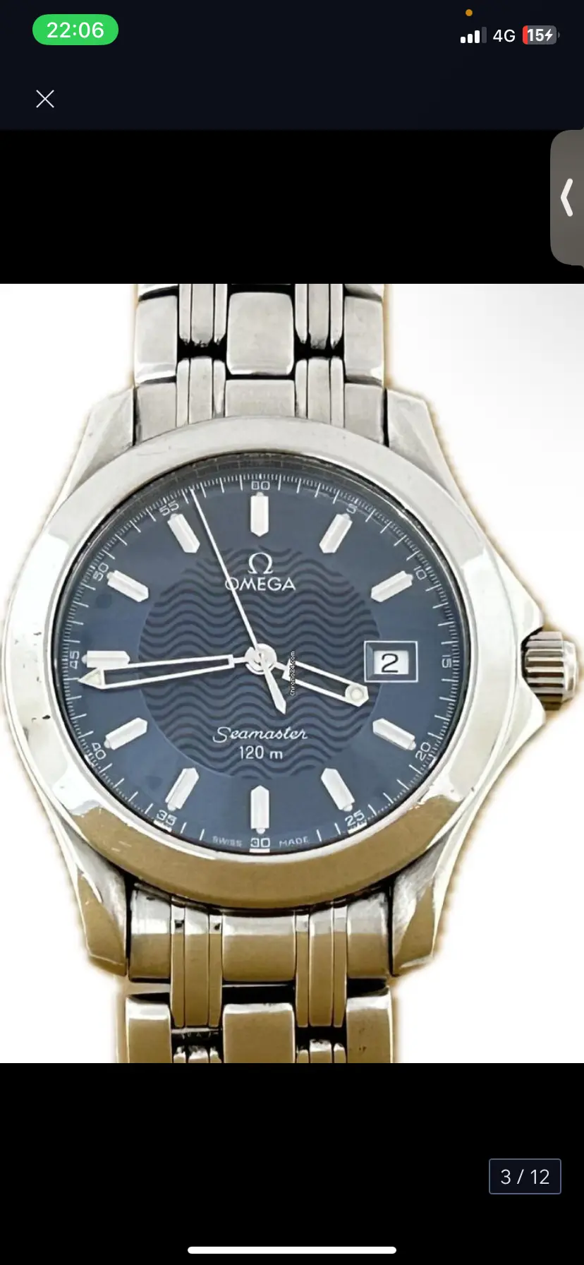

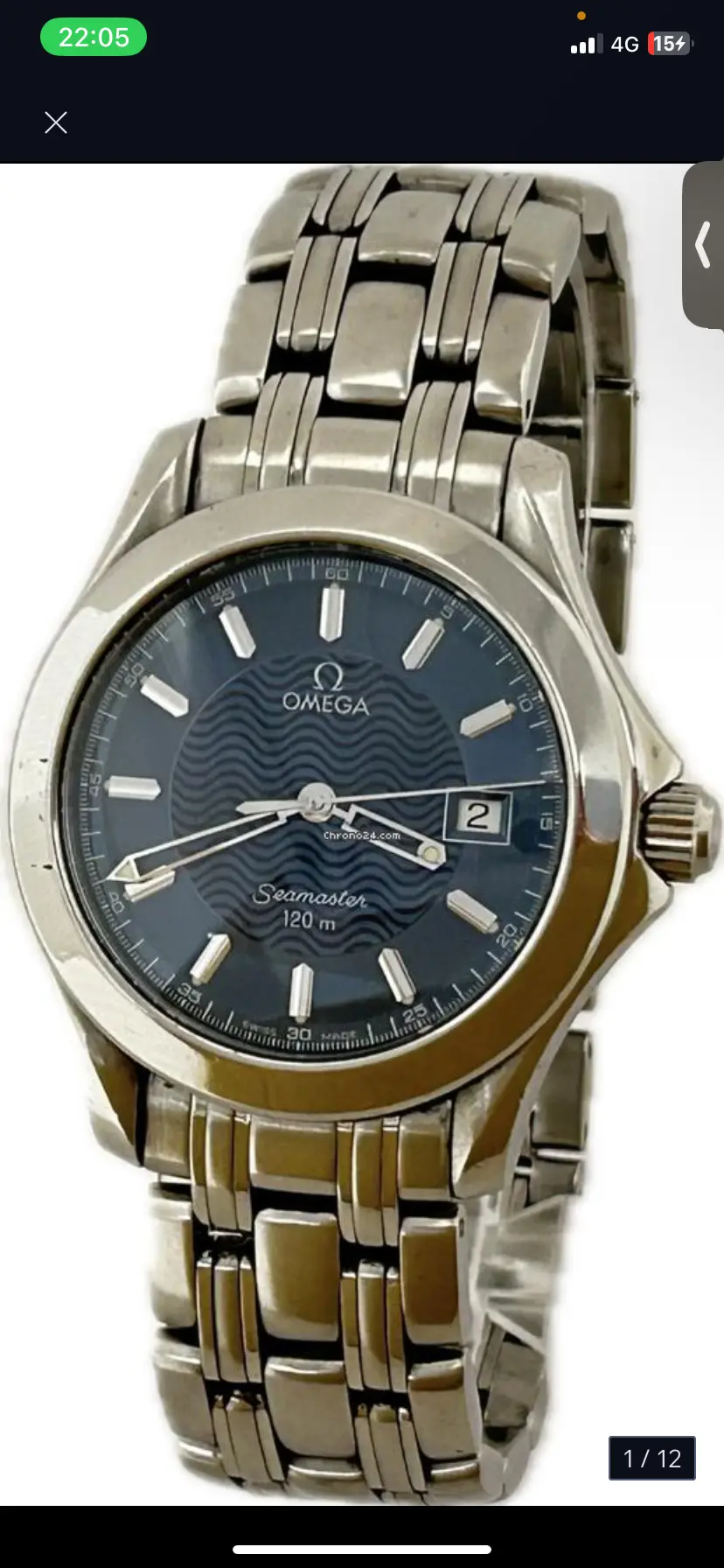

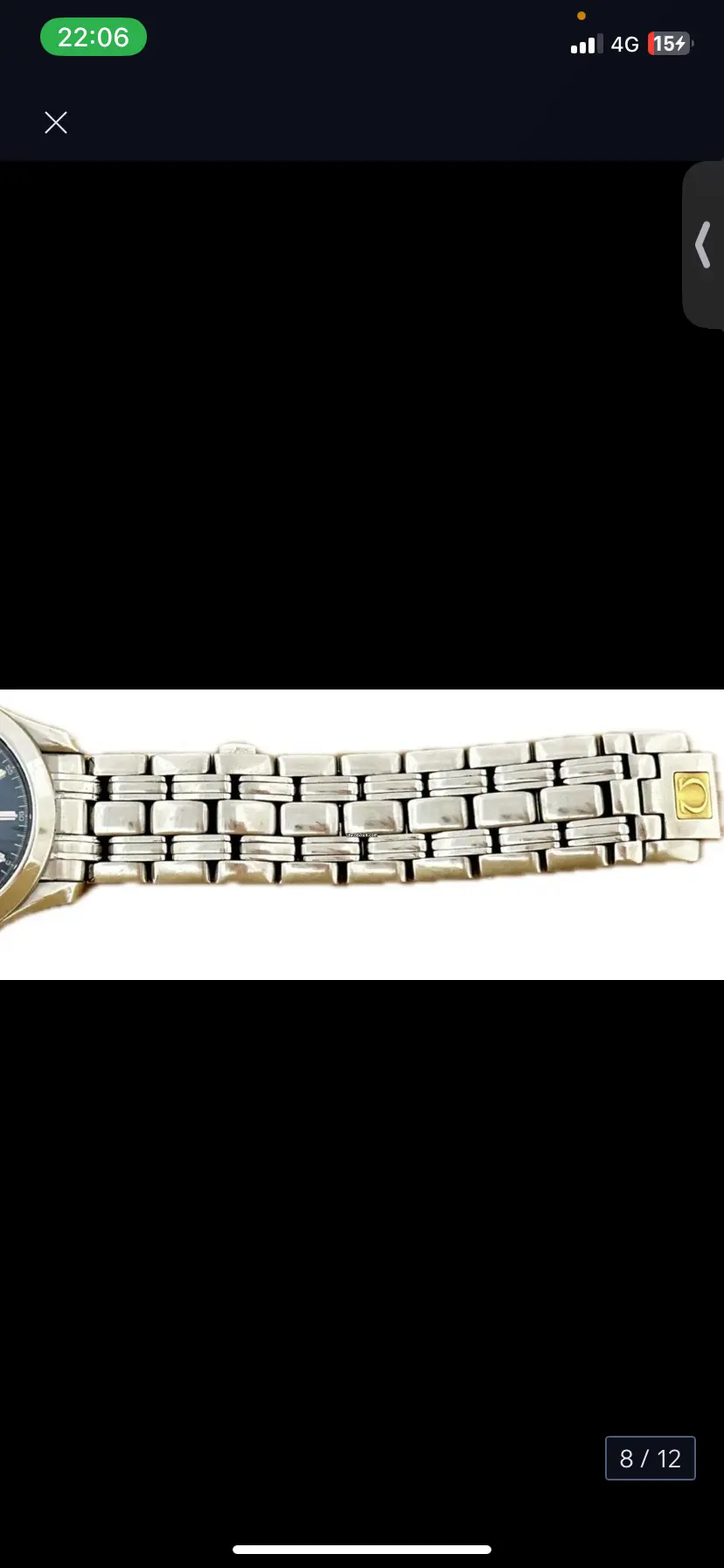

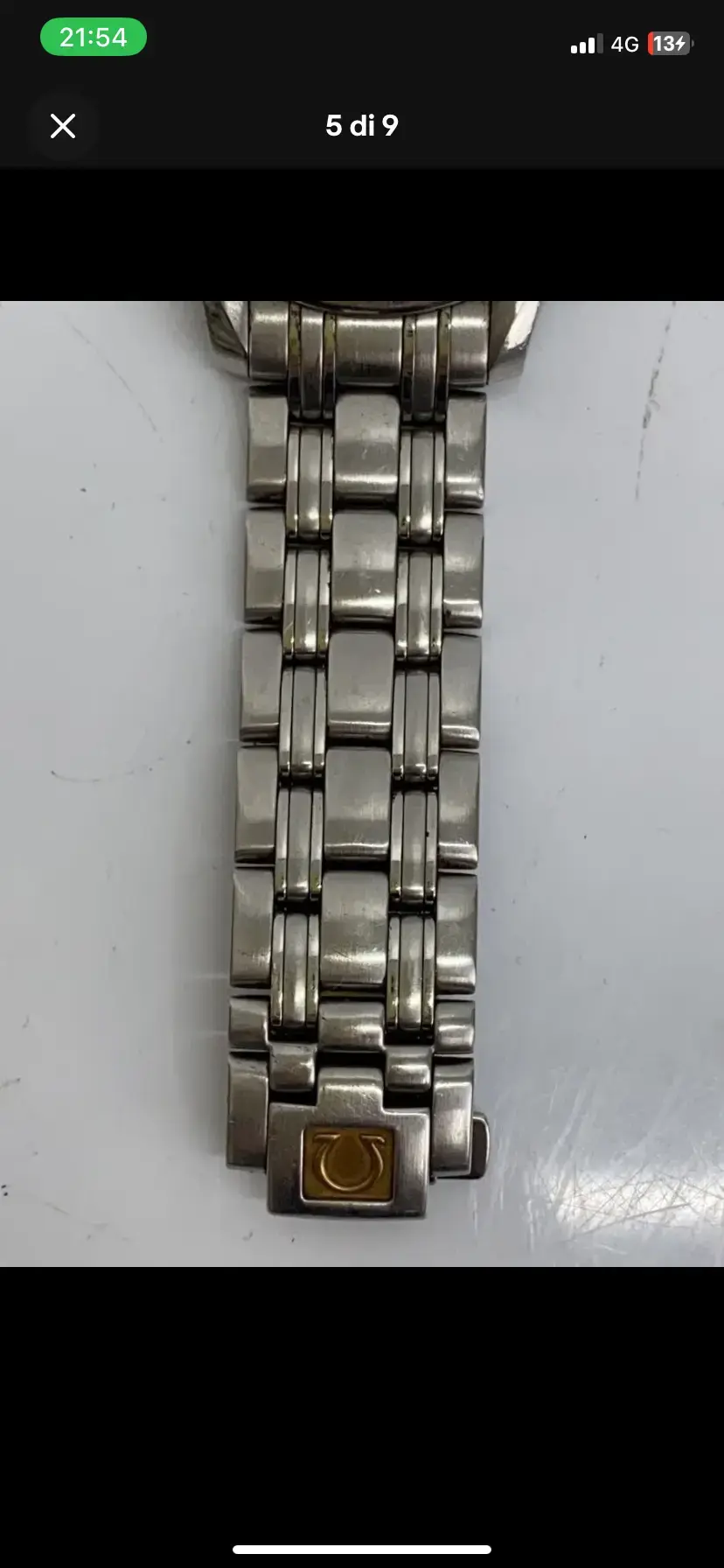

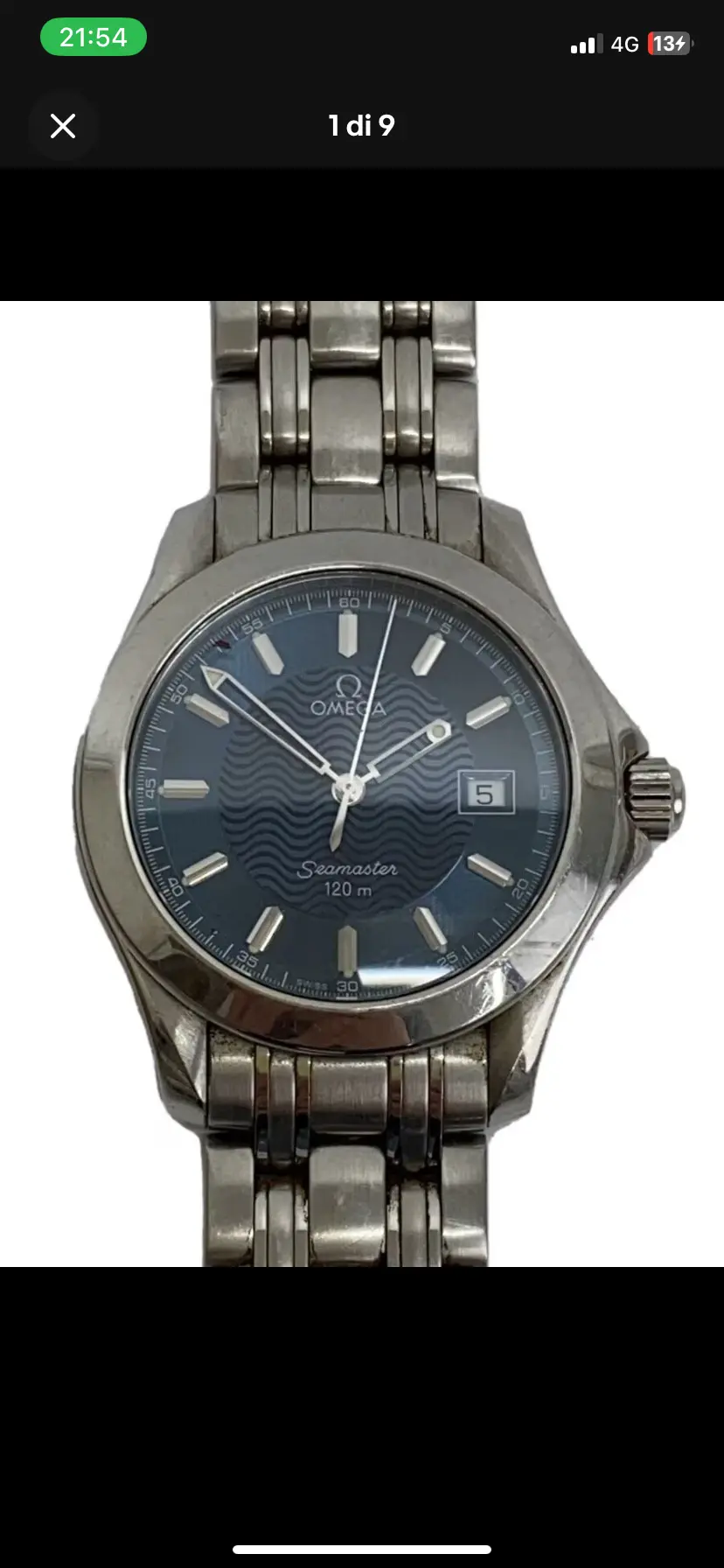

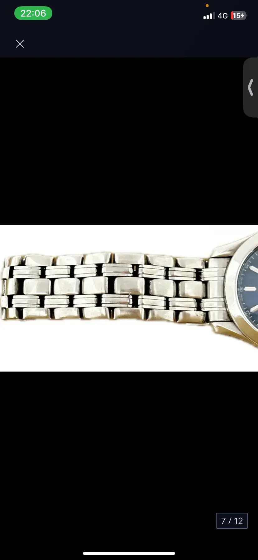

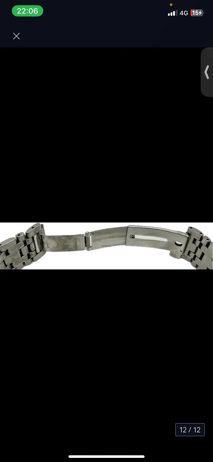

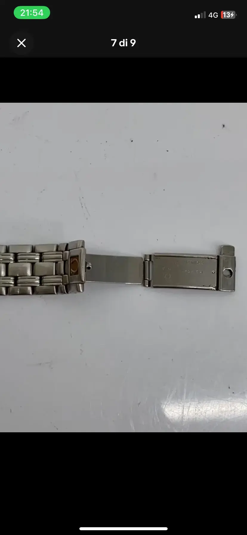

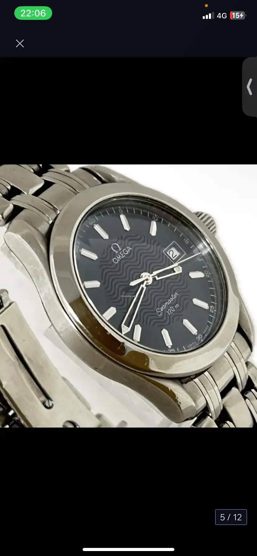

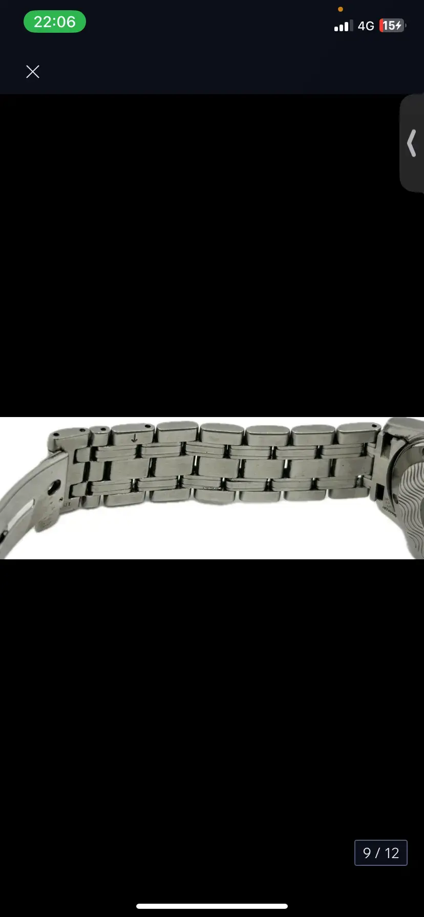

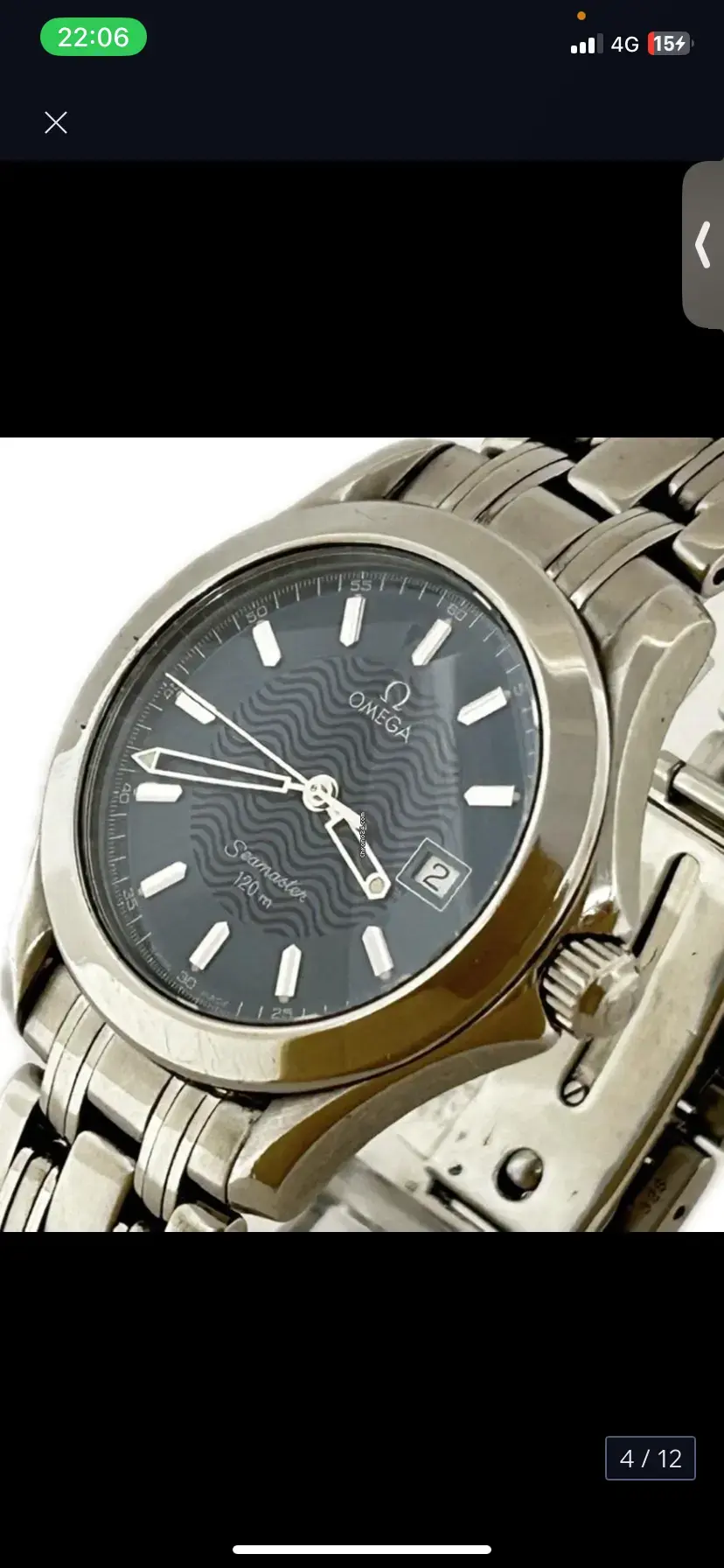

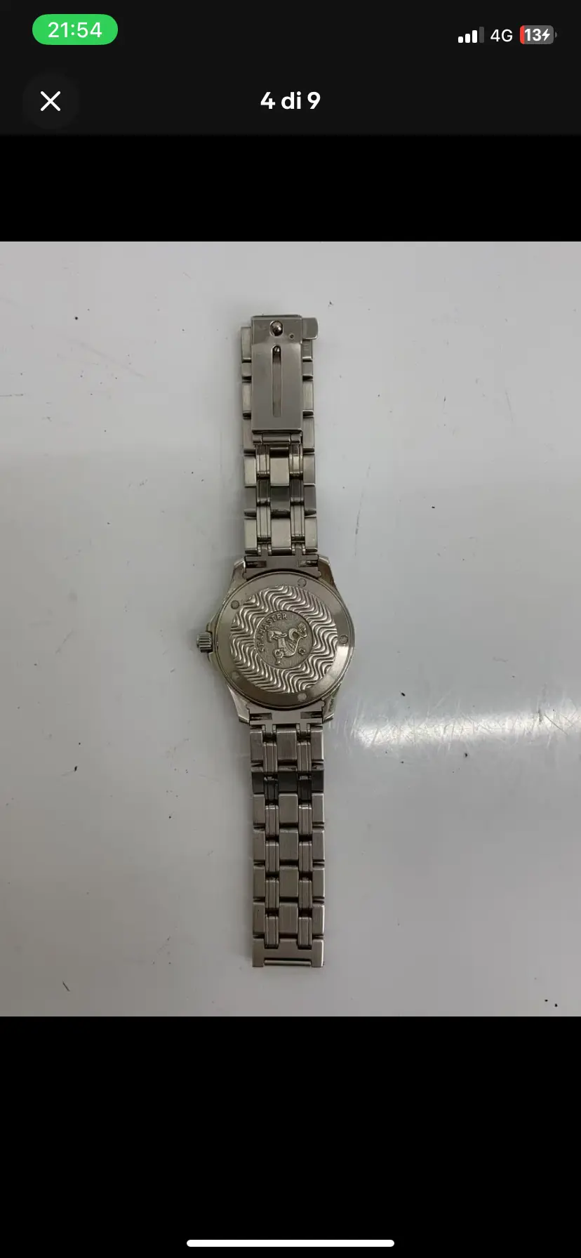

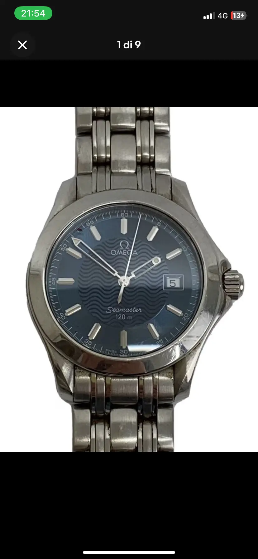

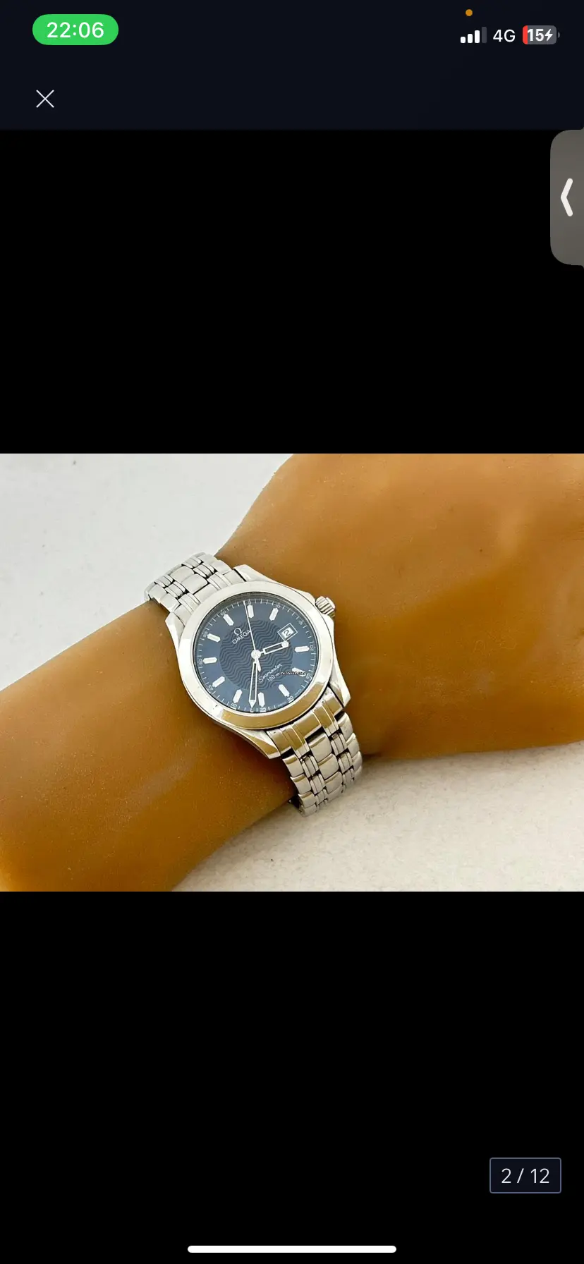

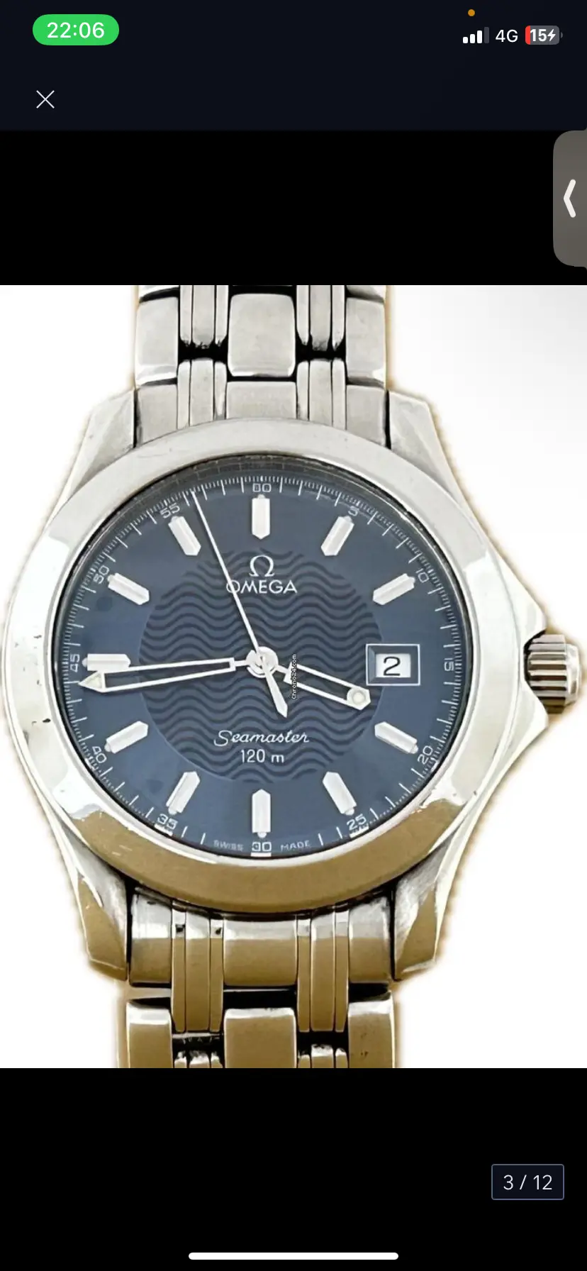

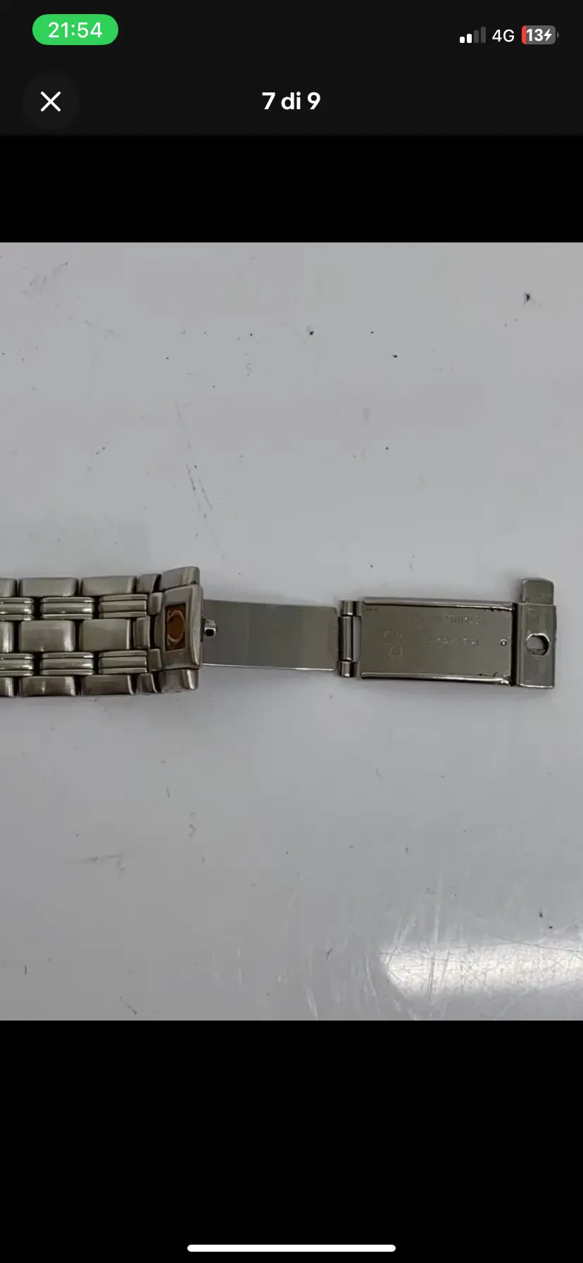

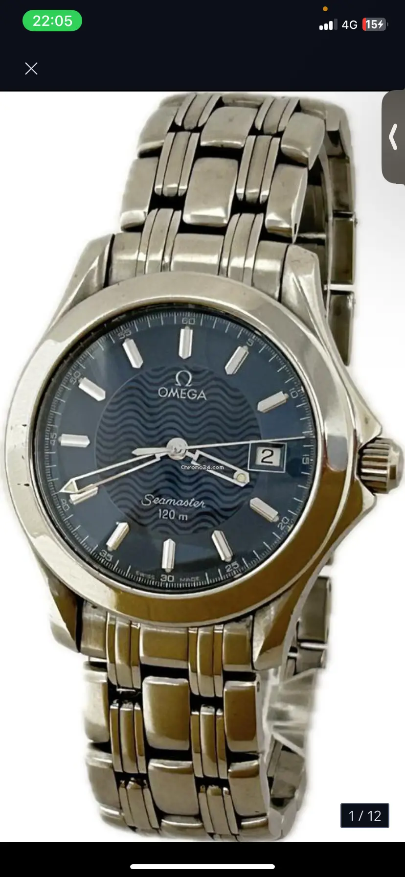

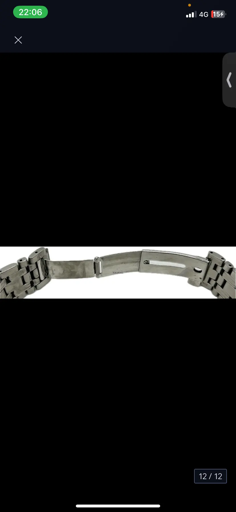

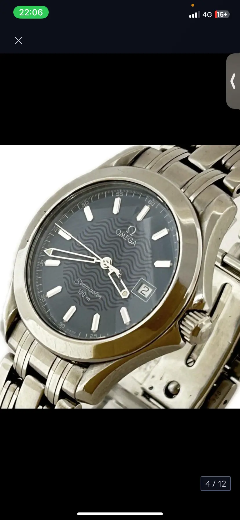

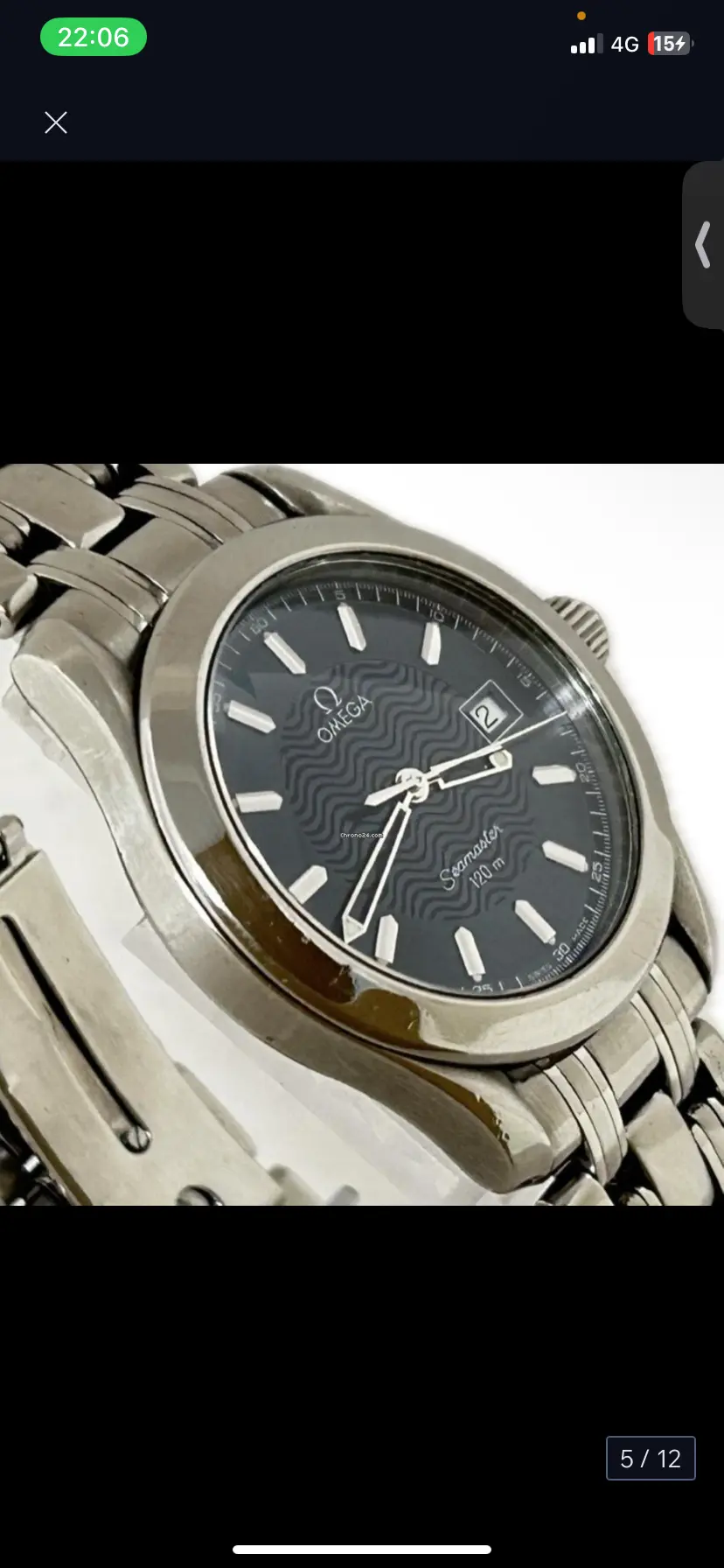

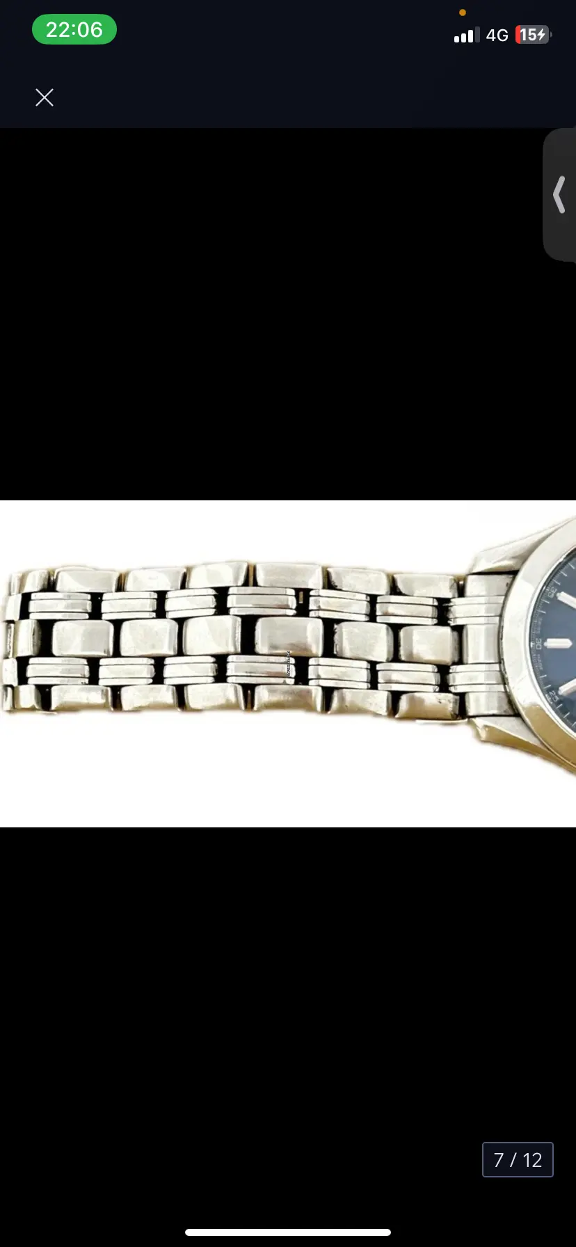

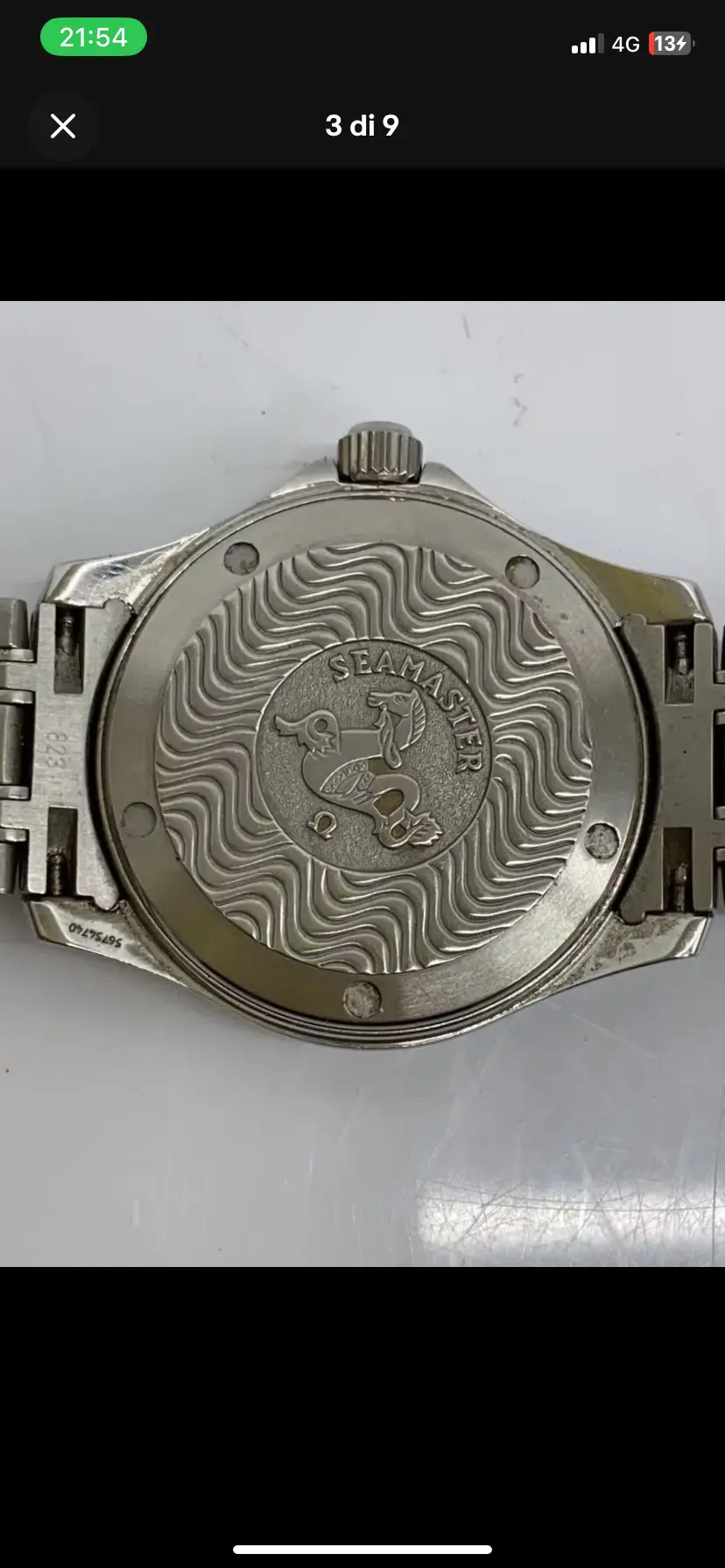

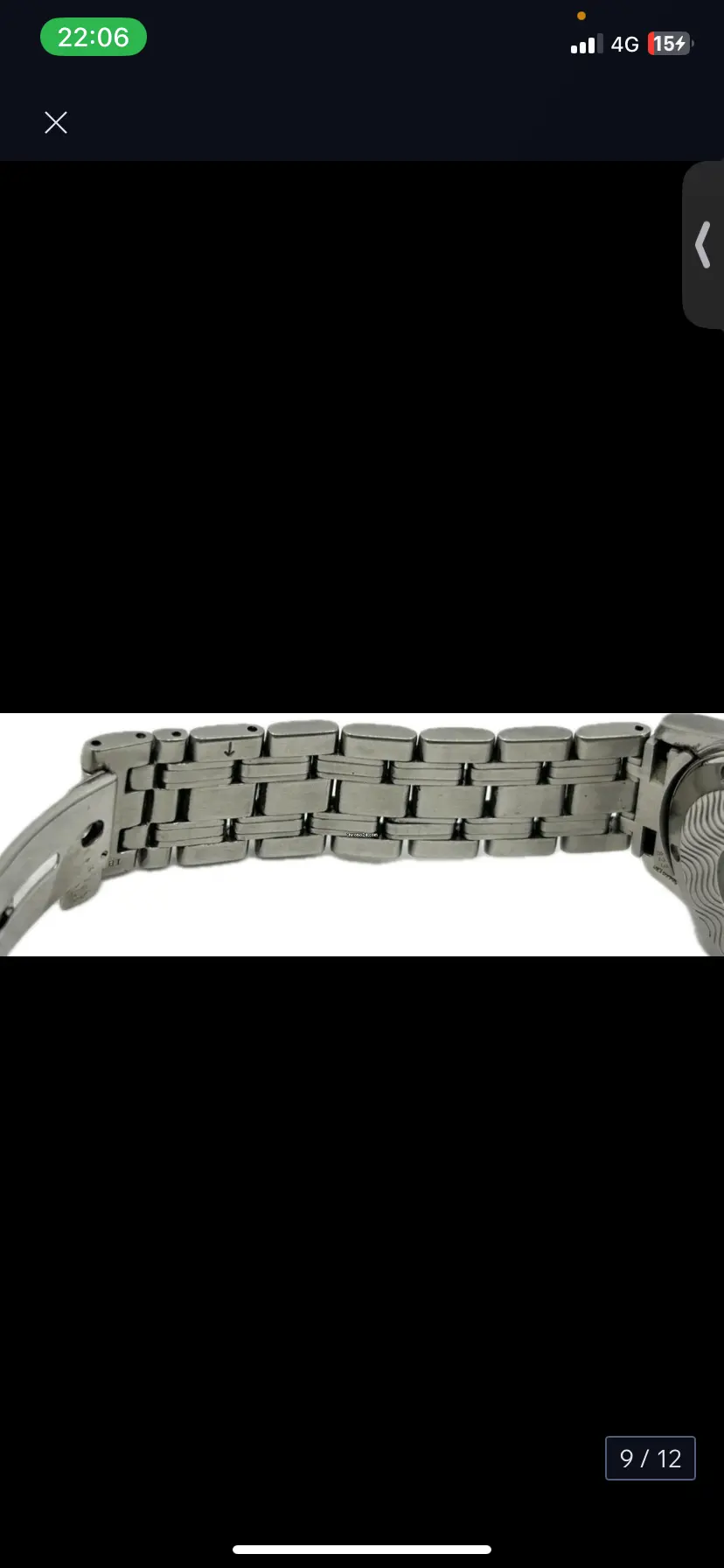

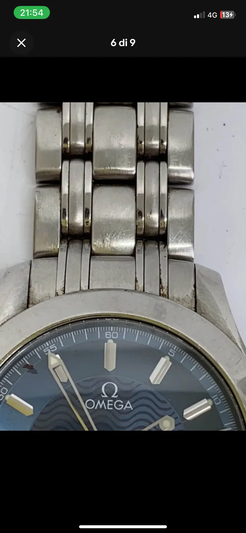

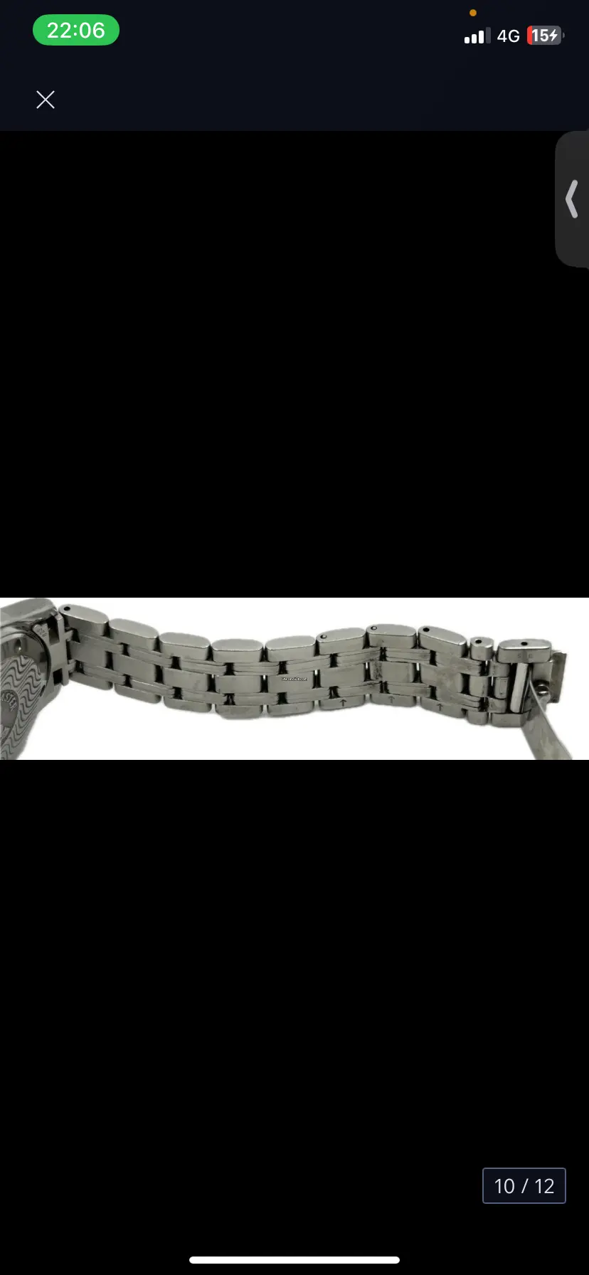

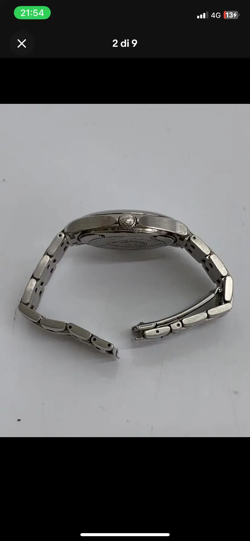

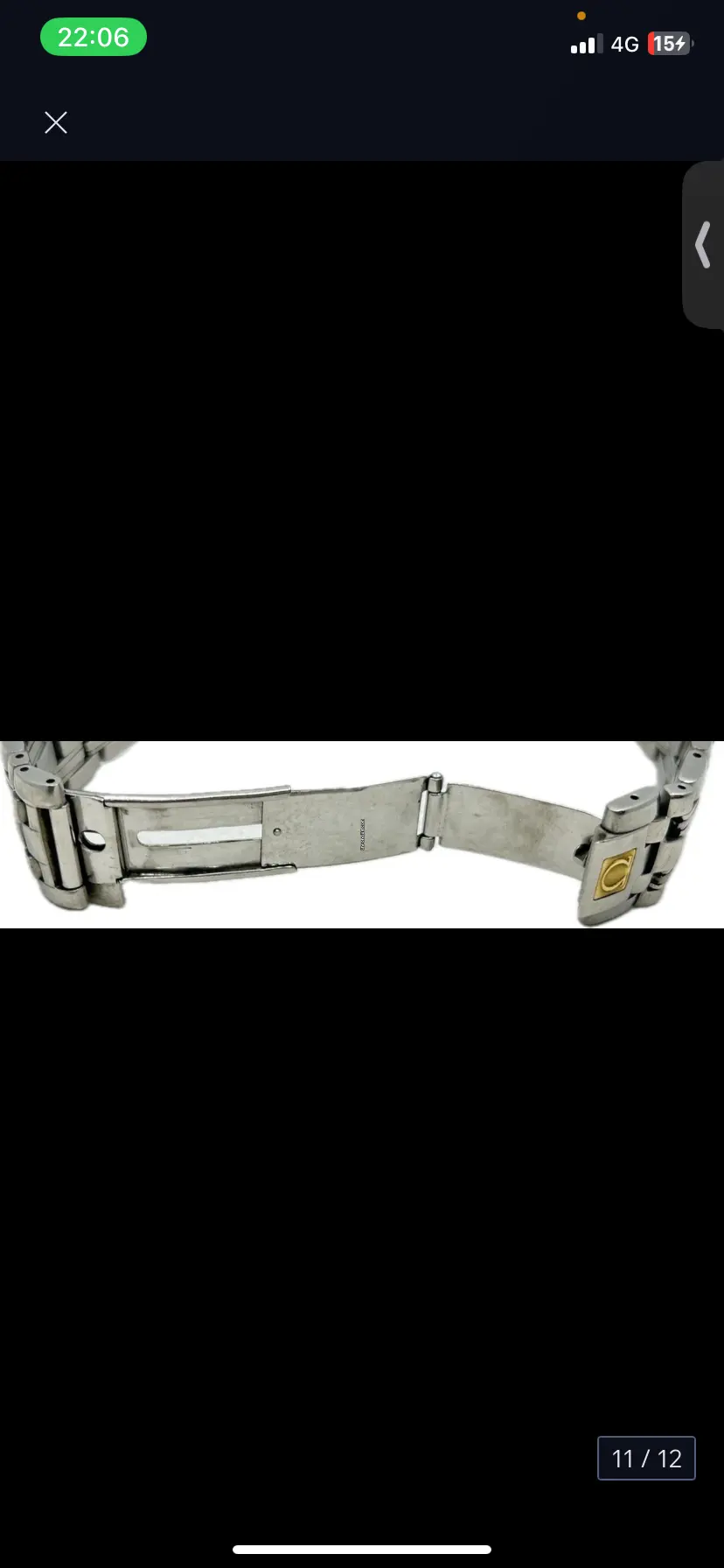

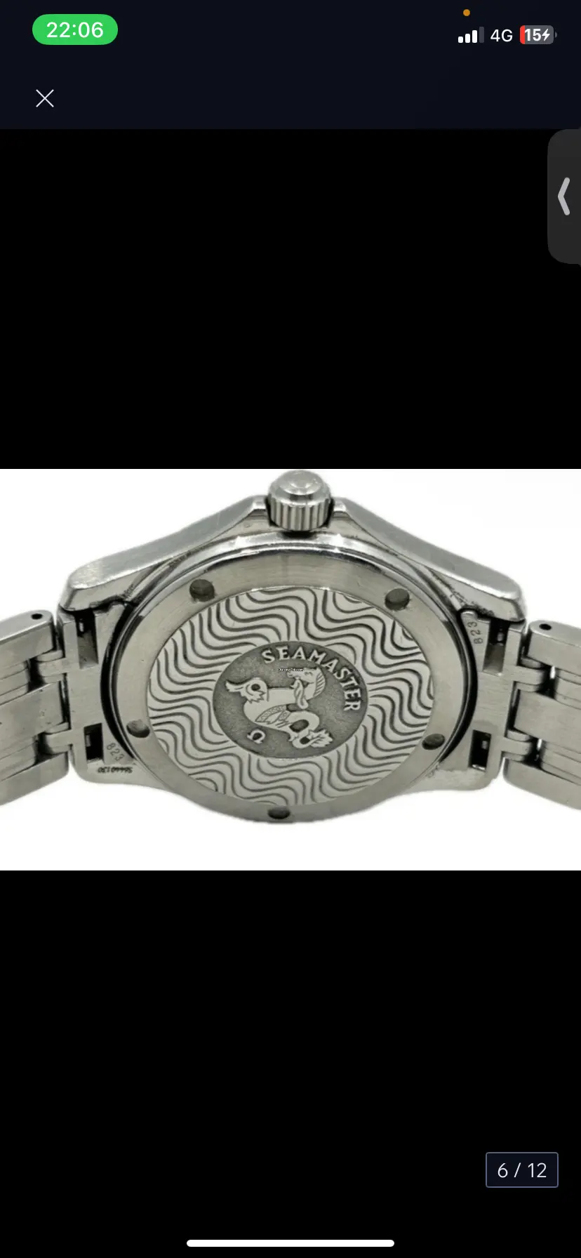

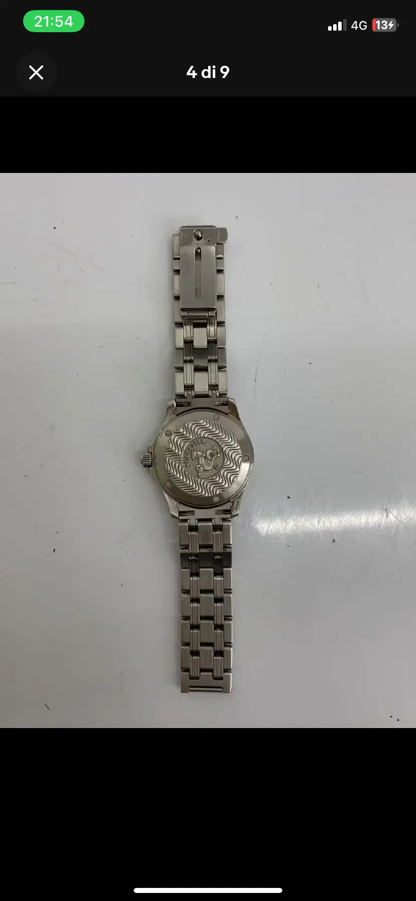

I would like to buy one of these two watches most likely the one that i have more pics on, the one that I would like to buy is from chrono24 the other one is from ebay. I don’t know if they are fakes or no. If someone could pls help me thx! I have separated the two watches with a black pic

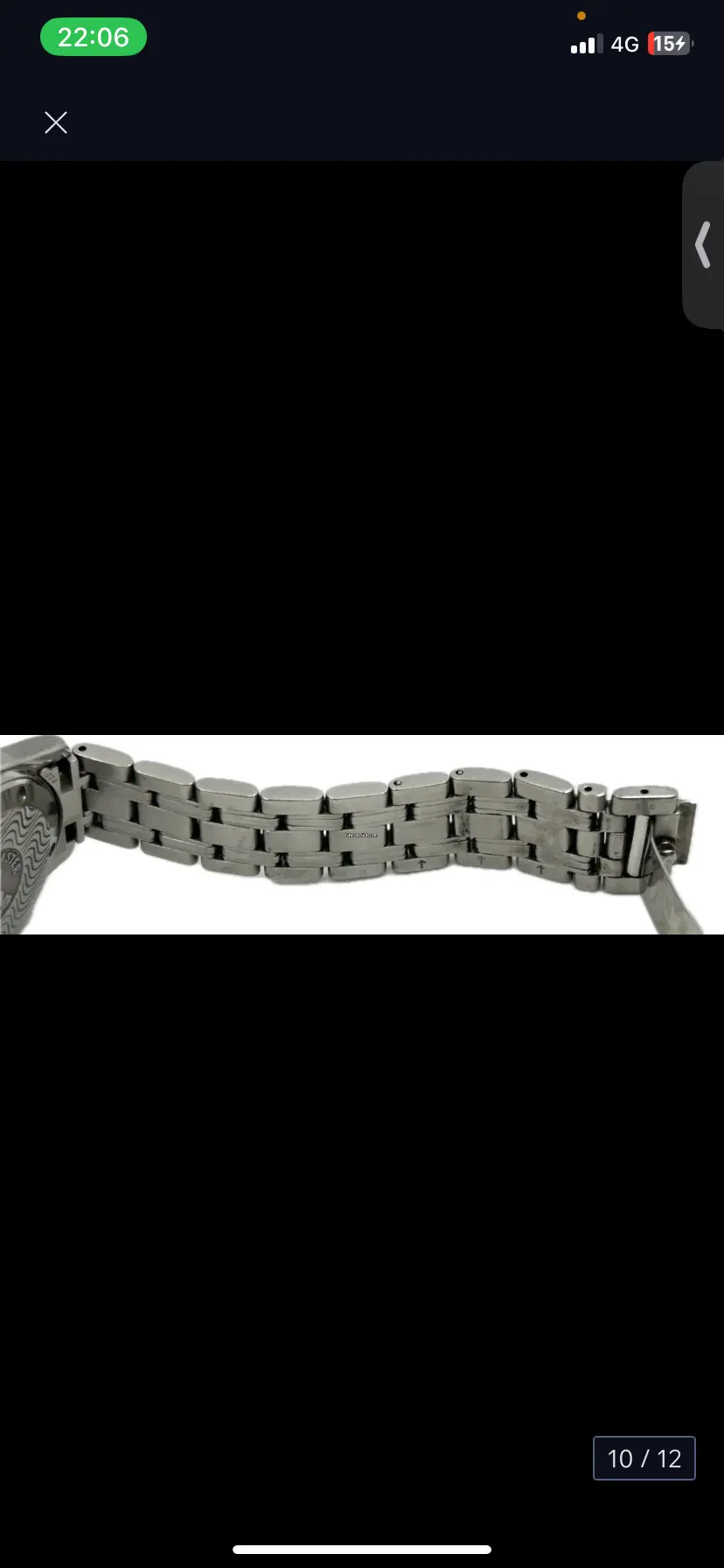

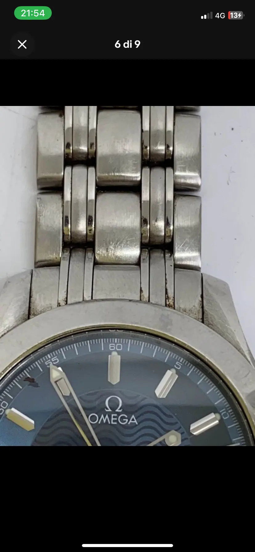

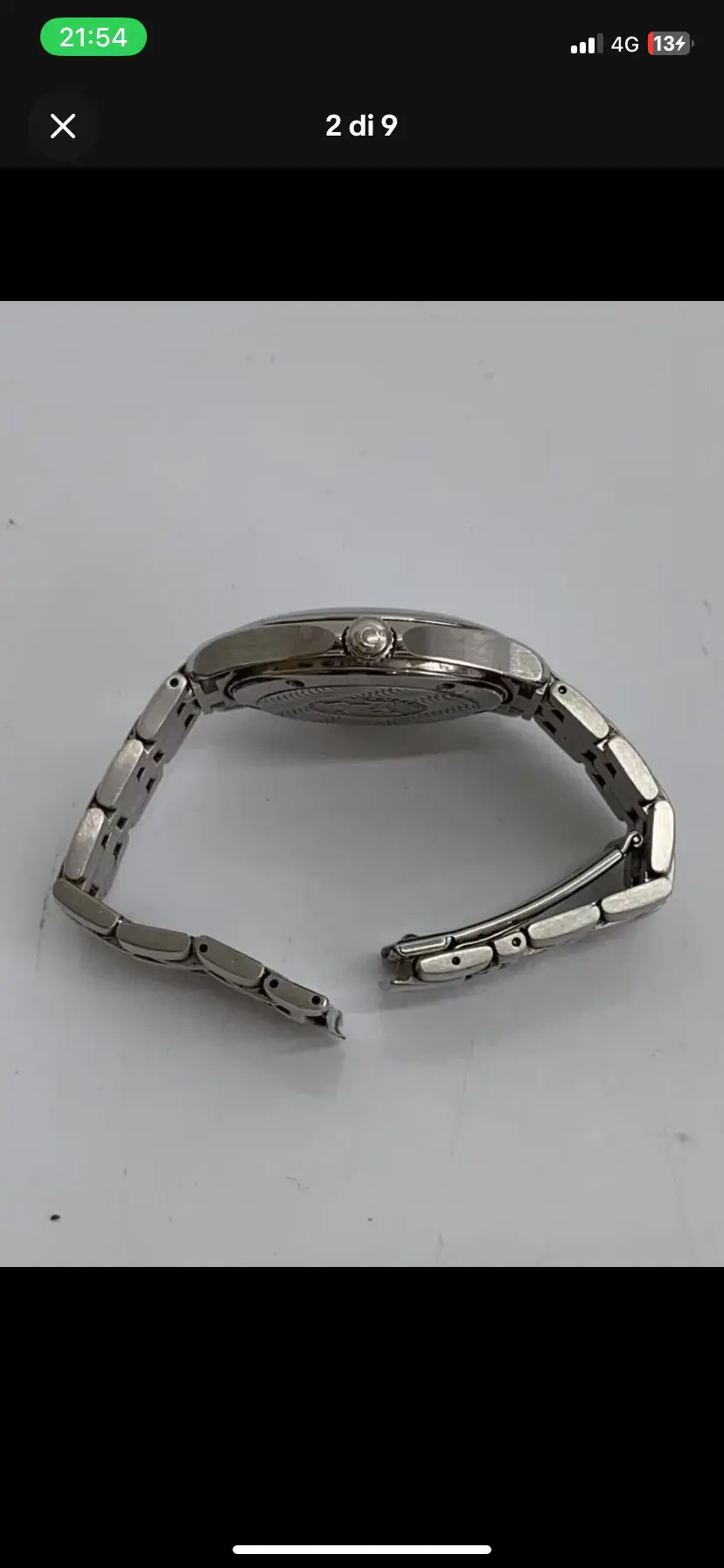

Both watches are quartz look like 2511.81? They both look legit IMO from outside, both appear polished (common in Japan), the Chrono24 one looks cleaner, and the dial on other one has something on edge of dial (?Crystal) between 10 and 11 markers. Bracelet on non-Chrono may be missing a link near clasp?
To me the Chrono one looks less worn in better condition.
Any service history?

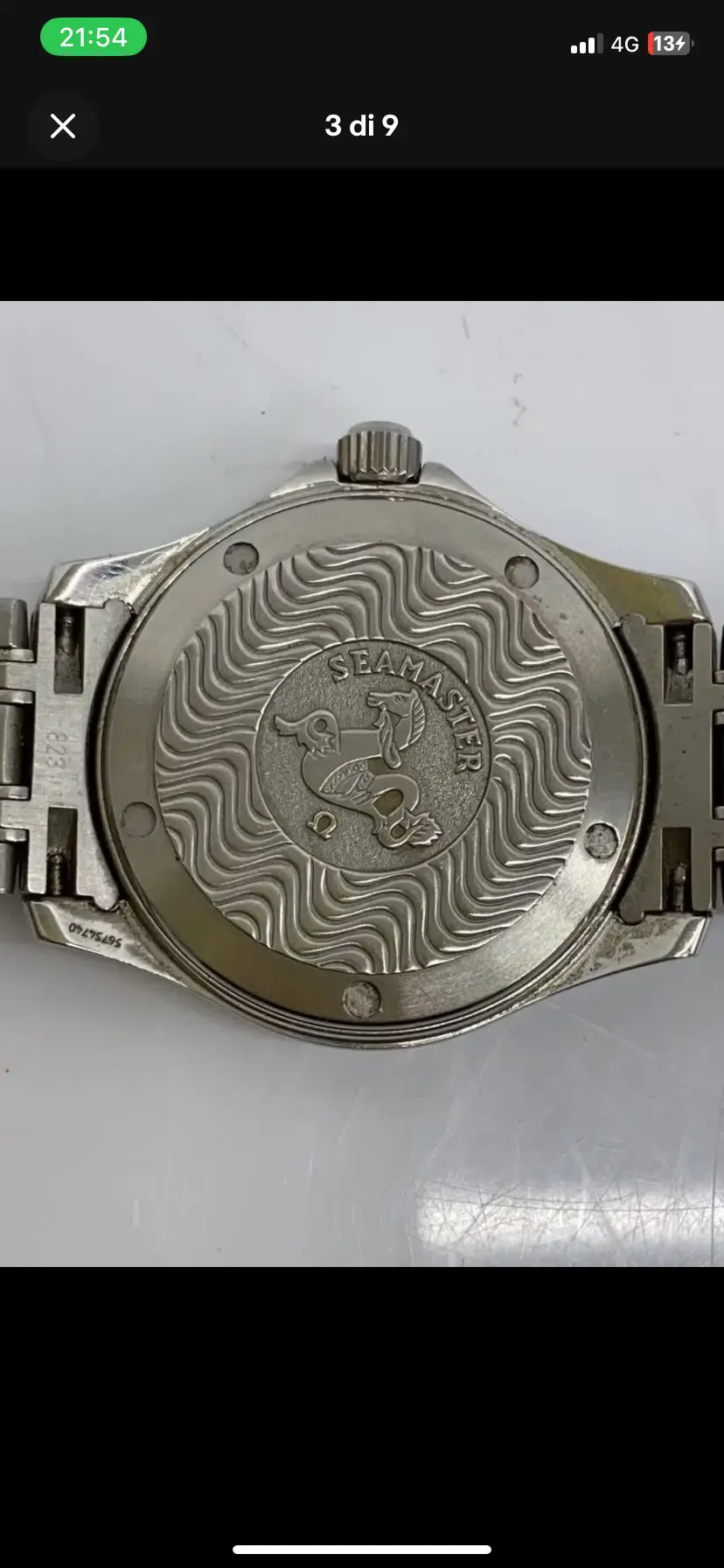

Member with access to Omega intranet can check SN and identify watch cal. Would be nice to see movement if possible.
Returns are more difficult to Japan but not impossible. Also consider tariffs

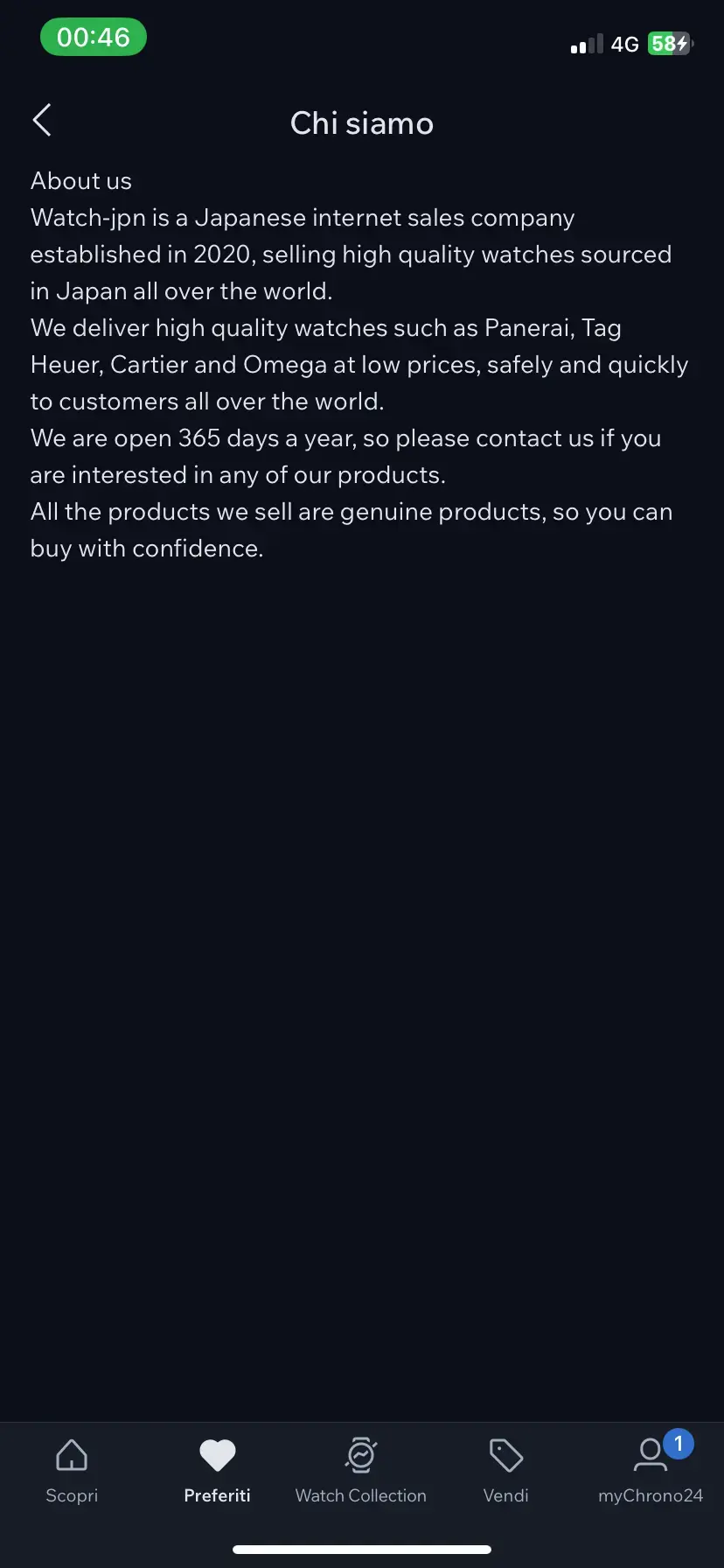

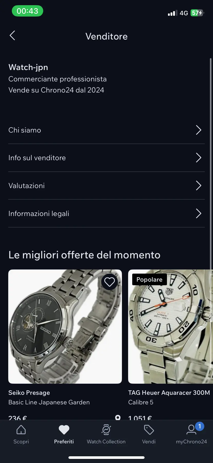

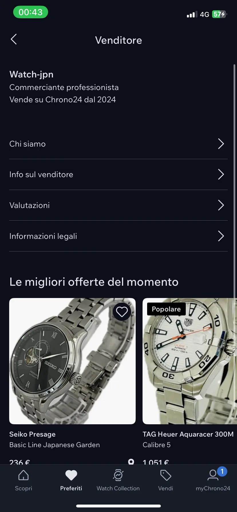

Is Chrono seller a dealer or Private seller? Dealers are required to provide return option is watch not as described. I would ask for movement photo. Who is seller? There are some well known dealers with good reputations.

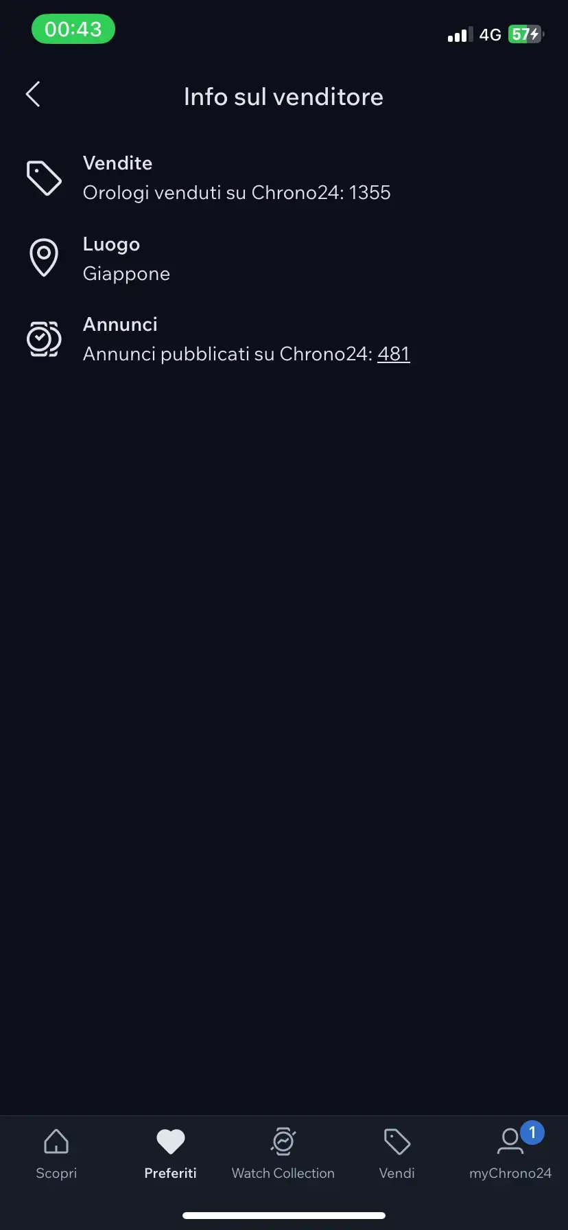

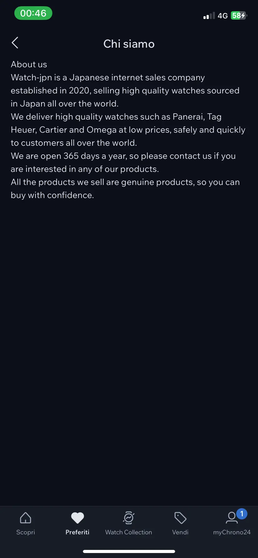

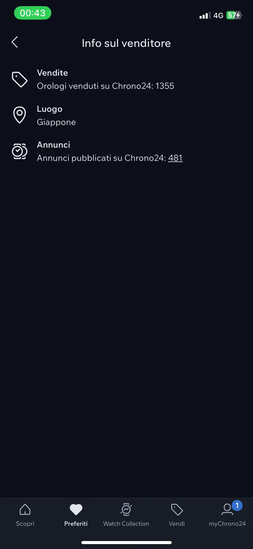

I’ll add two more pics, this is the seller is a dealer. The weird thing is that there is written that he sold more that what he published but i think that is the app that count that automatically

There isnt any specific policy about the store

If you search Omega 2511.81 in Chrono24 you will see your watch and also one from dealer Closer- the main photo is slightly at angle- they are a known and respected large volume dealer- many members here have been satisfied purchasing from them. The dealer you are looking at is probably ok too- but don't know history.
Keep in mind returns are more cumbersome to Japan- but hopefully not necessary.
Hope this helps- good luck

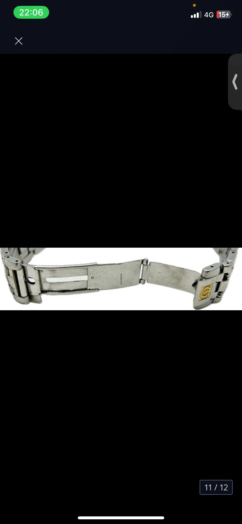

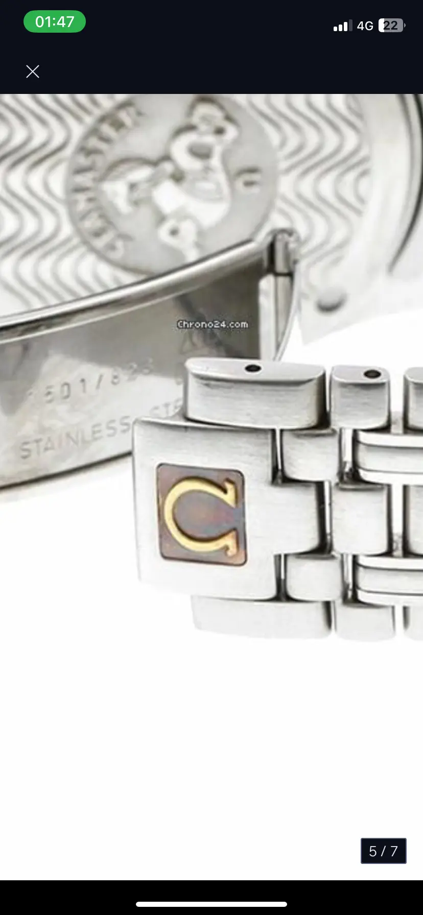

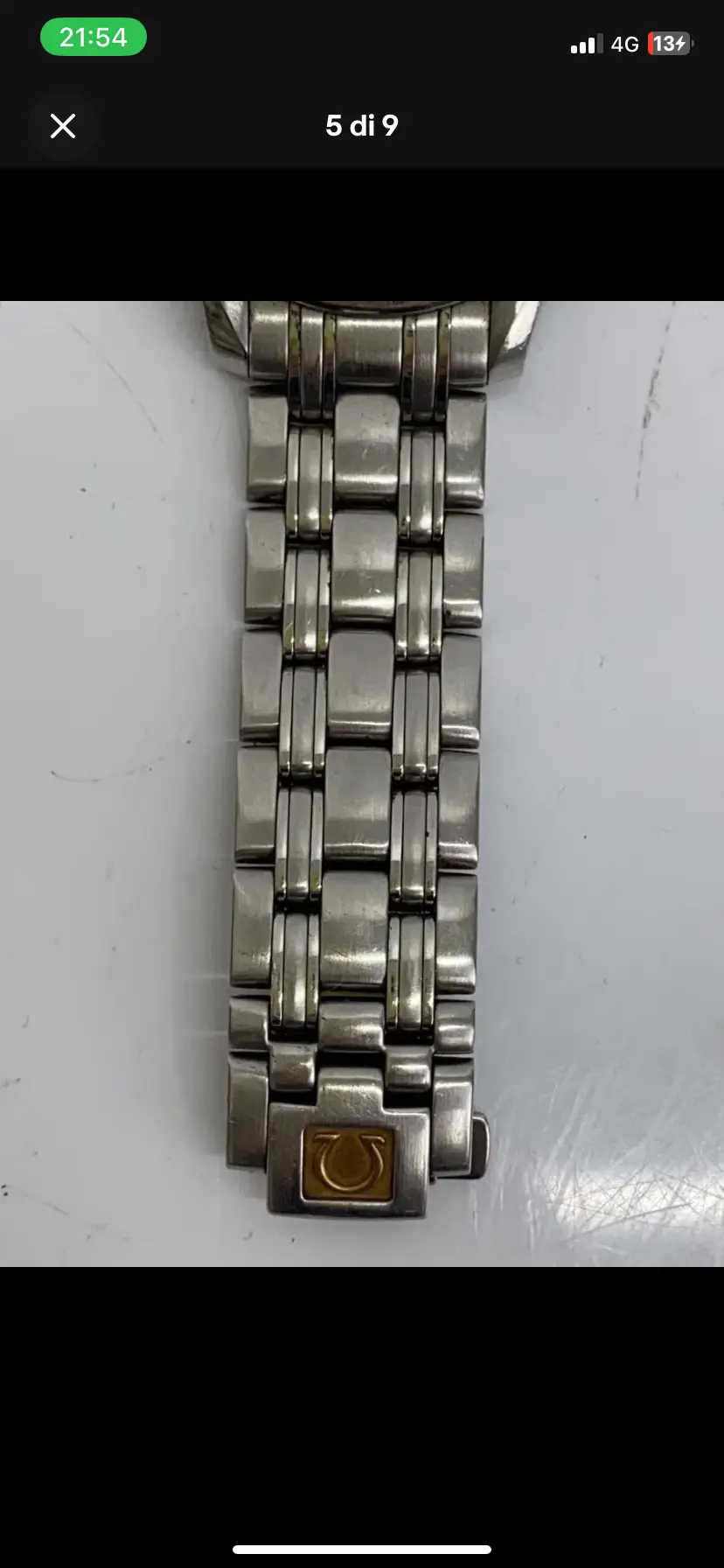

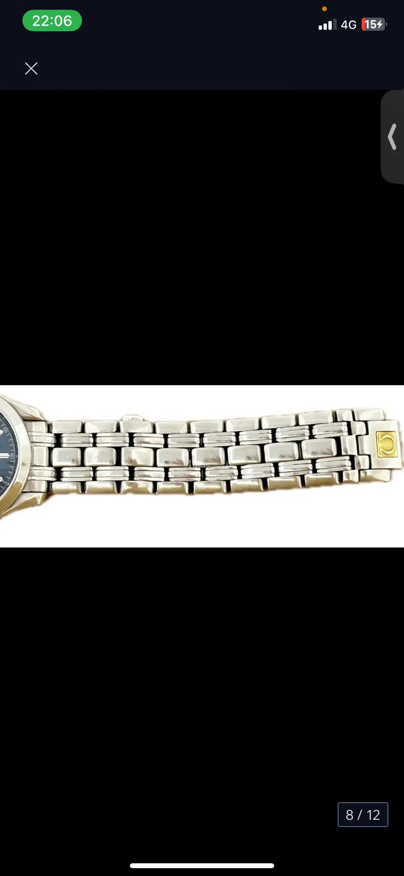

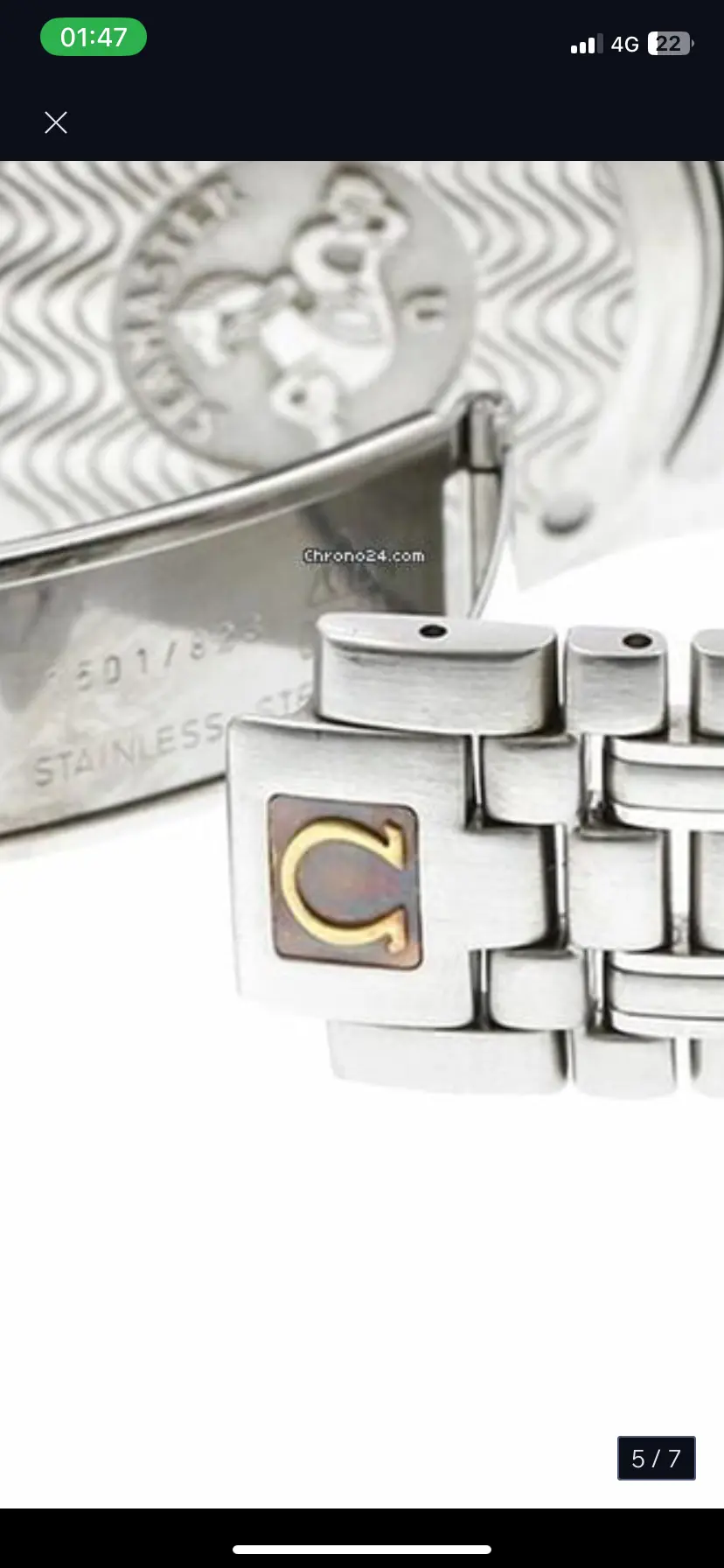

Sry if i keep bothering, do u think that it is normal for the golden logo to be this ‘rusted’ as i don’t know the material used, maybe brass it make me think? also i was hoping for a response from the dealer about the serial number on the card but he isnt answering, i just think that is blurred on that pic, i hope..

I wouldn’t worry about the gold logo it looks like tarnish to me and should clean easily.

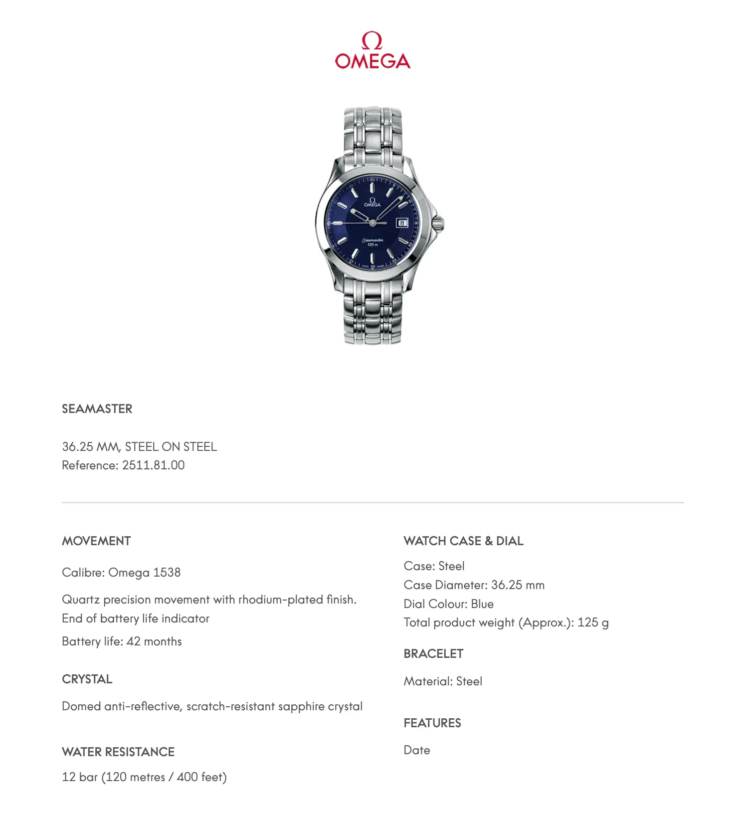

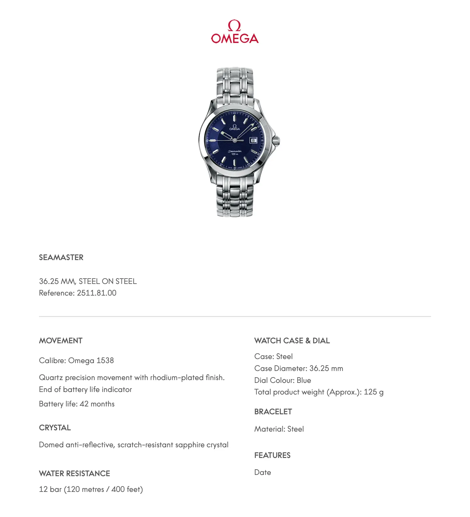

Regarding the number of ticks per second these watches come with quartz movement which will tick 1 time per second.
The automatic mechanical version will beat multiple times per second, ranging from 5 beats per second for a slower frequency watch (18,000 bph) up to 10 beats per second for faster frequency watch (36,000 bph). A medium frequency watch is 28,800 bph and ticks 8 times per second.

how is it possible for the same 2511.81 model of watch to have differents ticking per sec?
It is not possible. The Omega 2511.81.00 is a quartz watch and will tick once per second as @SOG53 explained.
The only variation is if it ticks once every two seconds. That the End Of Life (EOL) battery indicator telling you a new battery is needed.
If there are any descriptions that vary from this, the people stating these facts are incorrect.
