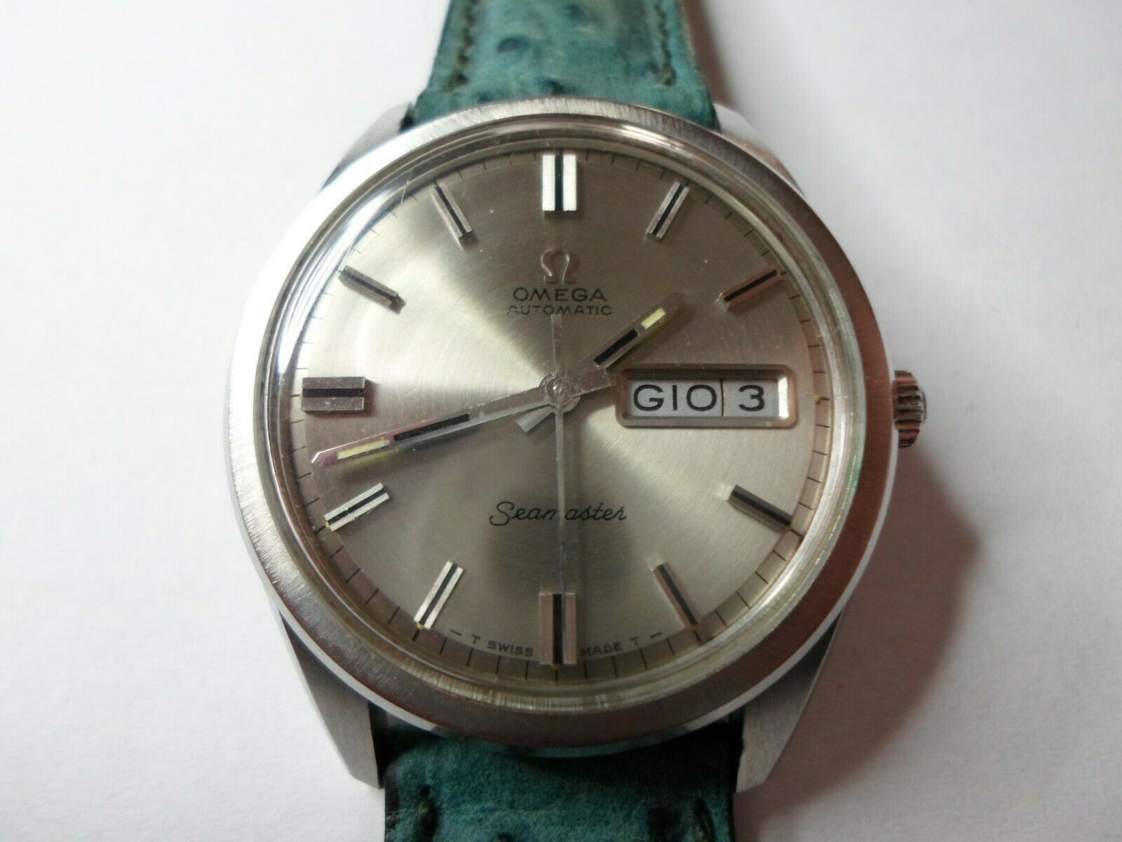

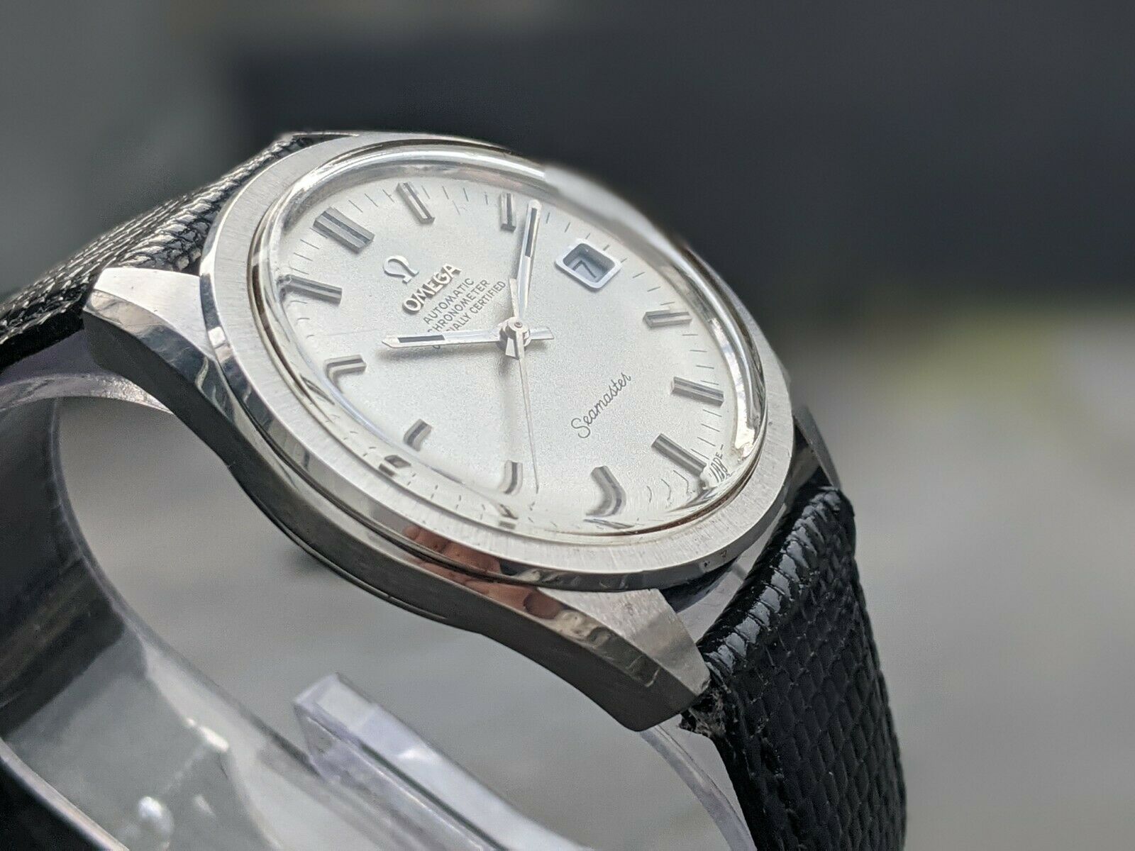

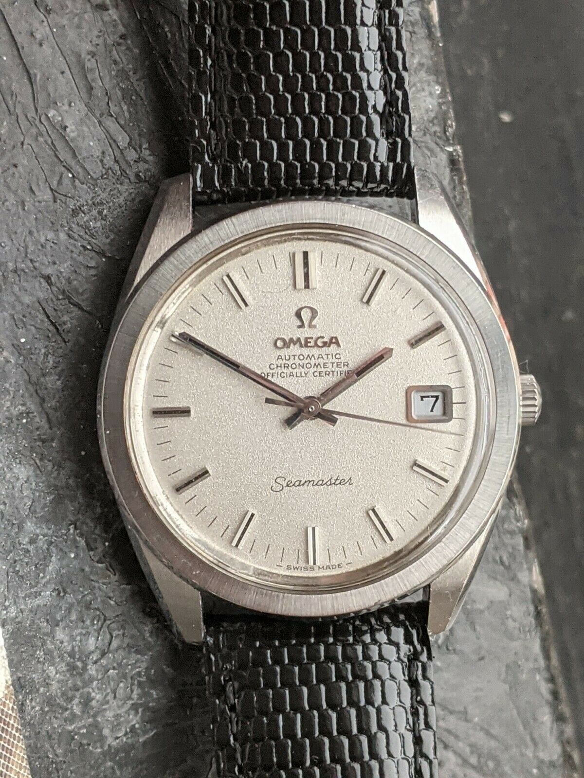

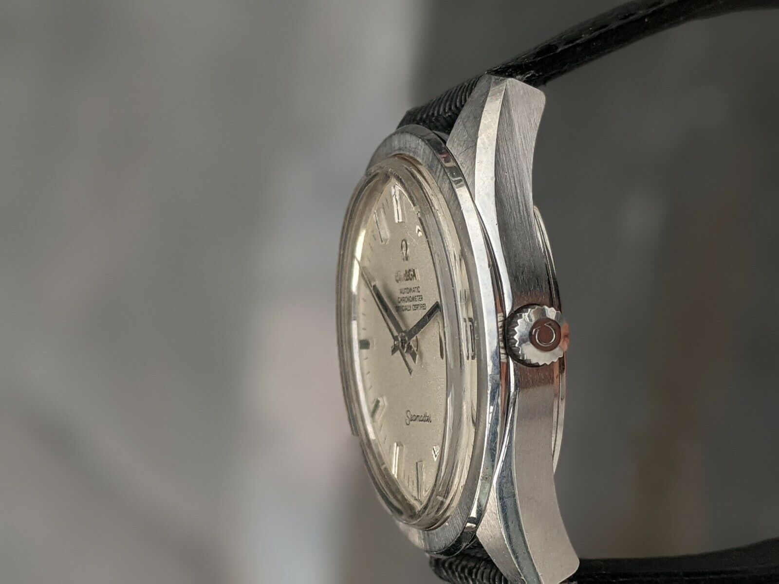

Hi guys . this is my first post here.
I am from Italy and I would like to add to my collection a vintage Omega.
In particuar I am interested in Omega Seamaster Cronometer 168.022 ,168.033, 168.032 , 167.005 reference.
I found this watch is in an auction today at about 450 euros.
What do you think about it?
How much should I bid?
Thank you very much
Andrea
495
1,210
Andrea-
Looks like a good example; everything looks correct and in good shape. These seem to go in the $1200-1800 range, at least from what I've seen (I can't tell any price difference between pie-pan sparkle dials and the flat ones, like this example, nor between day/date and date-only varieties). IF you can get it for under $1k, grab it. They're wonderful watches.
1,120
1,792
You can rest assured it won’t end at €450.

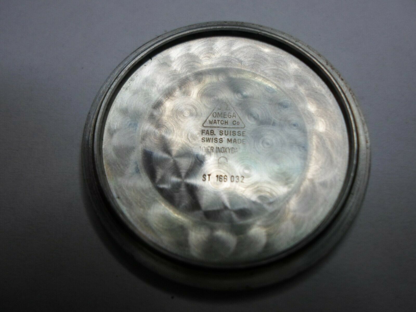

Yes I know 😀 I asked becouse I am not a vintage expert and I wanted to know how much I should bid for an honest price.

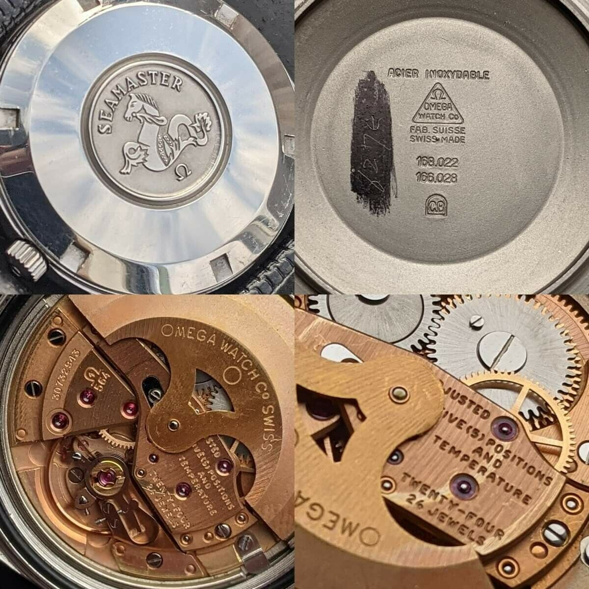

Regarding the double reference number, what does it mean?
1,120
1,792
By sharing case backs across two models it would have helped Omega minimise on parts and keep costs down. The 166.028 is a non chronometer version which shares the same case.

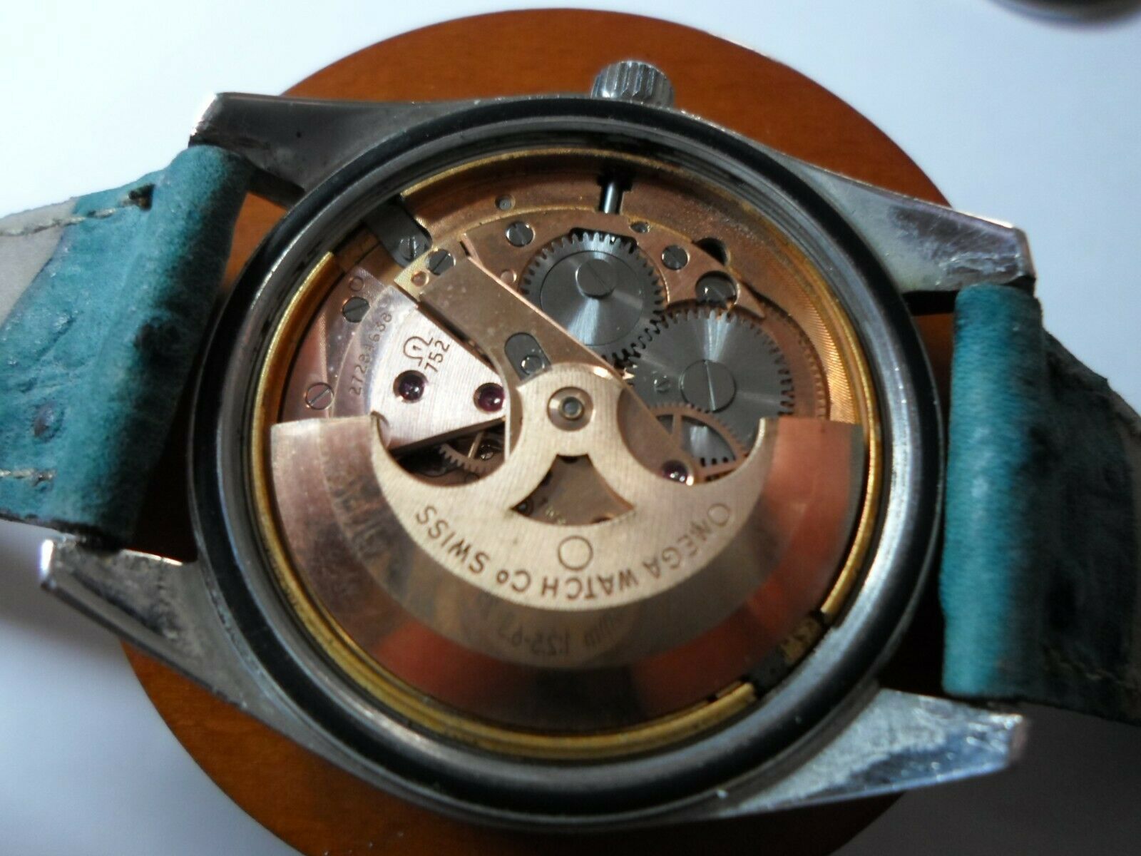

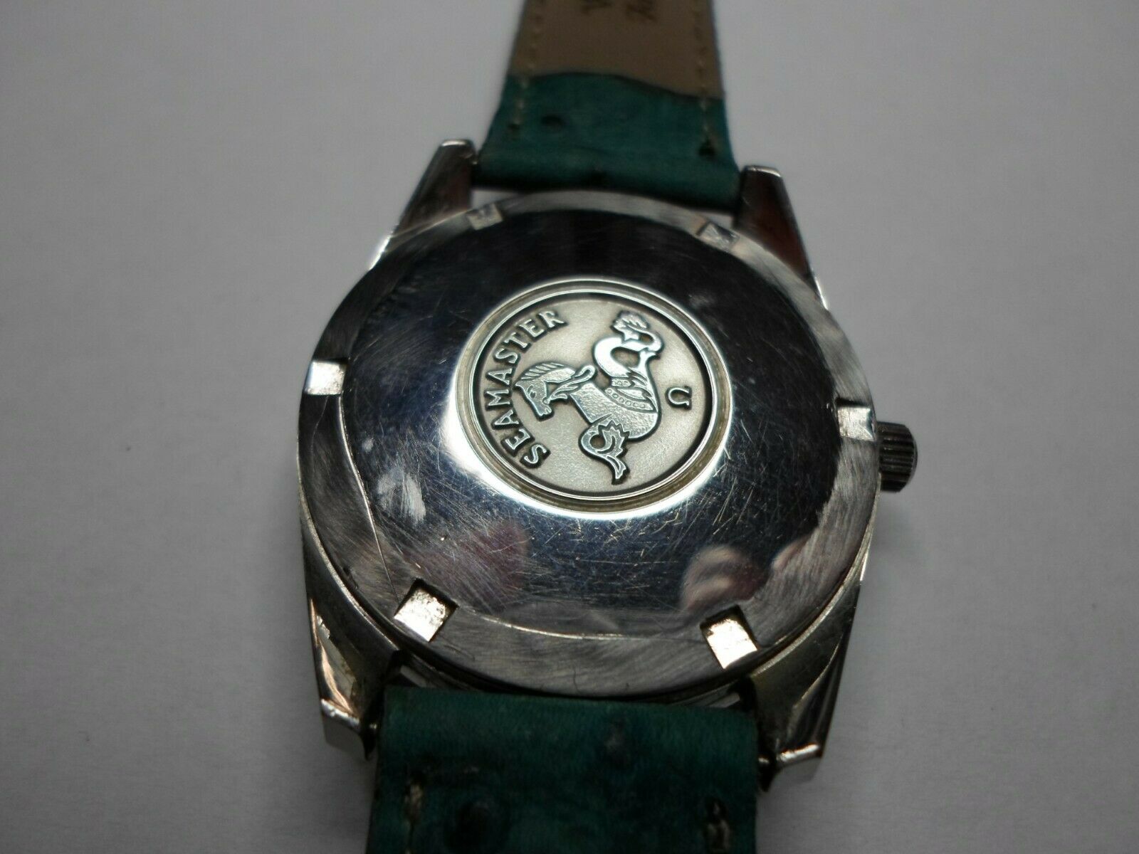

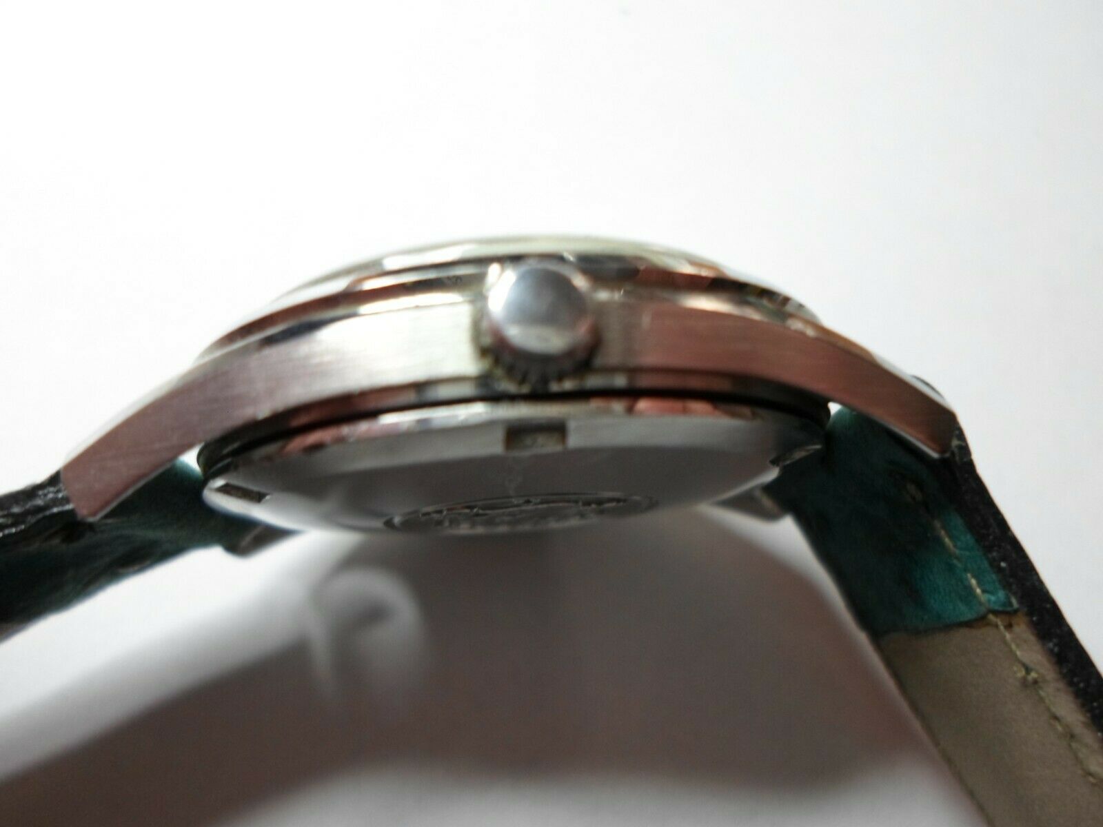

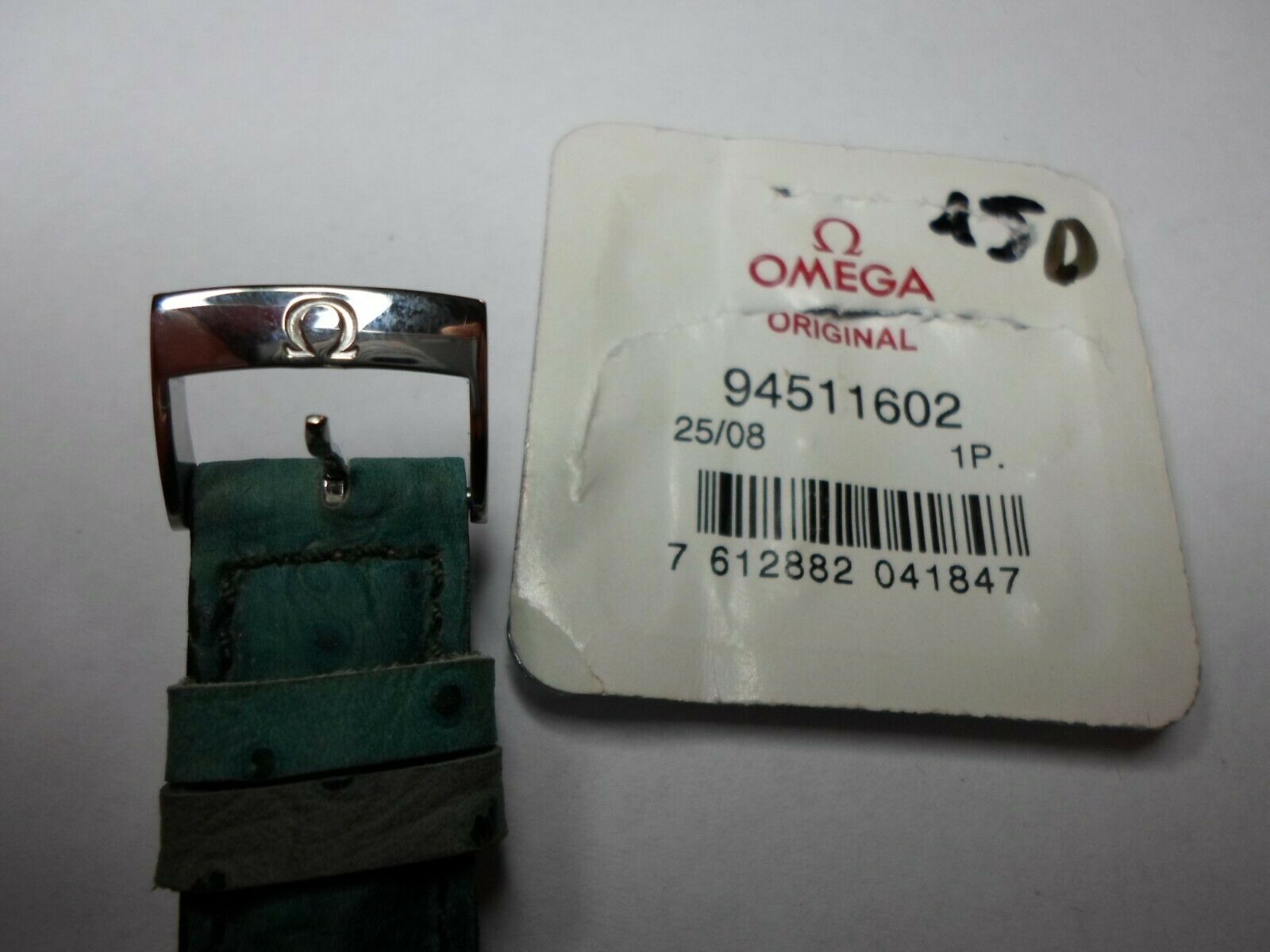

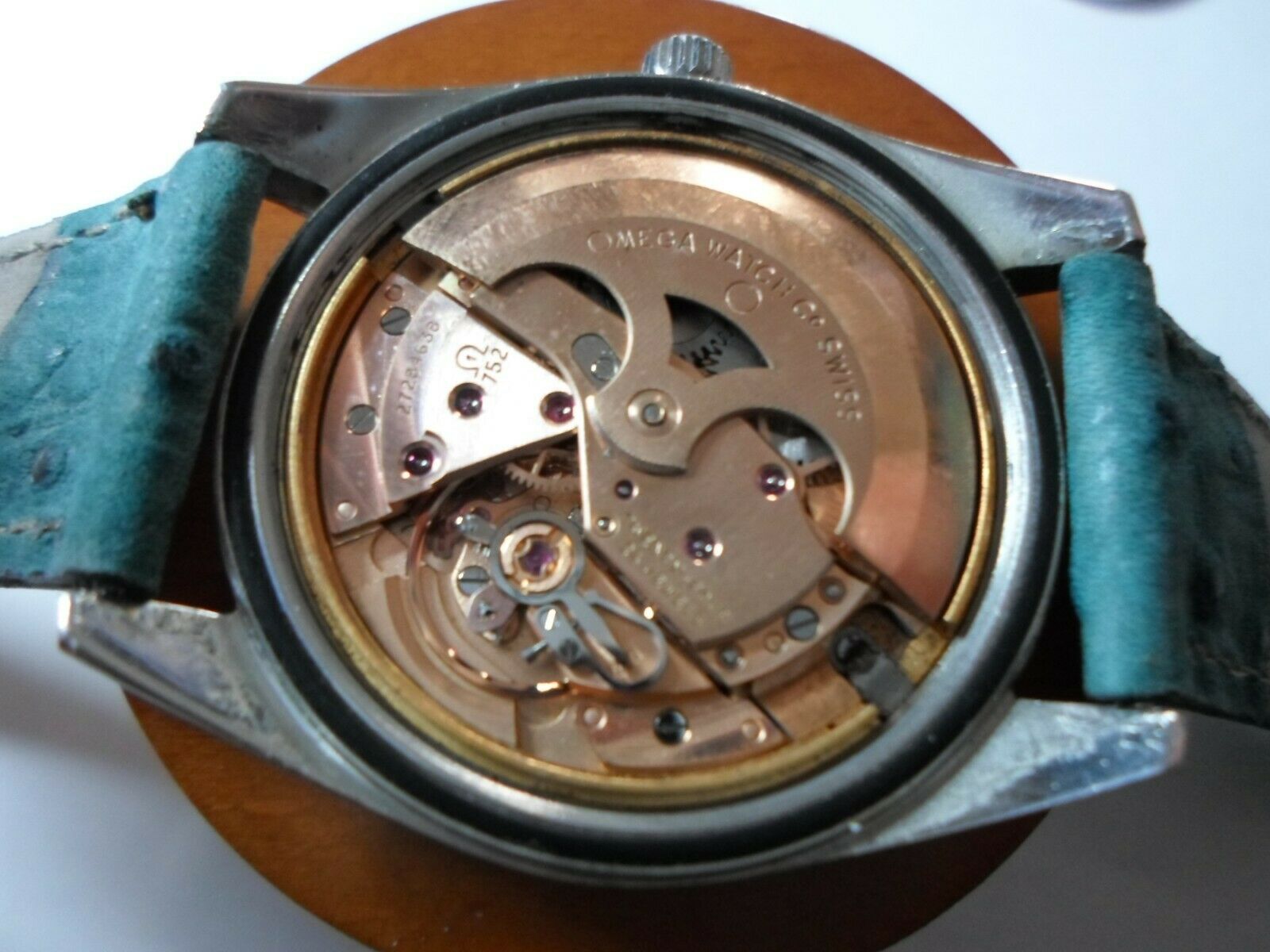

I spotted another similar watch that costs under 1000 euro. But it seems to me having a few issues.
- winding crow not original
- bucket not of the same age of the watch
- maybe over polished.
Am I missing something? I am trying to learn 😀
495
1,210
It's the non-chronometer version, which takes some percentage off, and, yes, the crown's been replaced at some point. The caseback doesn't look great, either. A standard 166.032 usually goes for around $600, at least on ebay, that I've seen. If you like the style, you really can't go wrong--they're wonderful watches.

It’s difficult to see the lugs properly but judging by the bezel condition it doesn’t look over polished.
The scratches on the case back look quite deep. Some clumsy person has slipped trying to get the back off!
Dial side looks nice, not sure about the crown.
The buckle is a modern replacement - but I wouldn’t worry too much about that.
