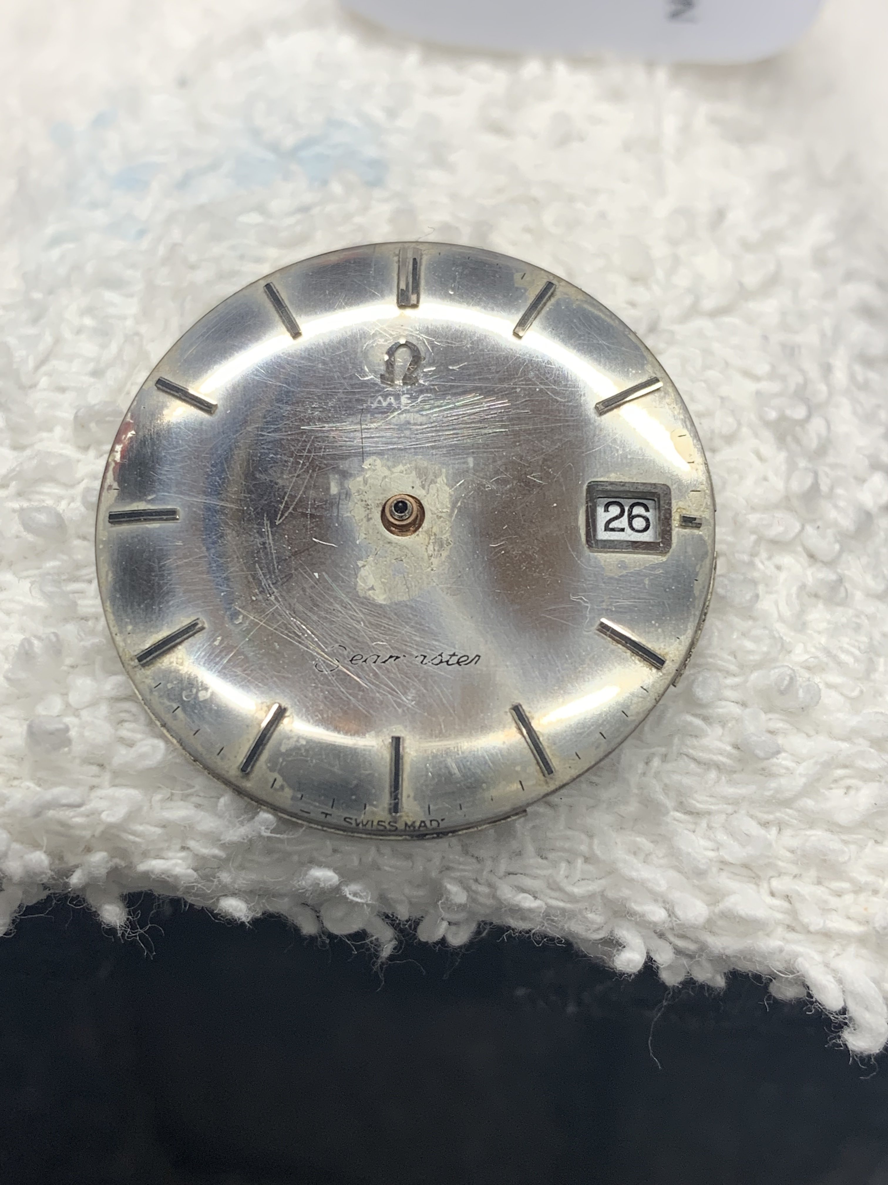

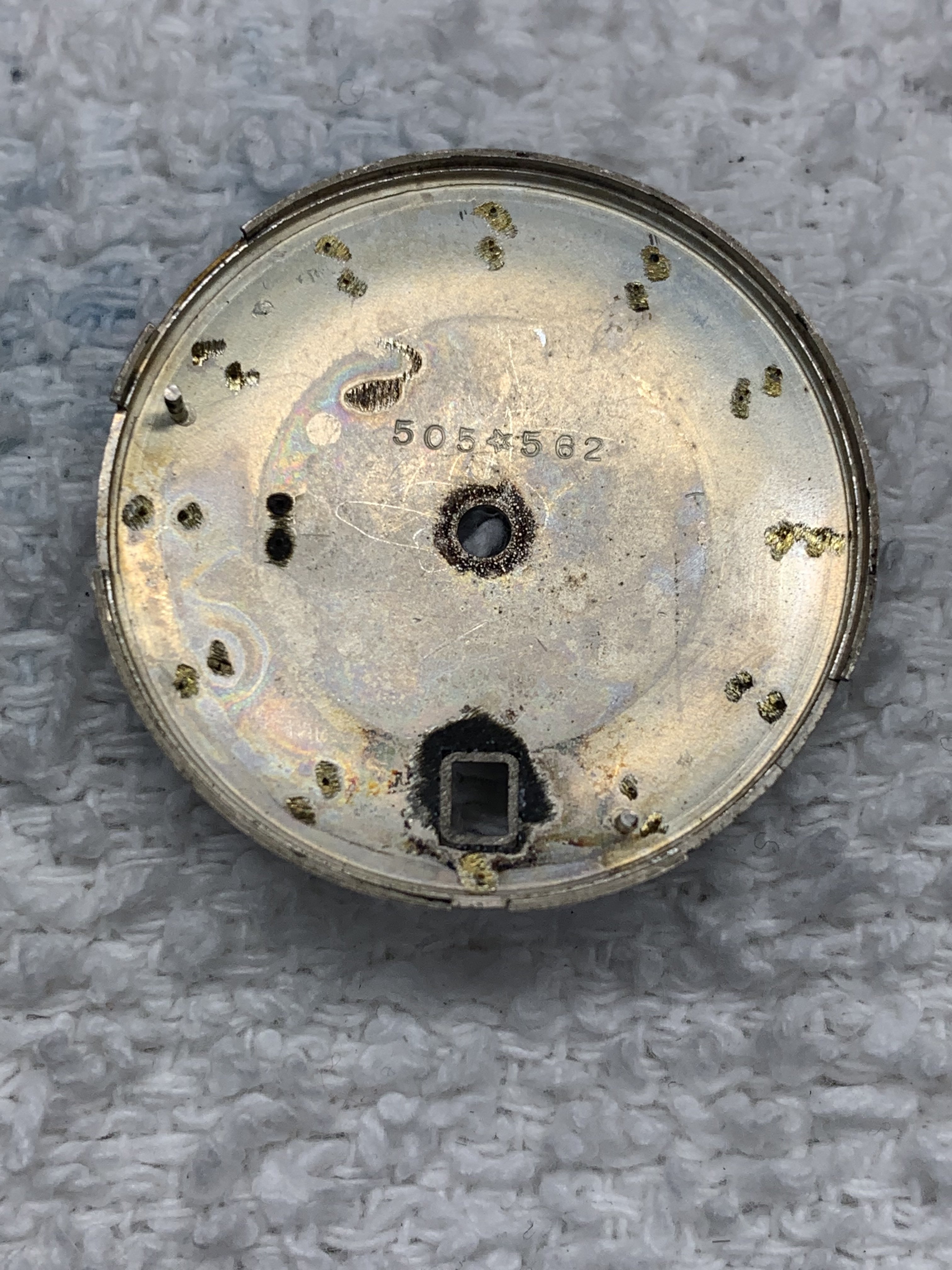

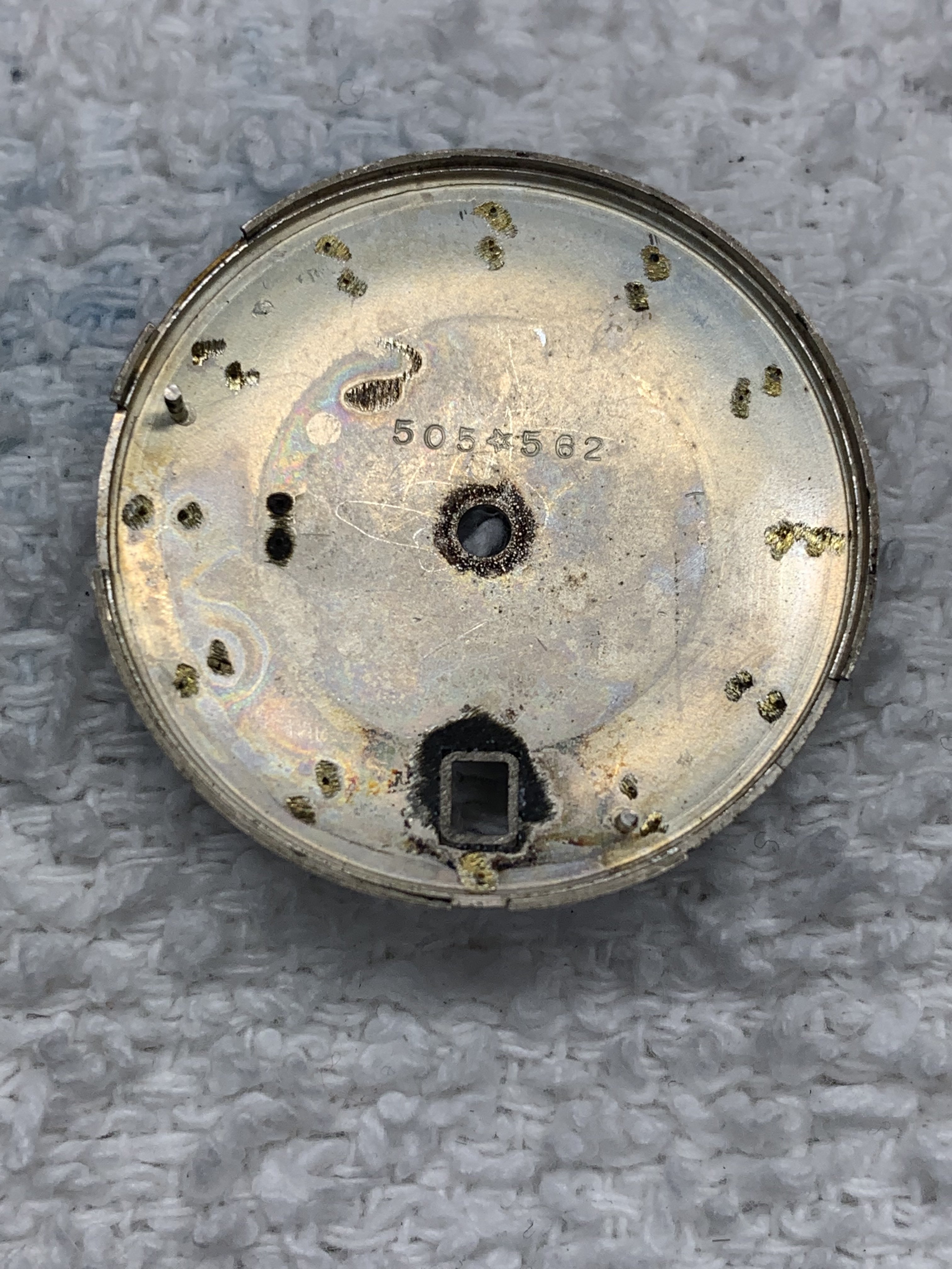

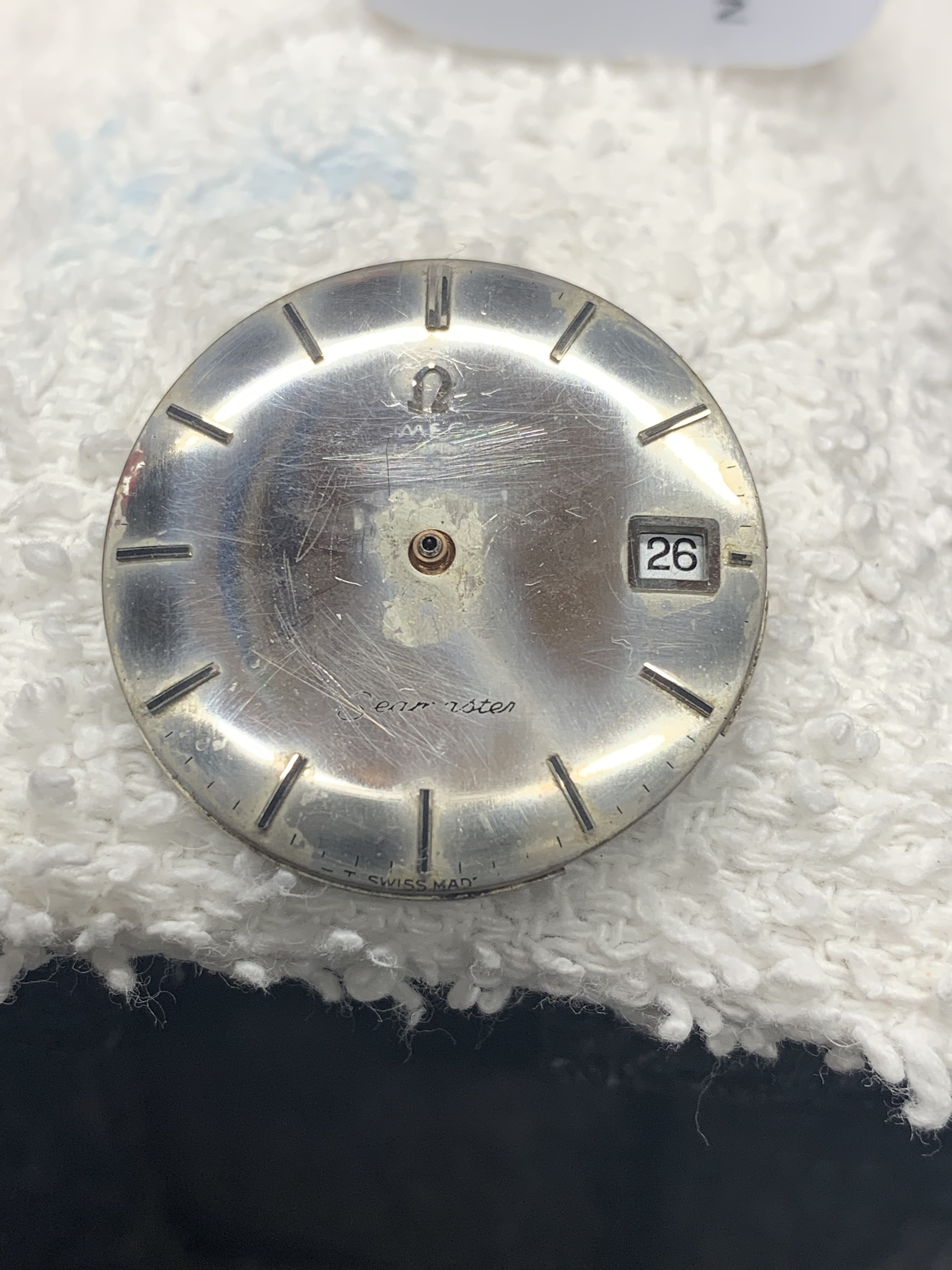

The dial for this reference wraps around the side of the movement, sort of creating a bit of a movement holder / enlargement ring. You can see the edge of the dial between the movement and case in the pics below. Sections of the sides are cut-out to leave room for the clamps and stem.
21
20
You could have a seamaster with a special dial with cutouts (see attached picture of my old dial) that helps lock in the movement to the dial and then uses conventional case clamps. I am sure this type of dial has a “name” if any of the seamaster experts care to share the “actual name” that would be appreciated by everyone.
