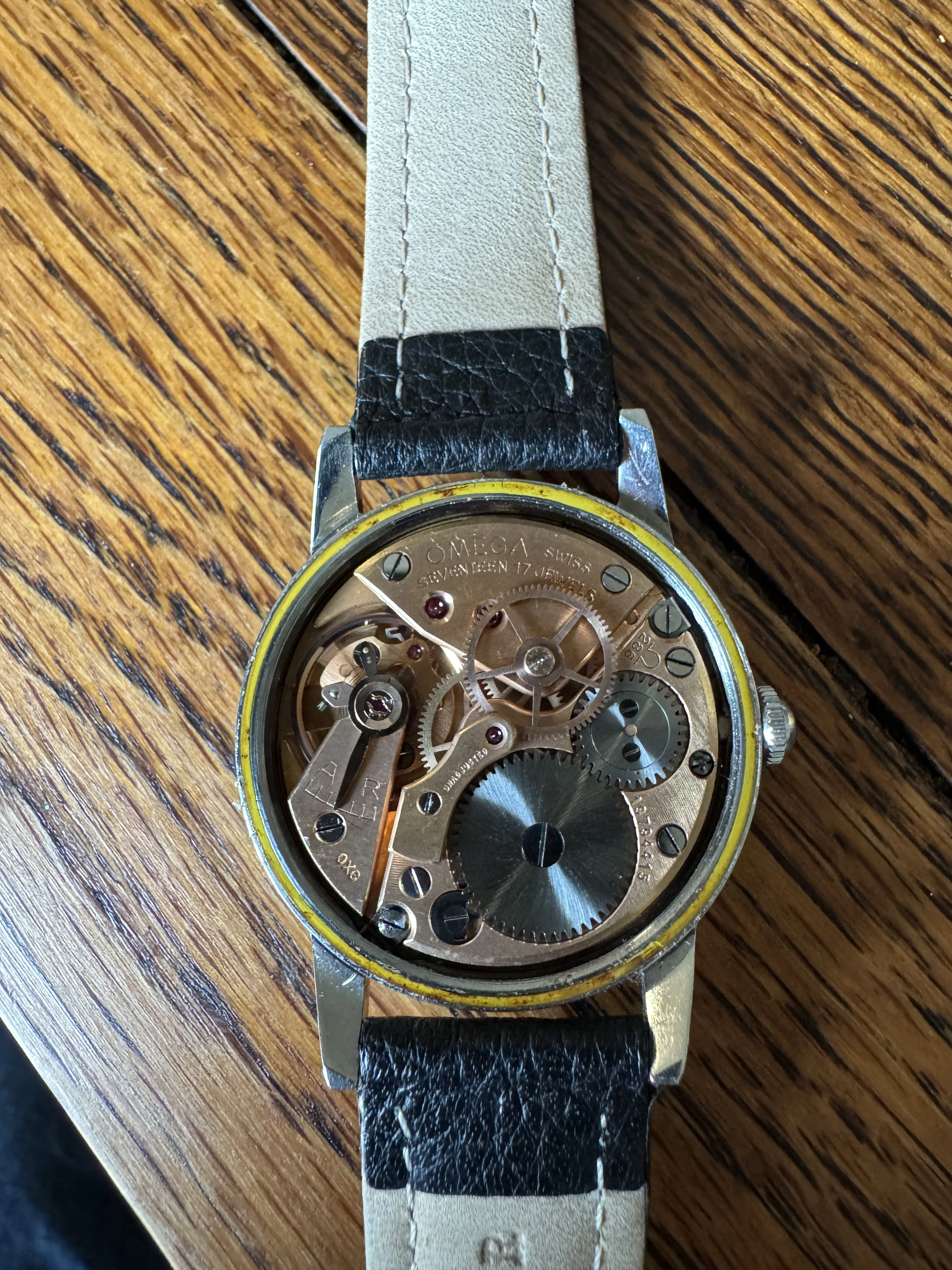

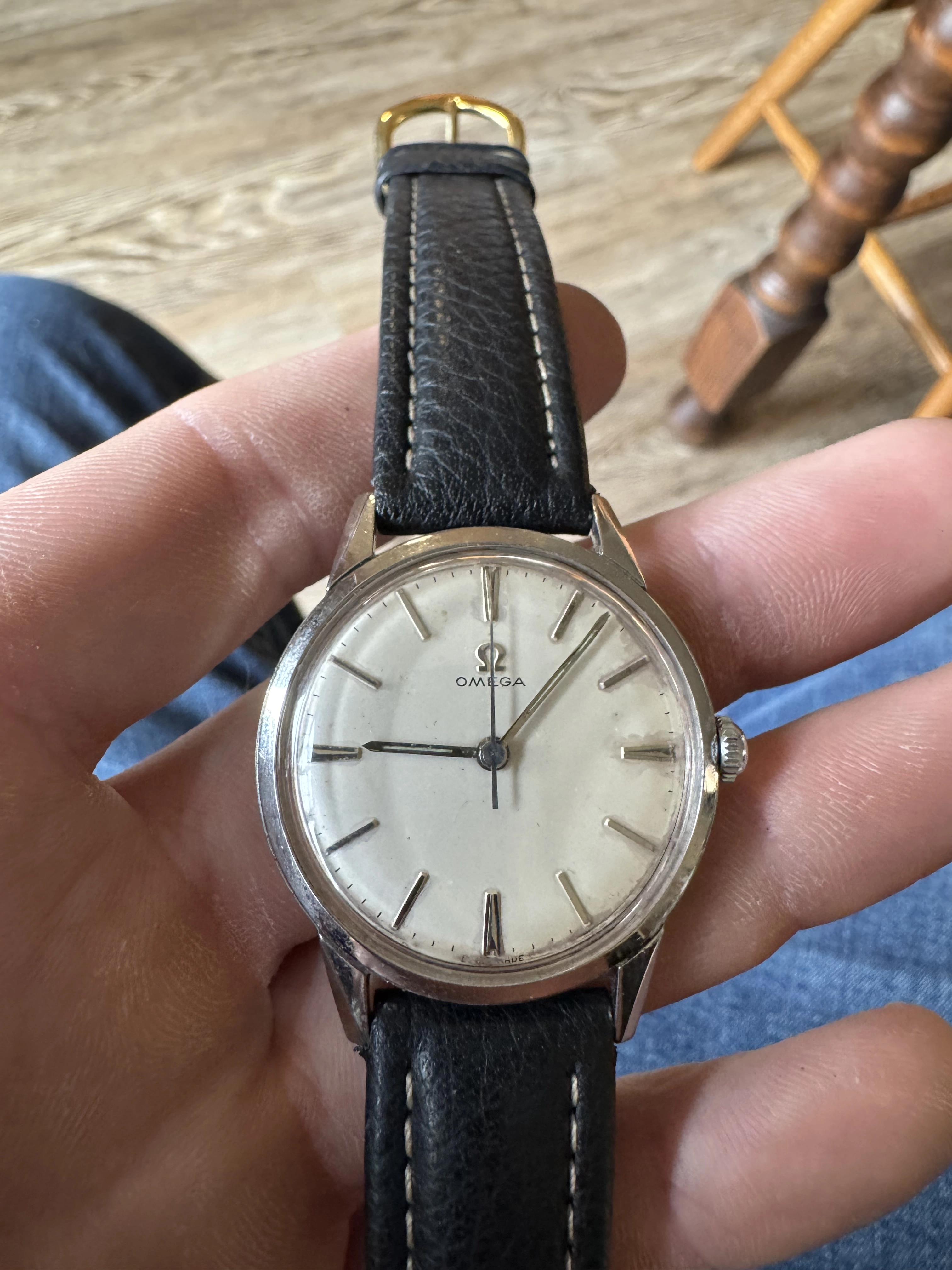

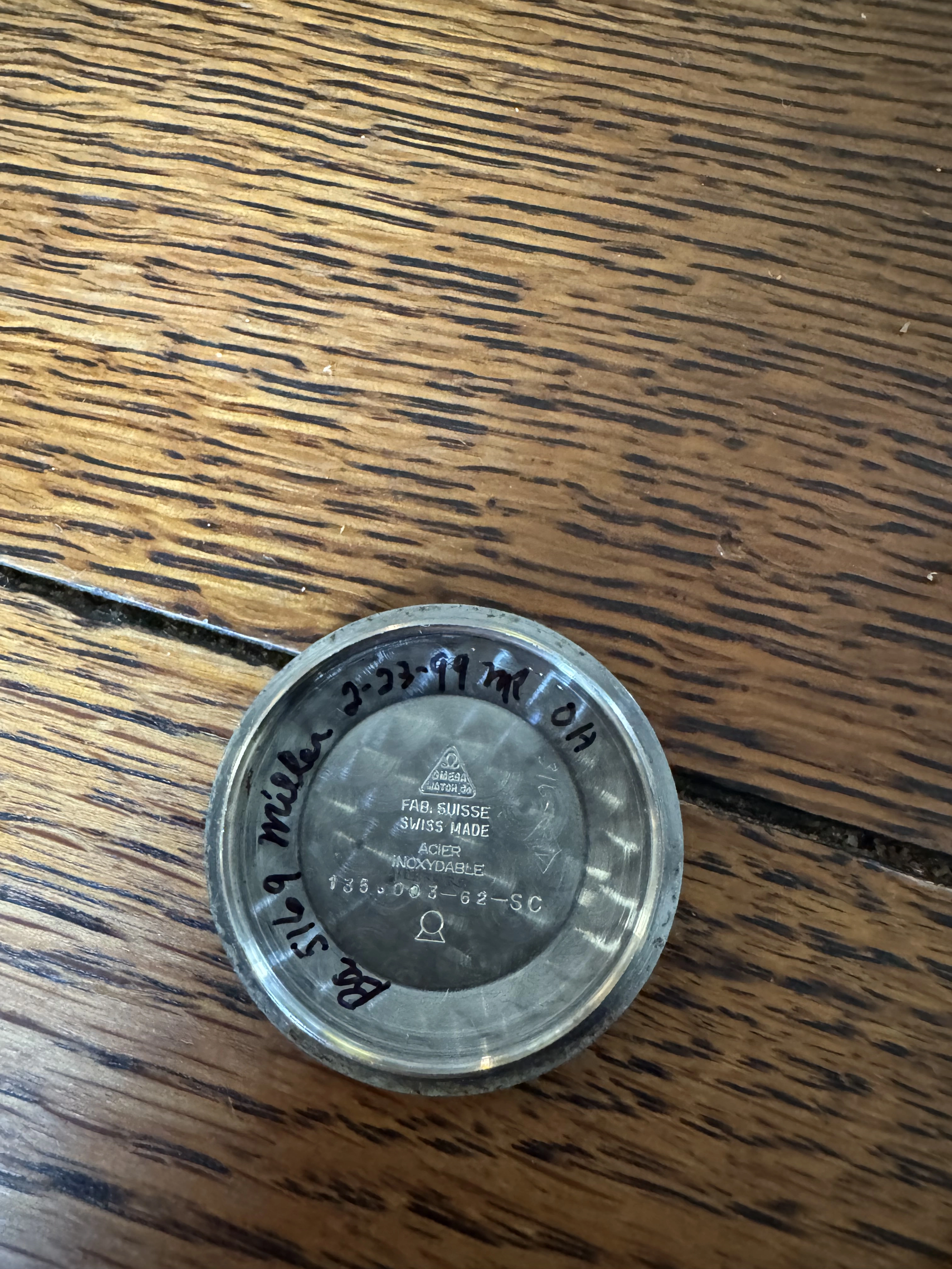

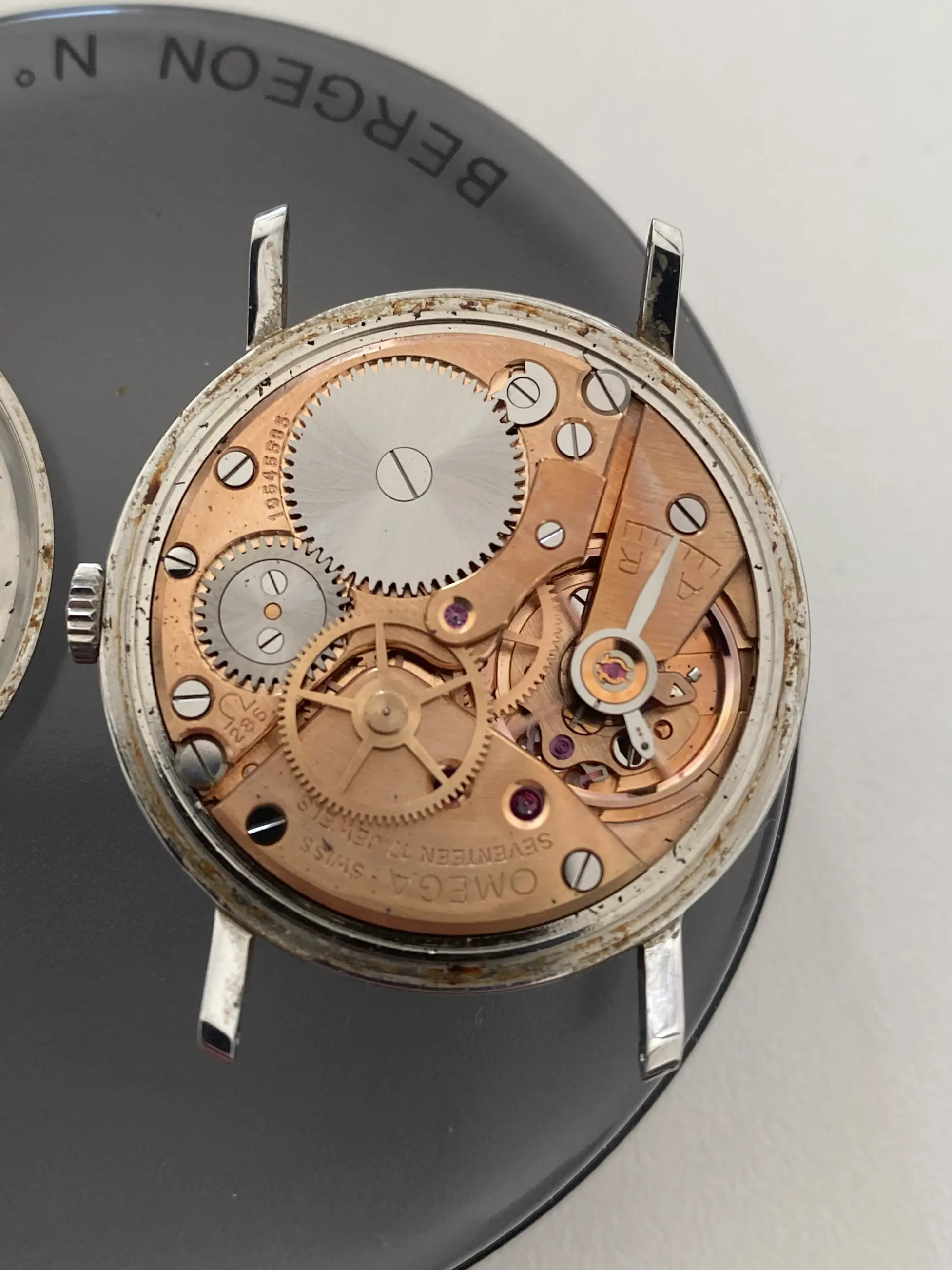

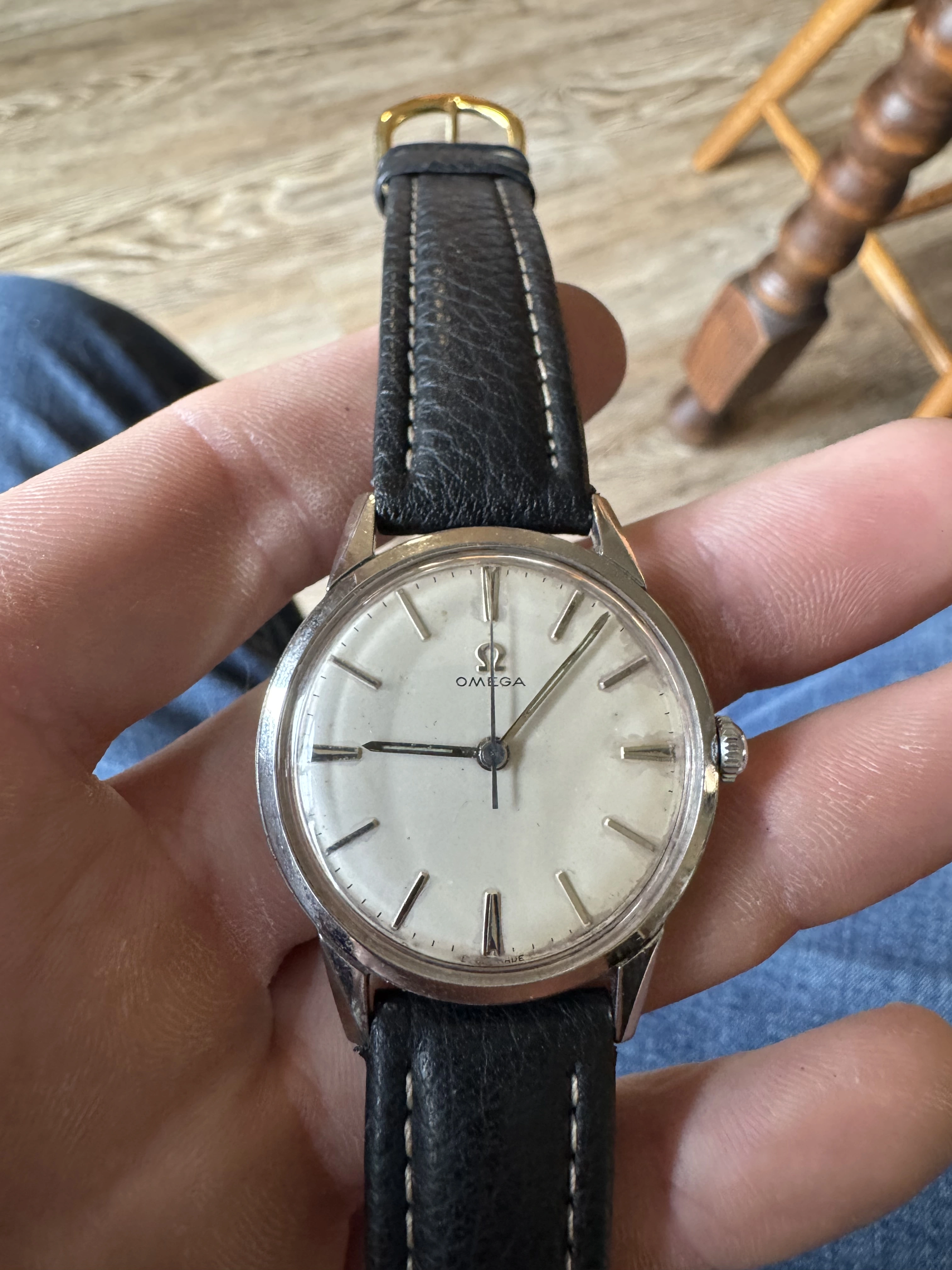

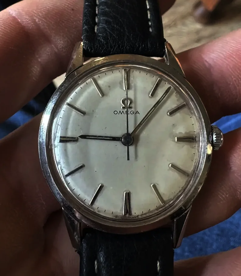

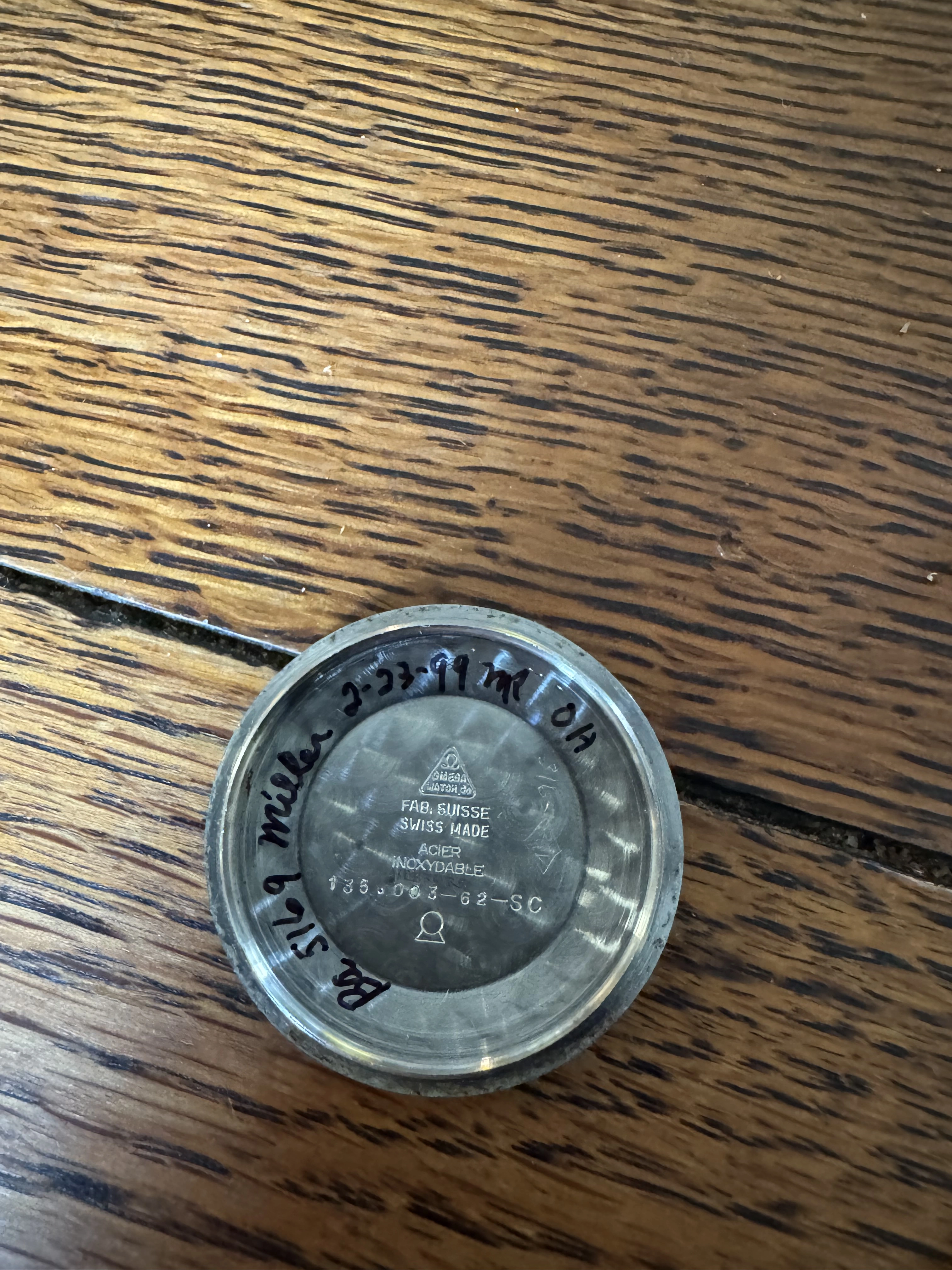

Hey there, I just got this watch and cracked it open and saw what looks to be a SEAMASTER 30 from around 1962-63 but there are no SEAMASTER engravings on the dial or the back plate. I was wondering if these were from a different watch or aftermarket parts. I would love the input I’m super curious.

and saw the reference, that stands for different executions from a watch, that also
can be a Seamaster

Please help me understand your comment. I have zero knowledge and want to learn more about this watch so any good informan will help..

evering is ok - it is a Omega
would be the dial Seamaster signed and the caseback Seamaster
engraved, it would be a Omega Seamaster

So that means it’s not a seamaster, but now I’m curious what it would be classified as?

it is part of a merketing strategy to create different modell lines,
such as seamaster, constellation ...
these lines stands for different attributes, that are also vissible
for the clients by engravings ...
so the seamaster line for example stands for/suggested a higher value product,
as a "only" Omega basis product

Understood. Thank you I appreciate the help

explanation for the TS:
bad dial - movement the part with most value. complete watch not more

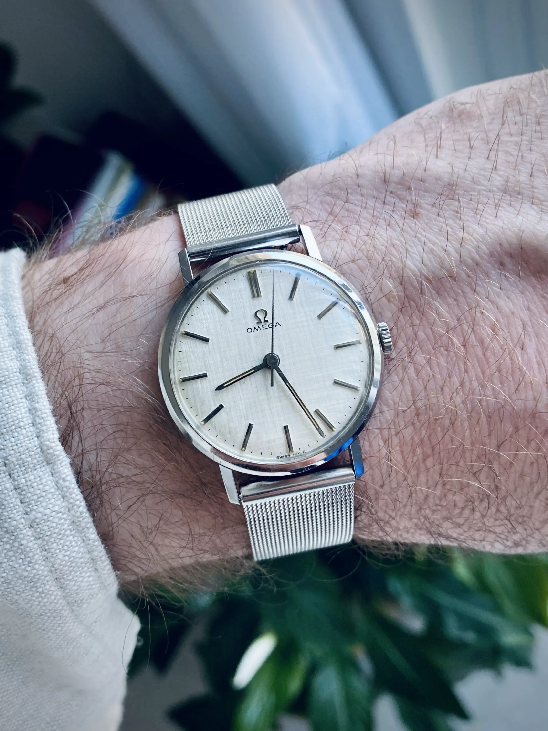

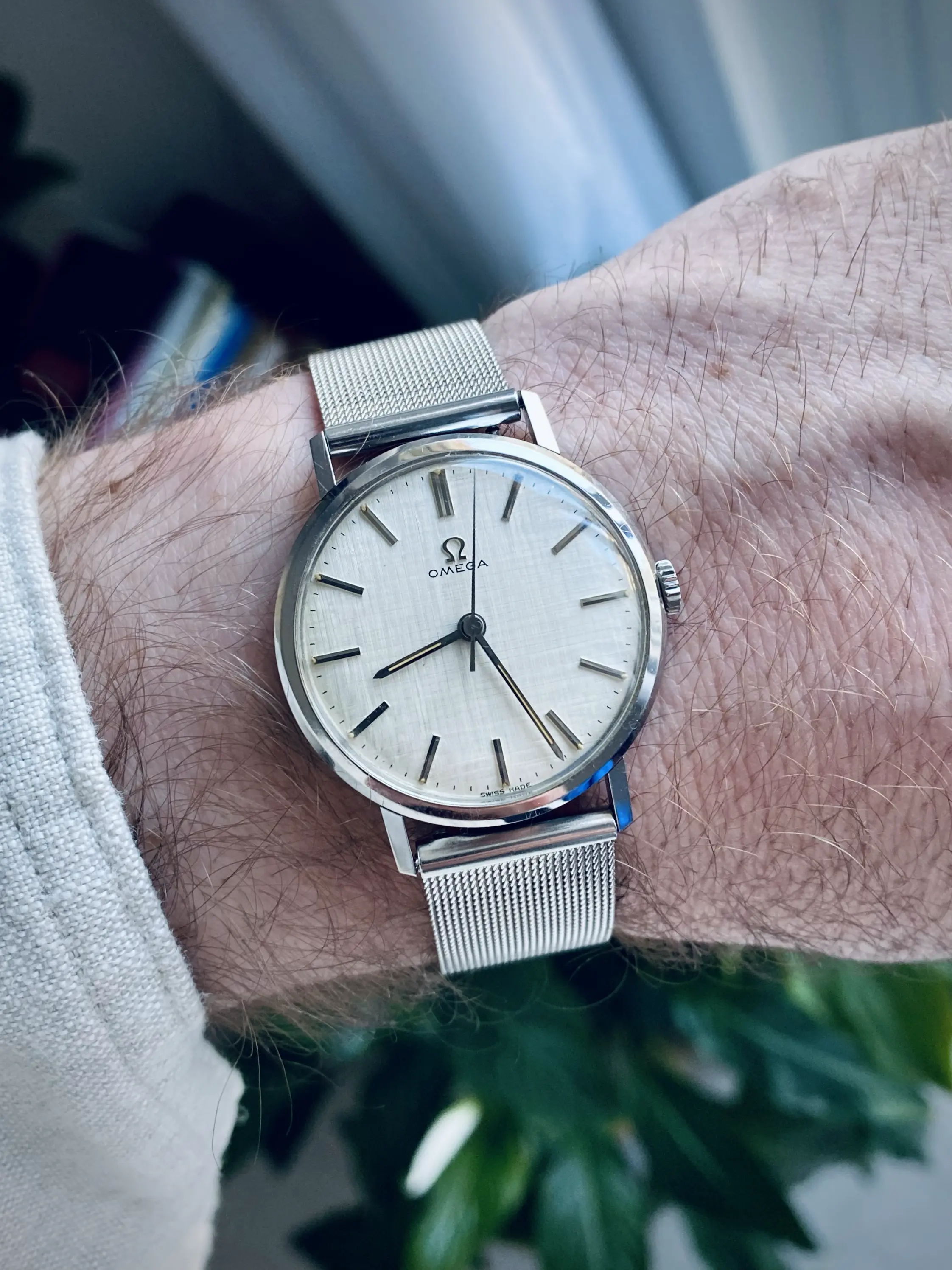

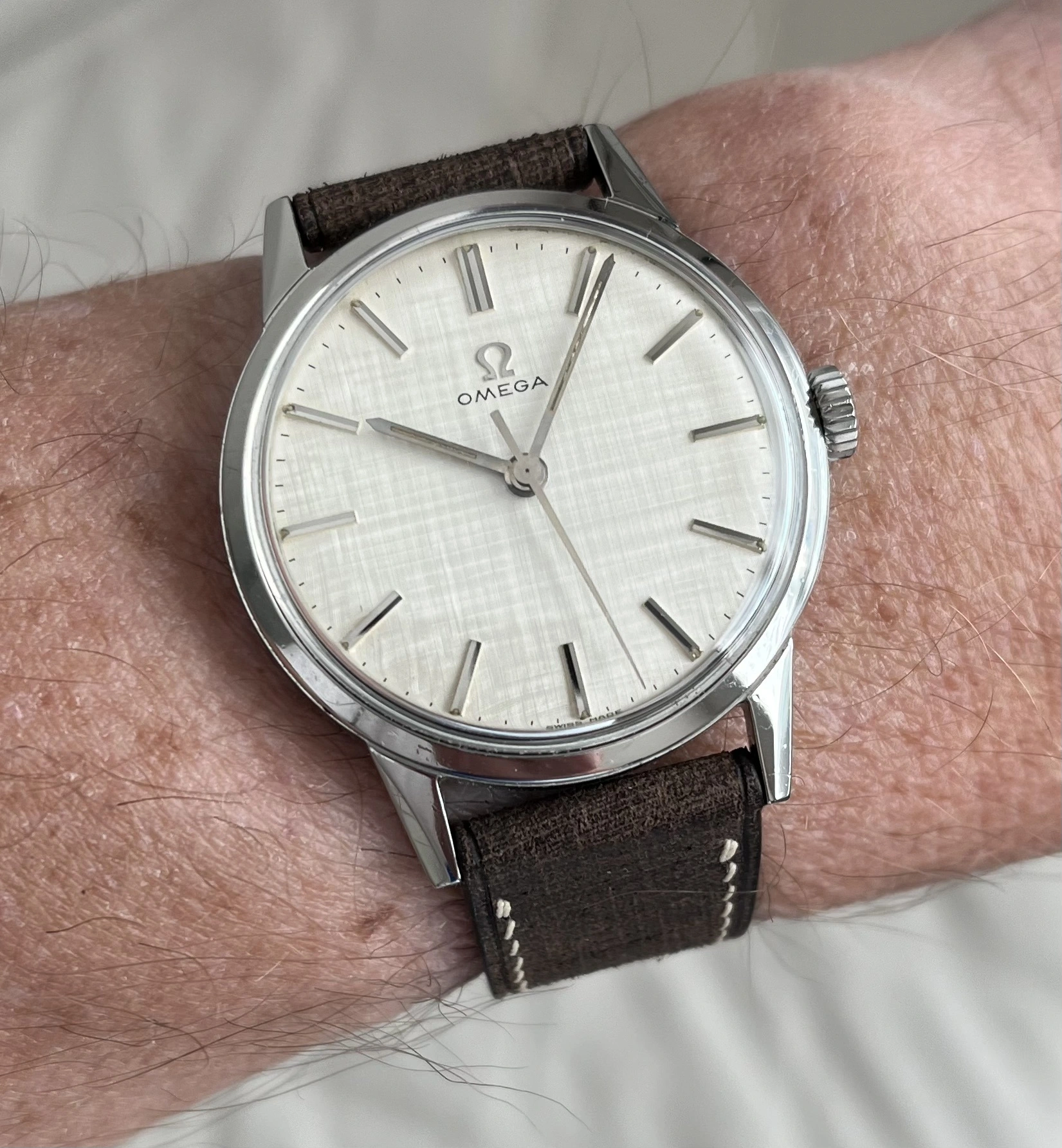

I don't think it's as clear cut at that. I also own a reference 135.003-62-SC that lacks both a "Seamaster" signature on the dial and a hippocampus on the caseback. Notwithstanding those deficiencies, Omega clearly identifies the watch as a Seamaster 30:
13,559
23,507
According to the Omega Vintage Database, ref 135.003 is a Seamaster.
It's not unheard of for some Seamasters and Geneves to have 'sterile' dials.

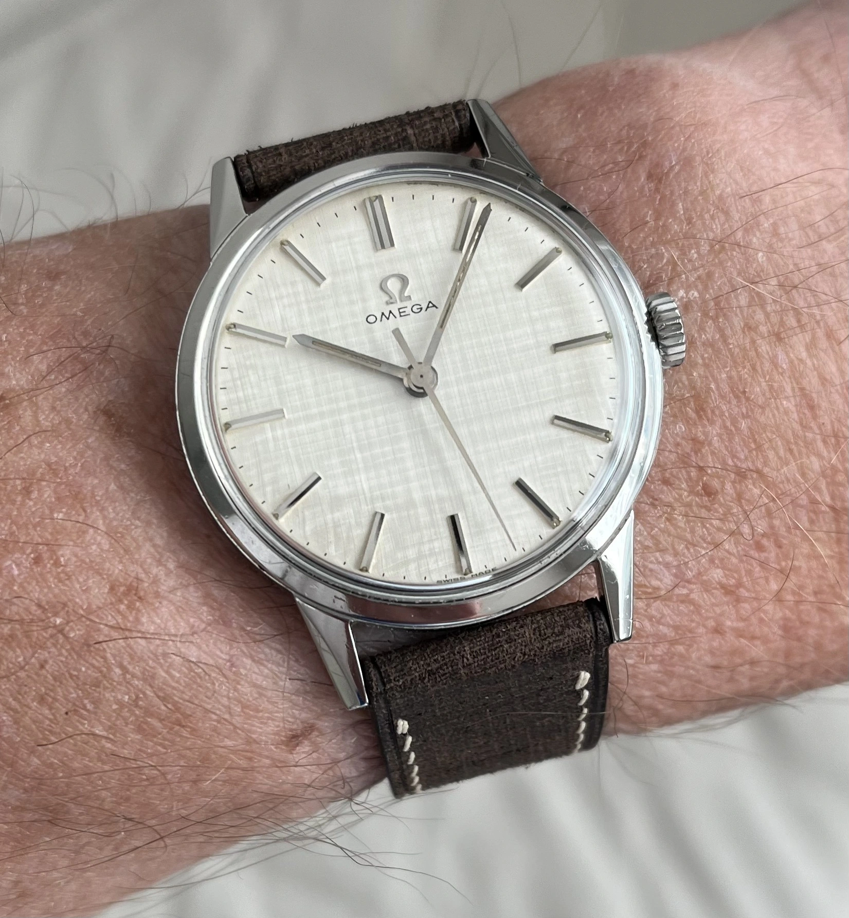

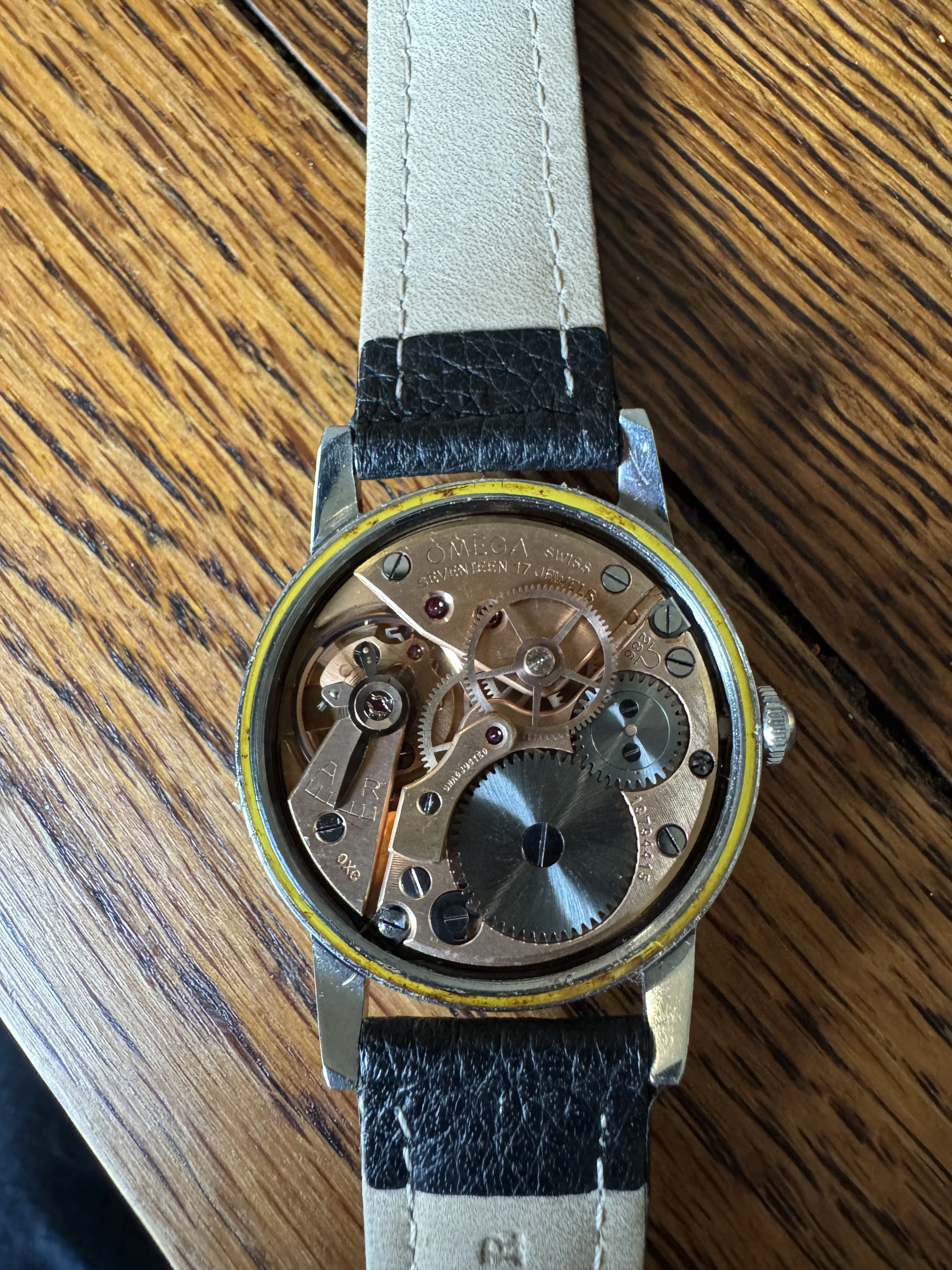

I missed a beat because just last week I found and serviced this one: reference 131.002 - 62 - sc and I didn’t notice right away that the case was different😅.
Both my watch and the OP's watch are Norman Morris OXG imports. That makes me wonder if sterile dials were exclusively or mostly for the US market.
Mine is not! And I'm very confident there are no swapped parts because it was "pristine", with no signs of being opened (not even the case or scratches or marks on the screws and so on), very dry and stiff indeed. From what I understood, it was simply forgot in a drawer for decades in Italy.
