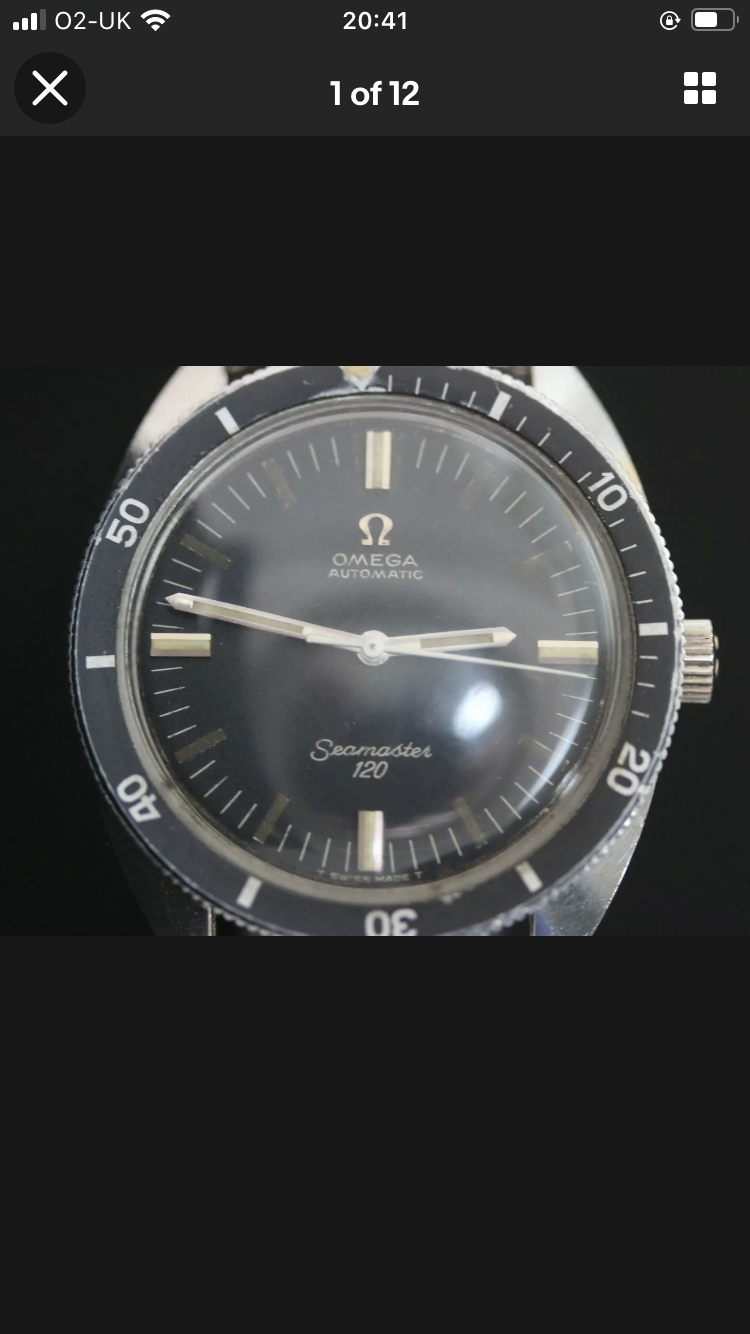

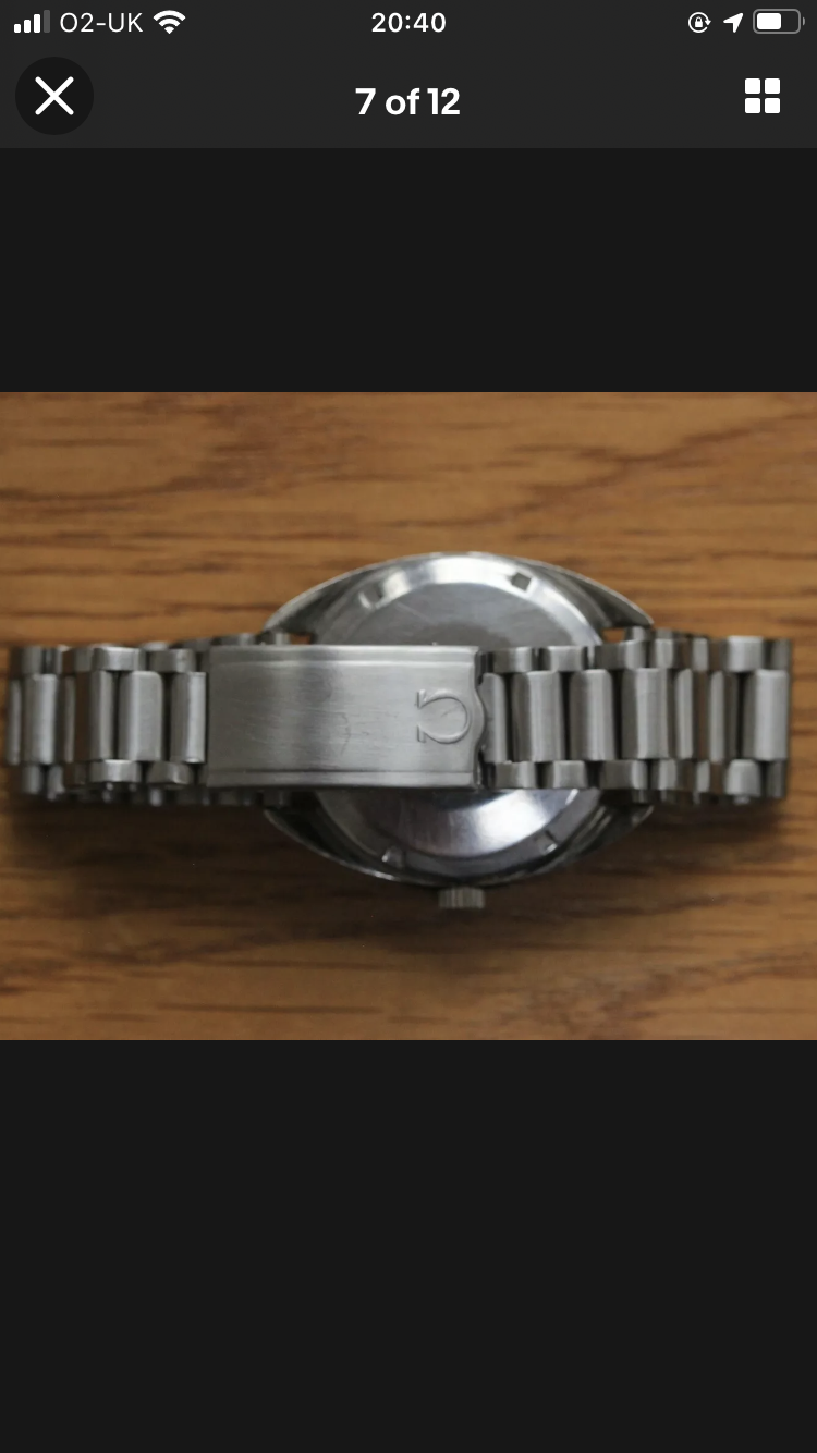

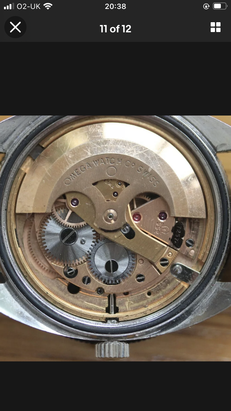

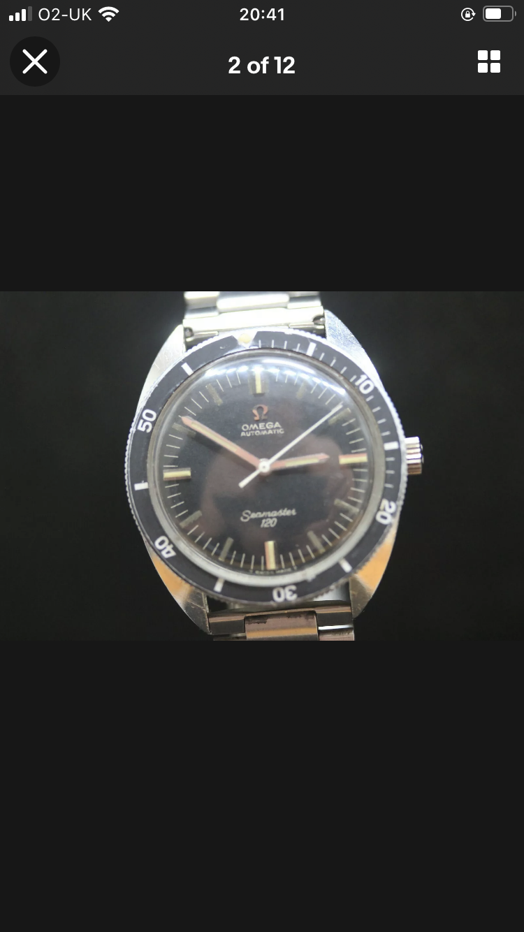

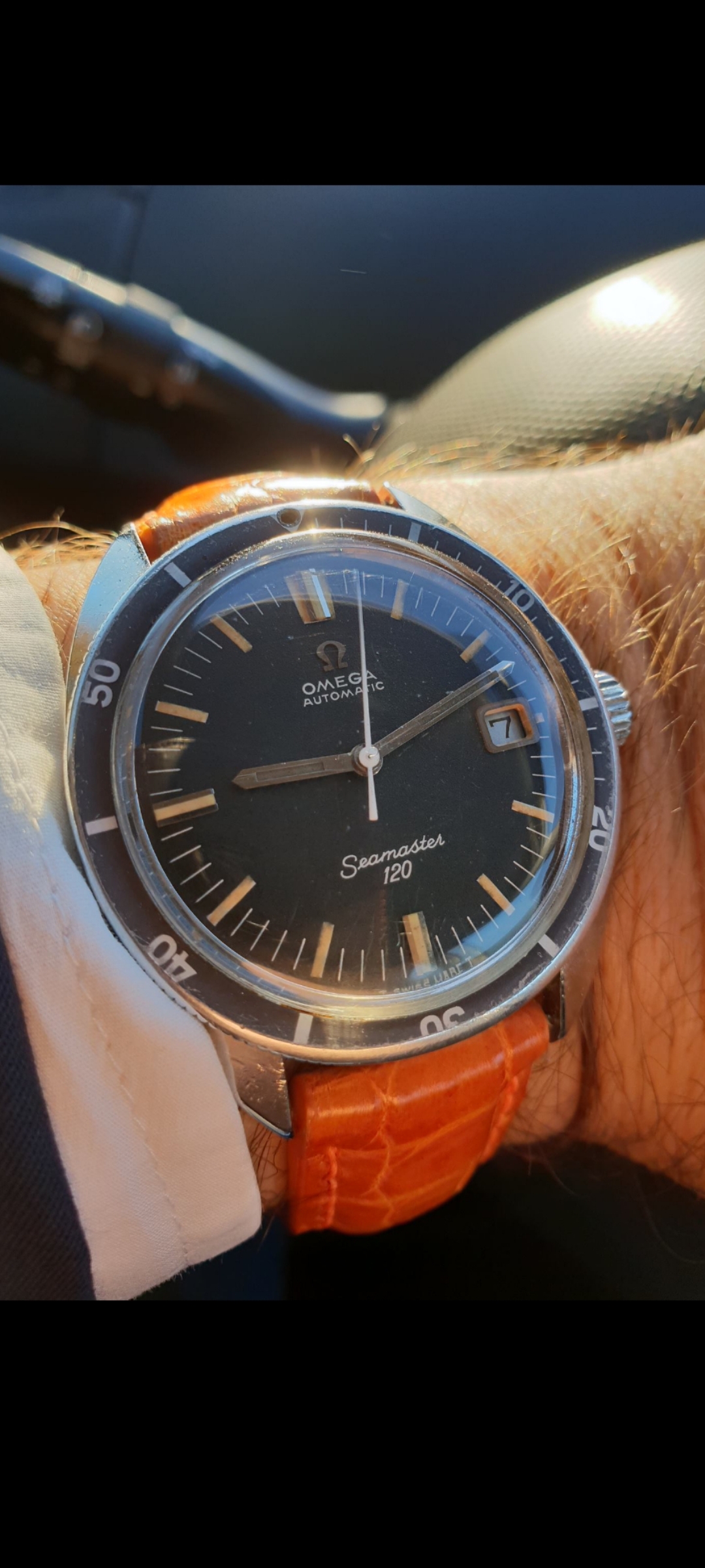

Considering purchasing this watch. Sorry photos aren’t brilliant but it’s said to be all original. Price is £1800. Any comment on price, condition & originality please?

I know 552 movements are good but £1800 😲

For what it’s worth, I think the lume is original (but not particularly attractive as it’s a mouldy green colour), as is the bezel.

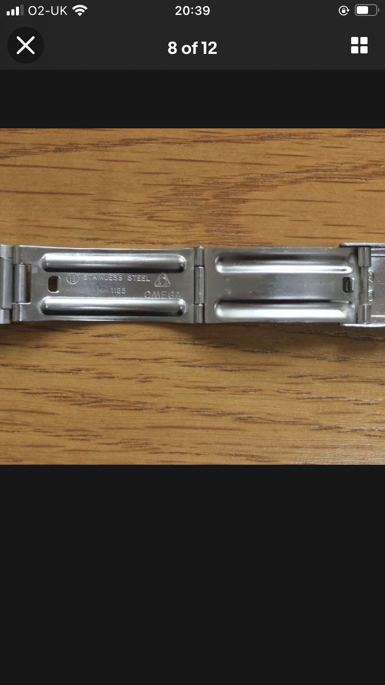

The bracelet almost certainly added later (or at least the end links were).
These 120’s are great watches and I regret selling mine. This mode is on my casual buy list as they’re great value IMO when compared to other 60’s Omega tool watches.
This isn’t a great example and I’d pass on it but in UK you’ll need patience to buy a better example at a cheaper price.

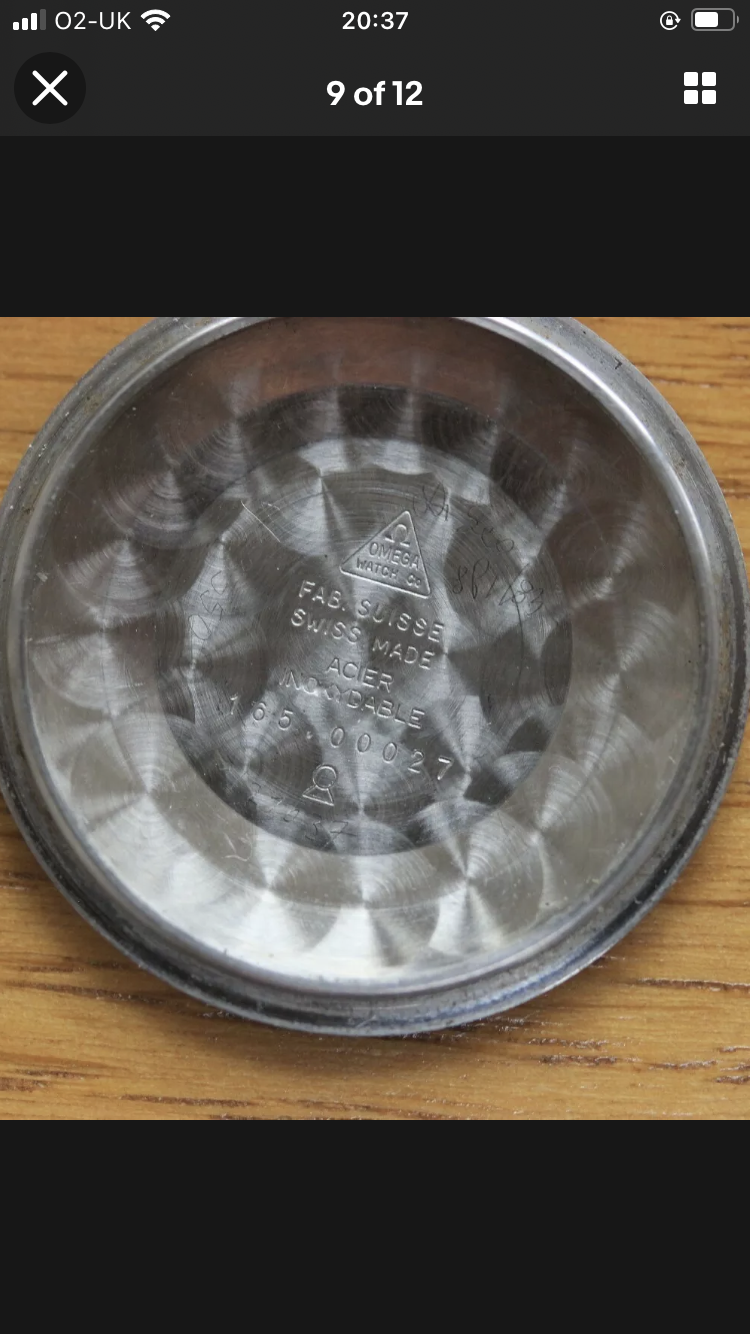

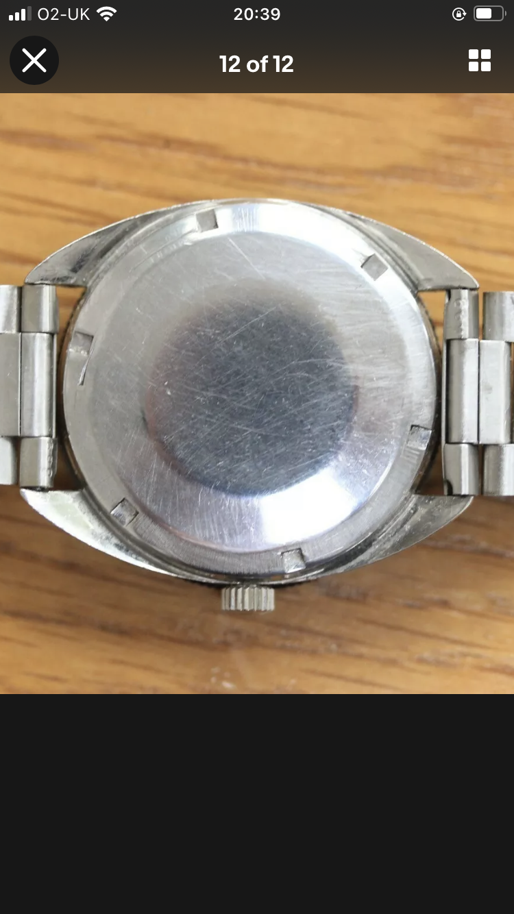

Proper caseback reference is 165.027

Why do you think the watch has been relumed? Same goes for the bezel? I dont see anything wrong except the condition of the watch in general is poor to mediocre. Bezel is ok by the way. Bracelet is added later indeed.
Yes. Sharp. But you had the double 0's with these. Were there also triple 0's? I've lost all of my pictures of my former 120's but I had double 0's in the caseback.
yeah I noticed the extra zeros so assume this is a service back from late 80’s onwards?
5,026
18,608
I doubt that. You see double 0's more often. All 80's service casebacks? Hmmm. But I've never seen these triple 0's. If I remember correctly.
I have - checked them with Omega and they are legit.
The watch isn't in the best condition, but I see nothing there that would suggest any part of it is fake.
24,836
55,256
I'm not crazy about the overall condition, especially the dial, which is not appealing to me. These watches are common enough to wait for a more attractive example IMO.

it’s hard to price unattractive examples. I wouldn’t even pay £1200 for it. I’d rather wait and pay more for a good example. I could see this one selling for £1300-1600 if unserviced.
Good to know. Makes sense as all the markings on the inside look contemporary.
I’m going to check the pics of the two I’ve owned to see if they’re single/double/triple O’s...
