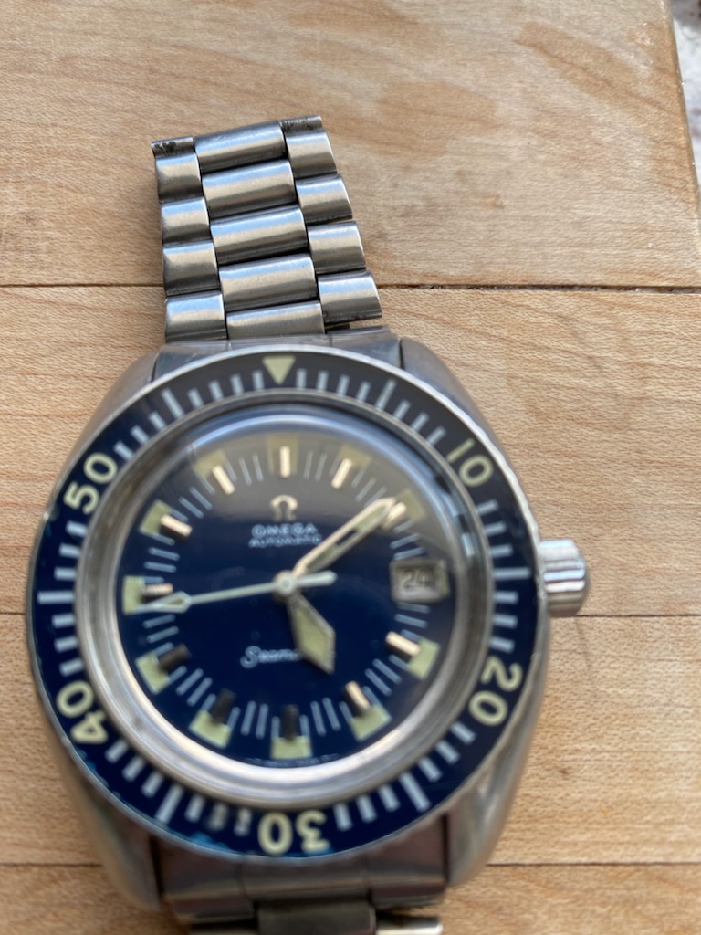

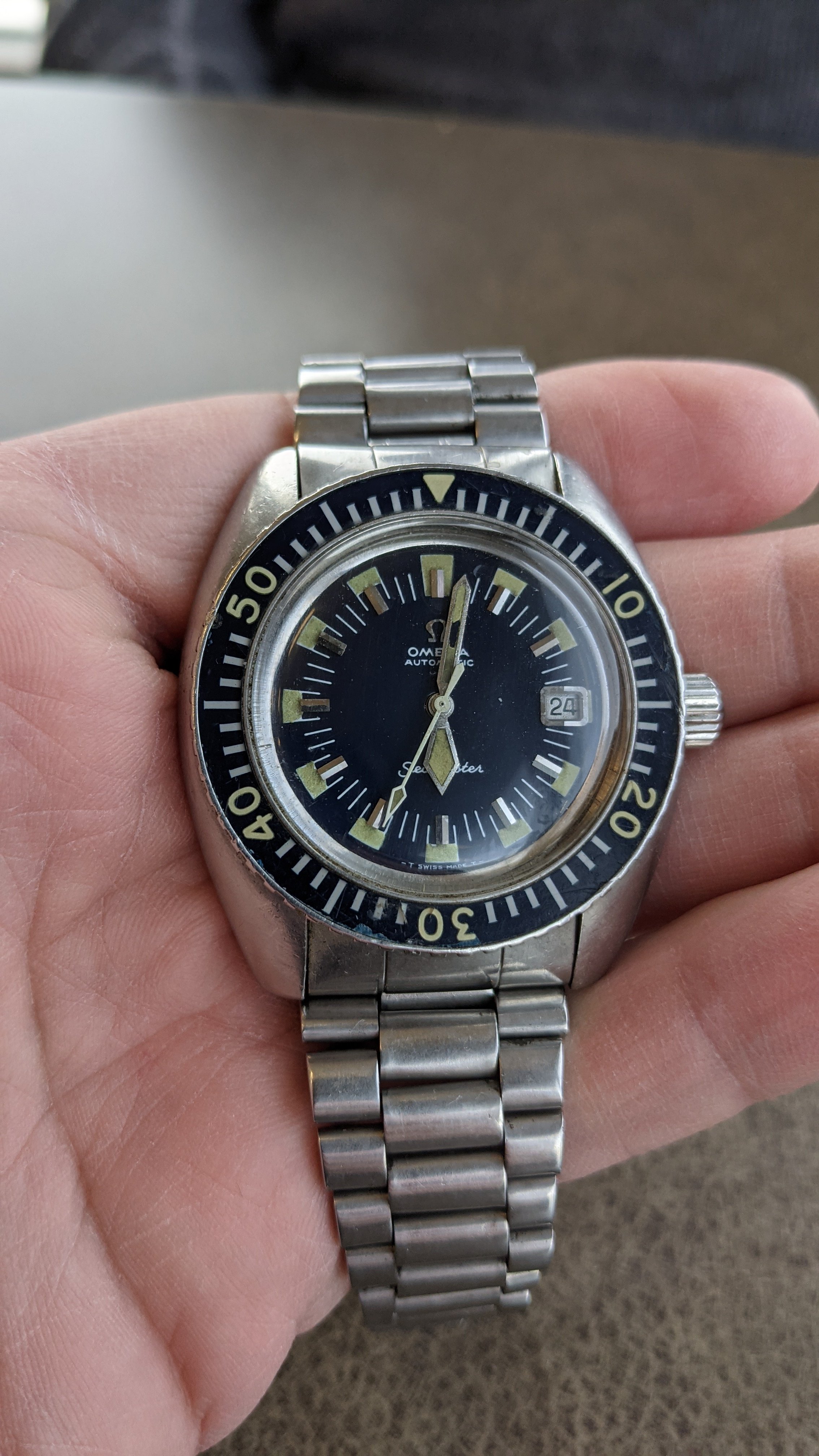

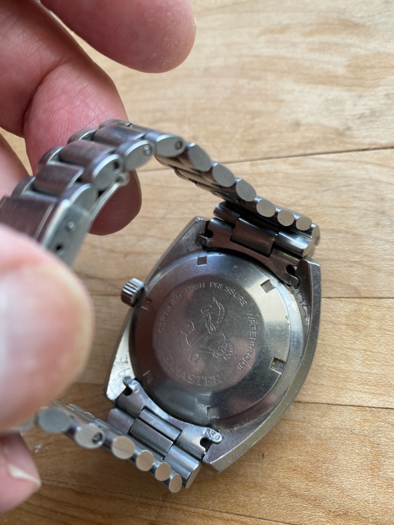

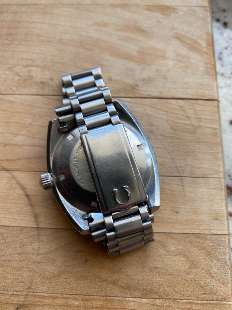

I seek advice from this group regarding a Seamaster 120 that I am considering.
I will apologize in advance for the quality of the pictures. I've handled the watch in person but didn't realize that the photos were less than ideal.
Anyway, the watch is available to me locally and I will tell you what I know:
-The watch runs well, the date set works properly by pulling the crown;
-A previous owner has crudely engraved their initials in the backside of the lugs;
-Note the damaged lume on the minute hand;
-The clasp is an 1171 with 634 endlinks (should it not be an 1170)?
-Minor chipping and cracking in the bakelite bezel at 32 minutes.
Here's what I'd like to know from the group:
-Approximate value (how does the crudely engraved caseback and minute lume affect price)?
-Given the crack to the bakelite bezel, is the watch "wearable" or is there a risk of the bezel falling apart?
-Any other positive/negative observations that I need to be aware of?

Additional piece of info, watch supposedly dates from 1973 (serial number is not available to confirm at this point).

Hello, the watch is original condition and looks very nice to me. The minute hand is a minor issue In my opinion. What price have you been asked for it?

Its not a popular model. The cushion case and busy dial are not a great combo in my eyes. Having said that if you like it thats whats important. The condition looks honest, but well worn. I would be happy at £1250-£1500? I expect I would have to pay closer to £2000 to buy it though. I wouldn't expect the bezel to deteriorate further unless it is knocked again, and the engravings to the lugs not an issue.

I think 2000 pounds is an optimistic price. The last ones sold publicly in the forum were around 3500/4000$.

Ah well, I expect I am off on price due to not being a fan. Ignore my £££ speculations.

There's one on ebay for £2700 atm in a similar condition though your bezel is better and it has no bracelet.
I think that amount is probably fair for your example as well.

The bracelet is 22mm at the lugs so its not a 1171, could be 1170 or something similar, obviously the clasp is not correct, anyway not a big issue. The hands can easily be relumed with a similar colour of lume, which I would get done during a service.
I'm not sure about the damage to the bezel, if its cracked then maybe its not all the way through and will stay together.

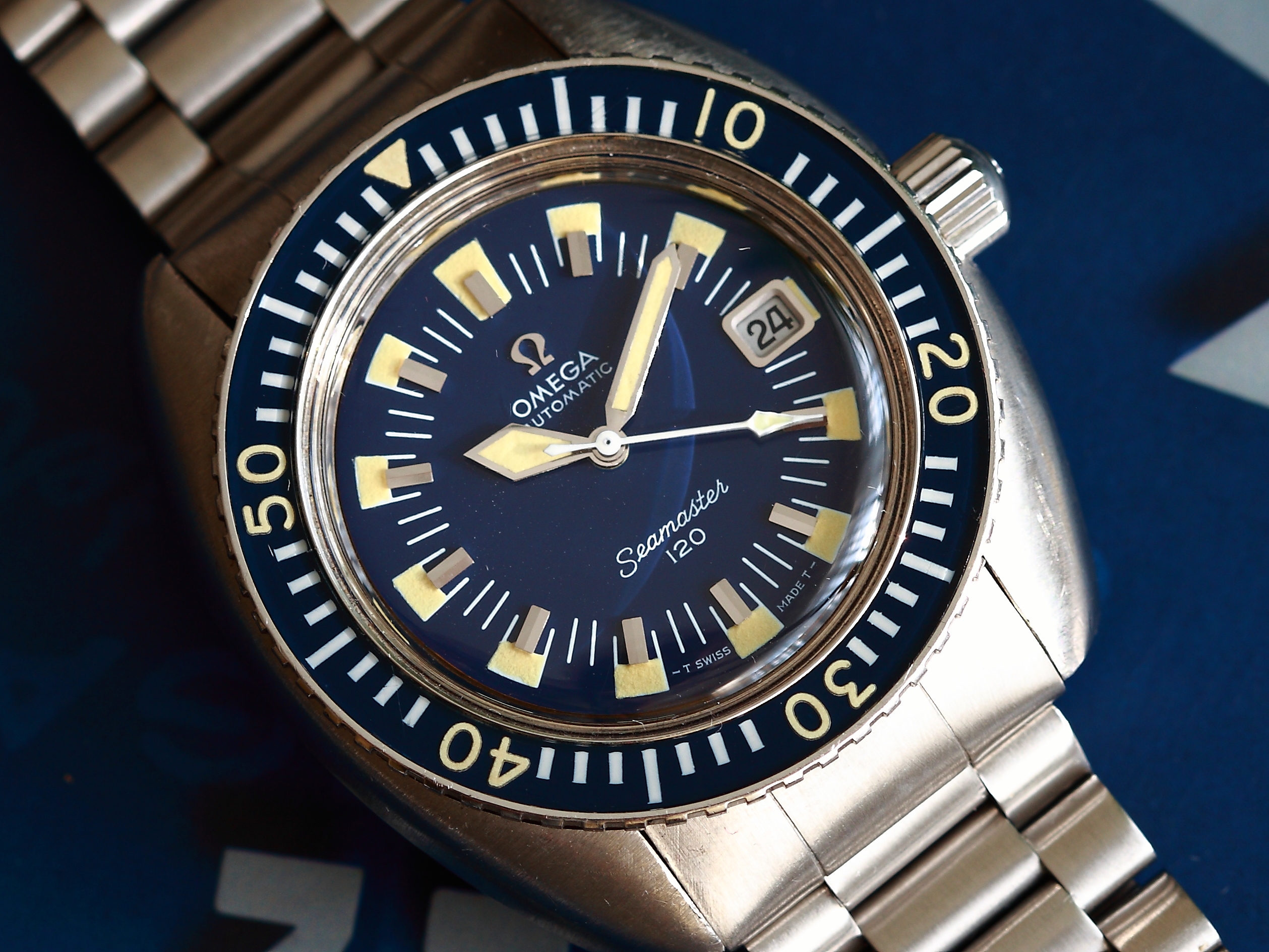

I really like these cases, but the dial is not to everyone tastes. When I was working on mine, I swapped the dial / movement out for my spare SM300, quite an interesting combination.

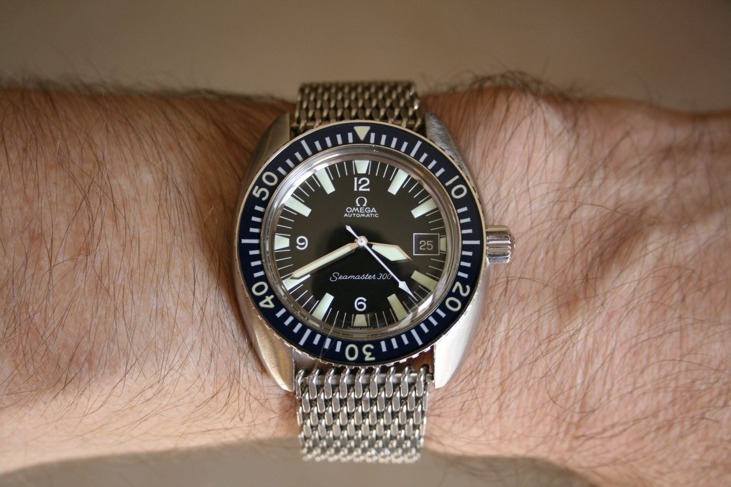

They are great watches, here's mine...but I think I'd maybe be blushing if I put a $5K asking on it..

And in a different league. Lovely colours!
