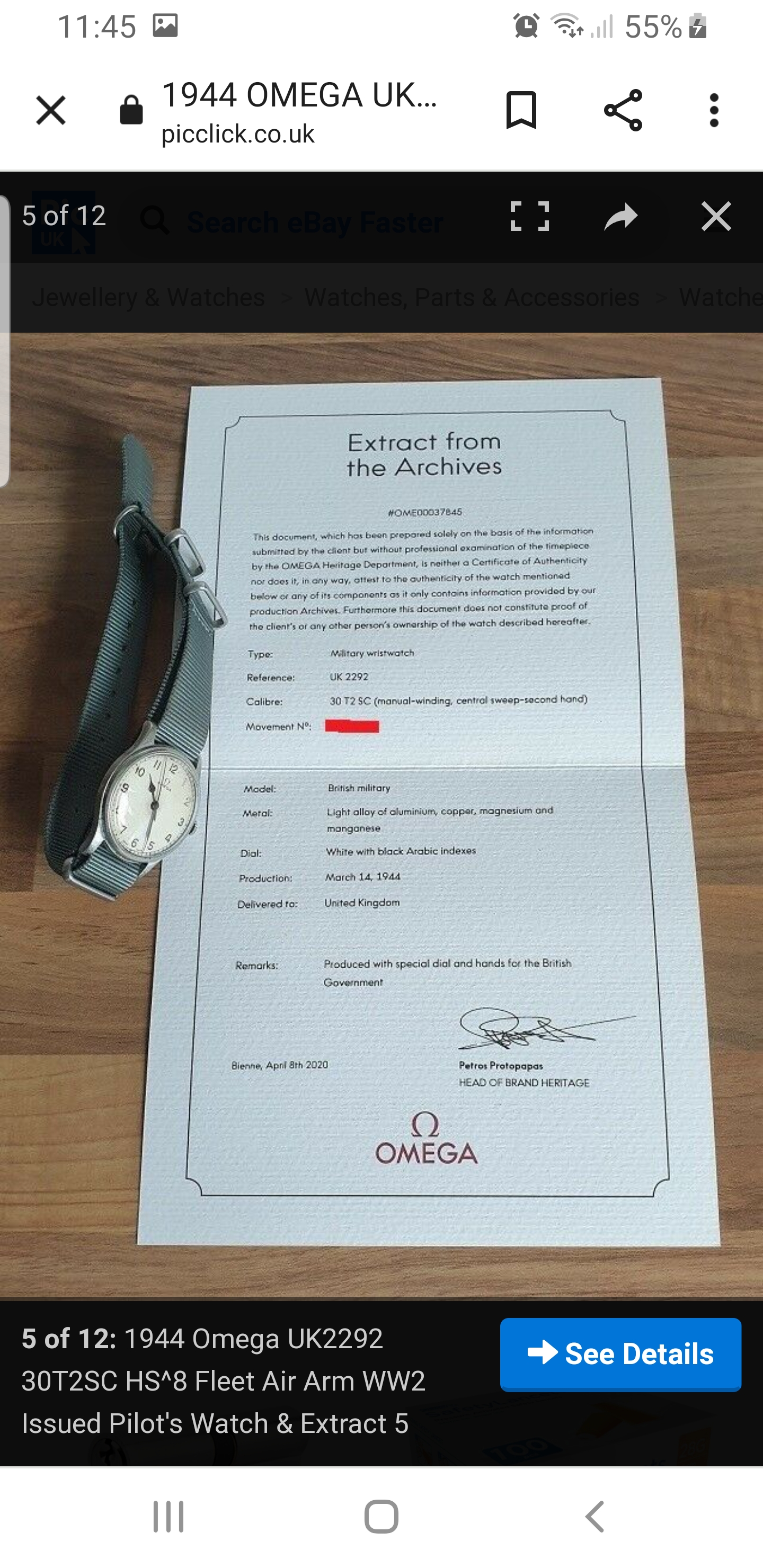

But I have seen this UK 2292 (which isnt mine) with a from the archives certificate by Omega,saying that it was produced in 1944.
I'm sure that I have seen other watches with 1944 serial number dates.

I don’t have much to add except here’s another 1944 alloy cased one. https://www.blackbough.co.uk/produc...de-for-the-british-government-in-1944-wwosml/
the claim in AJTT isn’t incompatible with these, though. It just says 3000 were made between March and June 1943; it doesn’t say that’s when production ended.

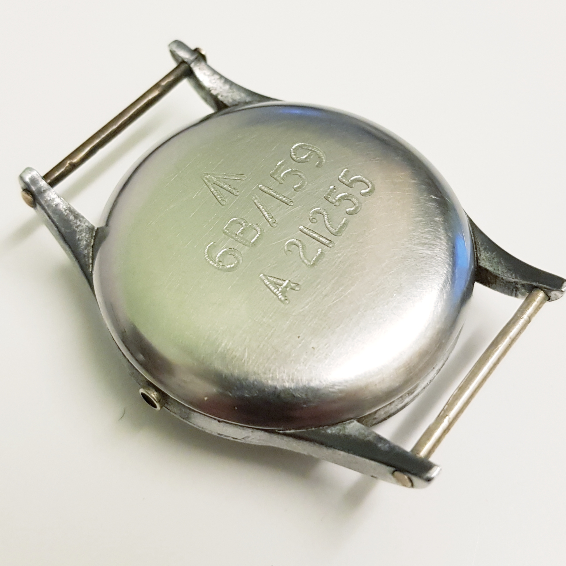

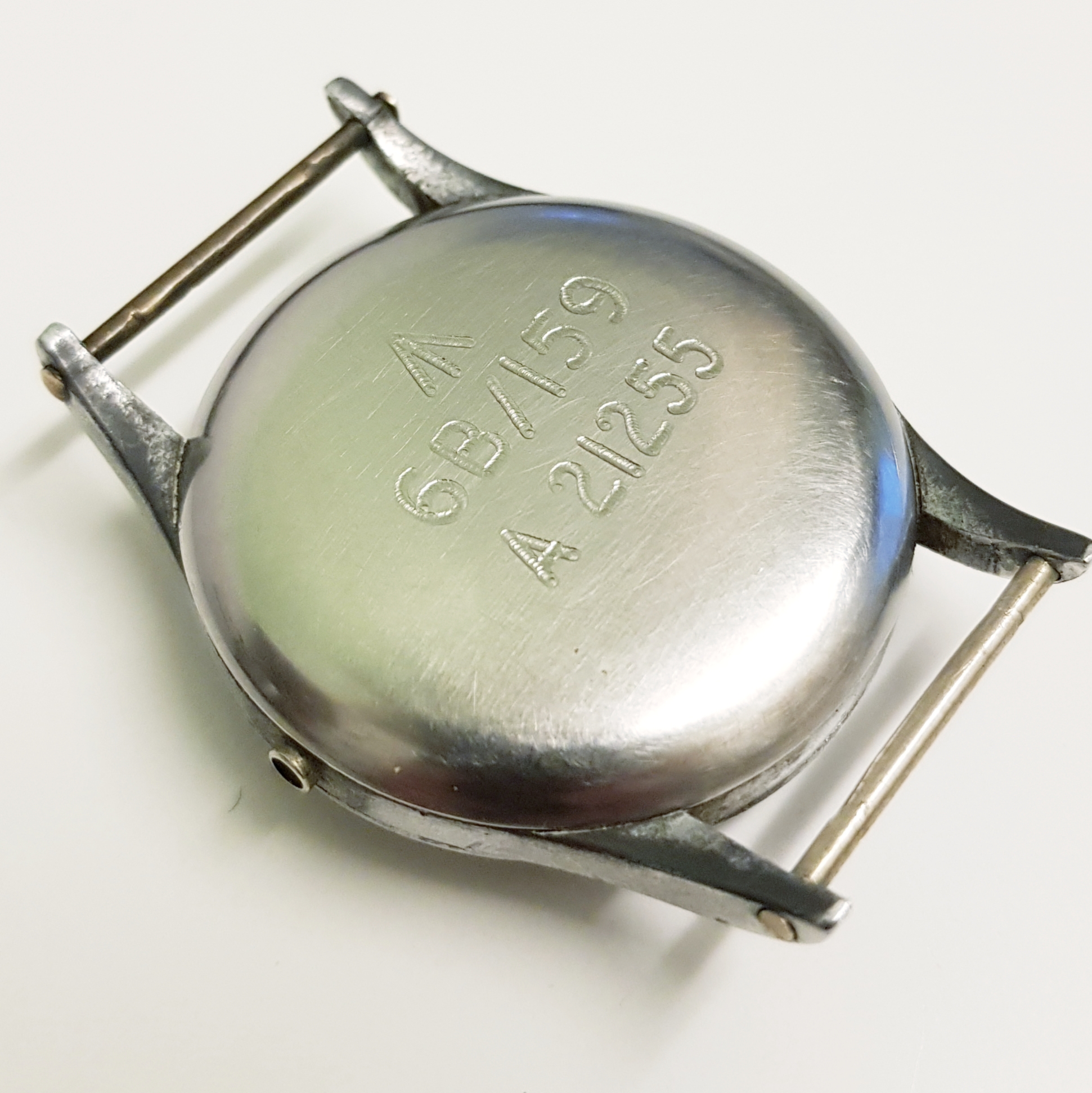

Does your watch have any markings on the case back?

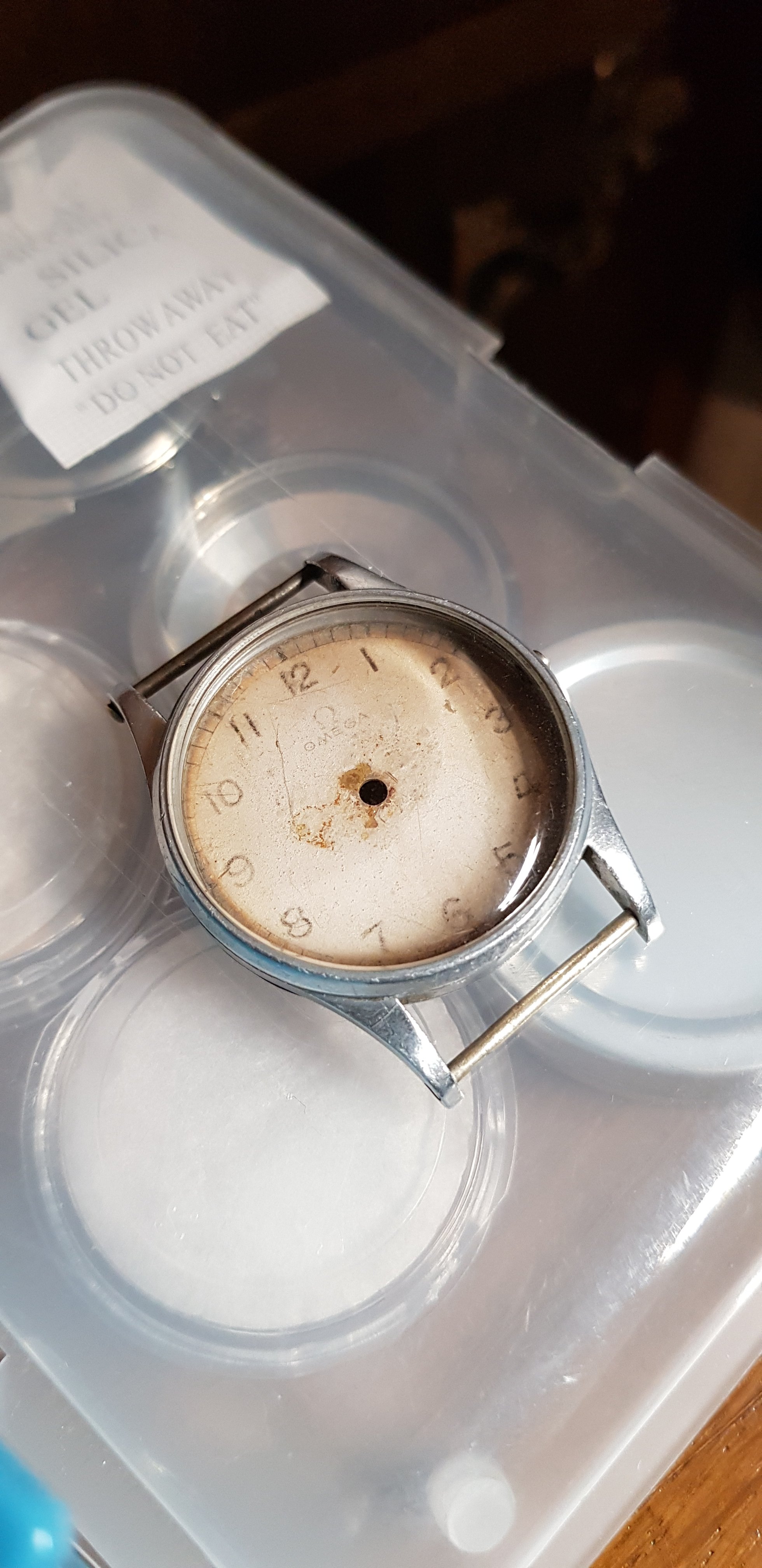

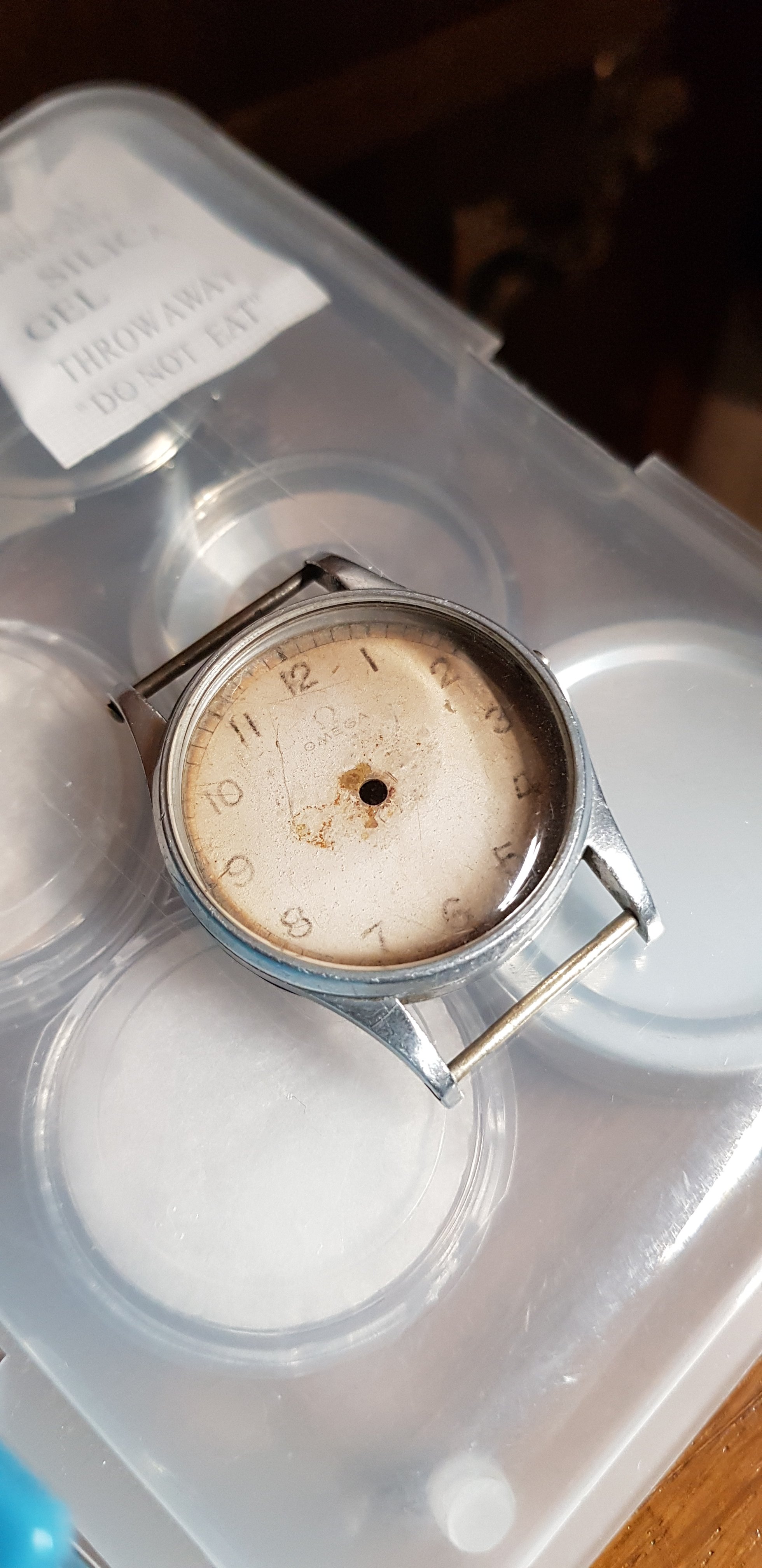

But,I have a uk2292 case it was purchased with no movement.I bought the case for a great price on ebay,it had a non omega movement and dial,but I recognized the case and hit the buy now button.
I also have an original but worn dial.
Think it would be great to find original parts if possible to complete this watch and keep it with my 30t2 collection.
I know this could be folly on my part,but I have just purchased a cheap 30t2sc movement that has many parts missing apart from the bridges

My situation is a bit different and may not be helpful in this discussion.

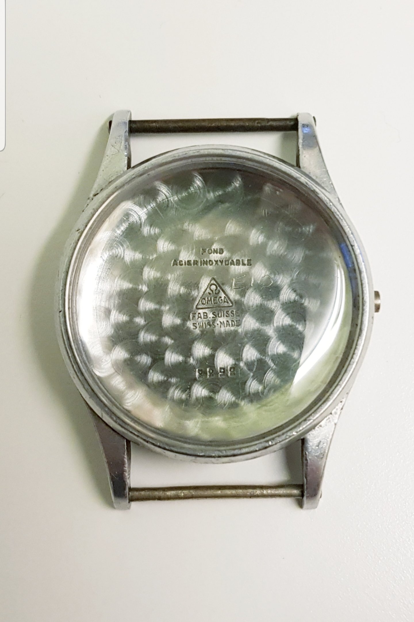

That is a nice little project (maybe a big project :0) - out of interest what are the markings on the inner caseback?
