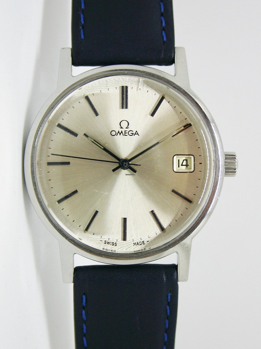

What is going on with the lume at the 2:00 marker? Also, the minute tics seem to vary in length, but that may be due to the angle of the camera. I would want a better dial photo, and preferably one that is not so overexposed (overexposing is a trick that helps mask issues). I would also be nice to see some case photos that are not so overexposed so the severity of the polishing is easier to determine.
Isn't that a reflection?
It may be, but it looks different than the reflections at the other markers. Which is likely due to the angle of the photo. I would want a better dial photo.
No doubt about wanting better photos.
I have already asked for other photos

The inconsistent spacing between markers and minute tics, the 'Swiss Made' positioning, the 'E' in Omega, some markers not aligned properly with the center point, green lume, etc. all seem like signs of a redial to me. But others with a lot more knowledge will likely provide more feedback.

These 10xx watches are a bit different when it comes to dials, I actually think it's OK, just distortions from the crystal. That being said it's about 200 € overpriced.
