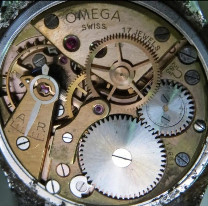

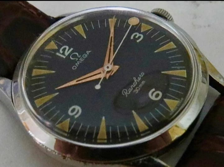

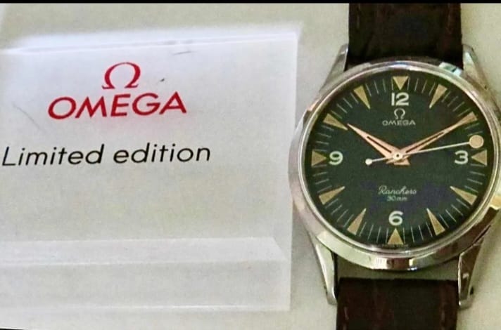

Hey guys.
I've come across something strange. Not sure about this Ranchero 30mm with the 283 caliber.
What are your thoughts on this?
Thanks for the assist.

How about your thoughts first?
10,125
57,953
I'll give you a hint. This is not an authentic Ranchero and you don't want it. Do your research.

Compare that dial (and case) to other genuine Rancheros.
883
1,774
There's a very good thread somewhere on this forum about Ranchero redials.

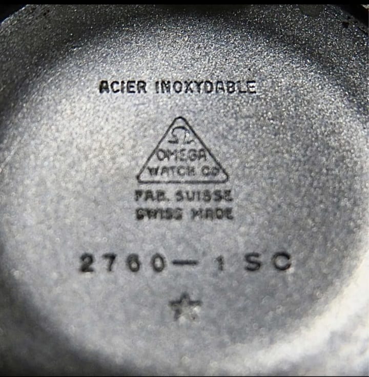

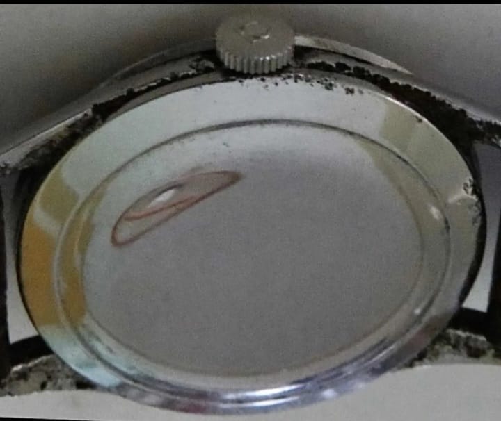

It’s not just the dial with this watch. The case isn’t even correct.
10,125
57,953
Should be a 2990/2996 case for a Ranchero. 2990 for the subsecond version and 2996 for the sweep second version. The cases are identical and often double stamped. The only difference is that the 2990 has a flat case back whereas the 2996 has a slightly domed case back to accommodate the slightly taller sweep second movement.
