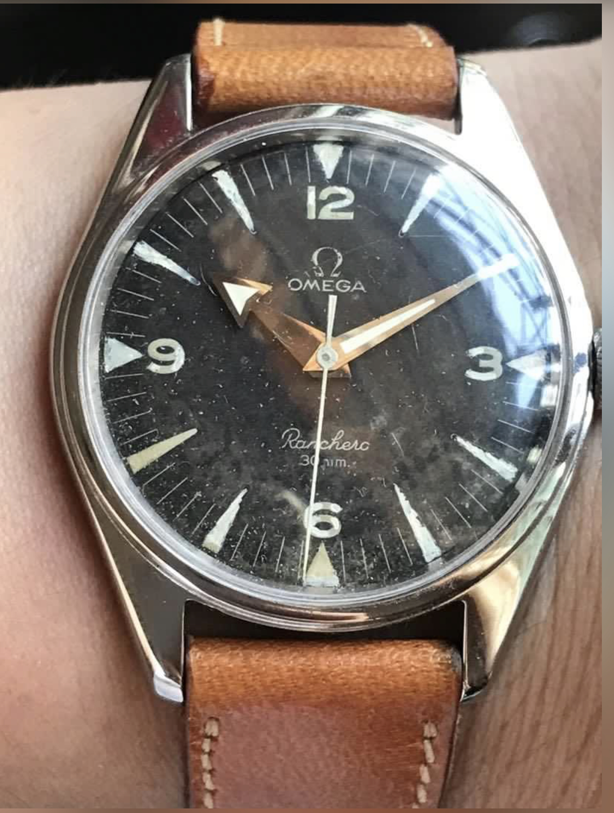

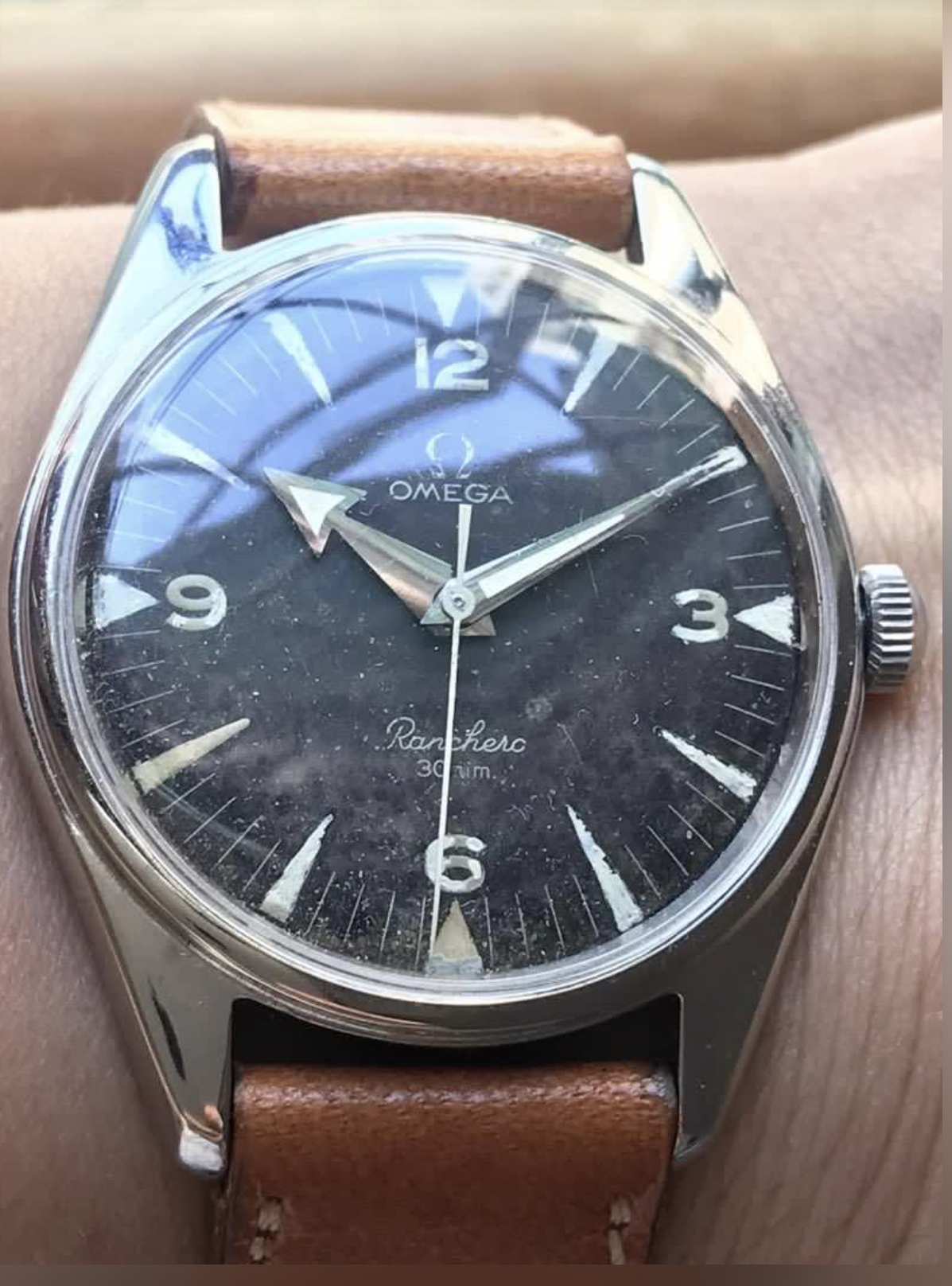

Hi! Good morning!
I am not an expert and would like to seek help to see if this watch is authentic. thanks for your great comments and help! Wishing everyone a happy weekend

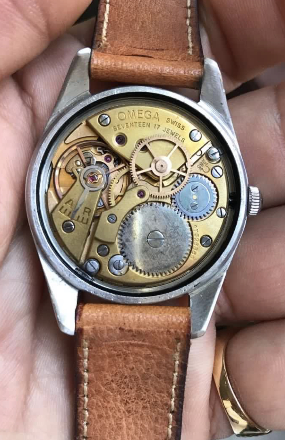

I would never buy such a crappy example. dial is not attractive and look at the movement! It has lost nearly all of its plating, ratchet and crown wheel have been ground and polished to hell.
My advice: run

Rancheros never really had sharp cases to begin with but this one has definitely had a polish or two.
Dial looks rough. Poor relume job with little flecks of lume paint clearly all over the dial. Original rancheros would have radium dials.
Nothing that's a deal breaker if you can get it for the appropriate price. Any watchmaker can relume with an appropriate coffee-brown kind of luminova and service properly.

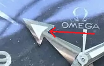

@mac_omega: depends on the price 😉..... I doubt (from the distance) the hour-hand.
should be straight, may be optical error

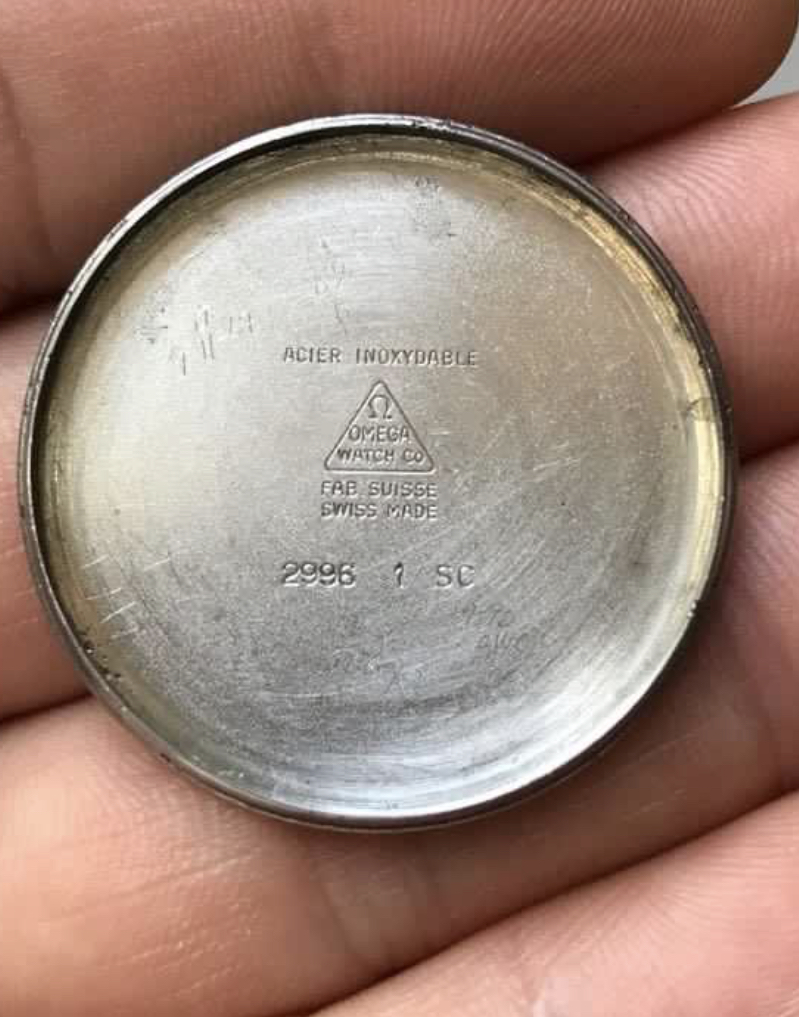

What is written beneath the "6"? Can you make a lume-test ?

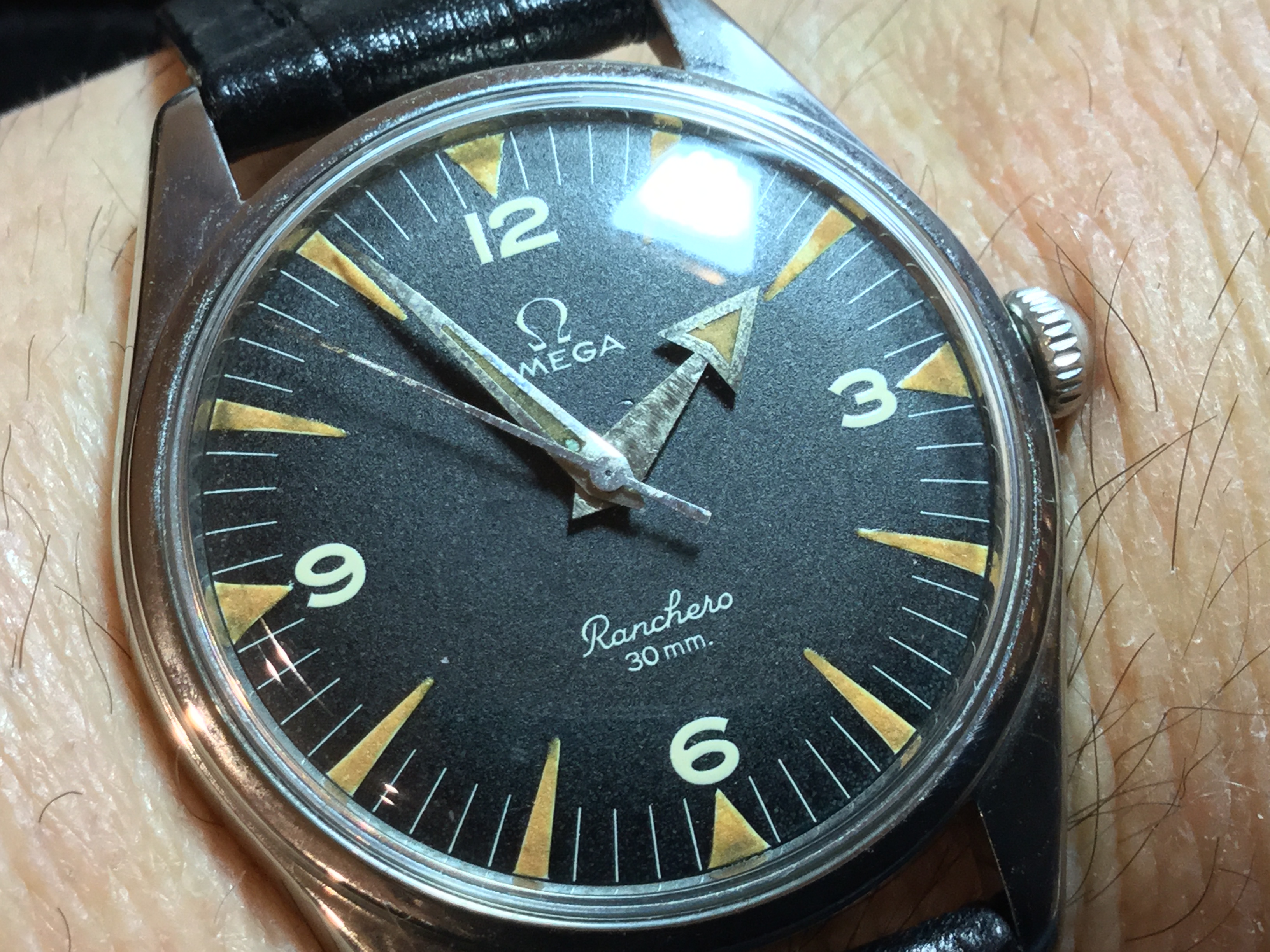

The dial schould look like this one of @gemini4
Looks like all radium have been removed and relumend, not attractive

If you've got a spare dial, hands, case and movement, it might make a good project watch. ☕

Whatever flooded the movement (requiring later the removal of original de-luxe finish), also damaged the dial and required the replacement of hands and luminous.
I would not buy it, not even for a substantially lower price, not even considering the crown which is good
