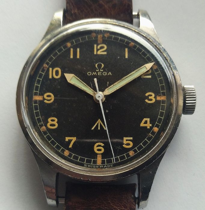

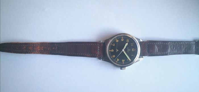

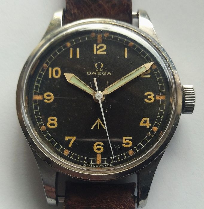

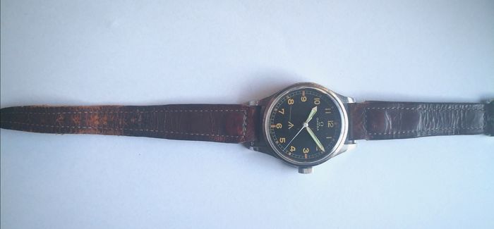

Hi everyone,
I came across this watch this morning. After comparing it to other pictures posted in threads across the forum, my main question is about the hands. The seller says the whole watch is untouched, but compared to the rest of the dial it seems even a different type of lume. Furthermore, any other red flags?
Sorry for the quality of the pictures, it's on auction and cannot message the seller.

You could ask for a video where the seller shines light onto the dial, then moves the watch to a dark area, the bright hands will indicate relume as old lume doesn't work any more

for this specific auction site, you cannot communicate with the seller ahead of the sale - so it would be a bit of a risk

Dial looks very nice, but yes, the hands were clearly relumed

Radium does not age to that colour so yea hands are relumed.

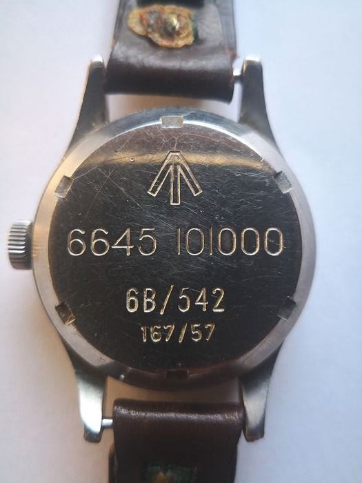

Original Thin Arrow 2777, with radium dial. Rare. But hands relumed.

center seconds hand might have been replaced too. just a feeling it does not belong there
it might be correct but looks as if it was re-painted incorrectly

These original TAs are hard to find with a decent dial that relumed hands are a minor consideration when it comes to deciding whether to buy the watch or not.

Thanks everyone for the expert opinions. I decided to bid and won the auction!
The ad said it was never serviced or restored- which from the looks is not true. Still, I might bring it in for a service. Would you need specific expertise for these watches? I live in Barcelona, and typically go to Javier aka doctor_clock _bcn.

I’d think long and hard before you go ahead and relume that dial. It will significantly impact the e originally and value.
