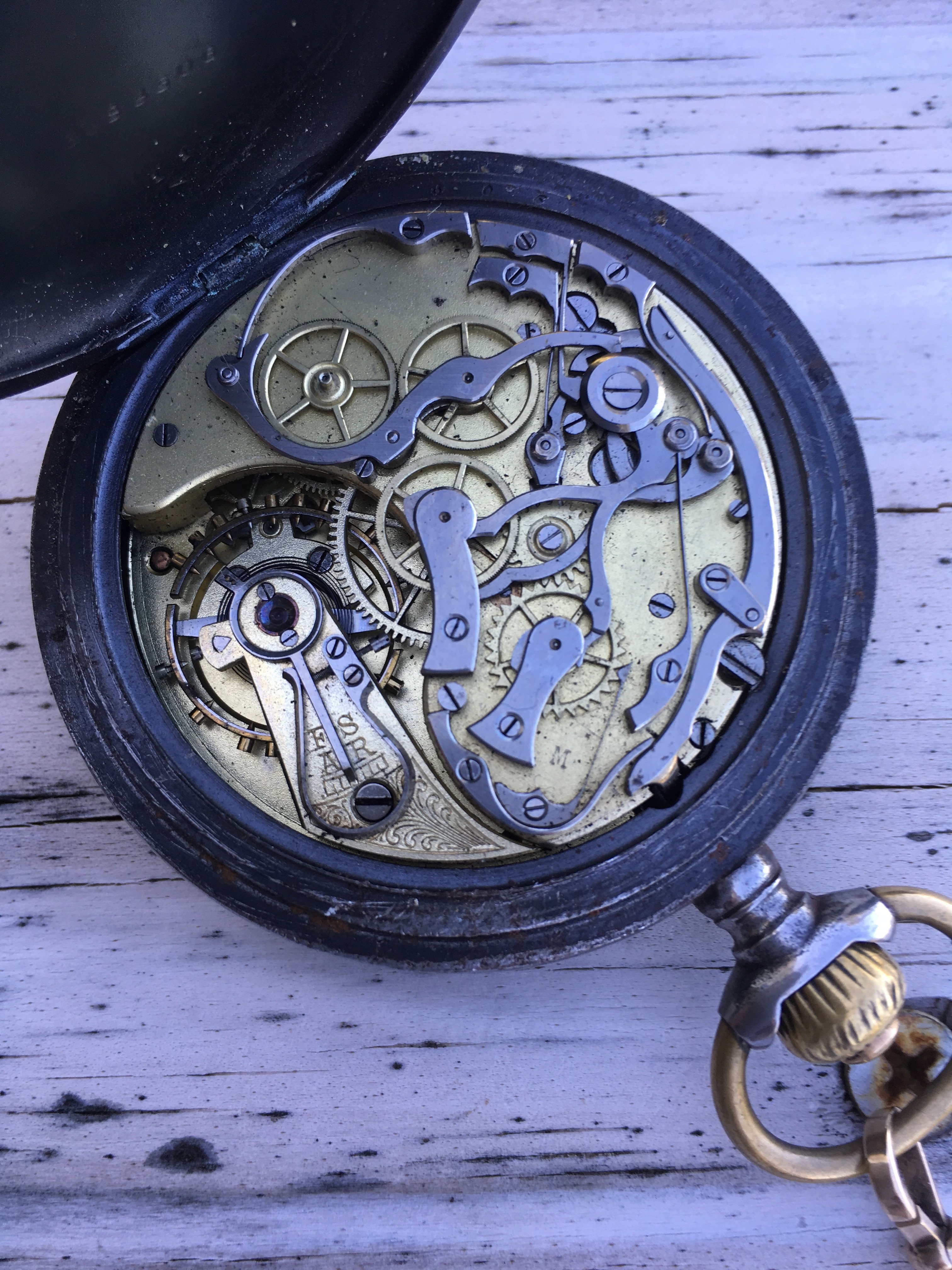

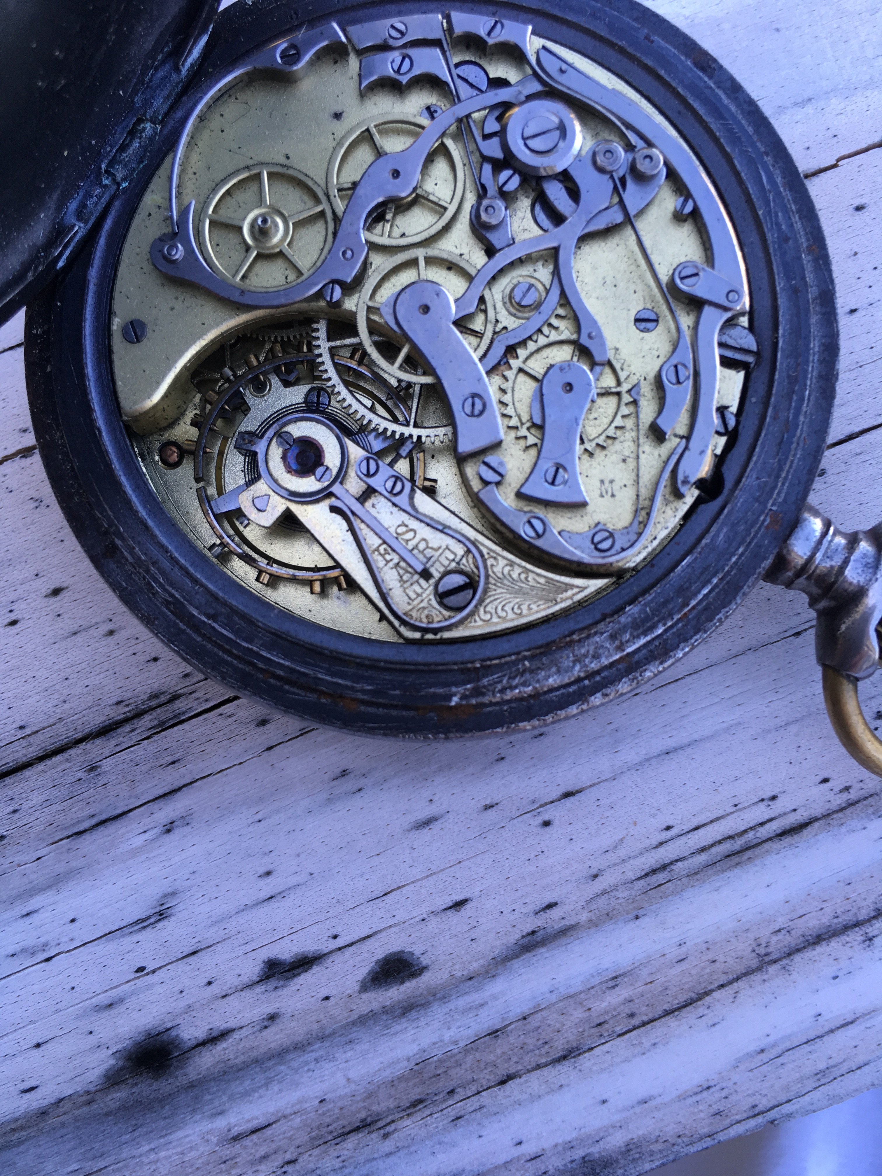

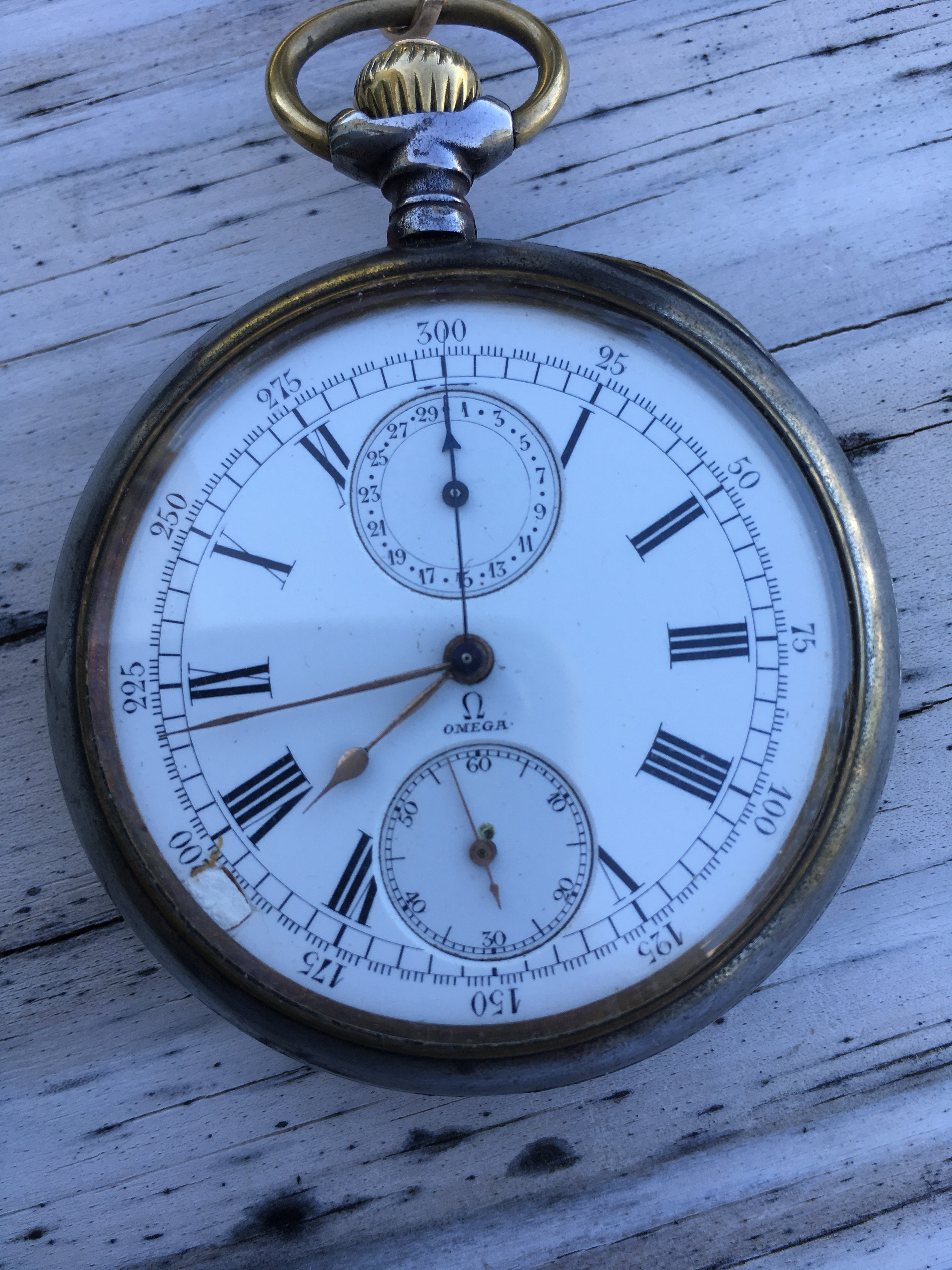

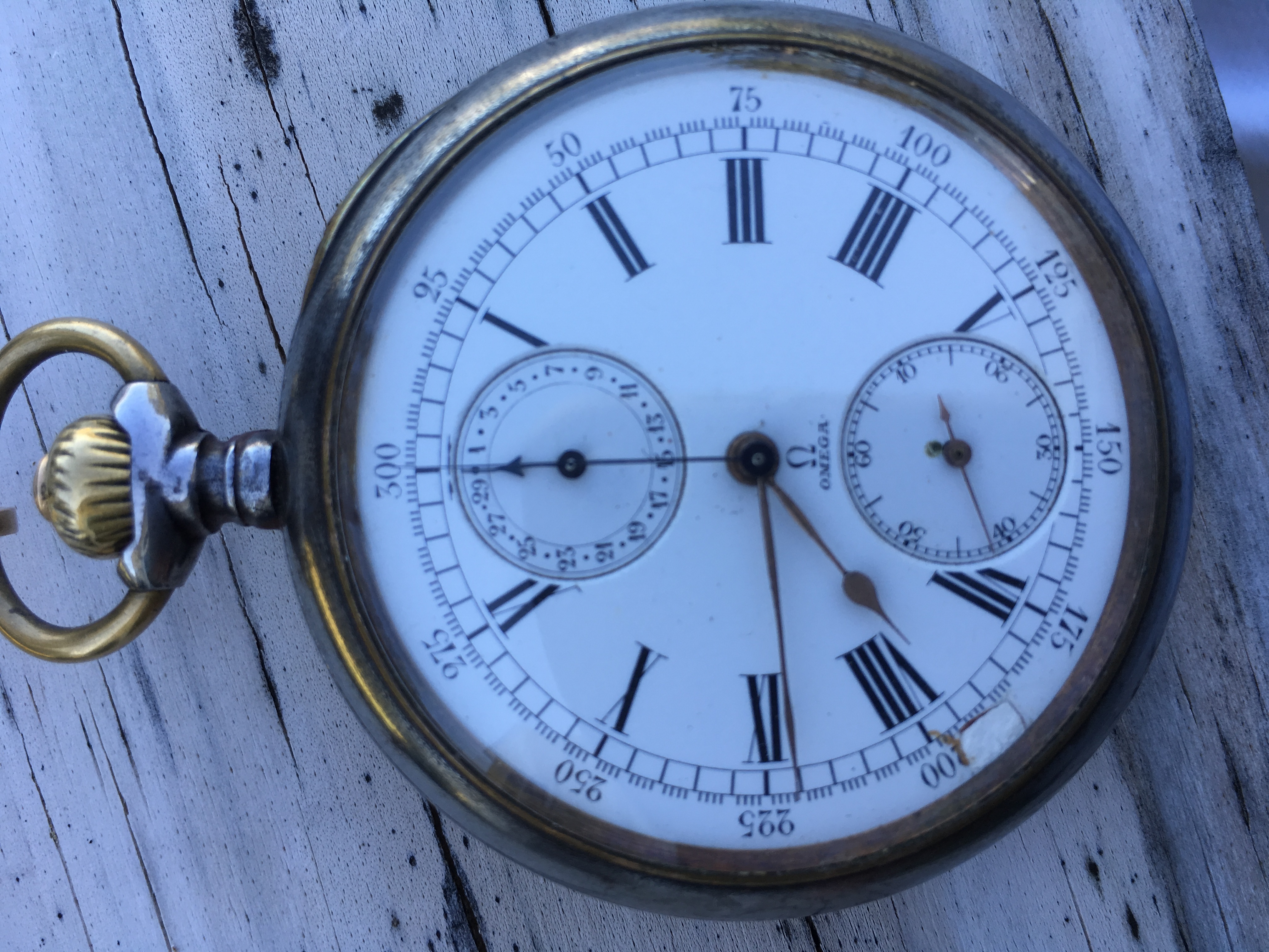

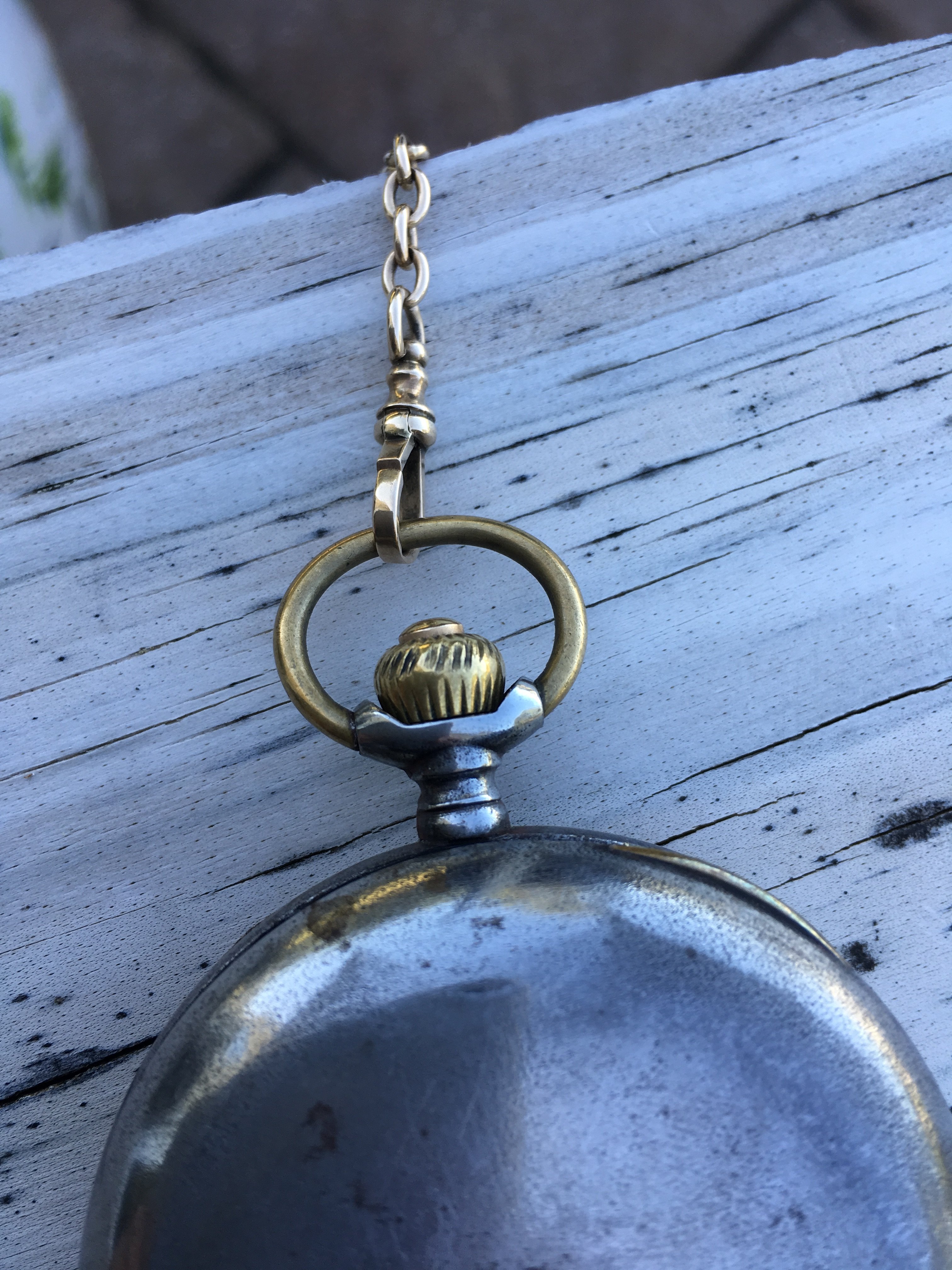

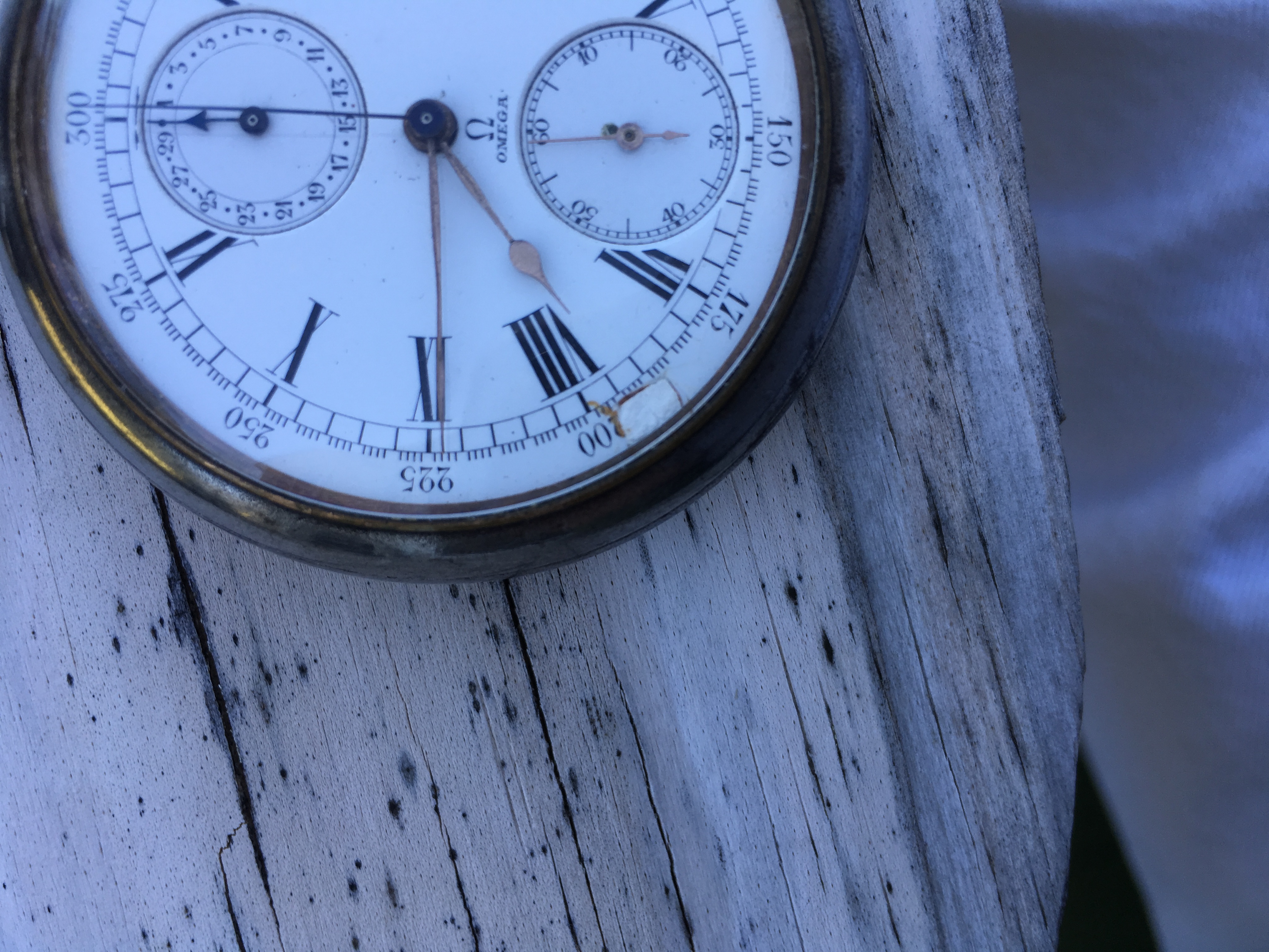

I’m new to the forum and really like what I see. I live in North Myrtle Beach SC and have been here since 2003 after moving here from Annapolis, MD. I collected and repaired clocks as a hobby for many years and was active in the local chapter of the NAWCC. About 35 years ago a friend of mine gave me the Omega pocket watch shown in the attached photos. It was given to him by his grandfather and he had nobody to pass it on to. It does have a stopwatch feature built in that just suddenly stopped working. It feels like something is simply hung up. At any rate I was interested in knowing more about this watch. My photography is not the best but hopefully good enough to give you a good idea of what I have.

I think you have a very nice early pocket chronograph. My guess is a caliber 19''' CRO which was introduced in 1898 and I suspect your watch dates to around the turn of the 19th/20th century.

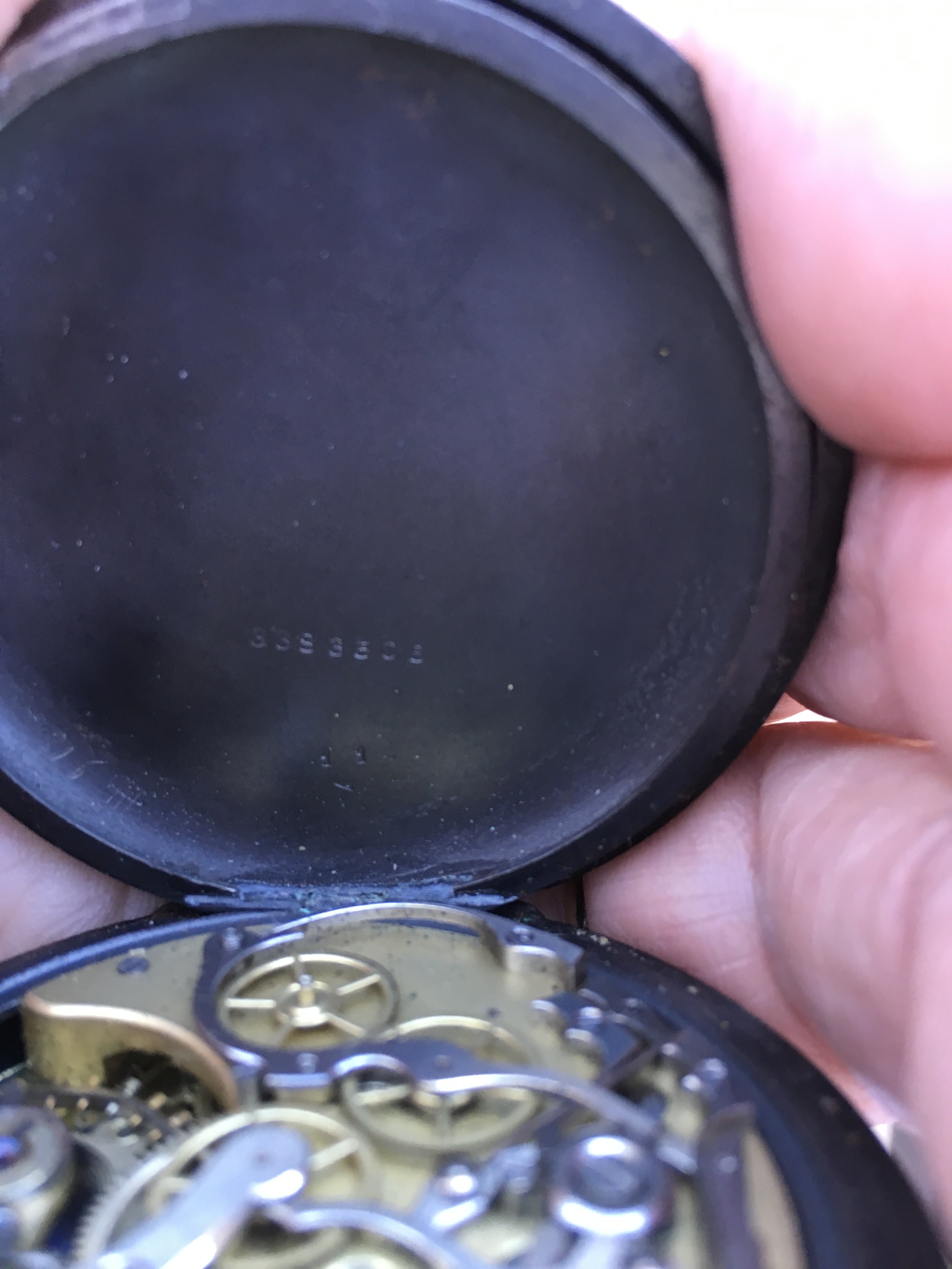

If the case was made by Omega, the serial number would put your watch somewhere around 1904.
The "M" stamp on the bridge signifies that the movement is Metal (brass/copper etc), not a noble metal like gold.
Aside from some hairs in the movement I can't see anything broken (is the chrono actuator pin missing?) so a good watchmaker should be able to bring it back to life.

Thank you for the invitation @Vitezi! Yes, I think I can offer a bit. I agree with JimInOz’s comments, very good.
This is a 19’’’CHRO, the first of Omega’s chronographs, originally dating from 1898 - and because of this dating, I’d expect the movement to be a 19’’’ CHRO HNB.

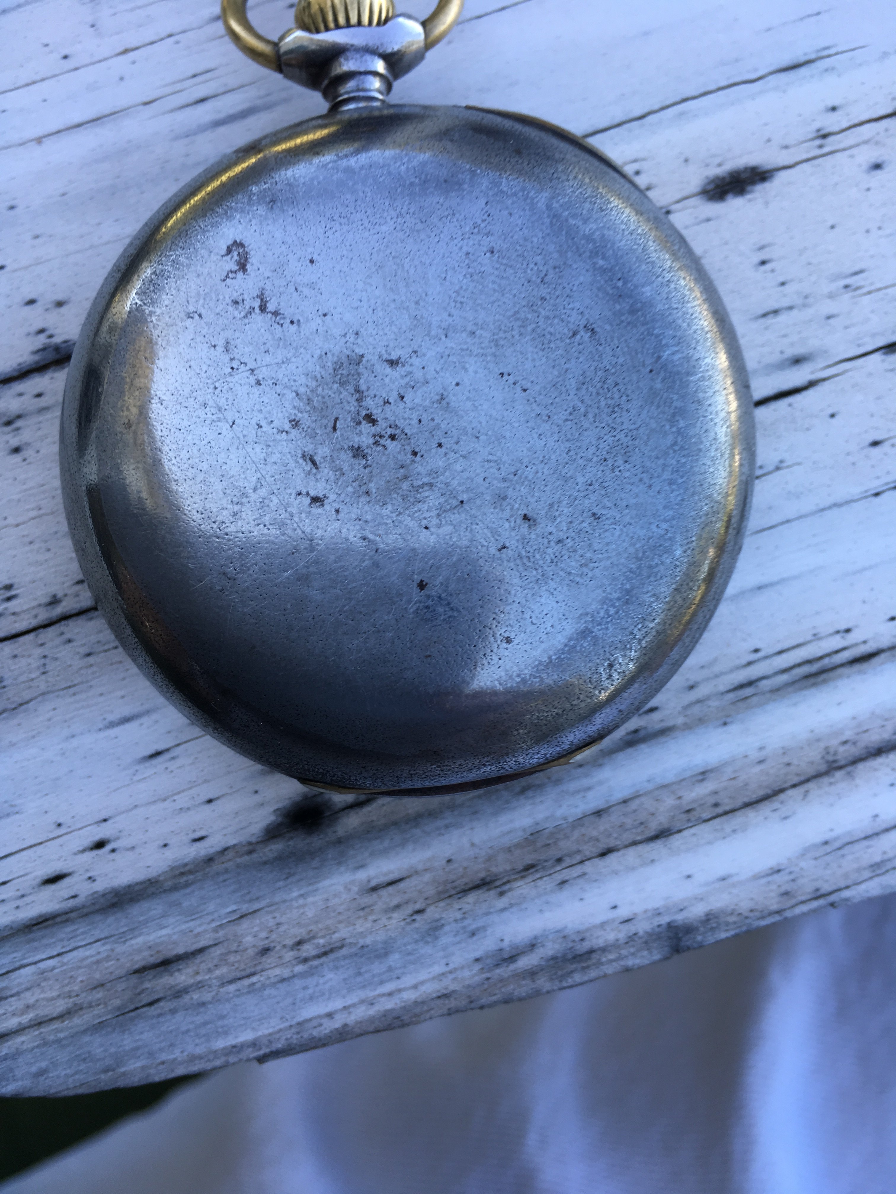

The case will be listed as ‘Acier’ - which is French for steel, but in those days not stainless steel: it would be mild steel and possibly with a gun metal finish. The case looks original (Omega) to me: we see the inner case-back/dustcover - I think the outer case-back will have the Omega mark on the inside.
I agree with Jim that the case number dates it at around 1904. The movement number will of course be under the dial.
The minute track on the dial is marked to 1/5th second - which is why it is marked up to 300. Of significance is that there are two sub-dials - continuous seconds at 6 o’clock and at 12 o’clock is a 30 minute counter. Later dials on the 19’’’CHRO were the ‘special A.T.’ dial with the ‘CADRAN BREVETE S.G.D.G.’ - which (typically) did not have a sub-dial at 6 o’clock and the sub-dial at 12 o’clock was a 15 minute counter.
Jim is correct in noting the ‘M’ on the movement (to which @Tire-comedon has previously referred), which was used on watches destined for France. ‘M’ was used if the movement was cased in metal, ‘A’ (for Argent) if the case was silver and ‘O’ (for Or) if the case was gold.

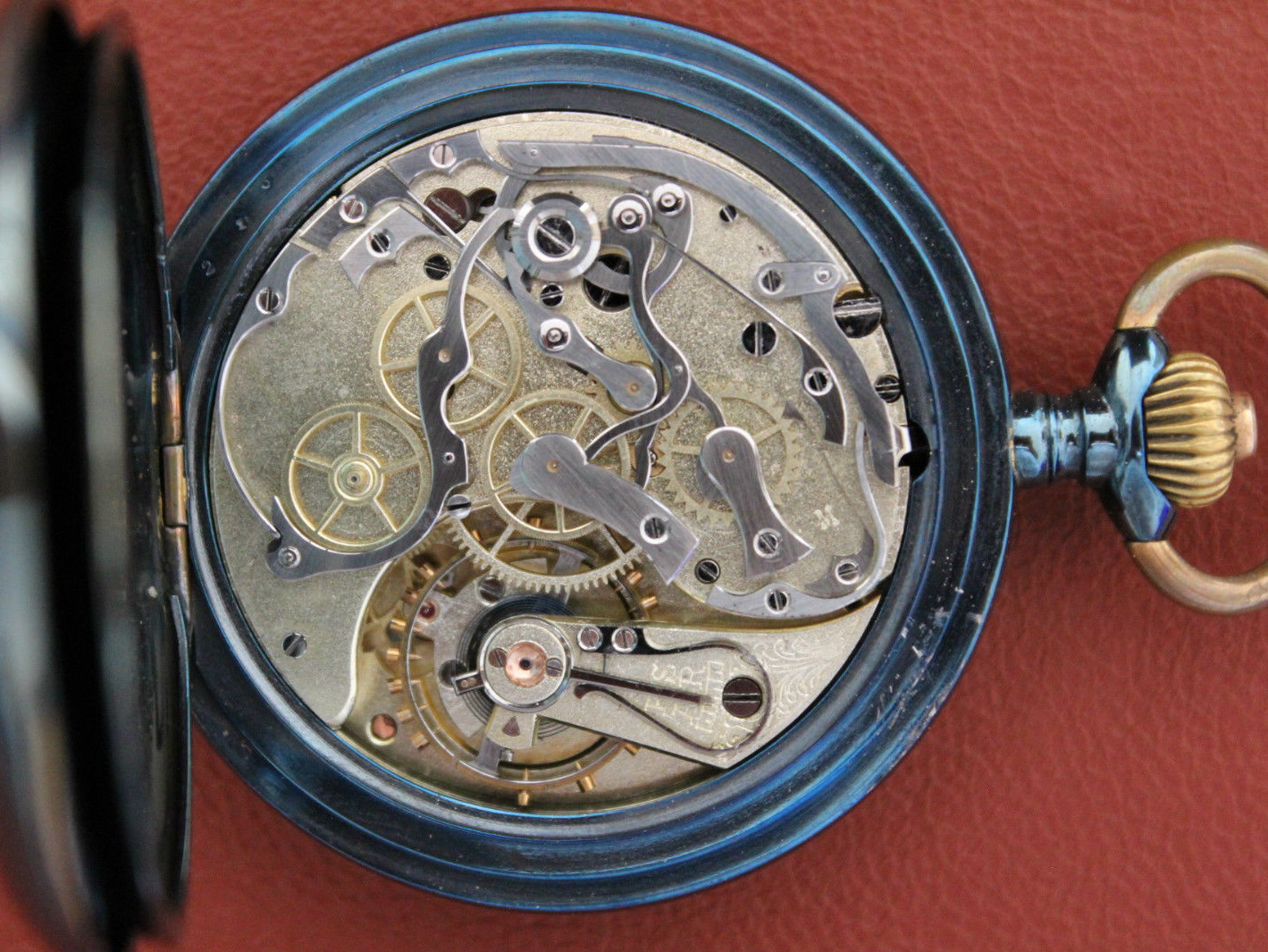

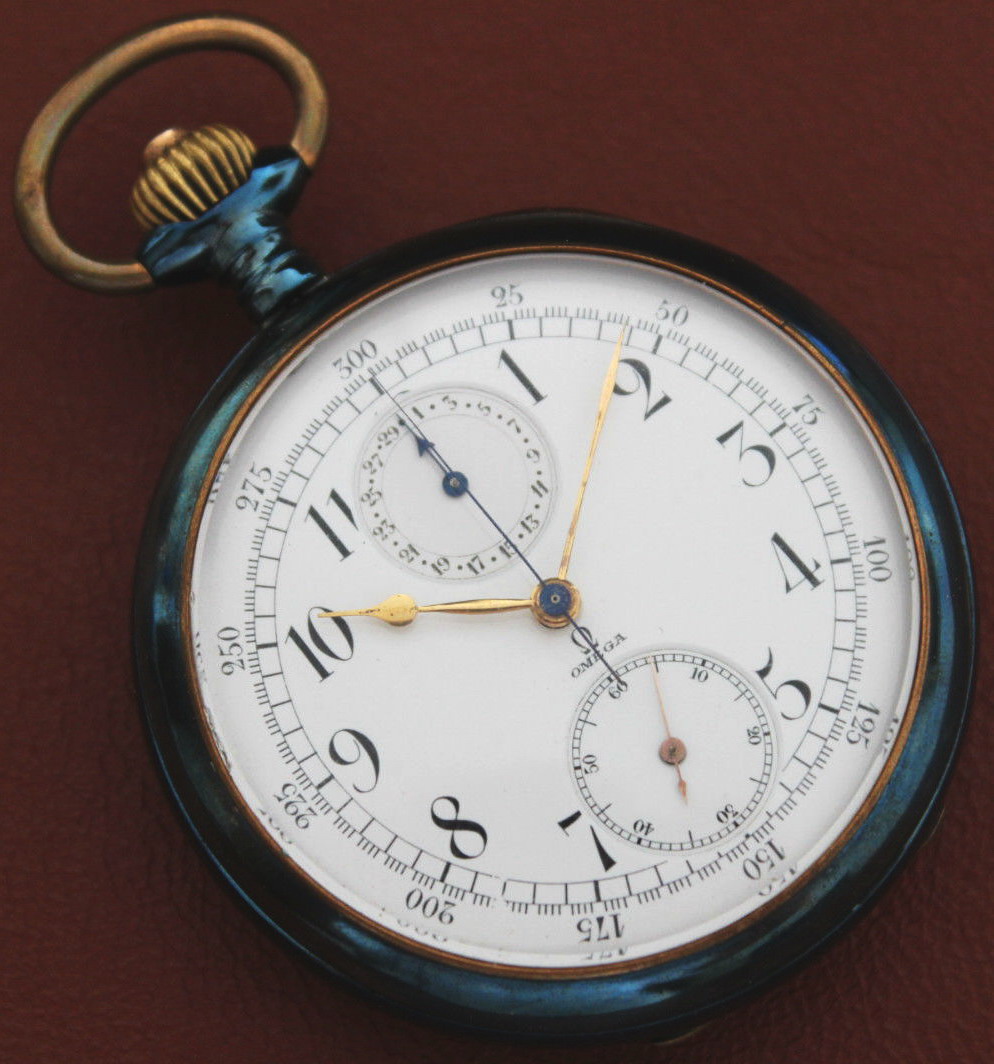

My own version in gun metal, quite similar to the OP’s, is below. This came from another distinguished OF member!
Lovely watches - and now over 120 years old!

I had it in my head that the "M" meant a metal movement (not case) so once again, learning the correct meaning will have to be plugged in to a vacant spot in my memory bank.
I also didn't realise I was looking at the inside of the movement cover and not the caseback. I shall have to pay more attention in future. :whipped:
