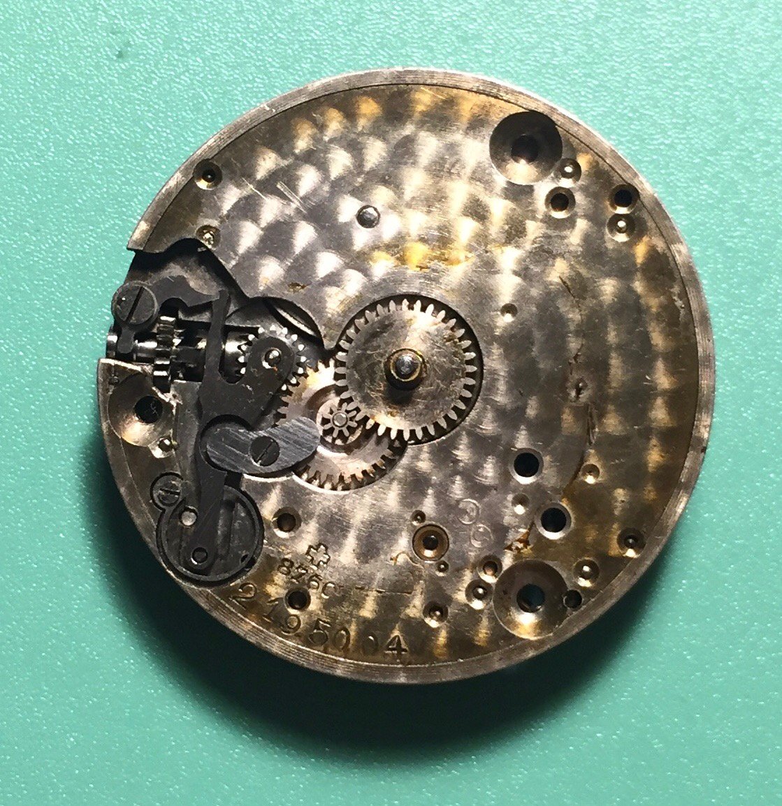

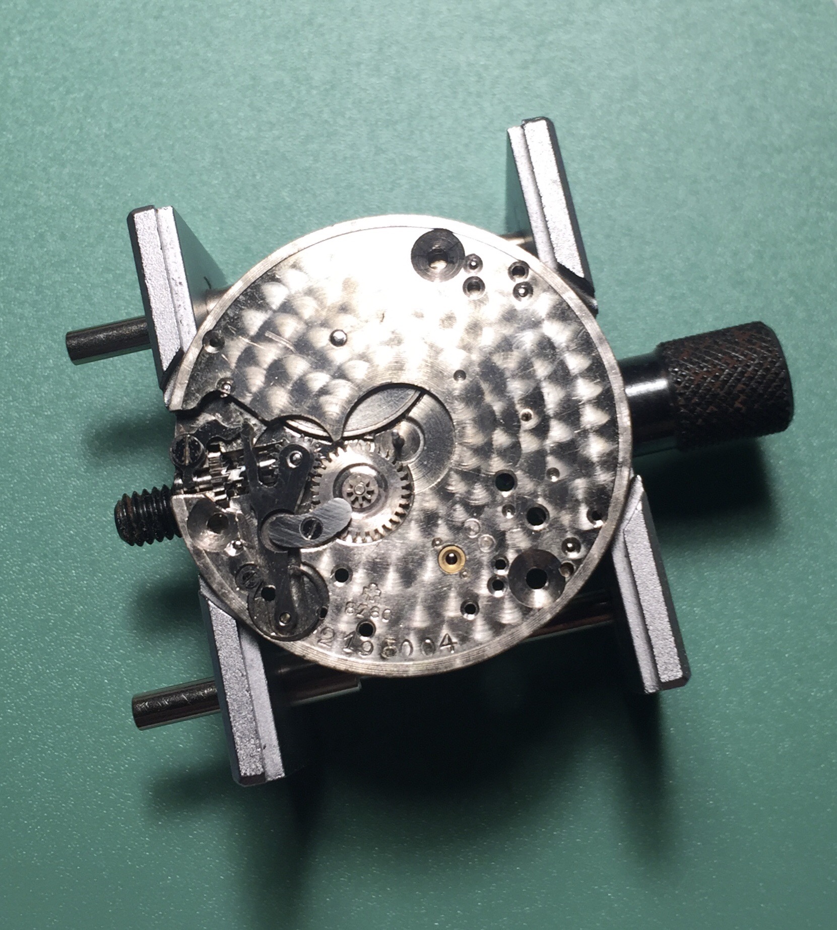

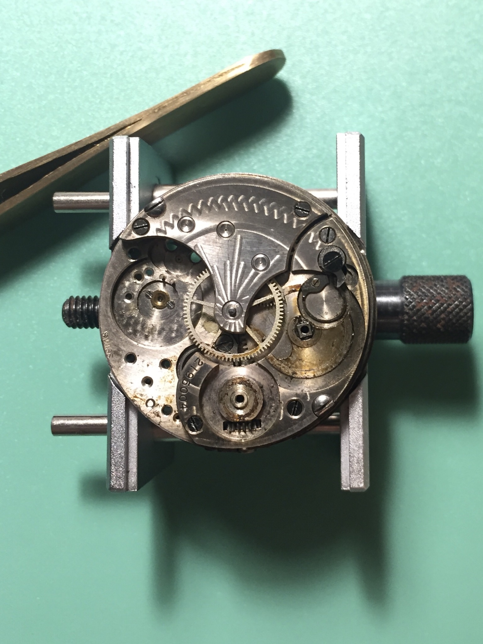

This is perhaps my first Omega pocket watch, an impulse buy to tinker with. It smells horribly of WD40...obviously not running. You can probably just make out the old, solidified oil on the centre wheel. It seems to be quite an early piece from 1900s, when watchmakers still combined the movements and cases together.
This may seem like a silly question, but there doesn’t seem to be a setting lever screw. How, exactly, are you supposed to remove the stem? 😕

Look for a screw on the crown tube. But, if this is a negative set and the crown pulls up, that actually leaves enough slack to get the movement out.
But! If you are not a watchmaker, there is nothing you can do to improve the situation. I can't tell you how regretful certain past actions were.

The crown does pull up, so I guess it’s really as simple as that. I’ll update the thread once I have the time to work on it and get it running again!

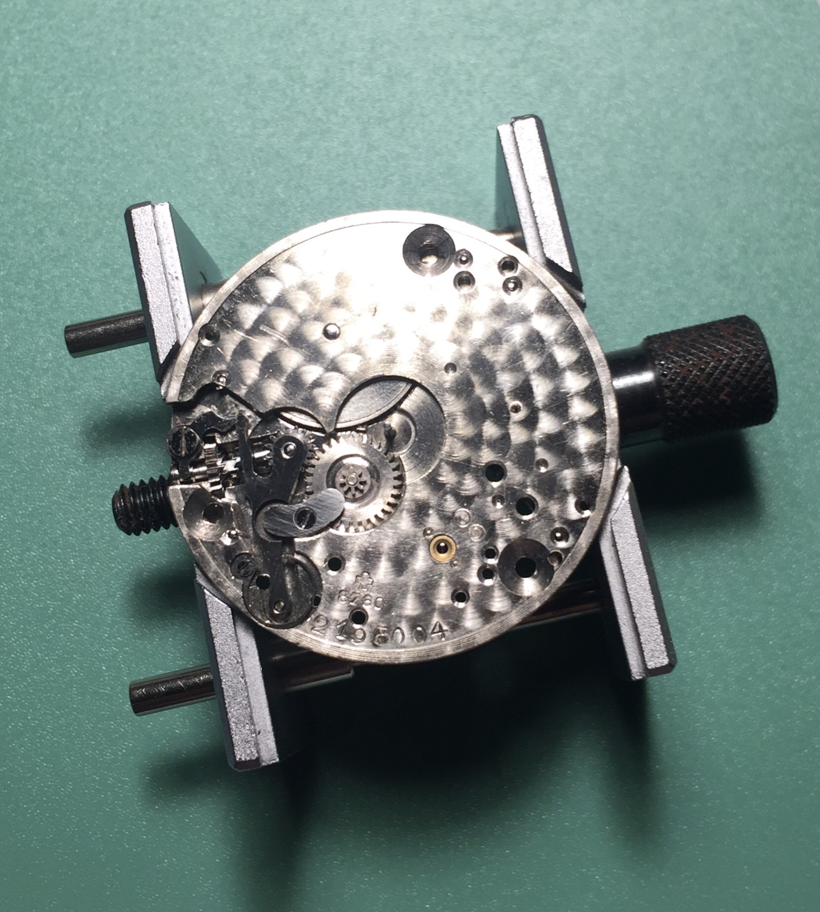

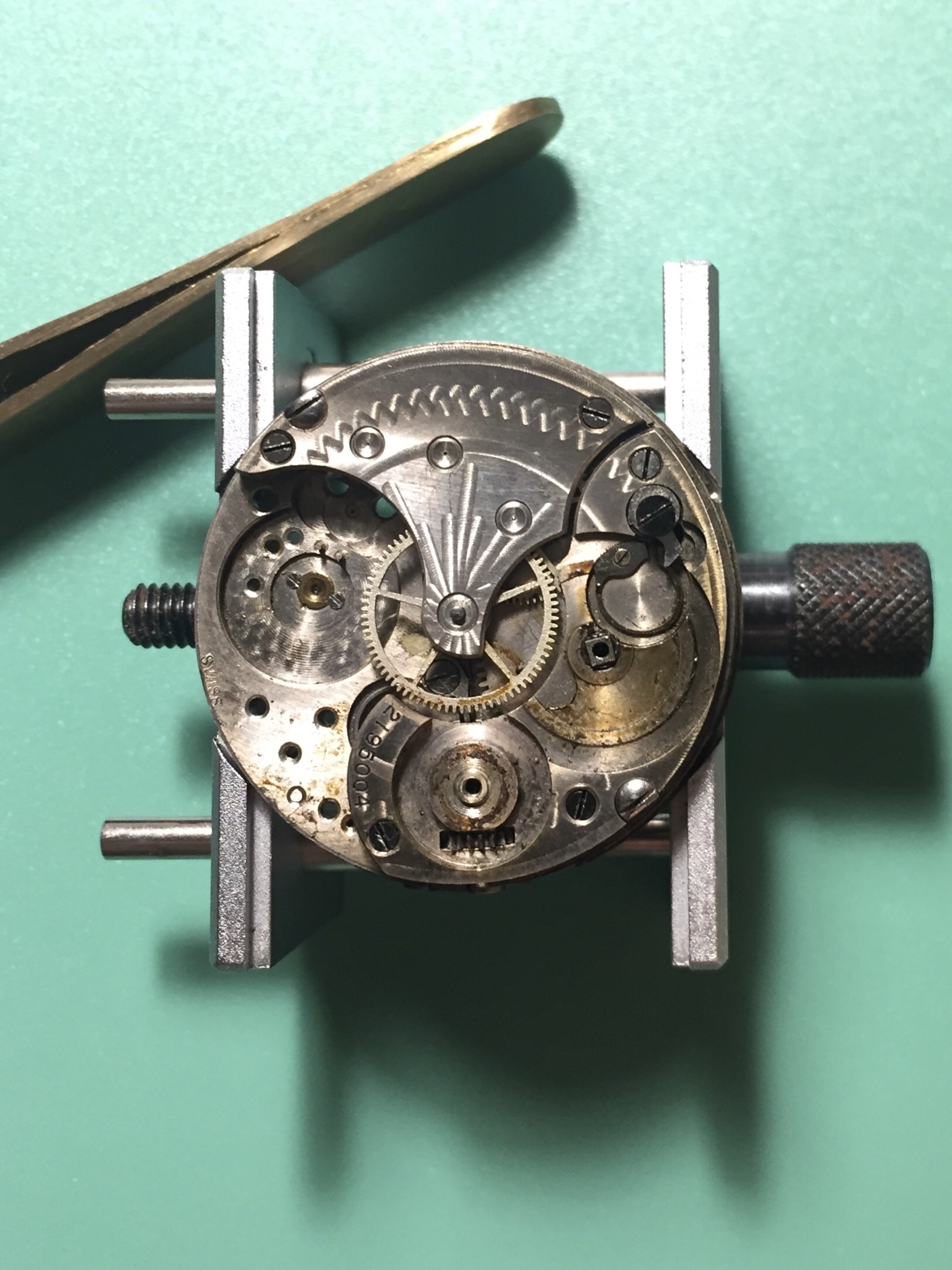

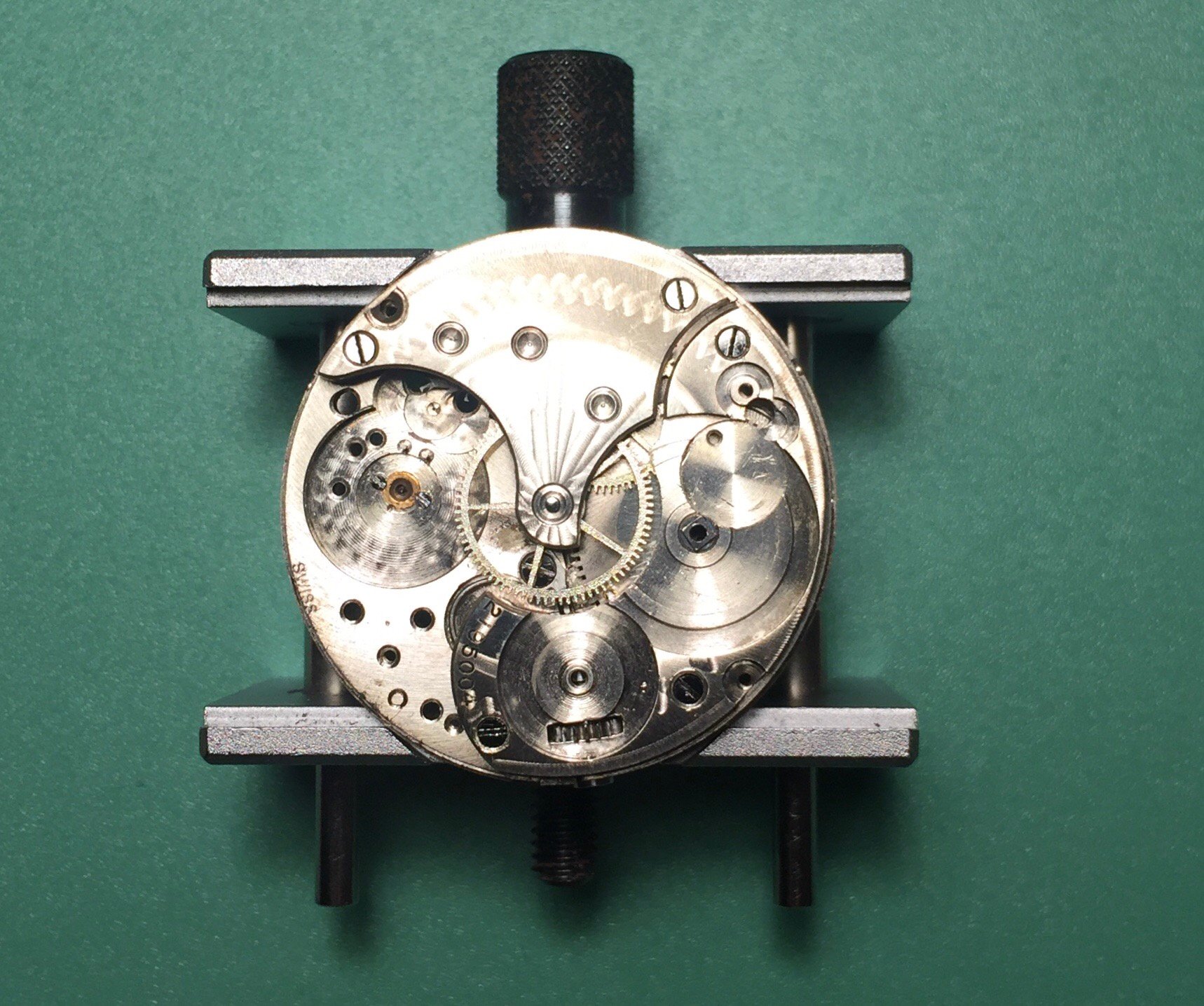

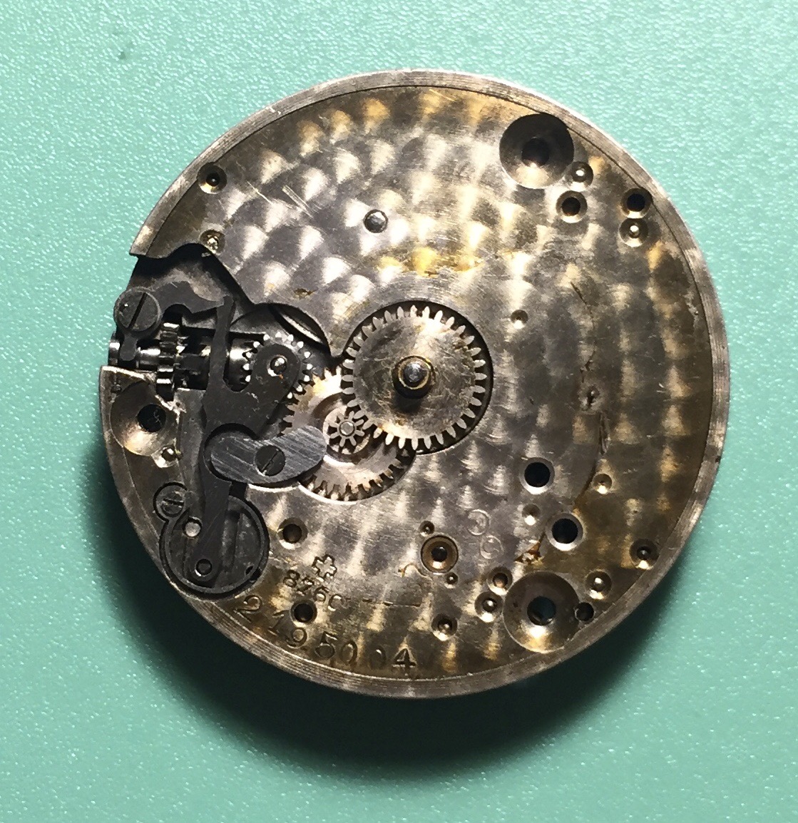

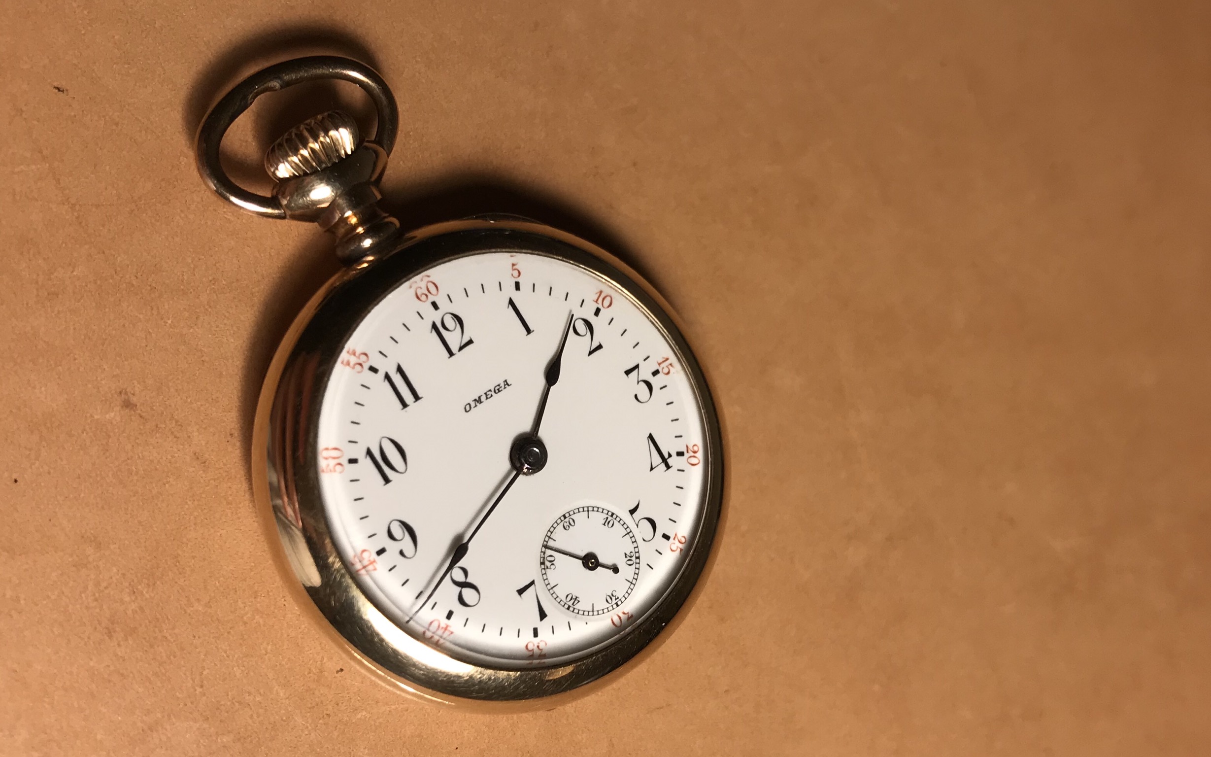

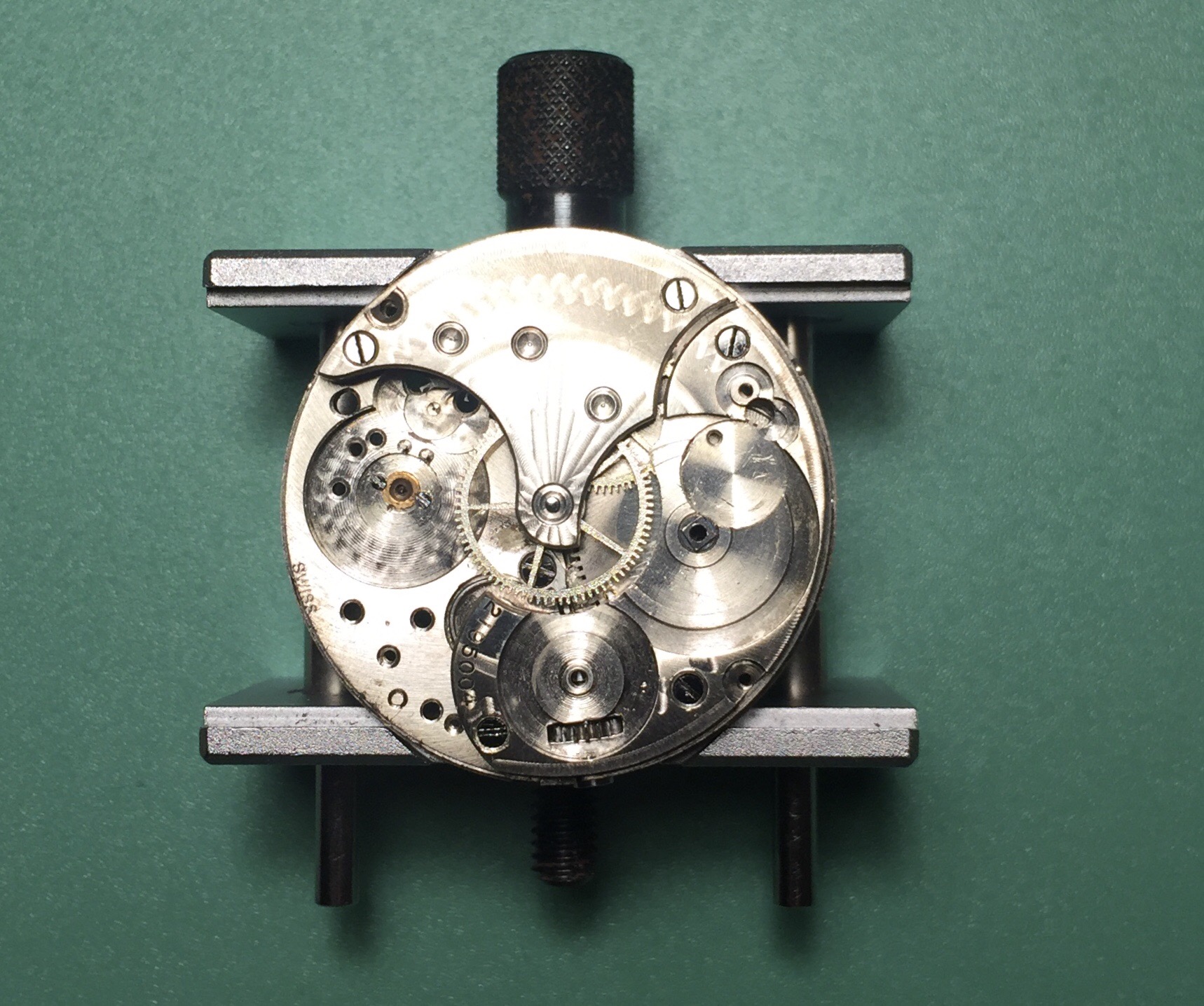

Thanks again for the advice! The movement simply dropped out after having pulled the crown up. The movement was in a horrid state.

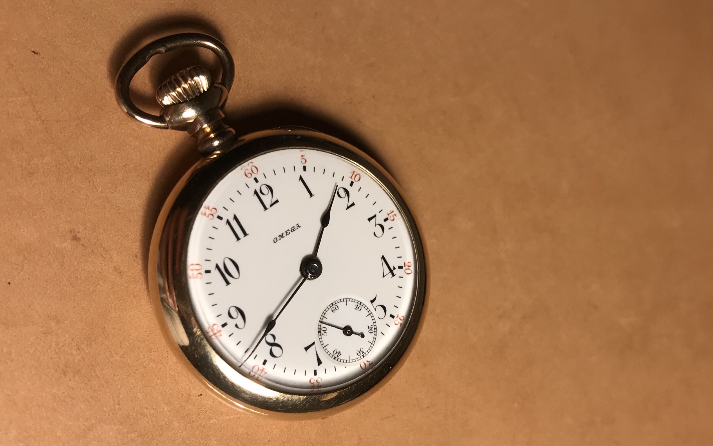

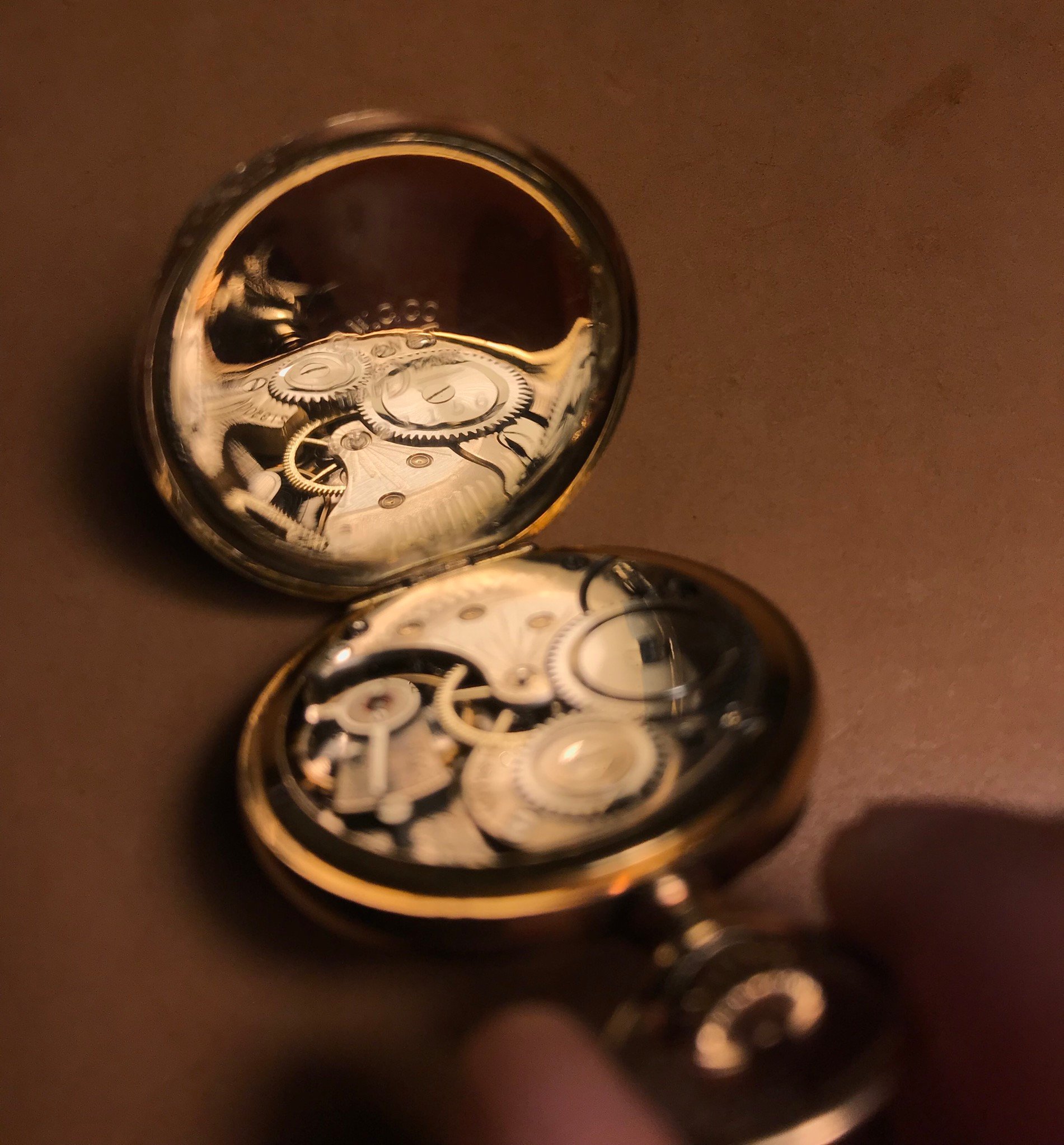

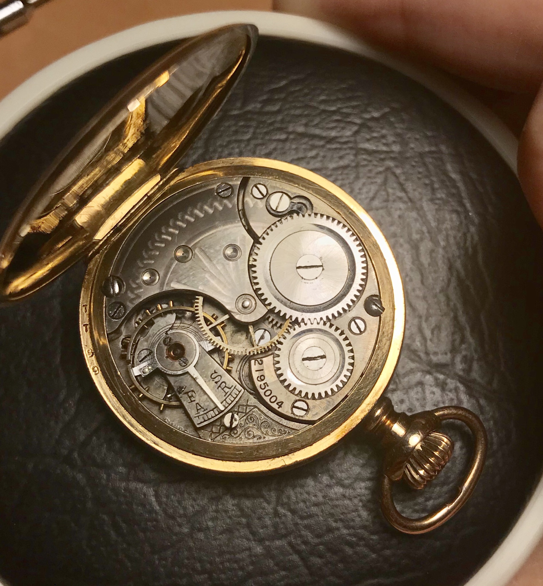

So, as promised, here are some before and after photos which I quickly took during the process. Running nicely now.
411
627

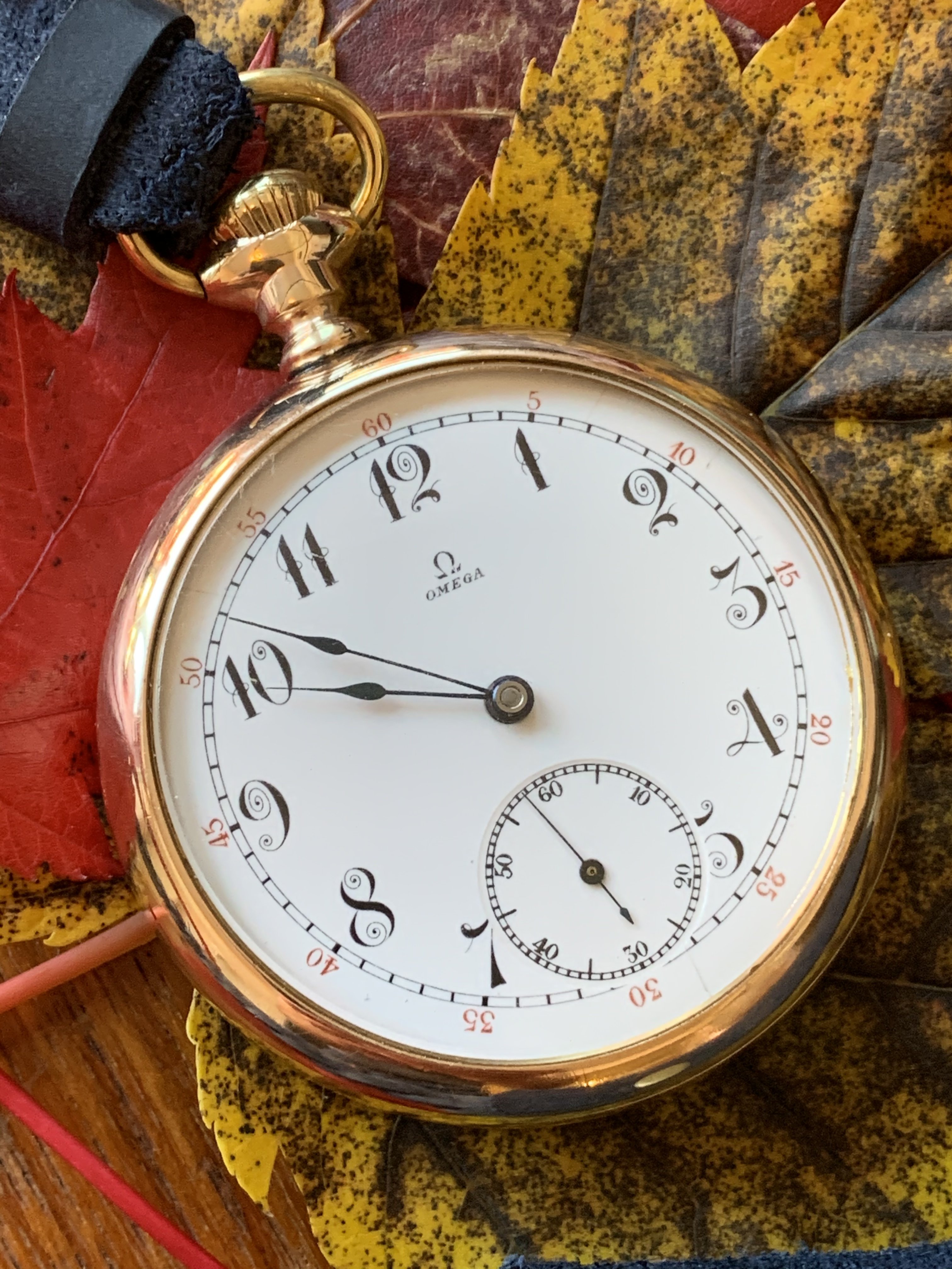

Congratulations! Wear it in good health!
5,076
15,713

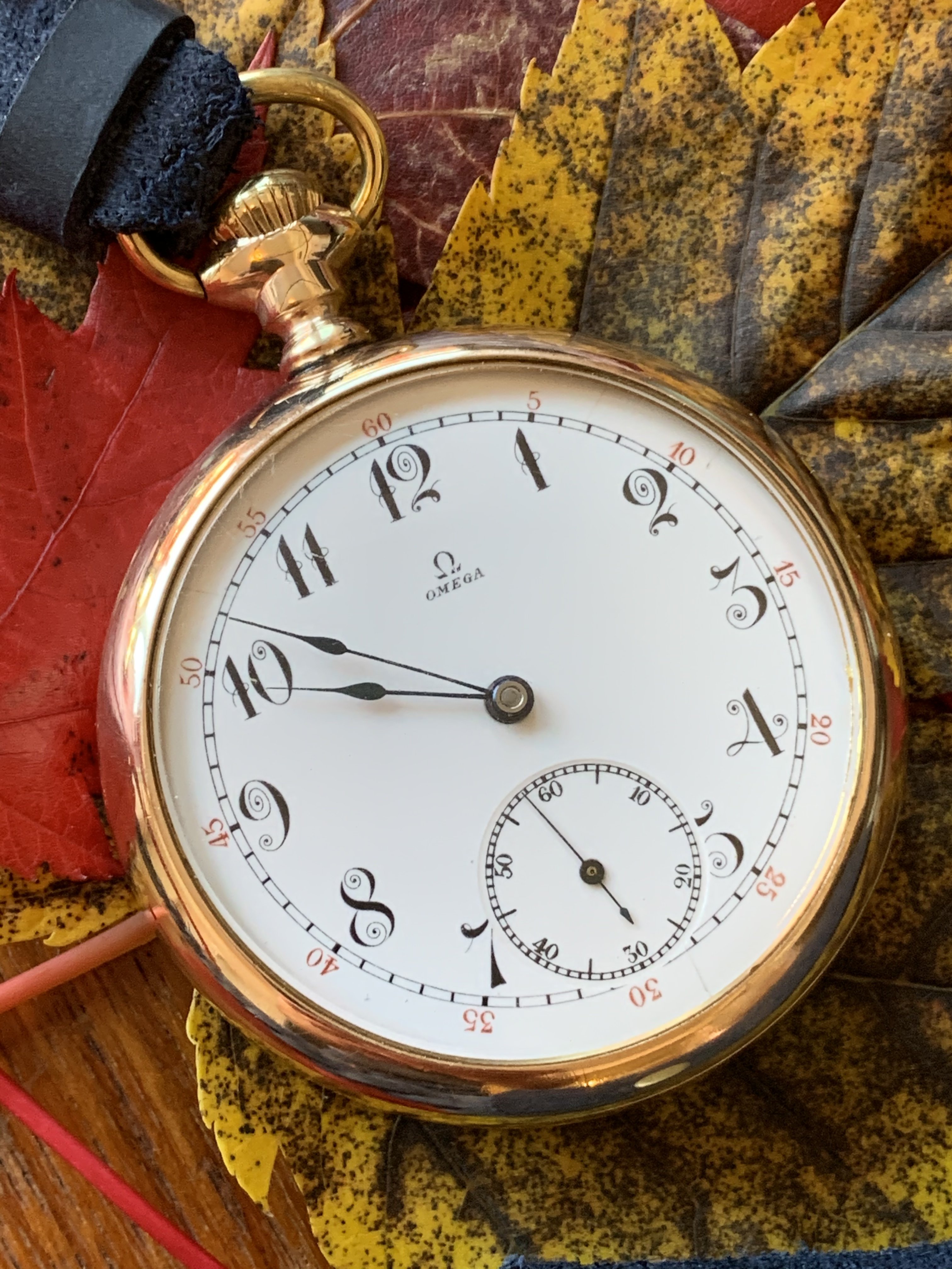

Your serial dates it to c1903, it is similar to my c1907. Fun to see how the font had become more extravagant in a few years
