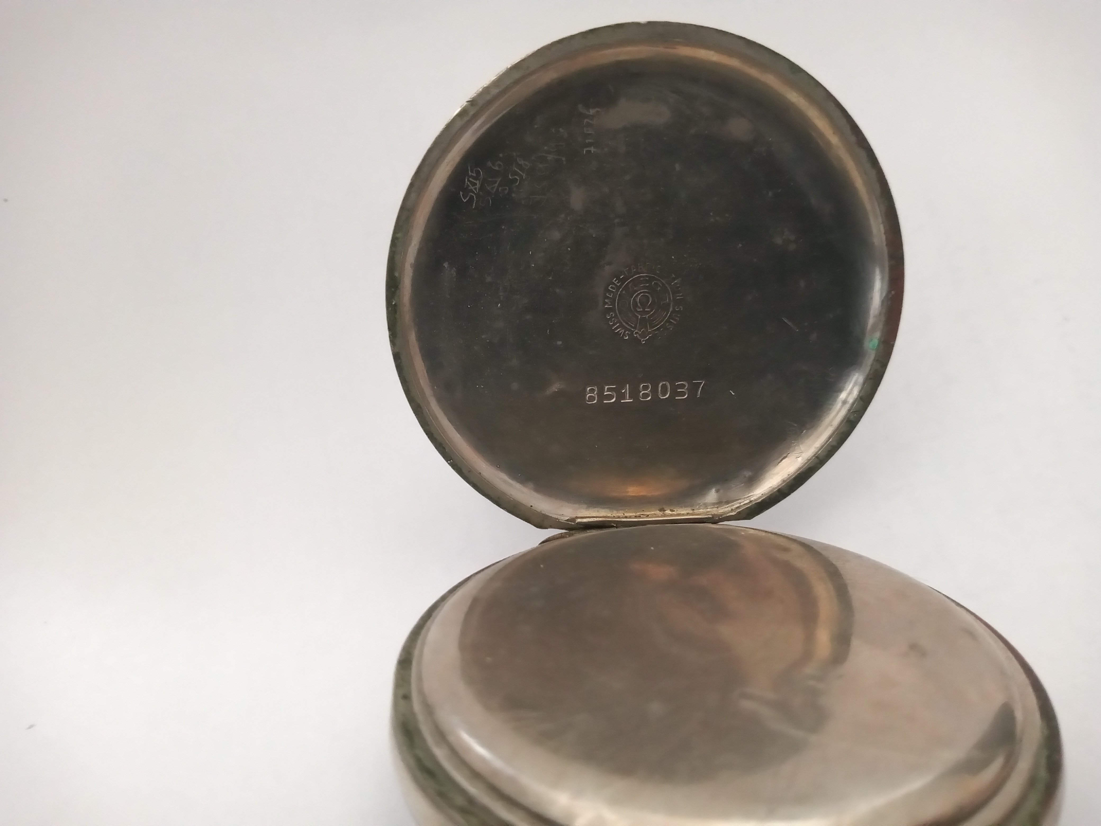

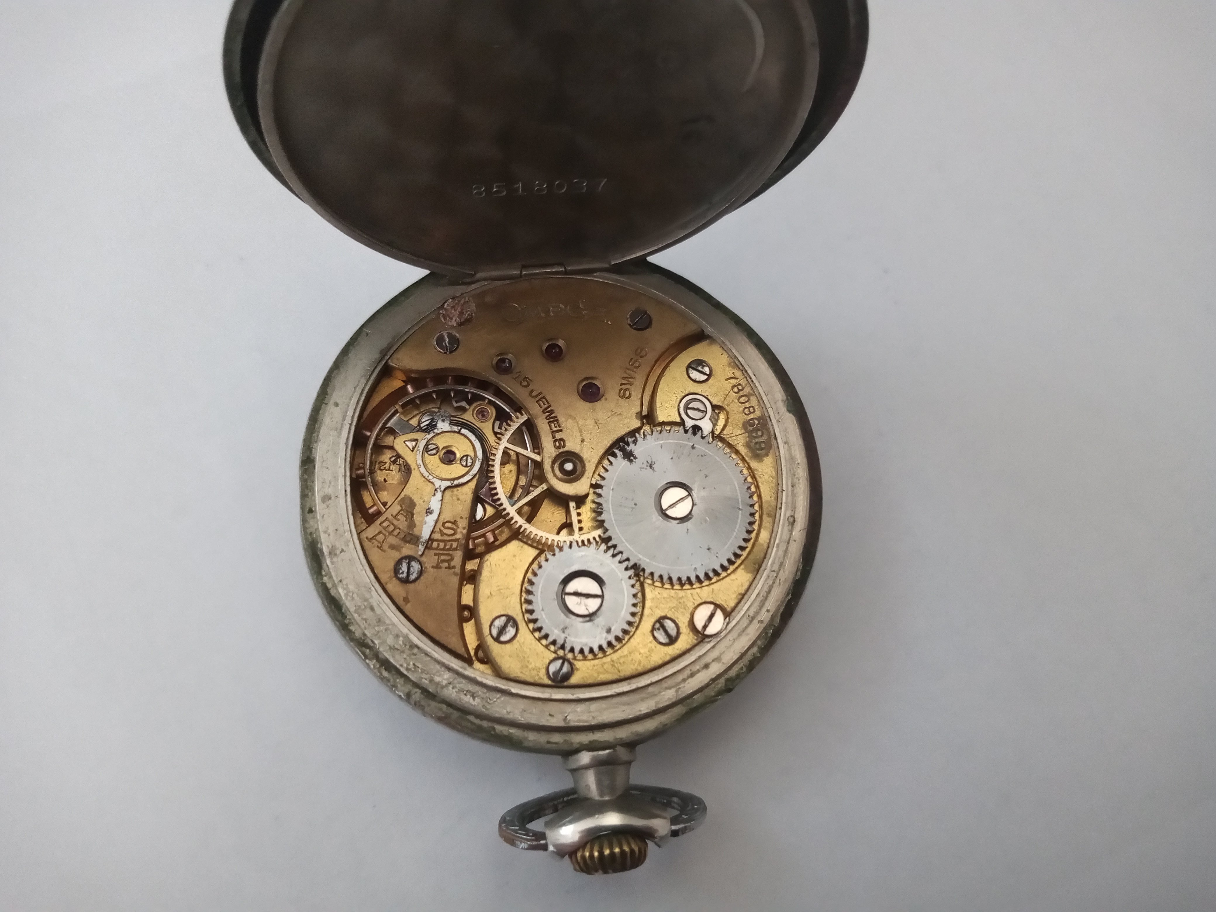

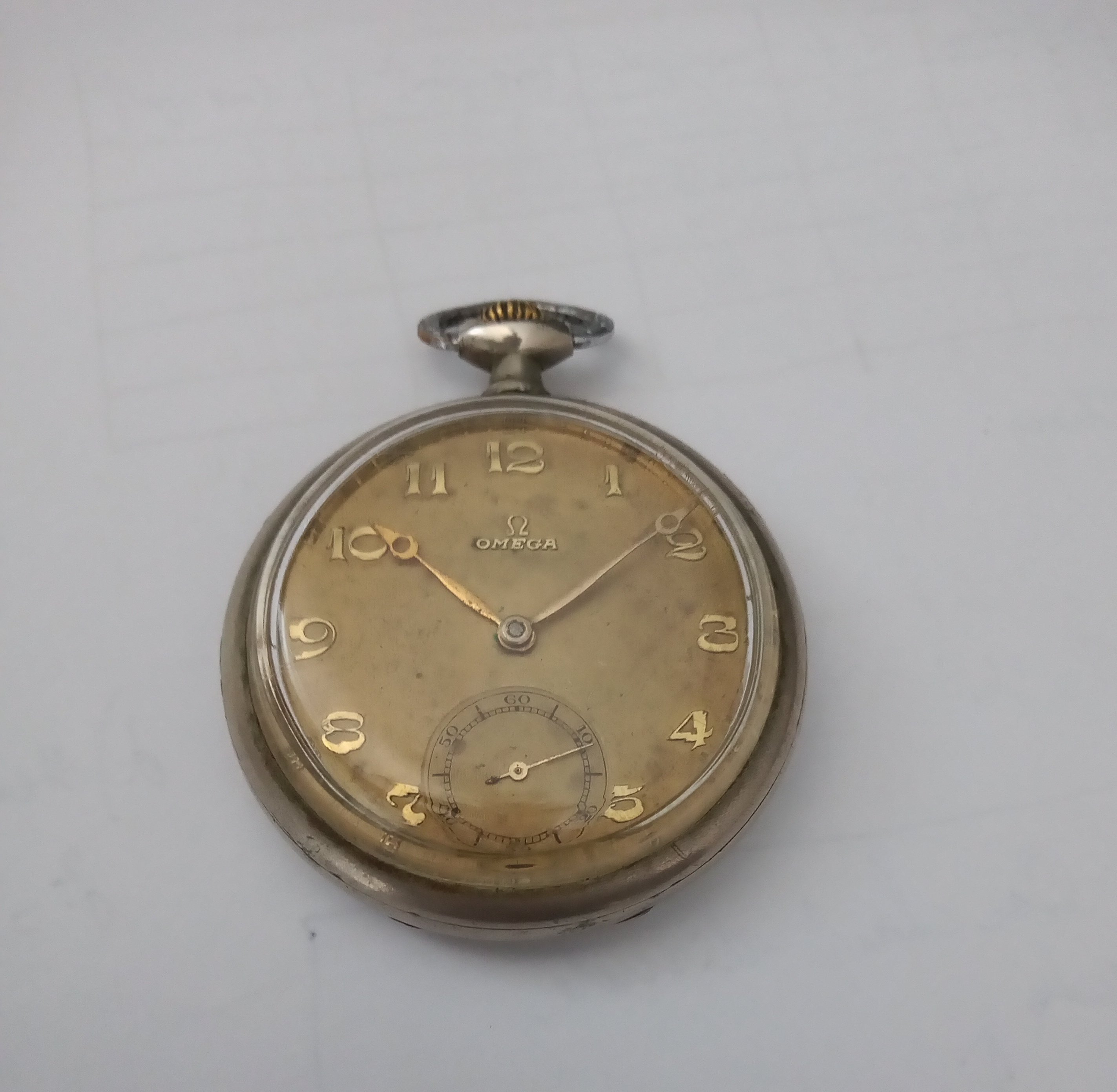

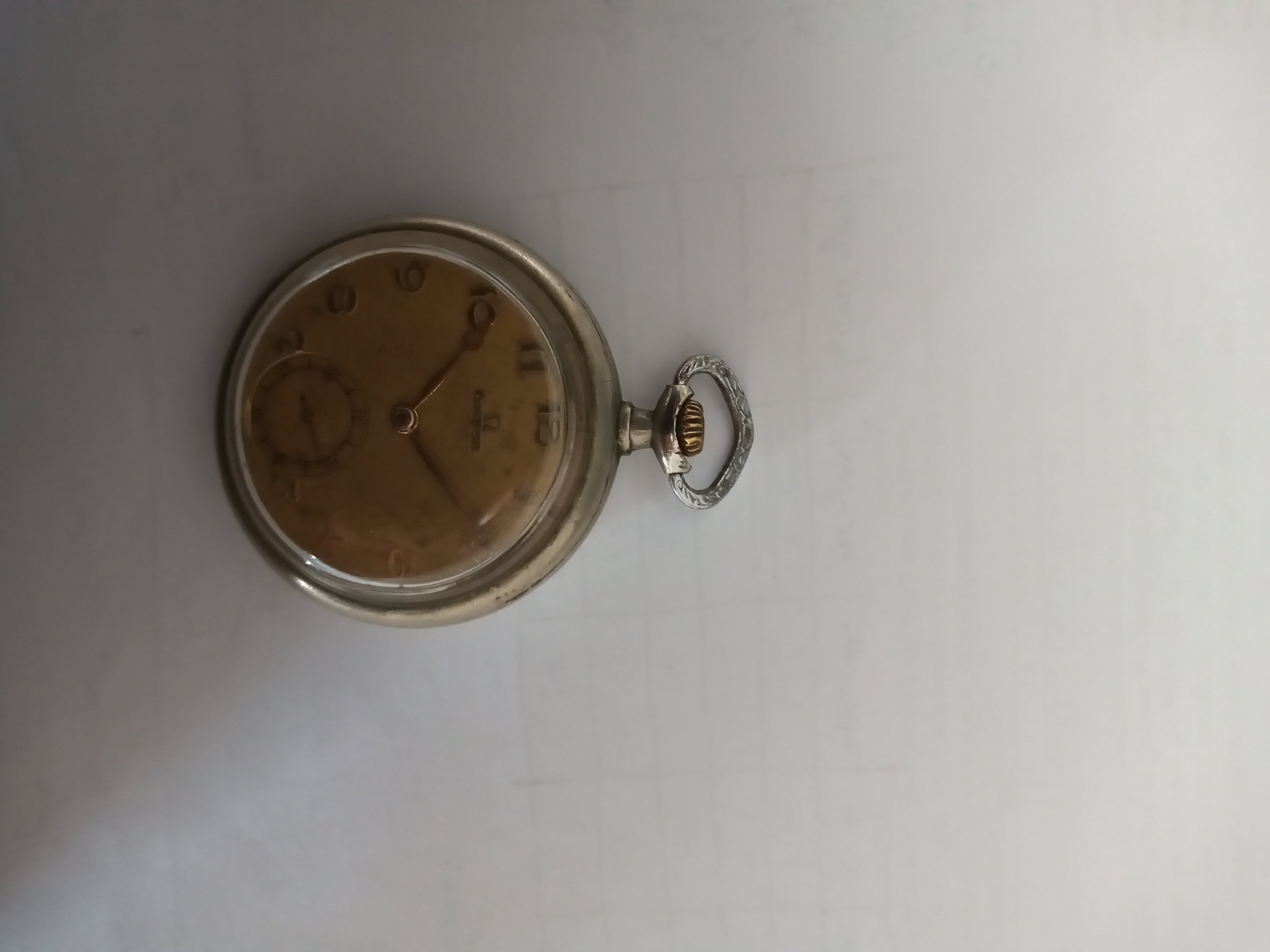

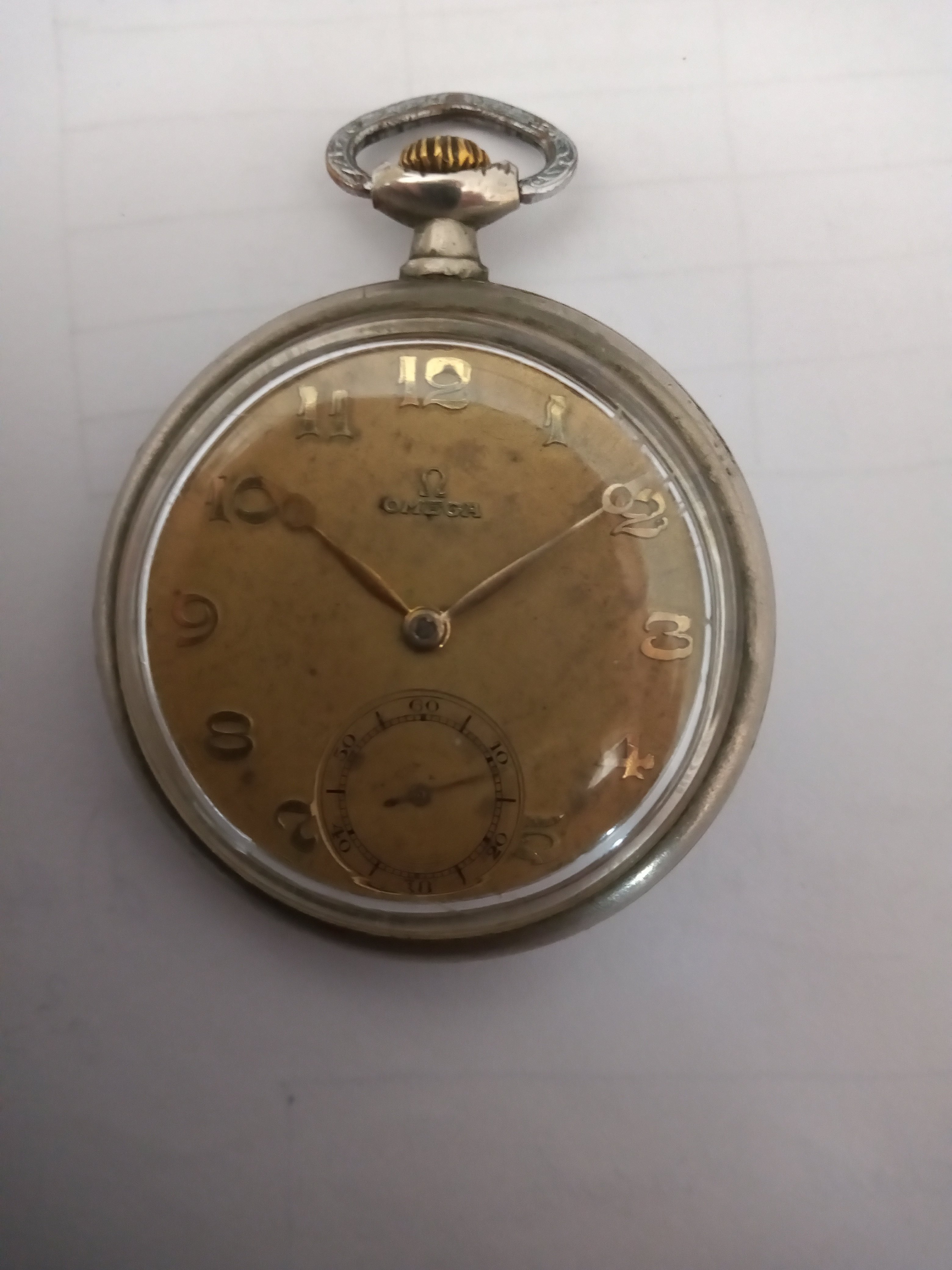

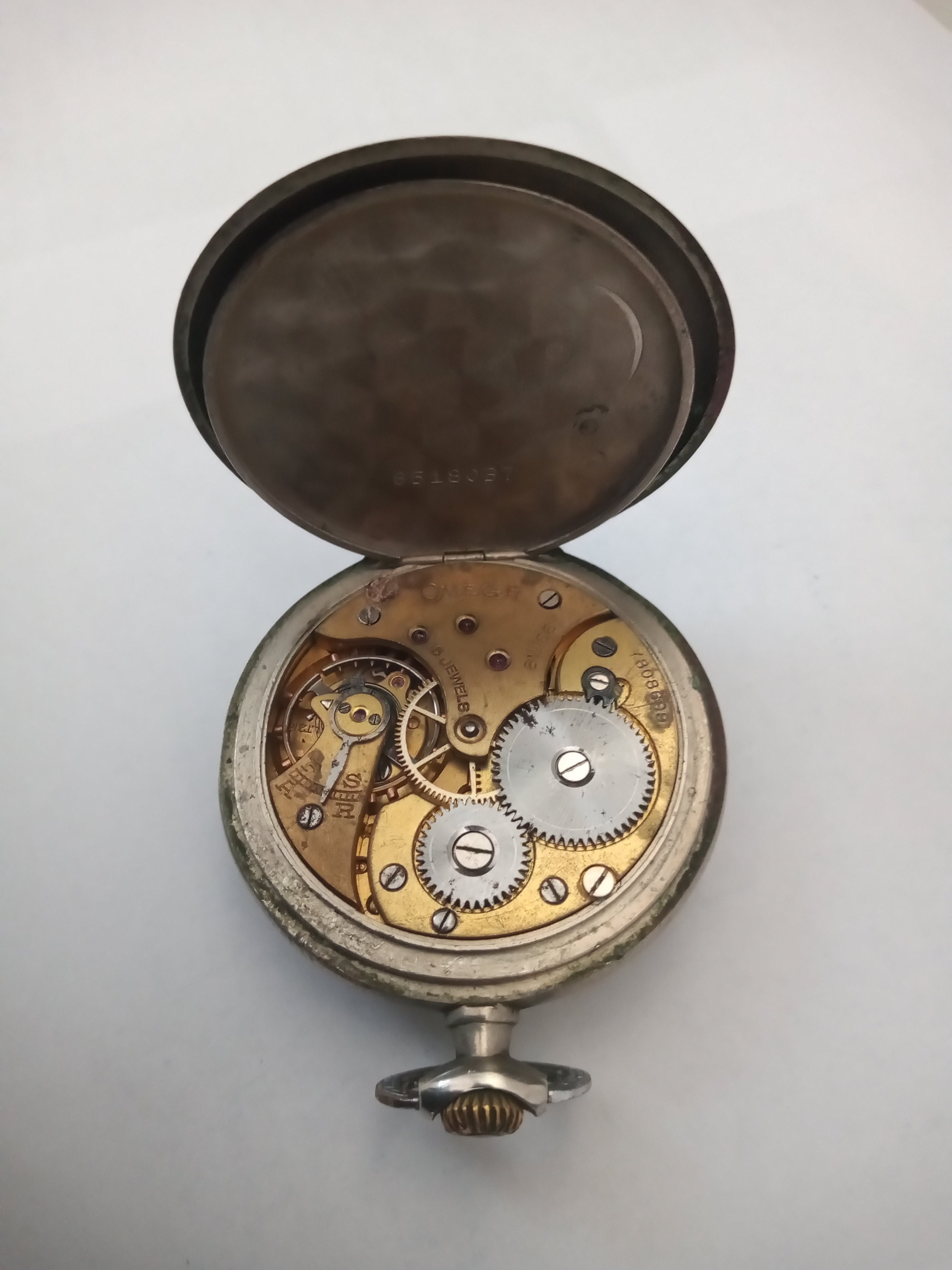

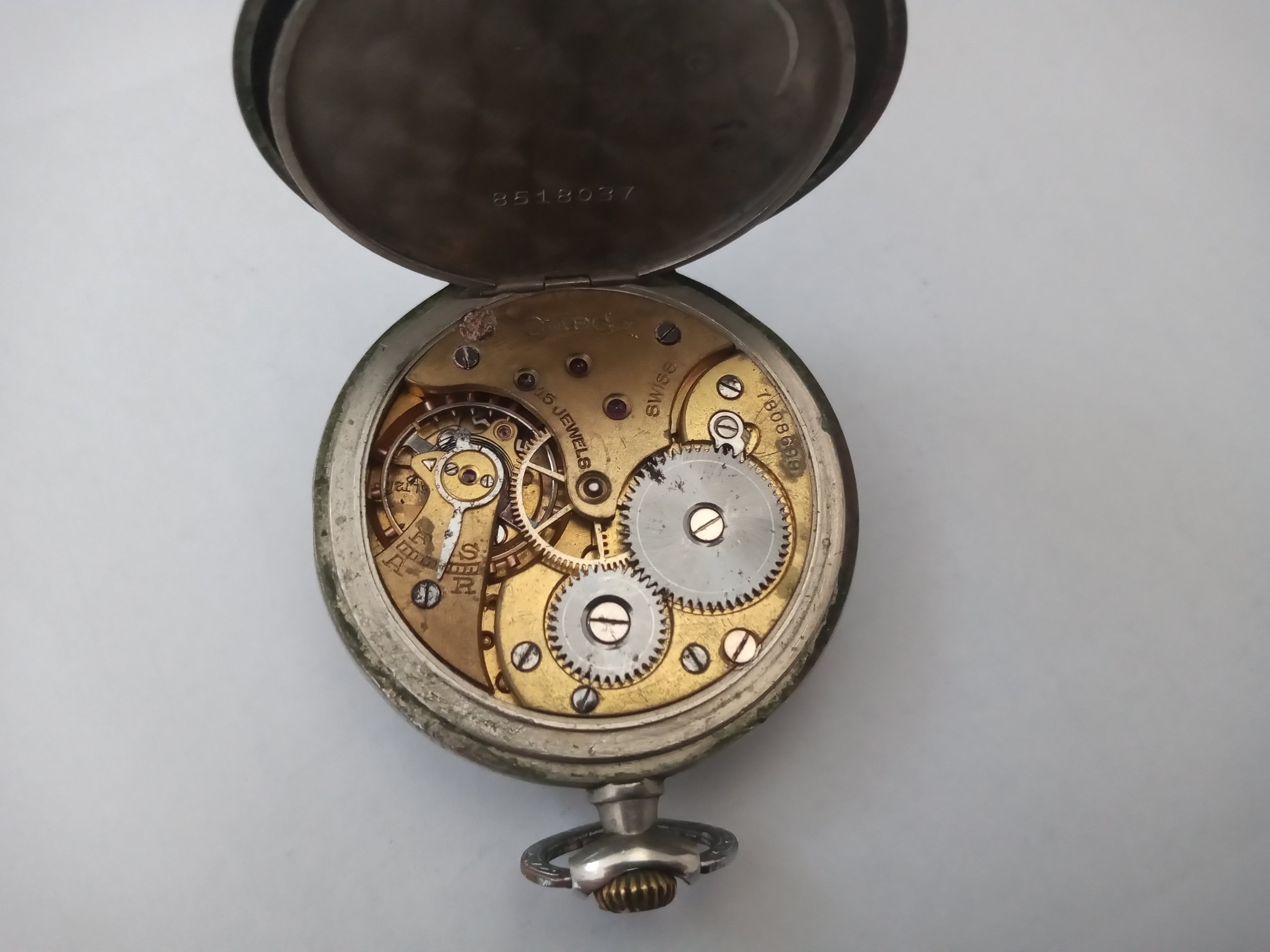

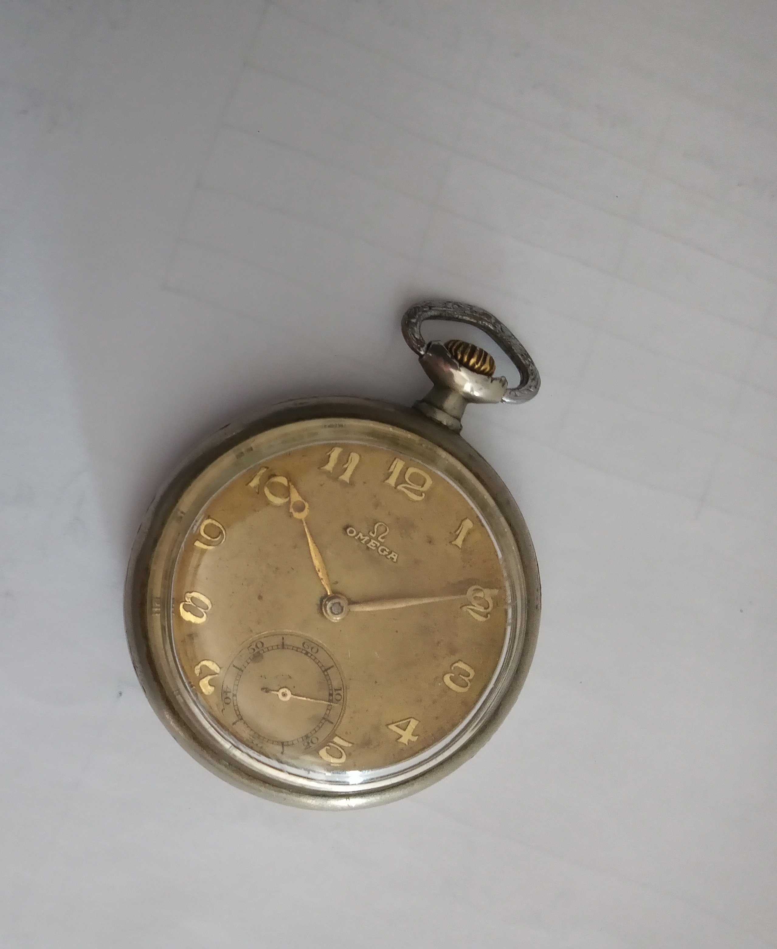

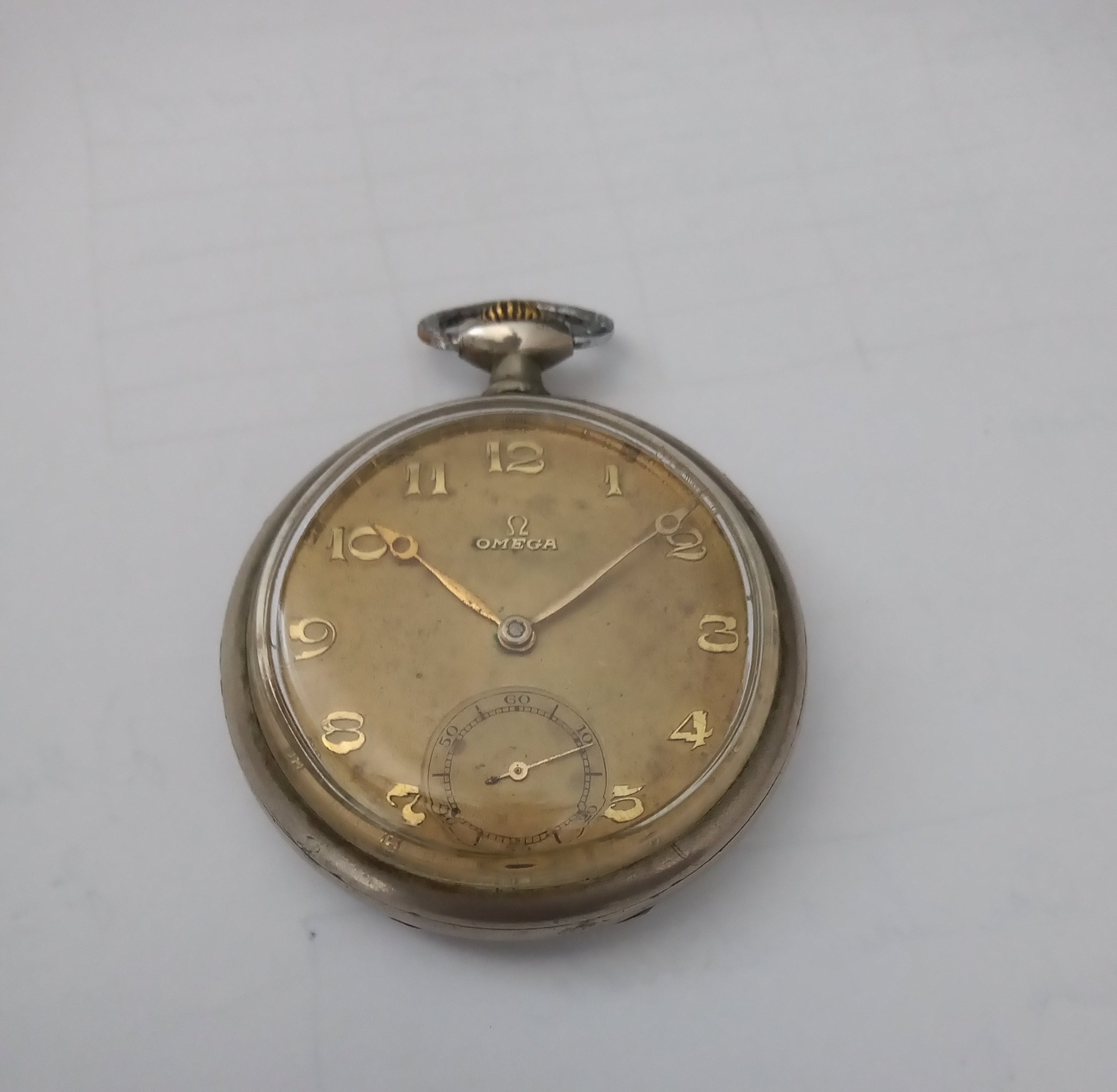

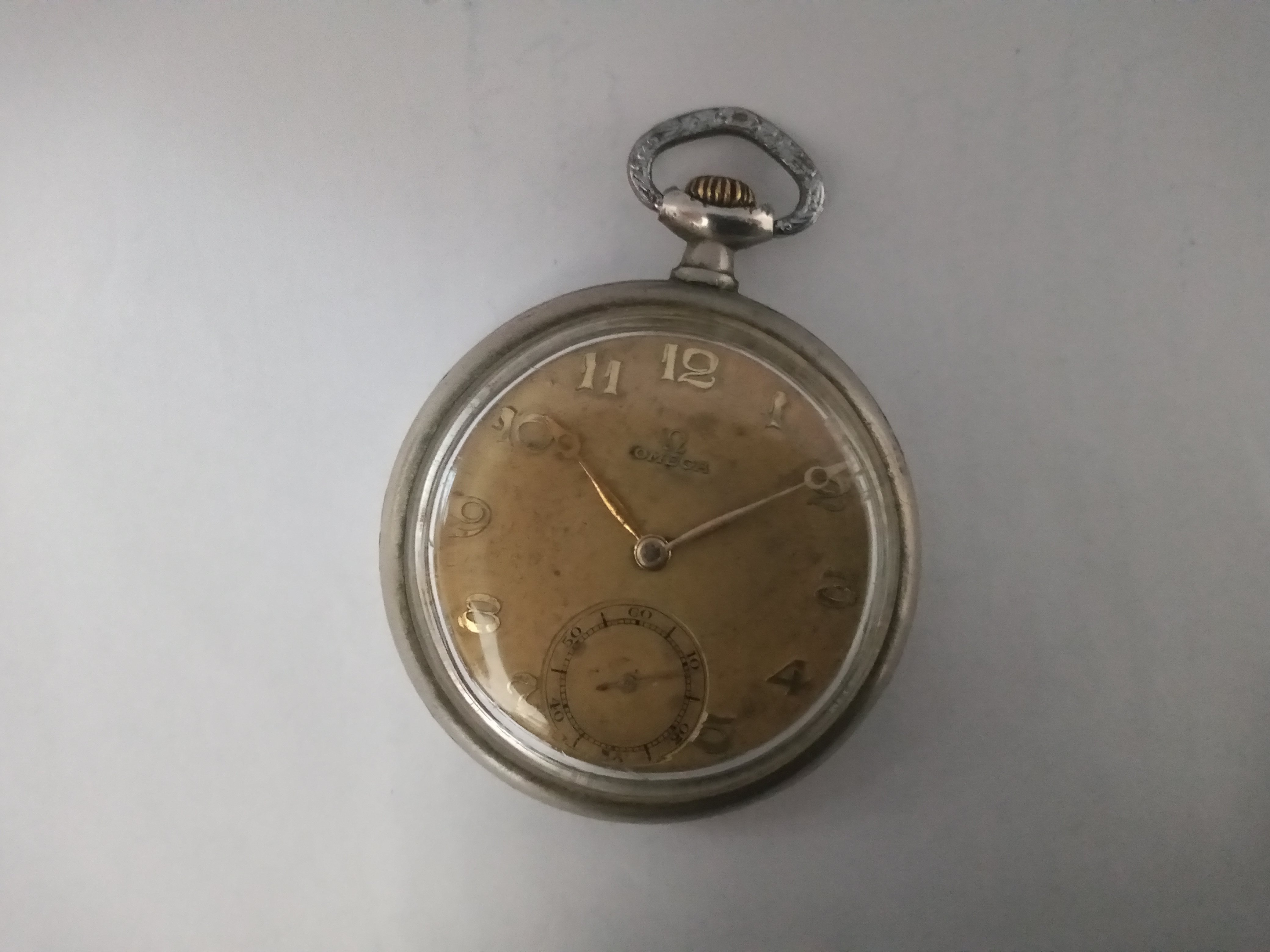

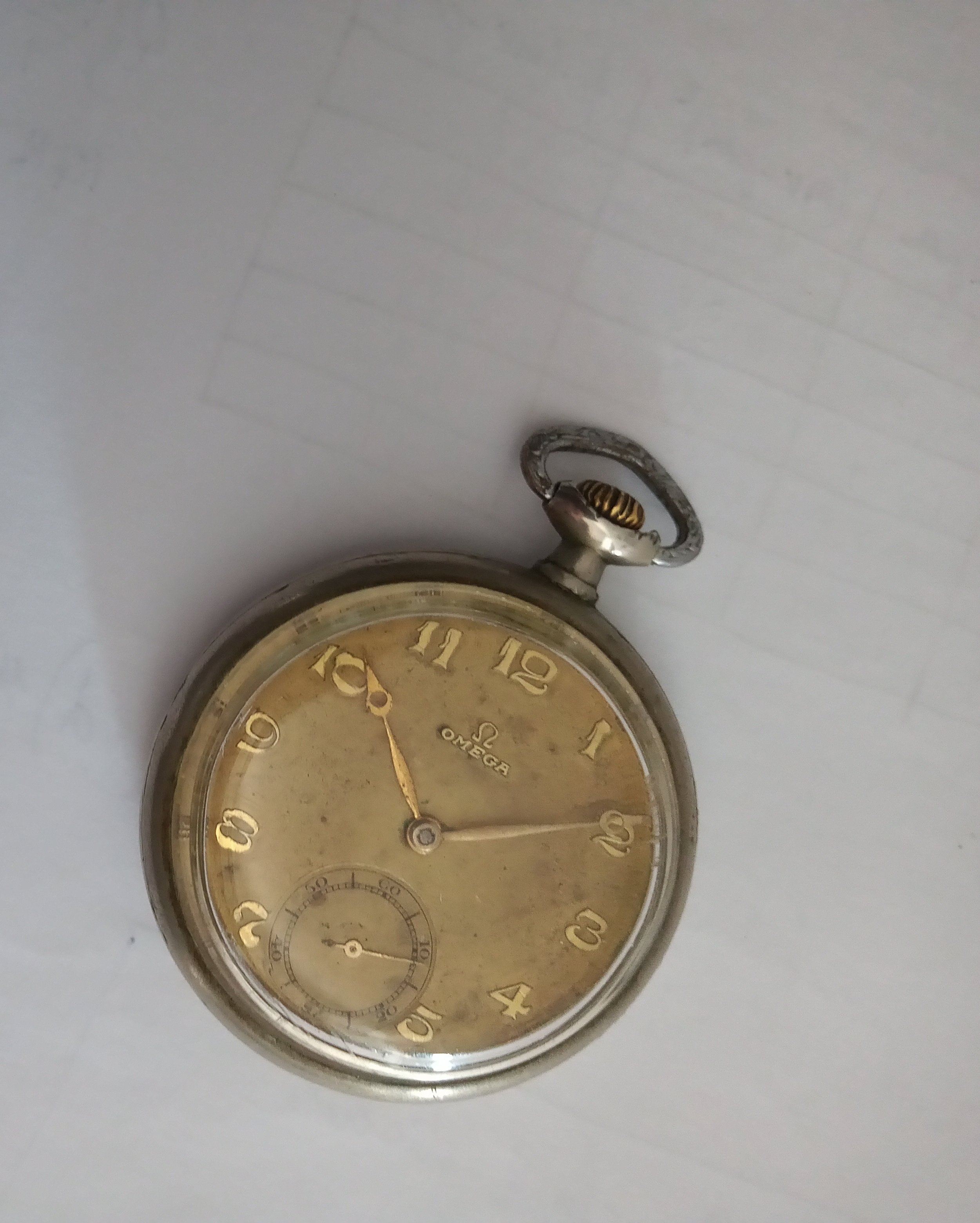

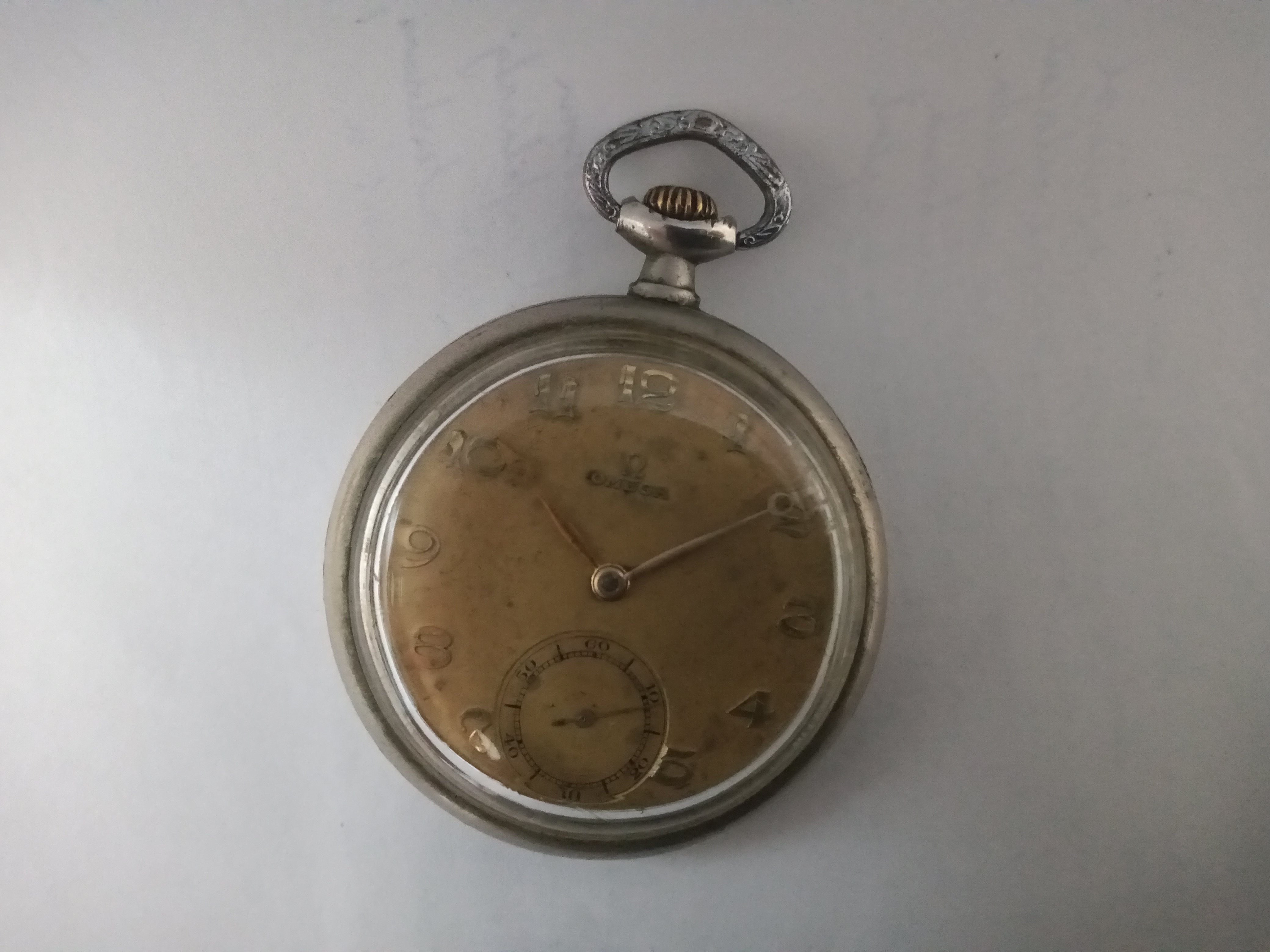

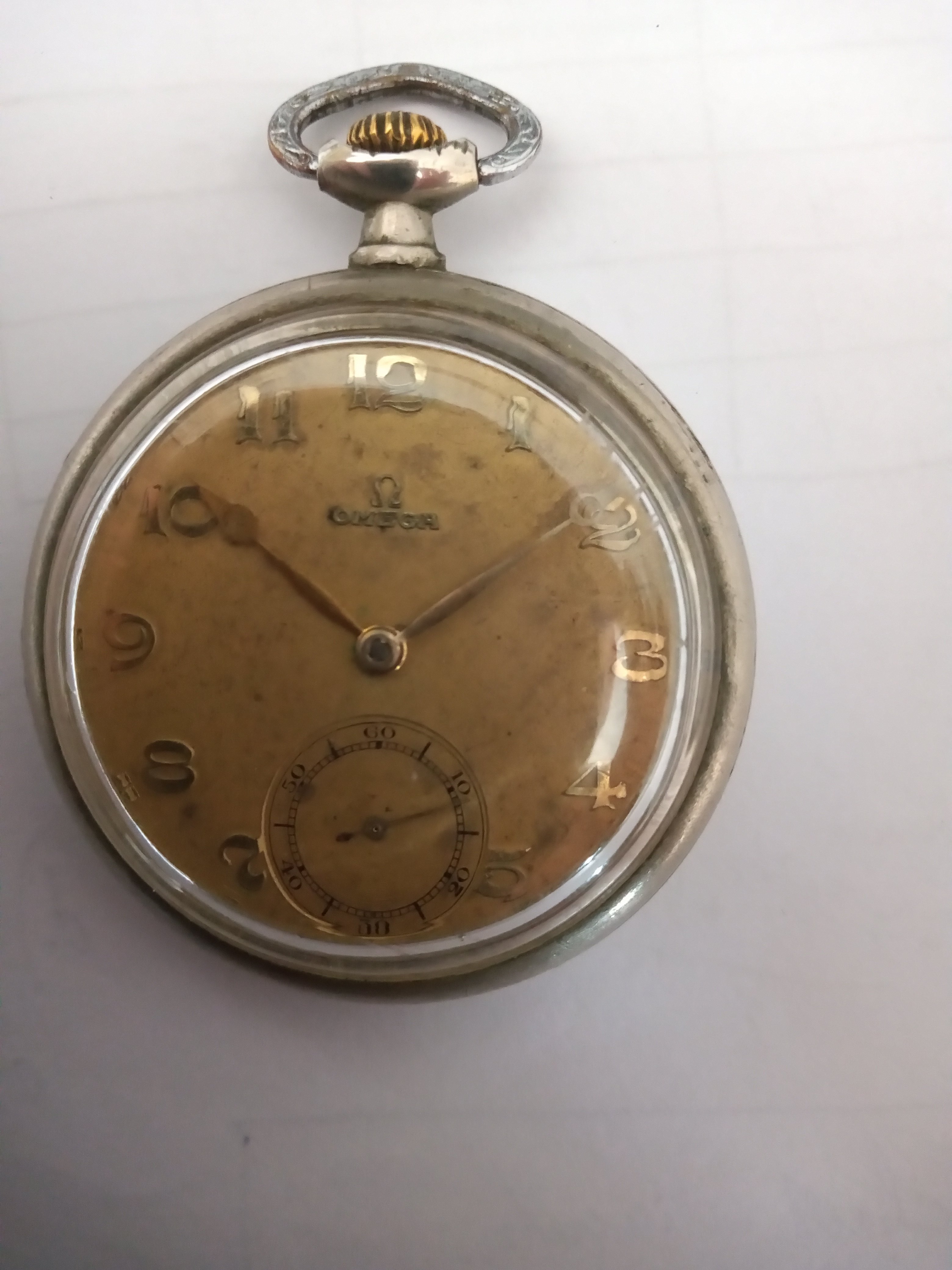

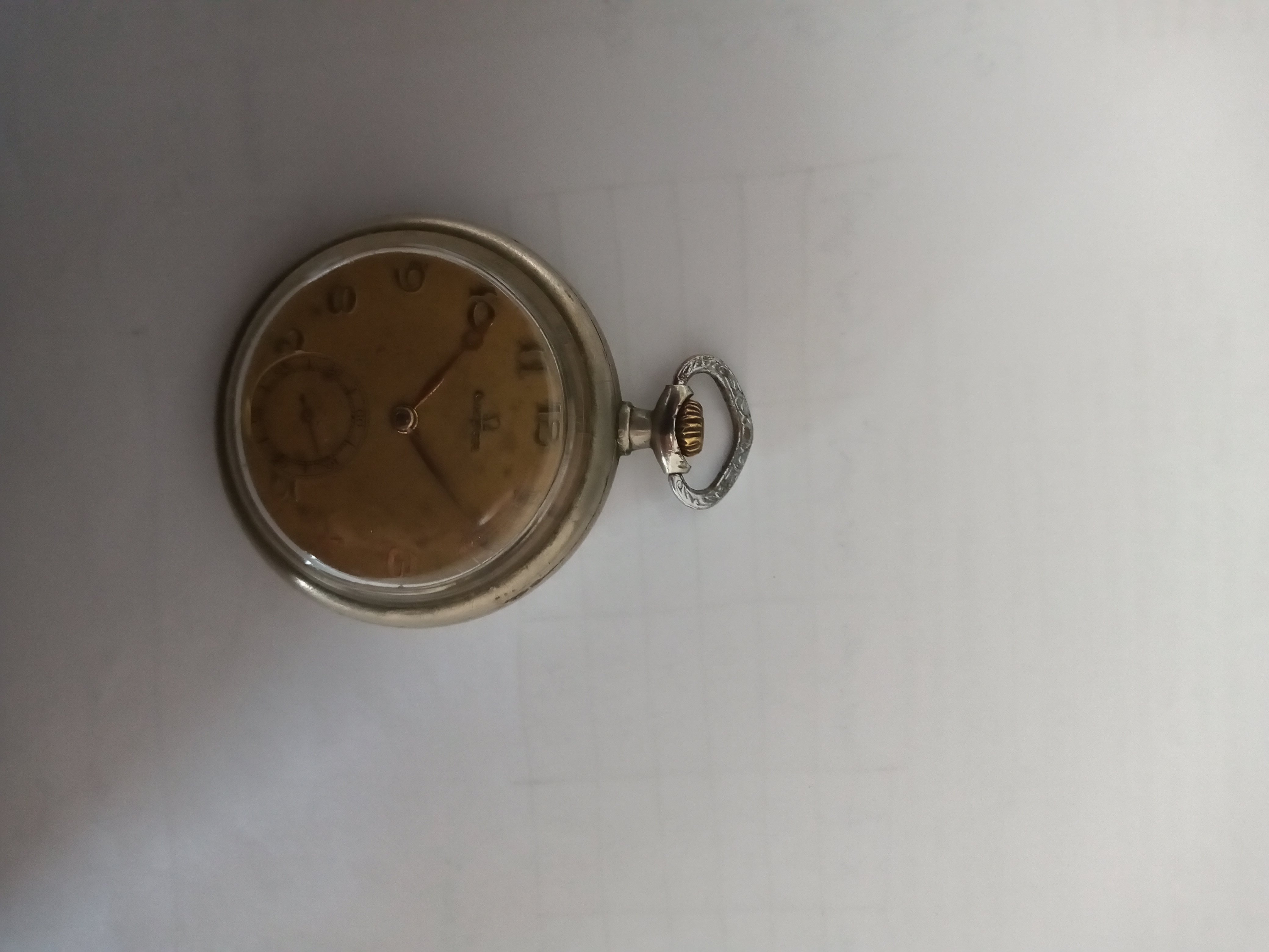

Hi, I have at home this Omega pocket watch from my great grandfather. I do not know when it was last serviced, watch is not working.
I'd appreciate any information about this pocket watch.
Thank you
153
261
I see an "L T2" under the balance and from that will venture a guess that this is the movement according to Dr. Ranfft
http://www.ranfft.de/cgi-bin/bidfun-db.cgi?10&ranfft&2&2uswk&Omega_40_6L_T2

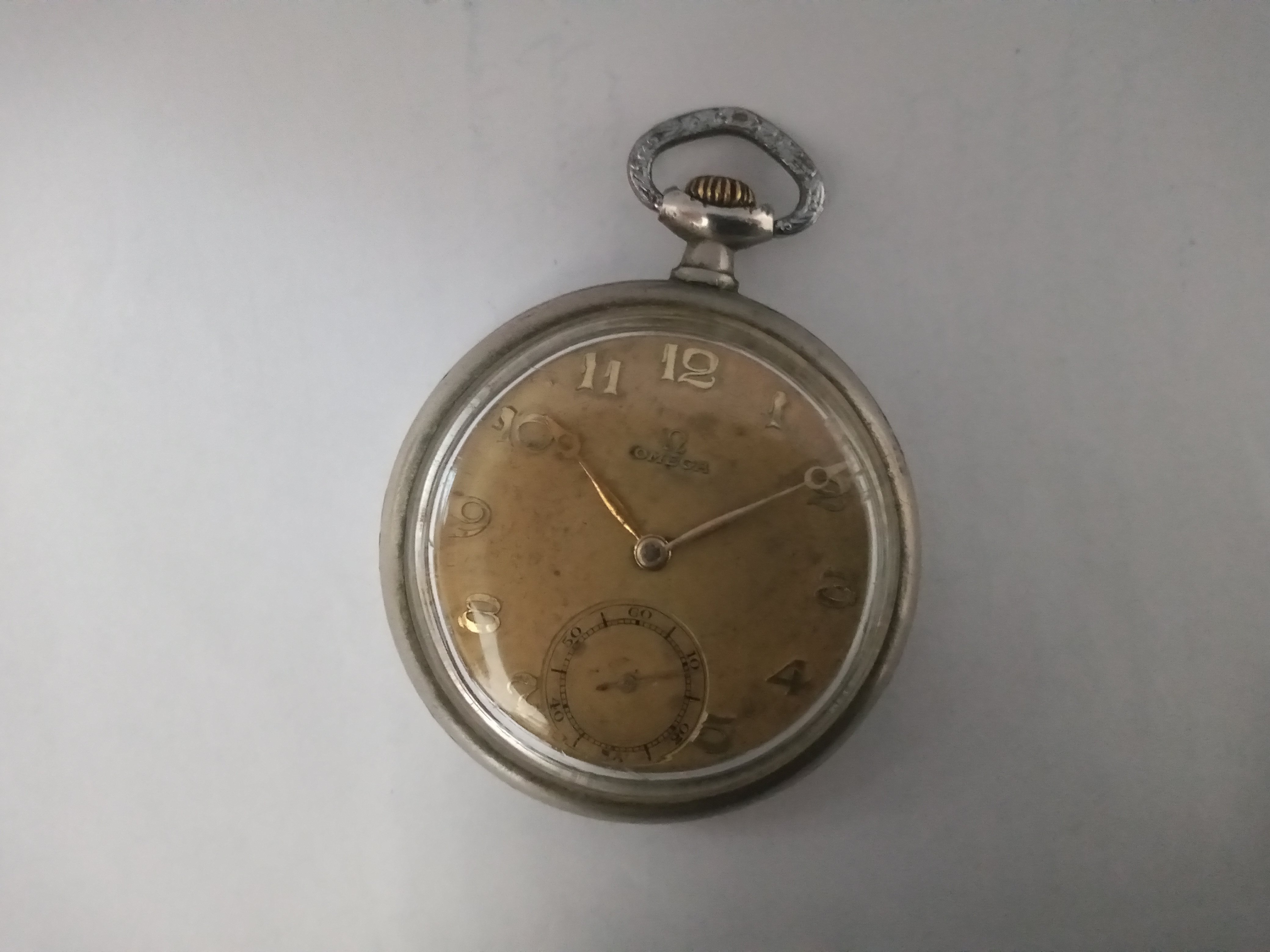

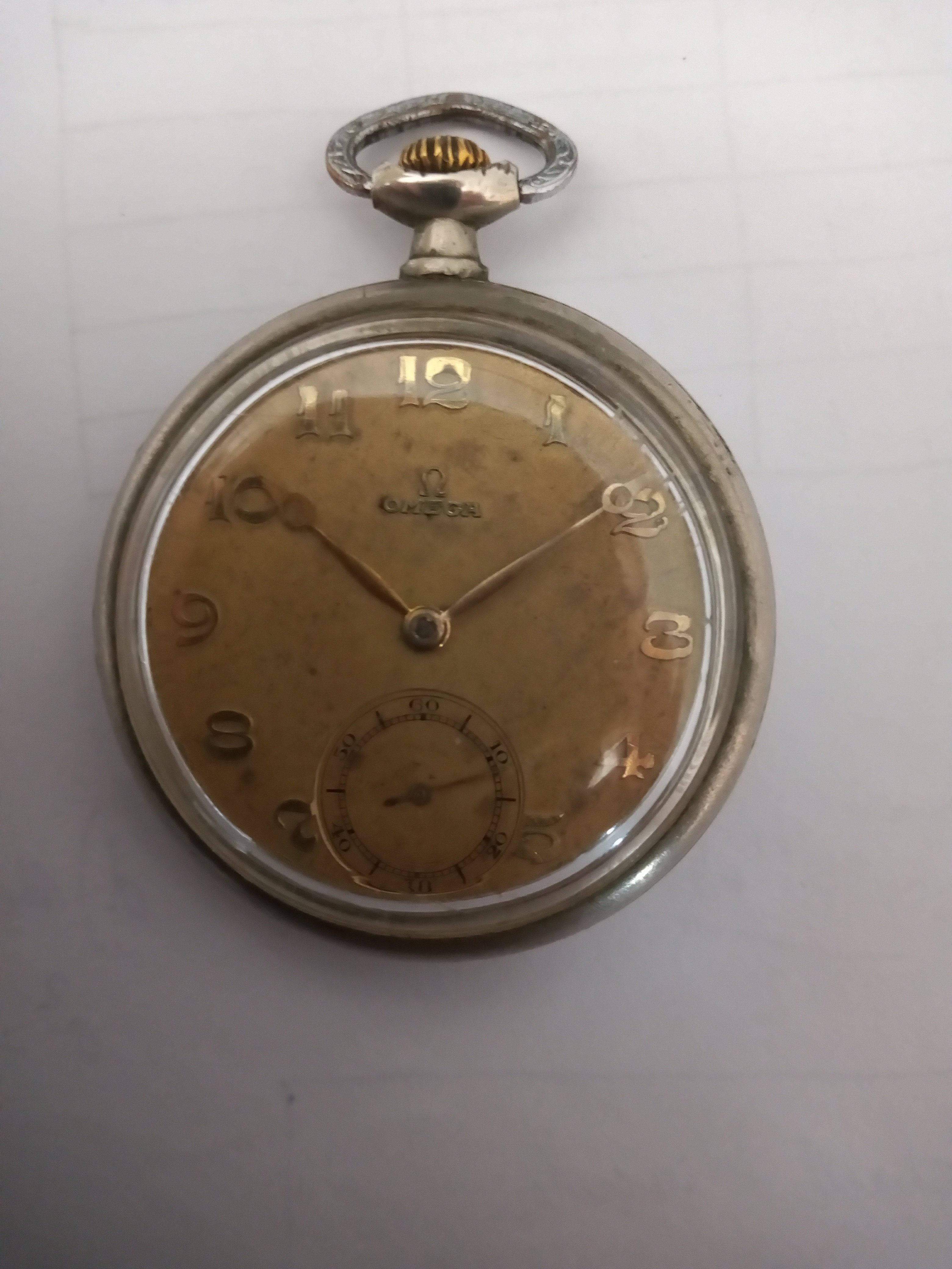

Looks to be a silver, silveroid, gunmetal case and overall it's had some dirt an moisture intrusion. The balance is not
shock protected. If you hold the perimeter in your fingers and gently turn it back & forth does the balance wheel turn
or the seconds advance slightly? If not then only a watchmaker will be able to tell you if it can be restored to working form.
You won't be able to do anything with the dial. The dial looks to me like late 1920's or early 1930's. Where are you located?
823
1,491

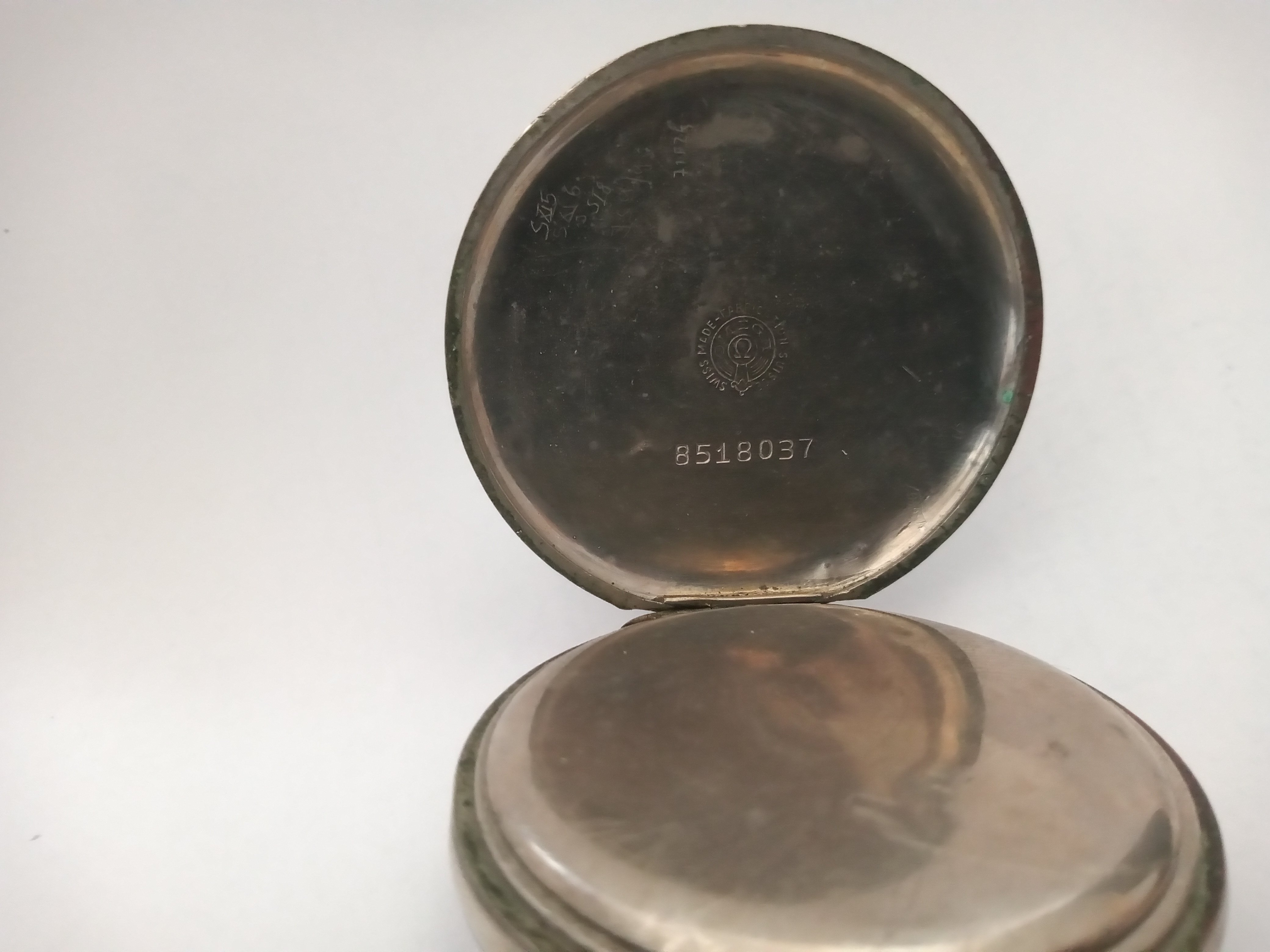

Case and movement serial numbers both suggest manufacture in the early 1930s. Best guess is 1934.
8,877
62,873
It has "moon" hr and minute hands and had water damage at some point.
Nice heirloom
5
Thank you for your answer. Balance wheel is not moving. I am form Slovakia.

Another thing with the old pocket watches is to inspect the jewels that you can see on all the bridges and check for cracking. I worked on one once and once I cleaned it, I noticed the jewels were cracked and needed replacing.
Also don’t put the pallet forks in the cleaning machine. Hand clean it. The glue or resin that holds the jewels in sometimes gives out. Again happened to me.
