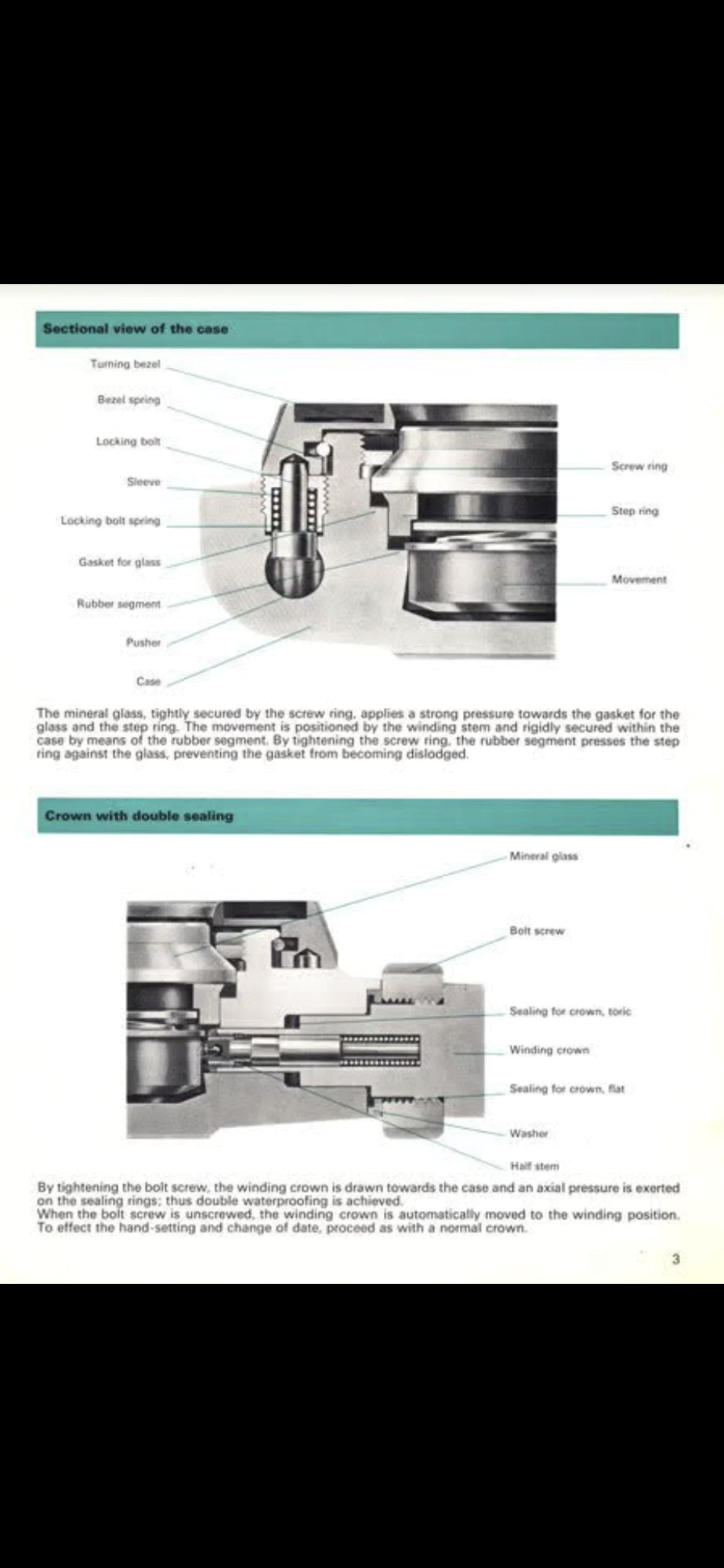

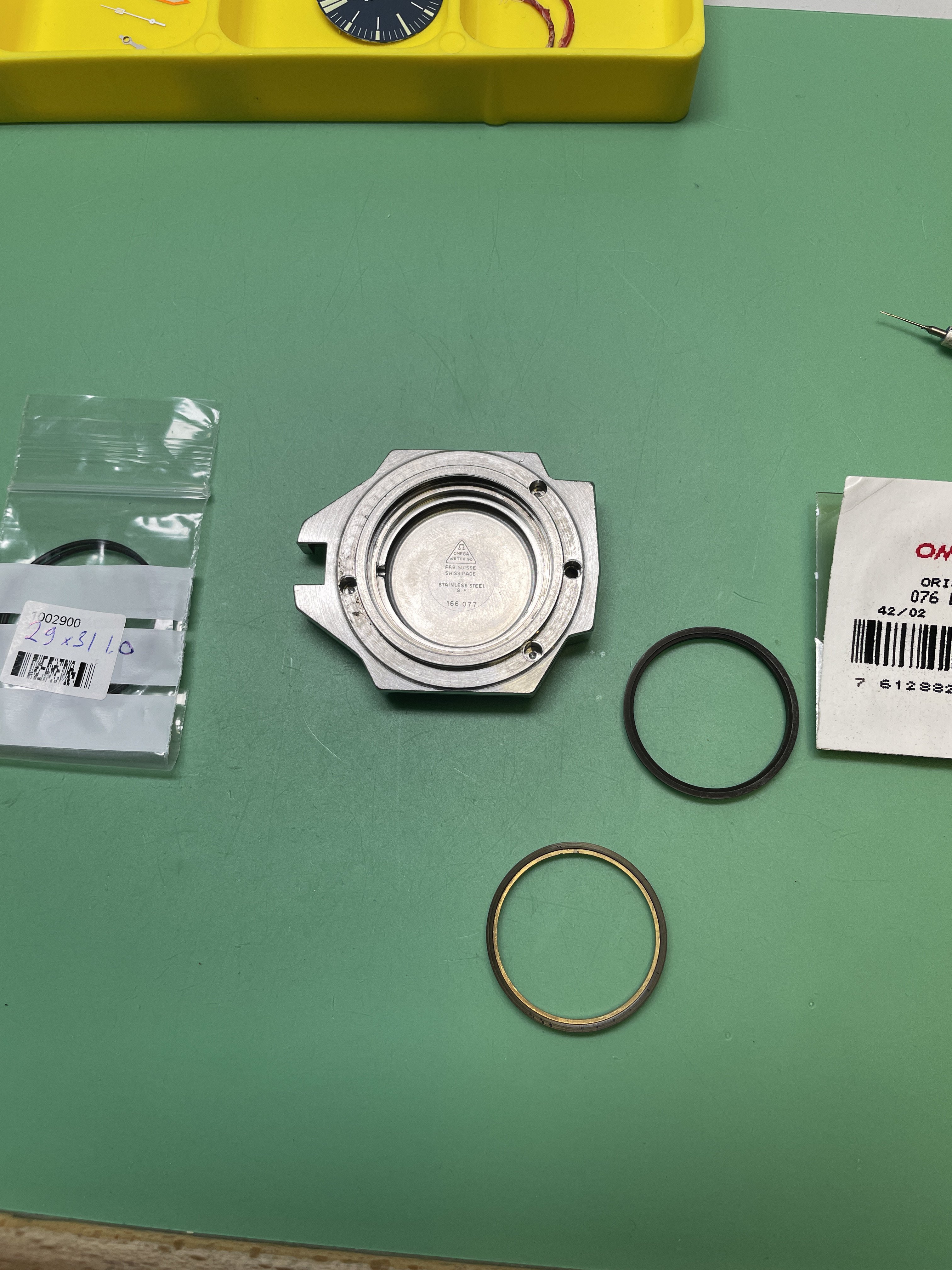

Hello. i also have a few Problems. Because all rubber seal where total spoiled i dodnt know how those Are in case. Can somebody tell me order of assembly? First movement then rubber segment? Where comes gasket to glass? Between flange and case? I guess it is 29x31x1.0 o-ring?
is rubber segment just cutted o-ring? Does anybody know it size?
8
Anyone? Normaylly it is quite easy find out pictures and videos of case assembly but not now.
i find this picture. Does it kook right? Glass gasket is coming under the step ring lip? I think if I instal it like that it have to squeze quite much until it selaa everything.
i also think that 1mm o ring is too big if I use it as rubber segment. Does somebody know right size for rubber segment? Or omega part number. I cant get skrew ring in place so things under it Are too height.
i try movement first. Then rubber segment to side of dial. Then step ring and i put glass gasket under step ring lip and between step ring and case.
