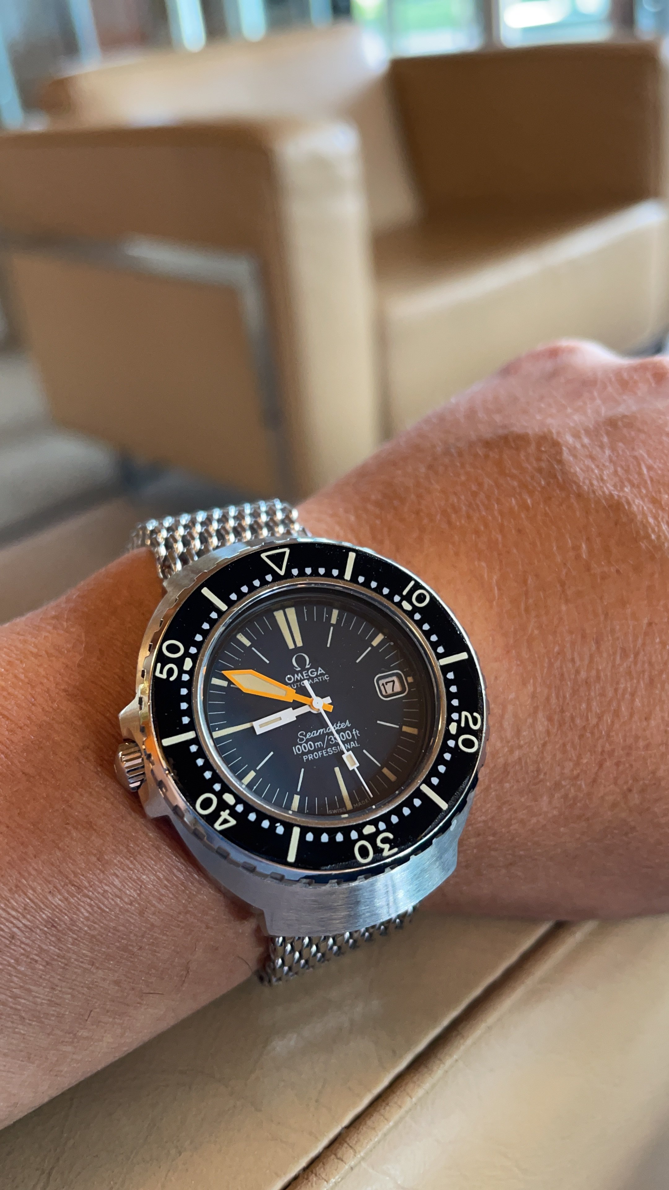

Short question: is the Seamaster 1000 Ploprof crown and tube the same as the Ploprof 600 crown and tube ? If different, anybody has the correct omega parts number for the 1000 ? Kind regards. Achim

Hi Achim
different for shure and long I had to redo the water resistance capacity of my SM1000 and took 3 weeks just for a new tube .
For 166093:
Crown - 069ST43199
Case tube - 090ST0054
Still available from Omega.
