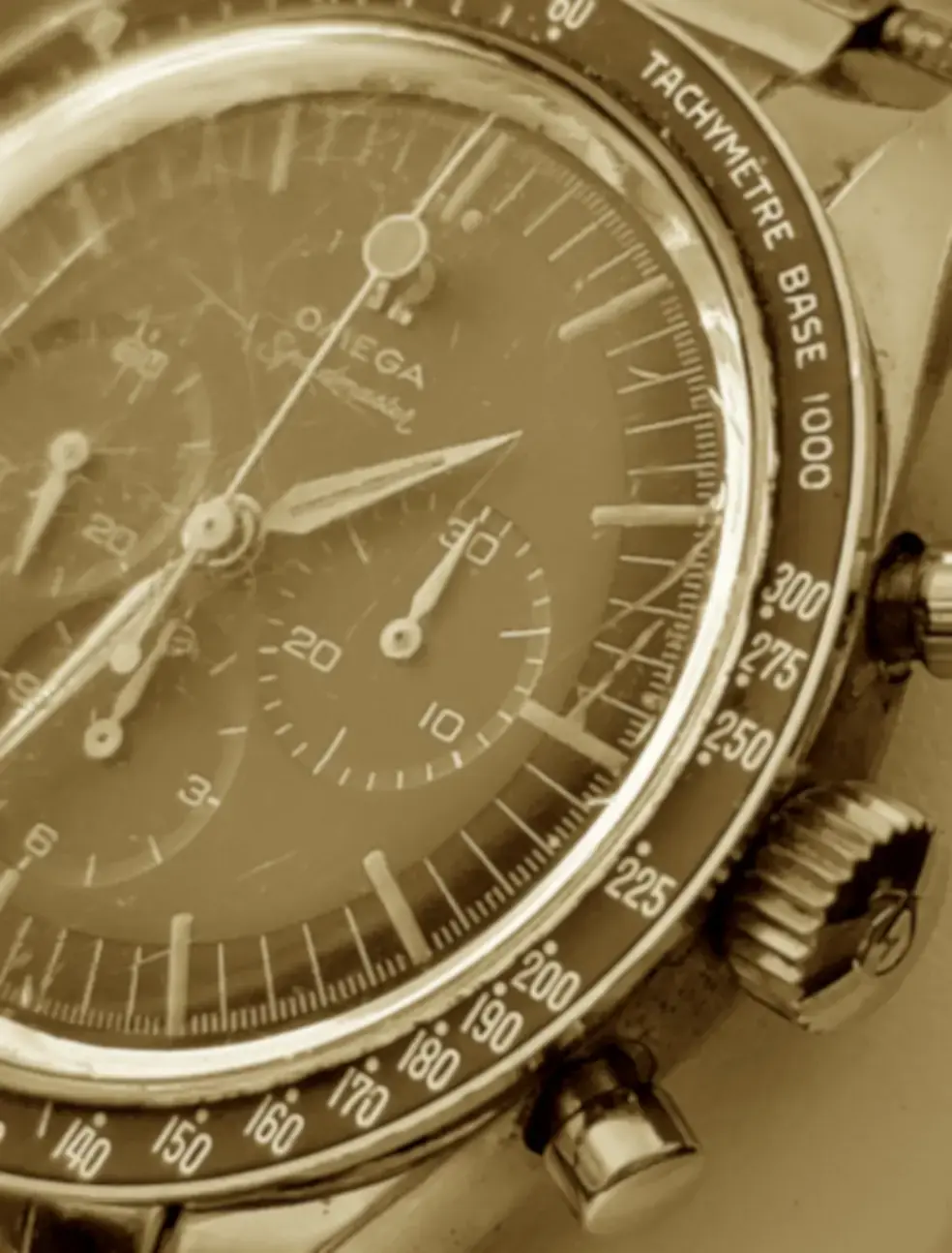

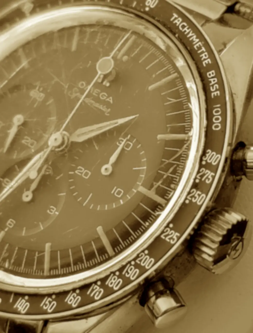

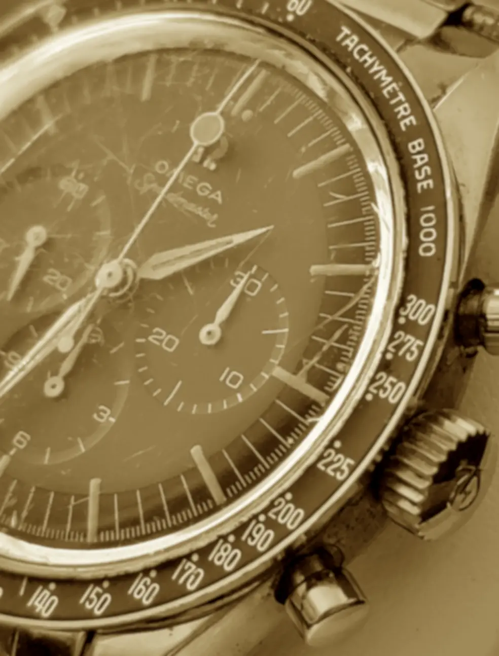

Yeah, it's probably just an old beater like this.

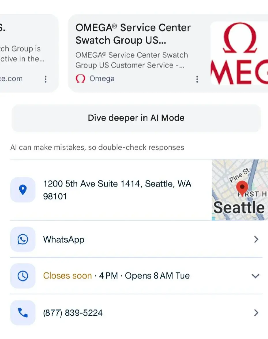

Hello AshUK,
Thanks for your message. 馃憤 I called the number shown in the link that you inserted and I got the "The number that you dialed is not in service". I shall try to find Nesbits on the web.

Hello AshUK,
You've got me curious. I'll drive by the Omega address next week to try to find out if they are open and get contact info.

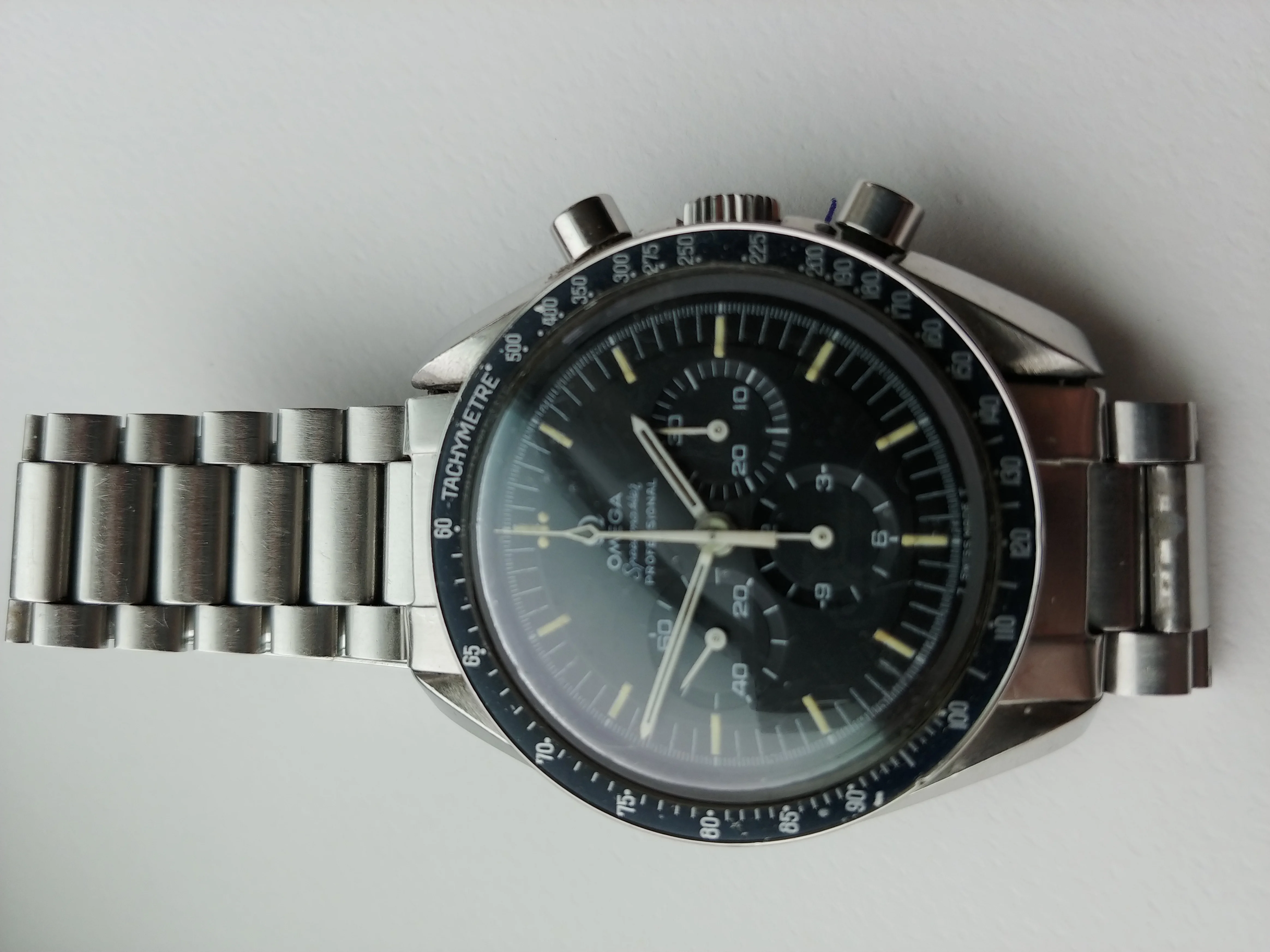

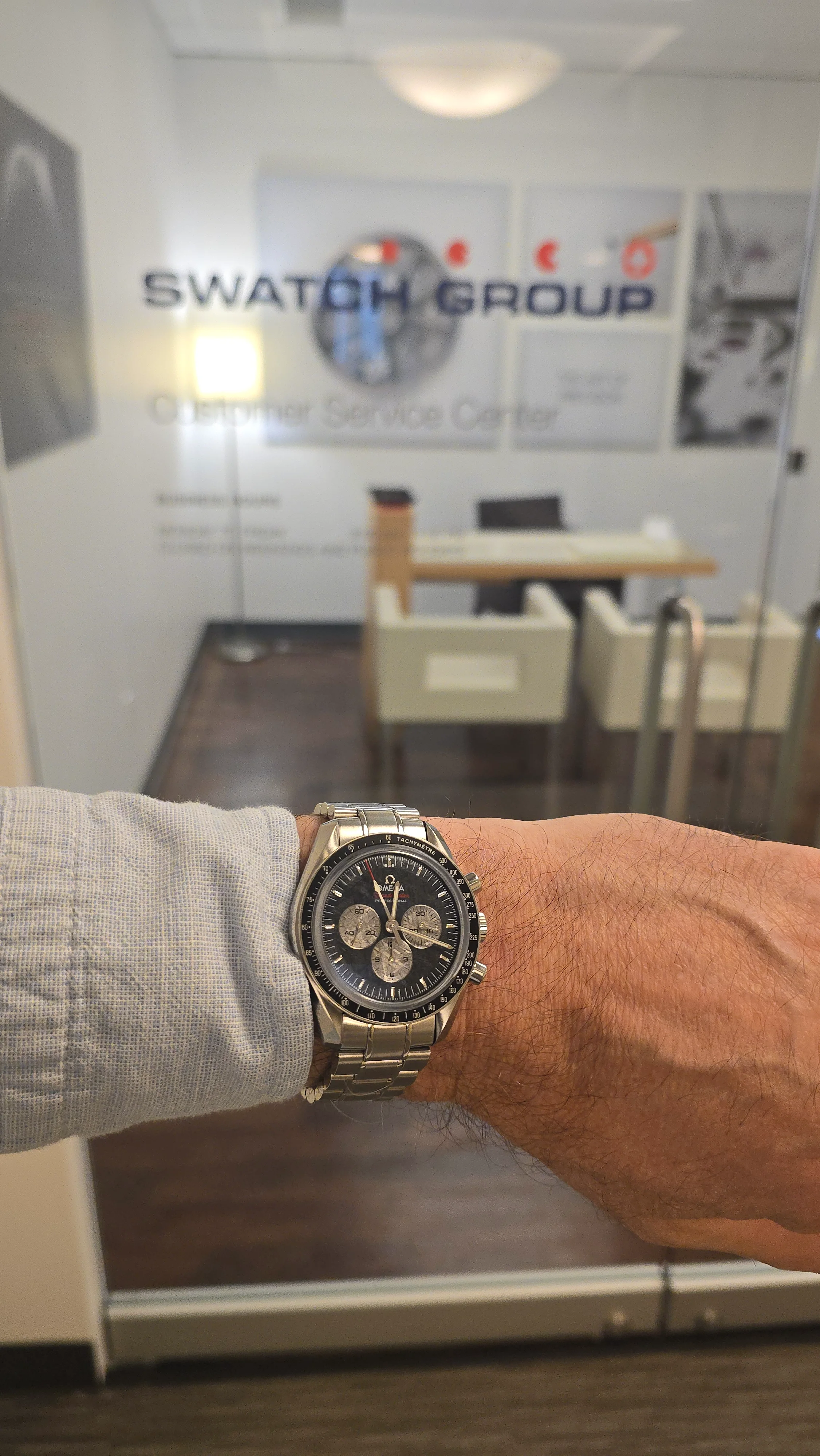

Hello Jim,
I made progress based on the help I got in this foru m. I have now confirmed two options in Seattle, Nesbits and Omega Swatch Group.
As requested I am attaching a photo I just took of my watch. I guess it looks like every other Omega Speedmaster but I am a complete novice when it comes to watches. I just feel the watch is worth spending some money on.

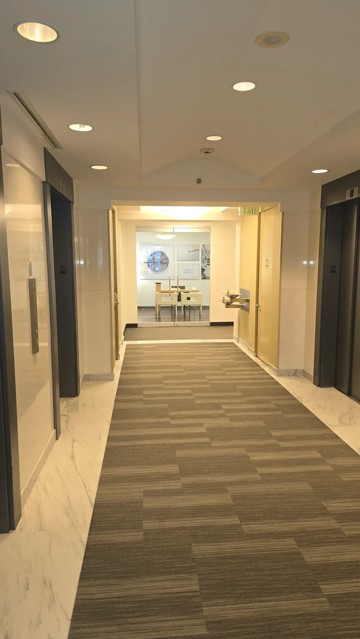

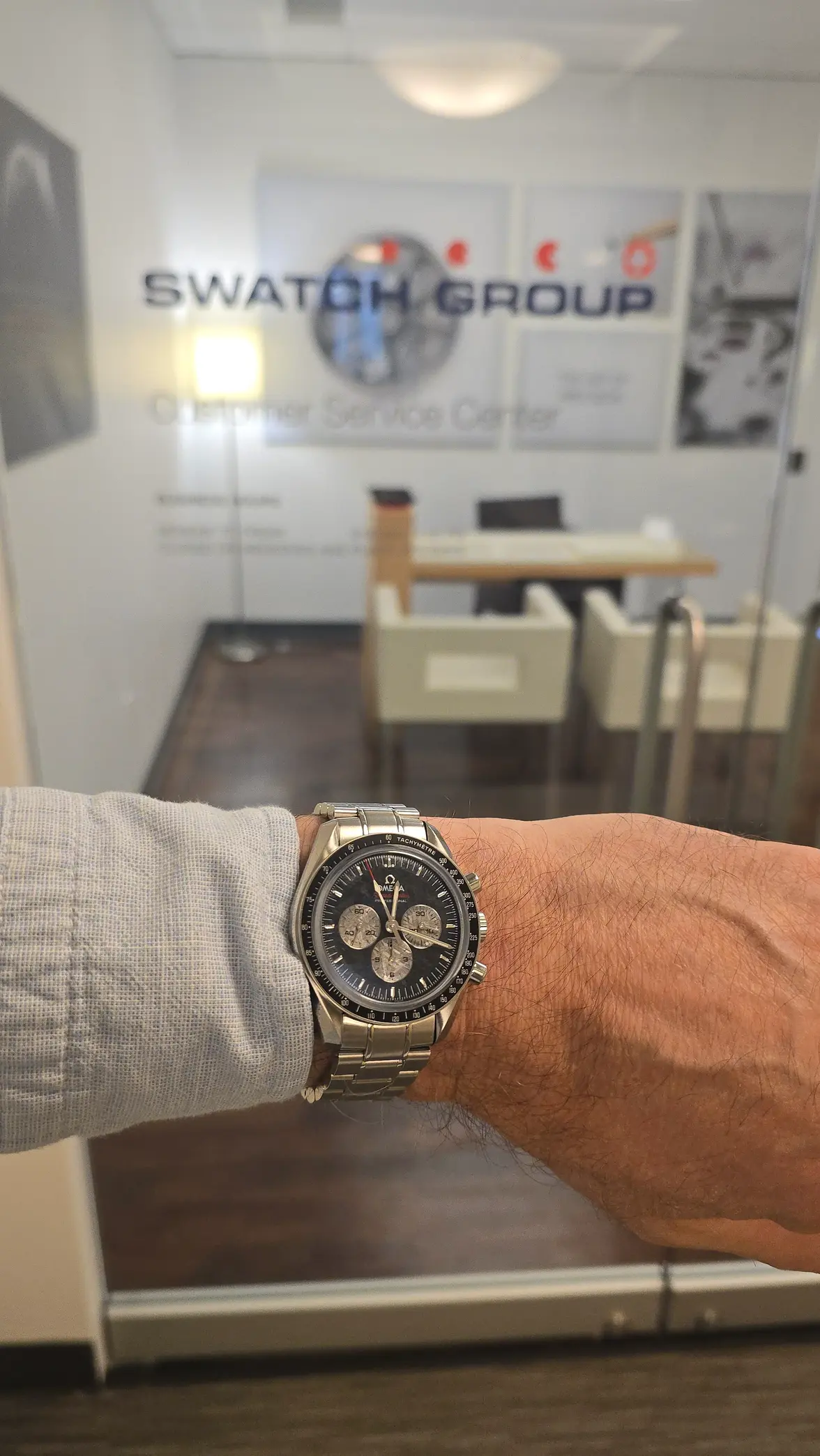

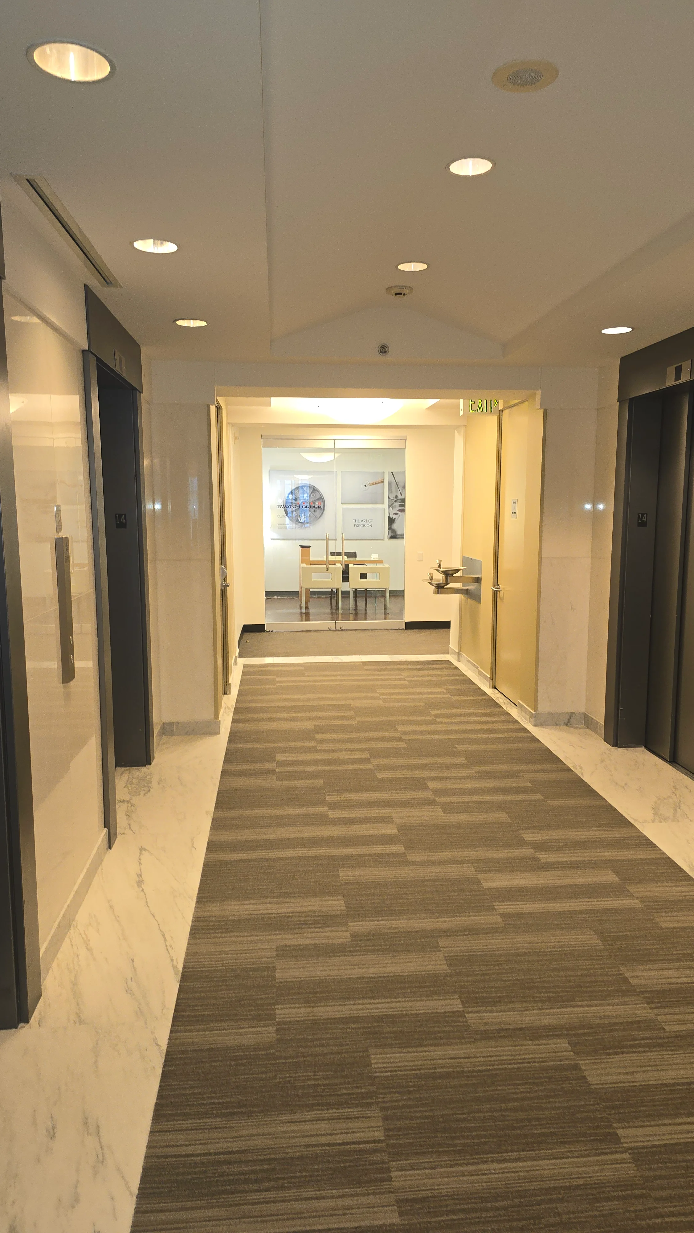

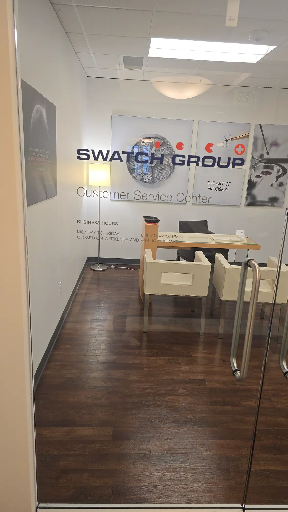

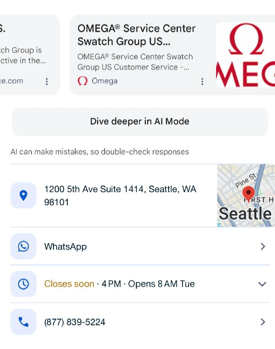

@LastGreekLetter, I visited the Seattle location today. They are still in service and receiving work. Here is their local phone number:
They're on the 14th floor and allow walk-ins for either warranty work or any service. I asked them to check my Speedy and they said it didn't need service after the timegrapher showed high amplitude and only losing 2 secs per day. They did this as I waited without a prior appointment. Omega is serviced there, in house. Other Swatch brands are accepted but sent out.
They don't sell parts but you can order bracelets or even clasps. For example, depending on the reference, they could get a new clasp and swap it into an older style bracelet for you.
It's a nice option for anyone in the PNW. Nesbitt quoted me prices higher than Omega's, and of course Omega replaces a lot of parts as part of the service without additional fees.
Good luck, and hope this is helpful.
