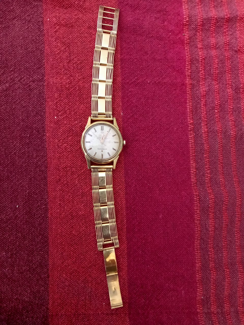

please see photo of Omega i inherited from my grandfather
looking for useful details- model, movement, year , value
thanks for the help

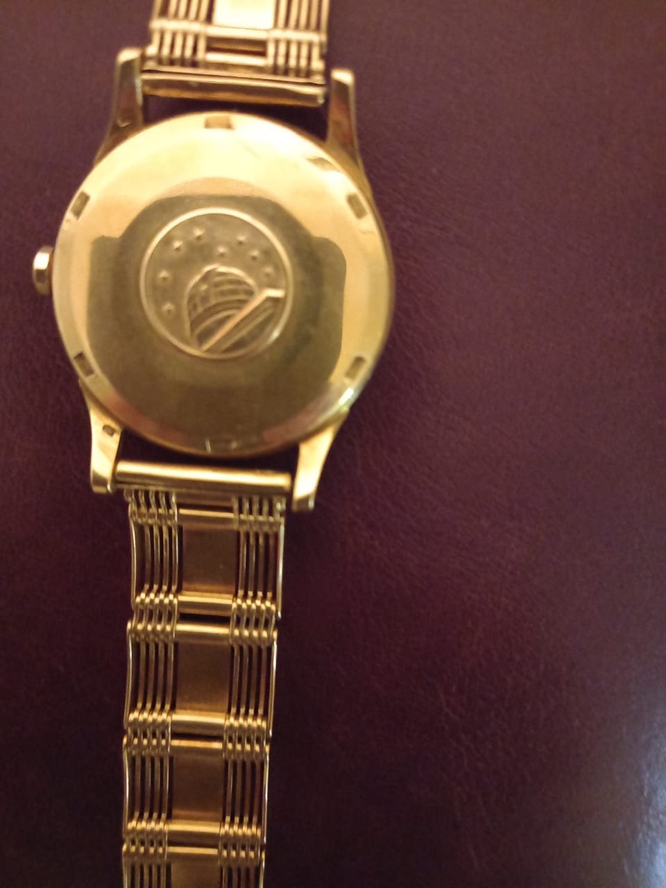

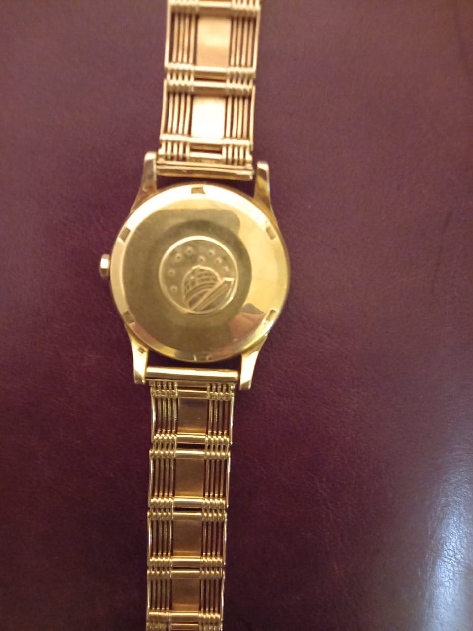

Is it gold tone? Can you provide pictures of the back of the watch?
5,660
9,496
As was said a million times here: open the case back or have it opened. All Information s, you need ,are there. Then come back with pictures of mvmt. and inner case back. Front: move your hands away from every piece of writing. Then take a picture.
2,814
6,941

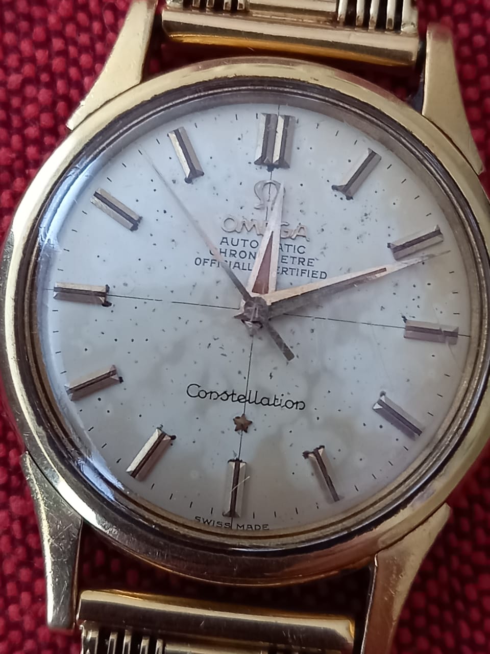

It’s a 14831 ref with a 551 movement dating to somewhere around 1960. For more precision, have it opened up. For value, check ebay sold listings.
6,764
10,418
welcome @Pilot..737
Your watch is a bit of a funny one.
it looks like a polished 14381 - and it even has the later 'thin' decagonal crown of this reference.
However, it has the dial of an earlier watch (no missing 'officially certified' of a 14381 and etre spelling of chronometre)
Your pics aren't sharp enough to see if the dial has been repainted out not, so as others have said, the best way to tell the reference is to have the watch (carefully) opened to see what is written inside the case back. (gold cases are relatively soft and easily damaged)
Sharper pics all round would be a help.
The darkened colour of the lume suggests radium, so don't go opening it up yourself and breathing any dust particles in.
As for value:
As an heirloom from your grandfather - absolutely priceless
As a collectors piece, the case is a little soft (polished) and the dial is quite damaged.
It still has some value as an old Omega but I'm sad to say that the main value is likely to be in the value of the gold in the case and bracelet.
A kind member reminded me that there may have been some early 14381s with the ‘standard’ text and French spelling dial.
An uncommon anomaly for sure but worth mentioning as an addition to my comment above.
The case back info and movt serial number would be useful to further assess the watch.

I am a little surprised at this since you don't see the RE versions much after 1958, yet the 5 digit case number watches weren't seen before 1960. As you say an anomaly.
Whatever, as already noted in your earlier, the bulk of the value here is in the metal in the case and presumably bracelet, people won't pay a big premium for that dial.
I think the 14381 reference was first released in '59
so there may have been (rare?) early versions with the 'French' dial?
10,747
16,733
Well perhaps but as I note above, I would treat even a 1958 watch with an RE dial with suspicion or at least worthy of a much closer look so this one really does raise my eyebrows. I am not Desmond (or you for that matter 😀) and new facts about Connies surprise me every week so I am only imparting feelings and not firm convictions!
6,764
10,418
Well perhaps but as I note above, I would treat even a 1958 watch with an RE dial with suspicion or at least worth of a much closer look so this one really does raise my eyebrows. I am not Desmond (or you for that matter 😀) and new facts about Connies surprise me every week so I am only imparting feelings and not firm convictions!
in the same vein, I was only imparting a possible correction to my earlier statement.
If they do exist, there may have been only two pop up on OF (including this one)
All the more reason for the OP to put us out of our misery and let us know what's written inside...
To be honest, I thought the 'missing text dial experiment' started in '58 but if the 14381 came out in '59 I'm not sure that fits
