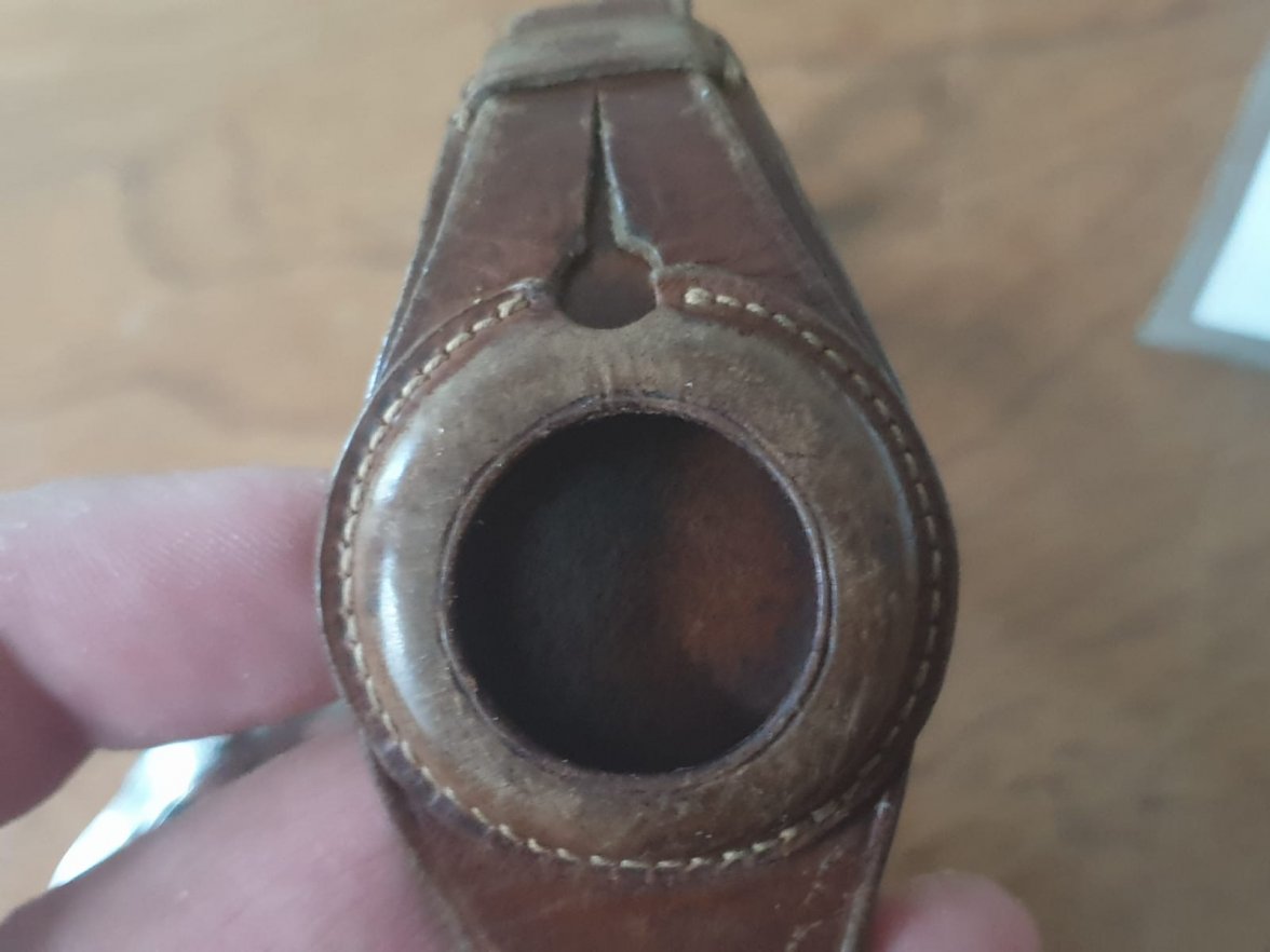

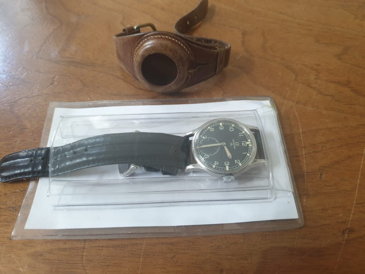

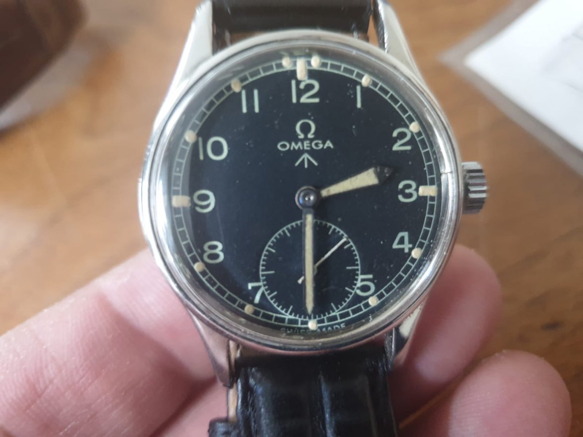

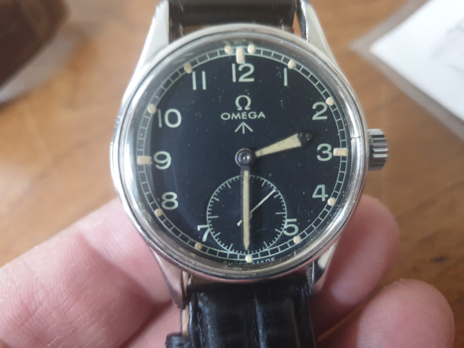

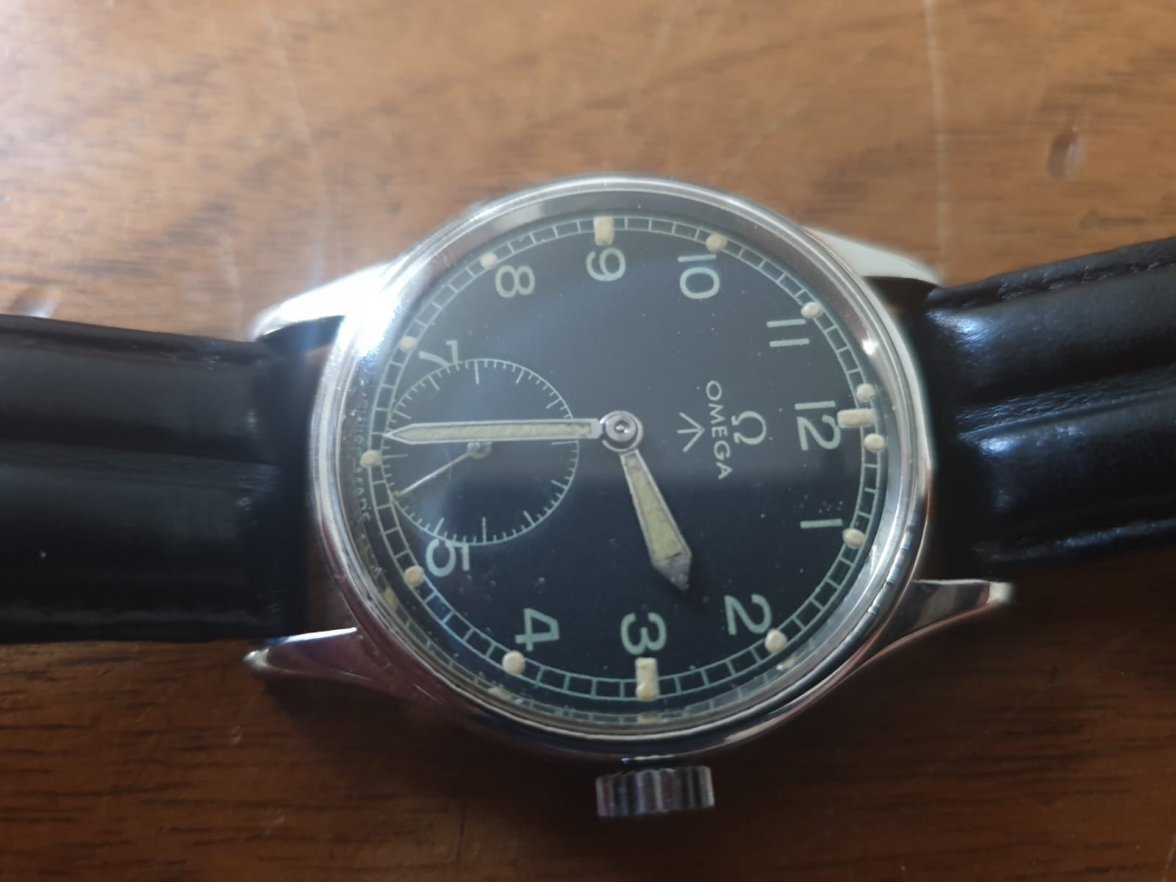

Hi All,

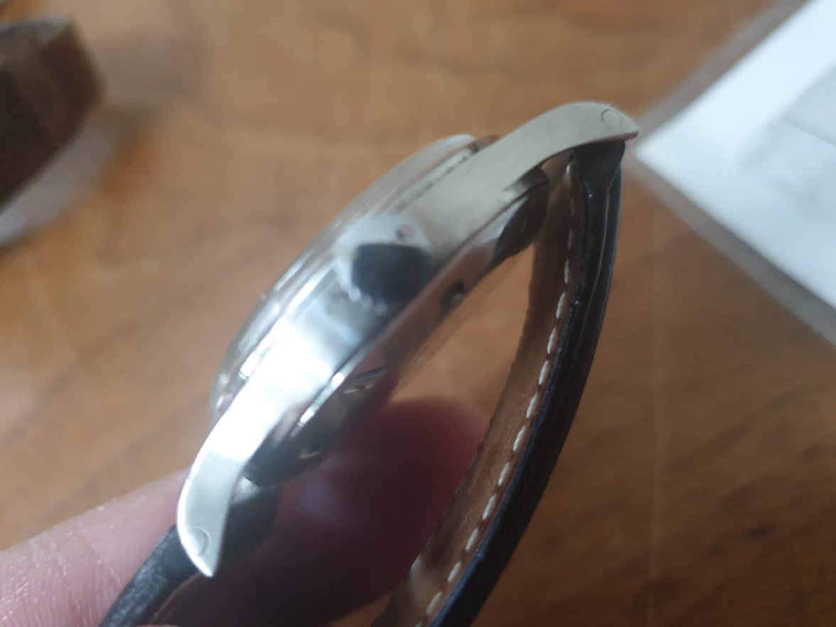

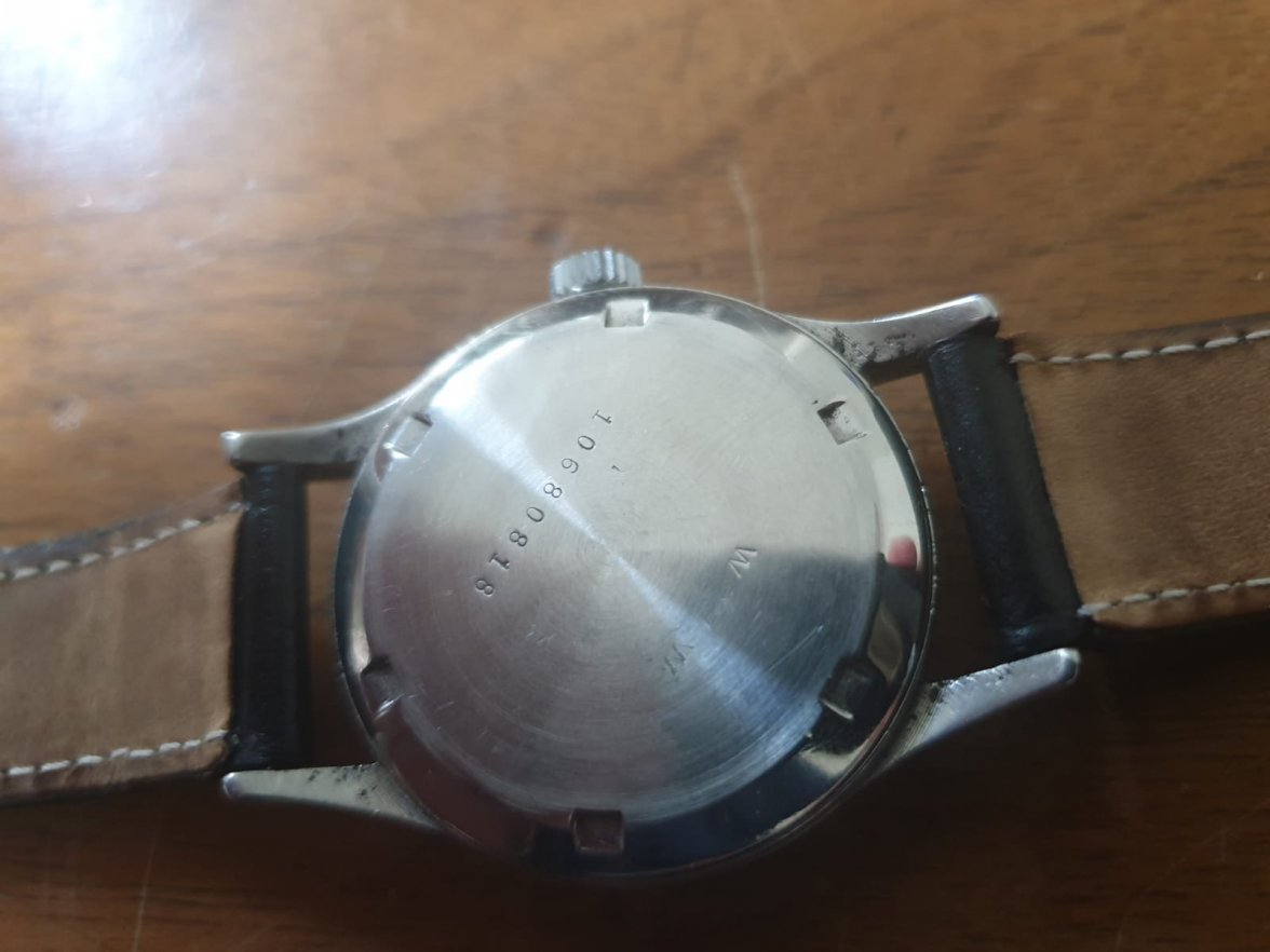

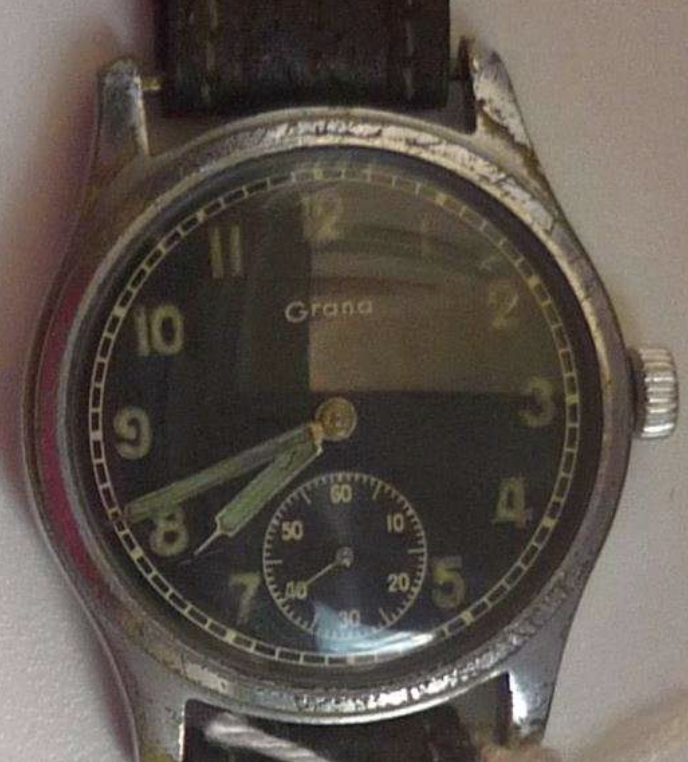

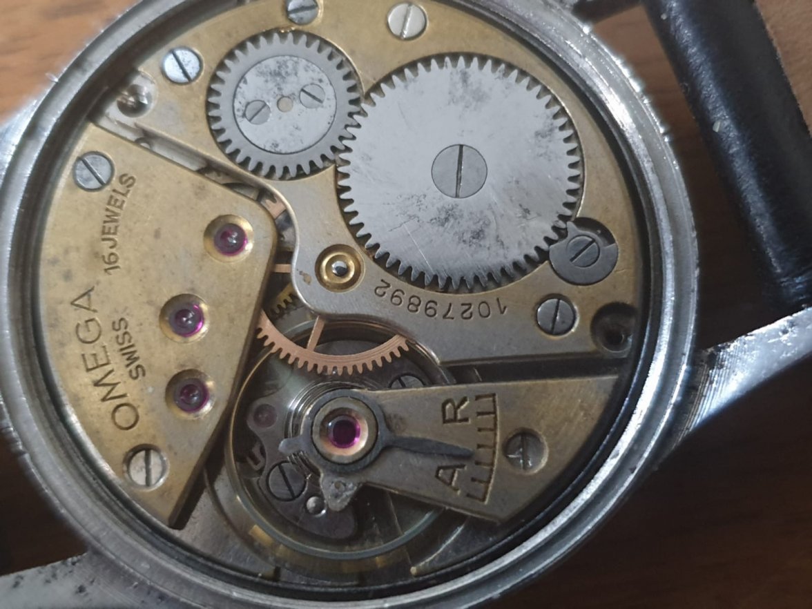

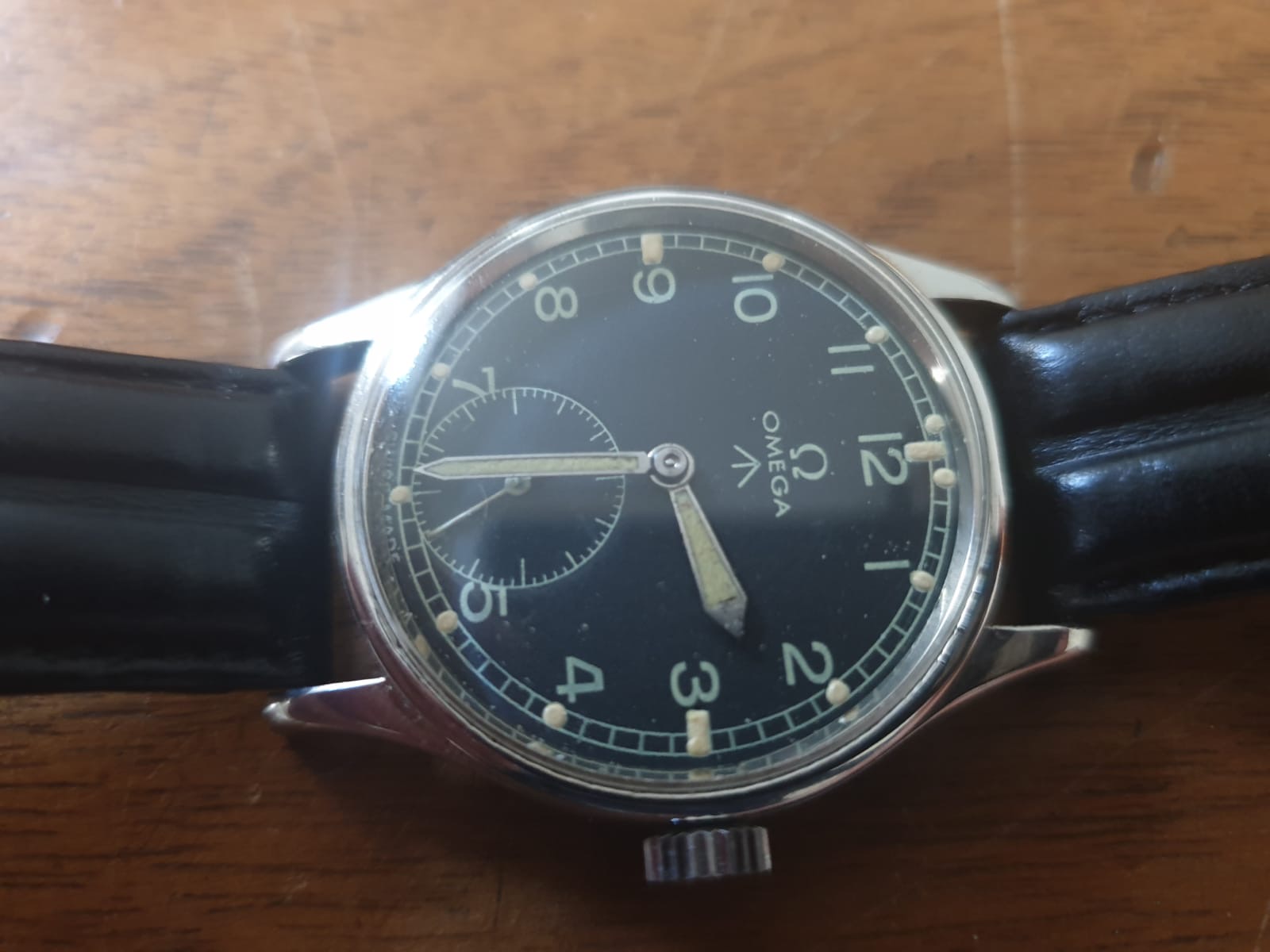

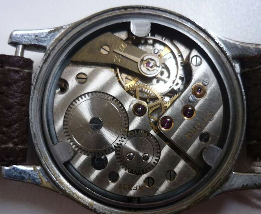

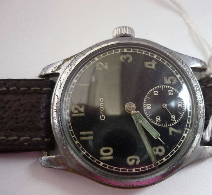

I was offered this watch for 1200 euro and wonder how I can tell if this is an original and if it is actually worth this amount? Perhaps someone also could tell me if this Grana was one of the "Dirty Dozen".
As usual, any advice and help appreciated. Sorry for the possibly bad pics.
Have a good day all.

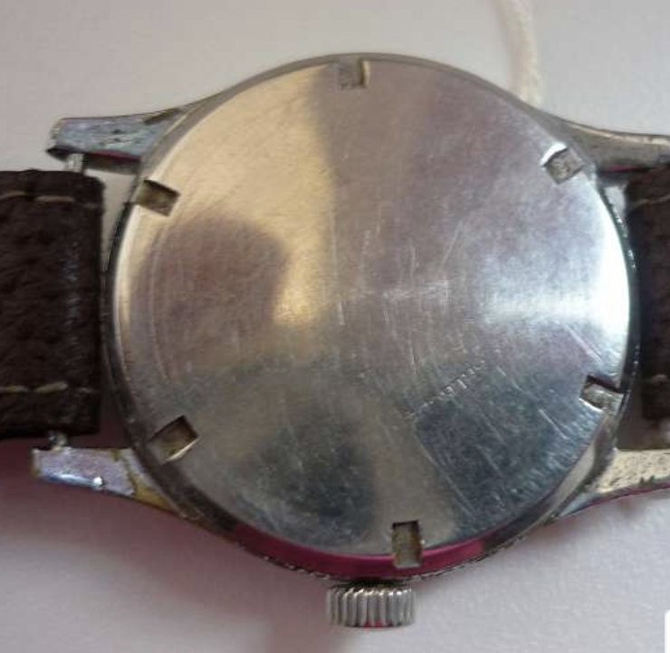

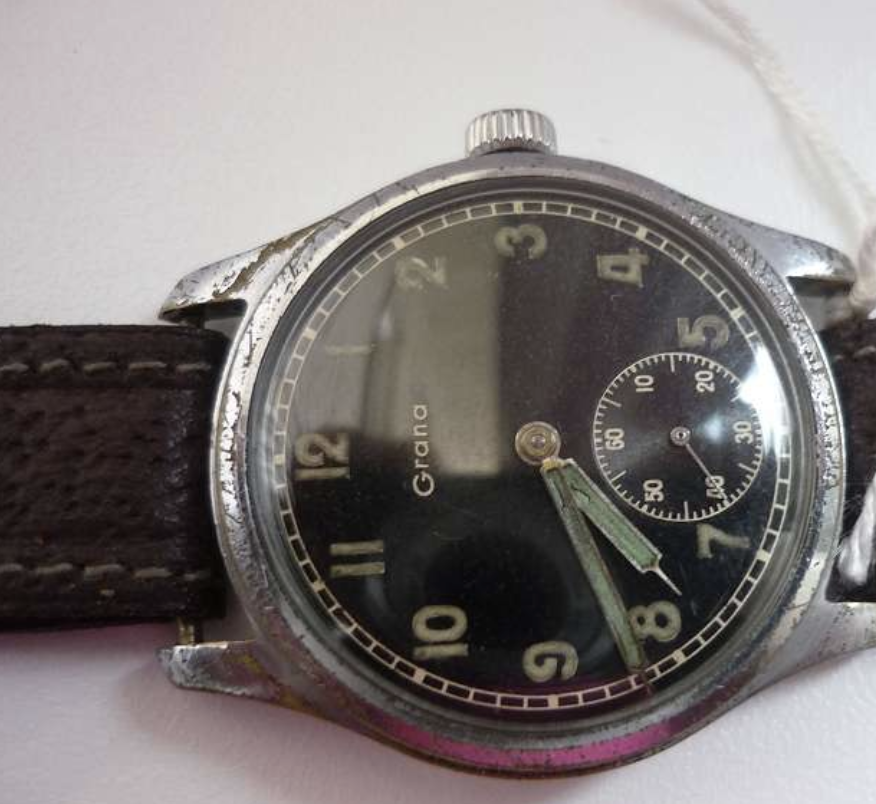

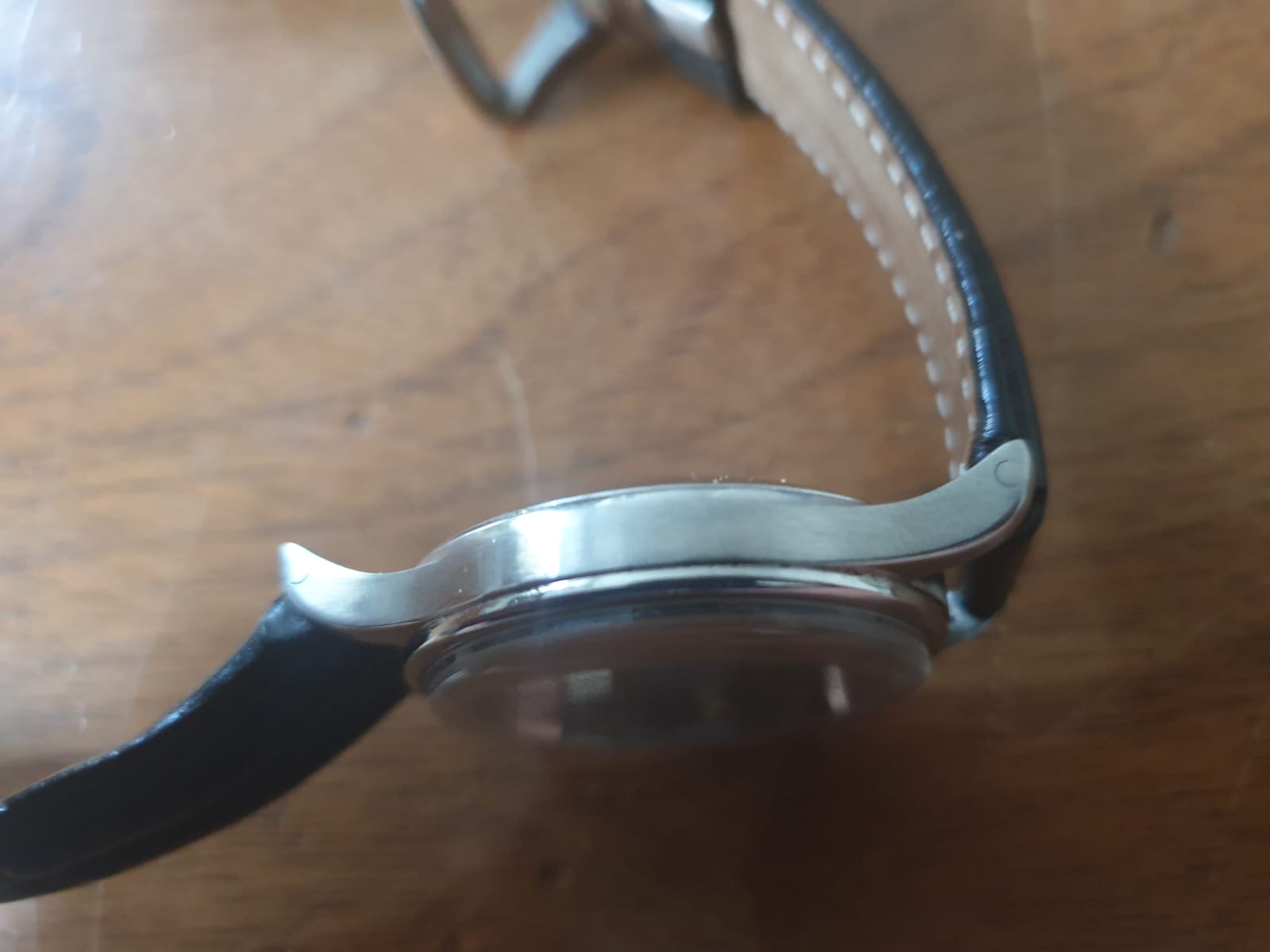

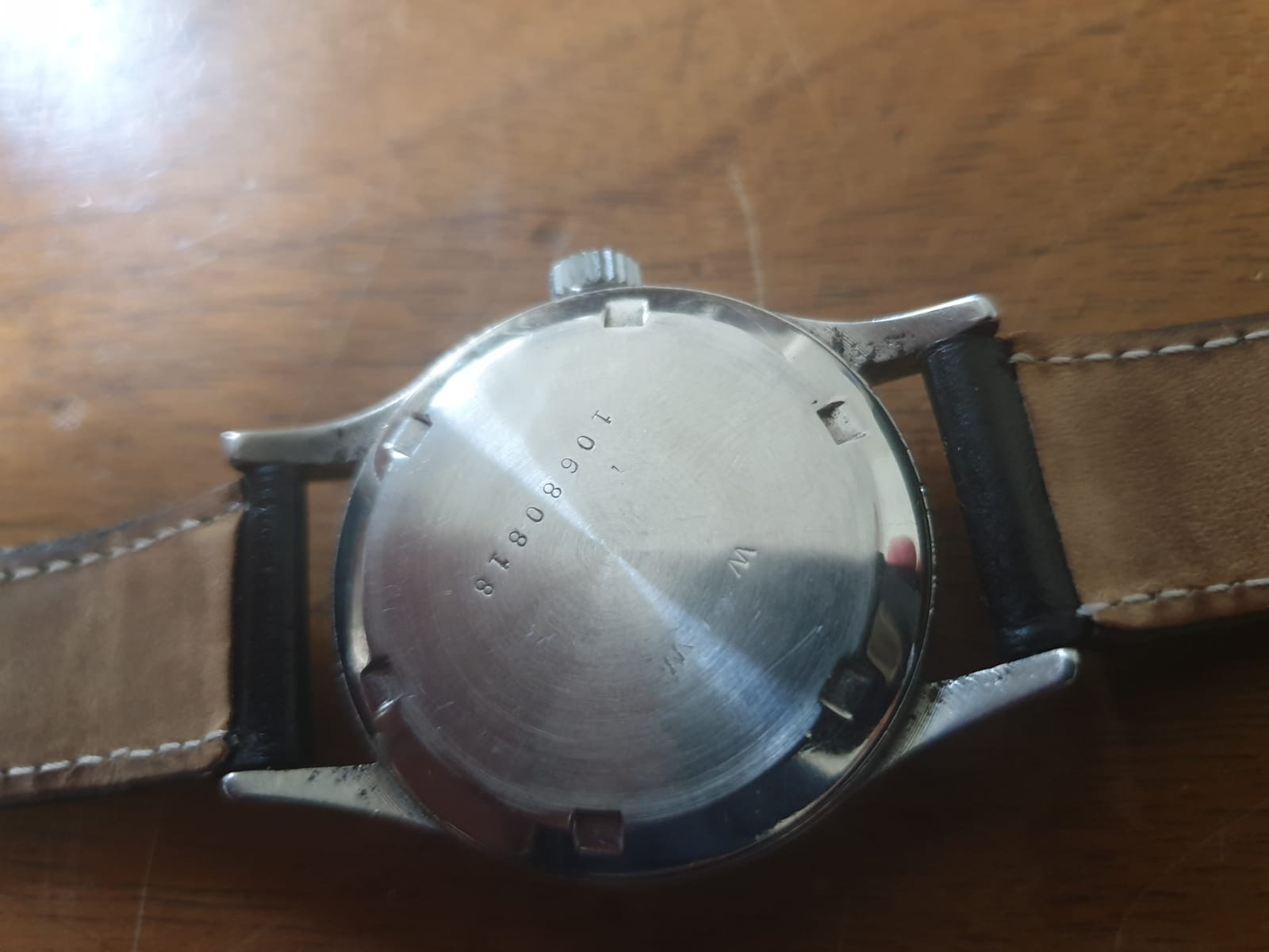

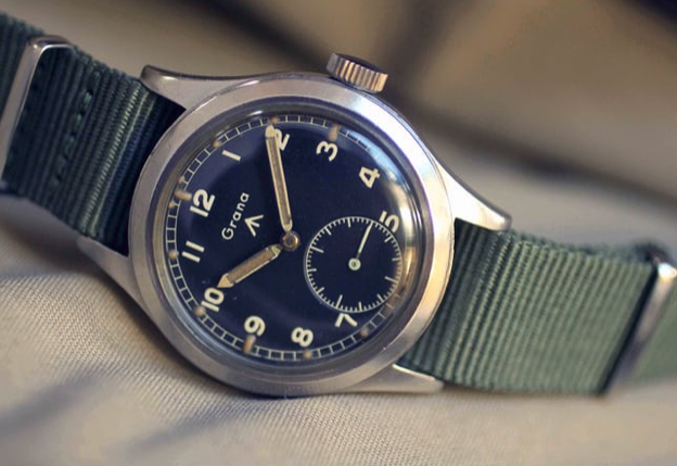

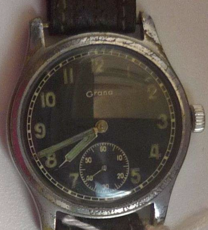

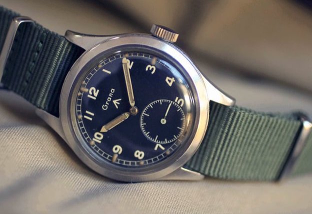

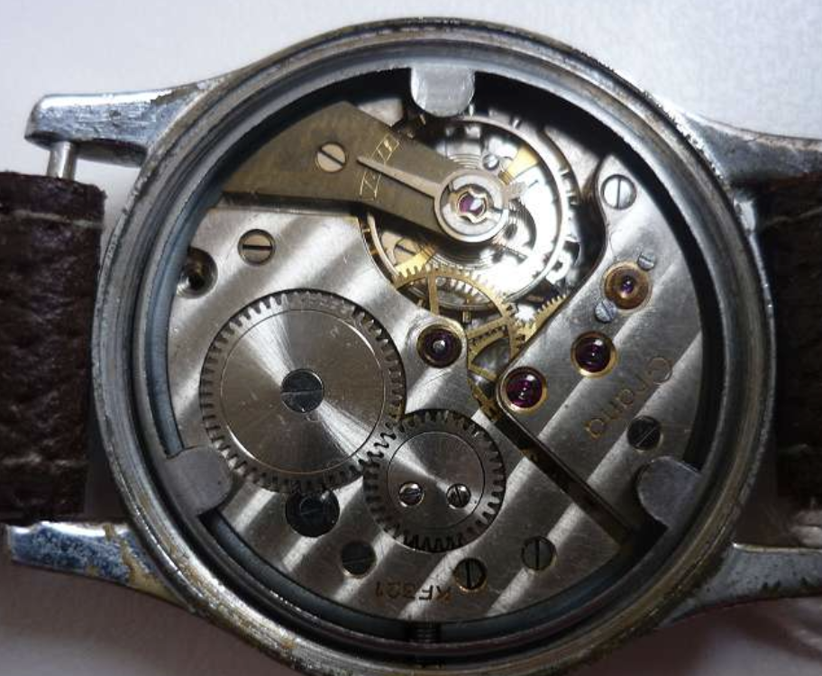

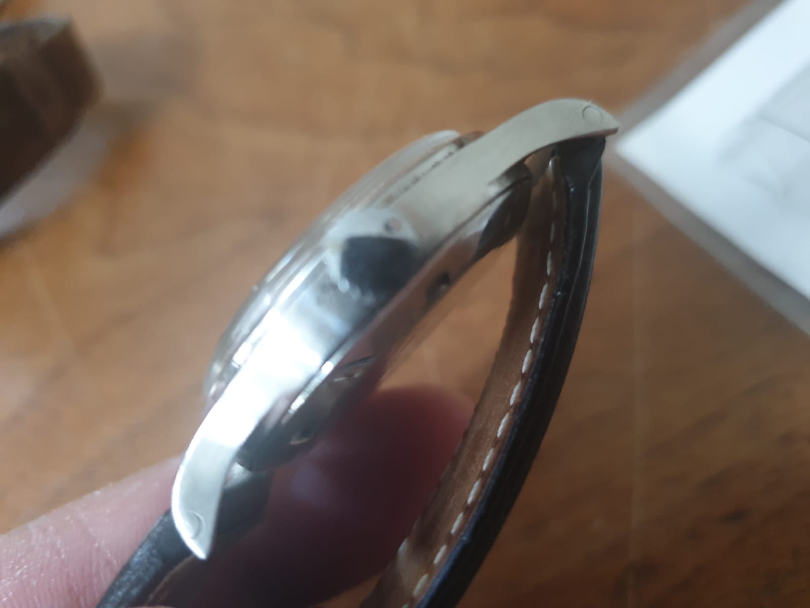

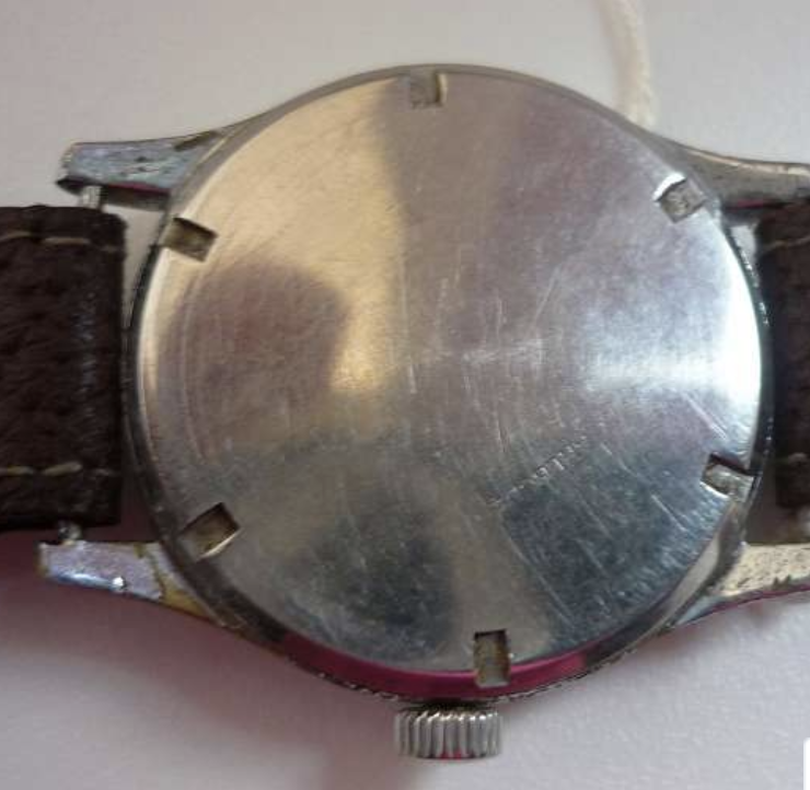

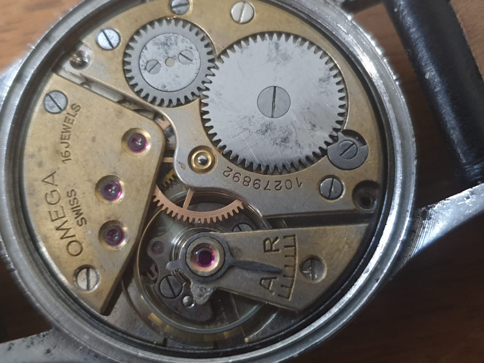

The Grana is a Grana DH, made for the German military. The Grana WWW 'Dirty Dozen' is a different watch with different caliber, KF320. The case back is polished (it should have military engravings showing D and H either side) and the case is shot. The DH is worth a few hundred £s.
The Omega is a redial with a heavily polished case. One to avoid.
WWW Grana
WWW Omega

Hi, thank you very much for your reply glad I did not commit at this point. Would the Grana be worth 150 euro?
Thanks,
2,205
7,267
Thanks,
No problem. You can probably find a better condition D.H if you search Ebay, they do come up for sale. I would say €100-€150 is about right i.m.o.
