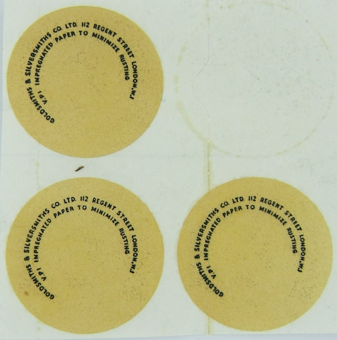

In the second watch, the seller claims that the watch is ‘ALL ORIGINAL’. As you say Achim, the "Do Hickey" is available (from Antoine) and the moisture absorbent paper disc from Zaf.
I have nothing against a restored watch (just like many beautifully-restored classic cars) - but to claim that it is ‘original’ is another matter.
Here are examples of Zaf’s discs: nice to have for a ‘restoration’:
Can I ask where you get these paper discs from?

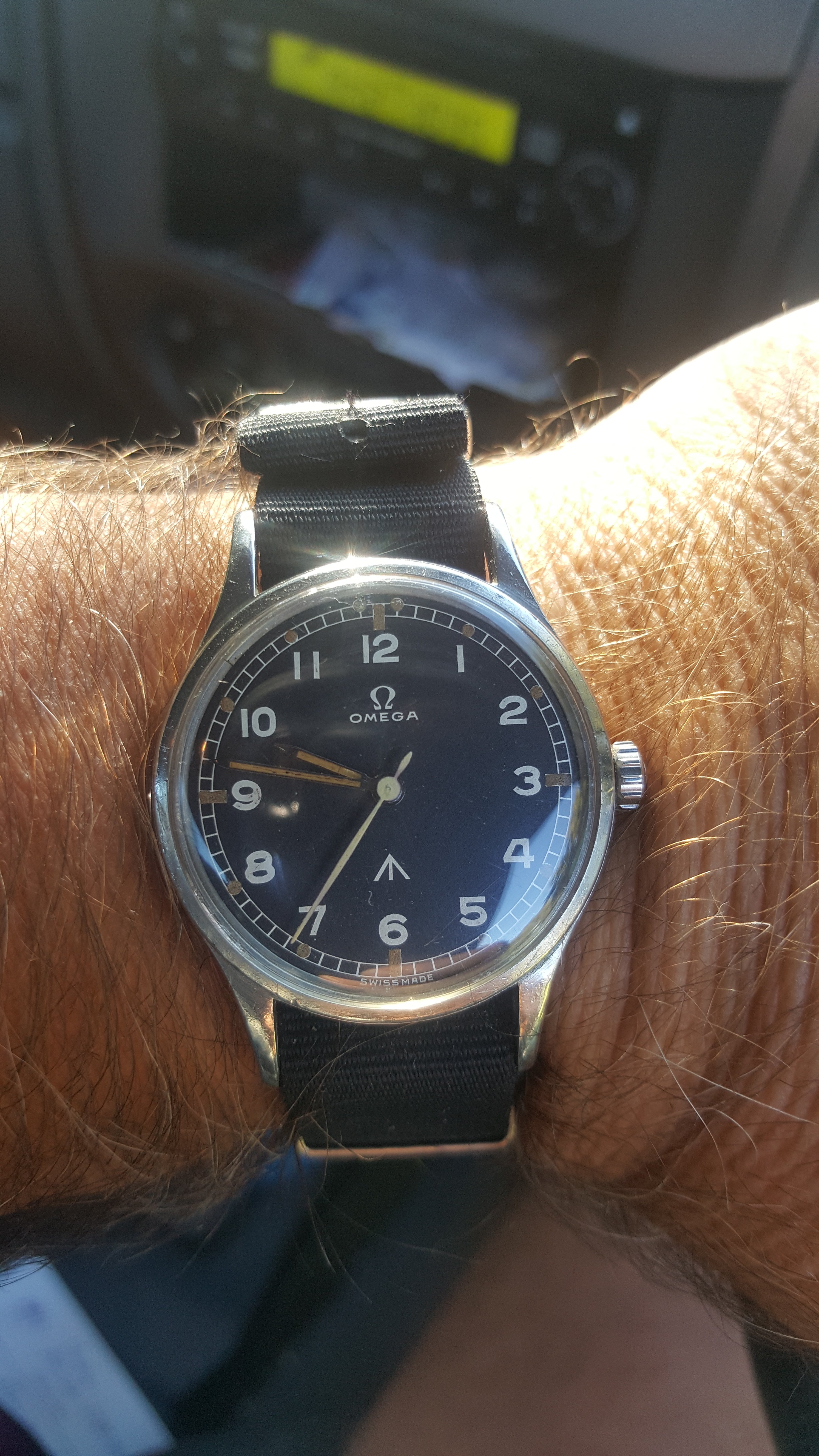

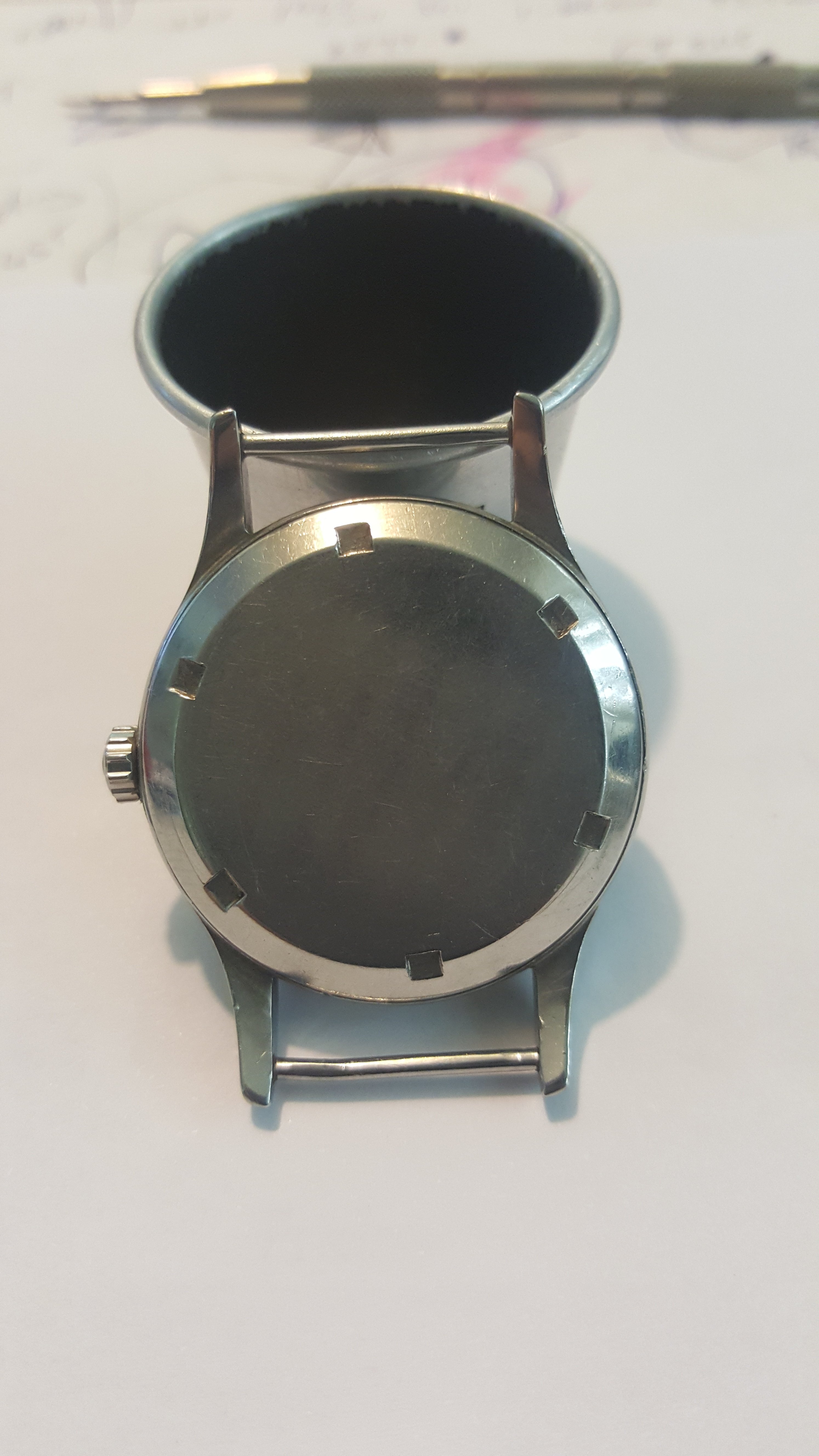

Hi
This is one 34mm Omega Thin Arrow mystery watch that i own and still have no conclusive evidence of the provinence the watch.
Cheers Russell.

Do you have more pics? Inside and out?

Yes I do and will add to the post later as I'm not home at the moment. Cheers Russell.

The reference for a '53 is 2777-1, I believe the crown on yours is wrong, there should also be a soft iron inner case back to improve protection against magnetism.
I don't know enough about the movement numbers assigned to these watches but yours seems to be from around 1947 which could be correct but a 4/5 year wait for a case seems a long time. The second, minute and hour hands look wrong to me as well. The best place to get a definitive answer to your question in MWR forum, they are the experts on military stuff.

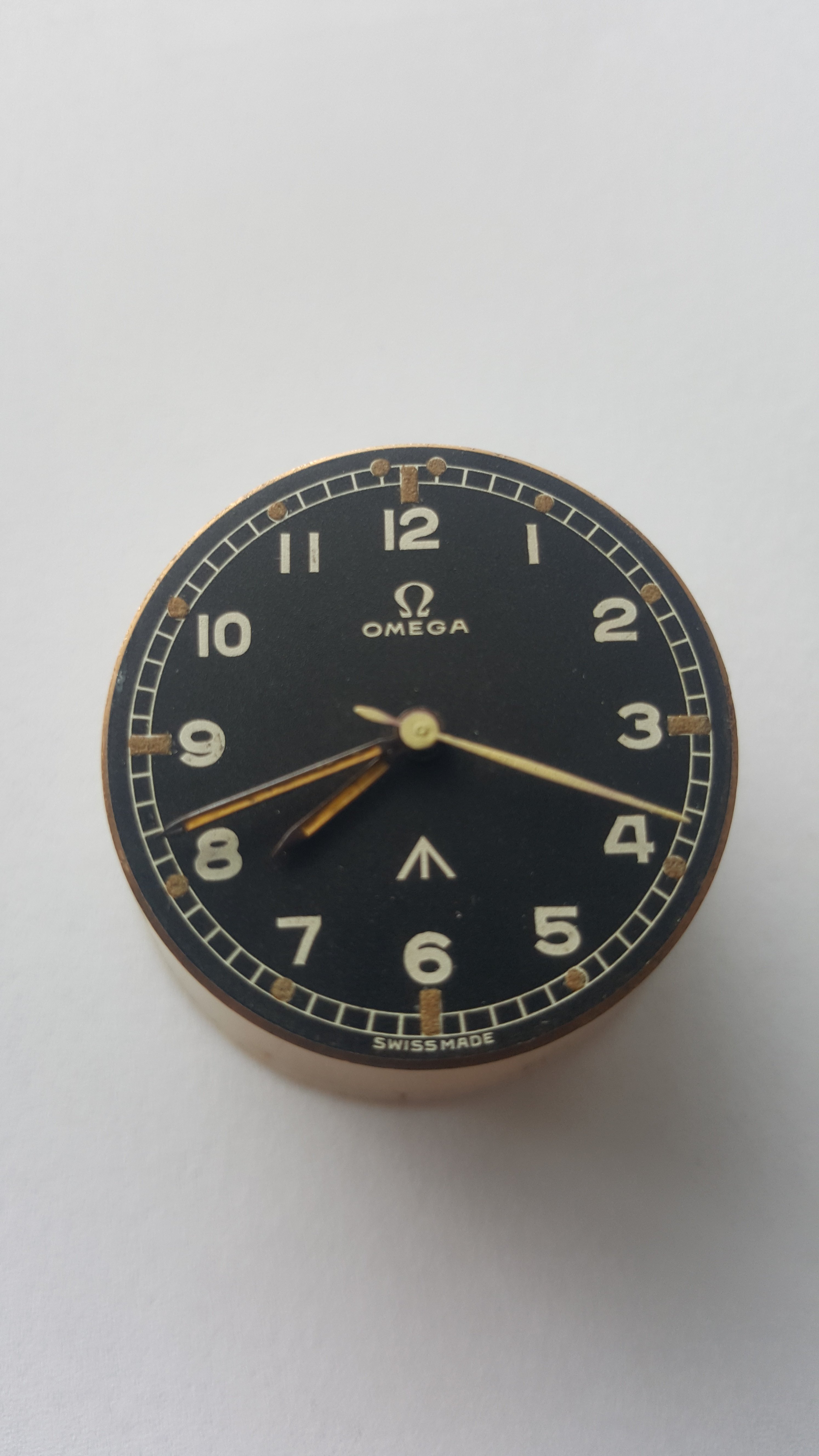

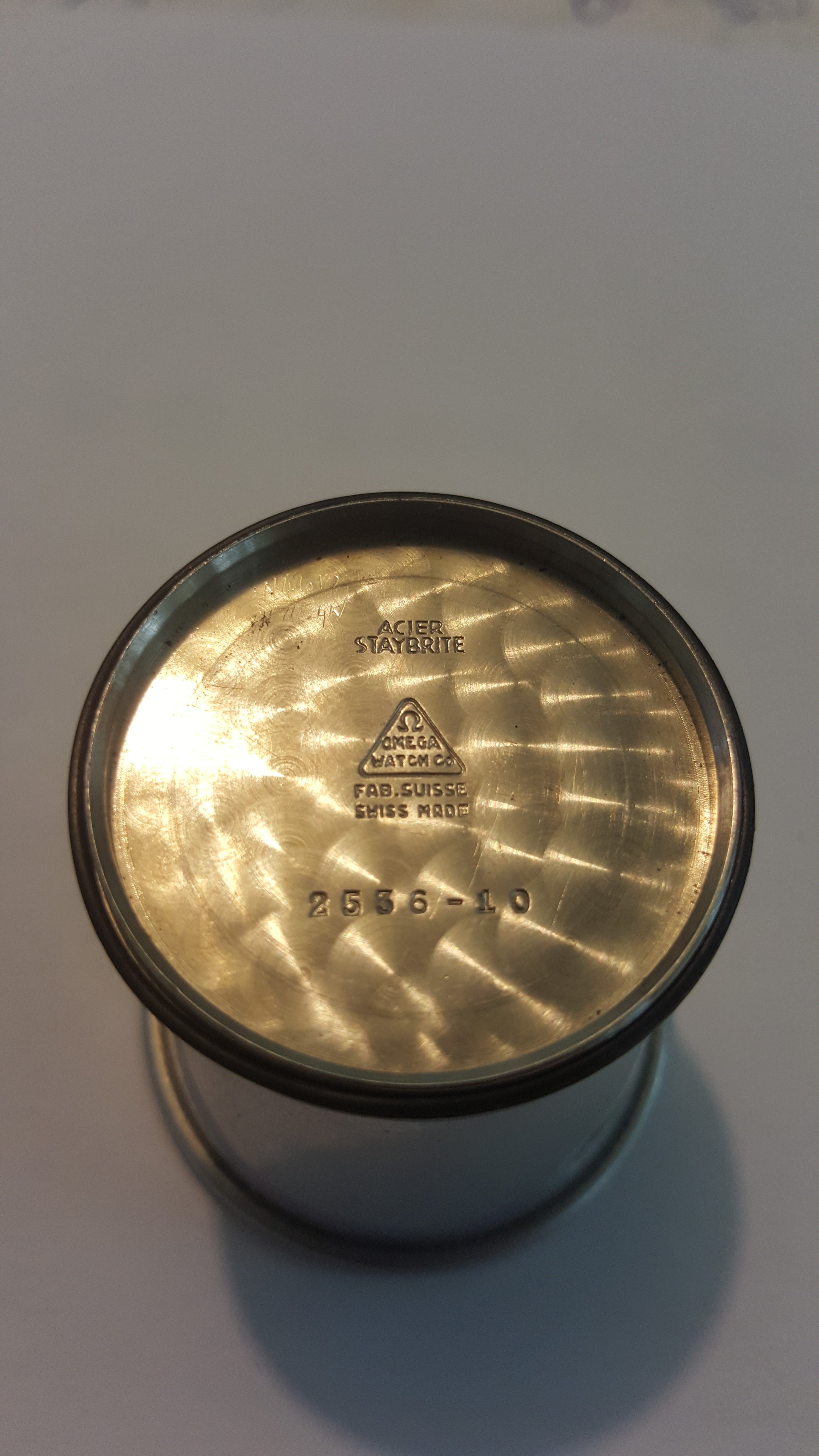

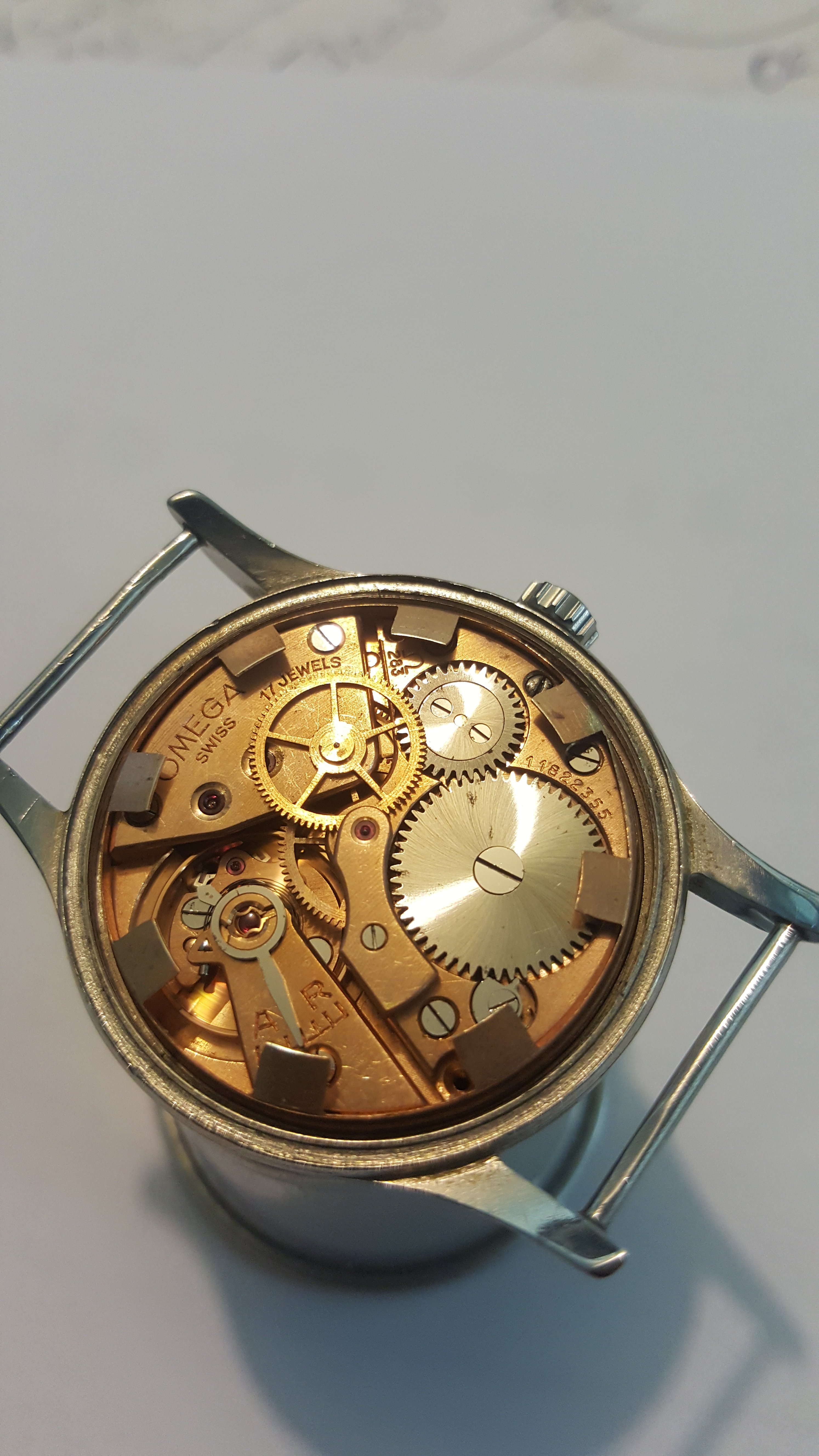

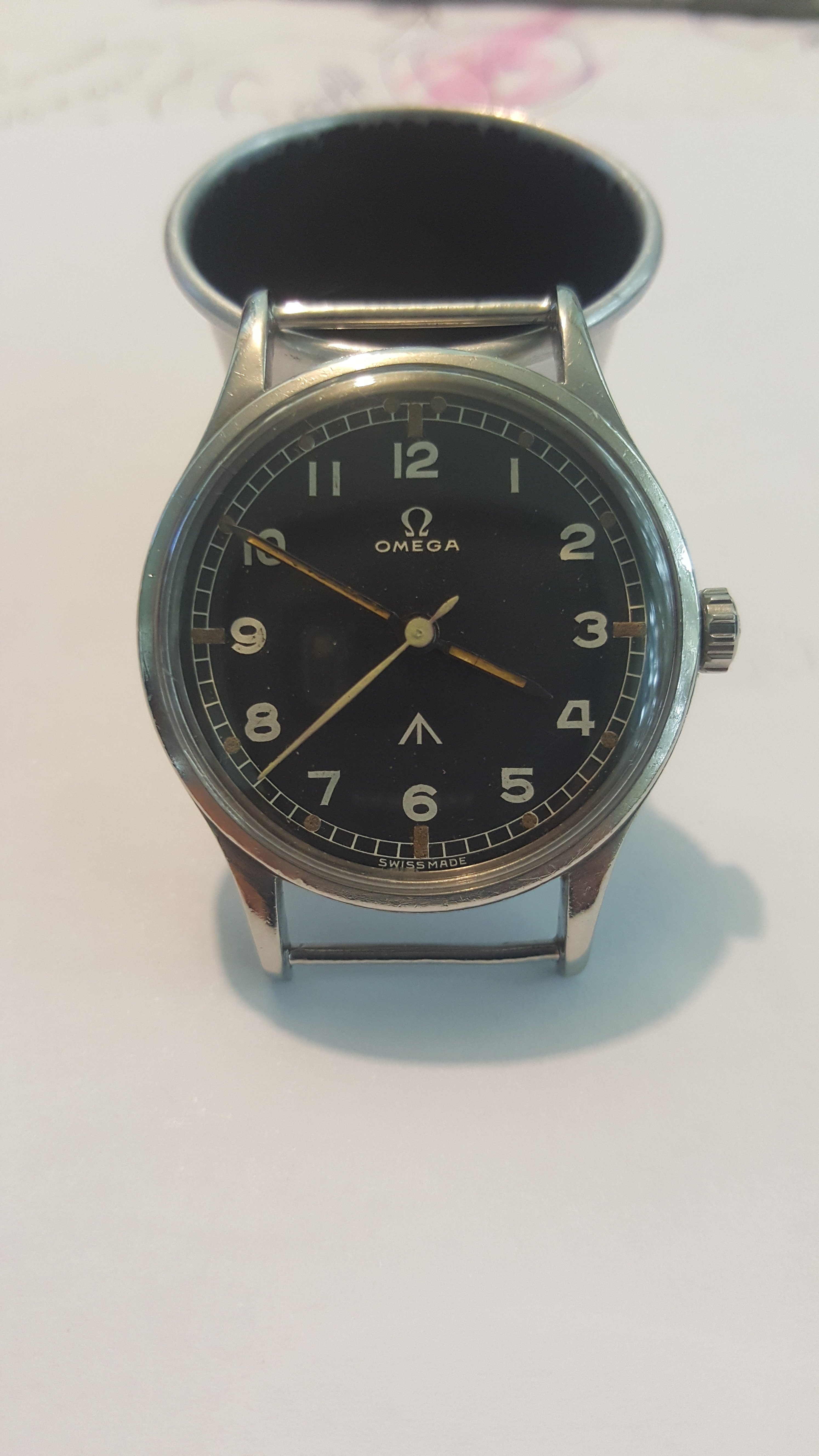

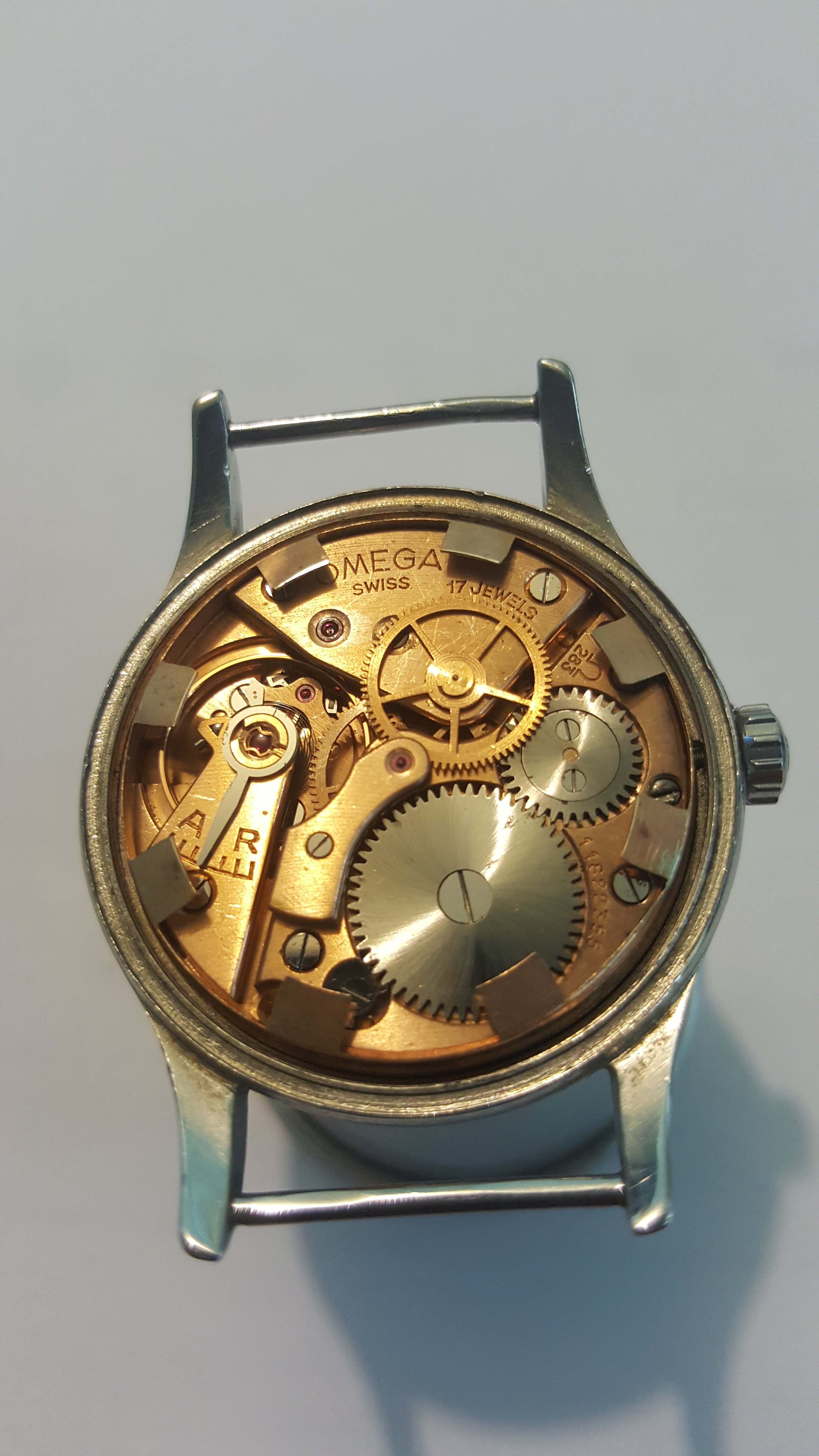

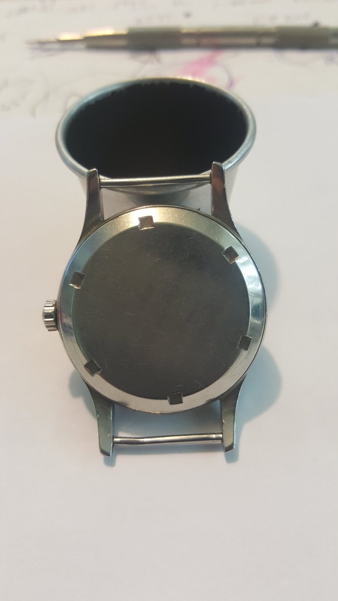

View attachment 533700 View attachment 533700 View attachment 533703 View attachment 533710 View attachment 533713 View attachment 533714 Hi
Pictures and details as requested. I have taken some pictures of the movement and inside case back plus front on looking at the dial. The movement is cal 283 serial 11822355. Case ref 2536-10. The case has fixed bars.
Cheers Russell.

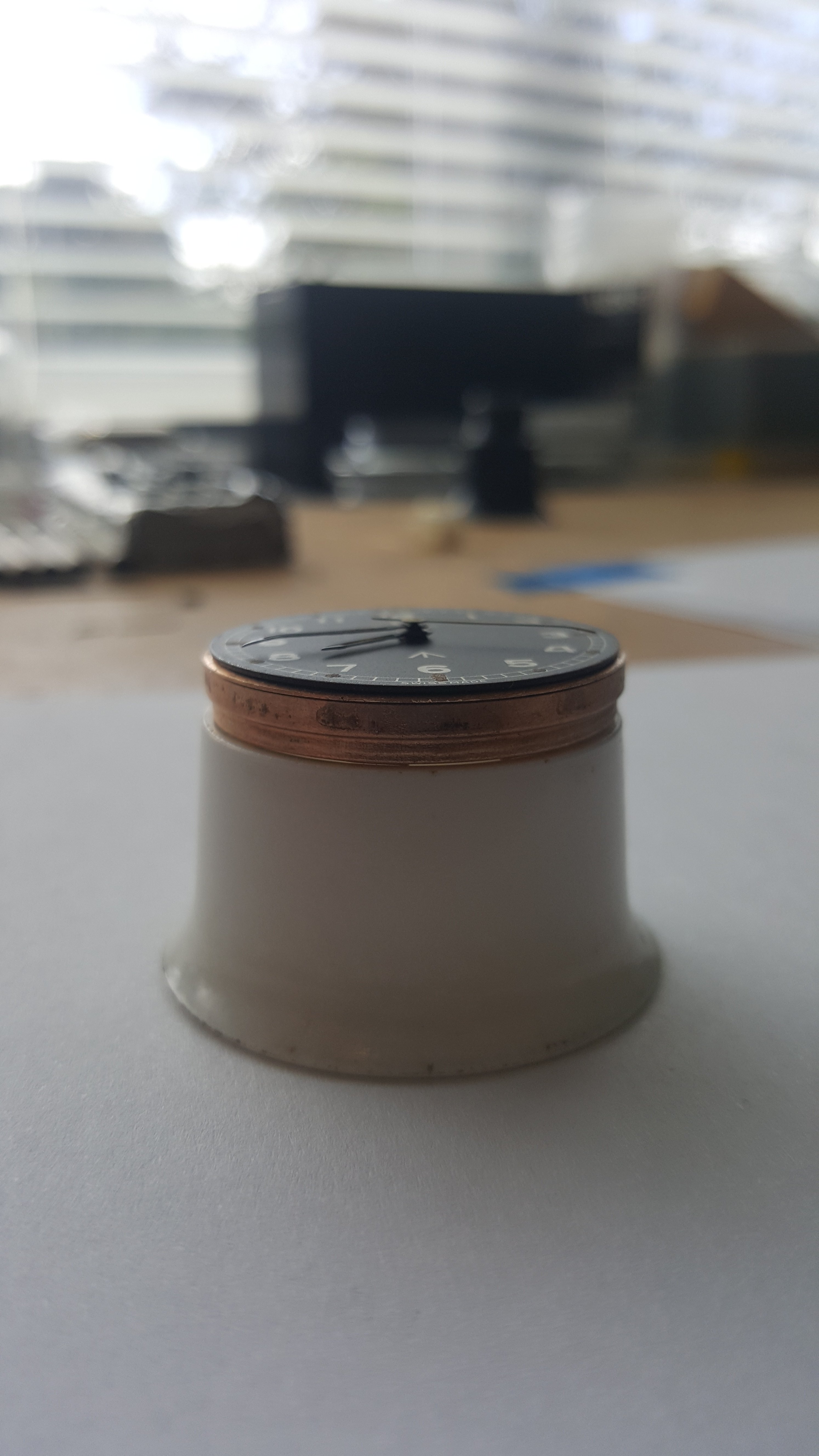

Is the dial the thick one like in the usual '53s?
734
4,686
I will take to my watchmaker today and check.
Cheers Russell.
734
4,686

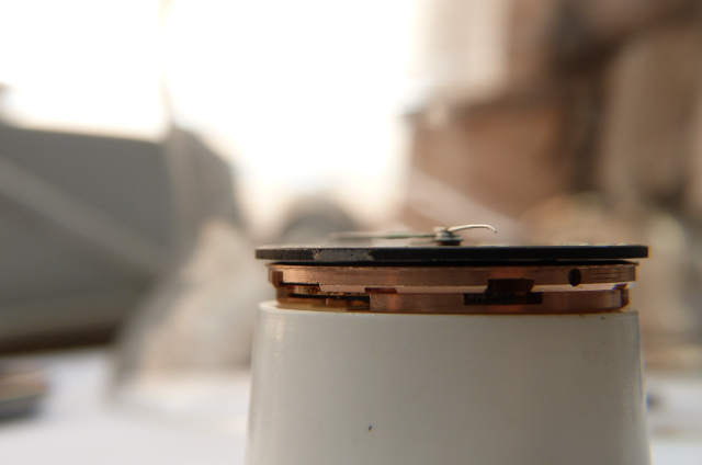

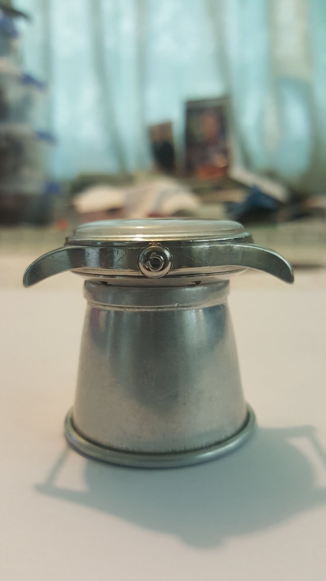

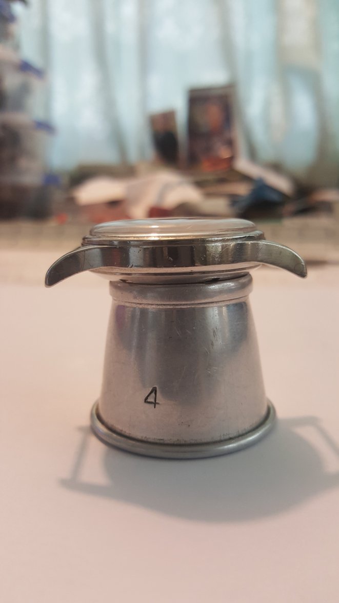

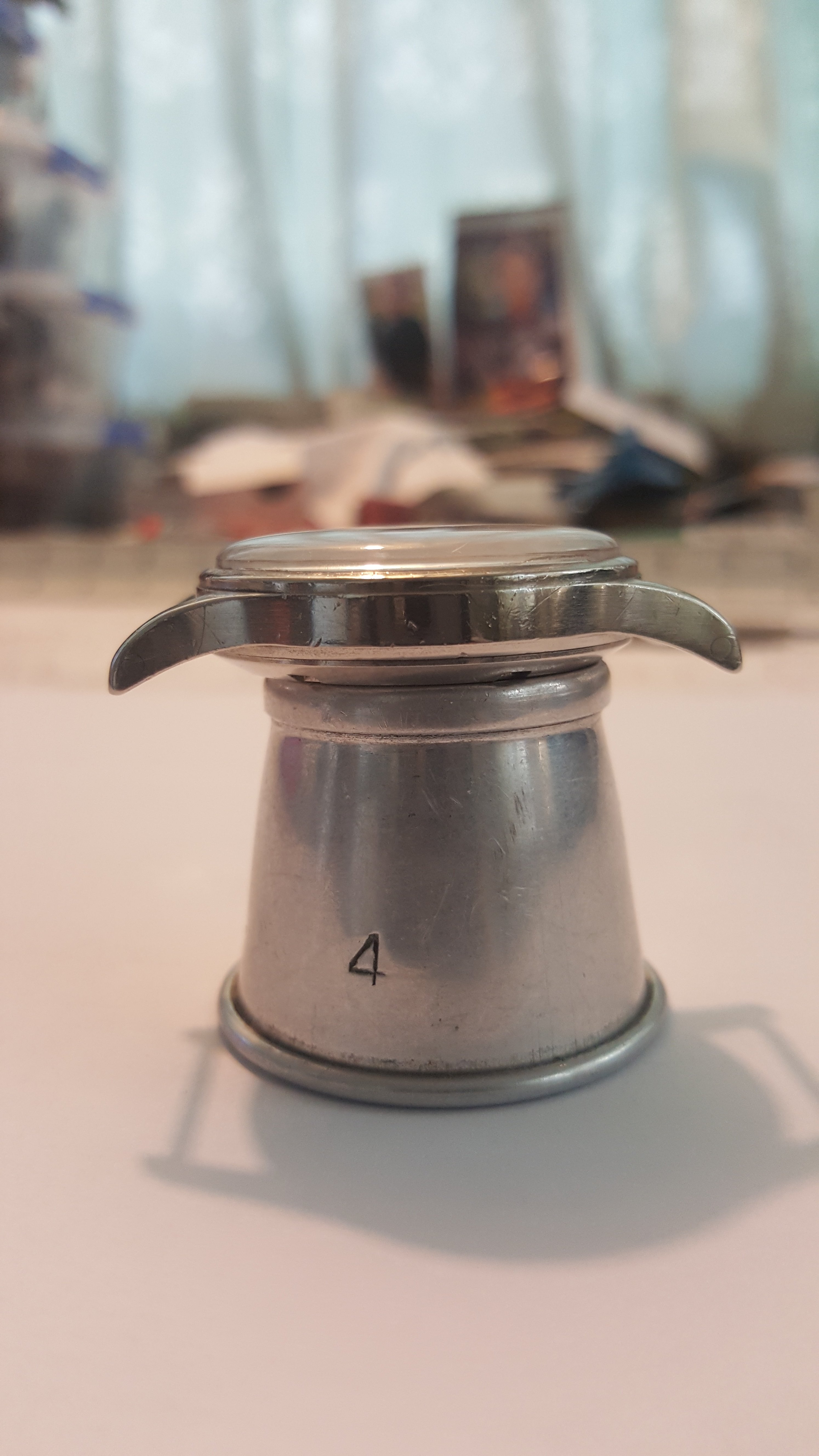

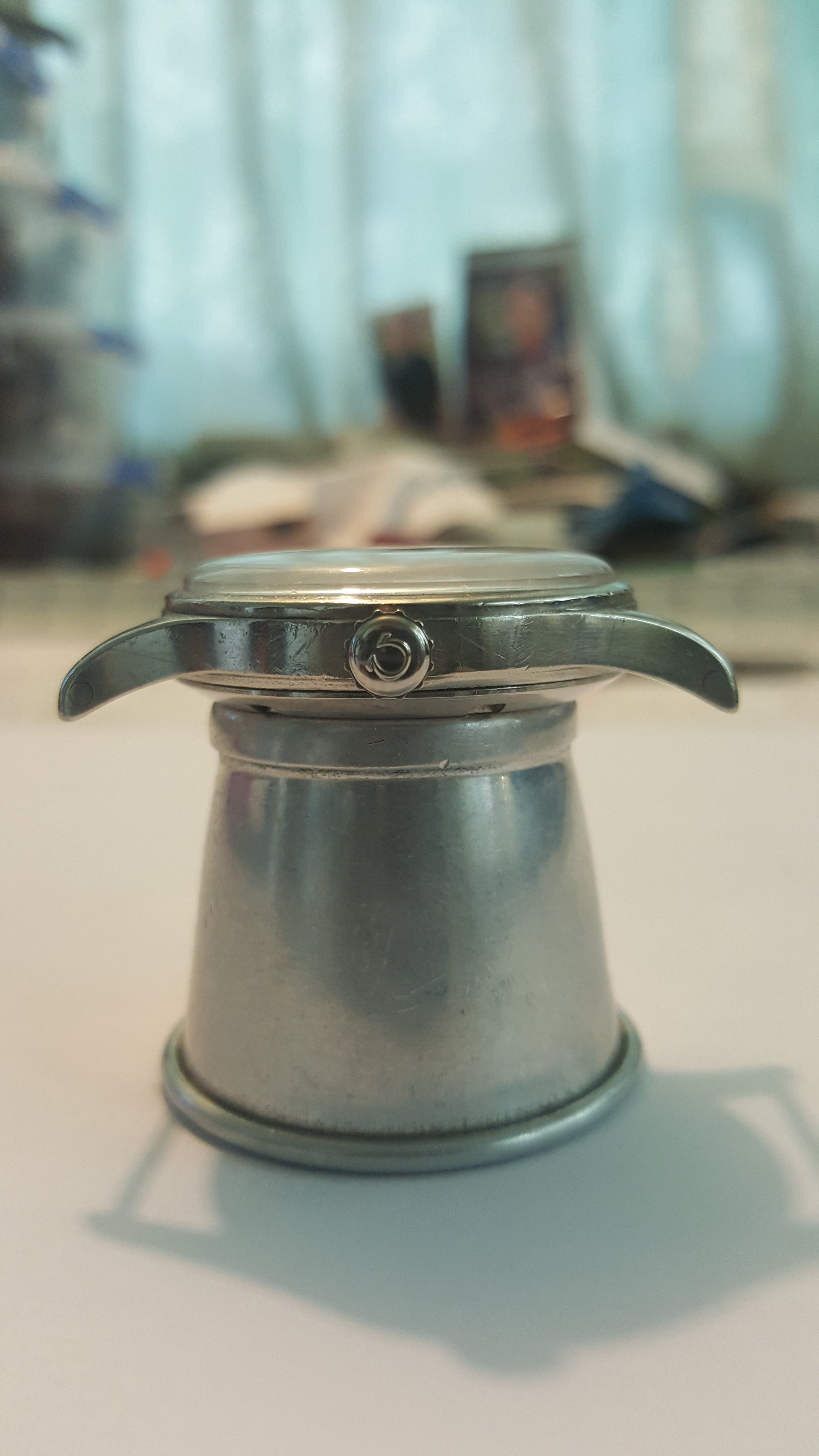

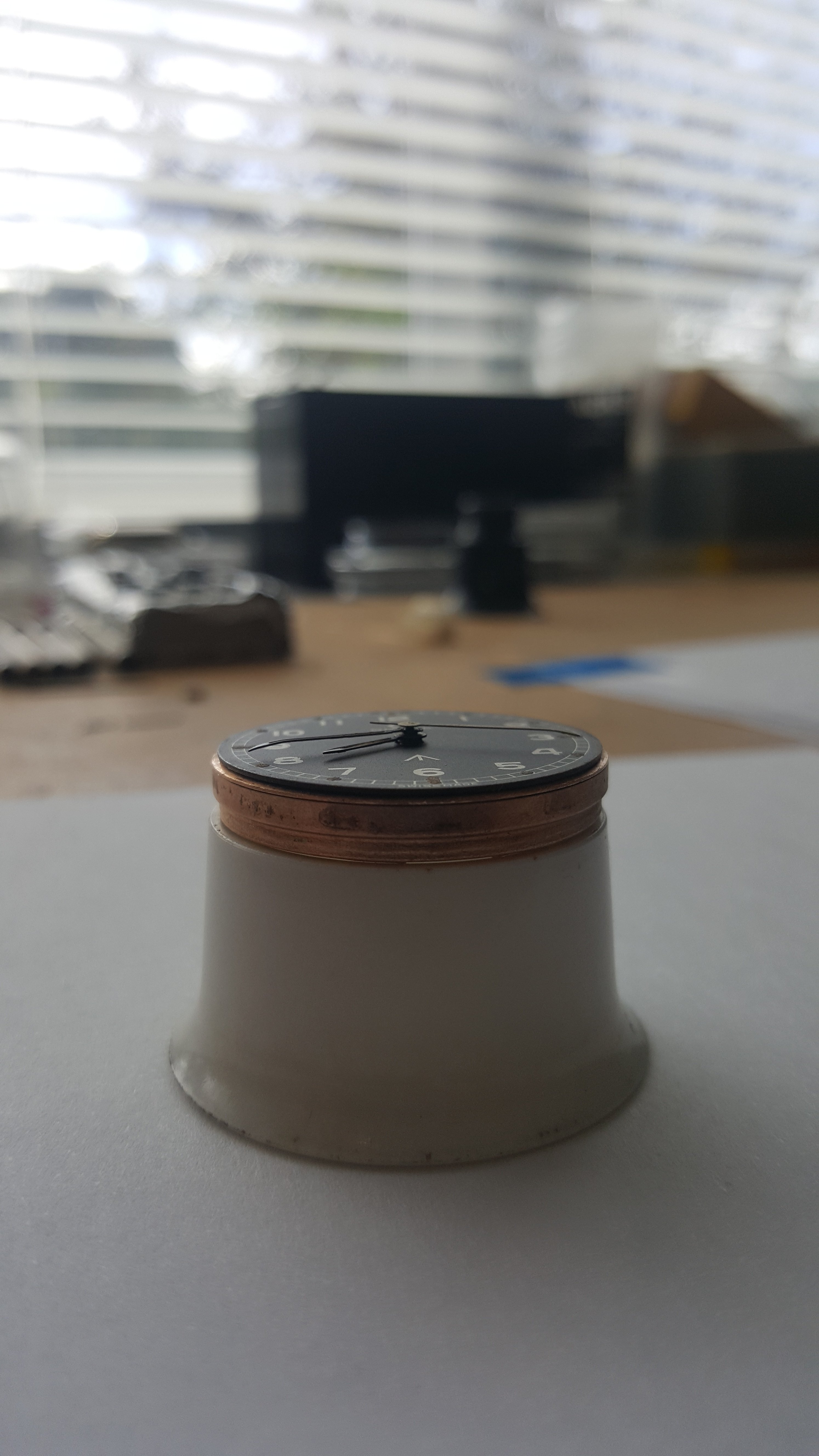

The dial is 29.6mm in diameter and .5mm thick.
Picture looking side on and dial up.
Cheers Russell.
This is a picture of my Omega 6b/542 dial showing the thickness for comparison.
Cheers Russell.
