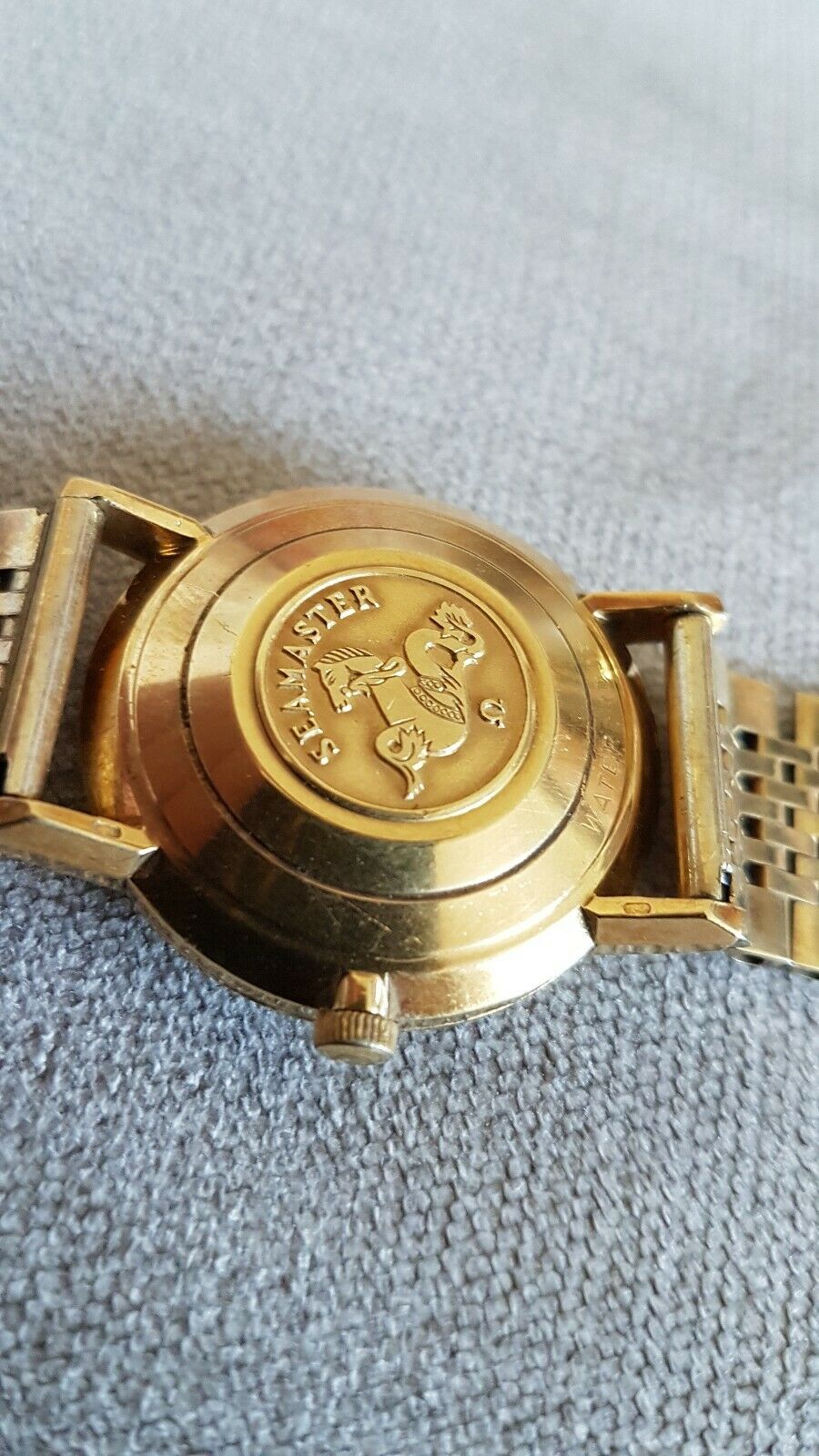

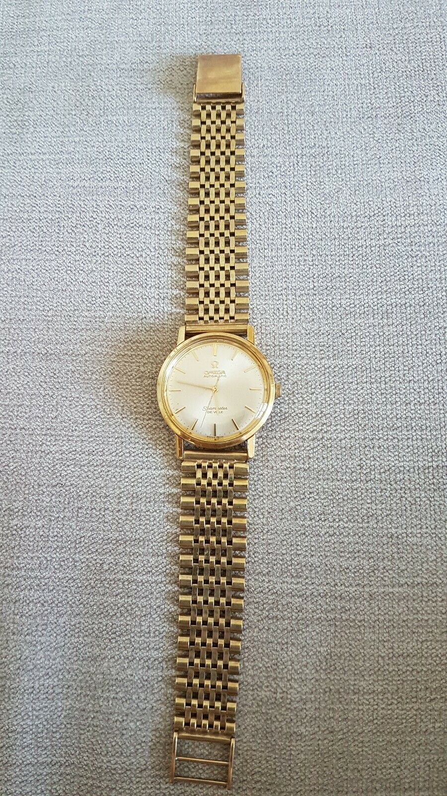

hi, i have a chance of purchasing an omega 18ct gold seamaster auto deville unishell case dia is around 33-34mm , but can not work out , what the case reference number is as I only have 1 photo. my question is whats the case ref, and what calibre movement it holds..... I hope somebody can help. many thanks regards p ...................................................................................................................................................yes, sorry. here,s another photo. I was hoping it was a 552 calibre. but not sure. as the back, looks a little unusual to me .. ps thanks again ,re all your help. regards ,,all

Not sure why anyone would purchase a watch based on a single picture like that unless they were planning to scrap the case for gold.
We’ll need more to go on.

It sounds like it's just the case on offer, but still: that one picture with two correctly placed hallmarks that I didn't even notice, on a yellow metal case isn't even enough to convince me it's gold.

It sounds like it's just the case on offer, but still: that one picture isn't even enough to convince me it's gold.
The two correctly placed hallmarks on a yellow metal case isn't enough? 😀

yes it could be thanks but where ever I google, I can not find this same case...

OPs watch looks like a mid-size, 31mm, cal 670/671, in steel it would be a ref 165.004.

hi, thanks to all re your replies. excellent news...........regards to all... and thank you
