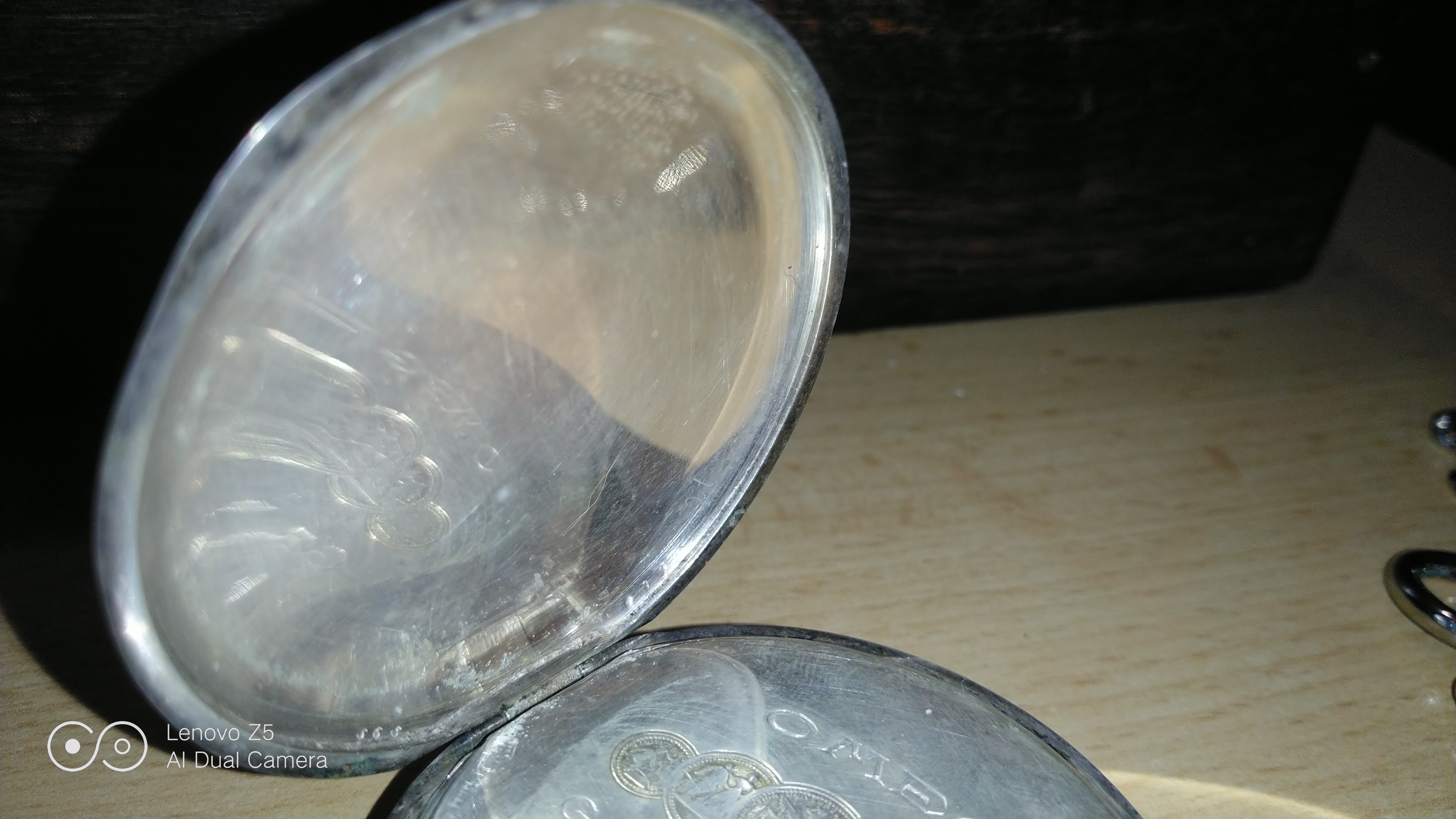

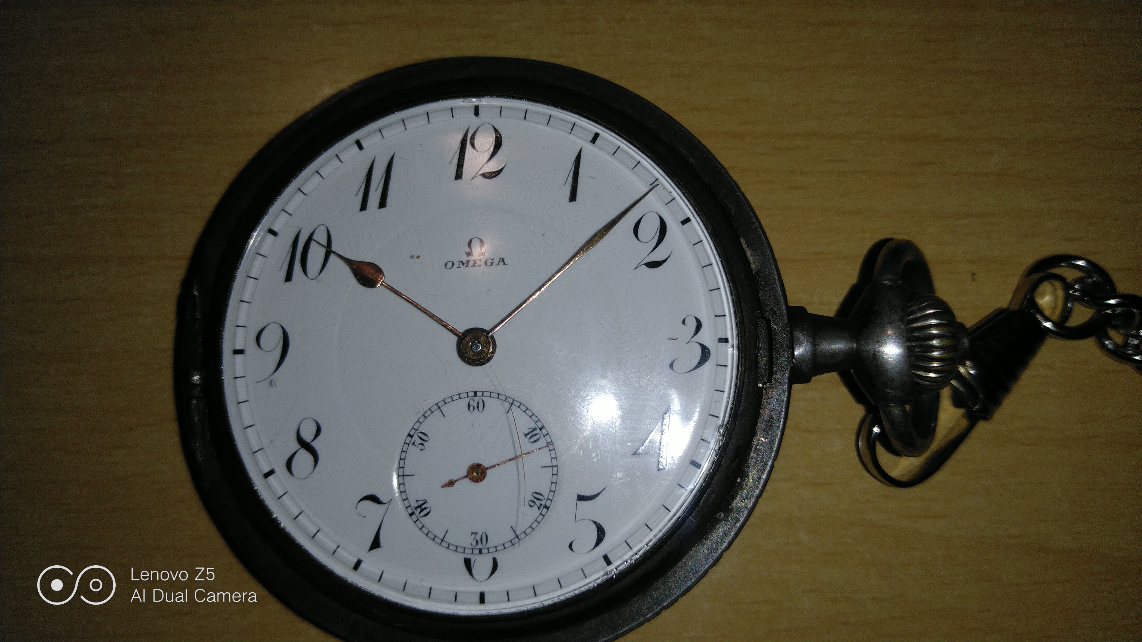

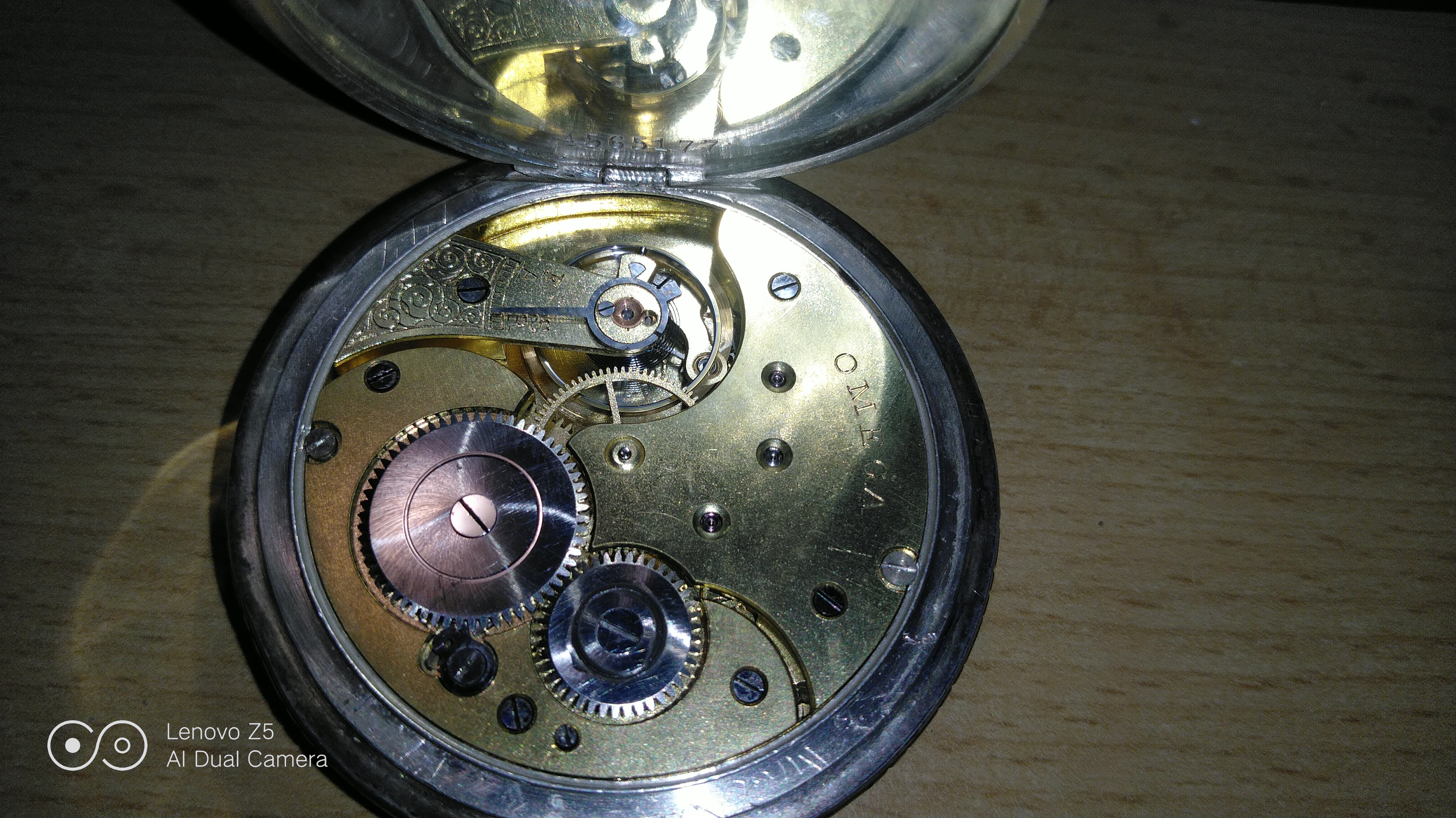

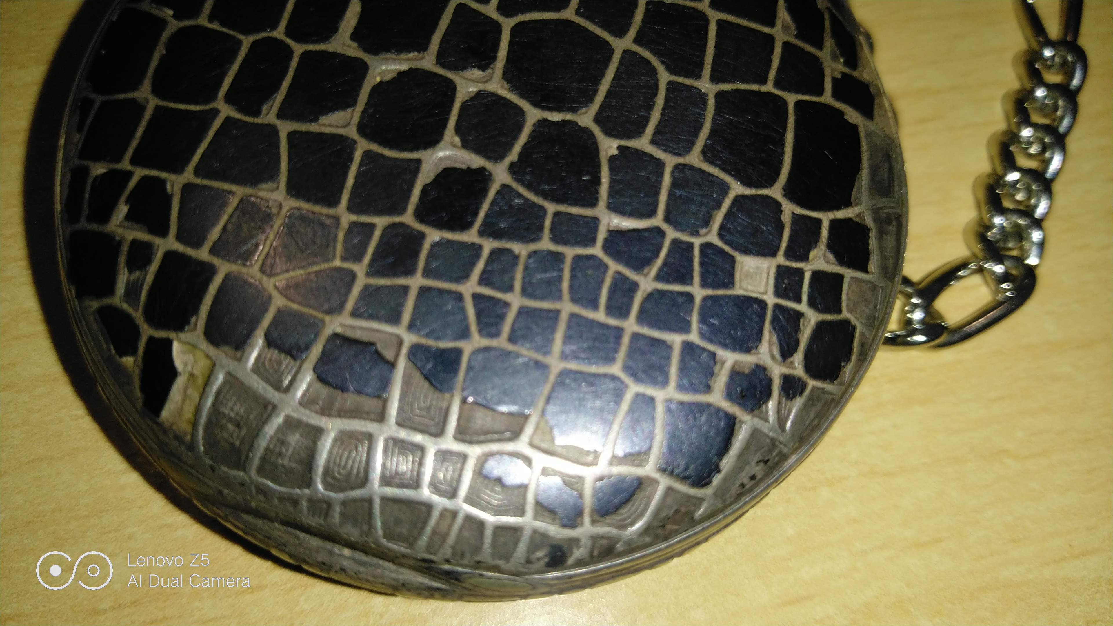

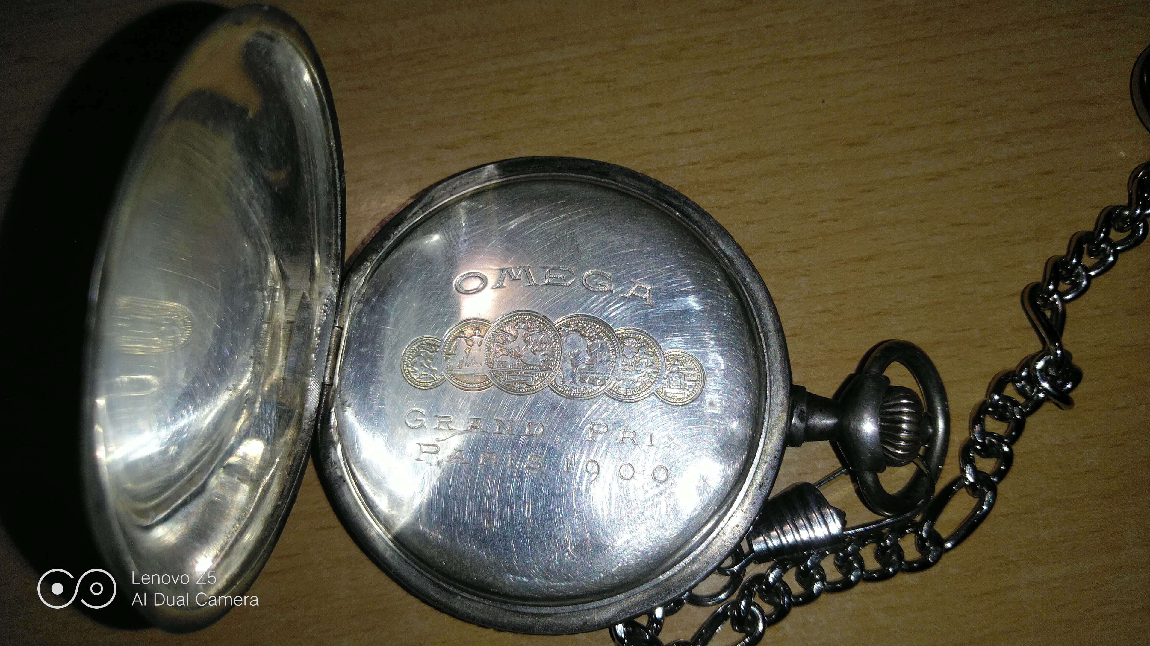

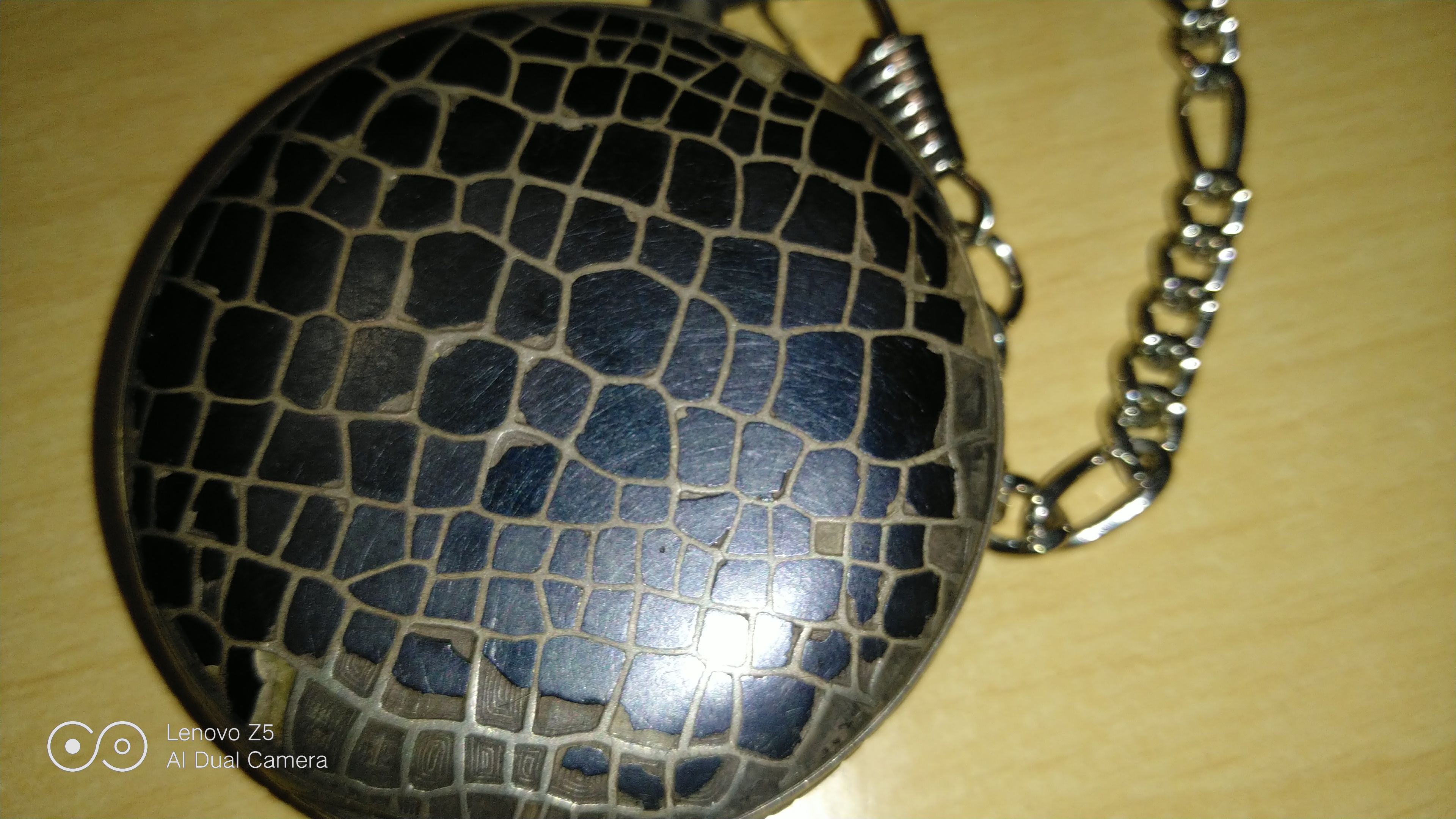

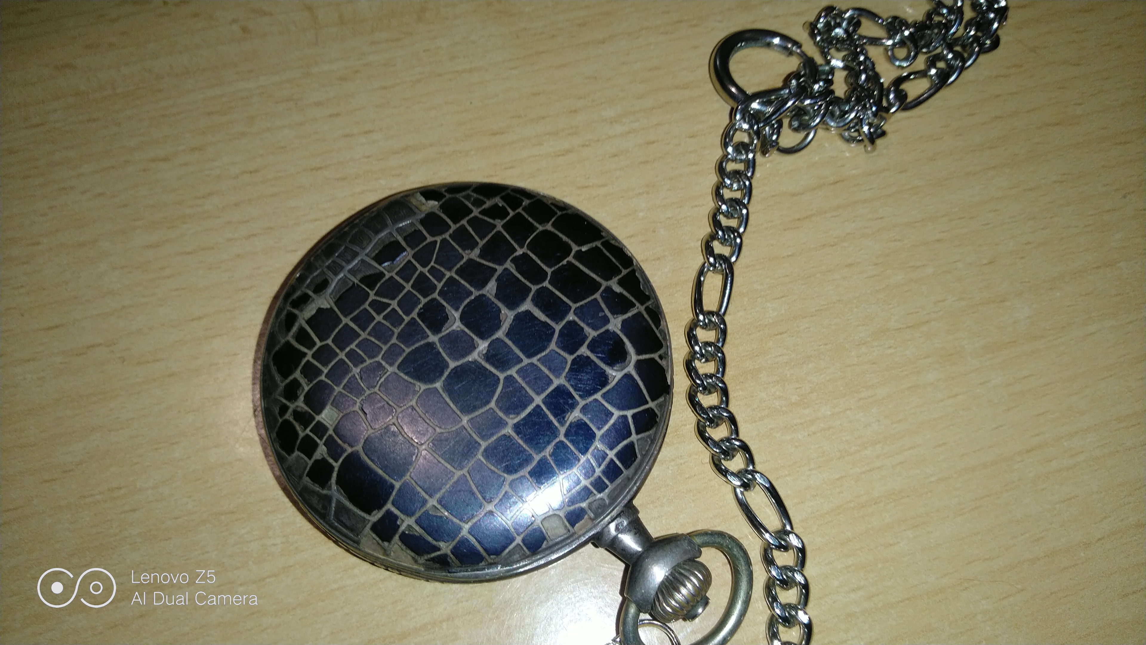

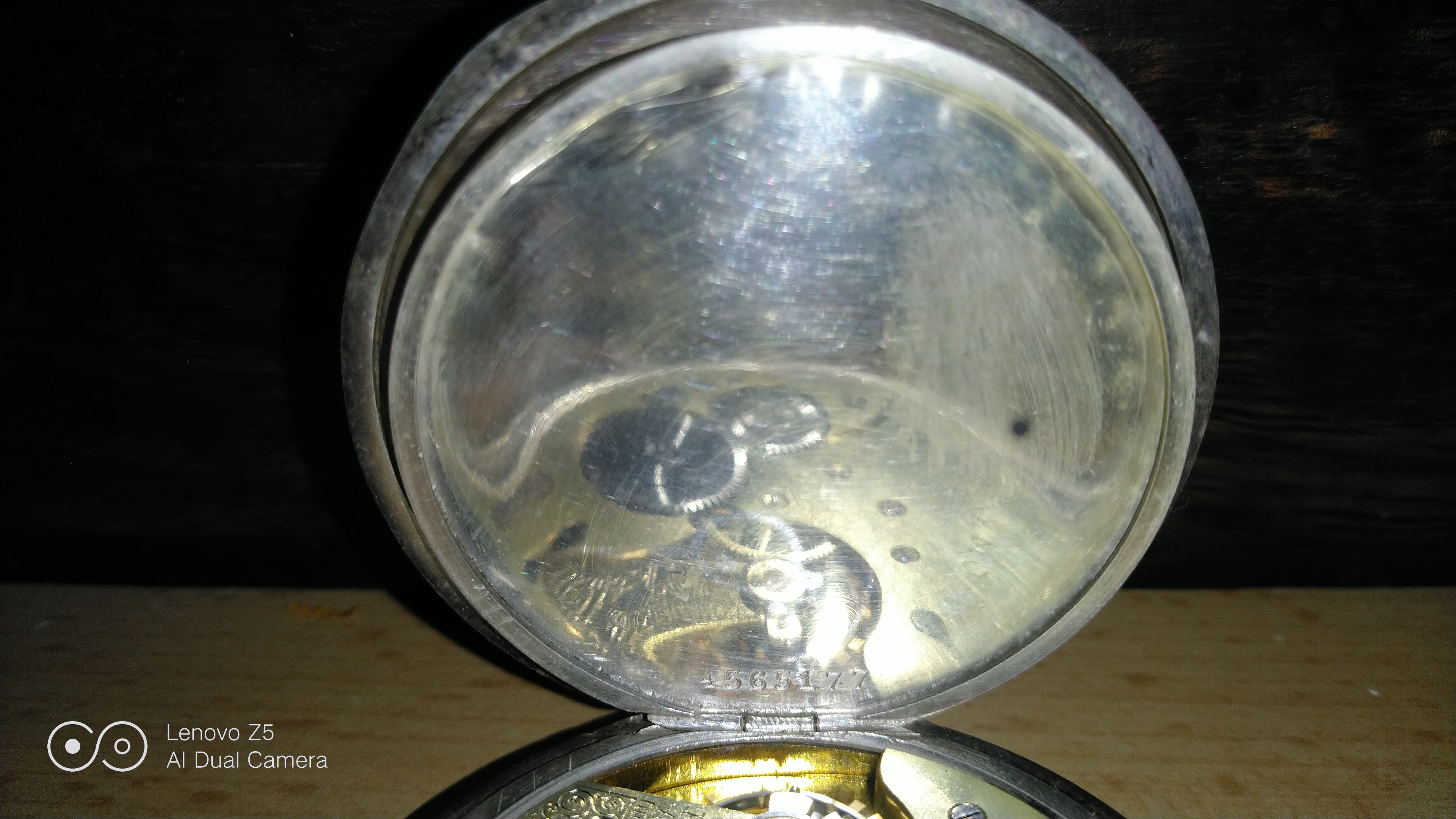

Hi, does anyone knows something about this watch? It is from 1914 but I didnt find this design on internet...thanks, Josip

Looks like an Omega movement in a busted hunter case. No cover. The finish is called niello. Almost like a metallic kiln fired enamel. Typical of many similar Swiss watches of the era. Cuvette (inner cover) emblazoned with almost meaningless attributes.
Thanks, I found it on internet now. Do you know maybe on which site can I find the parts that are missing?

For something like this, you almost need to find an identical watch to steal parts from. What you do is going to depend on how much sentimental value you have.
One "tier" is that nothing is actually missing, or NOS parts are available.
Next "tier" is that the parts can be made easily.
Last "tier" is to send it to Omega where you spend a minimum of $1500 and they make whatever parts you need. This is for watches produced before 1940, and I am confident that yours is that old.
Some here froth whenever they read about factory service but that might be the only way to get that one working.
