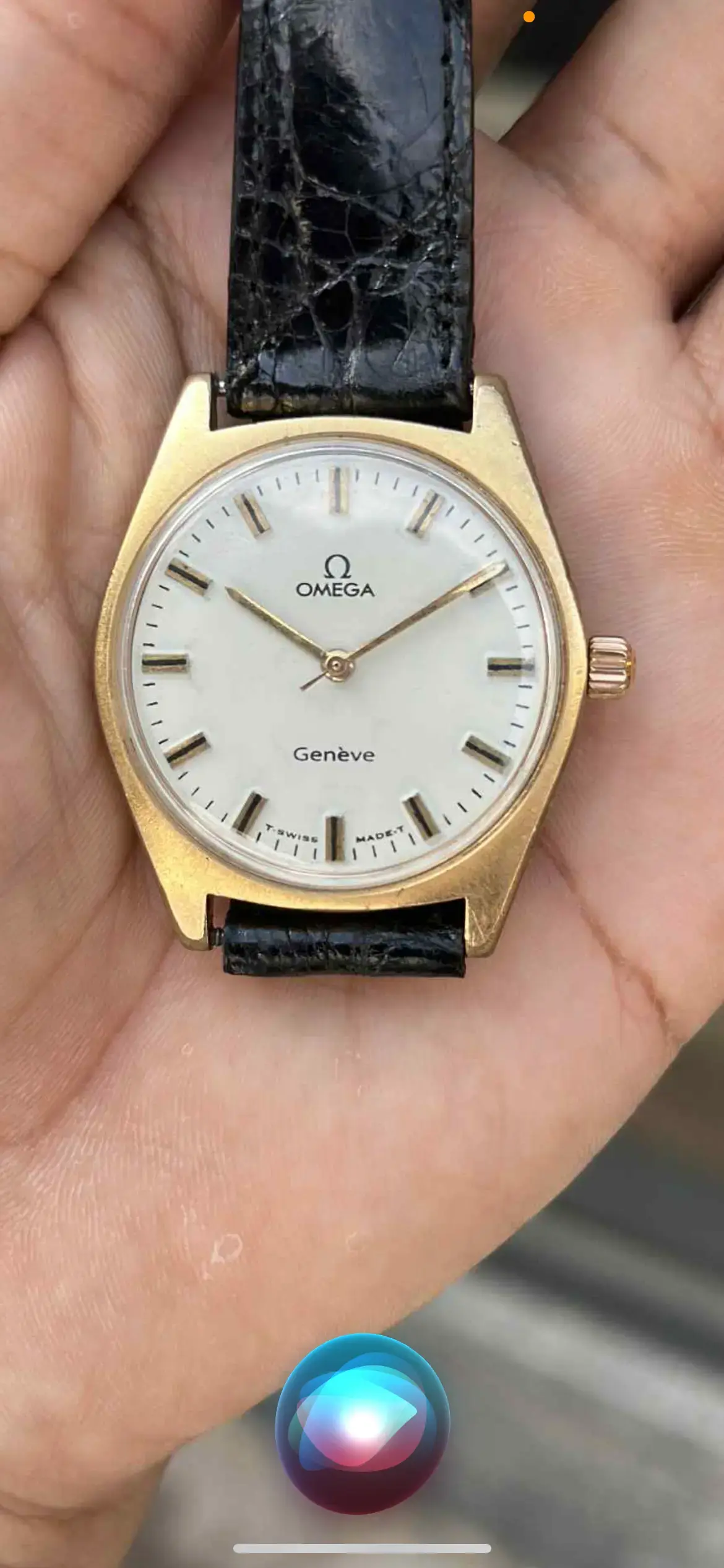

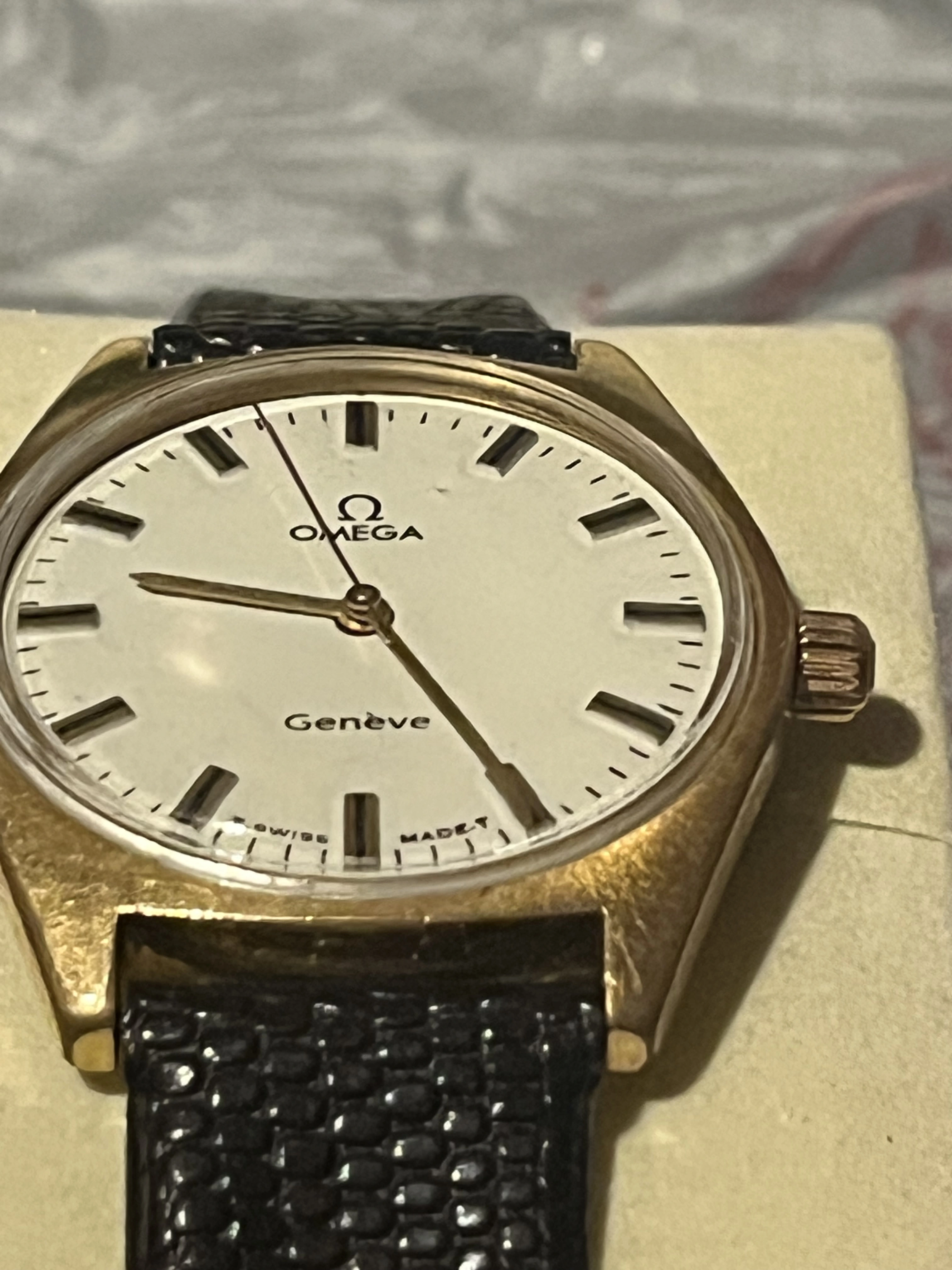

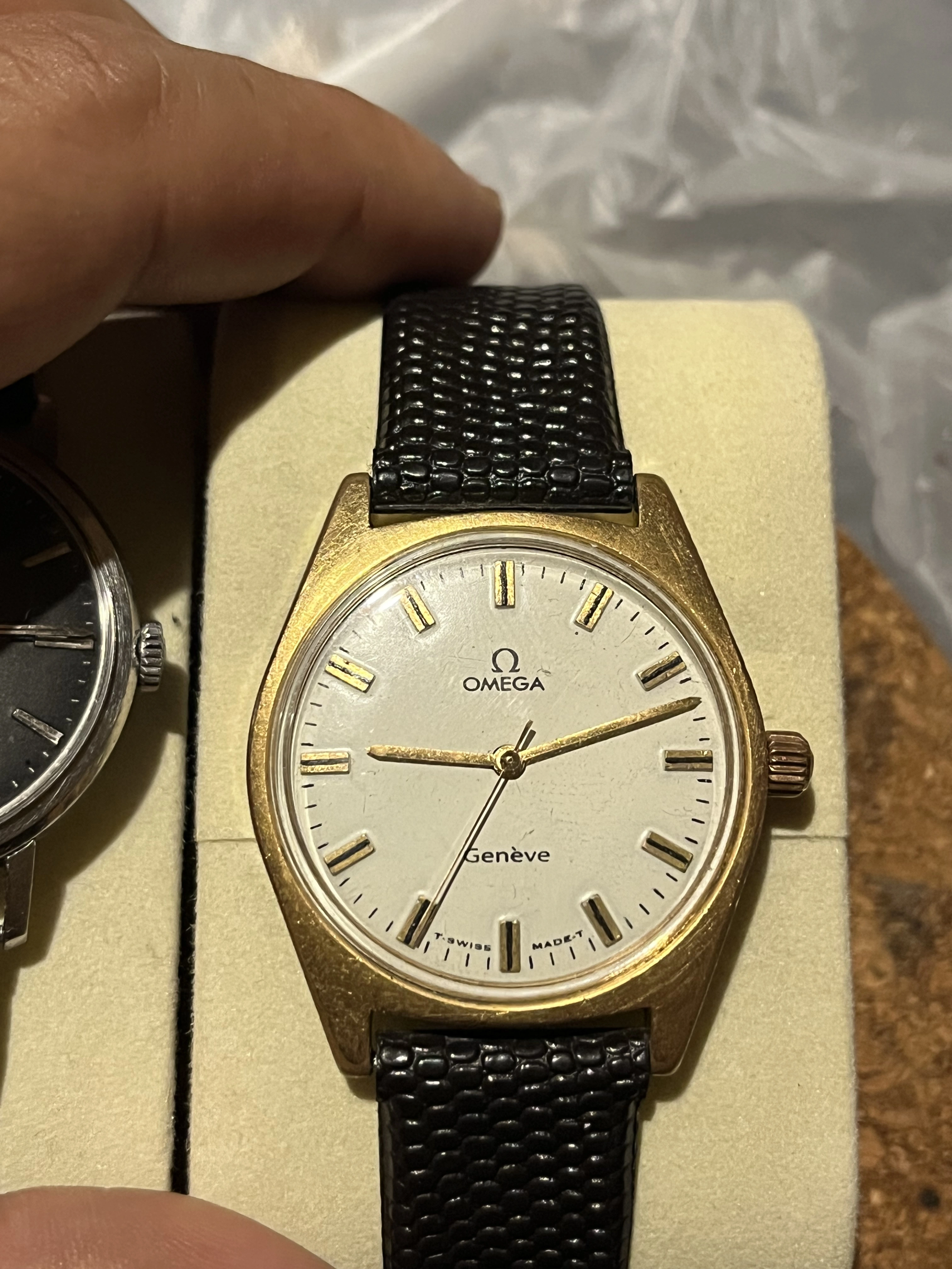

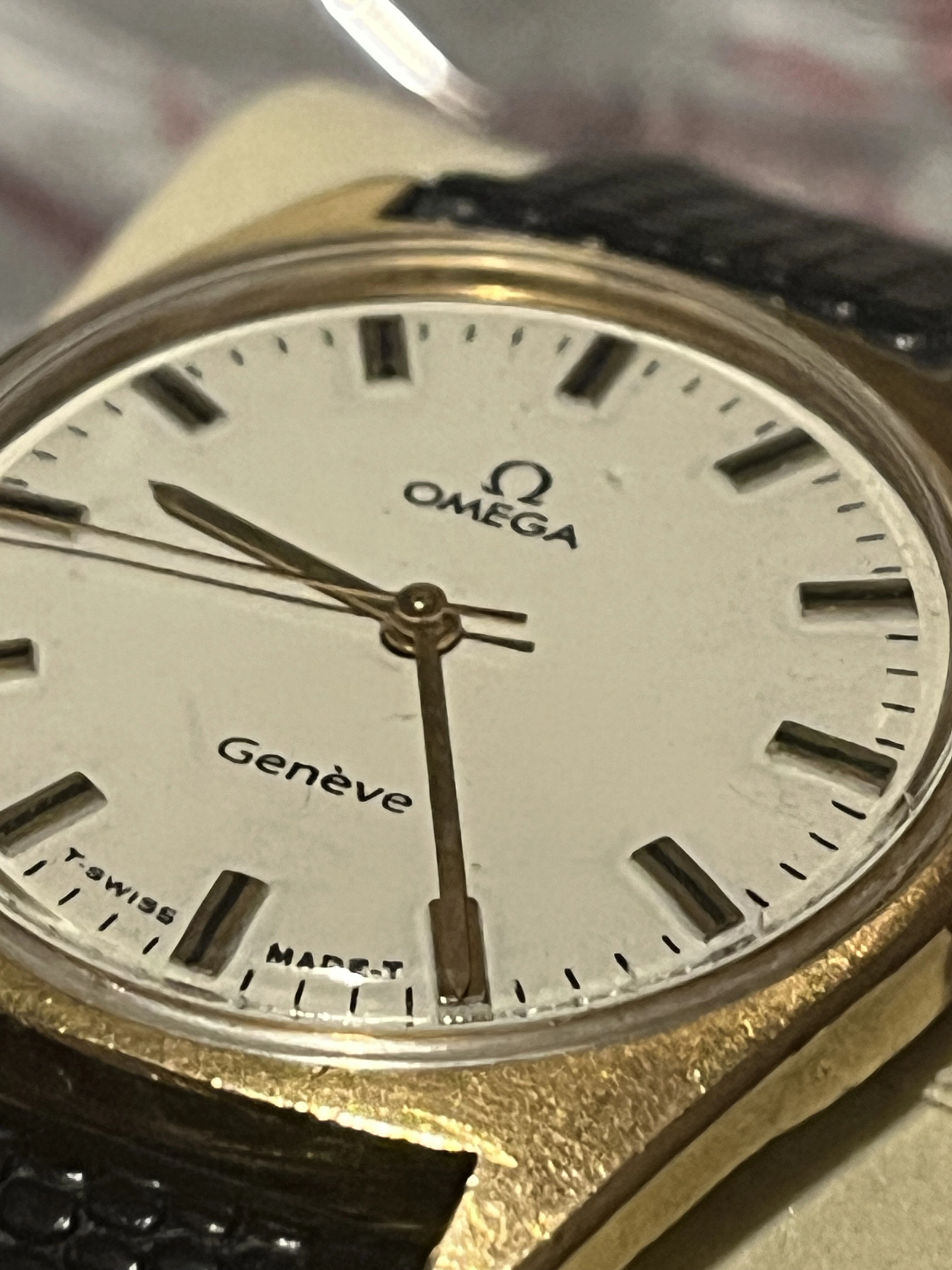

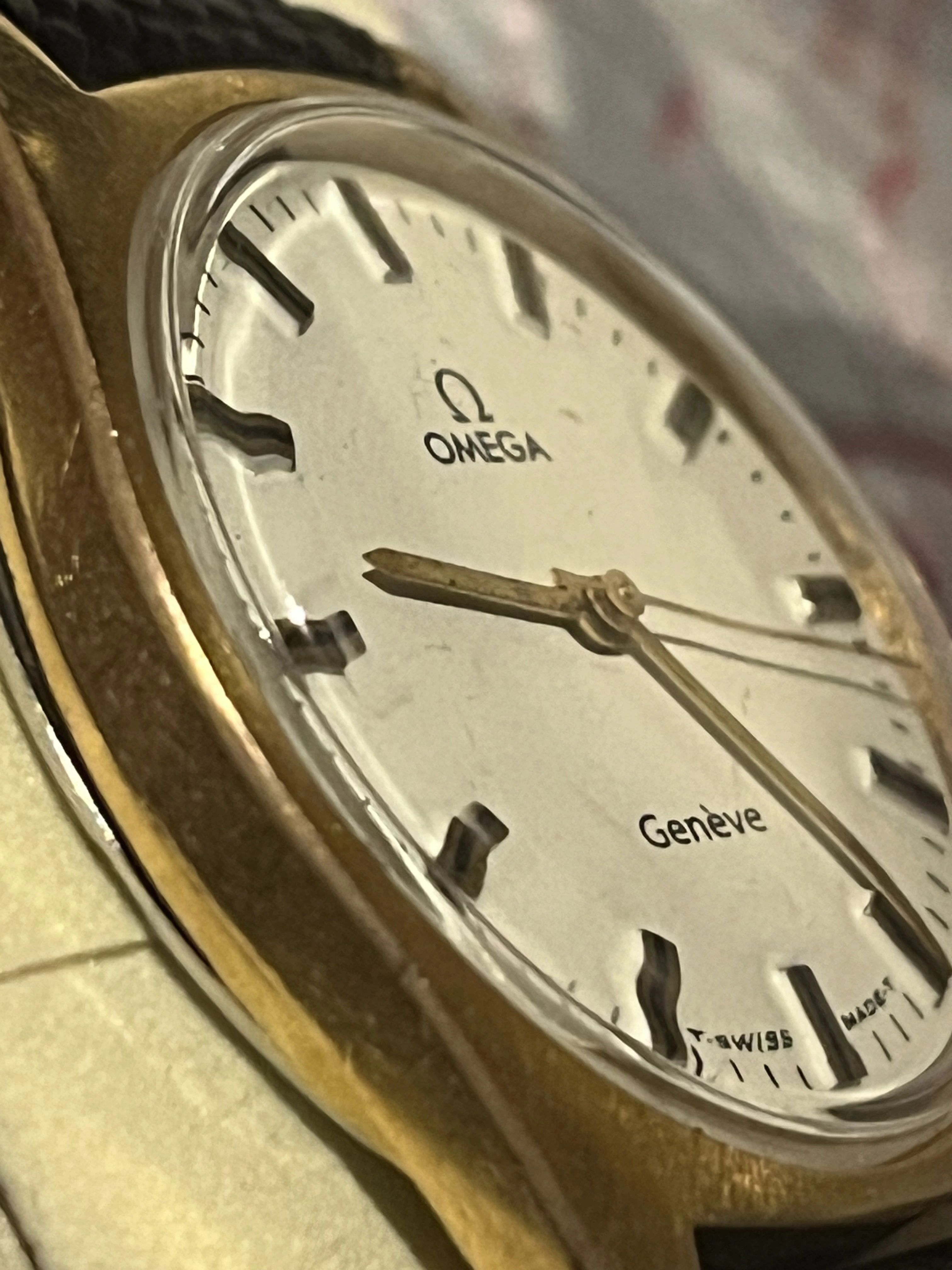

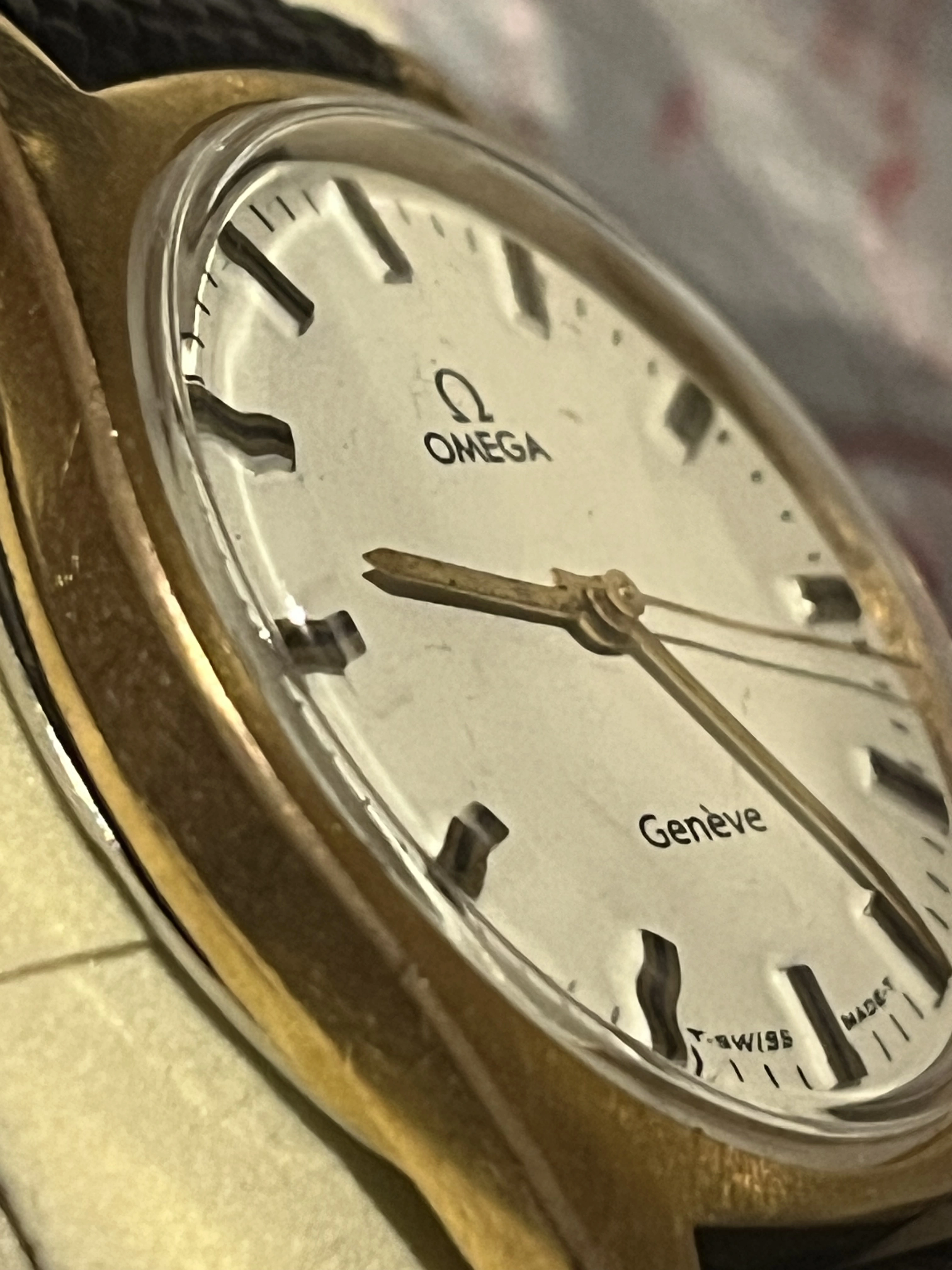

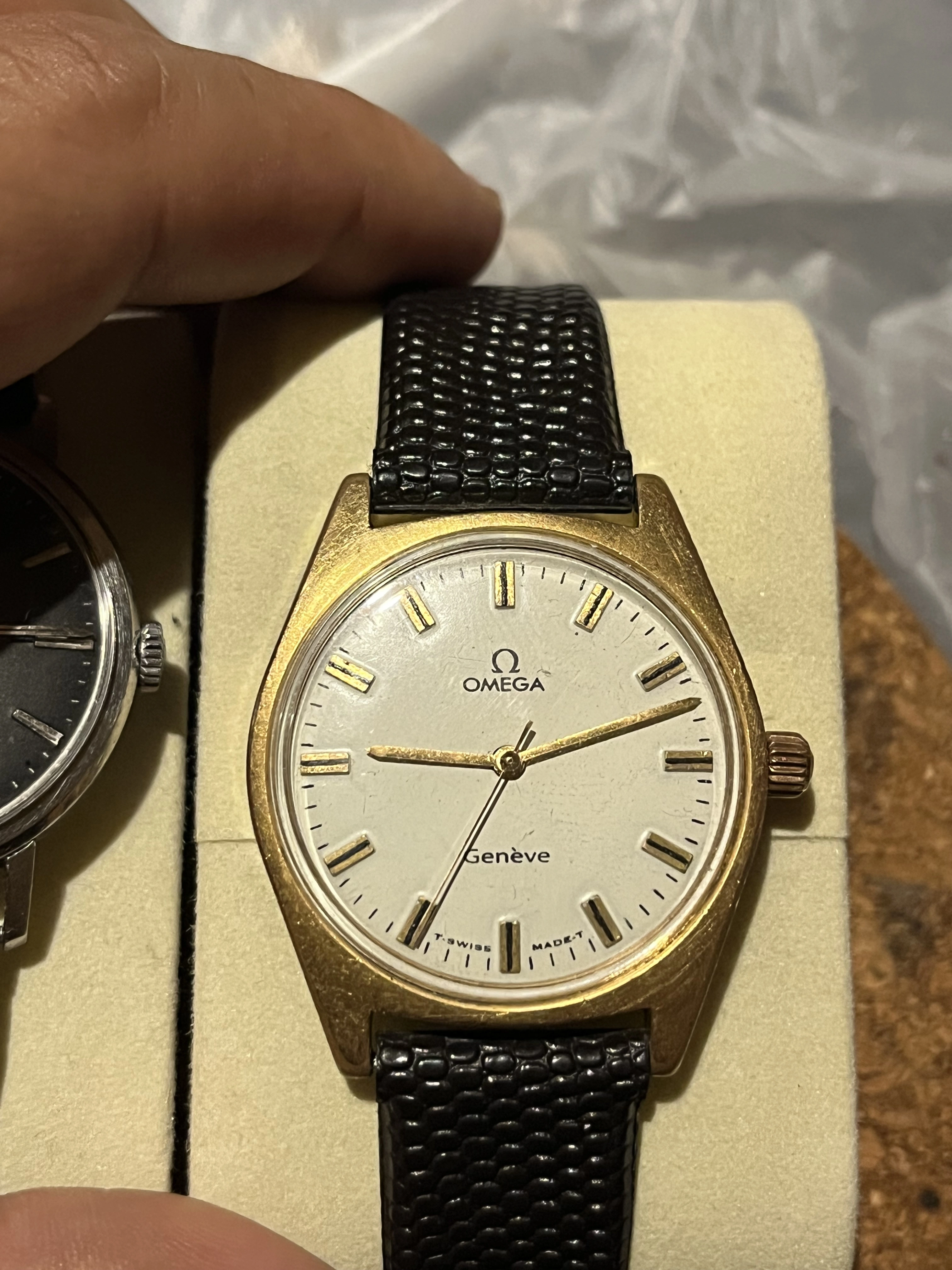

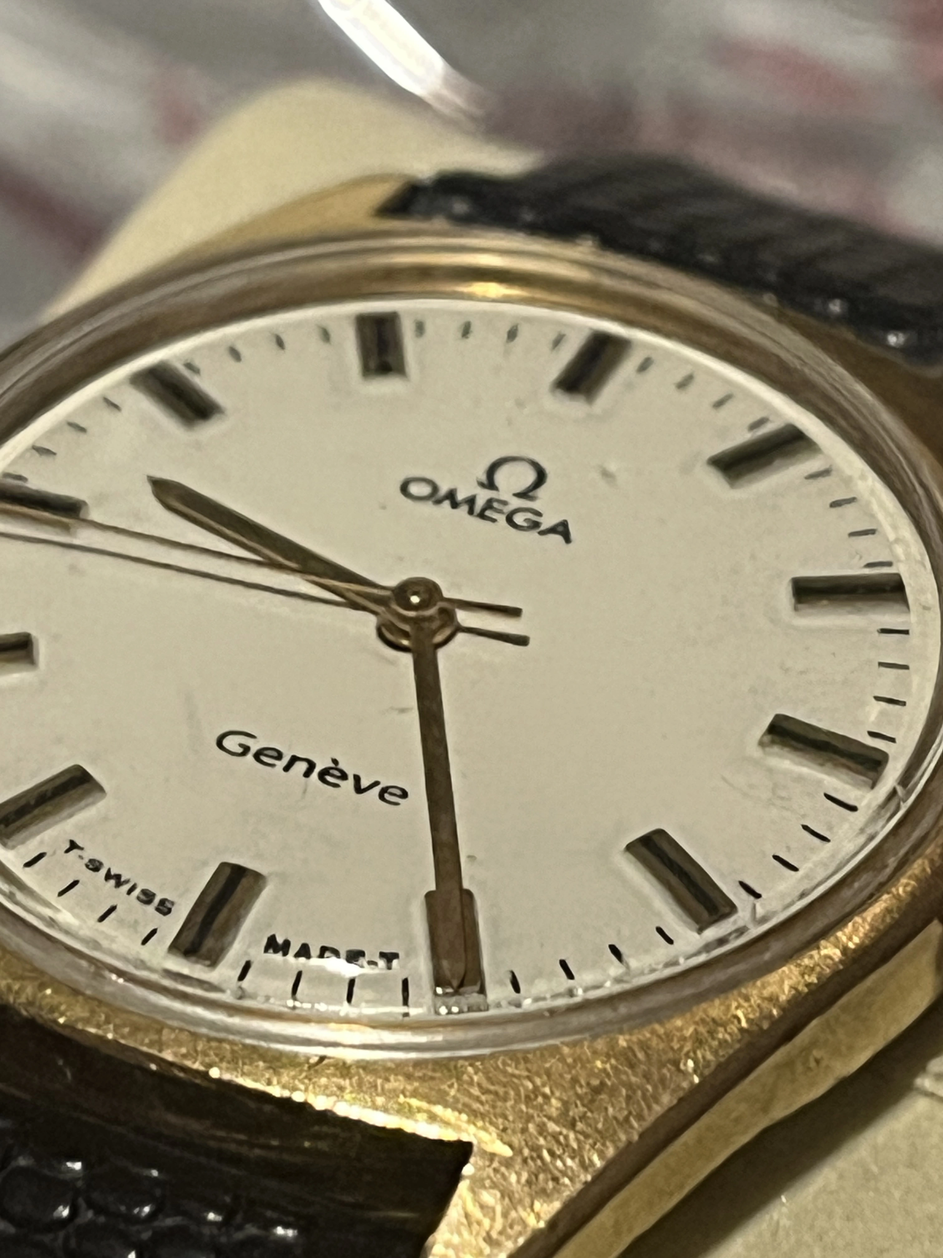

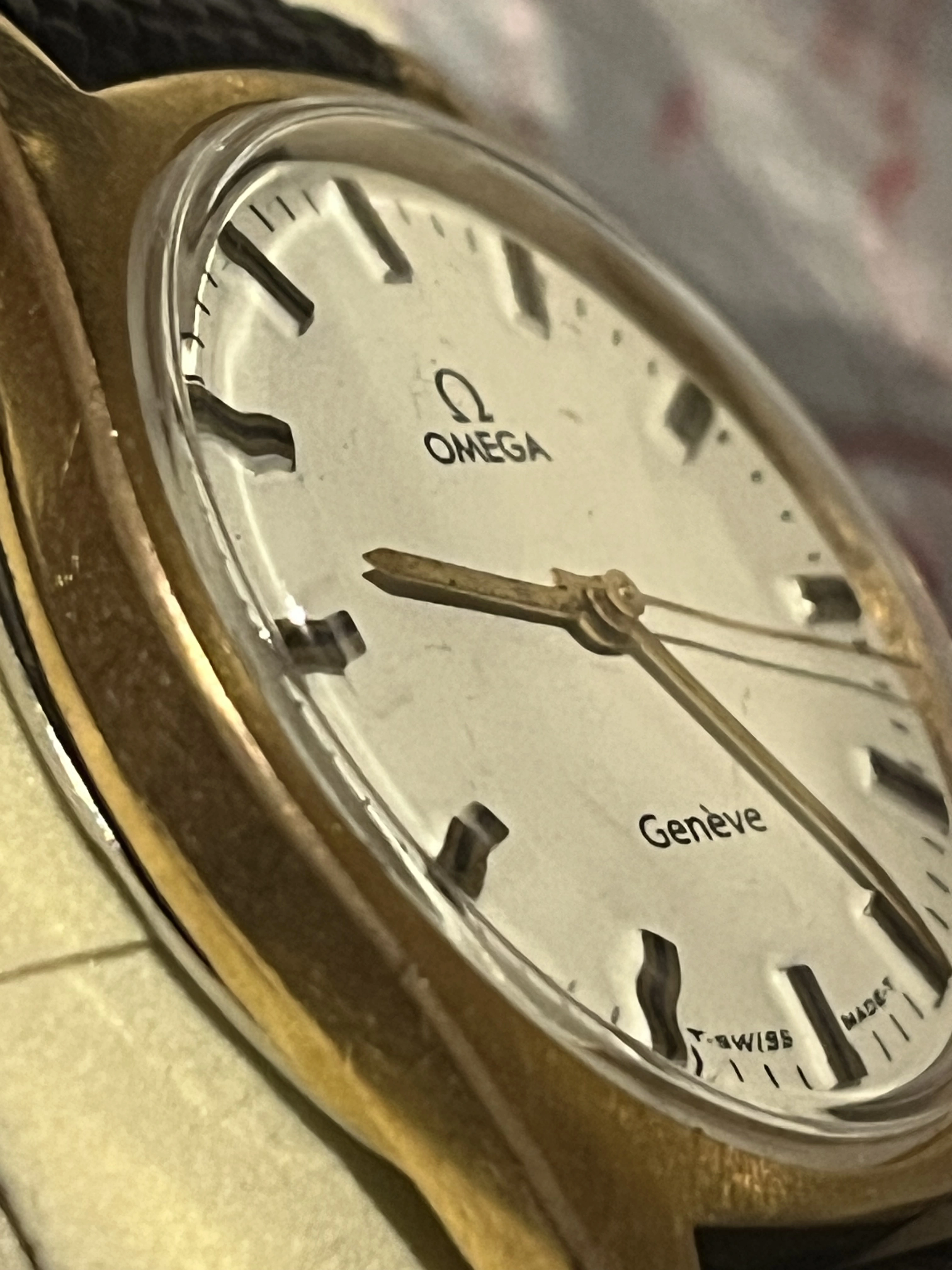

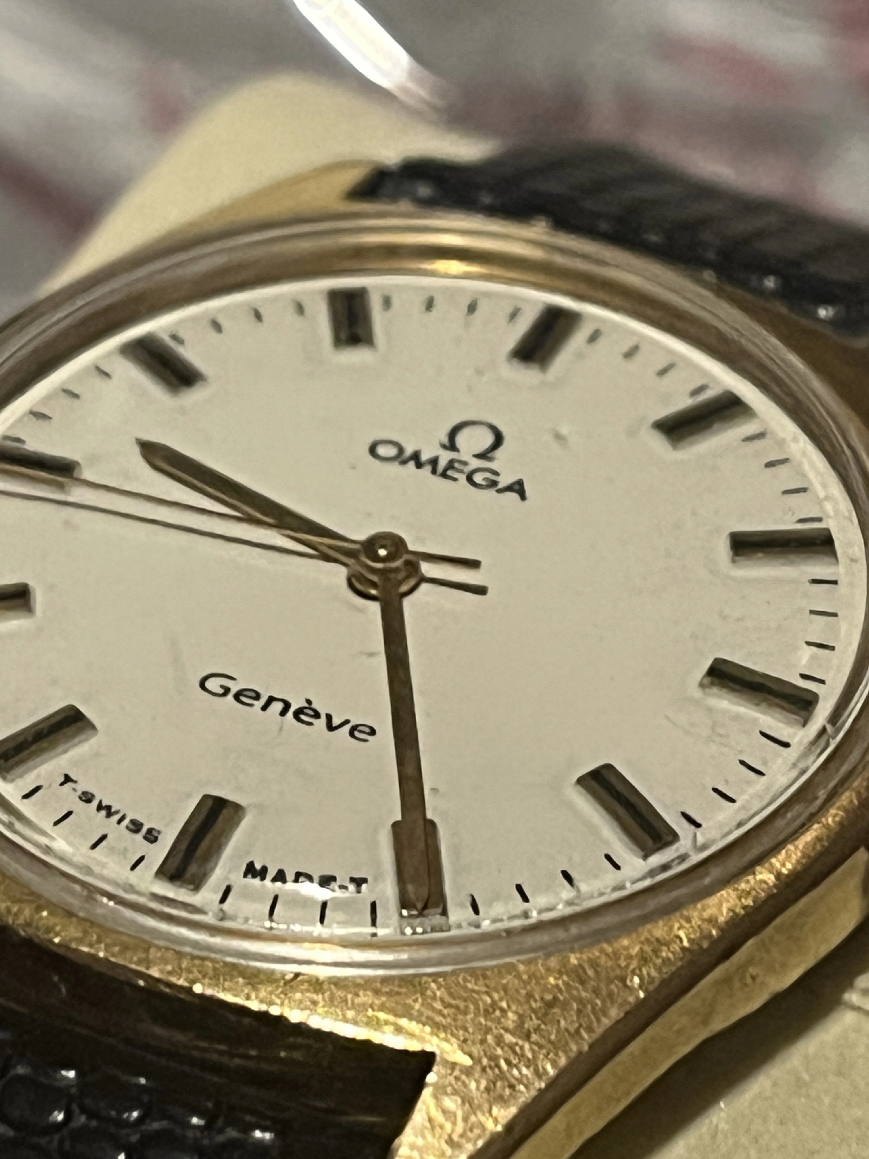

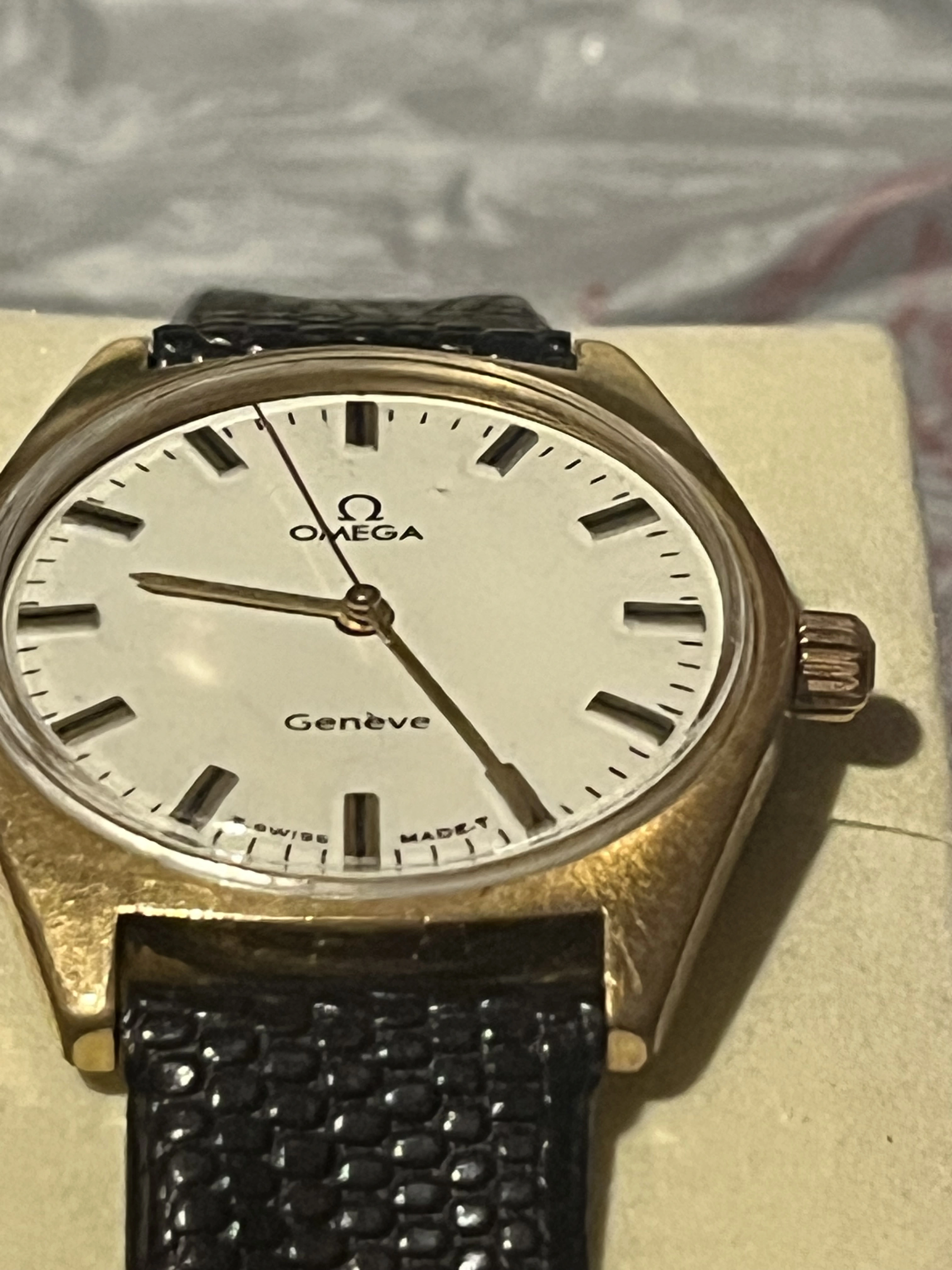

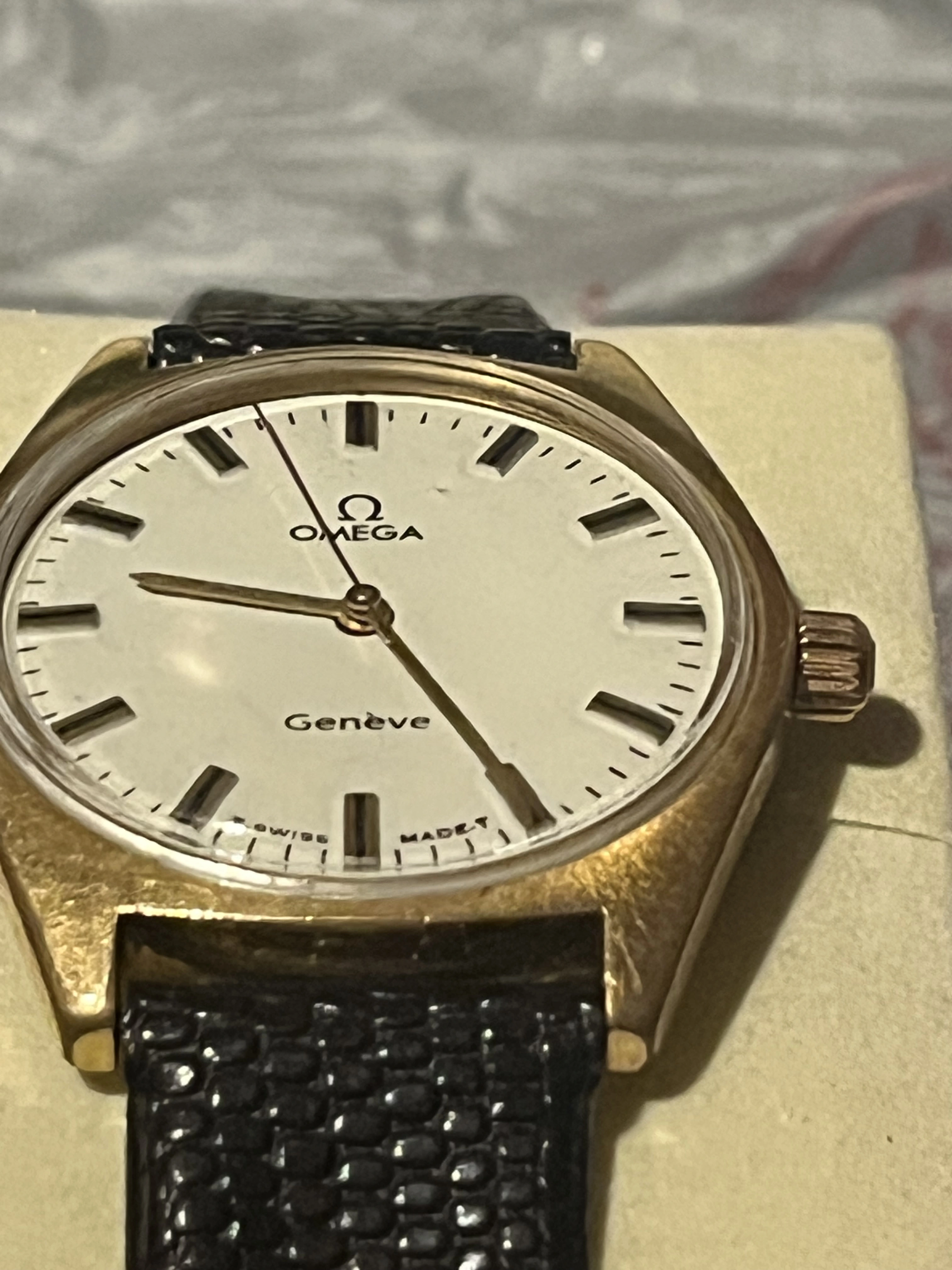

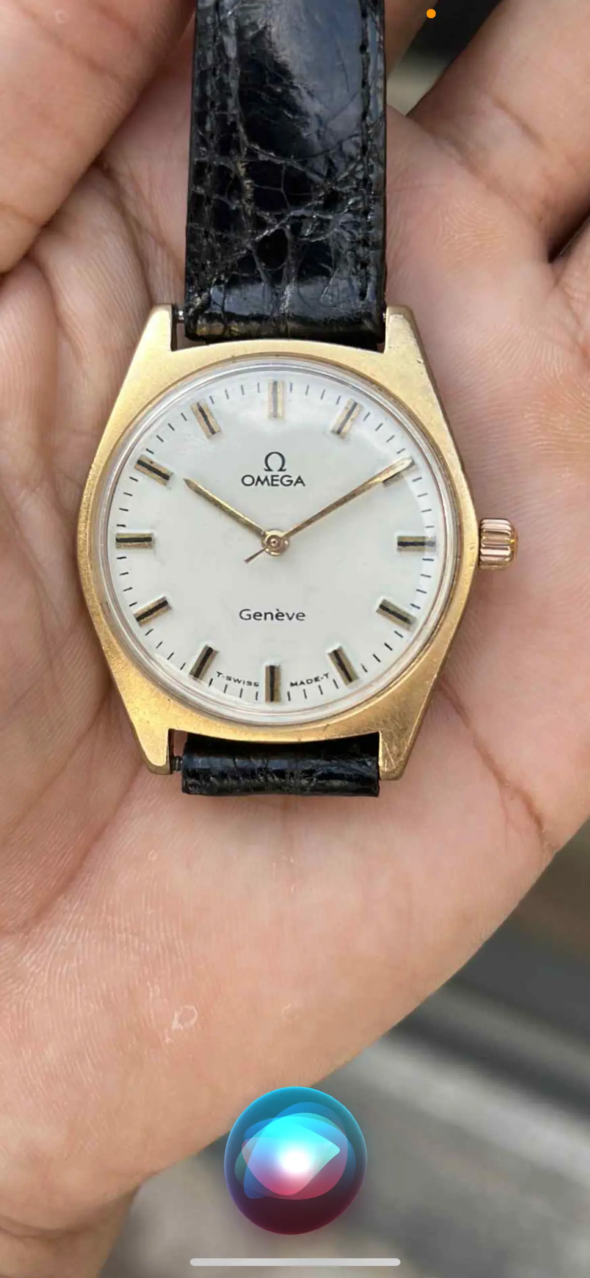

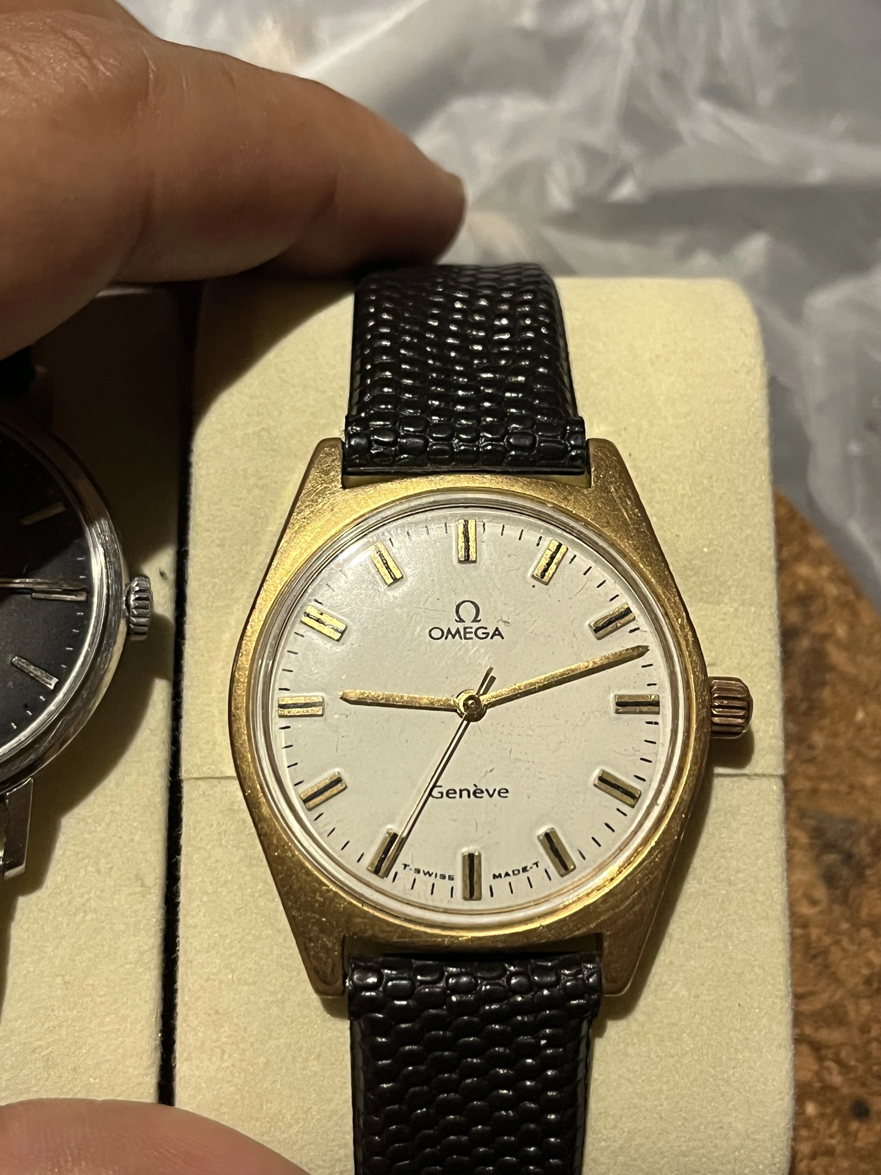

Posts 1 Likes 0 andsed ·Sep 24, 2025 Could you please let me know if the dial and hands look original/authentic to this model, or if they might have been replaced or refinished?

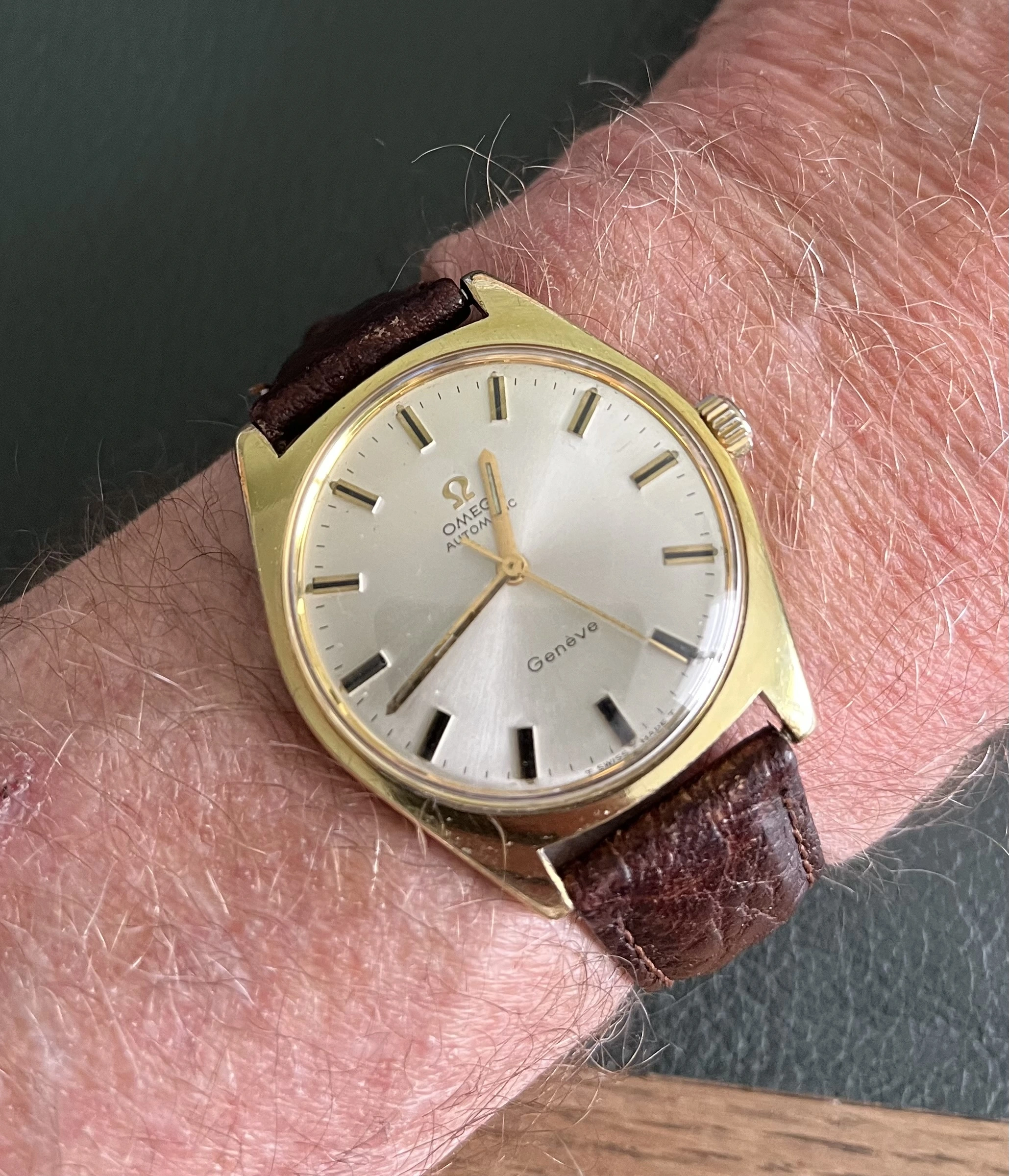

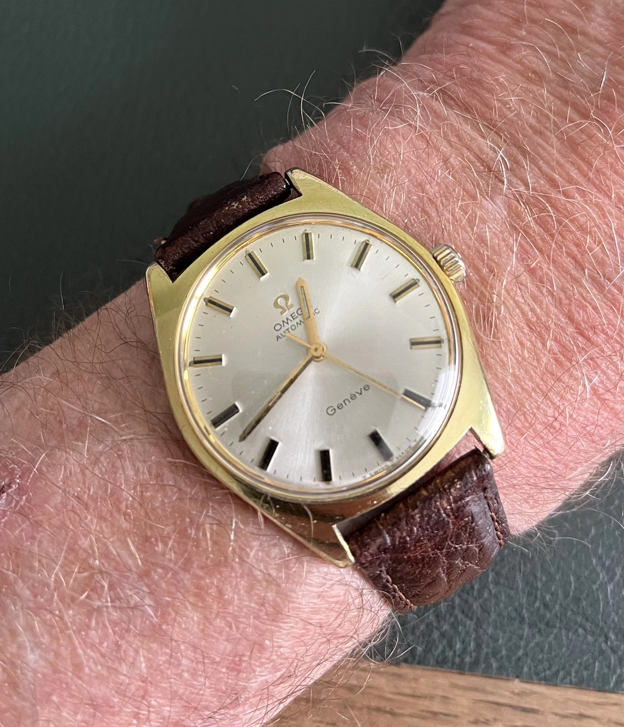

Posts 8,814 Likes 73,164 Spruce ·Sep 24, 2025·Sunburst dial fan The case is horribly messed up and the crown is an incorrect replacement And, if you find one you like, I’d go for the applied Omega logo rather than the printed one on the dial. I have one myself for you to compare.
Posts 18,133 Likes 37,844 JimInOz ·Sep 25, 2025·Melbourne Australia Really awful re-dial, replacement hands, other issues as noted above. A pointer for you is the "T Swiss Made T", can you see tritium on the dial or hands?
