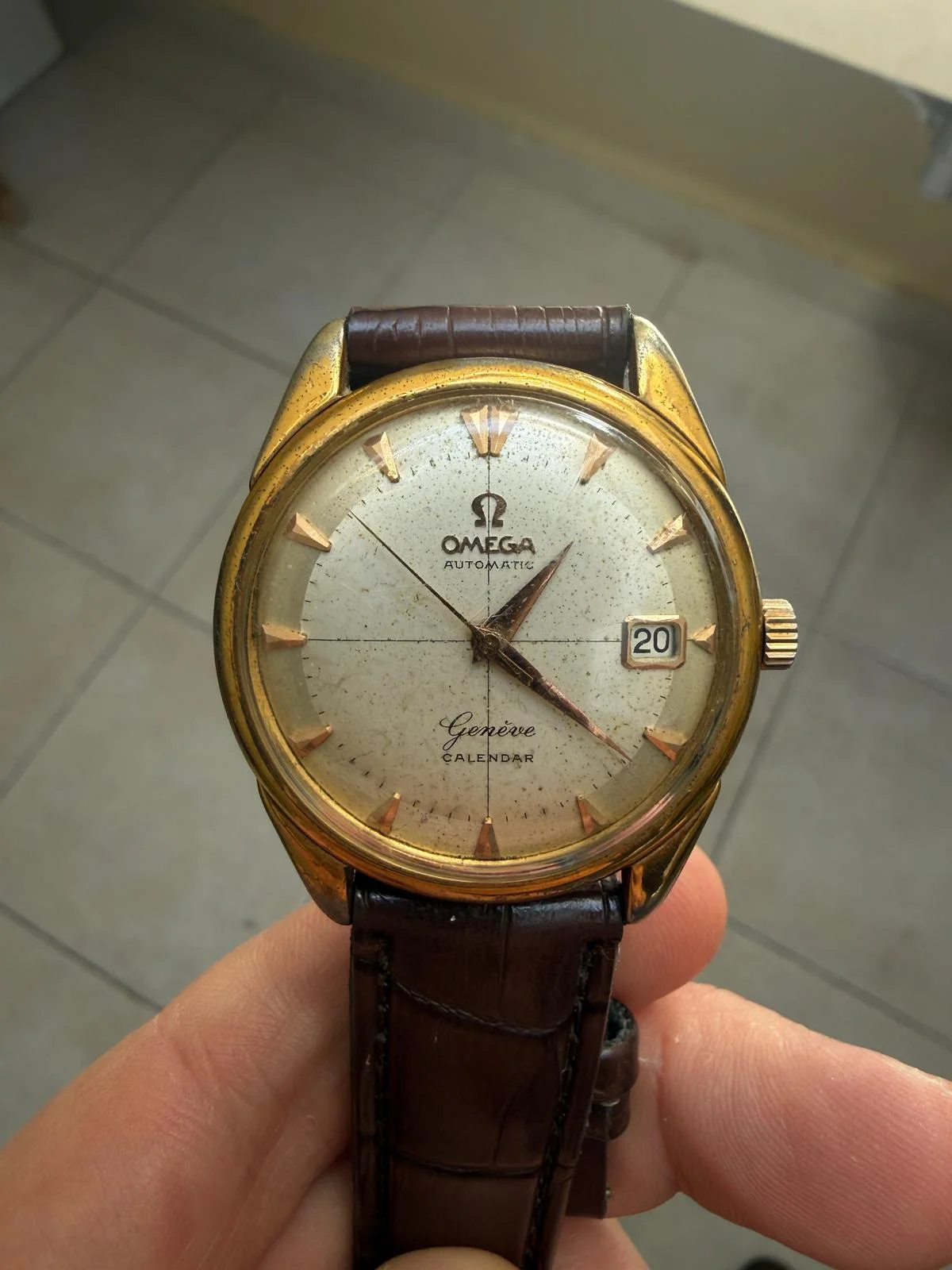

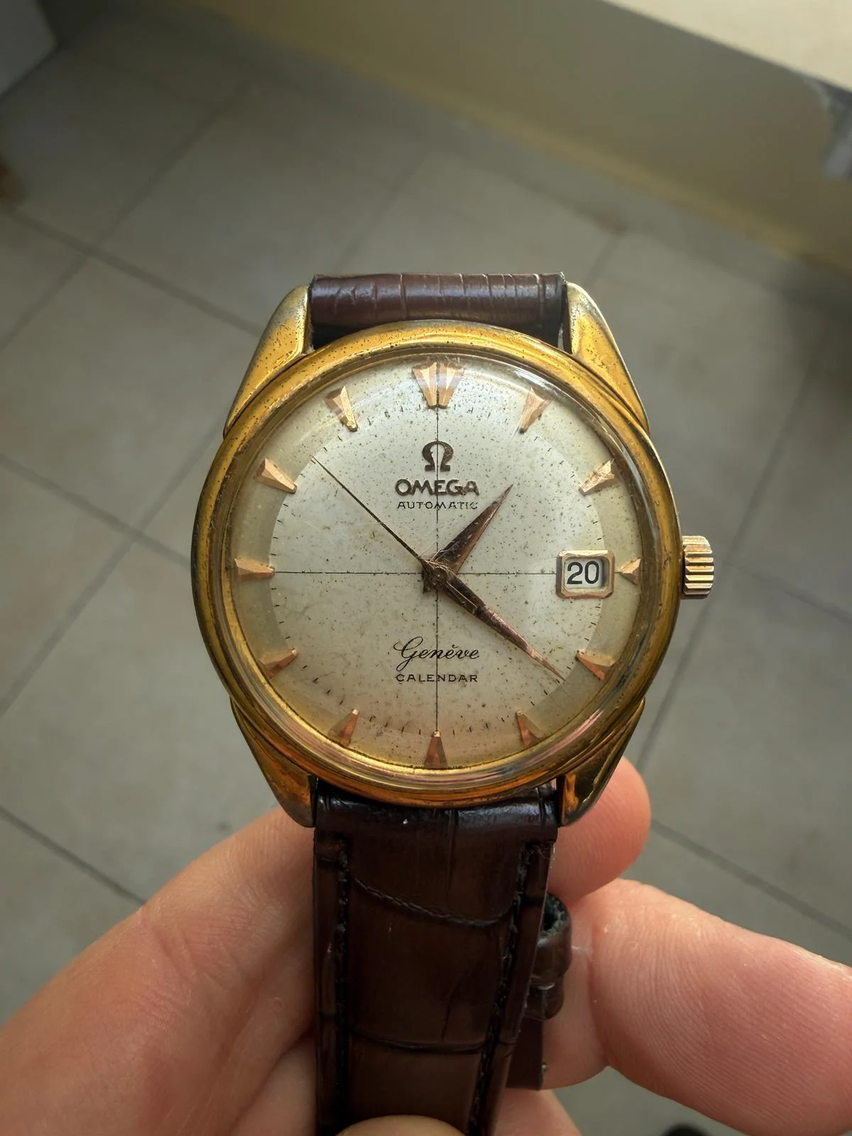

Hi everyone,
I recently acquired this Omega Genève Calendar automatic (1960s, I believe ref. 2982, though I have not yet confirmed the exact caliber).
My goal is not to sell it - I would like to wear the watch daily, but without unnecessarily harming its originality or collector value.
Current condition:
• It is running well
• Keeps time properly
• The date changes correctly when adjusted manually
• The date does not advance automatically at midnight
• Dial shows visible patina (spots and creamy tone)
• Acrylic crystal is heavily scratched
• Gold-colored case shows significant wear on the lugs (appears to be gold plated)
• Unknown service history
Main questions:
1. Would you recommend a full movement service even though it is currently running?
2. Is the non-advancing date typically a simple issue (dry lubrication / tired spring), or could it indicate something more serious?
3. Since it appears to be gold plated, would you suggest:
• Light cleaning only?
• Or re-plating?
4. I personally like the dial patina - would you keep it original, or consider refinishing?
My intention is to:
✔ Service the movement if necessary
✔ Replace the crystal
✔ Make it reliable for daily wear
❓ But avoid damaging originality
What would be the most sensible approach in your opinion?
Thank you in advance for your advice!

Does the date advance slightly after midnight? It’s usual for the date change to happen slight before or after.
That said, if it were me I wouldn’t spend more money restoring this watch unless it has sentimental value. The case has some pitting and has been polished past its gold plating. Dial is also very tired. I love these old geneves but you'd be better off wearing this as is, and save for a nicer example.

Just to clarify, the date does not advance automatically at all. It only changes when I adjust it manually via the crown. Around midnight there is no movement of the date wheel whatsoever.
Regarding the case, could you please explain how you identified that it has been polished past the gold plating? I’m still learning, so I’d really appreciate understanding what signs to look for.
Thanks again for taking the time to share your opinion, it’s very helpful.
On the top right lug, you can see there is a silver-ish base metal showing. There’s also deep black spots all around the watch, so this is likely pitting in the case (not just something on the surface).

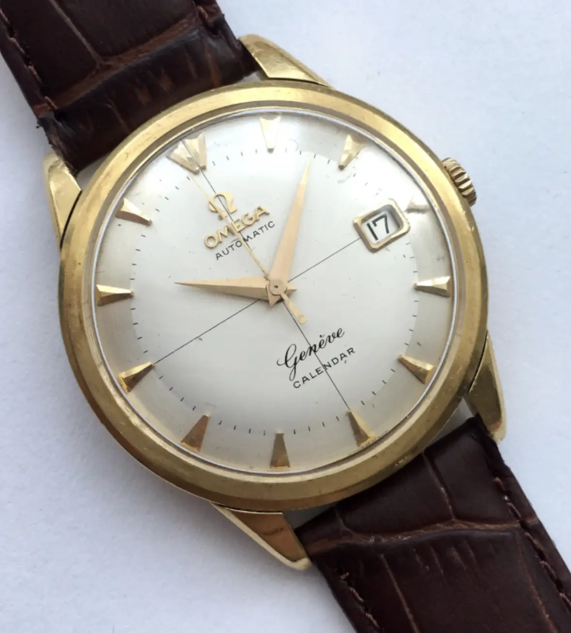

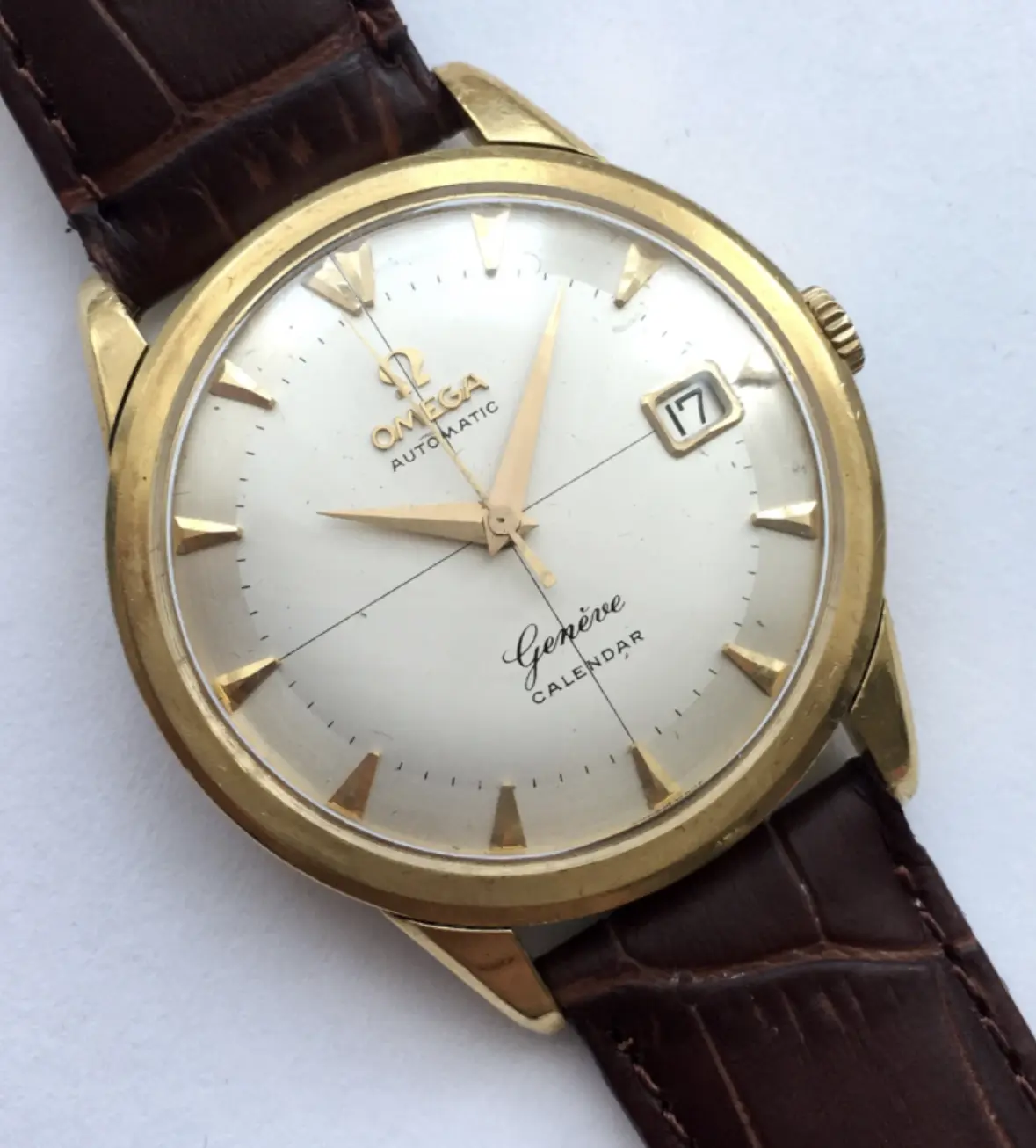

If you look at other examples of cursive Geneves, you will also see that the bezel and case should have sharp facets on the edges. So the one you have is polished. For example, here’s one I found online - notice the facets on the edges of the bezel, which is missing in your example.

Regarding the date change, maybe someone damaged the mechanism by using the quickset date it too close to midnight. Not sure how easy the fix is or if this is even causing the issue, so will defer to other forum members.

To be totally candid, because of the condition of case and dial, the watch really doesn't have much collectible value, so you will have to make a personal decision about how much you like the watch, to guide you as you choose to have the watch repaired/restored. I can say that investing more money into this watch is not likely to be a good financial decision, i.e. if you sell the watch you will not recoup the money you put into it.
As you probably know, gold-plated cases were used in entry-level Omega watches in this era, and unfortunately the cases really were not made to last with regular wear. It is unfortunate, because Omega used movements in these watches, and the dials were often very attractive. This particular watch also appears to have experienced moisture ingress, based on the damage to the dial.

Well at least you have solid gold markers.. at least that is what they used to be on the first and second series Omega Genèves of this type.
You case is not only polished through its plating it’s almost made into a C shape Omega.
To bad for the pitting on your dial, I love these two tone dials. But maybe someday even this patina becomes en vogue. That case is just shot frankly.

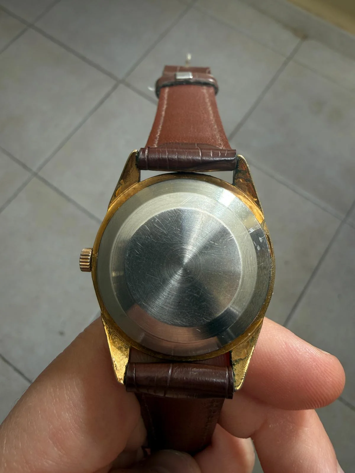

My understanding is watches of that vintage did NOT have a quickset date (~503 movement?), right? When you talk about changing the date with the crown, do you just mean advancing the time past midnight? If so, the mechanism when doing so automatically and with time-set are identical, so I don't know how it would work in 1 and not the other.
If it is a set, then it is likely a different movement than what came in the 2982. I'd have to see the back off the case though.
As others have said, sadly, this watch isn't really worth servicing. It'll cost you $300-$400 to get this through a watchmaker's bench, and I doubt it is really worth even as much as the service. IF you were local to me, I might be willing to poke at it (as a hobby watchmaker) as a favor since you seem to want to wear it.

I think the 563 ... quickset was around in the 1960s. Have not seen too many 503s which probably was a higher end complication in the 1950s.
Symptoms sound like a quickset, since there are separate mechinisims for date advance. The little finger on the midnight wheel was redesigned for reliability. To properly advance the date on non quickset involves moving the hands past 6:30. So if the crown adjusts the date when it is not midnight ...
Without a shot of the movement and inside case, there is not much to add.
