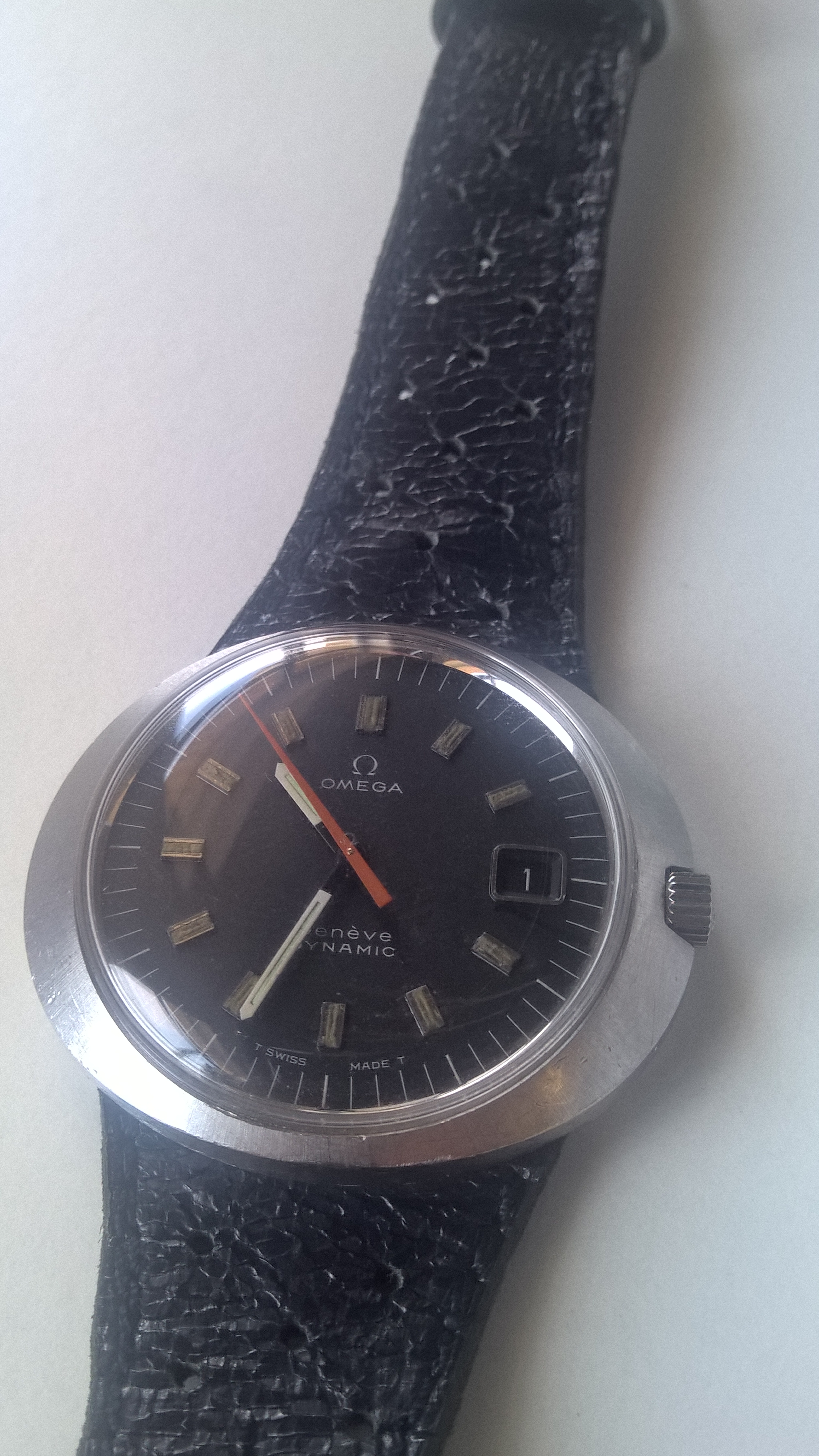

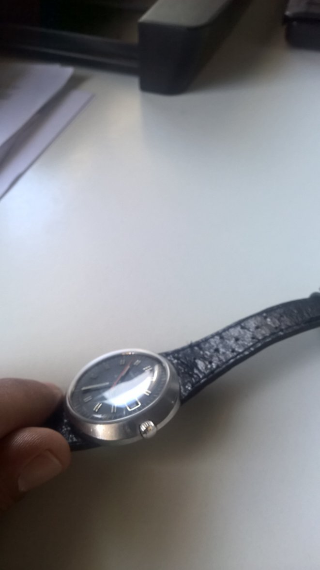

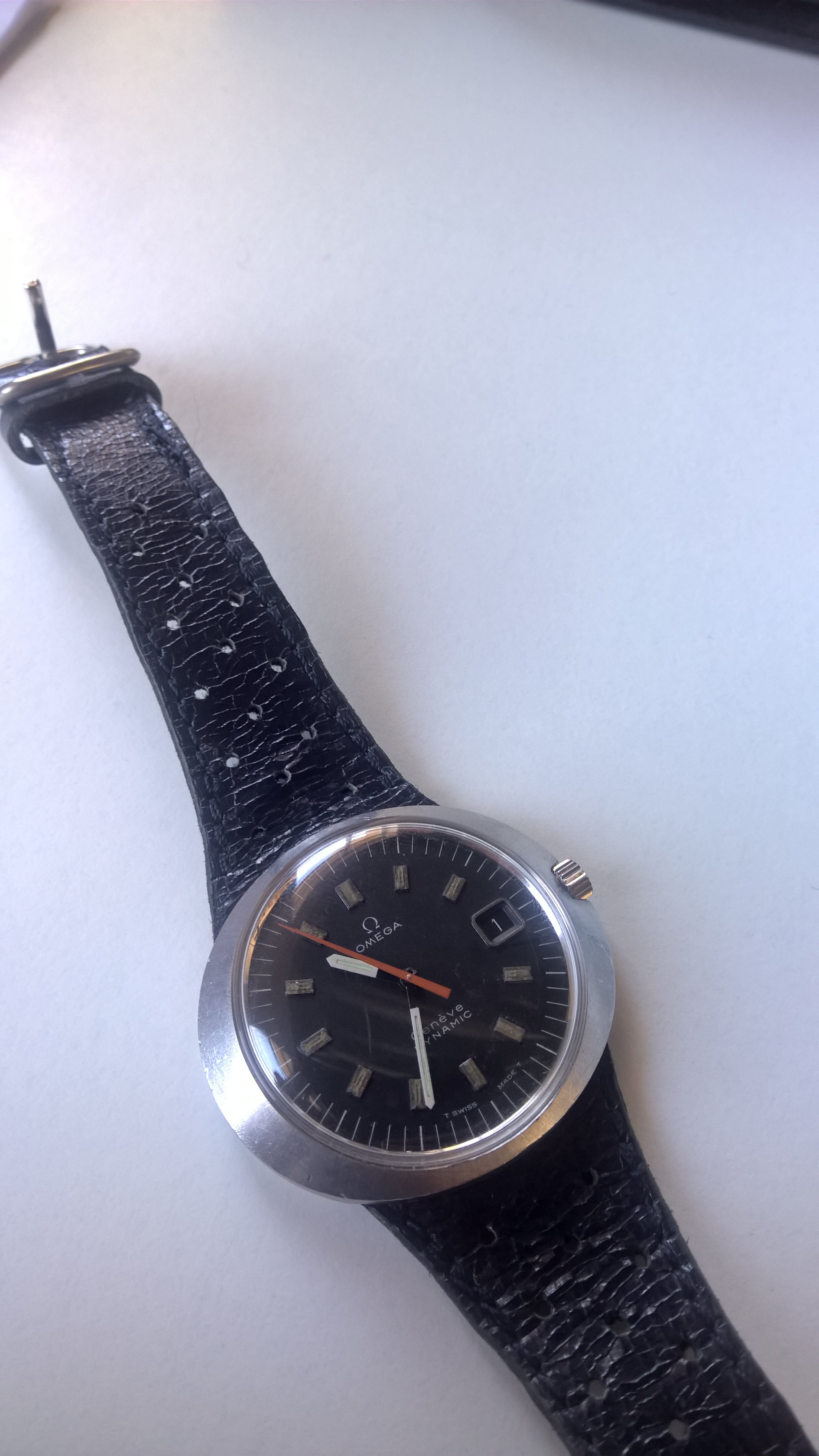

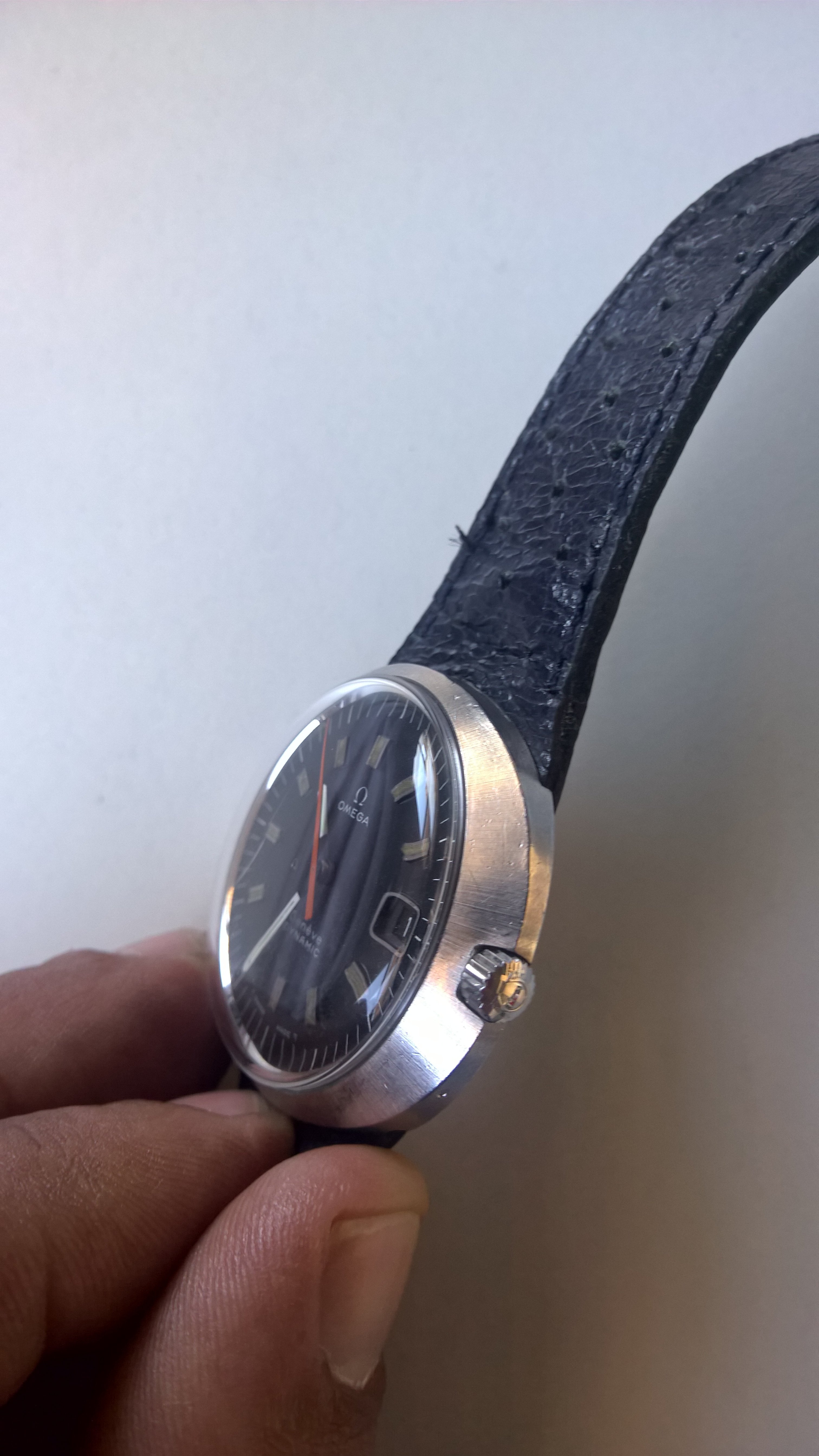

Anyway i´m posting some photos from the serviced omega dynamic...

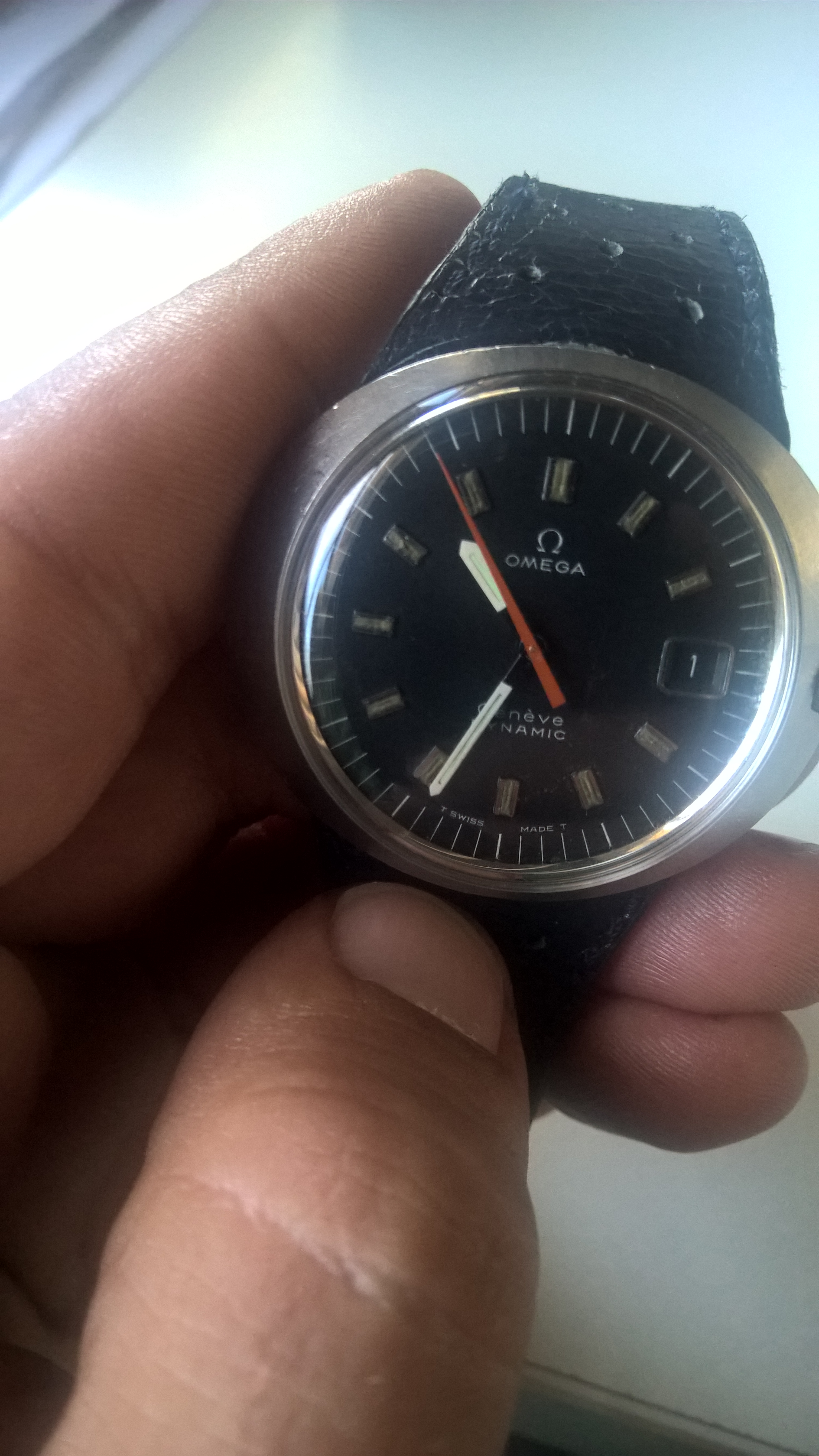

I´ve also replaced the crystal from Omega, wich i already scratch (see photos)...the genuine Omega crystal is really so easy to scratch? and could the crystal be polished or something?

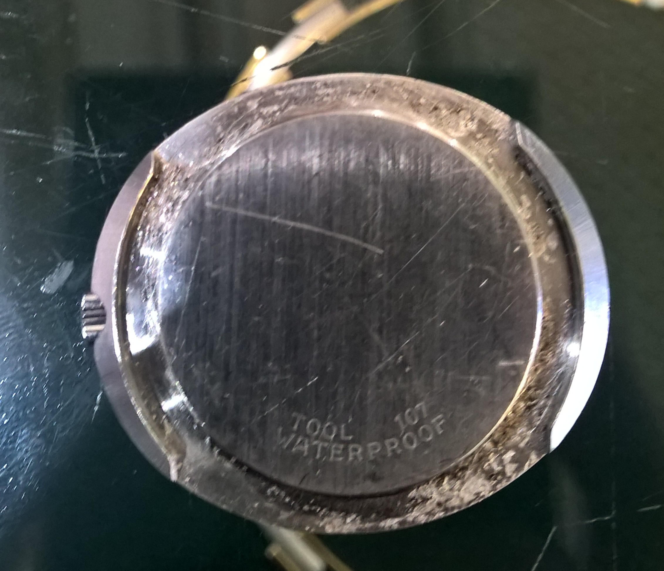

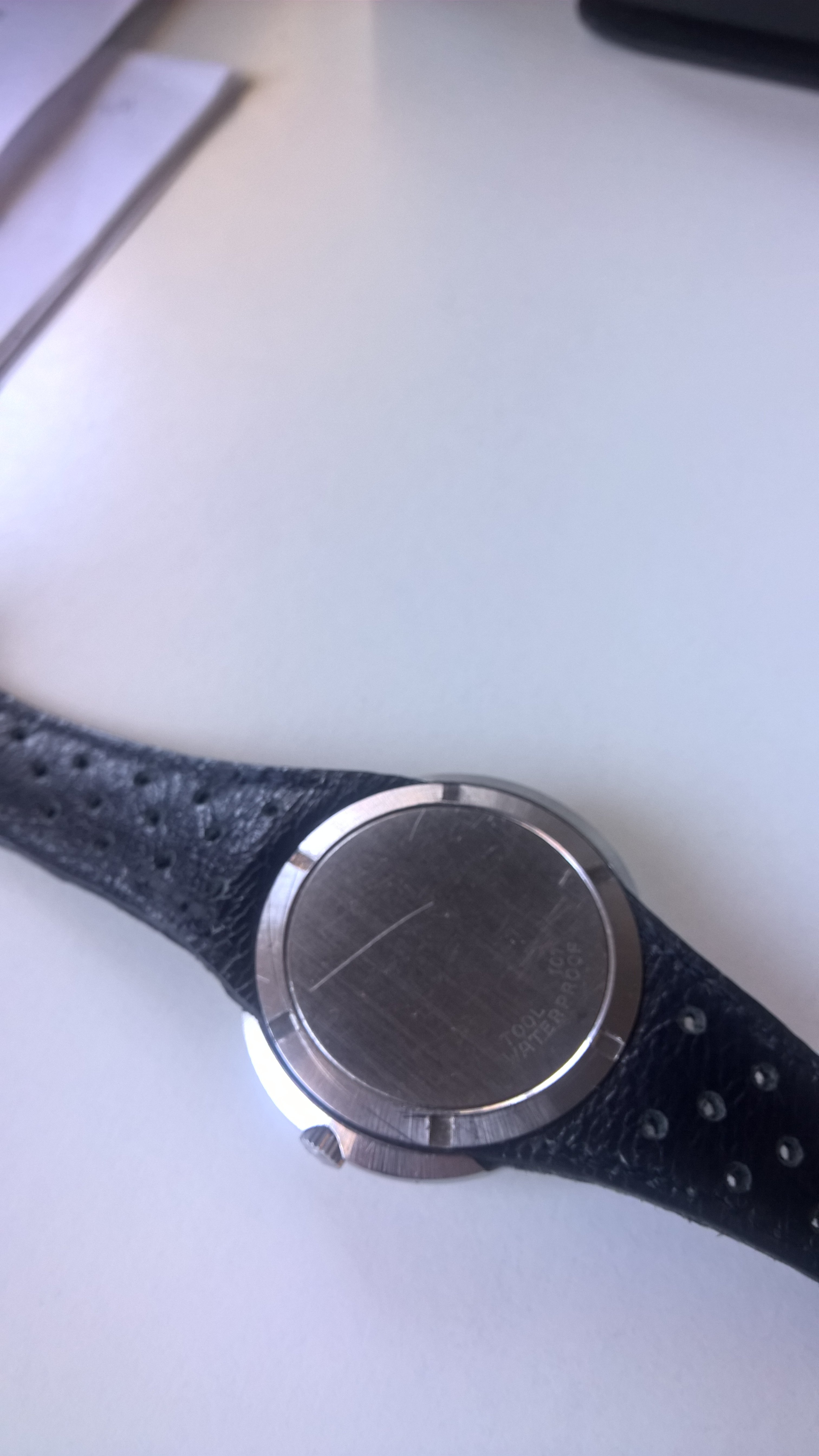

While i was returning the Omega to the jeweler, the watch strap was removed, and this was the horror i found in the back cover ...
17,968
37,553
You need to have a serious discussion with the service centre about their level of "service".
Your crystal is Hesalite (plastic) and will get scratches much easier than a sapphire one.
The good thing is that you can easily polish the scratches out, not like a sapphire one.
9
Regarding the level of "service" i´m very disappointed. Im guessing they subcontract the service to others, and just send the watch back with the service centre warranty (not Omega warranty). I´ve asked the jeweler about it, and he said that only if i send the Omega to get serviced in Switzerland will i get a Omega warranty like the one that JiminOz shared the photo above (thanks!!!). This makes no sense to me, if i´m paying a Omega service centre, i expect a Omega warranty...

Its been about two weeks since i´ve send my Omega back after it was first serviced, since he come back with some issues (it started delaying one hour each 2 days and then just stop working). Anyway, the jeweler call me yesterday to say that the Omega is back from service.
Like i´ve already said, i´m not really reassured about the quality of the service, and i´m wonder if the spots in the above back photo, if this is just corrosion as the jeweler say or the Omega wasnt even cleaned?
Thanks, i would appreciate some input!

Hi Manuel
Do you have the watch back now and it's running well? Or still with issues?
From what I can see in the picture of the back, it looks like corrosion but far easier for you to know when you have the watch in hand. The case must have been cleaned when the service was made.
It sounds to me like the jeweller contracted a Watchmaker who is Omega approved and it didn't go through the Omega network so, your warranty is from the Watchmaker. He still work to the same standard however it came to him.
I think the first thing is to get the watch back and see if it's clean. If it is, wear it and wind it at the same time each day (it appears to be a manual wind). Set it the first day and note the time and seconds versus an internet time source. Make a note each day how far it is out.
Let's see how it keeps time. Sometimes, mistakes happen but if they've had it twice, you'd expect it to be fine now.
