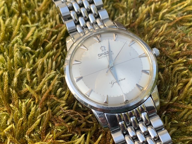

Dear Omega Forums,
Some of you might be aware that I have a couple of vintage Omegas.
Generally with my most special watches that I intend to keep I try to bring them back to their most original condition as possible.
This means I try to hunt for the correct crowns, buckles, boxes etc.
Here I have a nice 1959 Omega Geneve with cross hair dial. If I recall this is a 14702 case in SS. Carrying a calibre 552 movement.
Whilst the hands could probably do with a polish, and there is a slight blemish between the 2/3 o'clock the case is sharp and it's otherwise in very nice condition.
It does clearly however had a replacement crown. One which I think looks quite bulky on this model. Does anyone know the correct crown that this model should have or any details which could help me find the correct one say on ebay, which I would be able to swap this out with.
It also has the original crystal but sadly it has a very small crack I think near the 12, although in this photo I cannot see it. Do you think I should leave the cracked crystal in or replace?
Whilst I'm using a beads of rice bracelet, I have just purchased a seamaster that this will be moved to, and I'll be fitting this with a leather strap. What buckle should this model have been fitted with?
Finally, what kind of presentation box would this have been sold in? I've seen countless of the red Omega boxes that seem to be for sale on ebay everyday, would it have been one of these ones? Or something a little more special?

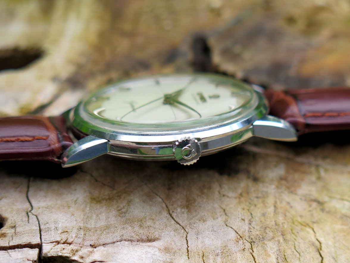

I think the crown of the first watch shown in this thread is correct:
https://omegaforums.net/threads/the-old-gen茅ve麓s-lets-see-them.59067/

Thank you I don't suppose you would know, or someone else here would know what I would need to be searching for to find this specific one?
Sorry, I don't know the part number or where to find this crown, but I'm convinced some other members here do know and will be able to help you.

I hope so! Thank you for your help 馃榾
2,816
6,951
Not sure if that鈥檚 the correct replacement part or not, but it definitely isn鈥檛 the correct style. Originals were much thinner.
1,453
3,023
Yeah I thought it looked chunkier - it is what is under this case reference on cousinuk though - perhaps someone would know the part ref of the original crown?

For case 14702 - 069ST32004
For case 14703 - 069ST32006
