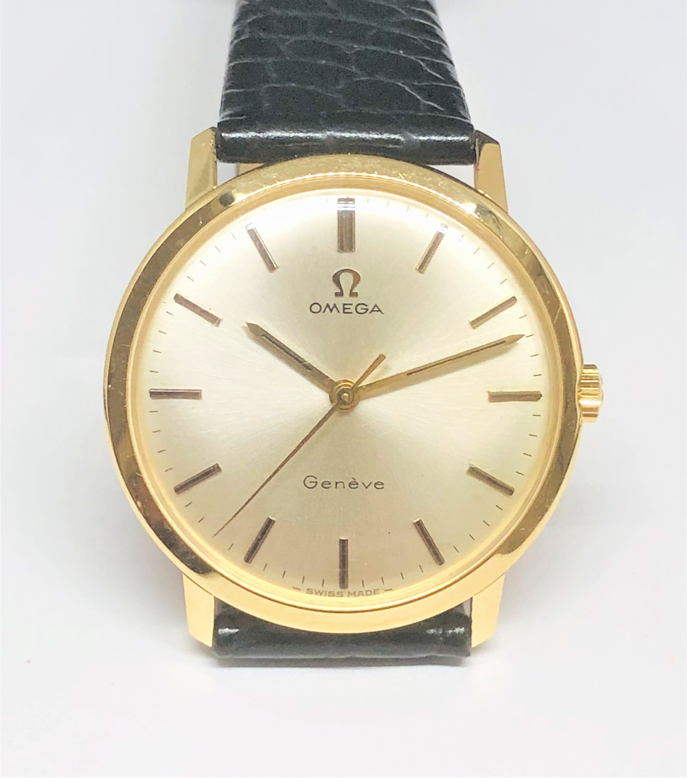

A good friend of mine received an Omega Geneva from his wife on their wedding day. Here is a picture of it:
somehow, while partying during the evening, he unfortunately lost the bezel… I don’t have a picture of that yet though. So now he contacted the watchmaker if he could help. He said he would like to, but he also said it’s very difficult to find in solid gold.
So the watch is 18k and now my friend (and the watchmaker) are searching for a matching bezel for the watch. Since it seems difficult to find I thought I might ask you for any suggestions/help. Does anyone know any way to come across a bezel like that, or maybe have any other thoughts?

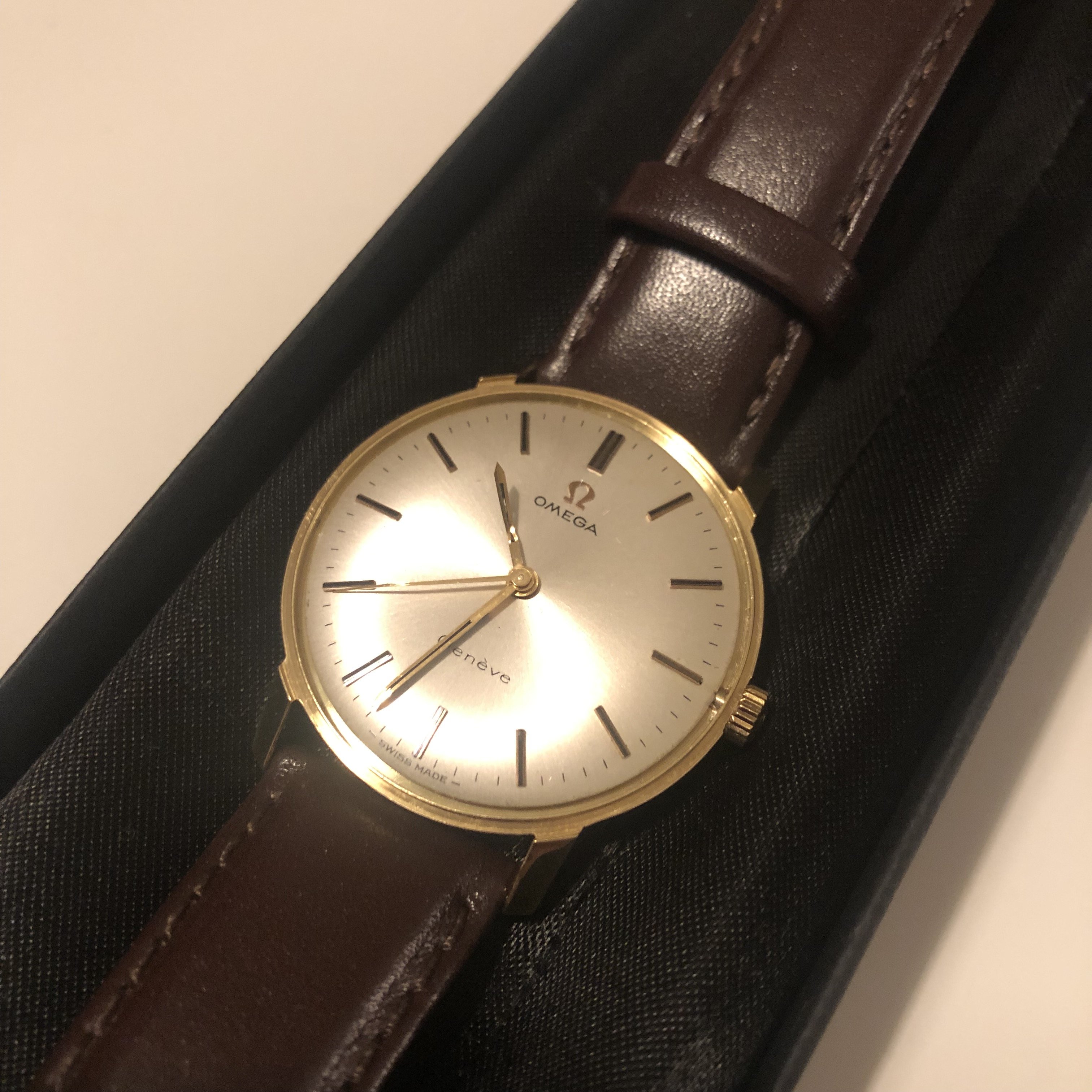

Edit: picture of the watch without the bezel

This is probably not the reply you’d hope for, but finding a spare 18k bezel will be close to impossible. I’d say your best bet would be to find the measurements and ask a goldsmith to make you one.

Yeah, I was afraid to get an answer like that. But I understand.
It’s a 131.021 SP with a cal 601.

Just checked - no bezels available from Omega. Sometimes they do have them, so it's always worth checking.
Not sure where you are located, but if in the US you may want to have your watchmaker contact this place:
HOME | watchcaserepair.com
I've used Peter several times, and the work has been of good quality and reasonably priced.
