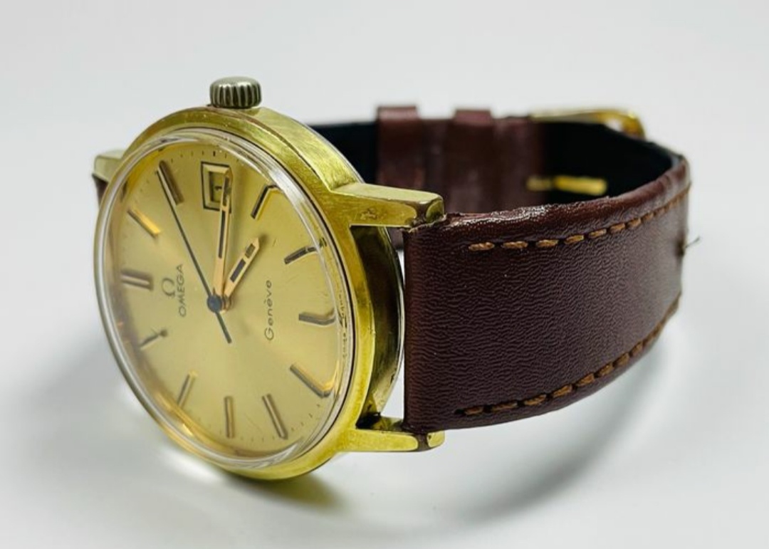

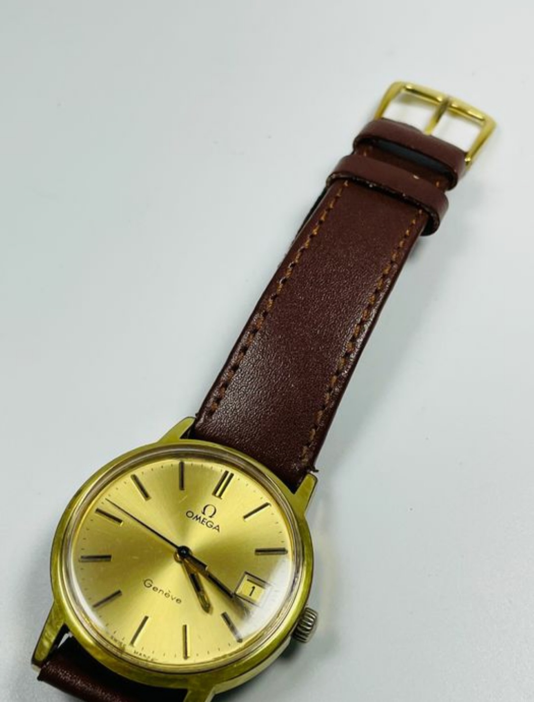

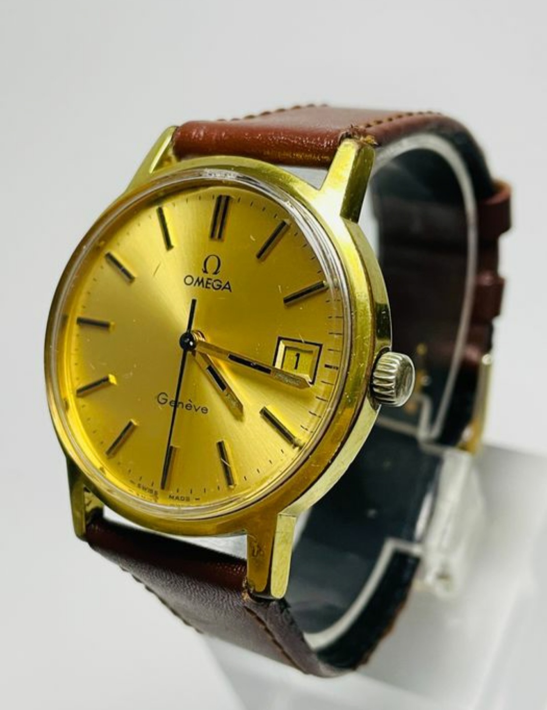

I'm really getting into (Omega) watches the last few days and I want to buy my first watch. Thing is, I'm no expert. So I found this watch (Omega Genève 136.0098) which I thought looks nice. It will cost me around 400 euro's including shipping. Service history unknown, but it's working fine. But as I've no idea what to look for I don't know if this is a good deal at all. Is it worth that much? How does it look to you? Can you tell me something about this watch?
Any info would be appreciated. Thanks a million!
Some pics:

welcome to a very addictive hobby - I’d suggest you skip on this one, though. Google “Omega 136.0098” and look at pictures of a few other examples to compare the lugs. This one has been heavily polished and if you zoom in on the edges of them you’ll see the gold plating has been polished off. It has lost its distinctive, sharp shape and the decorative thin layer of precious metal. The crown is also very worn.
By the way: The watch was sold on Catawiki only a few days ago for 260€, which is a much more realistic value for it in this condition (although I’d still consider that too much with a case this poor). Here’s the link:
https://www.catawiki.com/de/l/26879057-omega-geneve-136-0098-herren-1970-1979
Your seller is simply a flipper, trying to make 100€+ or so on you. Check eBay open auctions for those Genèves, they usually end between 250-350€, even if they’re quite nice. The classifieds of this forum might also be good to check out occasionally.

Agree with @MtV. This isn’t a good example as the case is poor.
These gold cap are the least desirable case material and the Geneves at this point were entry leve so they should be the cheapest vintage Omegas out there.
If you want gold cap, with some patience you should be able to find one in very good condition for the same price or perhaps a little more.

Isn't this 20 micron gold plated on brass (or a comparable alloy)? I haven't seen gold capped geneves before (maybe apart from the first generation with italic geneve writing). I would agree that gold plating is the least desirable case material but would also say that gold capped omegas are considerably more desirable than gold plated ones. If we go beyond the geneve line, some vintage Omegas are more sought after in gold capped versions than in steel versions in my experience (Seamaster De Villes being an example). But of course there could be geographical differences in that.
Anyway, I agree that the OP should look further. If your budget is in the 400 euro range then look for a geneve in steel, for example reference 166.070. With some patience you can find a nice one of those within your budget.

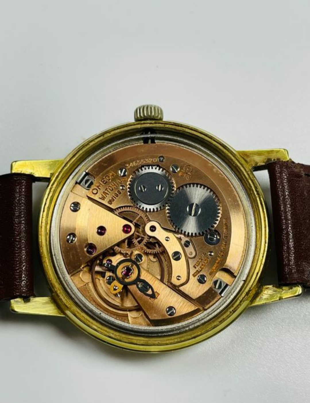

The Catawiki watch and the watch the OP is considering are not the same. The case of the Catawiki watch is in a considerable worse condition and the movement serial numbers are different.

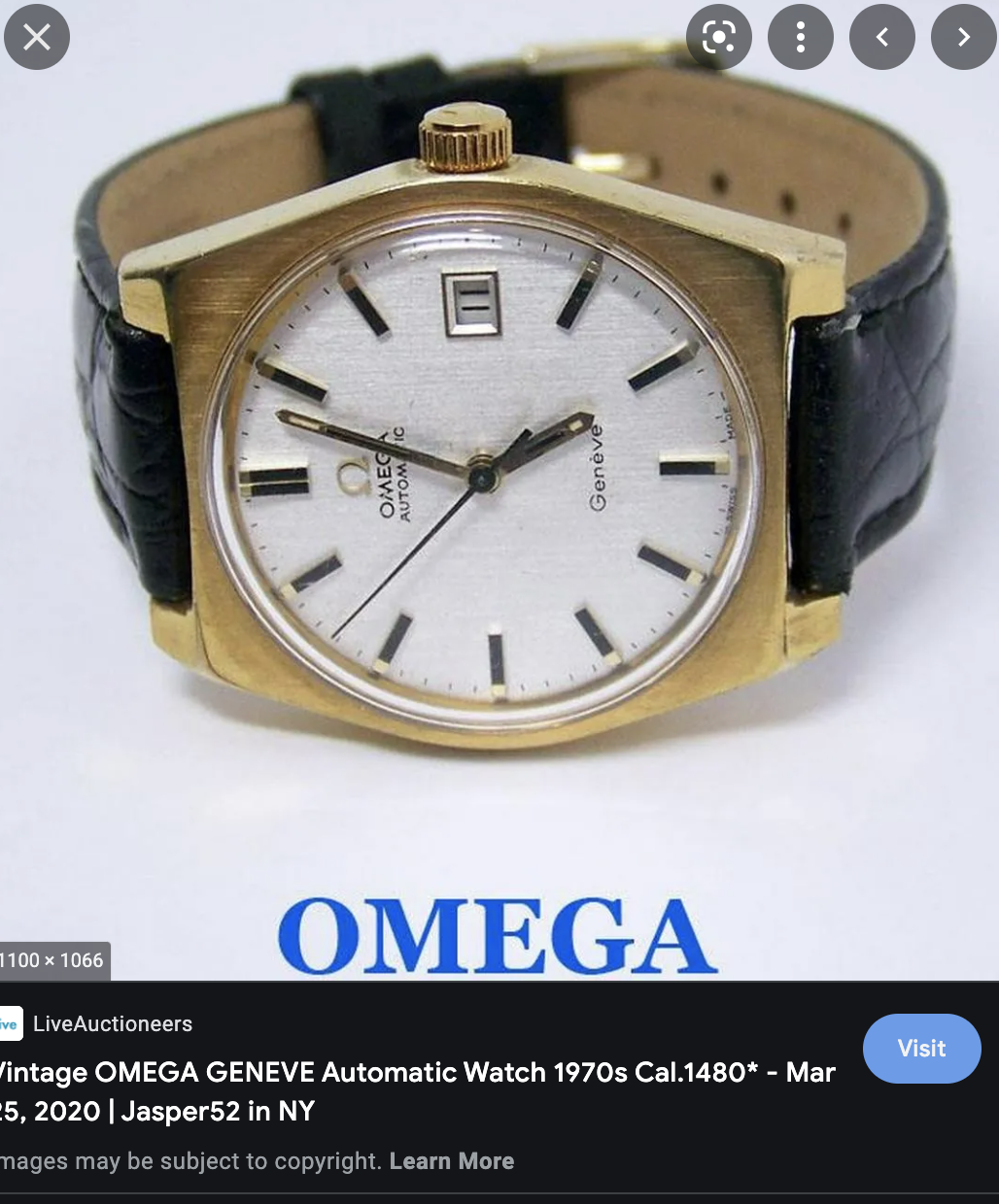

That doesn't look like a gold capped model to me, which is usually a decent choice. Rather. That looks to be gold plated, which is not a good choice for durability.
Gold caps only rarely wear through.

I agree the watch in this thread is a dog. But accuracy matters, others see these threads and may rely on the info.

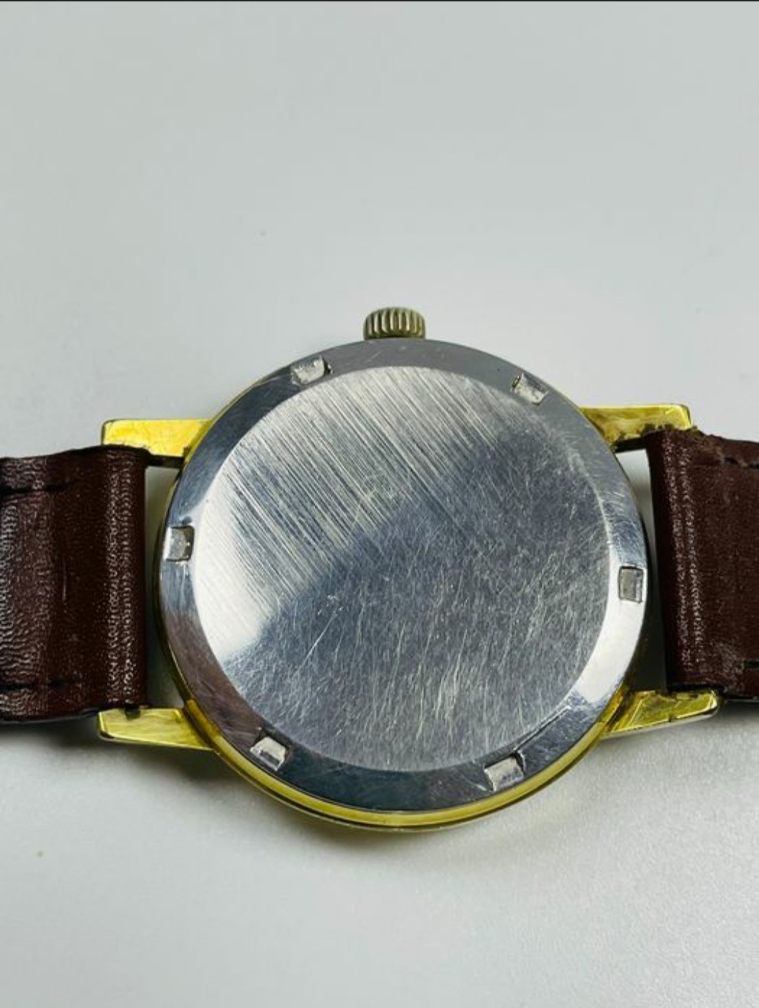

Gold capped is a thick gold Case Shell that is pressure soldered over a stainless case. These caps are very thick and durable and the underlying metal, stainless, is also very durable. These watches retain crisp lines, and in good condition look just like a solid gold watch. From the underside you see the stainless base. The cap is pressed down from the top only. Also, these watches can be laser welded and restored.
Gold filled is also a soldering process, but is thinner generally than a gold cap. It will wear through easier, and is basically a mure durable alternative to electroplating. Once it wears through, it can't easily be repaired, apart from electroplating over the whole affair with often limited results. The base metal is usually some sort of copper alloy.
Lastly we have electroplating, measured in microns. This is cheap, done over a cheap base metal like brass. The OPs watch is electroplated.

I desire steel more also but gold coated watches lately are very desired too, almost on par and sometimes more, very annoying when you are on the buying side

I’m not sure what your point is.
Ive already said I’m not an expert in the various gold plated/capped/filled models of this reference. I said, gold capped, you said it’s plated and I agreed you’re probably right.
What I am saying is regardless of the how the gold top layer is applied, if the base metal is showing through its a poor example and better avoided.
I also think the market (and I agree) almost exclusively values gold capped/filled/plated below stee and solid gold, perhaps with the exception of some rose gold capped models.

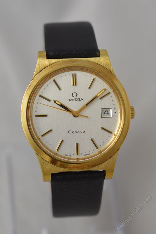

For reference, i saw in an UK antique shop this week, and fantastic gold plated Geneva in NOS condition ( albeit the case back was engraved), boxed, with 1977 omega certificate and instructions booklet, orignal omega black leather strap and buckle - asking price was GBP 350, but shop owner would take lower
unfortunately, i didnt take photos, so cant rember now what ref it was, but it could have been something like this - as it had large heavy downturned lugs.

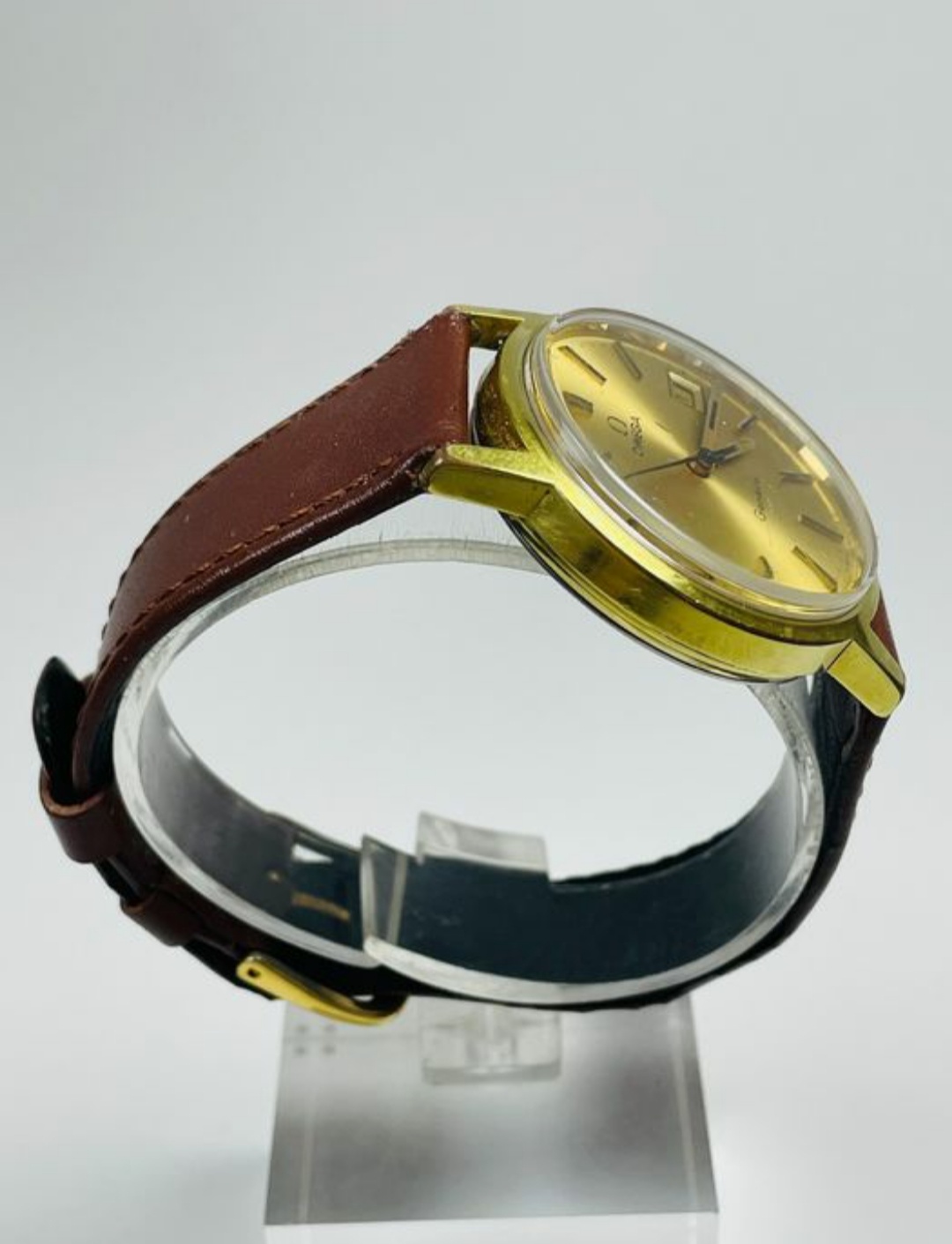

Downturned lugs might mean a Tissot movement though
Can you explain what you mean by this?
This is the easiest way to identify a gold-capped case IMO.
...if the base metal is showing through its a poor example and better avoided.
I assume that later incarnations had cal 1481s, the equivalent of Tissots 2481.

Yeah, indeed - my personal opinion; worse than Omega's 1000+ cal movements, free hanging dials kept in place with the caseback etc. - didn't have a good experience with one
Ah right. I thought these had 10xx movement such as the 1010 or 1012. Didn’t realise things slipped even further in the late 70’s.
